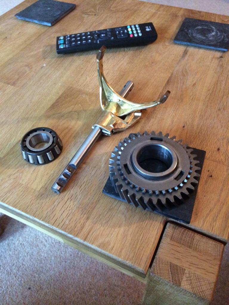

Few more little bits today NorthloopCup managed to scavenge a few bits from a gearbox to replace the knackered 1st that wheel spin Wayne had destroyed and a decent selector and a nice bearing that we damaged whilst stripping the old box

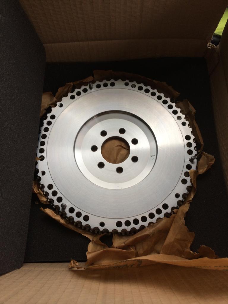

Well had a delivery yesterday, some more shiney bits so had to pop post office this morning whilst on route to me mates stag do in Liverpool to collect this

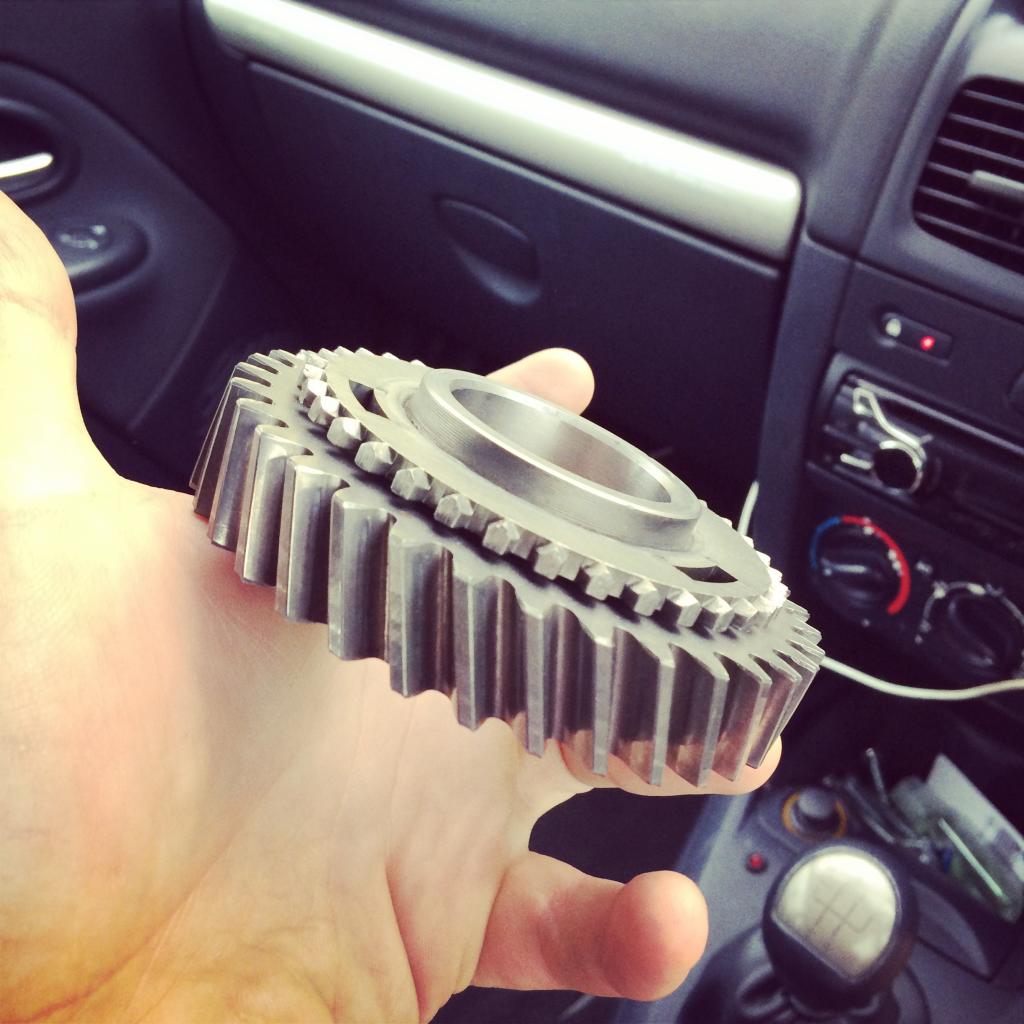

So for the last 90 miles this has been my passenger :) a 2.9kg lightened and balanced flywheel

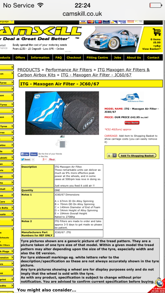

So after my trip up to Liverpool in the monsoon weather we had over the weekend the wonderful ktec filter supplied with there induction kit decided to get a little damp and let some of that dampness through causing a slight stutter :s
After looking at an ITG filter NorthloopCup had in his possession and seeing how it was better designed internally I decided to get one ordered off camskill

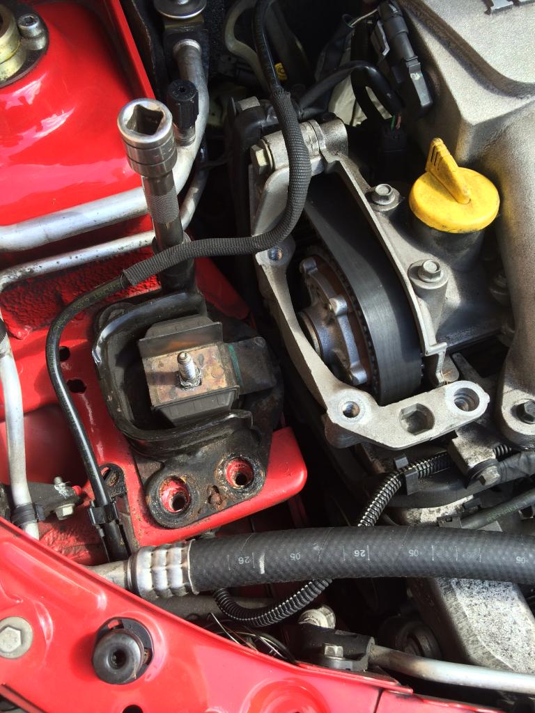

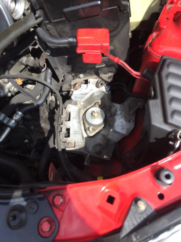

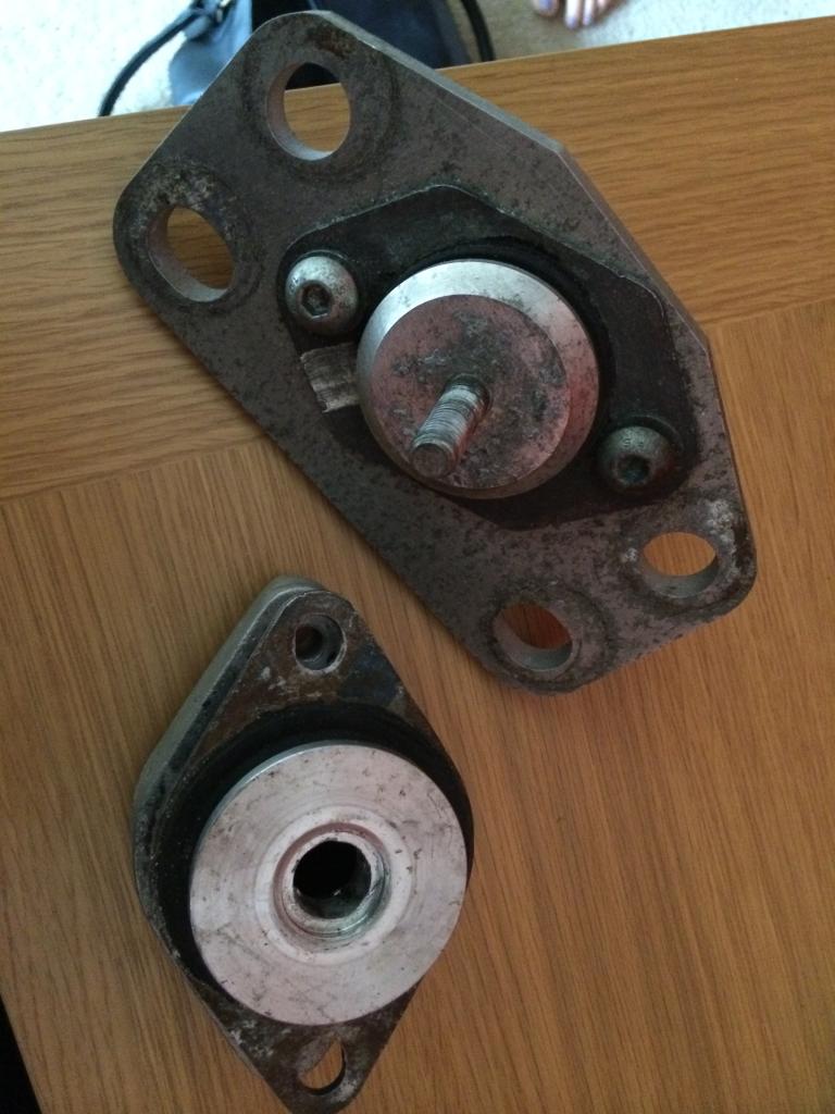

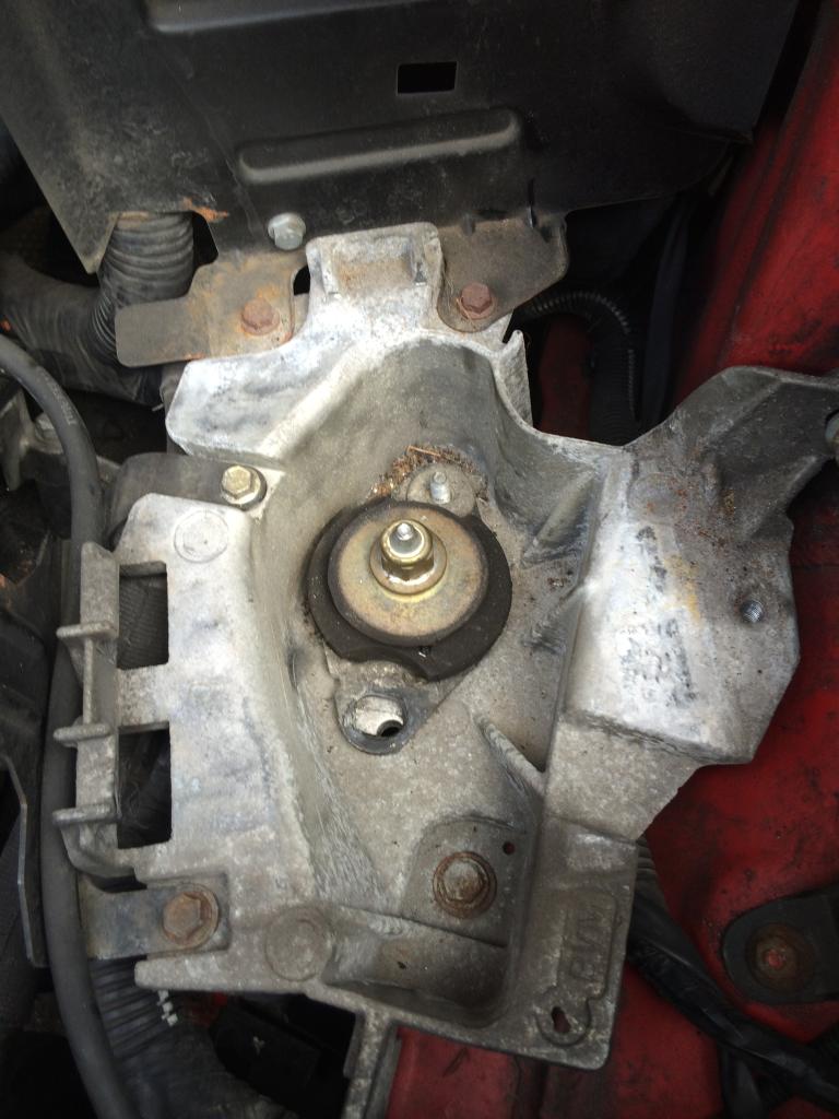

Well today I decided to fit me vibratechnics engine mounts and powerflex dog bone. Took a few pictures but as once got carried away with working
Old drivers side mount
New drivers side mount

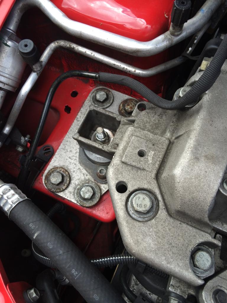

Then for the passenger side
Old
New

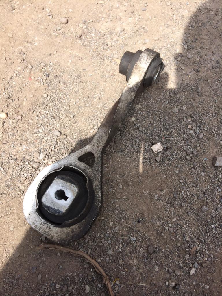

Old dog bone
The smaller bush had collapsed on the dog bone so that would of resulted in increased engine movement.
I had these fitted on my 172 so I knew what to expect vibration wise but I don't find them that and personally but they have helped with a more positive shift especially when down changing for roundabouts and corners.
