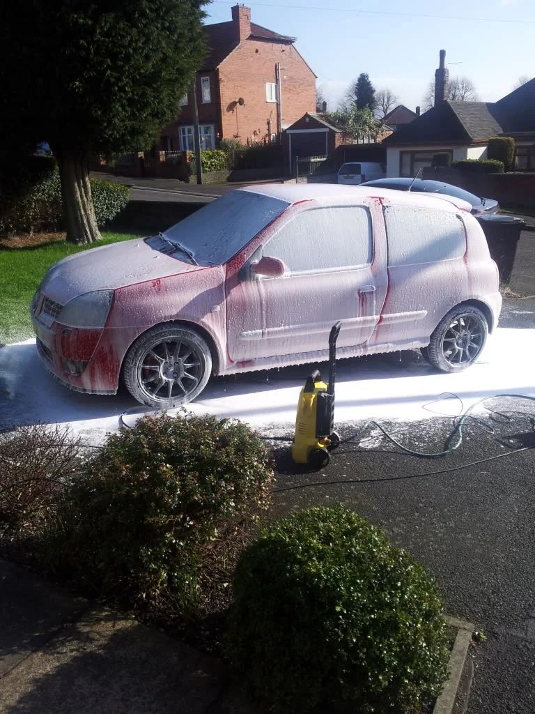

And here it is after a good clean

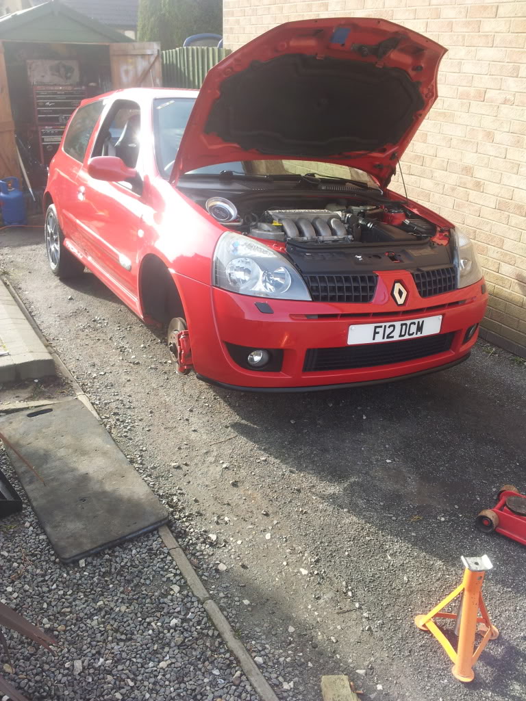

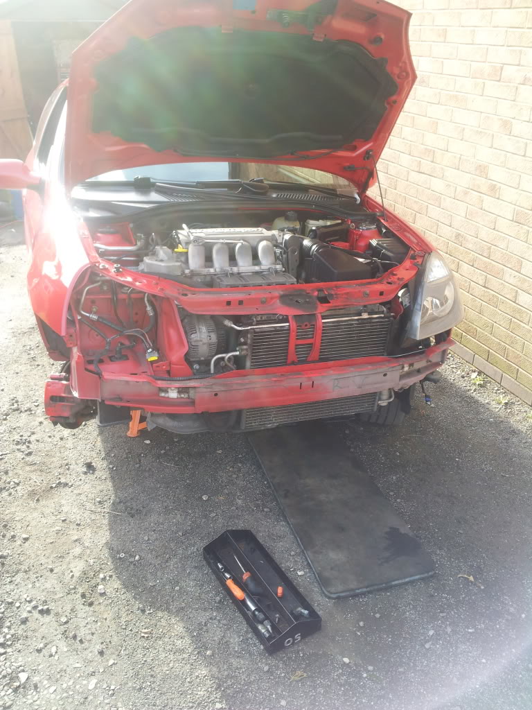

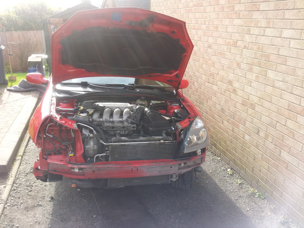

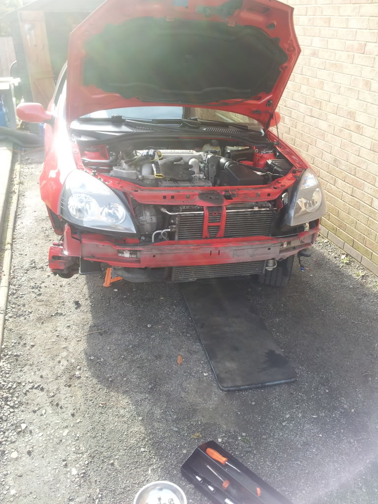

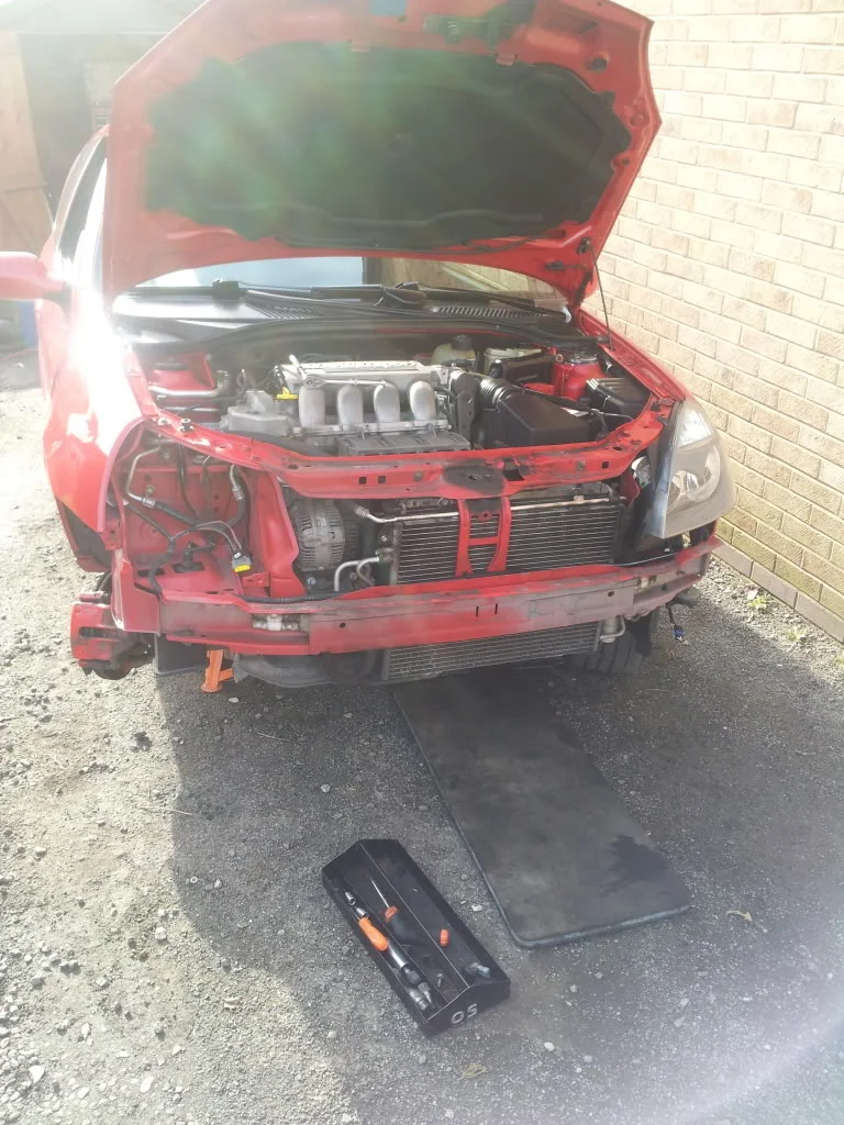

Heres a few pics from the aux belt change today
Only took me a couple of hours as I've done quite a few of these being a mechanic an a big RS fan and also done quite a few timing belts (the correct way) as I have ALL the renault tools.

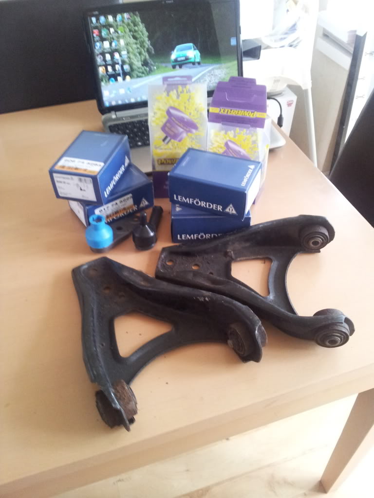

Well thought I'd post a few pics of a few more goodies thats have arrived this week :)
Took advantage of 30% off last week at euro car parts so bought all new lemforder bottom balljoints and outer track rods for my suspension and steering refresh. Also my "cup wishbones/later spec" finally arrived, even though my car is already fitted with these I got these so I can weld the sleeves on for polybushes and get powder coated without putting the car out of action as its still a daily.
Just got to ring adam later at trade parts renault (autoworld) for my inner tie rods and steering rack mounts and some service bits (spark plugs, oil, oil filter, pollen filter and gearbox oil). Also picked up a set of seat belts as mine are becoming a little slow returning so I'll give them a scrub up and fit them soon. Then all I need is my pure top mounts, mark fish springs and rear koni's and get me dampers off to simon at cornering force (hopefully next month) and the steering and suspension is complete, then we can move on to the exhaust and paint work and finally the engine.

Just got off the phone with adam from autoworld renault all in stock except the rack mounts so a little trip to wolverhampton on tuesday.
Parts ordered
Oil
Oil filter
Gearbox Oil
Spark Plugs
Pollen Filter
Inner tie rods for both sides (drumsticks)
Steering rack mounts
So with the bits photographed earlier I'm gonna have a busy weekend next week!

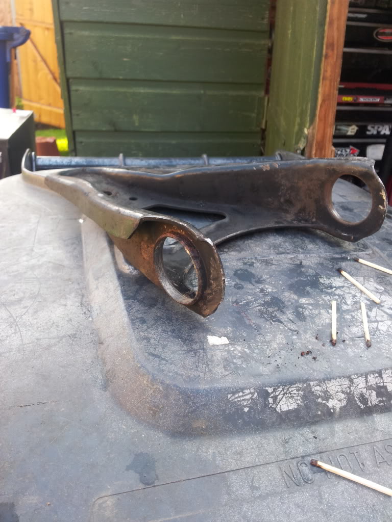

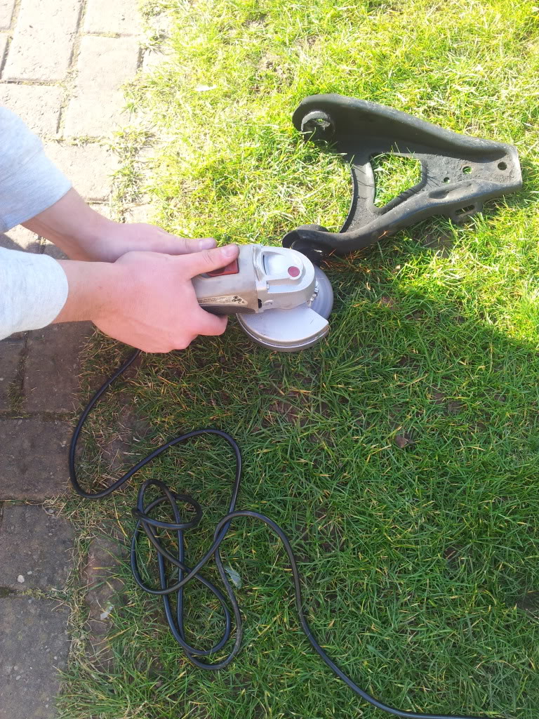

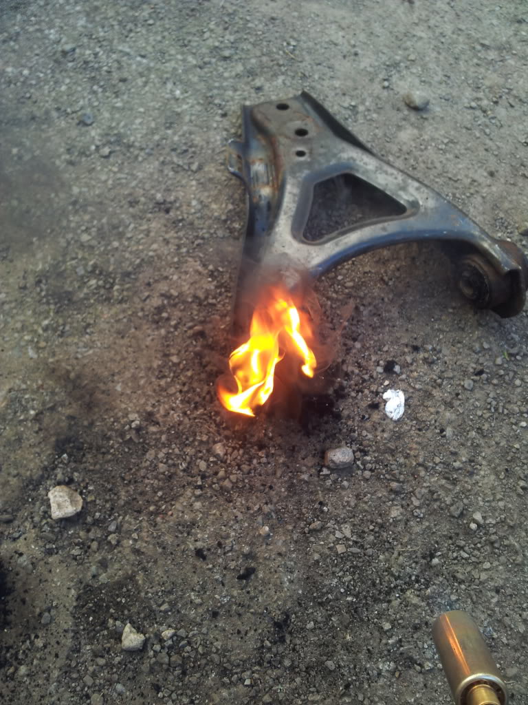

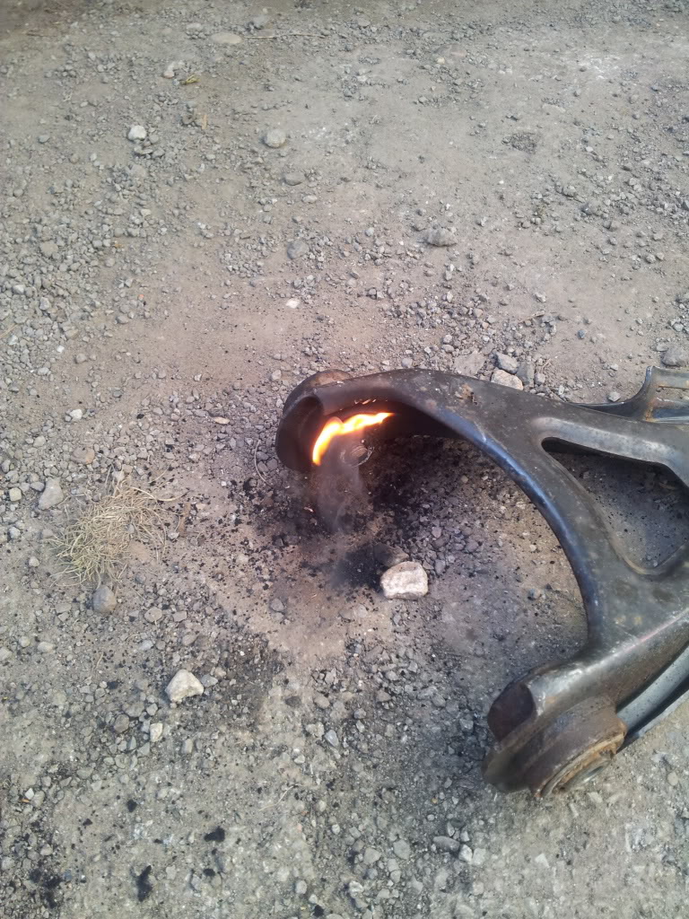

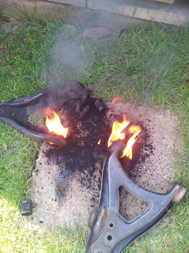

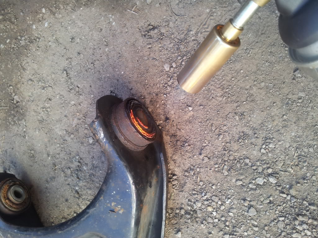

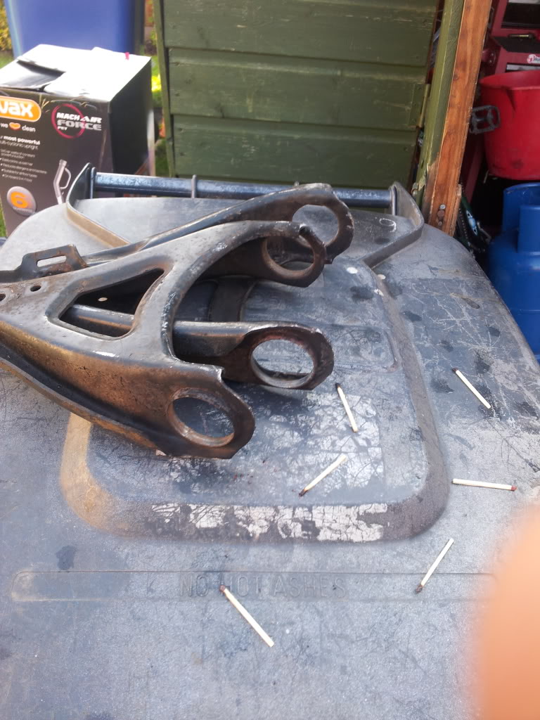

Well woke up this afternoon and due to being on nights but thought I'd get up and do a bit by removing the old bushes from the new lower arms. Did it the old school way as I don't have a press so a blow tourch, grinder, hacksaw and hammer and chisel so sorted it! And my health and saftey is getting better, got away with a small burn this time haha.
So out come the blow torch and some gentle heat
Sparked a fire (old man was worrying about his caravan at this point.
Then out came the grinder to nip the old bushe casings
Then folded the bushes in on themselves and knocked them out and here you go.
Told you I'd bring you some fire haha.

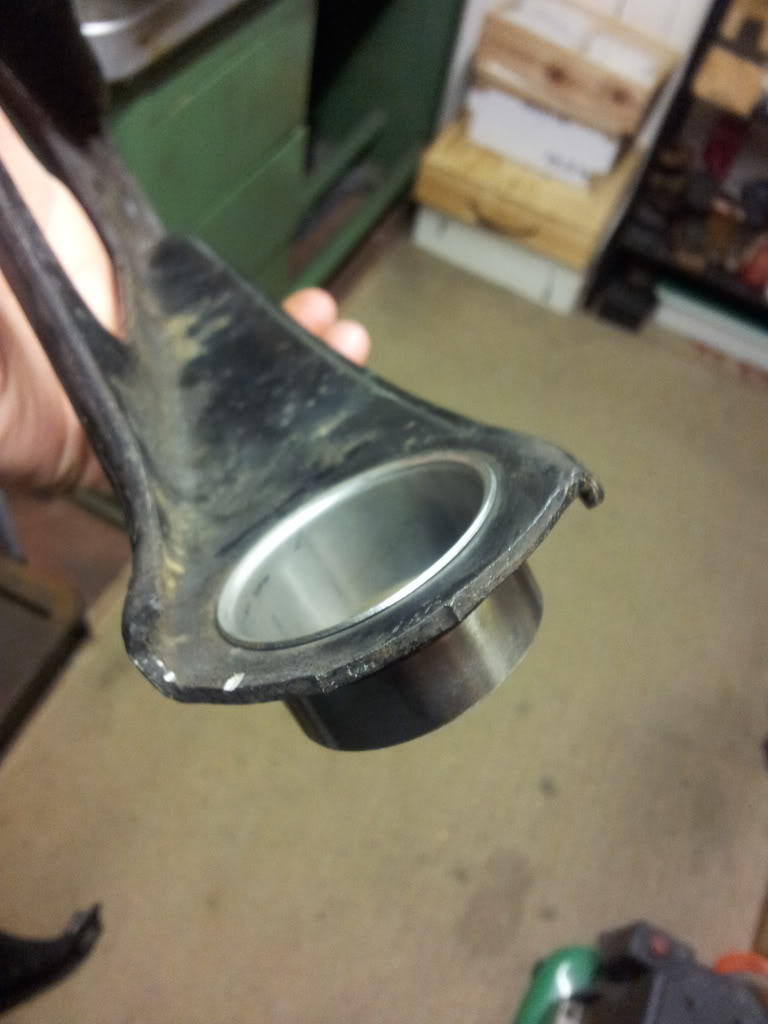

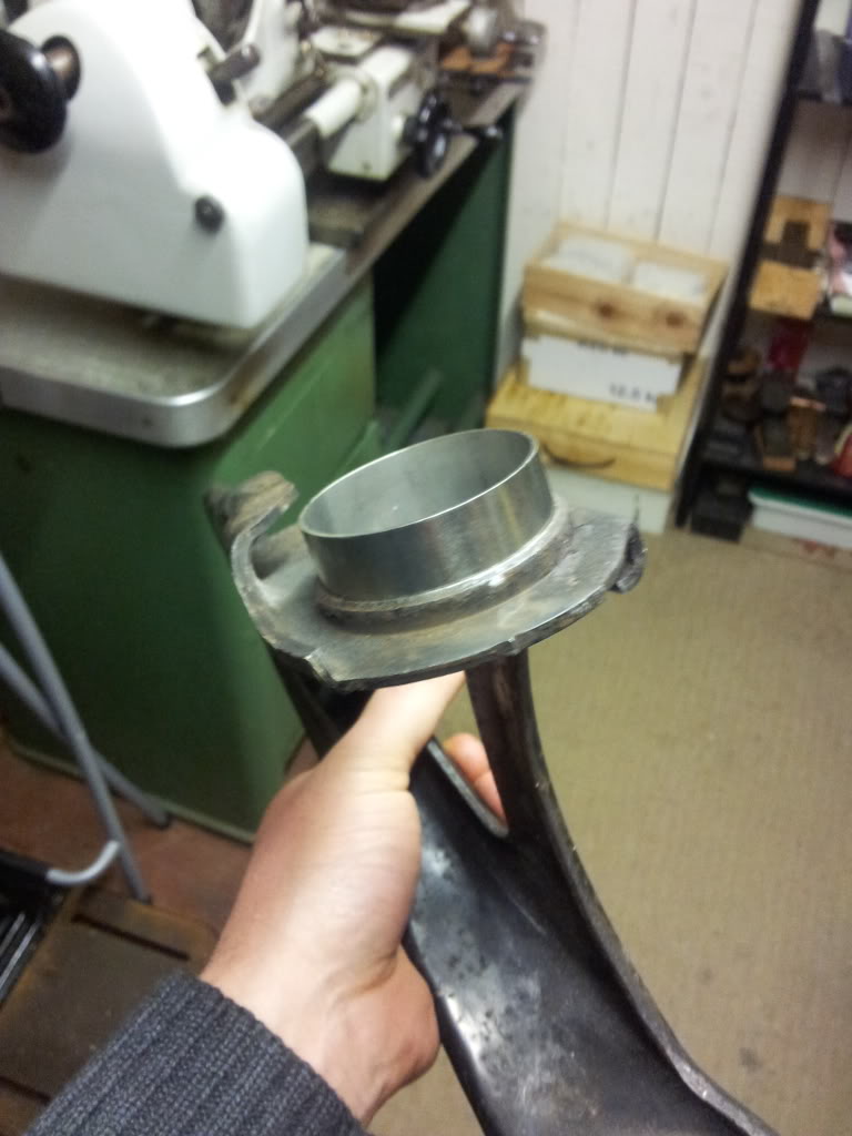

Well tonight I thought I'd clean the arms up and fit the sleeves that powerflex provide (old style bushes) and get them ready for welding, as you can imagine there designed to be a interference fit but after taking a few measurements with a set of vernier calipers its was clear they would need some slight alterations to avoid any damage. The internal bore of the wishbone measured in at 44.64mm, the bushe sleeves measured in at around 45.34mm. After a little bit of work with a few fine files and some emery paper and the addition of a vice and some blocks of wood the sleeves were in place and not going anywhere.
Then trial fitted the bushes and theres a few mm pertruding which is apparently ideal so tommorow after welding the wishbones will be off for powder coating :) Also tommorow I will be picking up a box of goodies off Adam at autoworld renault.
