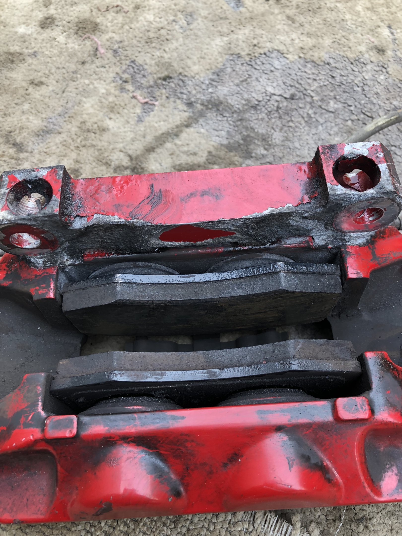

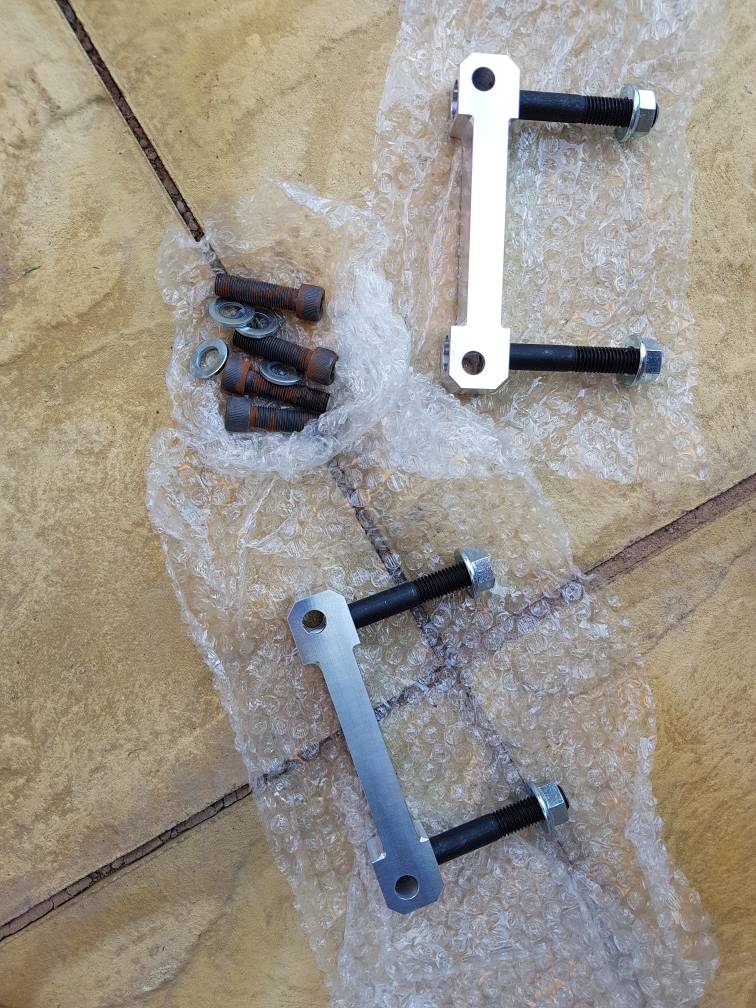

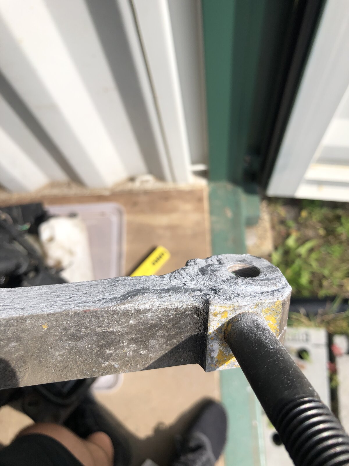

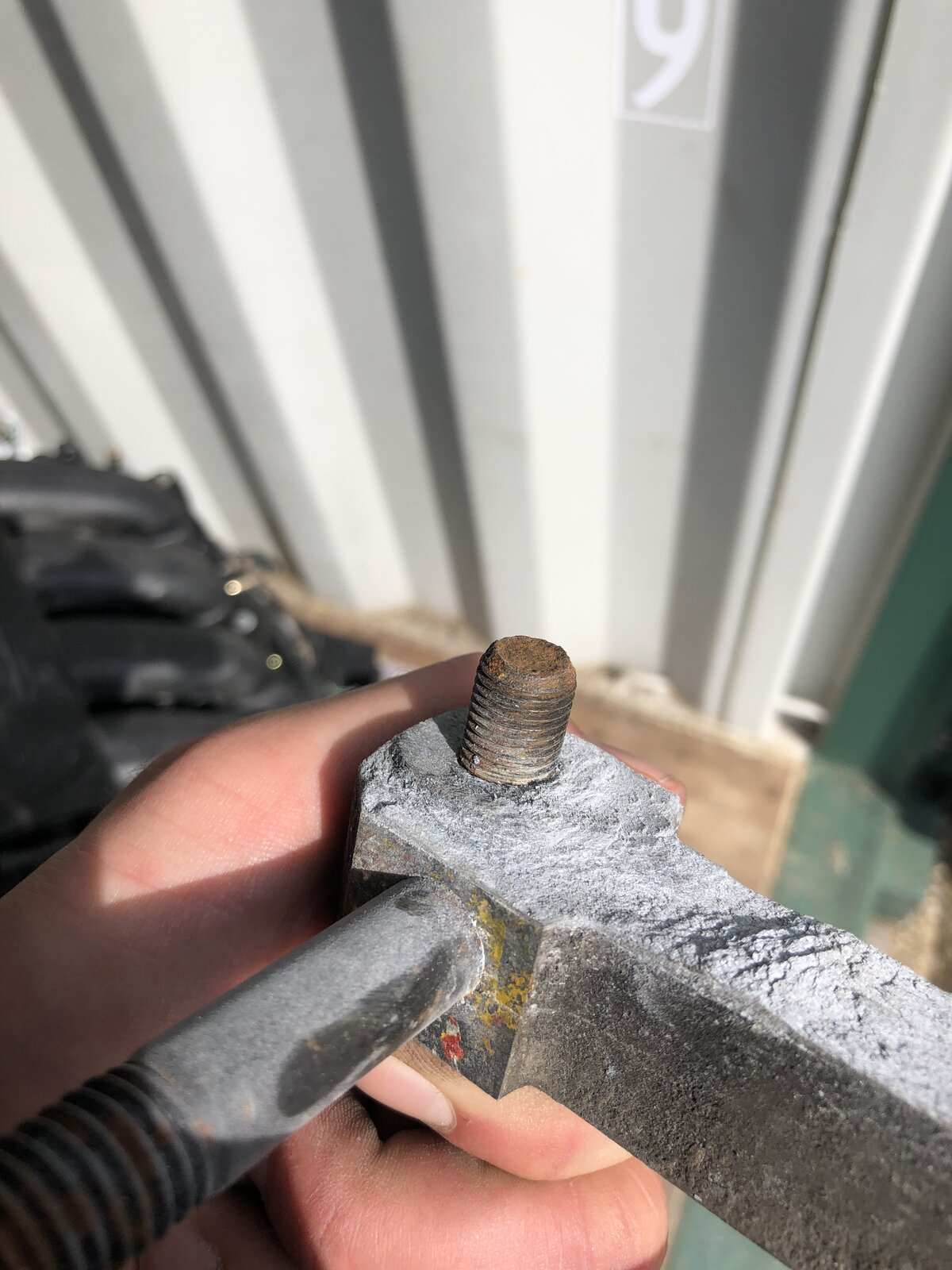

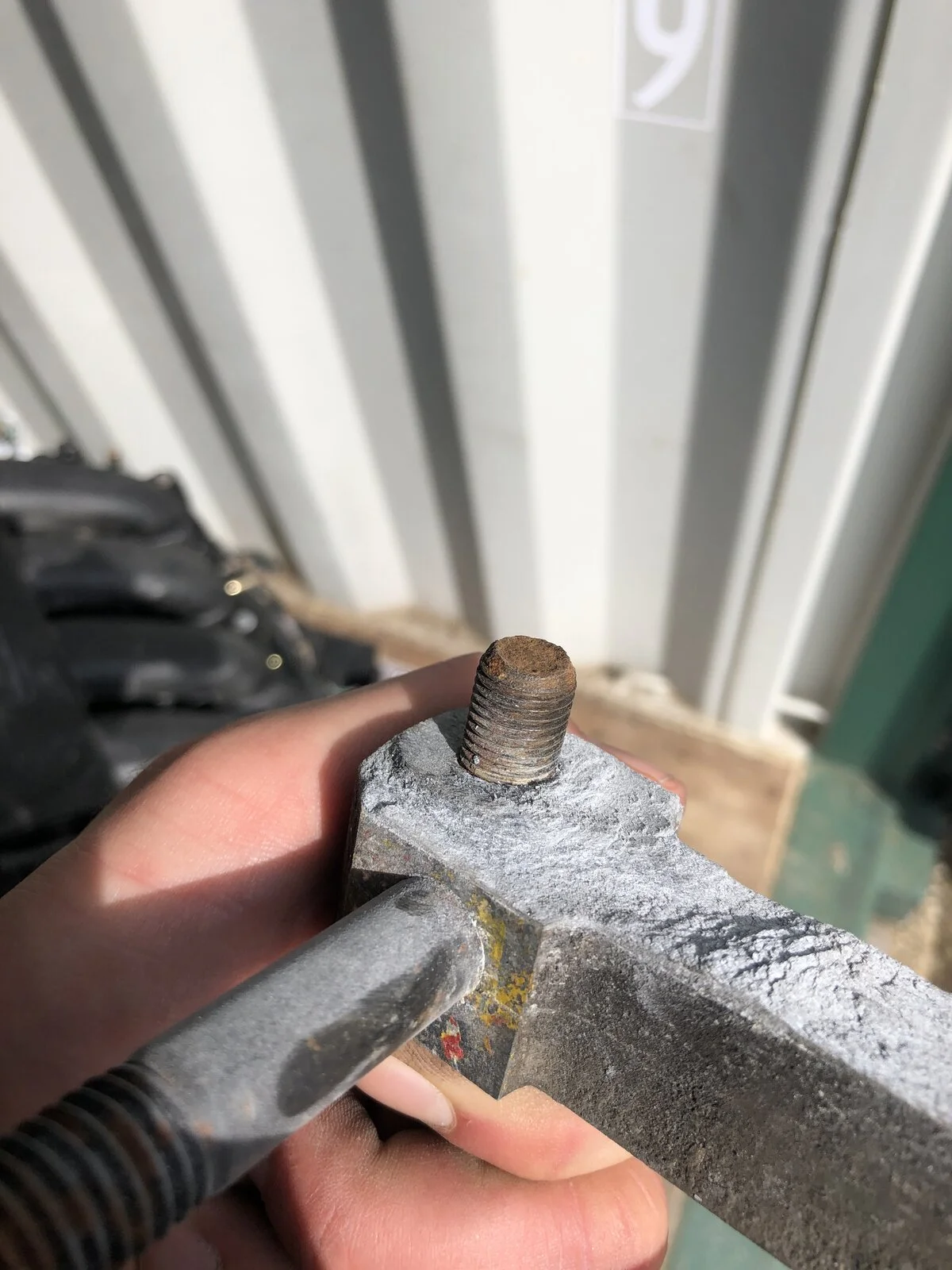

Failed Brembo brackets
I think only 5000 series prevent corrosion. But 7075 is not that bad at all. I use on brakes past and no problems. Imo they fail because of over tighten the bolts, that is how pressed aluminium looks like.
5xxx and 6xxx have good resistance and are suitable for marine applications, 5xxx are better though.
Making them out of steel is no problem, I can do some to mount milled calipers to 300 discs is anyone wants to got up from 280 discs.
Where they not anodised though mate?
They brembos are bolted to the brackets, then the brackets to the hub, no?
Brembos bolted through and then bolted through again. No threads on the brackets so just an extension lump of metal

Whoa! This looks like a close call. We manufacture our top mounts from 7075 and it corrodes very quickly so we cover them in oil and get them hard anodised as soon as we can.

Painting on the aluminium is not that easy, you need epoxy primer, very clean surface (sandblasting will be better) and then some finish coats. But this will not prevent scratching where the bolt head came into contact with bracket and could cause the same issues. If yours are fine now and are made out of 6000 series ( not 7000) aluminium, just get them anodized.
