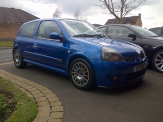

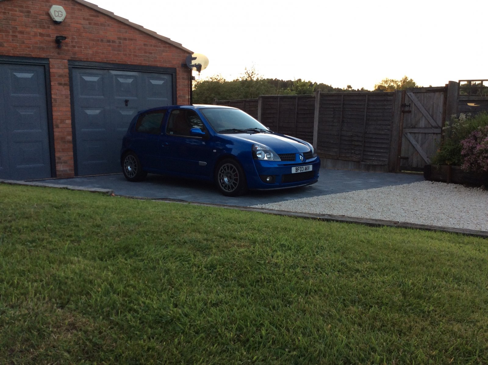

Few pics of my turbo'd cup
-Simon
  172 Cup, GT2, Meg250
First of all apologies for the quality of the pictures as they're off a BB.

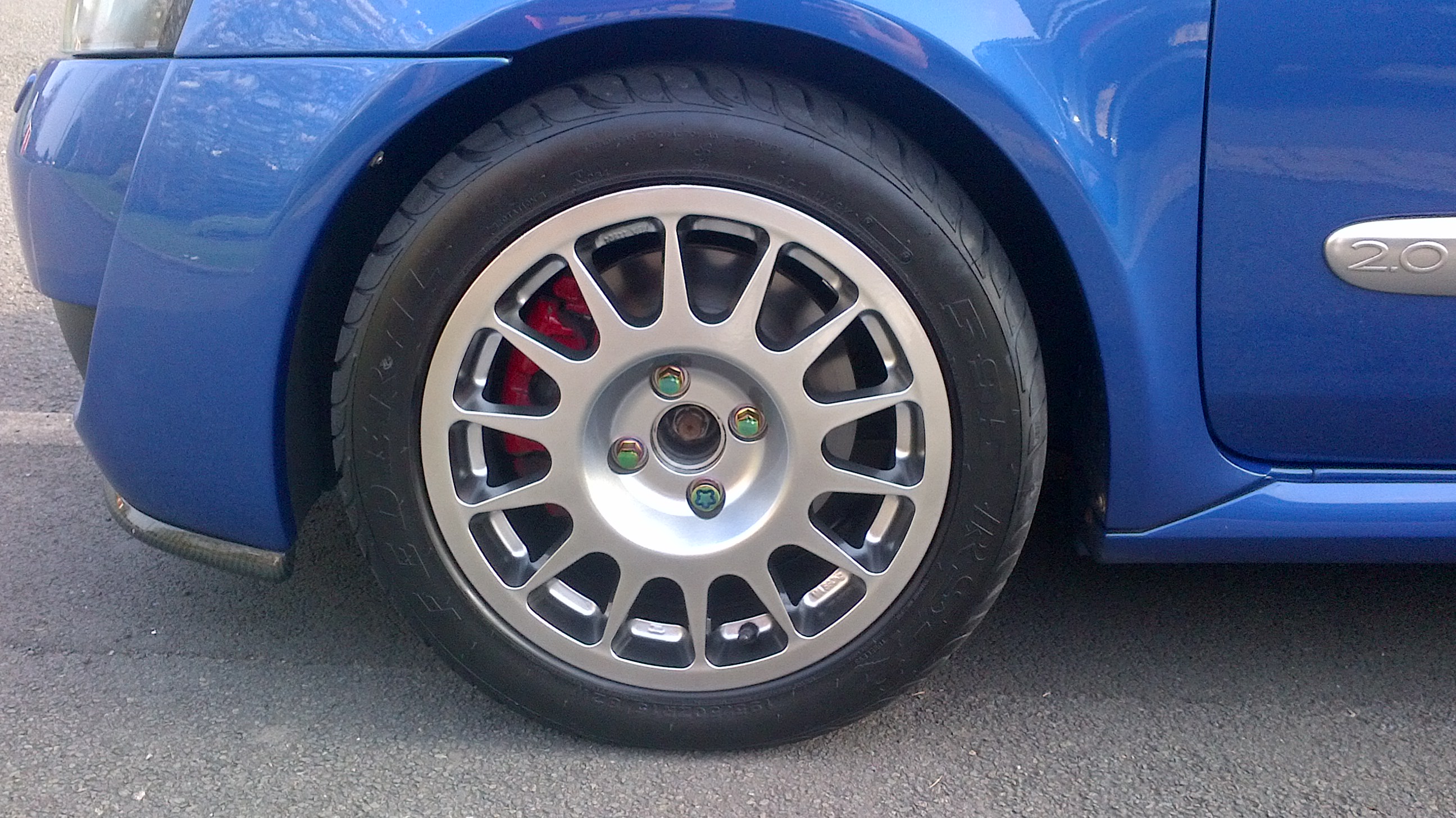

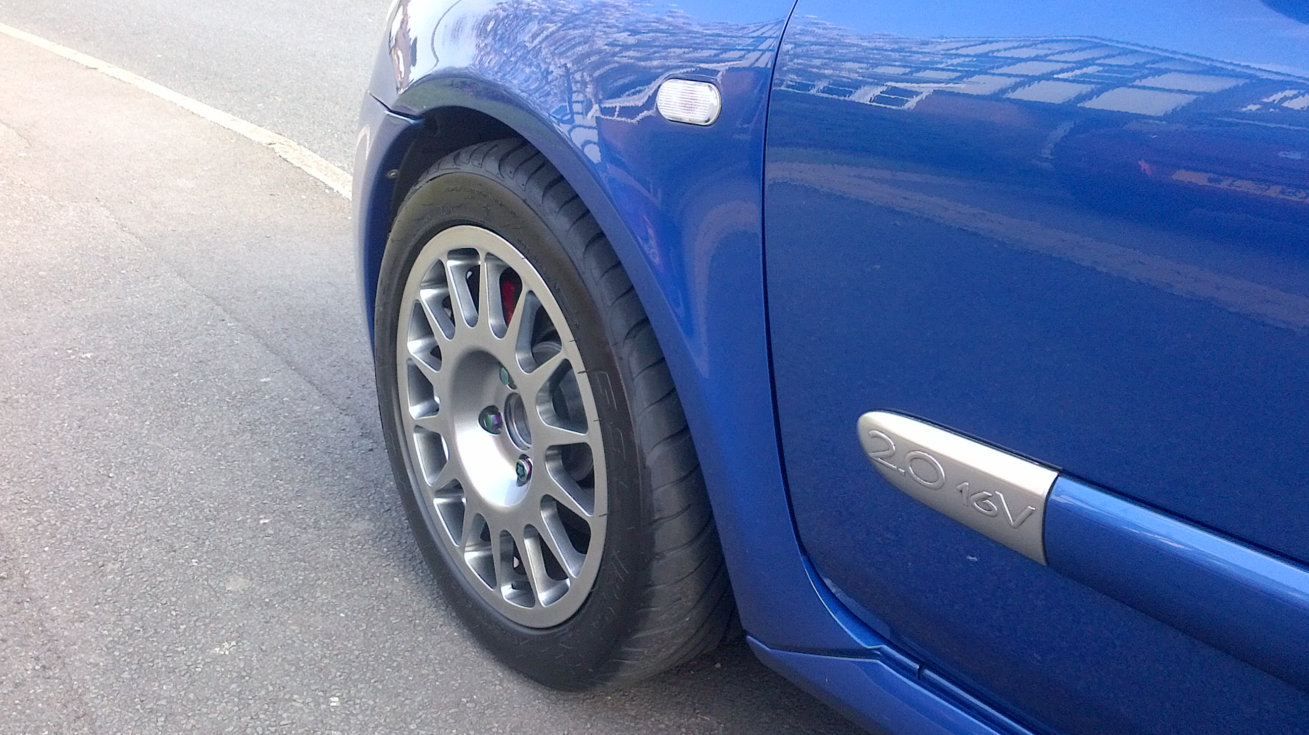

Quick spec of the car:
03 plate 172 cup, owned since 2008
Engine

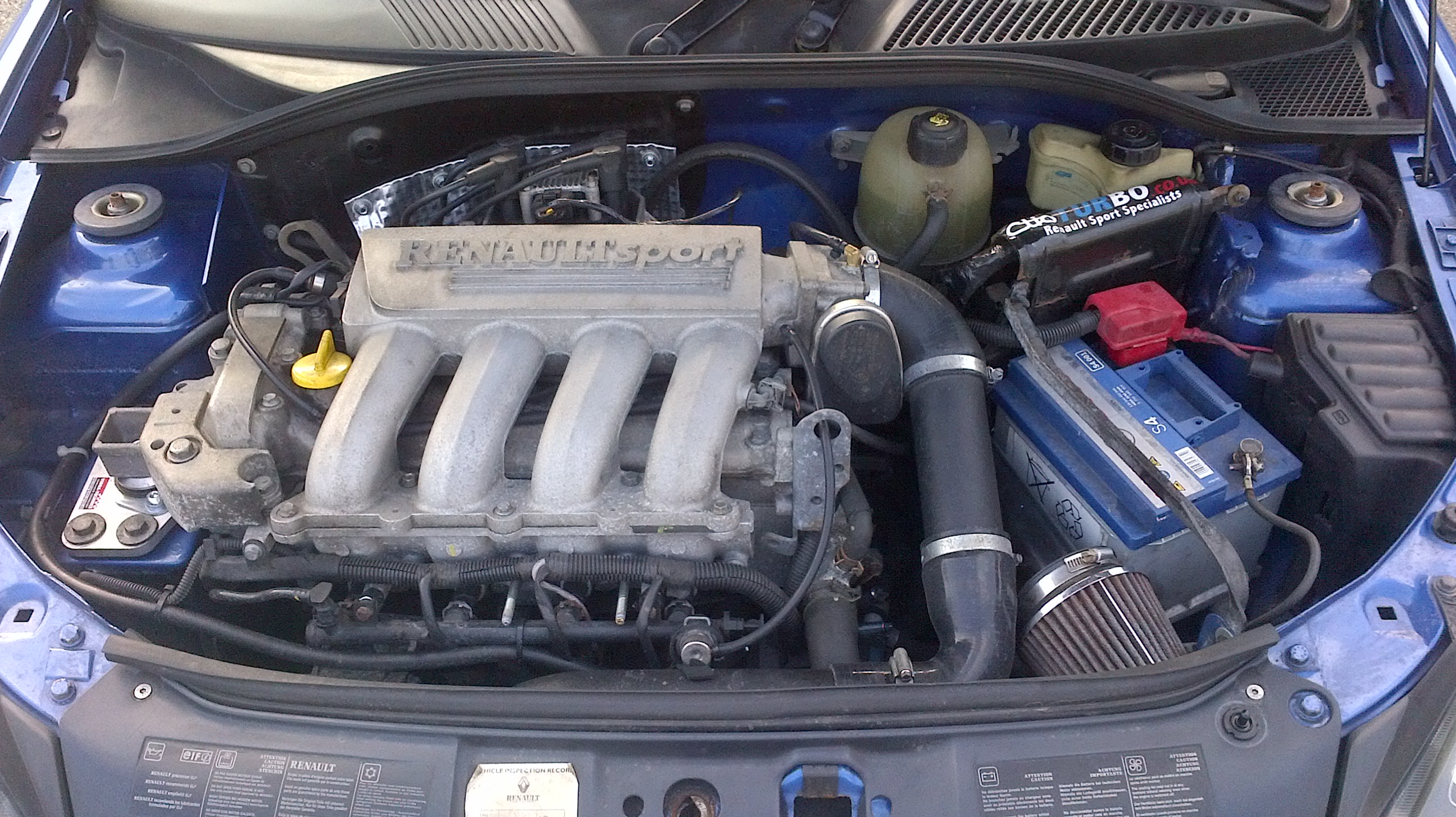

Clio-turbo low boost turbo conversion (235bhp 227lbs ft)
Vibra technics engine mounts
Paddle clutch
Supersprint full exhaust and decat
Power flex dogbone mount
Suspension/Brakes
New cup dampers and top mounts
Cooksport springs
Pagid front discs
Ds2500 front pads
Braided lines
New OEM rear pads and discs
Wheels & Tyres

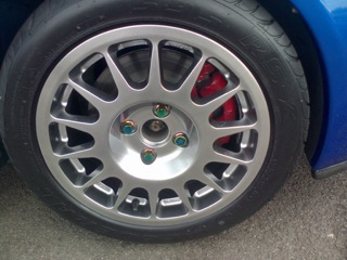

Speedline 2118's powdercoated black chrome with Federal RSR's
Also have:
Speedline turinis (16") painted trophy anthracite with conti's
Oz F1's with Michelin winter tyres
TPI polarised wheel bolts
25mm hubcentric front spacers
10mm rear stub axle spacers
Interior

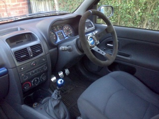

Momo deep dished alcantara steering wheel with custom centre horn and blue stitching
Renault Scenic gearshift conversion with Richbrook knob
Exterior
Carbon fibre front splitter (third one due to breaking)
Carbon bullets (being replaced with standard soon)
Stubby aerial
De-badged rear
Future Plans
Quaife diff
Stage 2 power upgrade
Front camber bolts and full geo setup
Corbeau clubsports fully re-trimmed in grey cloth with blue sticking and Renaultsport stitching
Powdercoat top inlet and general engine tart-up.
Anyway, enough of me rambling on. Enjoy the pictures and any feedback would be great.
-Simon

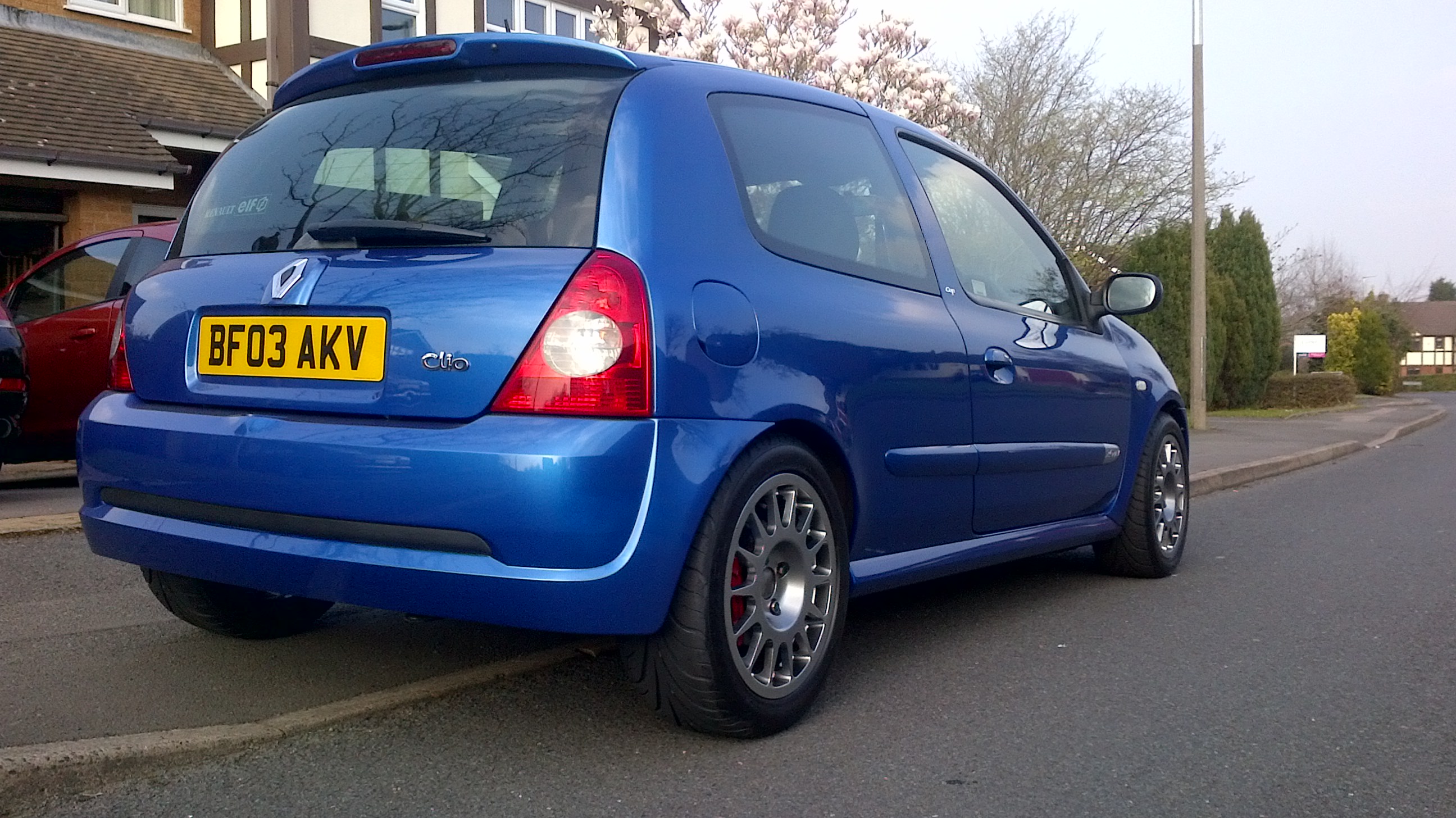

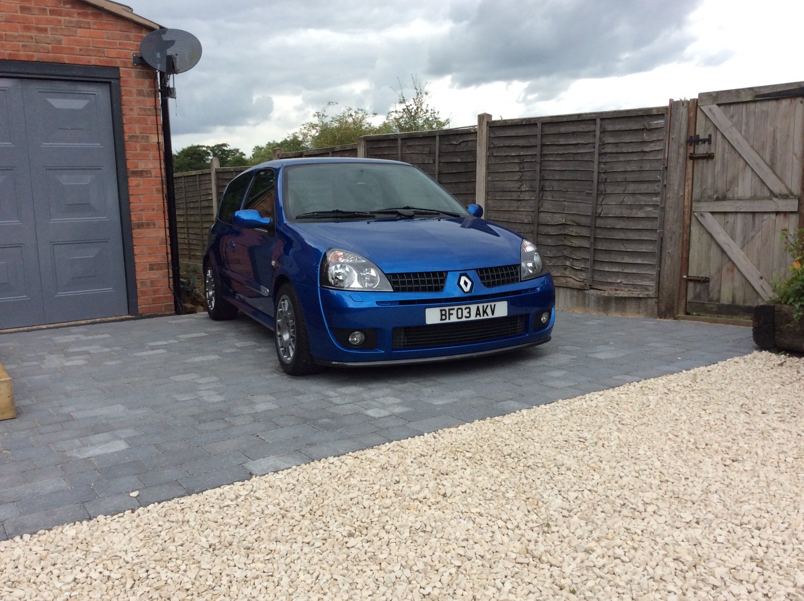

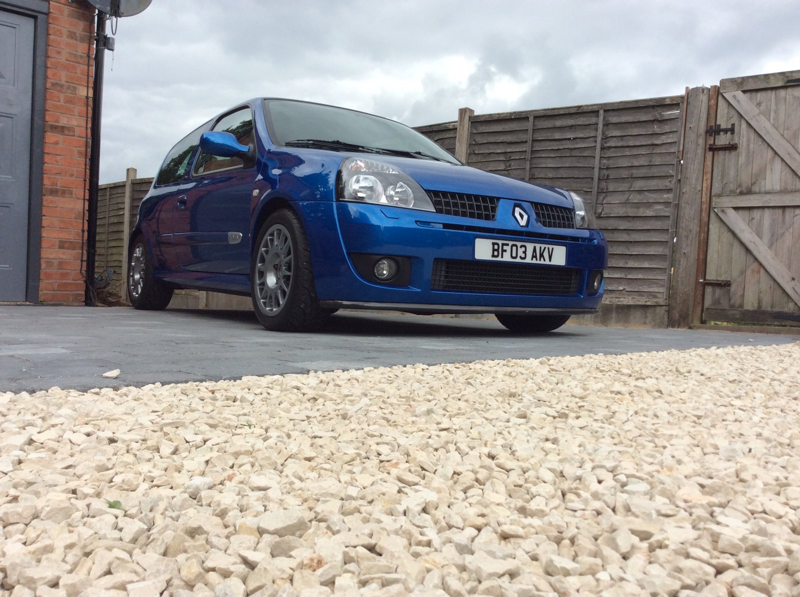

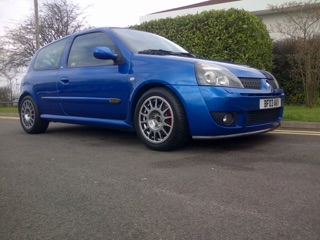

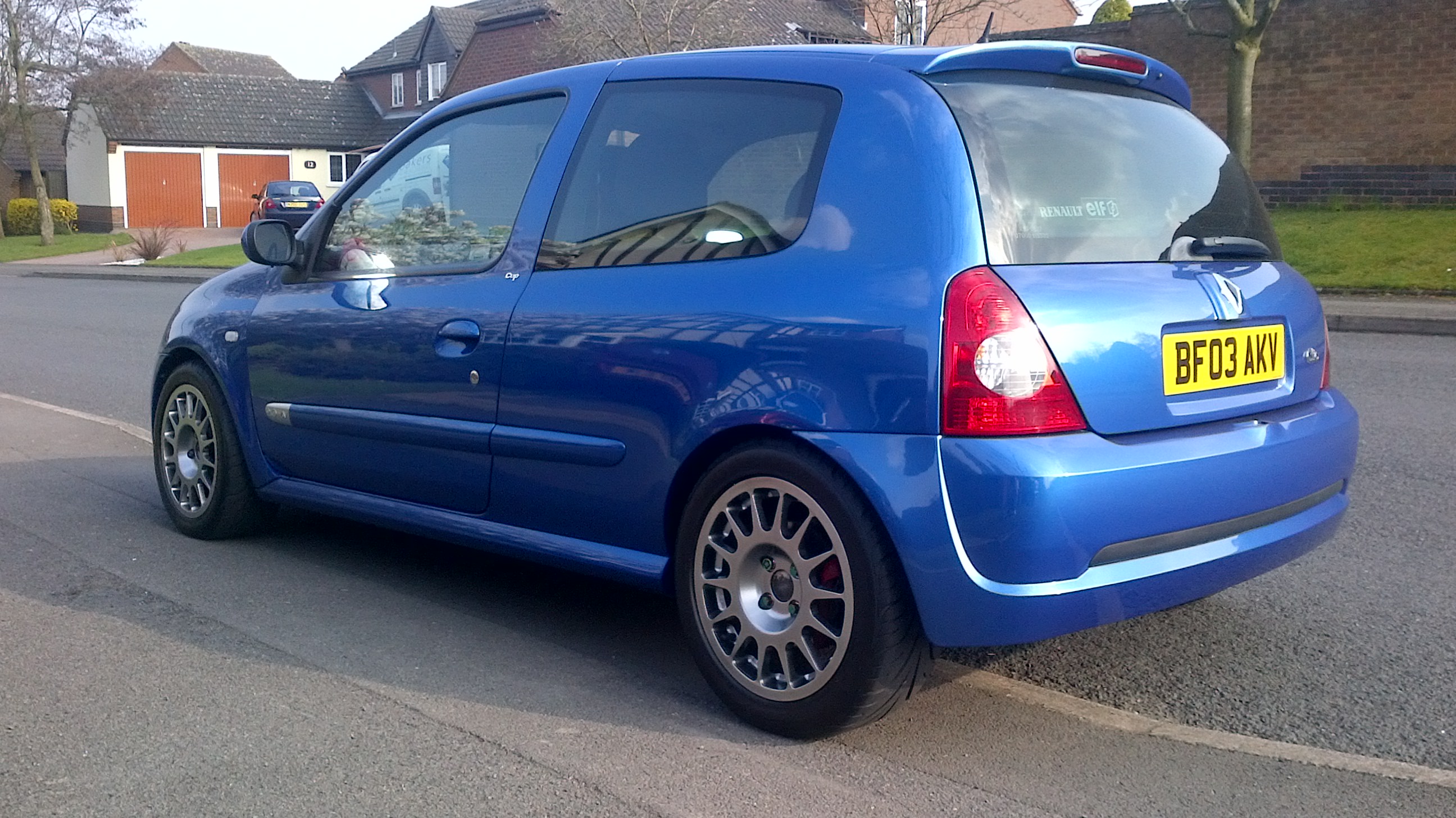

I'll try and do some today mate. I had all the pipe work done black along with the intercooler to keep the factory look.
As requested took a few more photos today. Put my original silver bullets back on. Miles better but need a bit of a clean.
Sealed my wheels with G-technik C5 which hopefully keeps the brake dust at bay.

Thanks mate. Now it's had some firmware upgrades and the tweak to the mapping it drives fantastic tbh. There is useable power from about 2500 rpm and it really comes alive after 4k. It isn't laggy at all and the way Chris (efi) maps it makes it very smooth throughout the Rev range.
If you think the standard car is quick you'll be amazed at the performance of the turbo cars. The only issue is once your bitten by the boost bug you'll be wanting more and more power ha ha. I would recommend having a clio turbo'd if your car is not your daily as some of the things required (mainly clutch & mounts) would piss u off if you drove it every day. As it likes open roads and not start/stop traffic as the clutch is either on or off.
The rest of the car copes admirably though and the stage 1 conversion seems just right for the chassis.
I am happy with 235bhp but you soon get used to it and Andy has taken me out in a stage 2 car and that absolutely flew.

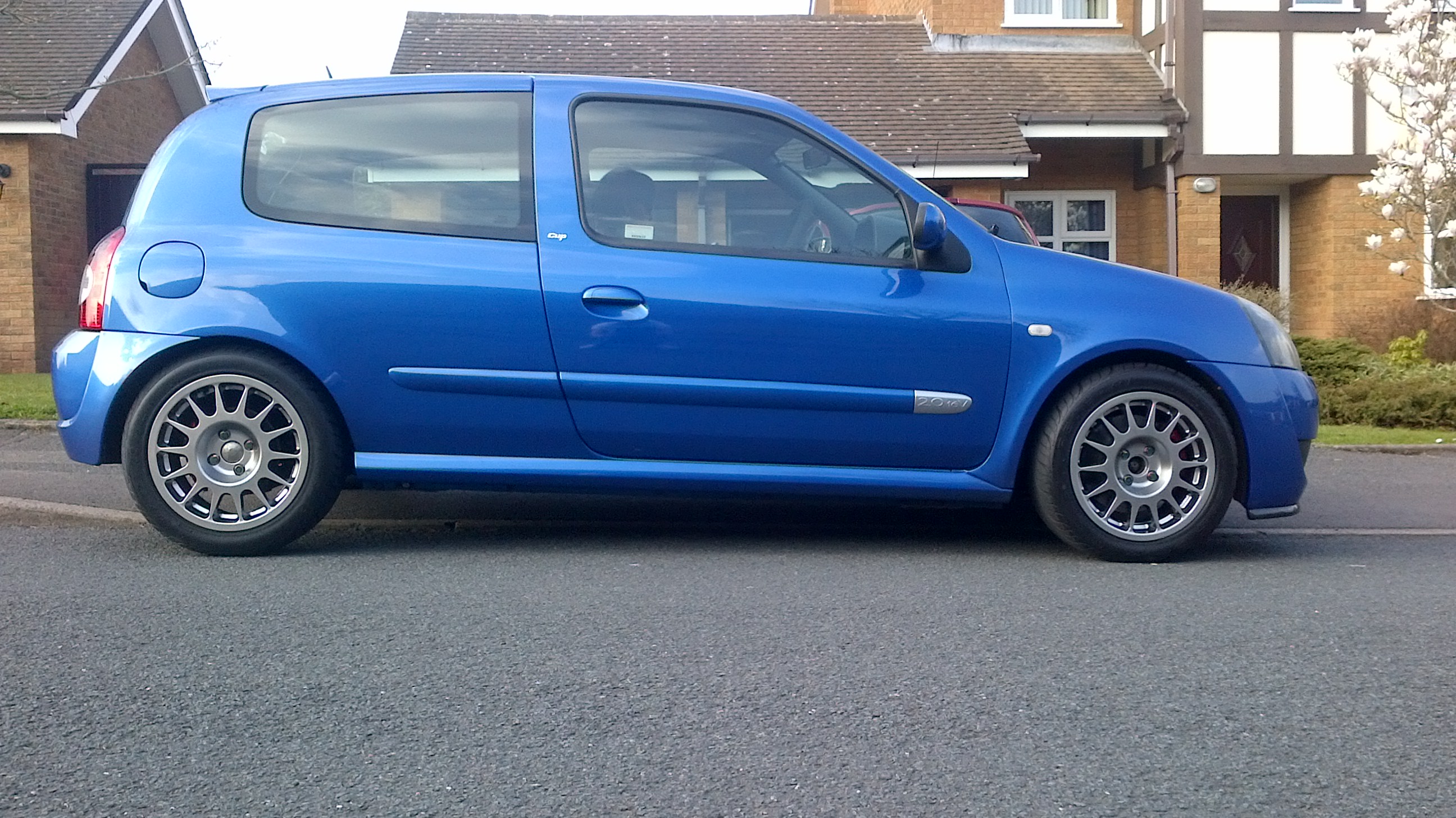

I'd love it lower but this suspension setup offers me 80% of the "look" I wanted with 100% of the ride quality and fast road performance. I hate crashy suspension and it also helps cope with the power as it doesn't get flustered over bump roads. I have considered the B14's and may have them in future.
In regards to the clutch I know a few have the standard one but mine was slipping on the dyno and it wasn't very old. This is a helix with the standard plate so it is the best compromise. Once you get moving the clutch is fine and as long as u blip on downchanges (not a chore :smile:) it doesn't chirrup. It's only in start/stop traffic when you constantly pulling away it becomes a complete ball ache. You feel like an idiot behind the wheel quite frankly as pulling away smoothly becomes an art form ha ha. The power is ok it's the torque that the standard one struggles with. Apart from that tho it's, to quote Gary Barlow: absolutely fantastic. :tongueout:

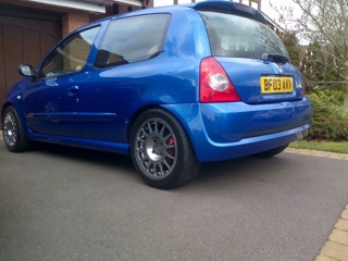

Thanks mate. They're off a euro cup racer car ET48 offset i think. They were white originally but really wanted something a bit different. The wheel only weighs 7.2kg too which is really noticeable compared with my old turinis.
When i went out with Andy in a car with stage 2 i was astonished, real difference when it gets into third gear. Would want a diff in it as that power tho as first and second were a challenge for traction. Your car is quality too mate by the way.

Just got my car out of hibernation. Gave it a quick detail over the weekend. Just needs MOT, and a few bits doing next week and then back on the road after nearly a year. Anyway, here it is:
