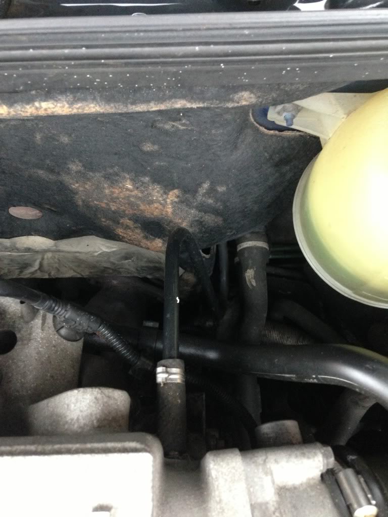

Now the rear strut has been changed no drama but the emissions is a weird one! There's a breather/vacuum hose coming off the top of the inlet and runs down into the bulkhead... that has melted... and is plastic!
Is it not meant to be rubber and heat proofed? It's sucking in excess air causing a few problems, stalling whilst reversing, poor fuel economy and now high emissions! Does anyone know a part number for said pipe please?

Possibly... it goes into the top right of the manifold... is it supposed to be a hard plastic or rubber?
I'll check out the lambda !
This?
No problem, glad its a easy fix.
