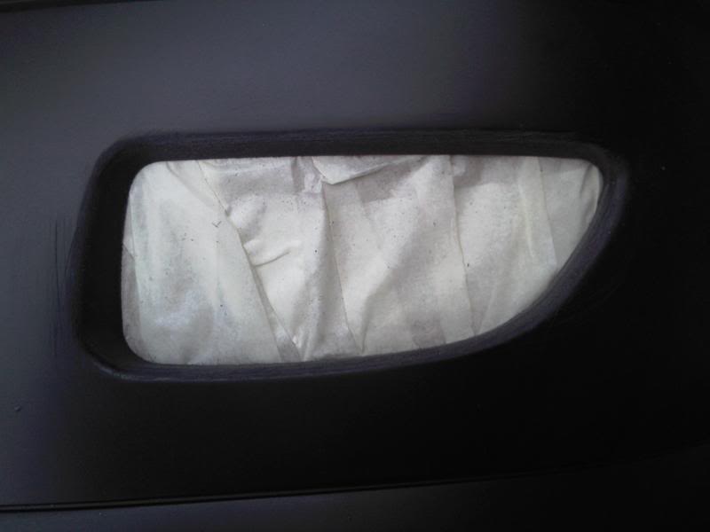

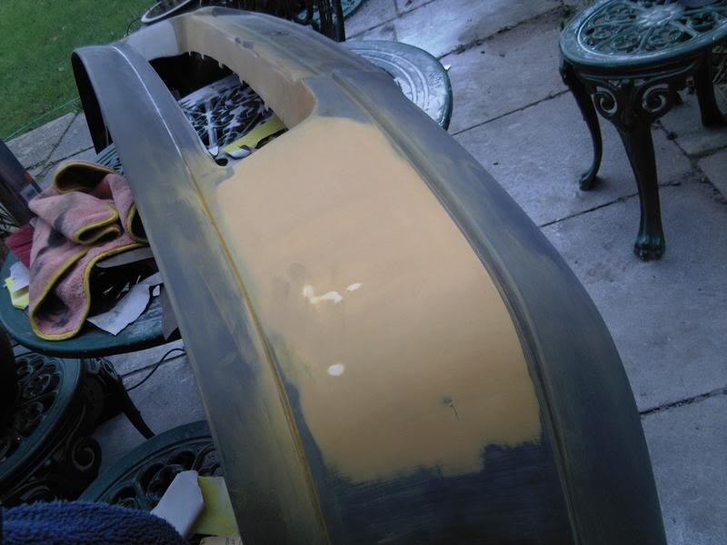

the same technique was used to smooth in fogs on this bumper
they have sprayed over the p38 filler with high build spray primer
that'll crack tbh
need a solid base for fibreglass or itll flex too much, especially on a plastic front bumper
hope it dont crack for ya, but i put money it will
it isnt my bumper mate, i only used that technique to fill the holes left from cutting the slats out.
