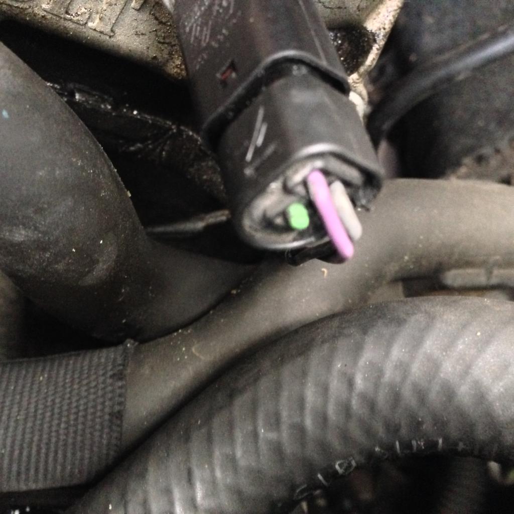

also I have found that there is only two wires coming of the cts plug and what seems to be a third green wire that has only 1mm coming from the plug end and no further wire can be seen?? Is this normal and just not used on this engine or am I missing something??
Pic of cts plug, is this normal or possibly my issue??
I believe that they normally have only two IIRC. Remember thinking similar when i changed mine years ago.
