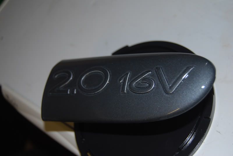

cars looking a little worse for wear , just refurbed the side bullets

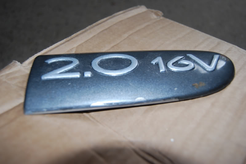

original state

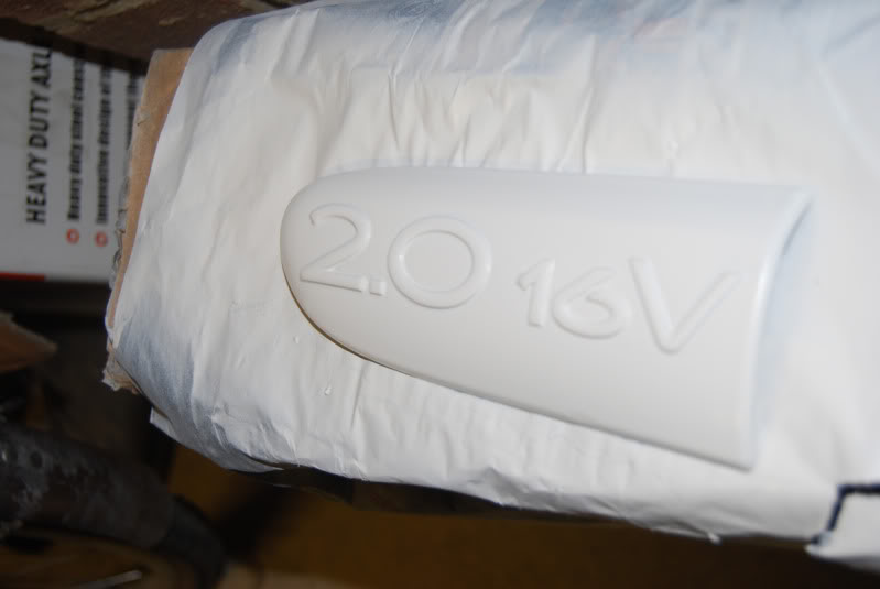

in primer

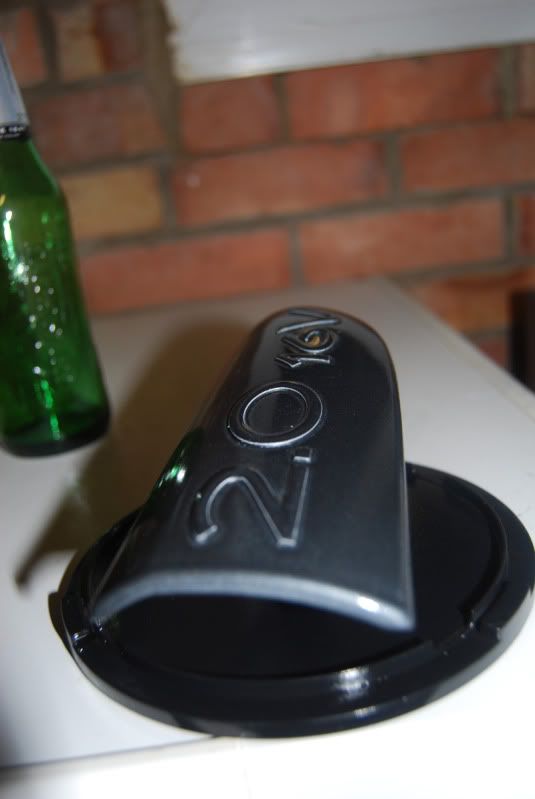

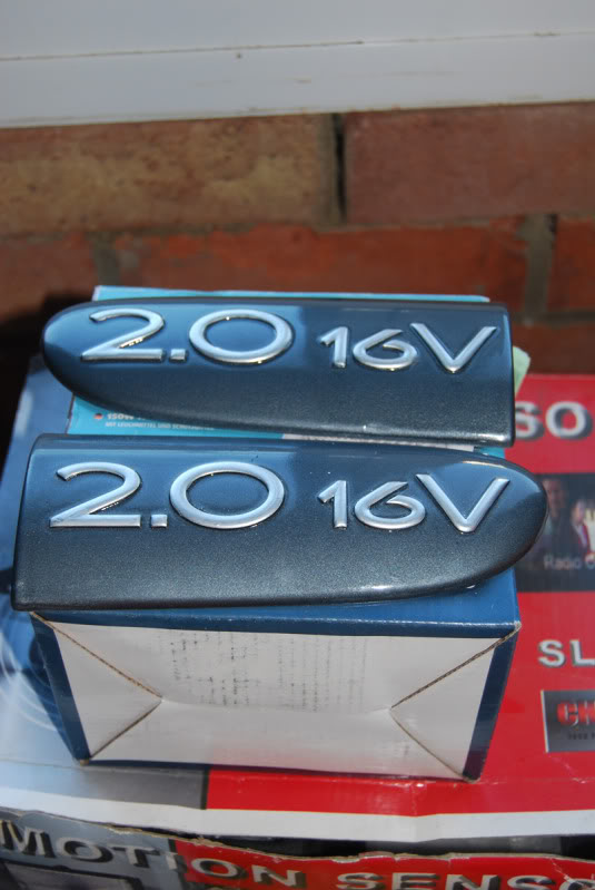

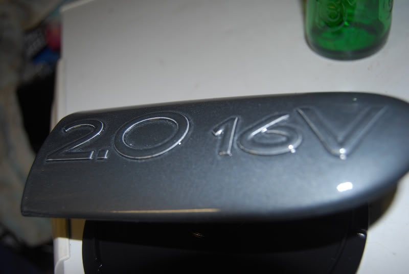

finished
used 2 layers of primer , 2 layers of colour (rover stone grey) and 3 layers of lacquer.

been doing a fair few of these bullets myself, i just used a paint pen on the lettering, no masked it off or anything. looks pretty good. :)
I feel like a right r****d when people talk about using 2 layers of paint.
I did near enought a douzen layers of primer to get some bits perfectly smooth/soft. Then 7-8 coats to get the colour perfect all over. Then 4/5 layers of laquer :S
Bits look good anyways dude^
When you paint the letters by hand, do you just put the other colour paint straight over the top of the other colour, then laquer the whole thing?
Or do you have to sand down the letters to put the other colour on?
Or do you laquer the whole thing then just hand paint over the top of the laquer?

i sanded it down then scatched the rest off with stanley knife blade been carefull not to cut into the plastic , sanded sown till smooth
