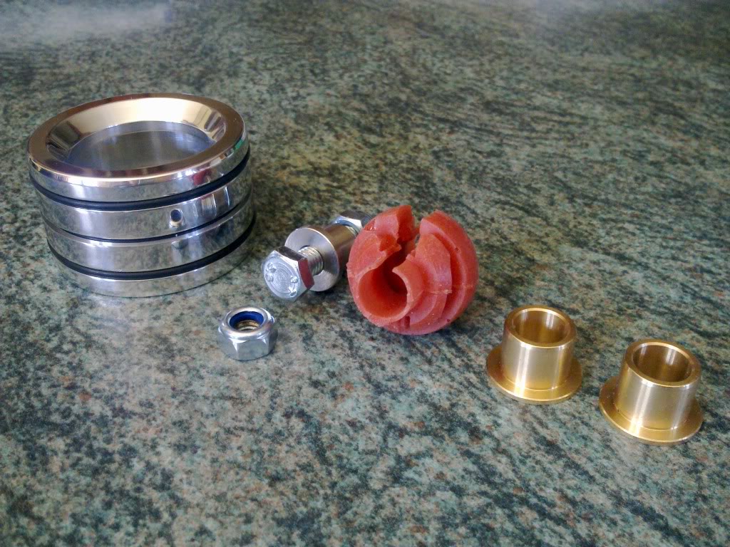

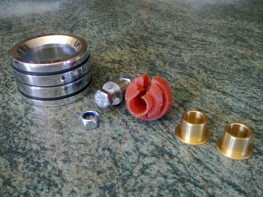

I fitted a stiff shift from Yanoo, I can't recommend it enough. It was a little bit fiddly to fit but nothing too challenging, especially since Yanoo was so helpful. It has taken all the unwanted slack out of the gear shift and made the change feel much more satisfying.

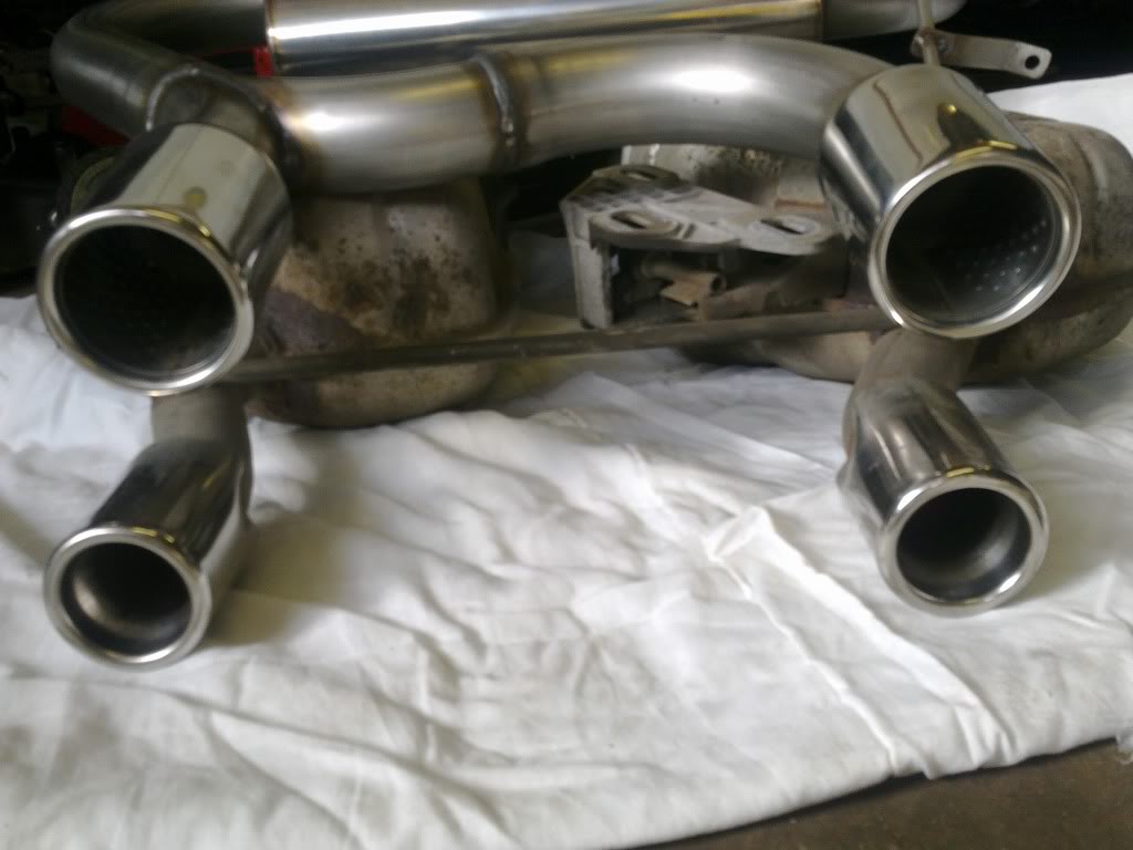

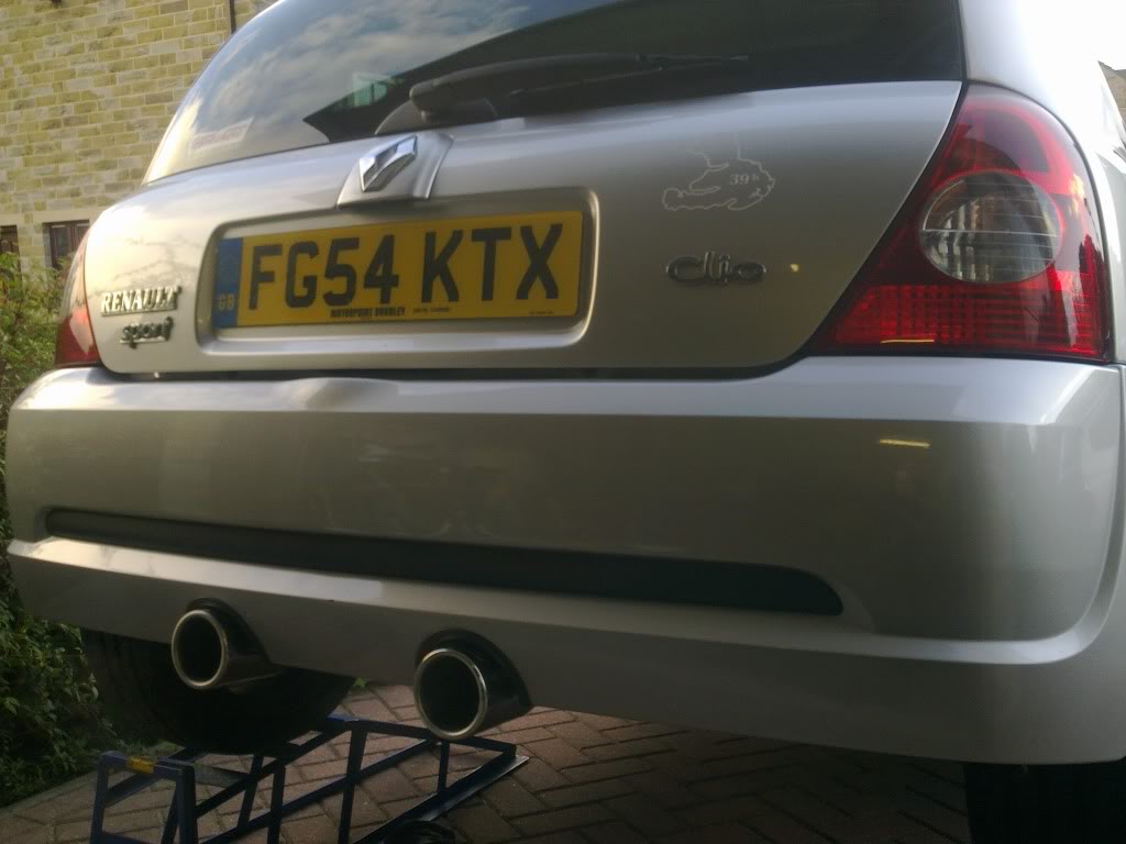

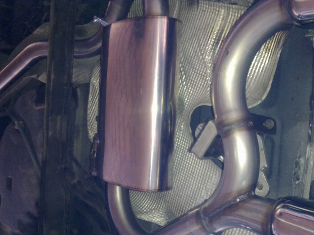

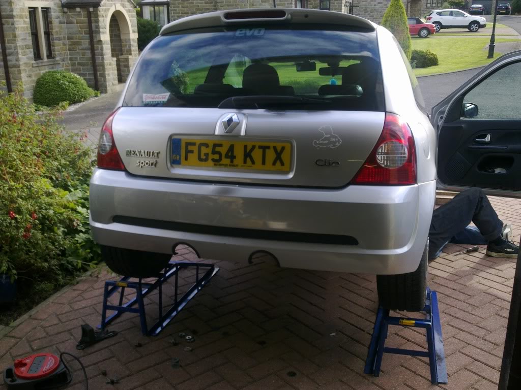

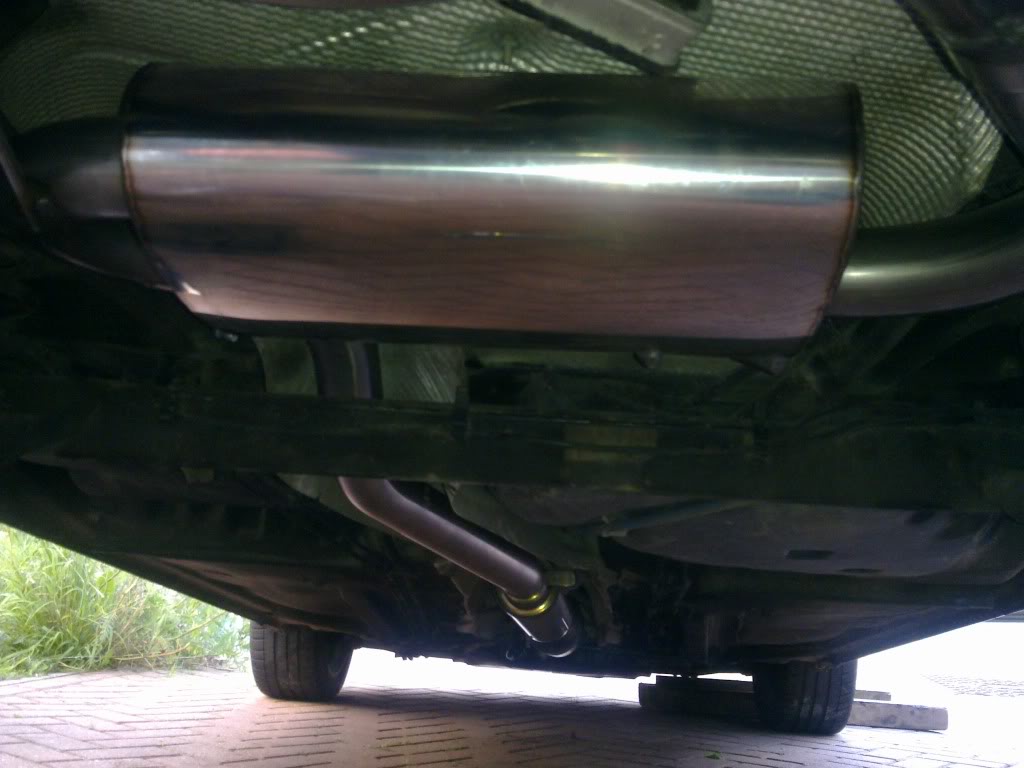

I also took delivery of a Piper Exhaust. I spent a lot of time looking for info on Piper cat back systems and it was very thin on the ground. So were audio clips. After fitting the system today I think it could be a massively underrated exhaust system. It was a breeze to fit and it looks brilliant.

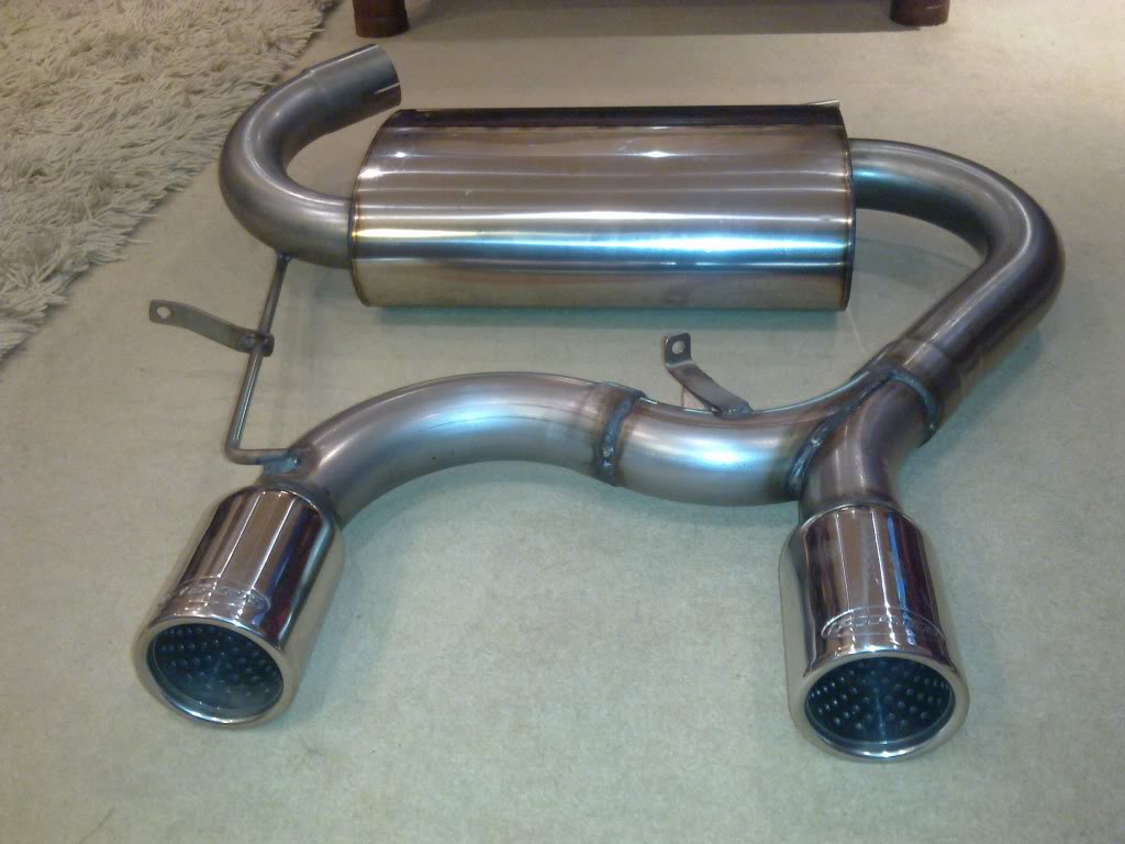

The tail pipes are nicely detailed the welds are neat, the tail pipes look like standard but fill the holes in the bumper perfectly at 3.5” and it hangs absolutely level with no movement unlike the standard system.

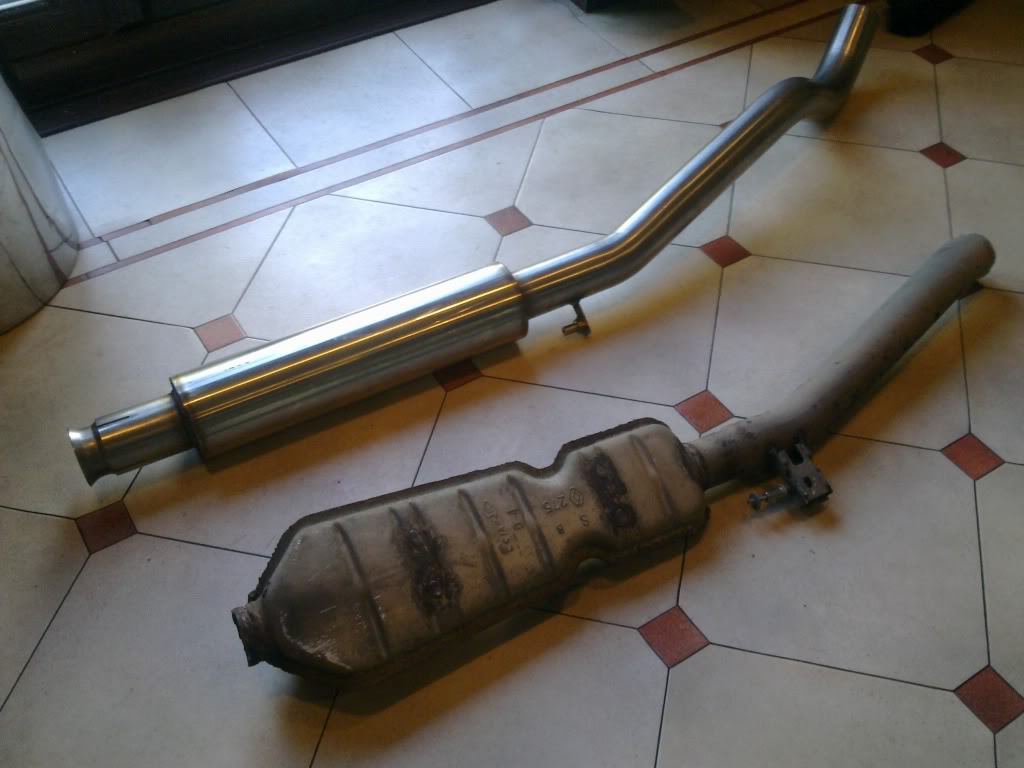

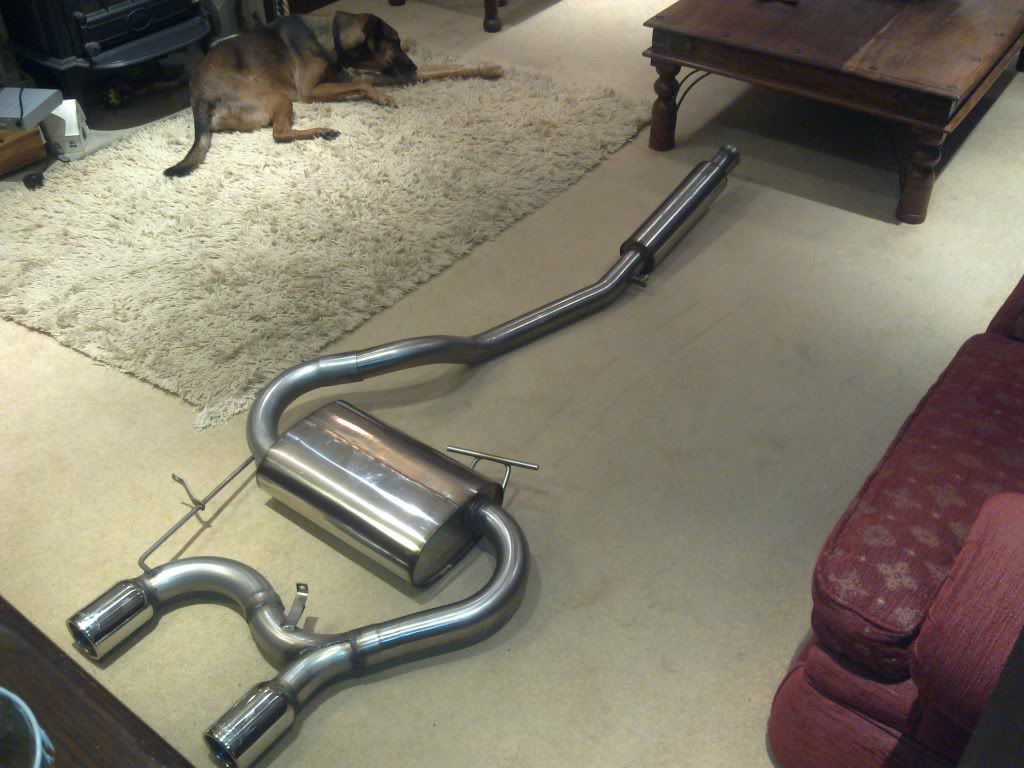

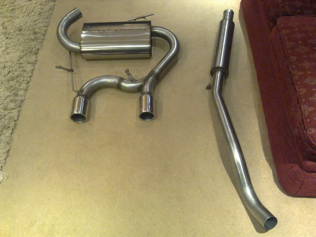

I also weighed the Piper system and the standard system as I couldn't find a weight for the Piper anywhere on the internet. The Piper weighs 15.8 kg and the standard exhaust was 22.6 so that’s a very healthy saving of 6.8 kg's :D.
However the biggest surprise was the sound. There was only one clip of a Piper on the internet that I could find but I can report, It sounds AMAZING! Really took me by surprise.
It's not boomy in the slightest, it is very tuneful and raspy but not embarrassingly loud. With the windows down at 7,000 rpm it sounds like something far more exotic and pops slightly on the overrun when hot. It certainly turned a lot of heads :D. Oh and at motorway speed it is barely any louder than the standard system. I couldn’t be happier with it!

Looks real good, sits perfectly! Where did you get the wheel ramps from? Do you think they're better than a jack? Must admit I fancy getting some of those...
Thanks, I could not be more happy with the way it fits and the noise it makes :)
I forget where I got them from now but I think you can buy some from halfords. They are much better and safer than a jack in my opinion. It also means you don't have a jack in the way of where you are working.
is there a few kits from yanoo?
which one did u get and how much?
I got the "base kit" Stiff Shift 1.0, stiffer ball insert and small metal bush with brass bushes. It was £56 posted in polished silver. If you want it in any other colour it is £59.
I have to say it has made the gear shift feel much more satisfying. It feels like the shift in my brothers Boxster S which is fairly high praise.

How long to fit the shift kit?

It took me about 2 hours to fit the shift kit but I was a little slow figuring out I didn't need certain bits from the kit, because the kit caters for all Clio's old and new. I would say if your moderately good at fiddling with cars, 1 hour. If your slow like me, 2 hours.
I think it was worth it though.

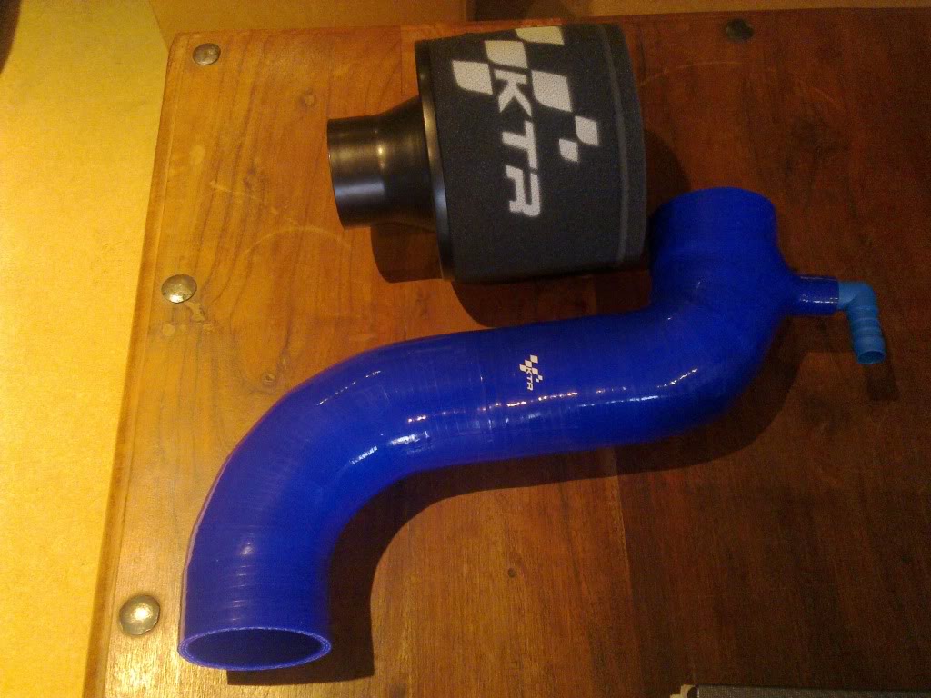

My KTR induction kit arrived today. Very happy with how it looks and it is huge! All I need to do now is get a smaller battery (turns out the previous owner replaced it with one which is too large) and get it fitted.

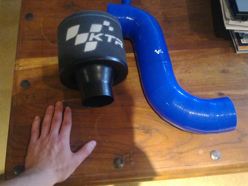

Here are a couple of pictures, I put my hand next to it so you get some perspective of how big it is. Sound clip to follow.

How do we know you don't just have freakishly small hands? ;)

Ha they aren't the biggest but trust me the kit is an impressive size :D

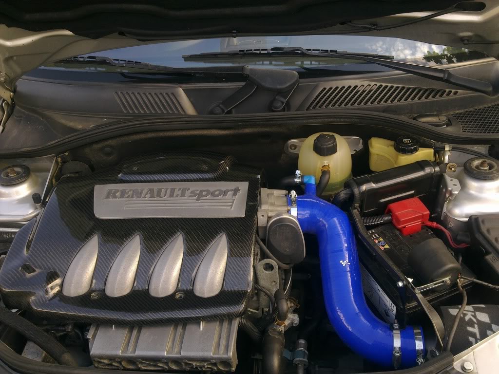

If you have a 21cm long battery (which I didn't it was bigger) it is very easy, just follow the step by step instructions, it should take you about 20 mins. It took me longer because I had an oversized battery so it wouldn't fit in the gap. It is a squeeze.
As for the noise, it only makes its presence known at full throttle. You can accelerate as quickly as you will ever need (apart from overtaking) without ever waking it up. But when you do, you will laugh, or I do. Maybe I am just sad ;)

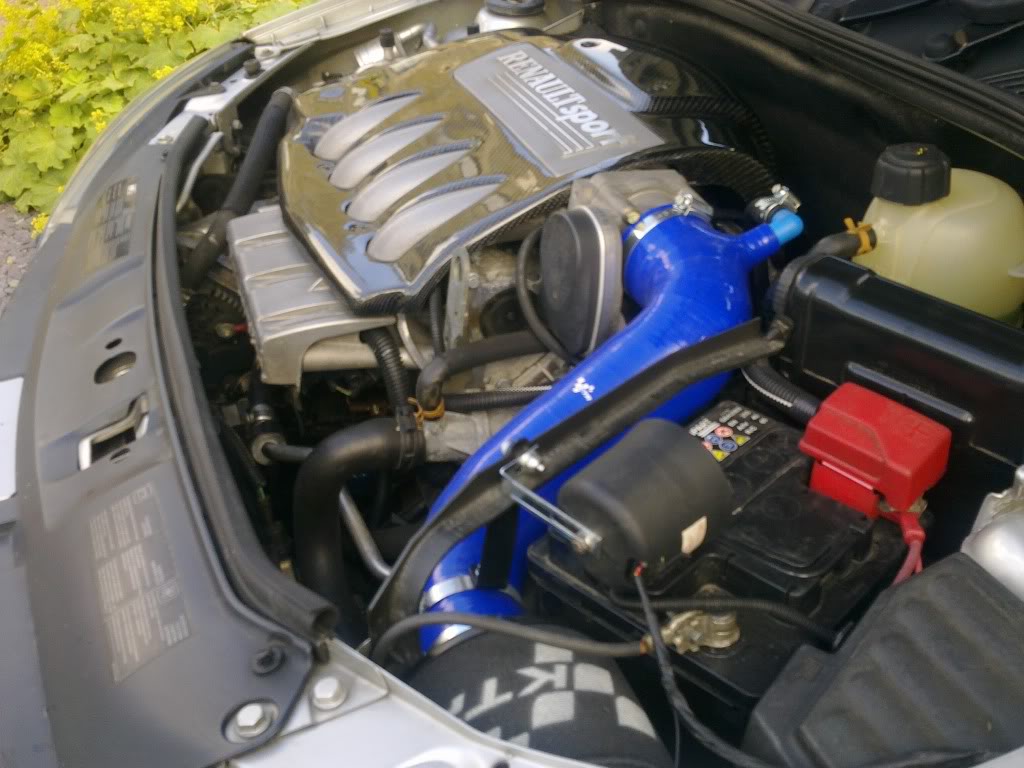

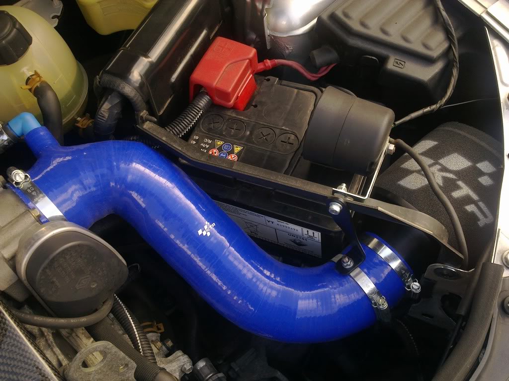

Here are some pics of it fitted. I WILL get a video this week I promise.
  Clio 182 Trophy #229
Oh I had to move my alarm and make a little bracket for it. That is the thing over the battery. I don't know if anyone elses car has the same thing.

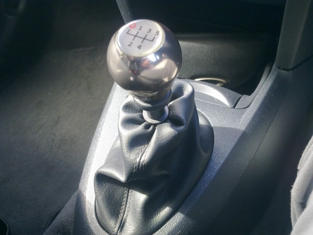

A very bad pic of my new gear knob as I broke the old one fitting the stiff shift. I managed to find one in titanium not silver or chrome. It is almost exactly the same colour as the door handles and inserts so fits nicely and feels a lot nicer than the standard item.

I just ordered myself a richbrook slant-top knob. Wondering how you go about fitting them? I heard they're threaded, did you just screw it on or did you have to make a thread or something? Also, how did you go about getting the original item off? I hear they're not easy.

hello bud, i fitted one to mine. in order to get the old one off you have to basically cut it off bit by bit (i dont mean at the stick) you will then reveal the end of the stick and the richbrook simply slots on and is done up with an allen key which is provided.

Great thanks! That doesnt sound too bad at all. How do you find the slant-top alloy knob? Much better than the stock? Hoping they're a good fit
