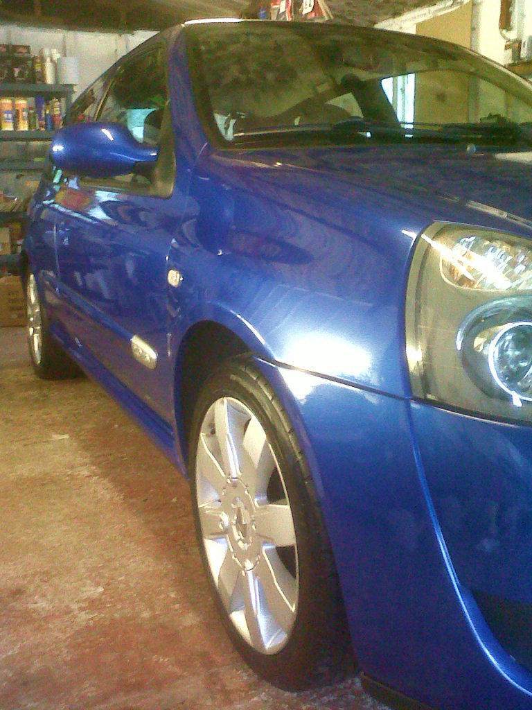

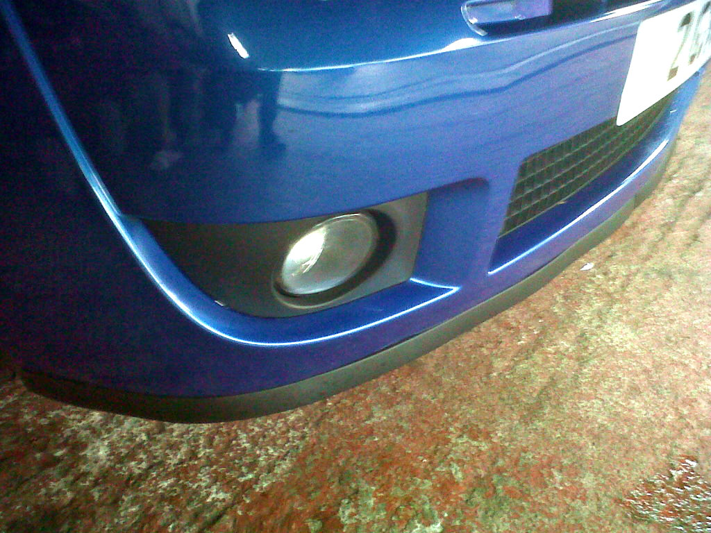

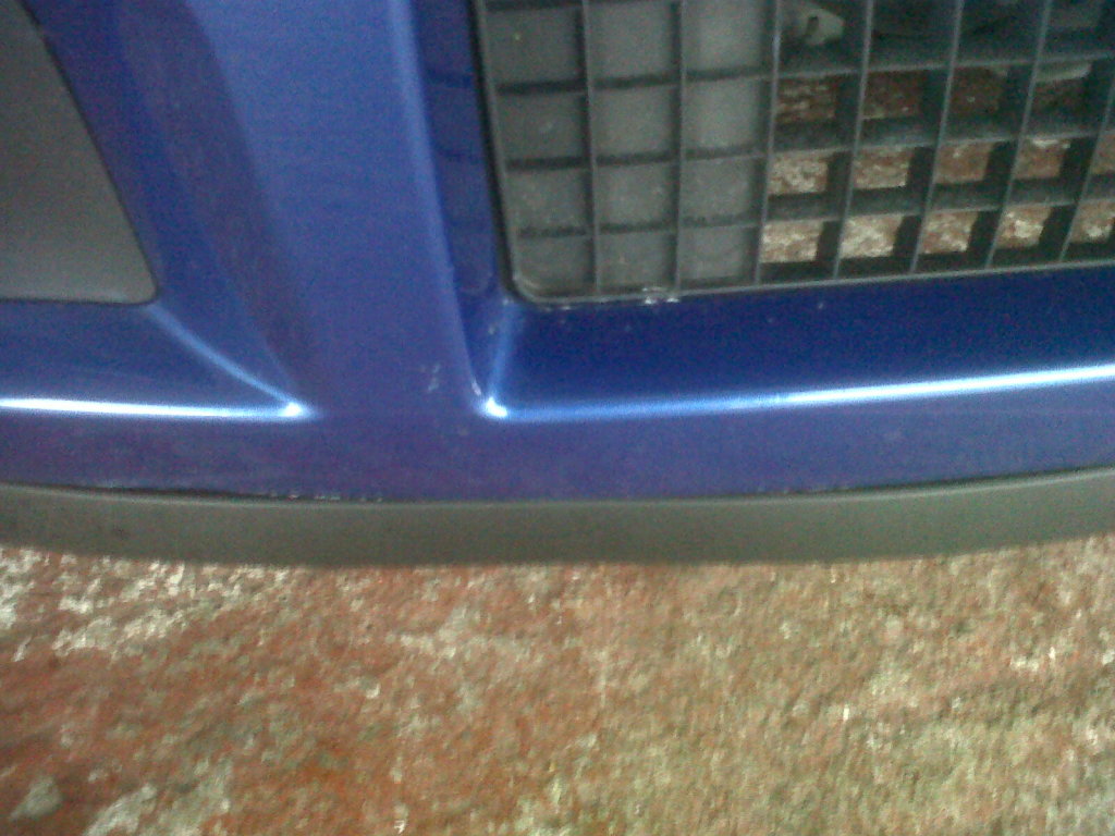

Hi there, got round to fitting the Fabia Splitter, however it does not quite sit right and has sort of waves in it, pictures below ( Excuse the bad quality - Blackberry S#@t )
Couple of coats of Auto Glym polish/ Cutting compound for the minor scratches and 2 Coats of Carnauba to finish off ( again sorry for the horrid picture quality.)
Used about 10 self tappers for the splitter and it would not sit correctly no matter how many times I tried, any advice would be appreciated... Apart from investing in a decent SLR!

I think I used about 20 self tappers to put mine on, spaced about an inch apart iirc. I found it quite easy to keep the splitter fairly straight with it being attached at so many points. Car looks nice and clean anyway :)

Mine sits about the same mate, in a similar position to yours. I think it's the rivets underneath the bumper affecting it.

Looks nice mate, even my cup splitter was sitting like that...had to keep re-drilling and moving the screws forward/backwards to get it to sit right! Lol

I did mine myself and it's perfect. There was a few bits like yours but i sorted it out. Start in the middle
