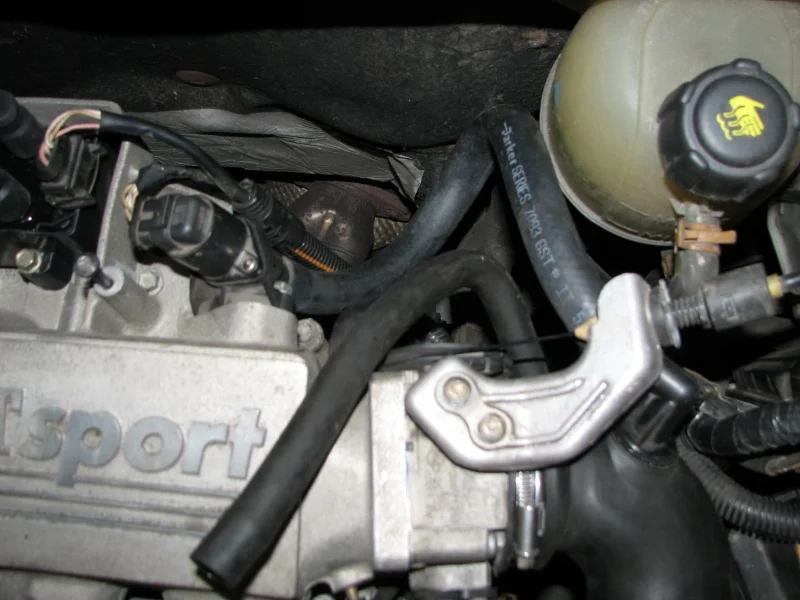

Can't figure out where this pipe is supposed to connect to - the one coming out of the throttle body
  172 ph1
Found it, but have a misfire :(
