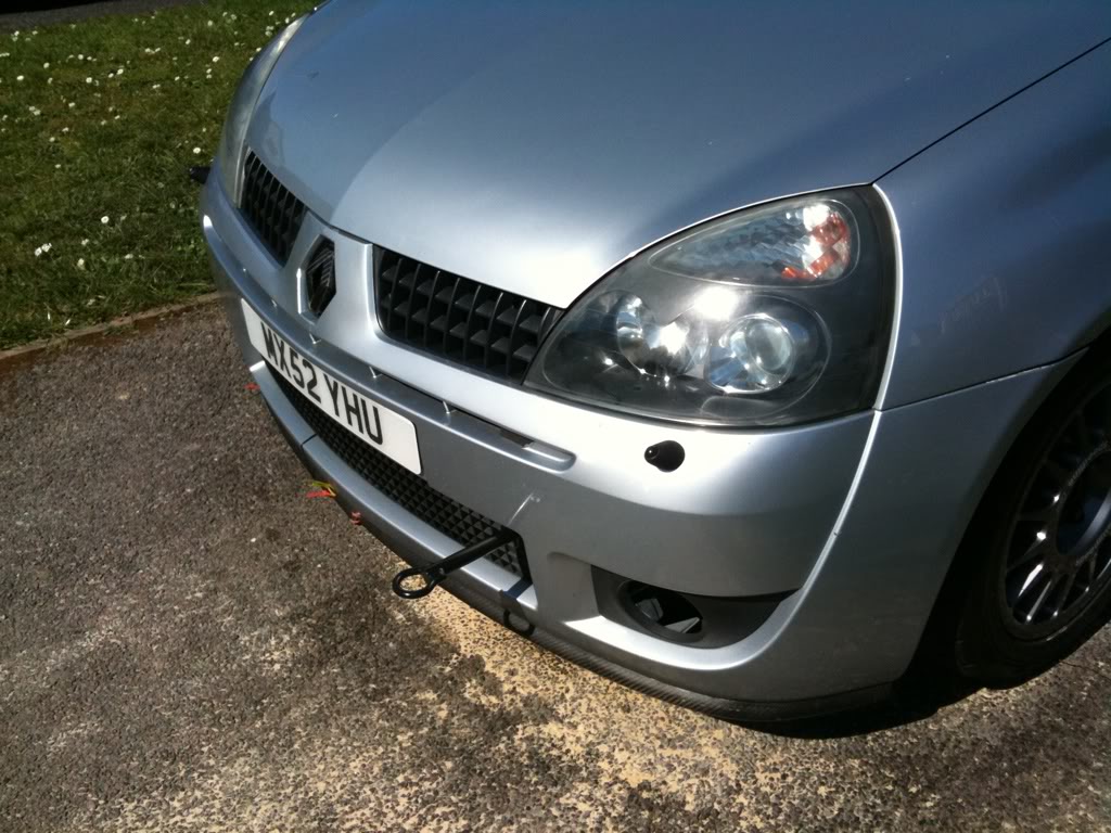

Fletch has gone a bit ott with the toweye :rasp:
^^^I can't believe you stole my 'Genuine' cup racer tow eye ;):(

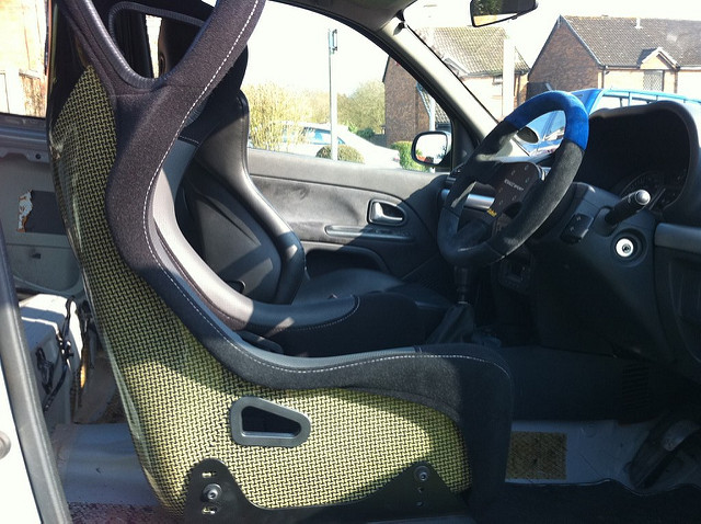

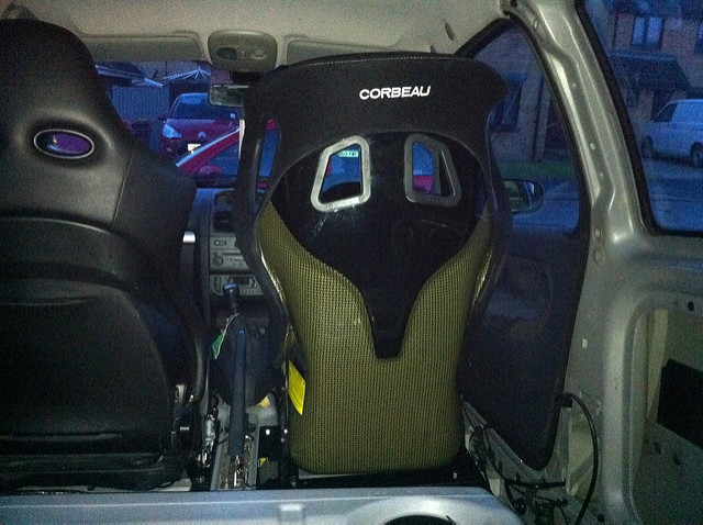

Seat is now in but not sitting level, as the OMP subframe doesn't really seem fit for purpose.
I'll buy some more washers, to try and level it up, and sort out a new harness ASAP as I don't have seatbelts fitted atm.

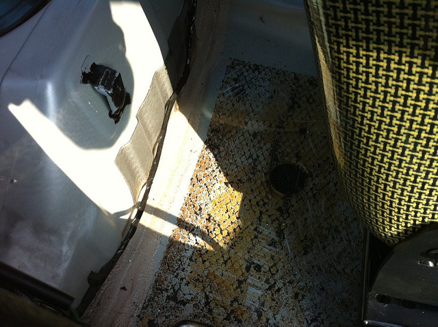

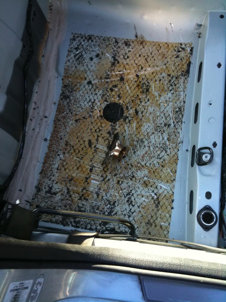

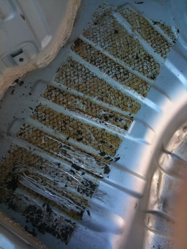

I bought a heatgun yesterday, and got to work on the tar patches, I'll get some pics up later.

Chris and I turned up and Fletcher was still out in the Hilux Cup so I decided to nick his genuine Cup toweye and replace it with my Meganes toweye.

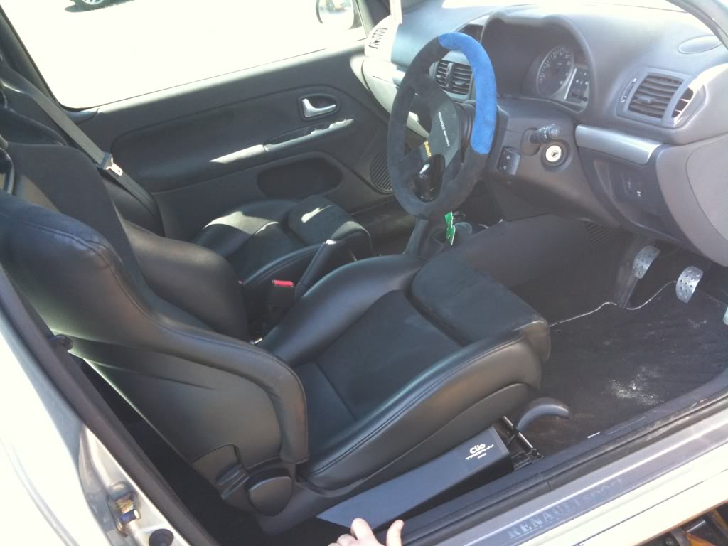

Here's what we started with nice Recaros and carpeted interior.

Recaro out, plastic trim removed, carpet removed/ripped (by Fletcher)
After trip in the R26 to Machine Mart and B&Q, Fletcher purchased a heat gun to remove tar patches and M8 bolts to fit OMP subframe.
Tar patches in boot and under drivers seat removed using the heatgun (excellent for 20 quid) and a chisel
OMP subframe is way out as mentioned above, we packed it up with all the washers we had but still didn't look level.

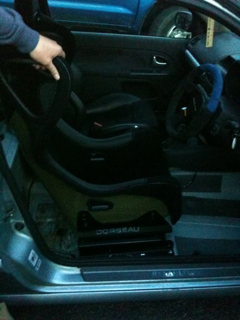

Finally the seat is fitted (for now)
Not bad progress by Team Anorak Racing, shame the OMP subframe isn't level and Fletcher needs harnesses with snap hooks/eye bolts.
Think options are pack with more washers, bolt side mounts to floor, or purchase new subframes.

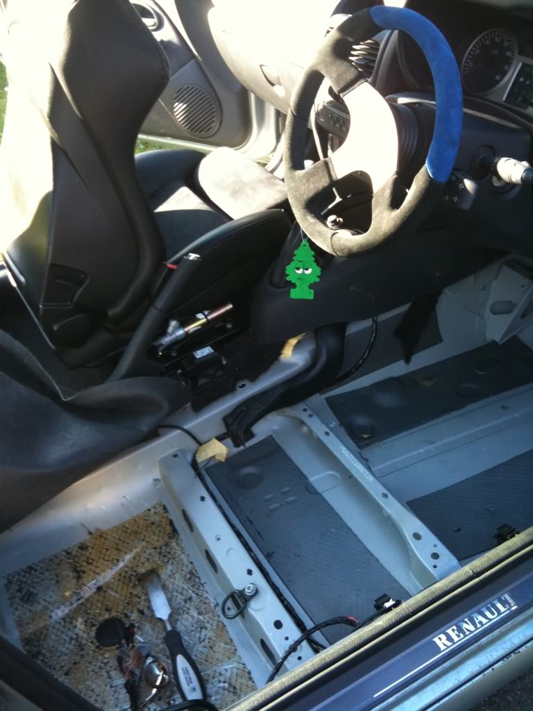

*****Todays Progress*****
I have removed all of the interior carpet now, and a load more tar patches (I now have a full carrier bag of heavy tar)
I purchased some more M8 washers to try and adjust the seat, so it sits level but didn't have the time today to fit them. I did adjust the seat, so it sits slighty closer to the pedals/steering wheel.
I have removed the drivers seatbelt too.

When you sya that the seat doesnt sit well, does it slant to the side? If so just get it straight using the holes on the sidemount chap, had to do the same with mine and i'm using Cobra subframes! There all pretty pants and you have to just keep on adjusting them until they seem alright.
Making progress matey!
Yes Nick it does slant to one side mate.
My Dad did suggest adjusting the sidemount holes each side earlier, so they sit level. I'll hopefully have time tomorrow to have another look at it whist it's still daylight.
Yeah just chuck it up a hole front and rear on the left hand side sidemount, will sort your porblems out! Thats how mine was at first, and btw, get rid of the washers on the subframe as thats something not even Failsport would do ;)

Yeah will be fine chap, all the pressure is going to be going to the bottom of the sidemount/on the base subframe. Had it like that on my Cup for ages now and trackdays included and nothings gone wrong (touch wood!).
