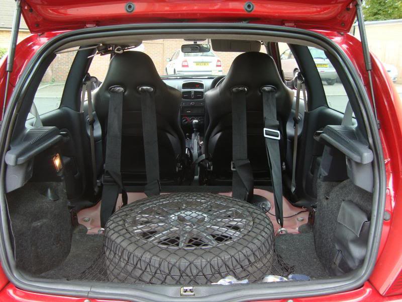

Thanks for the pics Tim.

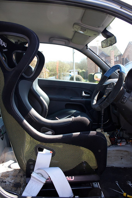

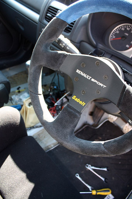

Just spent another couple of hours on the seat.
All of the washers on the subframe have been removed. The seat will not sit level, no matter what I do. So it looks like a Corbeau subframe will have to be ordered :(

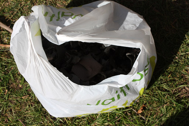

I had a few hours spare yesterday afternoon..
Carrier bag full of removed tar.
A bit more interior strippage.
How she now looks.
Just waiting for my snap hooks and eyebolts to arrive, so I can fit my harnesses
You need to raise the inside (gearbox side) by about 2cm. I did this by using 6 x washers (for each hole) between the OMP subframe and the car. Worked fine for me, just keep adding washers until they sit level :)

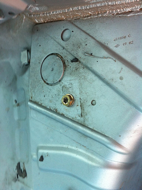

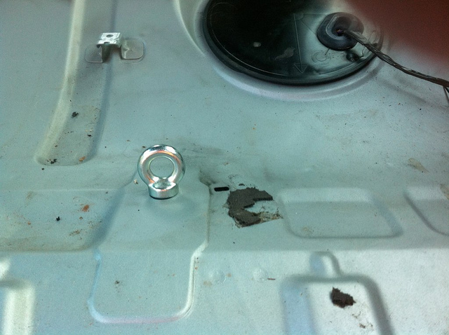

I bought some 20mm eyebolts to mount the harnesses.
Is this the second fixing point you should use for mounting the harnesses?
