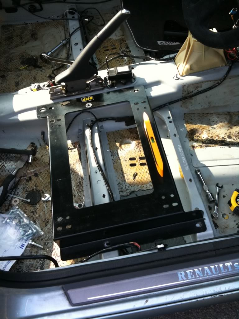

Here's an update of the progress Fletcher and I made on Friday.

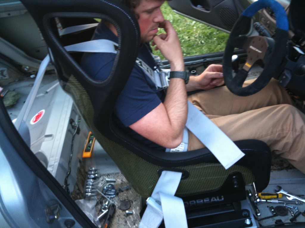

First thing was I asked Fletcher to move the car but he had taken out the seat! Reason being I preferred it facing up the drive when working under the car without axle stands :eek:

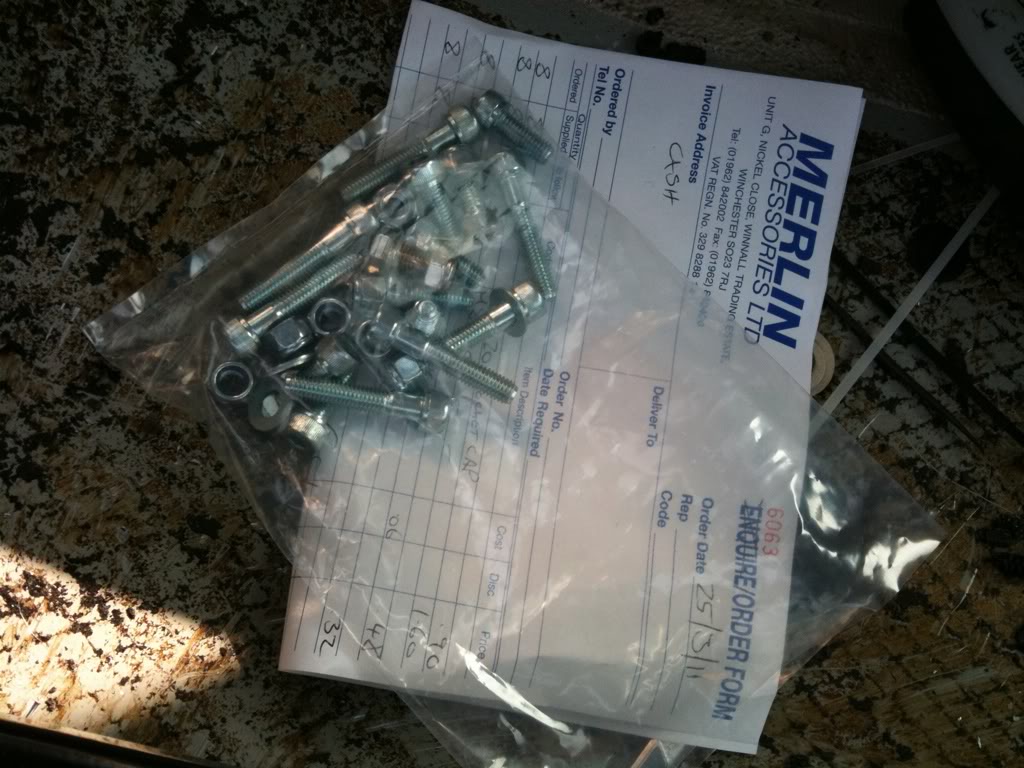

After a trip to Merlin Accesories in Winnal we had purchased all the 12.9 high tensile bolts we needed. Much better than cutting down B&Q high tensile bolts :p

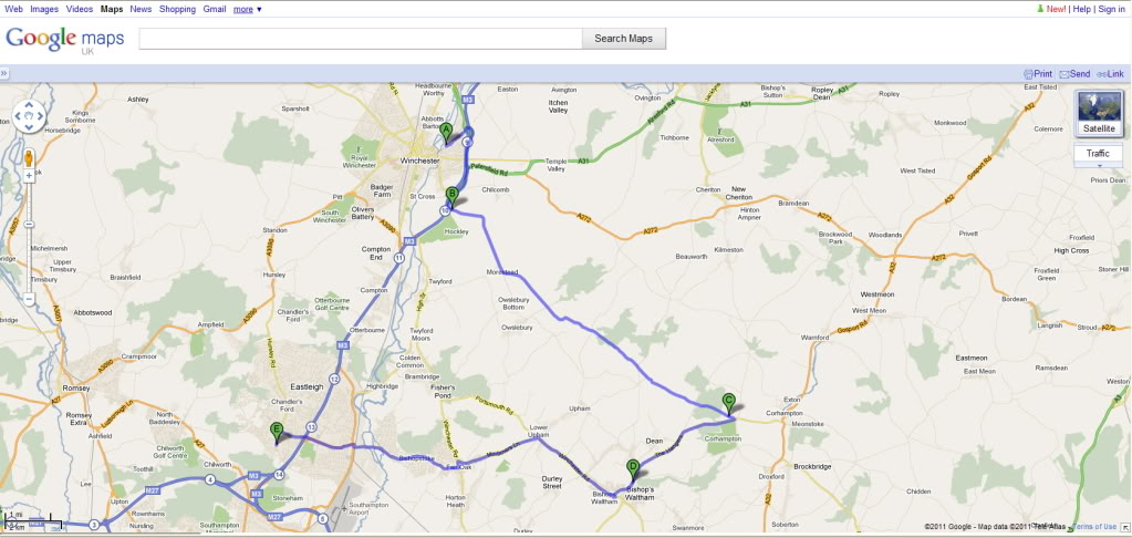

The trip back from Winnal to Chandlers Ford was via the "Hampshire Ring" aka Morestead to Corhampton. I have to say the R26 is epically quick on a B road blast :D
This 15 mile detour though meant we missed the postman delivering a "signed for" letter that we hoped was an important part we needed. Ooops!

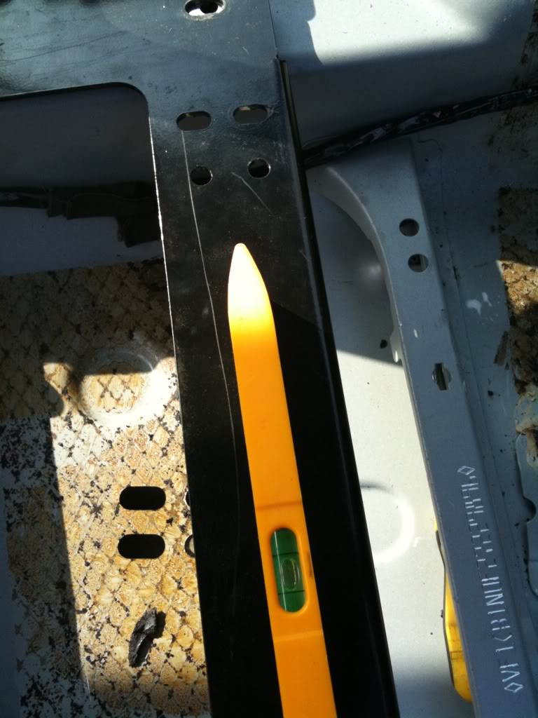

While waiting until we could go for the letter we test fitted using the vibration washers + an extra metal washer on the gearbox side.
And it was level!
After a trip to the Royal Mail depot in Eastleigh we had the Schroth B23A Bracket. Thanks Dave for the link :)

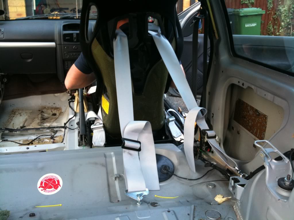

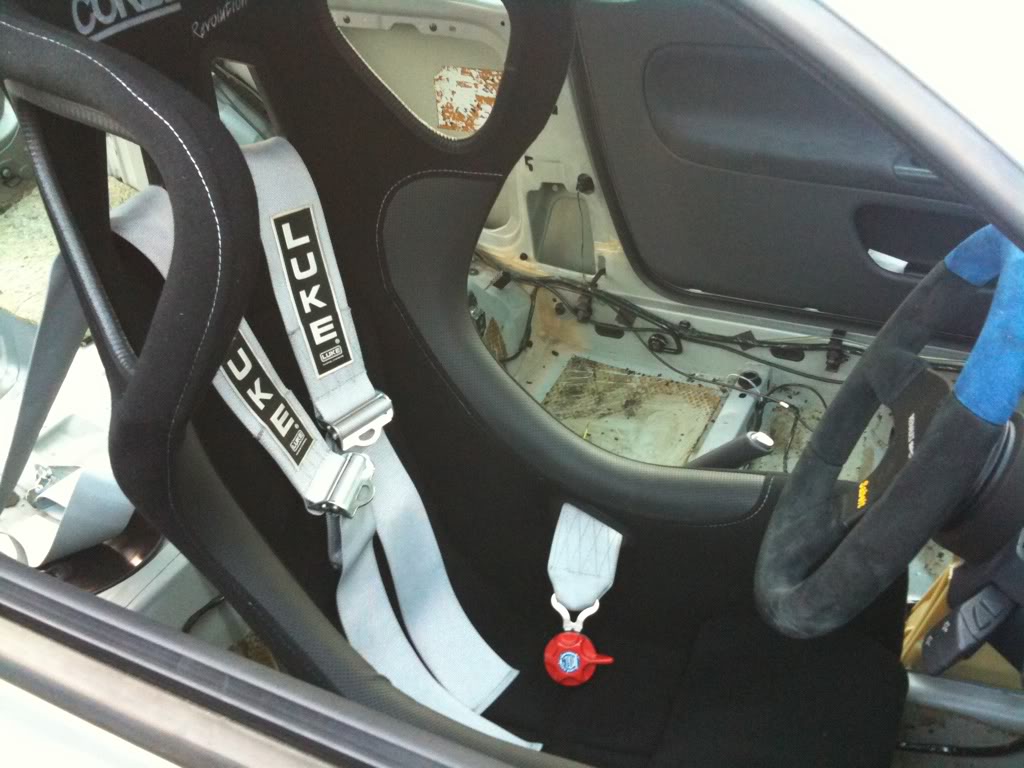

Subframe, sidemounts, Corbeau seat and Luke harness fitted. All bolts torqued to 30NM (first time I've ever torqued bolts LOL).

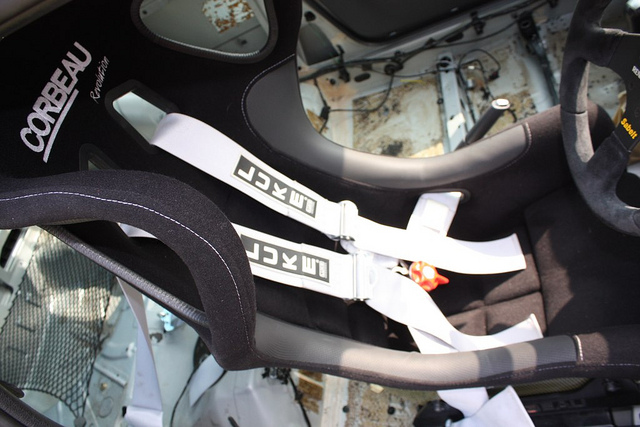

The mounting points used for the harnesses. Lap belts used the oem position on door side and Schroth Bracket on gearbox side. Shoulder straps used eye bolts in rear seat belt points on bench floor and side of the car.
Finally picture of the seat and harnesses and wheel :approve:

Although if you want both harnesses a bit straighter to the back of the car, i.e. less angle on the outside strap in this pic:
Buy an M10 eyebolt and use the rear isofix mounting hole for the harness.

What size M10 would fit. 20mm eye bolt was slightly to big for the isofix mounting hole?
lol. You forget, FailSport only have one associate who actually knows what they are doing (sort of), i just follow guides, Nick has a 'mechanical' brother, & Ollie, well ...
I used 2 of these eyebolts for the rear :)

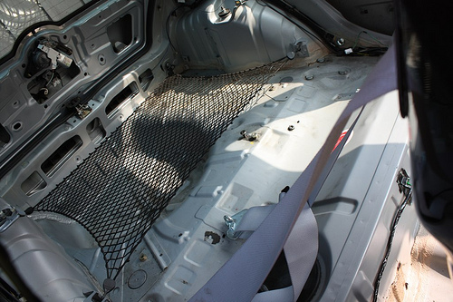

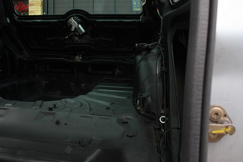

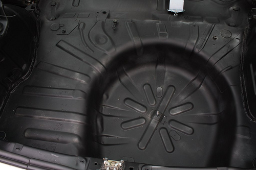

Today I had a few hours spare so carried on spraying the stripped interior matt black. No pics yet as I have used 2 cans, and still nowhere near finished :(
It does look a lot better/ tidier though.

So 23mm spacers did the job with OMP subframes for you as well? Still cant figure out why they are made this way, makes no sense.

I agree, you would think the OMP subframes for a Clio would sit level :rolleyes:
