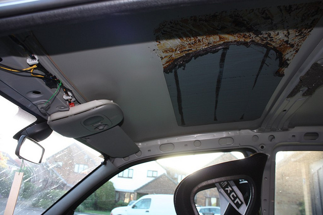

***Quick update****

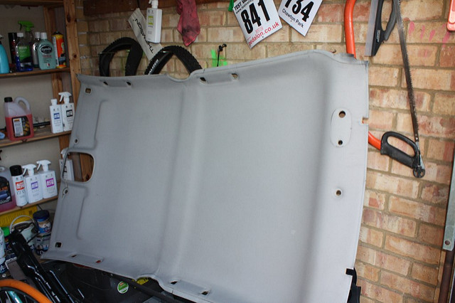

I finally removed the headlining.
And had a go at the huge tar patch on the roof. I stopped midway, as I burnt my finger, and was getting tired/hungry :dapprove:

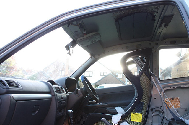

And how it now sits..

It always makes me laugh how big the patch is under the headlining, took me forever to remove it!
Coming along nicely :)
maynard
  ph2 172 track car
Me too :(
Only on the one side though, I still can't get rid of that orange glue. Just won't budge :(
maynard
  ph2 172 track car
It's so much thicker then the other patches..lol
I'll hopefully attack the rest of it tomorrow!
Tell me about it!
Be careful when you go at it, make sure you get plenty of heat at it and use your fingers to pull and pick it off - don't dig a scraper into it like at all the other patches on the car - you'll get horrible little dint marks in the roof :(
Thanks for the tip mate. I have been taking it really easy, as I don't want any more dents.

Yea they were a biatch too! Don't heat the roofup too much, mine got too hot and burnt the metallic Shiz in the paintwork on the outside. Looked fine in daylight but when it had water droplets on it, the roof was brown!!! Thats why I have a black roof now lol, cheaper to spray black ;)
Ooft! How much heat did you put on it!!

550 degrees Celsius pmsl. That'll do the trick. It was un-noticeable during day or most sunlight, but looked awful when you could see it
Brake and clutch cleaner on the glue, was shown that by someone else - works a treat. You'll need a 5l bottle though from an autofactors.

I got lucky with mine, the patch came off with the headlining like it had never been stuck to the roof.
One of the tar patches come off with the headlining... IIRC the 172 cup didn't come with the big tar patch.
Paint thinners and degreaser I used to get the glue off and ready for painting afterwards

I think I'll paint it black to match the rest of the interior.

Good lad, get rid of the little light unit and wires. You can have your climate control fan hidden away then.
Shame the visors weigh quite a bit too, not tempted by a tw*t strip?
