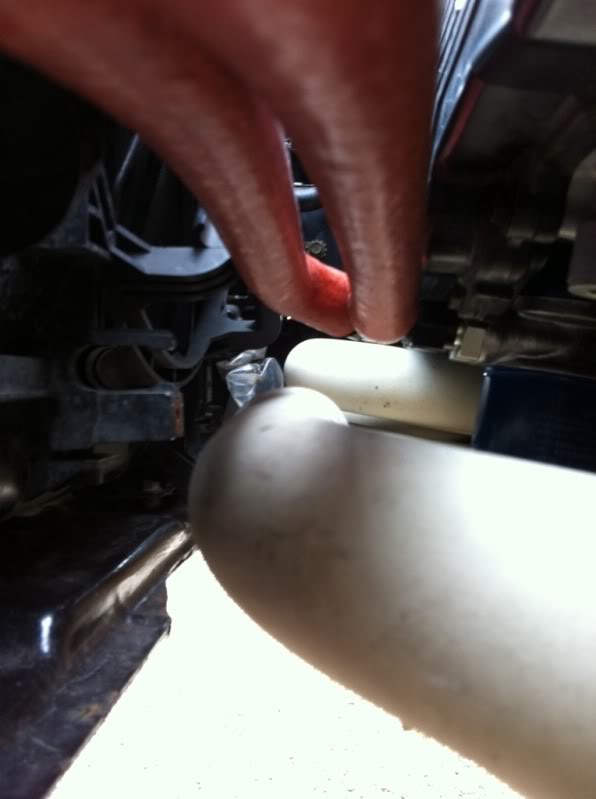

I think people need to bear in mind that it's still a huge 'Jap can' (cringe), just with the tip turned down. I'm guessing it's still a 4" exit?
There's no doubt it looks good, but it's not really any different to the usual systems, bar the tip.

It looks quite small, JDM.
Infact the Yozza 182 tailpipes look bigger!
frayz
Actually you'd be supprised just how quiet it is for a full 3" system. Noise was my total prerequiste for the system. Aswell as the rear 7" round silencer there is a 5x7" oval centre silencer. The whole system is made from thinwall 321 stainless and the only join being a single v-band.
The end result was 91.5dB static and 89dB drive by. The system has lost a lot of the trademark Subaru flat 4 beat due to the use of almost equal length tubular headers. It retains the burble at below 2K rpm. Thereafter it becomes an almost Superbike style howl. Its pretty intoxincating to be honest.

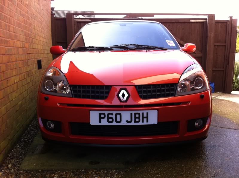

Picked up the Clio last night guys.
First impressions are very very good and im suitably impressed. Looking forward to getting out for a proper drive.
Im like a kid at christmas at the moment :)
frayz

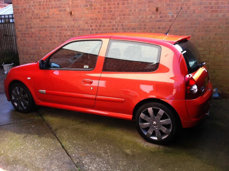

Well guys here she is.
The day I picked her up. 100% stock 182
Excuse the cak phone images. I'll get some proper ones once shes had a clean and i can get out in the sunshine. I wasnt 100% on the colour before i picked it up. But now im quite smitten on it. Still feels and smells like a brand new car, the rear seats have literally never been sat in. Even the door sills still have the protective plastic on them.

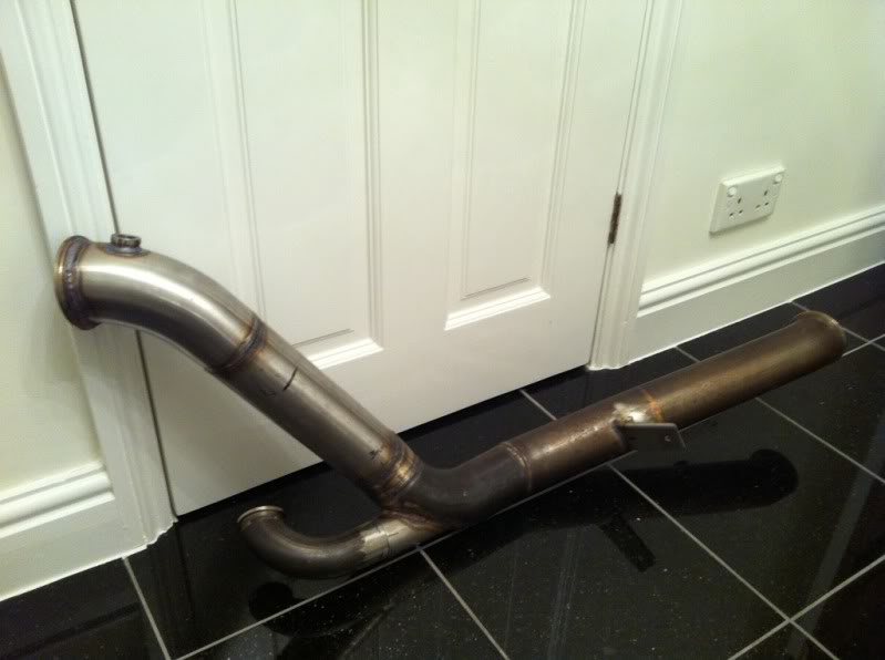

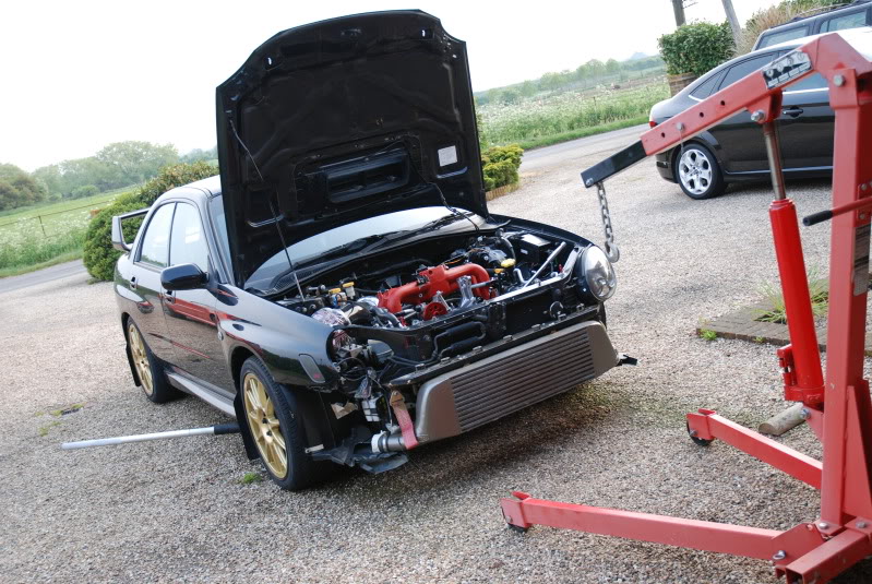

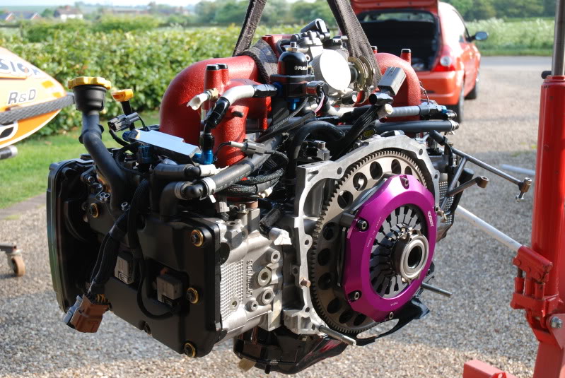

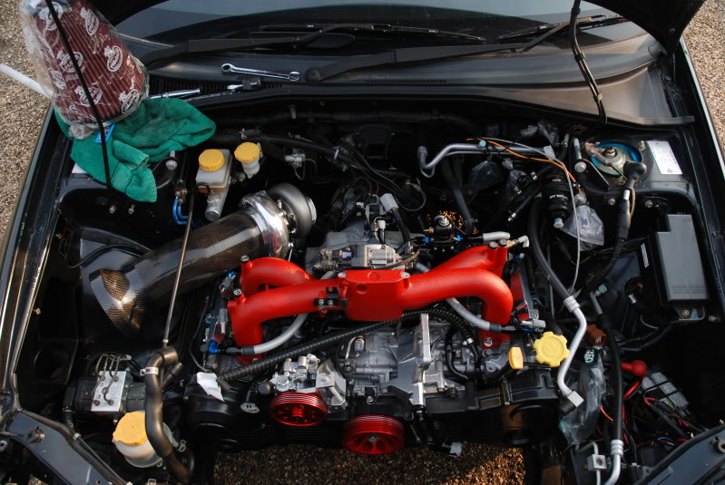

Having some greif with the twisted doenpipe that was made so that needs remaking. Done a few more little odds and sods jobs but till the downpipe is remade i cant do too much. Once thats done, both that and the uppipe can either be wrapped or go fer ceramic coating. I cant bolt the engine in on its mounts properly yet till the uppipe is done.
So here i sit and wait :D

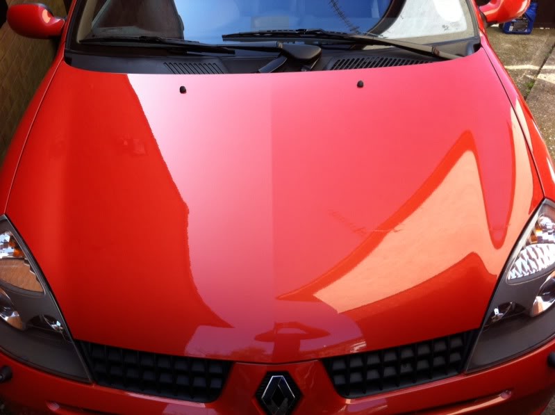

Detailed the 182 today instead :)

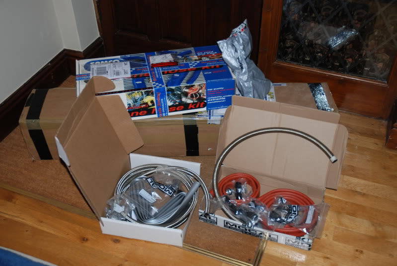

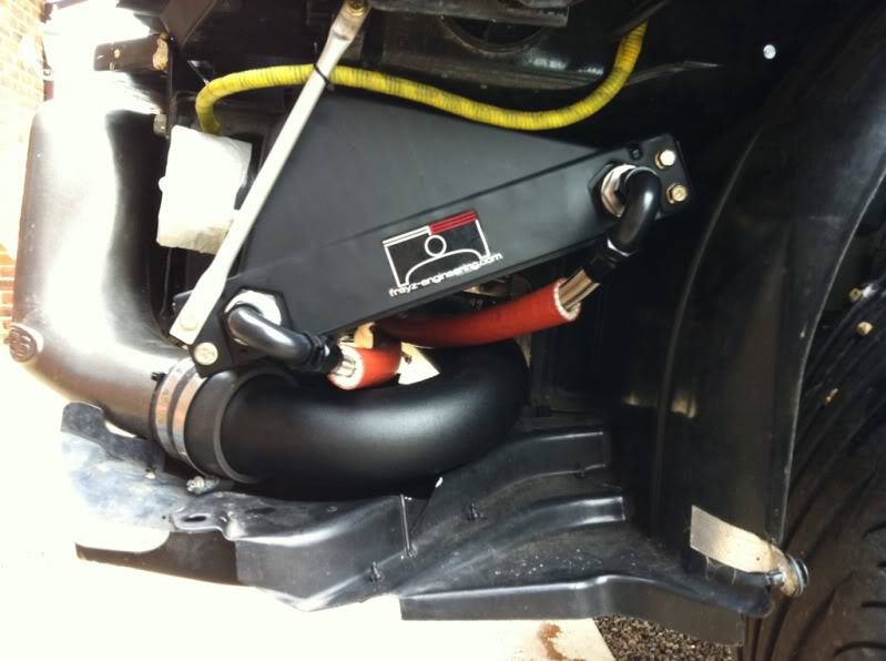

More stuff arriving all the time... my postman must be getting pissed off with me by now. This was todays little bundle :D

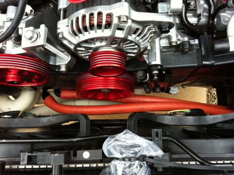

Oil cooler bolted up now with a slightly revised duct to aid ease of fitment. Just gotta plumb this up now :)
frayz
Oil cooler plumbed in. I'll clip up the lines when the rad gets its final fitting.

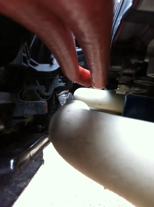

Also finally have a downpipe that fits. She dont look much but ive been on hold for this since dropping the motor back in.
So we're back in business, hopefully the homeward run now :)
