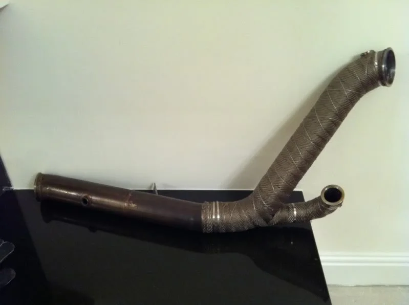

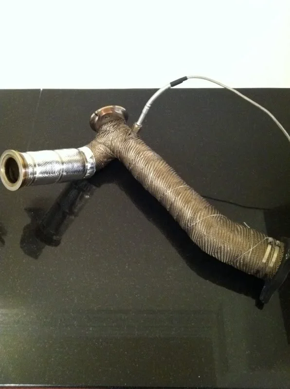

DEI wrap arrived today so took the turbo/uppipe back out and got these wraped up. Gave the wastgate pipe and extra layer of Kevlar to help protect the steering UJ.

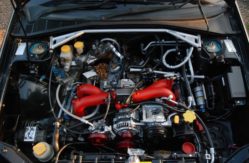

  TrackCar & F30 330d

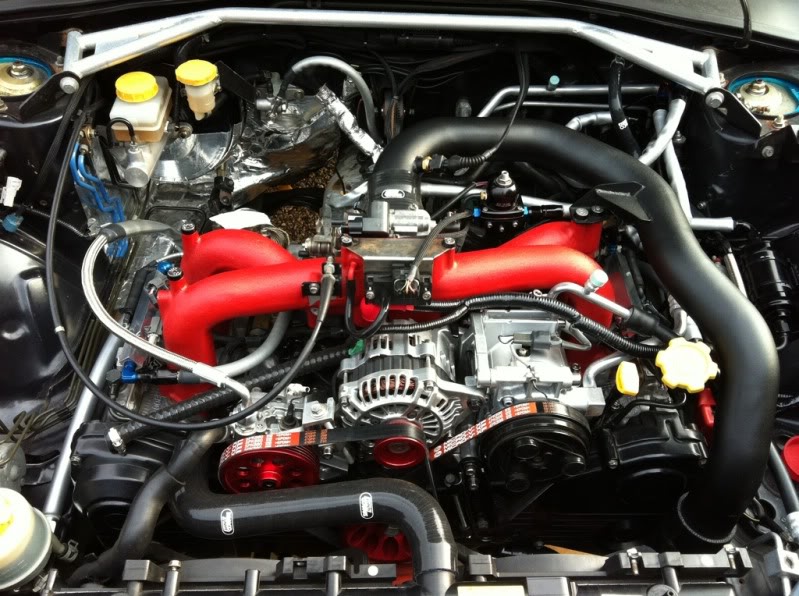

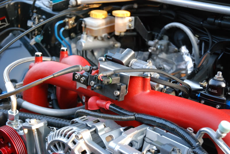

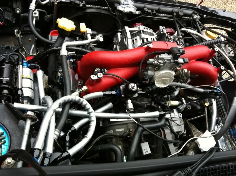

The engine looks pretty cool. I like the pulleys a lot. Did you buy them that colour if did you get them anodised?
Why did you heat wrap the exhaust downpipe thingy when you could have got it coated like you have with the big red bit on top of the engine?
frayz
Pullies were purchased like that. The exhaust is wrapped for thermal efficiency. This is to both keep the heat in the system and to stop heat radiating into the engine bay and surrounding components. The coating on the intake manifold is just Powdercoat. It's there only for aesthetics and corrosion resistance.

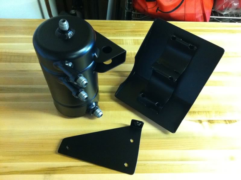

Collected some parts from the powdercoaters tonight including my fuel cradle and swirl pot. I think they've come out pretty nice. Hopefully pick up some fittings tomorrow that I've been waiting on, and then I can crack on some more.

Nice.

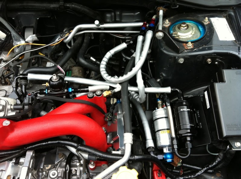

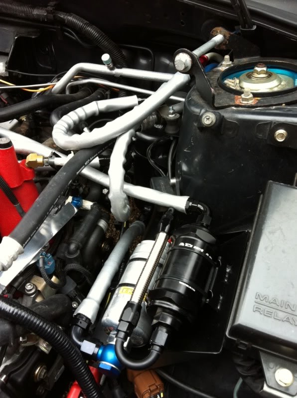

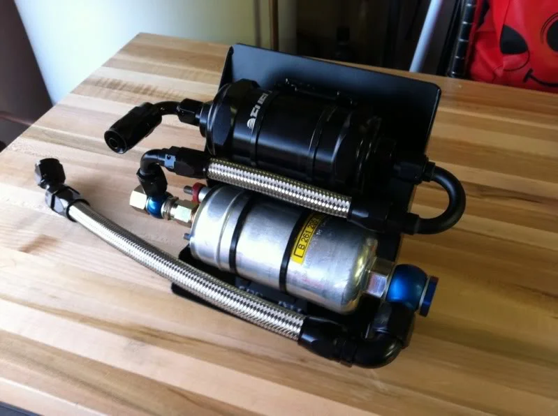

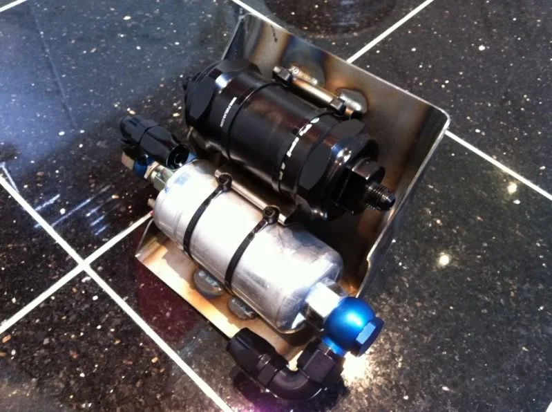

Pump/filter setup complete. Waiting on some fittings at the mo as the black stuff is special order only. Then this lot will go in. Swirl pot is in and ready to go now too.
frayz
Finally got the last of my fittings guys, so the fuel system plumbing is complete, and all Nomex covered.
Still have to do the wiring for the 2nd pump but thats not a worry.
Also refreshed my vehicle loom and added the plug for the Syvecs ACT sensor. However, i got to the last lot of wires and ran out of braided sleeve, :lol1: so ive ordered some more :)
Starting to take shape now and the "to do" list is getting ever smaller :)

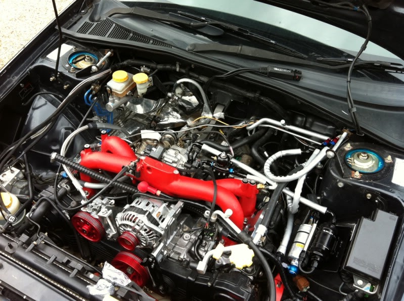

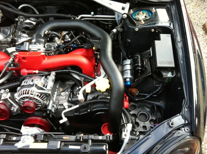

Late nights are paying off guys.

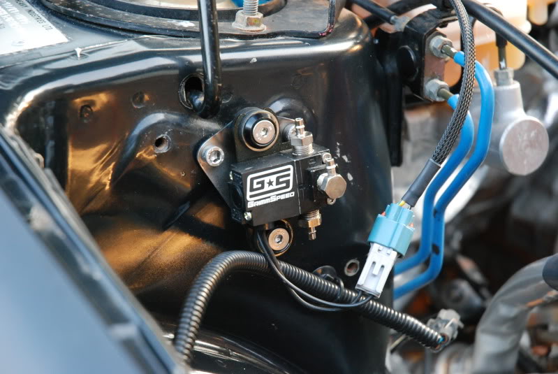

Wiring complete, plugs updated and heat protected where required, various brackets made and parts mounted including boost control solenoid, MAP sensor and A/C pump now back in situe.
Just waiting to get my turbo back and we can make the last boost hose, do the oil separator and get the final parts off to powdercoat.
Getting there :)

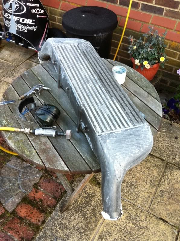

dont powder coat the intercooler... they don't perform as well! you can mask it and powder coat the tanks etc but not the fins as they stop it working as well...
frayz
Most coolers are powdercoated as standard mate. Lots of high performance as well as OEM coolers are powdercoated as standard. Its fin so long as you use a low build powder such as satin black.
MaLicE
Honorary Member
  Lazy v8
hnmmm mine isn't, nor is any greddy, blitz, pan speed etc cooler i have seen?? we are talking intercooler right??? if so i have never seen a powder coated intercooler on any car... painted yes, powder coated no...
frayz
APS coolers come powdercoated, as do ones from Perrin and the stealth range from Pro Alloy. Most OEM coolers are black powdercoated when black from the factory.
frayz
Having spoken with some intercooler engineers today at work it would appear I'm wrong. The OEM ones are not powdercoated, nor are they actually painted. It's a process that's somewhere in the middle. However I know that the APS and Pro Alloy are powdercoated.
So with that in mind I think I'm just going to rub it back and dust it on some satin black paint and see how I get on.

i know one of the guys in the hks drag series made a post about a powder coating intercoolers and said it made a pretty big bad difference to the actual cooling ability :/ its a shame as there are some cool powder finishes you can get :)
frayz

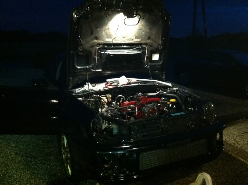

Whoops...
There was no way i could bring myself to bolt up the bumper with the intercoolers paint finish annoying me.
This was taken earlier when i started, it was dark by time id finished. The whole core is back to bare metal now. Hopefully if the weather holds, tomorrow i might get some etch primer on it.
