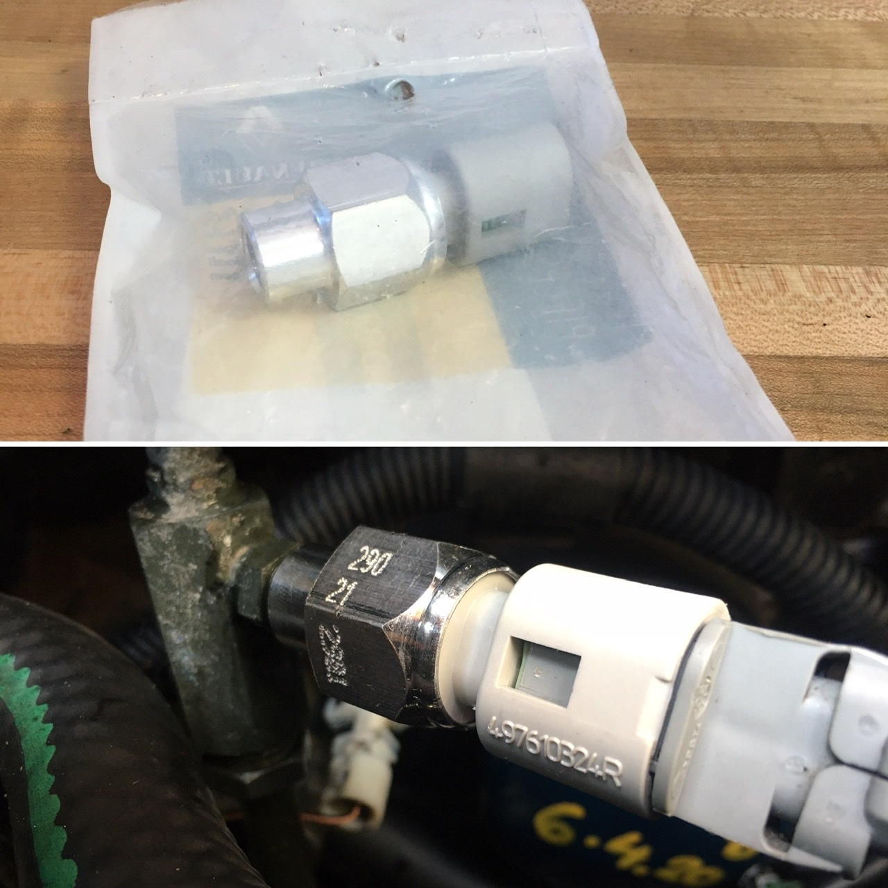

Project lockdown continued today with the arrival of a new PAS switch to try and cure my PAS leak.
Still no coolant bottle arrival so that will have to wait. Anyway, I fitted the new PAS switch which hopefully does the trick.

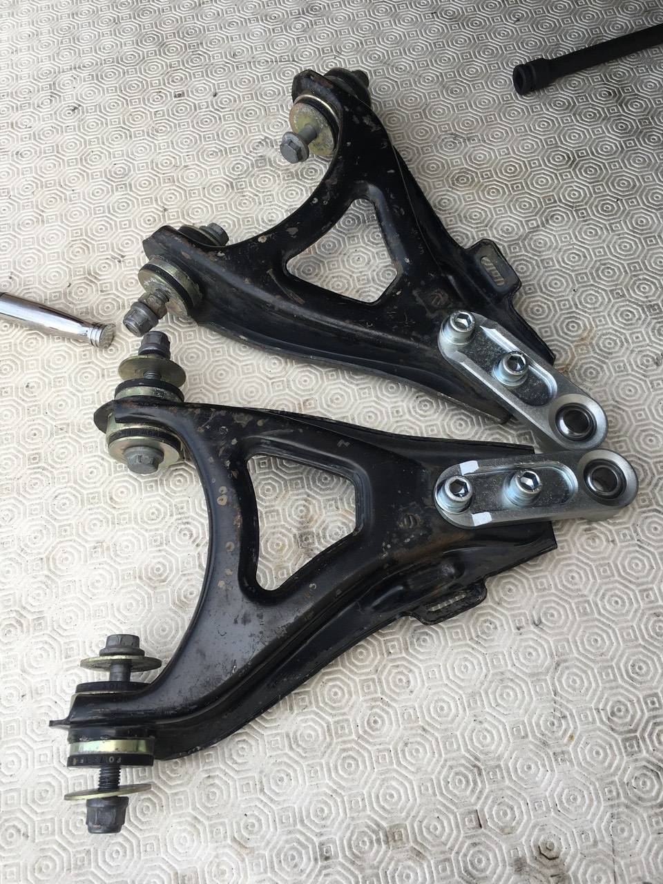

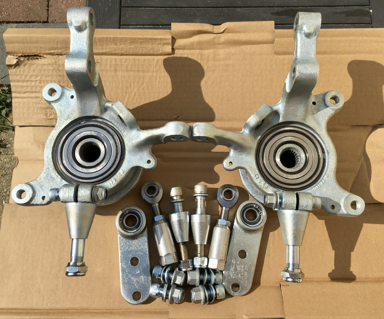

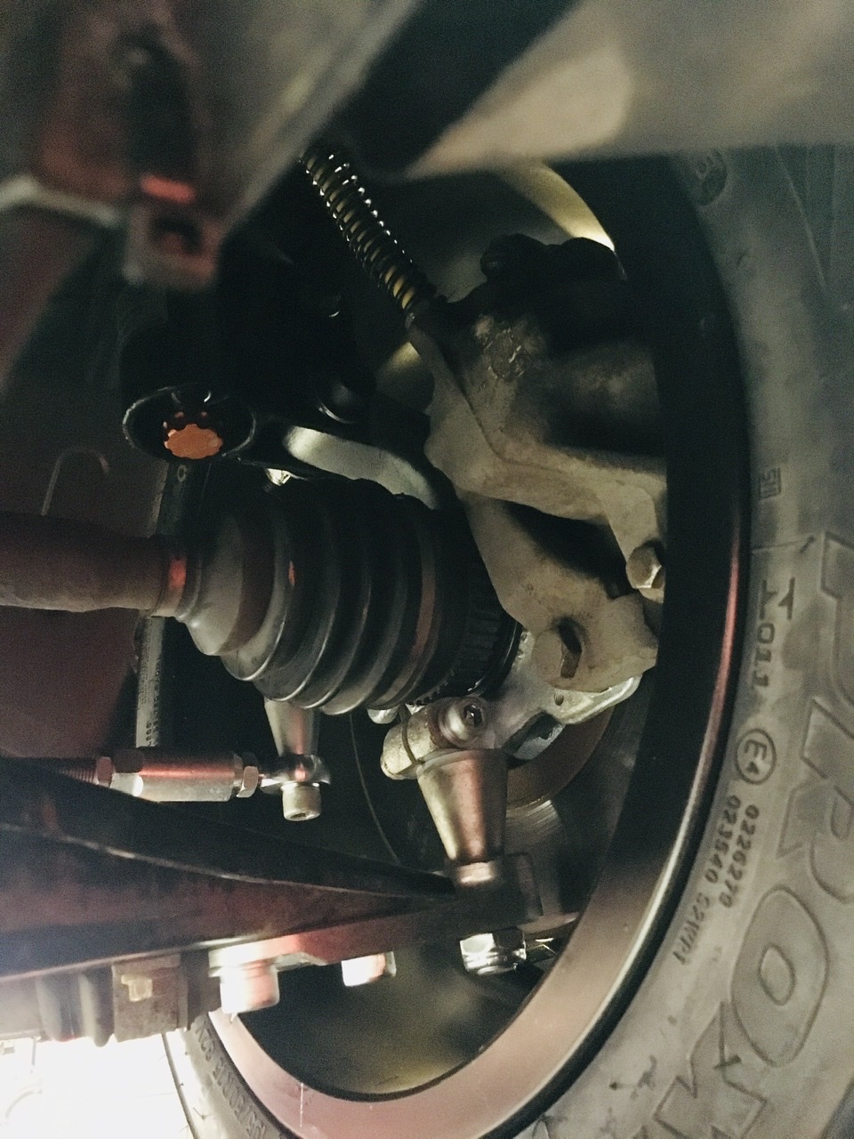

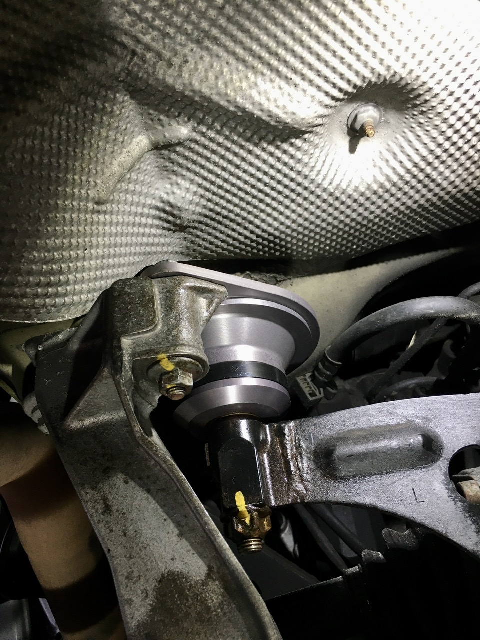

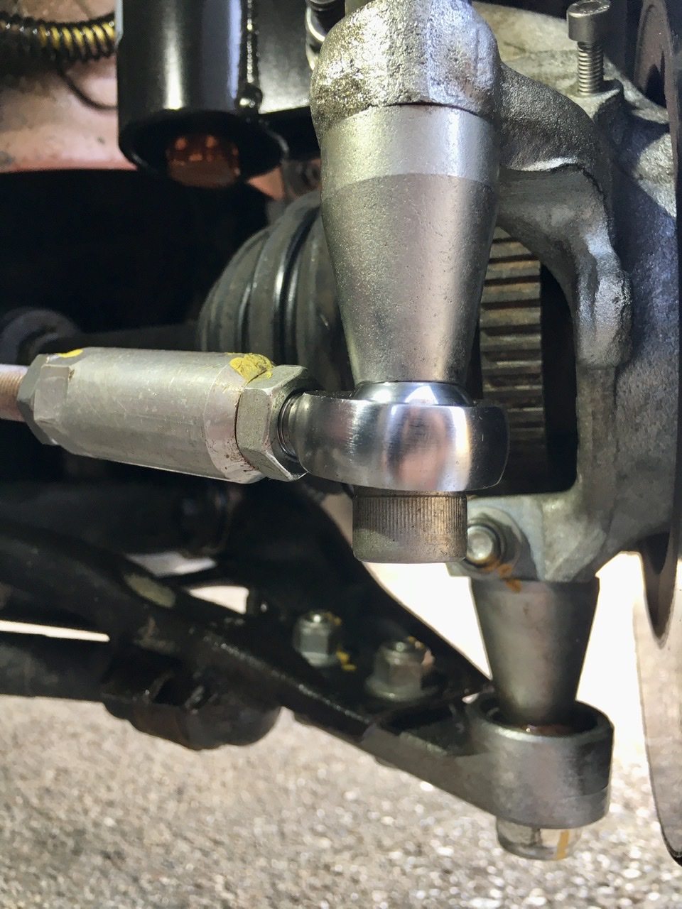

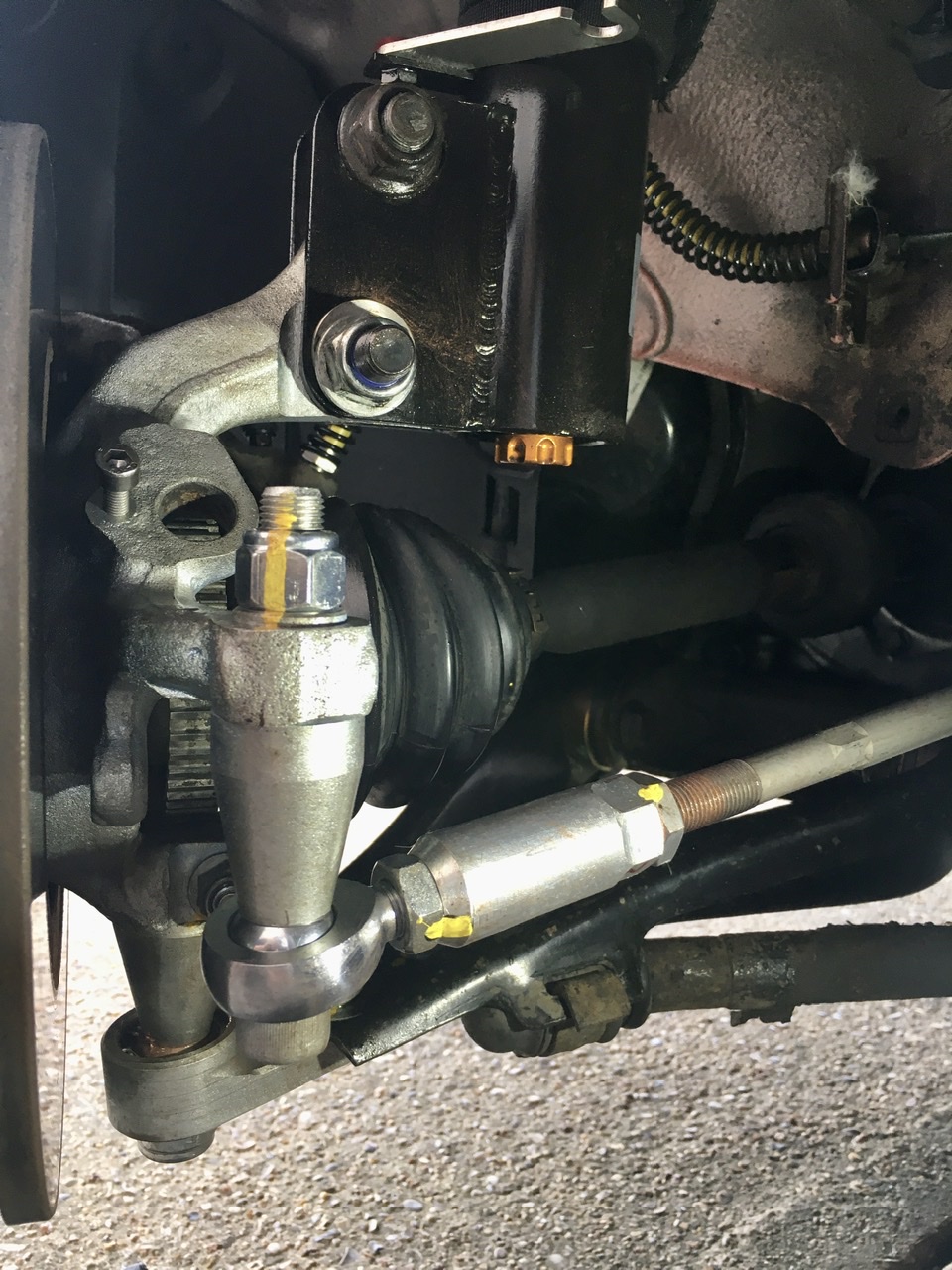

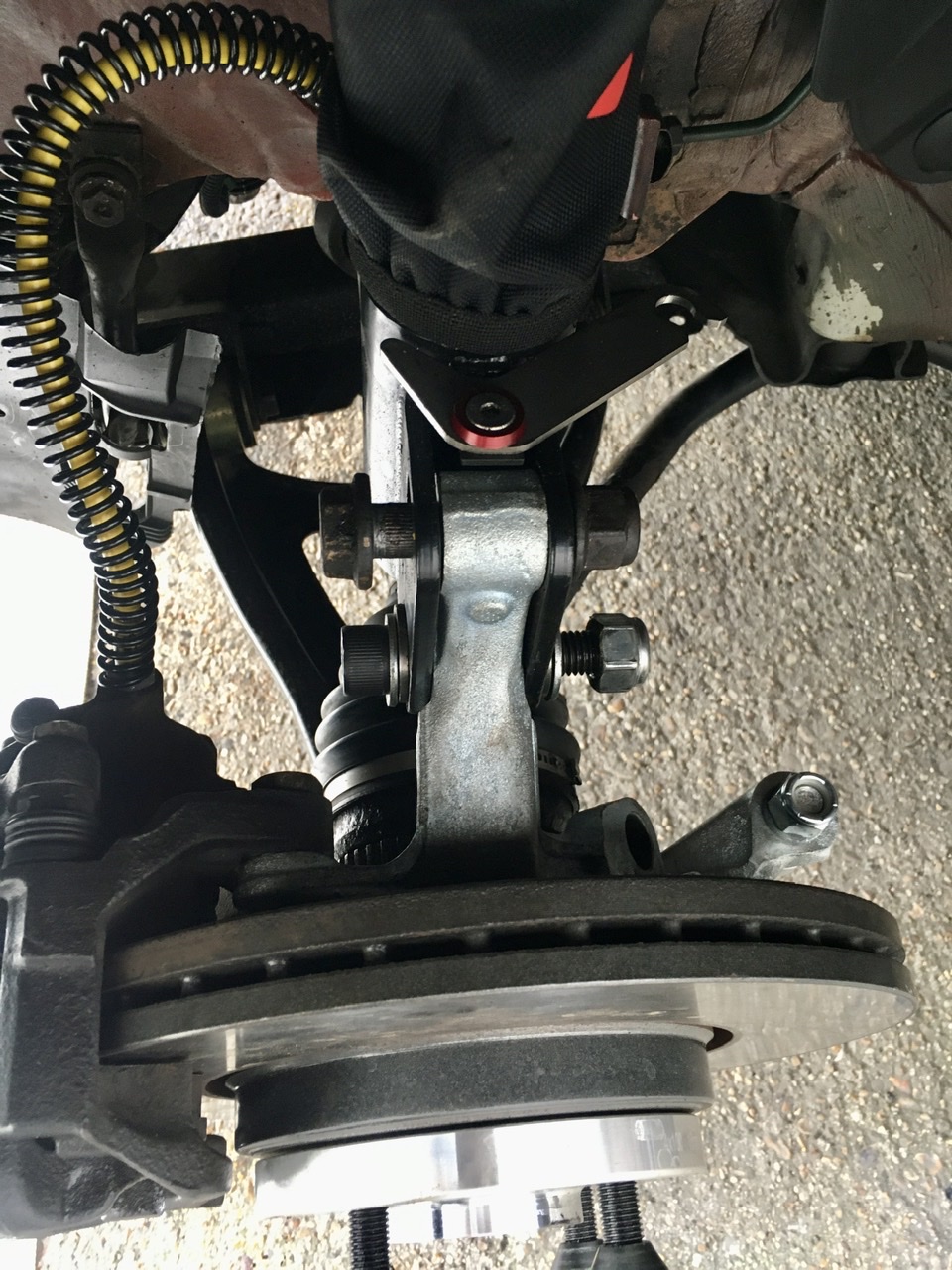

Also decided to bite the bullet and crack on with the roll centre correction hubs and other bits. These are now fully assembled with new rose joints, rod ends and genuine SNR bearings.

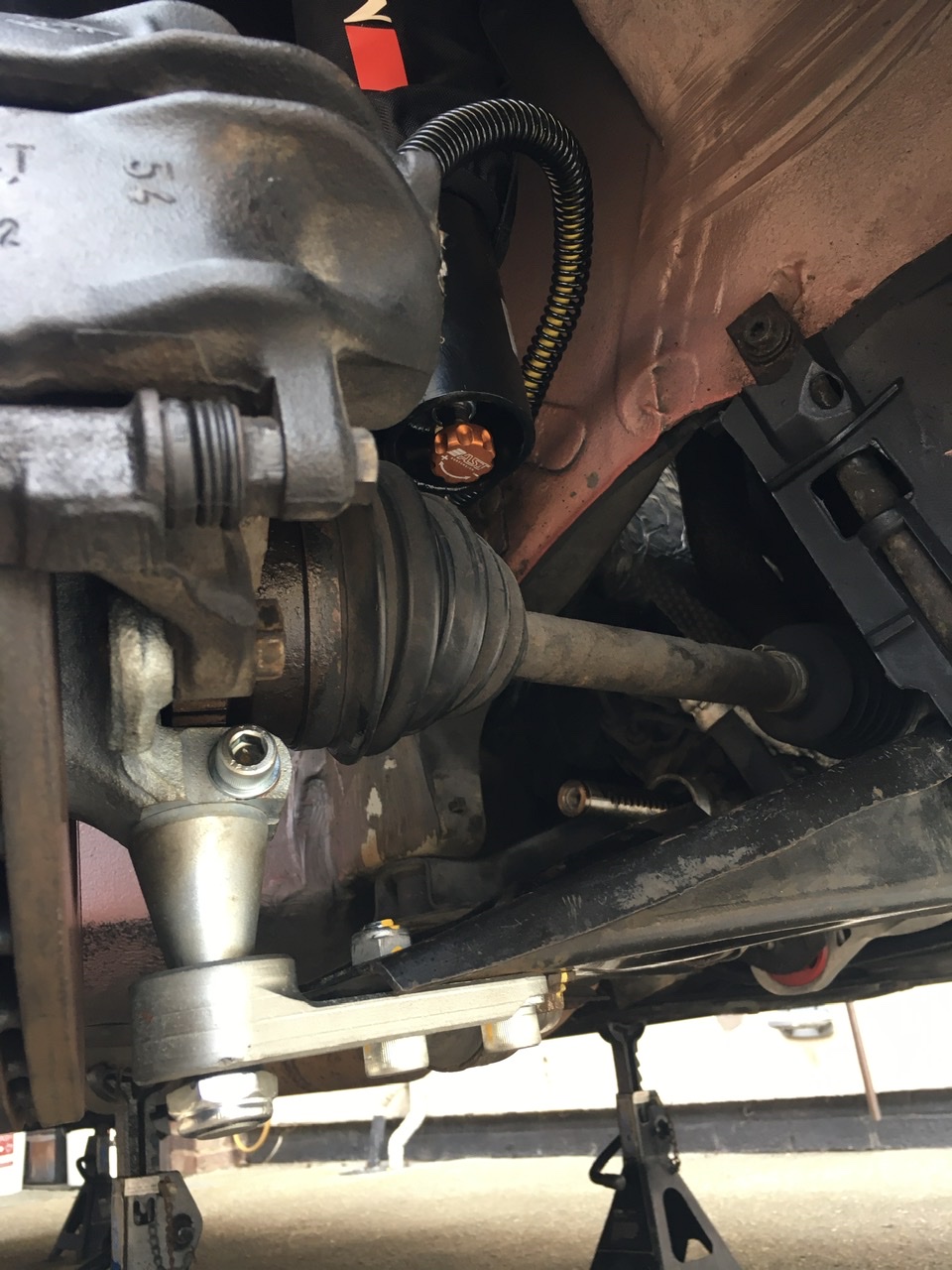

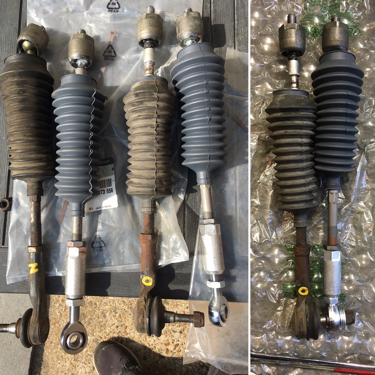

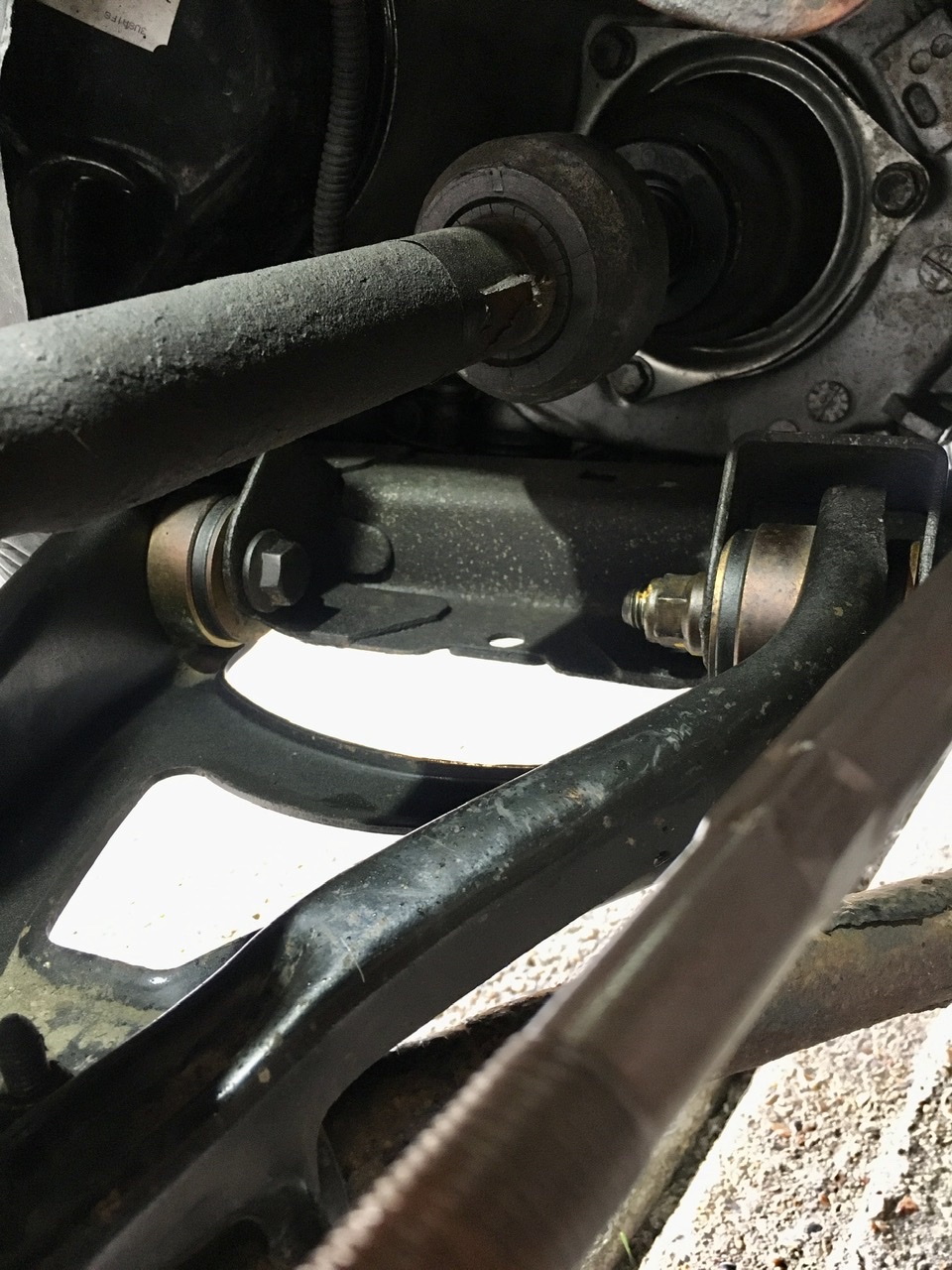

With no way of setting the track rod lengths easily I decided to remove the old ones inner and outer as one piece and make their location. This way I could hopefully build the new ones to the correct length before installing. (That’s my plan anyway 😅)
I found when setting the TCA lengths on their shortest setting they were bottoming out at approx the size I needed. This left too little room for adjustment to my mind so I shortened the rod ends by approx 15mm.
Also had new lower arms to go on with Powerflex black series poly bushes installed so they went on too. So once these are on, apart from the front ARB, that’s every bush, bearing, mount and ball joint replaced on the whole car. Green Loctite 630 was used on all fixed parts and Finishline Ti Prep used on all adjustable threads.
I didn’t start till late so I’ll fit the TCAs tomorrow and torque everything up. There are also a number of dirty bits under here I plan to clean/paint once this stuff is done.

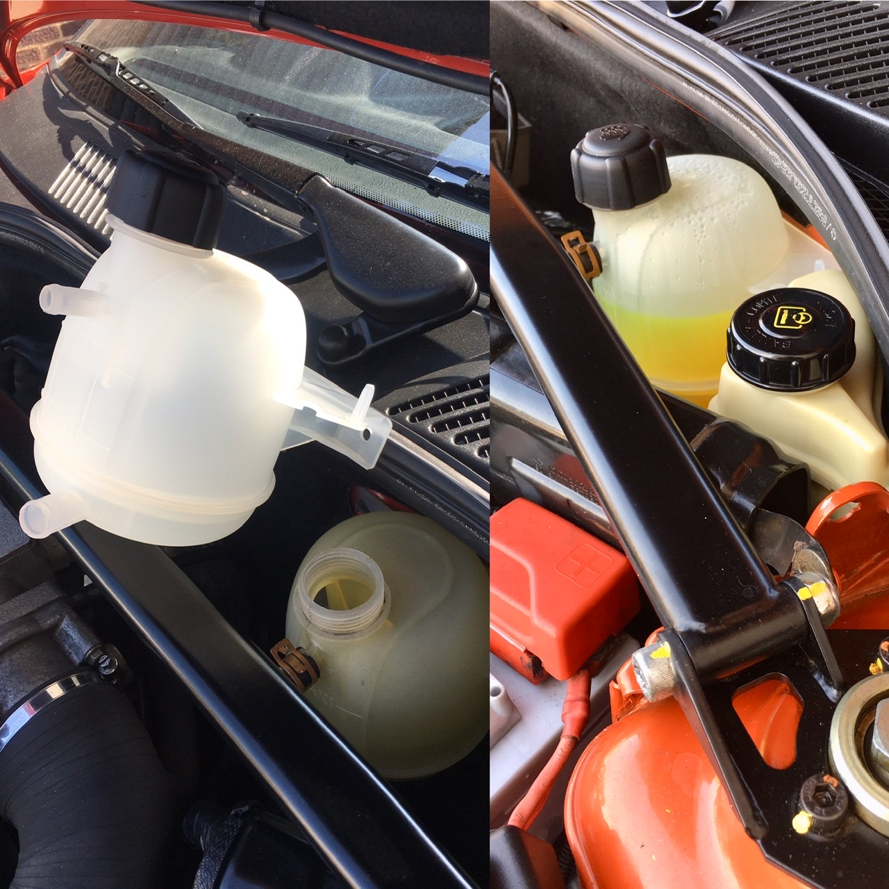

Coolant bottle finally turned up so fitted that, filled and bled the system with new Renault type D coolant.
New TCAs assembled and fitted. All hub hardware checked, double checked and marked before running it down the road to my local tyre shop to get the geometry setup. The short very slow drive there was awful, I could feel it toeing out massively and it was pulling itself from the road.
Ride heights set so the lower arms are parallel with the ground, toe out 12 min, front camber set to 2 deg negative.
Again I can’t really drive it, but the first impressions are very positive. The damping feels mega. Super compliant and the steering fast and accurate. The way the car feels on the road now is very impressive. It’s just solid planted and very positive. Bumps and undulations don’t even faze the chassis at all and there is zero tramlining or bump steer even on the fat 888s.

Came home, spanner/torque checked everything again before coating everything in a thin film of ACF50 and Dynax I’n various places.
Keen eyes will notice the absence of ABS sensors. This is because they weld themselves in and mine were no exception. So rather than fight to get them out, I’ve just ordered a new pair.

How did you do the geo on the driveway? I tried this once and found it a massive pain in the arse, but I am quite stupid.
Well it was even, but evenly miles out haha.
Where the track rod extenders drop the TCAs down, they pull the arms of the hubs in and effectively toe the car out massively.
I did the camber with a spirit level clamped to the disc and got it to within half a degree of eachother. Still crap, but drivable.
I could have been bothered I would have set it up with string, but frankly couldn’t be arsed and knew I’d be taking it straight for a geo setup.

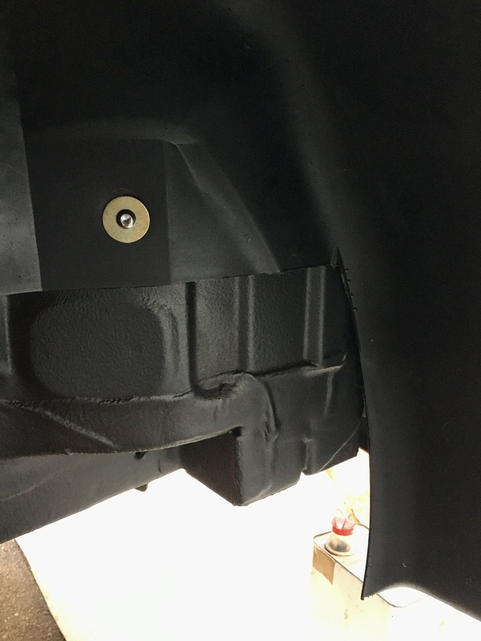

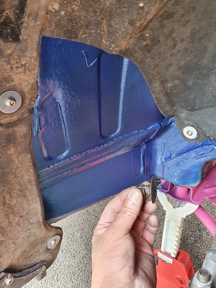

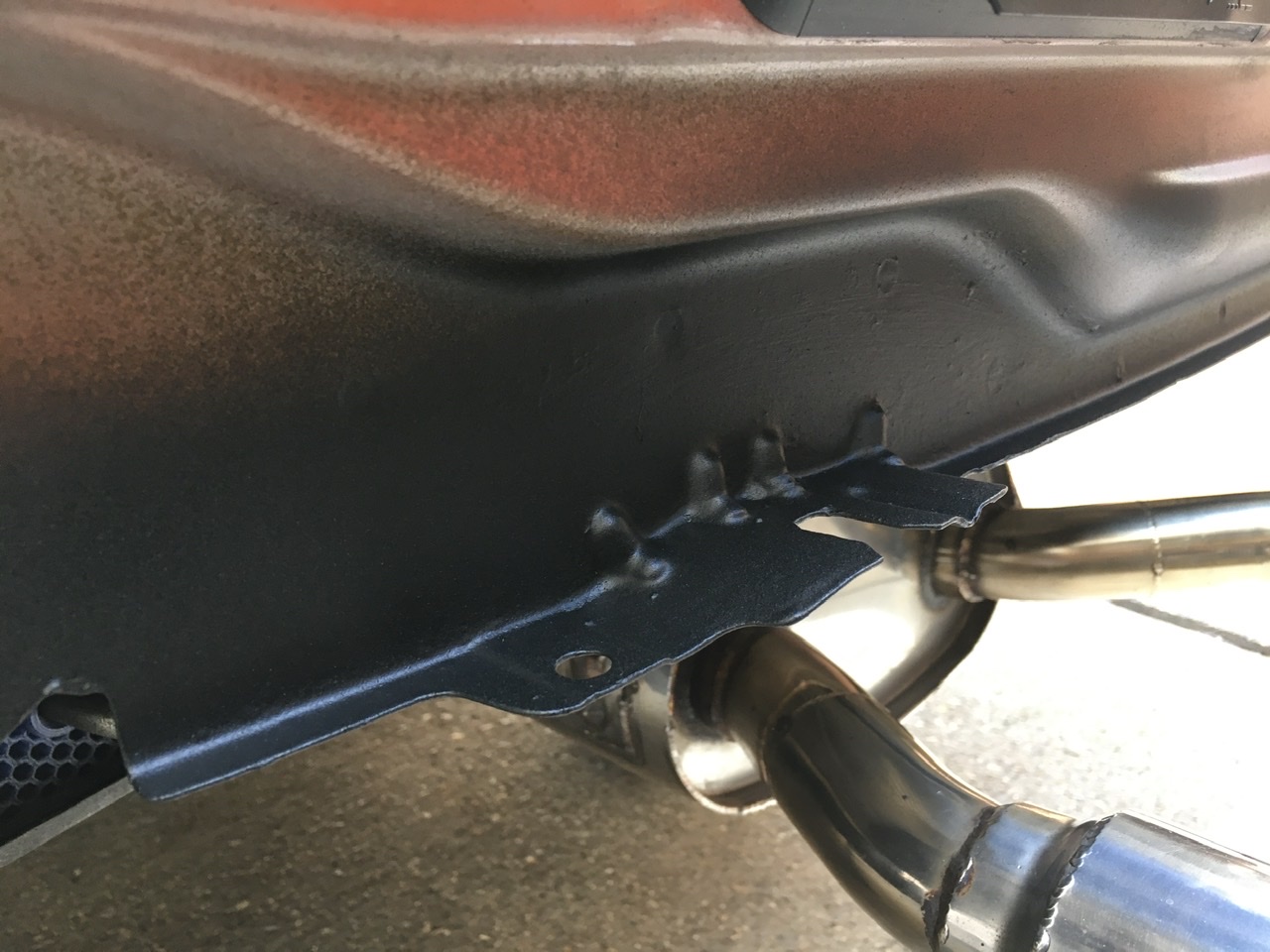

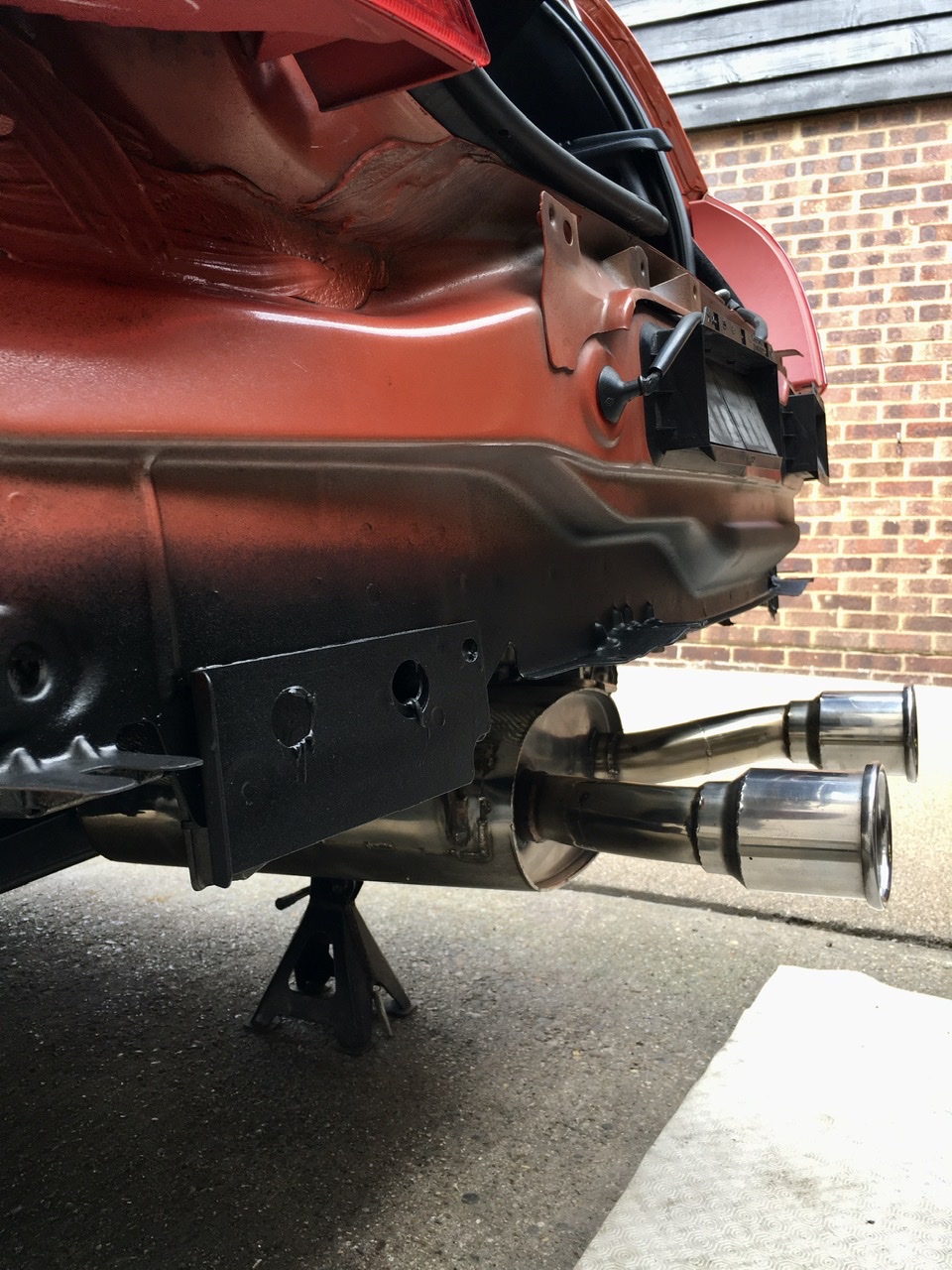

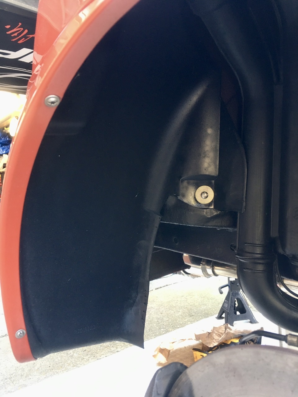

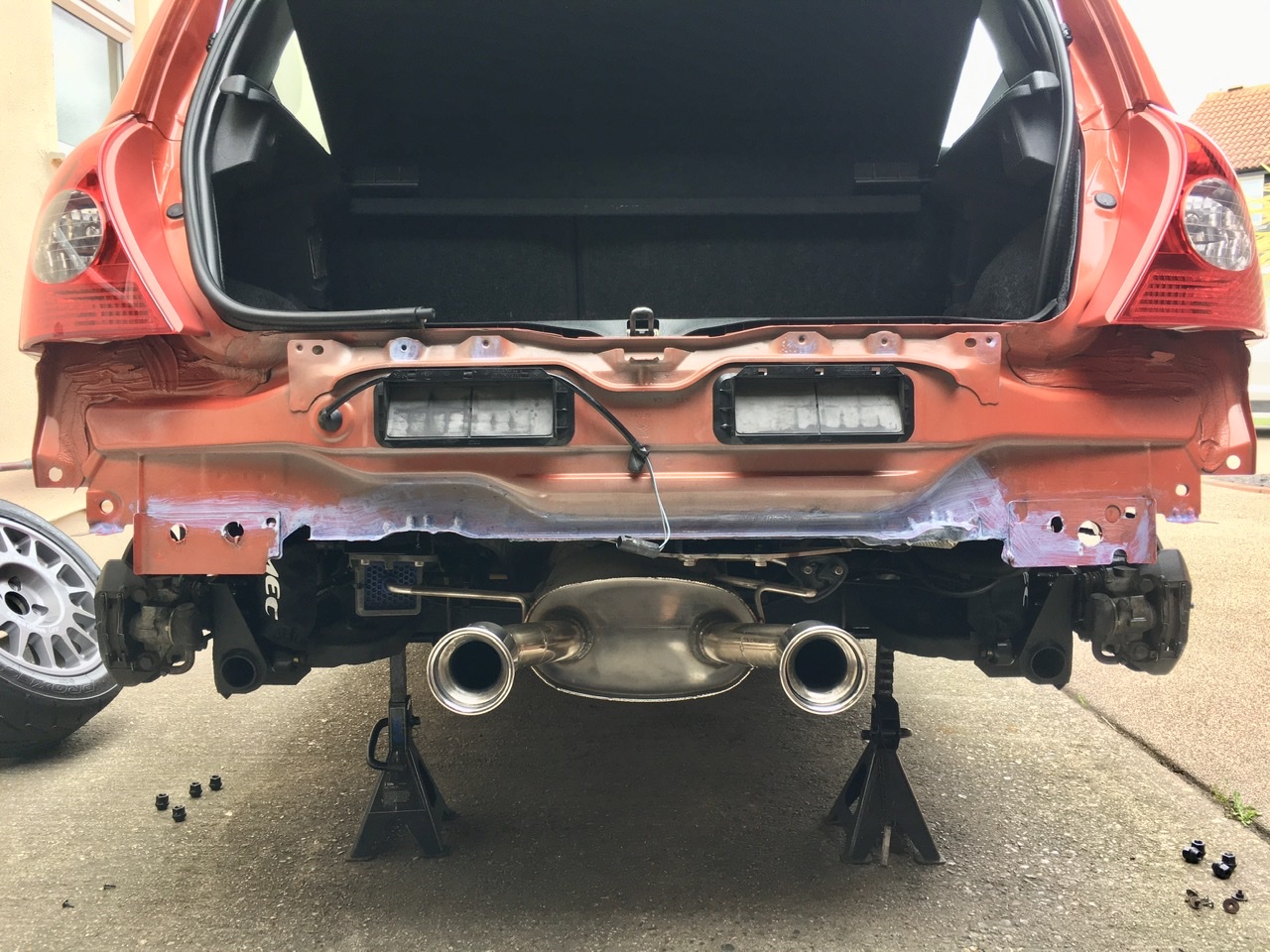

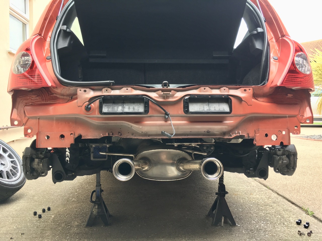

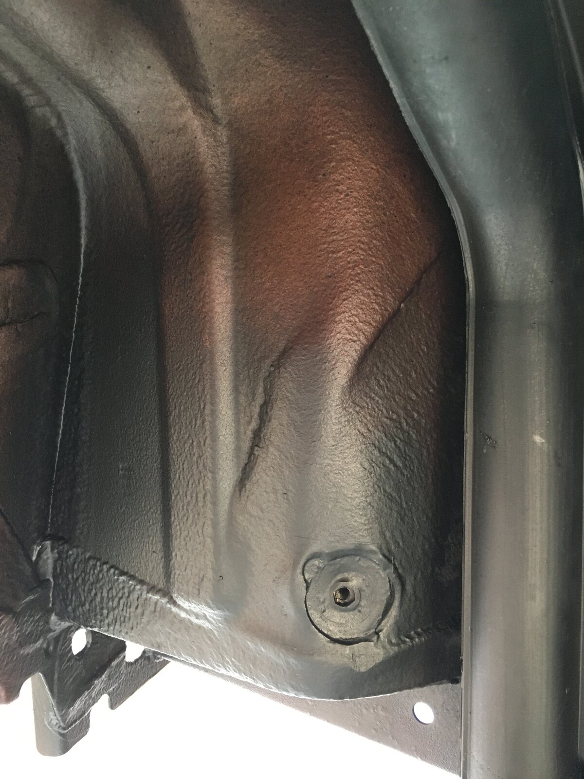

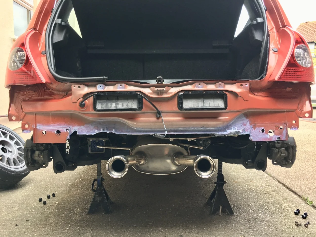

So having cleaned and protected the front panel when I did the rad, today I wanted to pop the rear bumper off and check the rear.

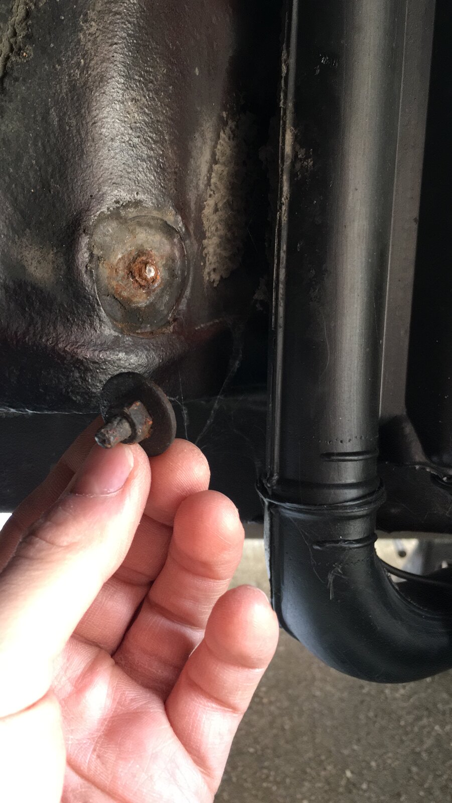

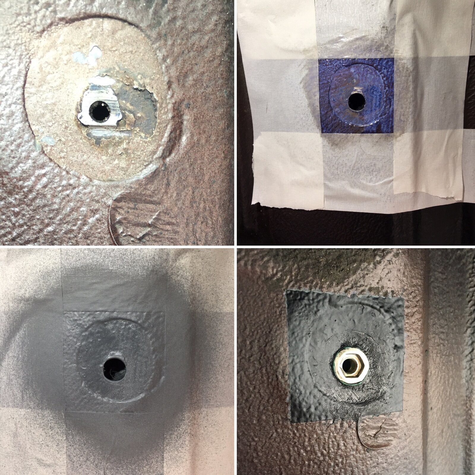

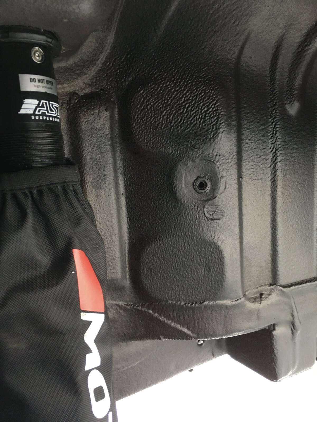

Instantly turned into a longer job than expected as both the rear arch liner fixings sheared clean off. Great!! #facepalm

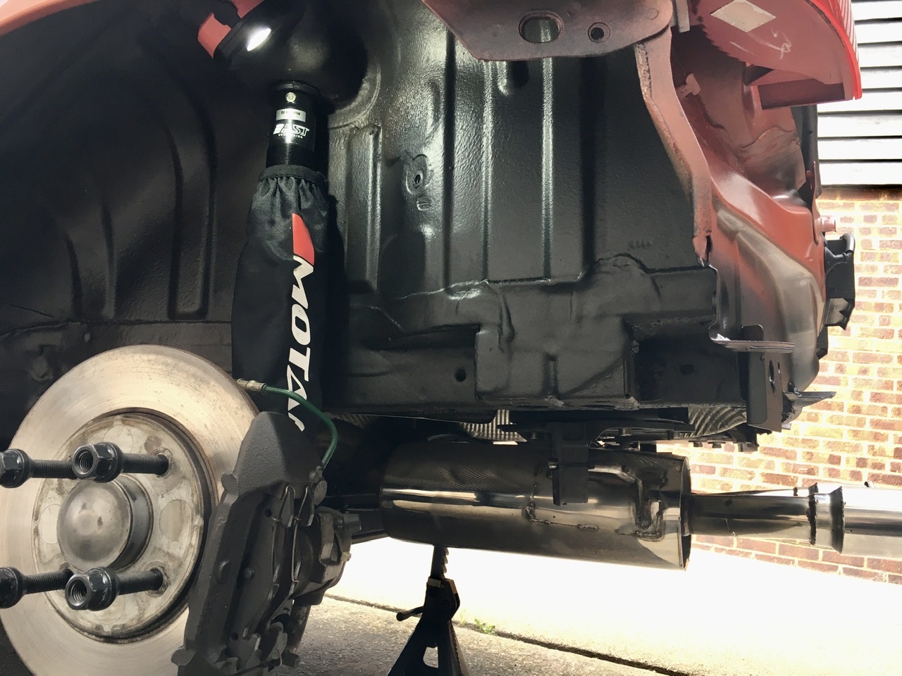

So I decided to grind them back and add some M6 RivNuts.
Drilled, Hydrate 80, Electrox, satin black and then filled the cavity with RTV before installing the inserts. This should ensure theyre as sealed and as protected as possible. Once all was dry, I coated in Dynax.

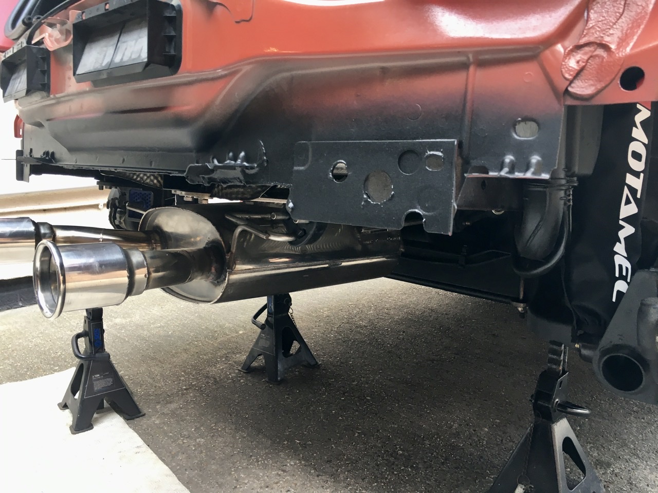

Then on to the rear panel, this was cleaned and found almost no corrosion at all. However, I decided to treat it all anyway and protect it a best i can.
Same process, clean, hydrate 80 on any suspect areas, Electrox, Satin black and finished with Dynax. Arch liners and bumper brackets were cleaned and dressed with Carpro Perl 4:1 before refitting with fresh hardware.
As you can see, shes no show pony but hopefully should protect this vulnerable area for years to come.

Hadn’t thought about converting the front, it was just the first thing I thought of when the rear ones snapped. The plastic for trees are pennies and I’ve a load of them, so I’ll continue with those at the mo. 👍🏼

Yea i know they're pennies but i was fitting it all back up yesterday and improvised/improved.. Makes life easier to take off again and cleaning the crap out of the sills in the future.

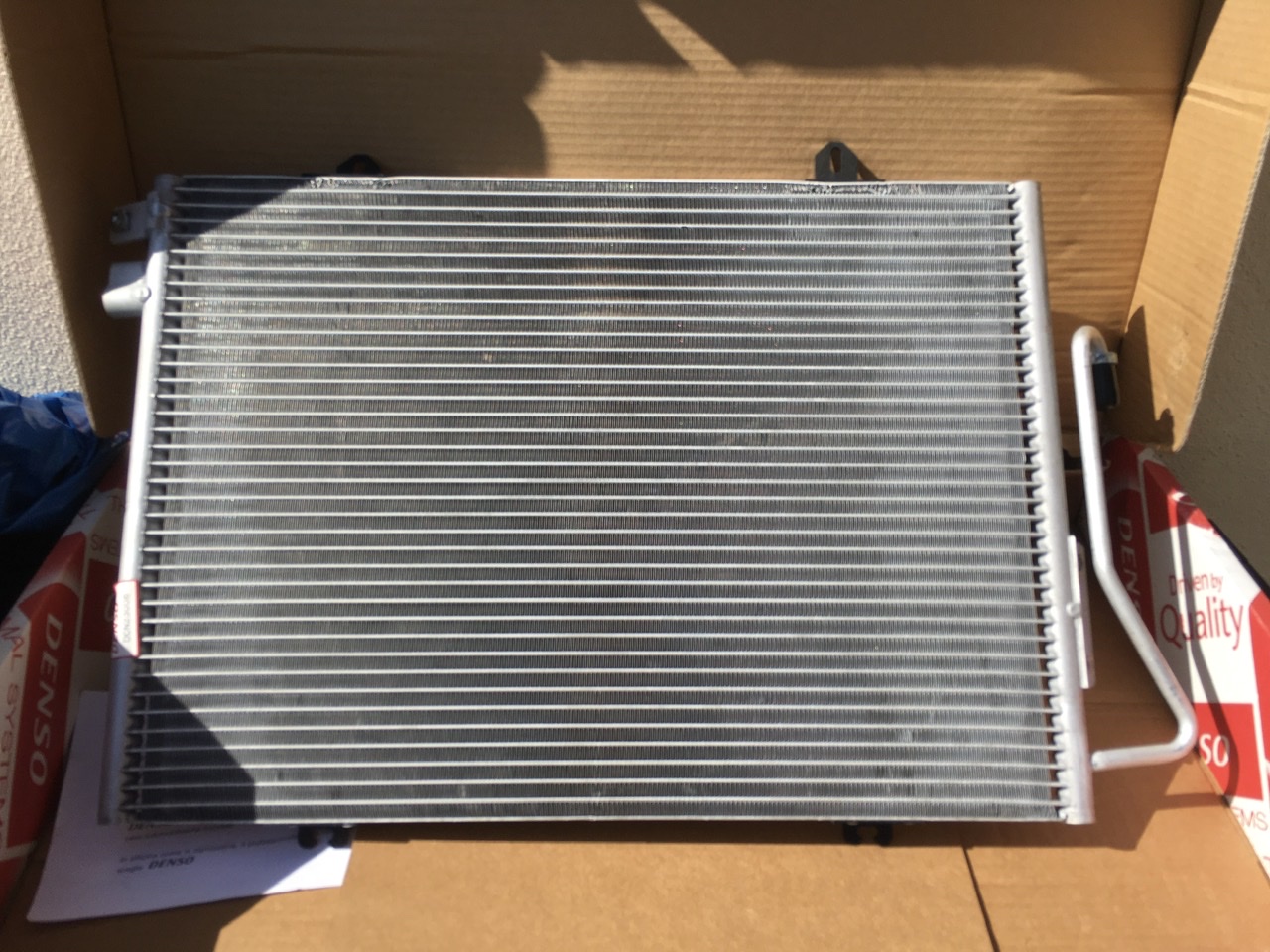

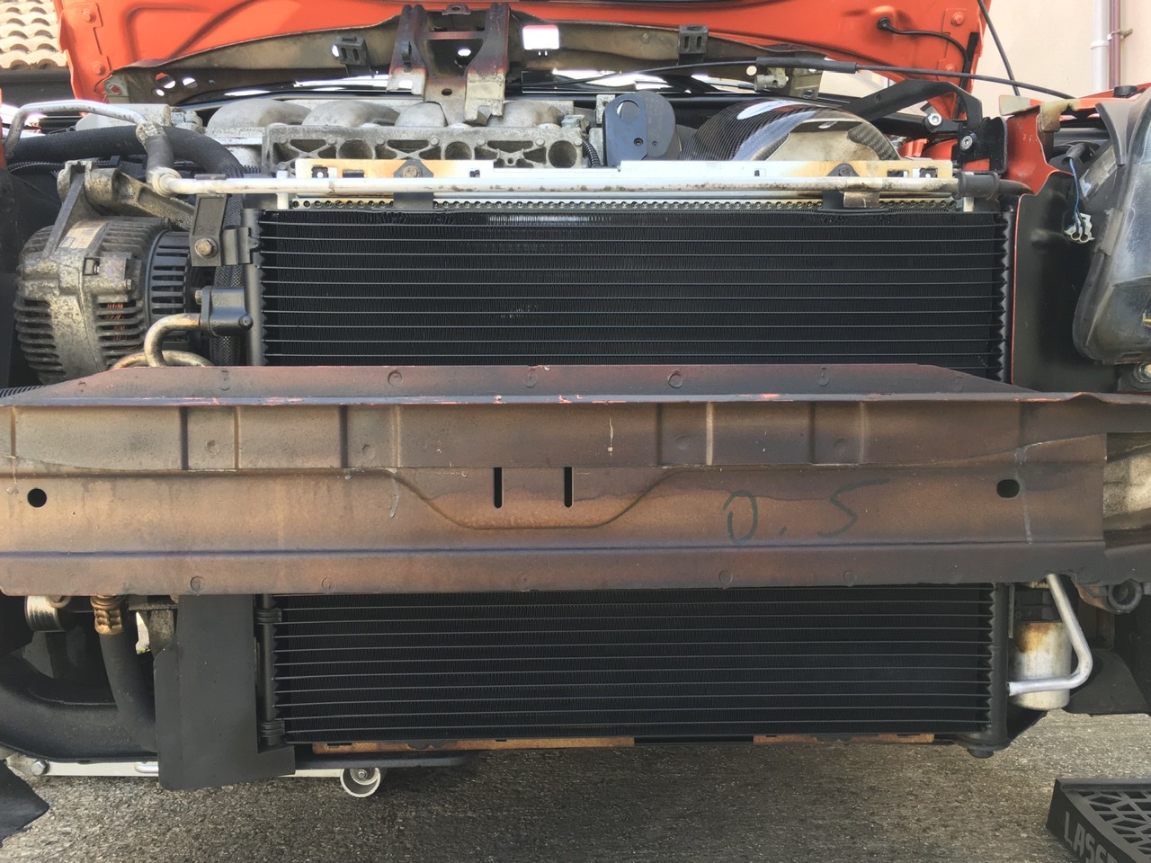

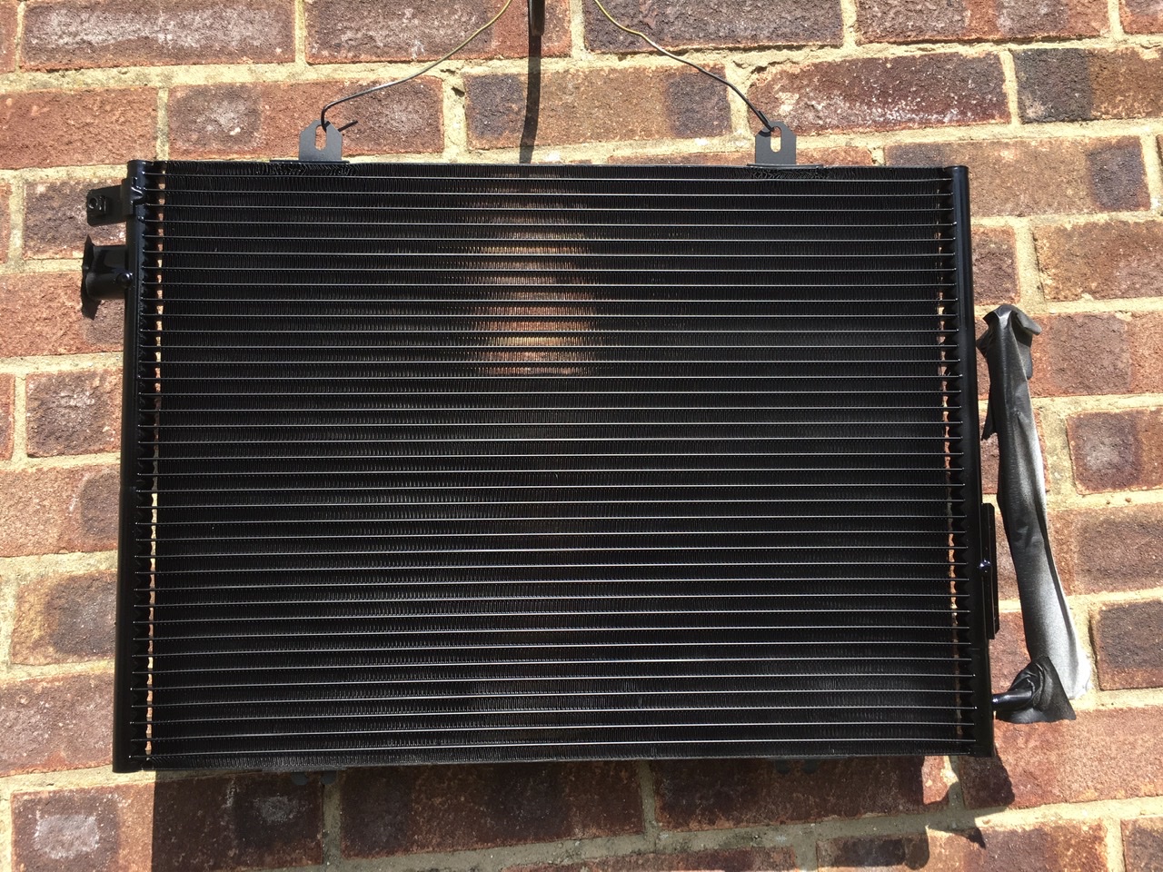

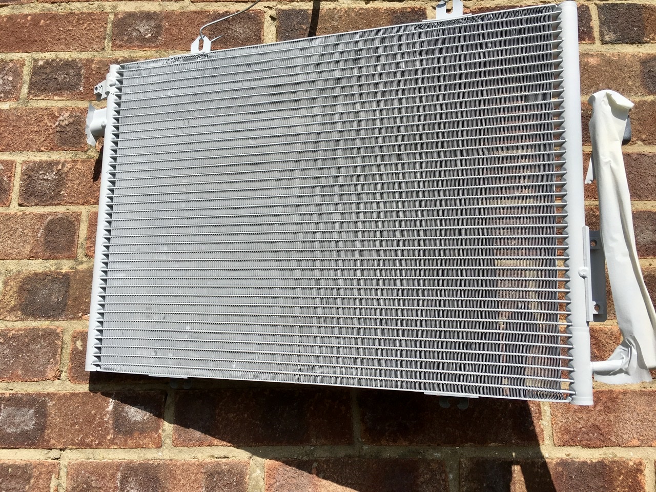

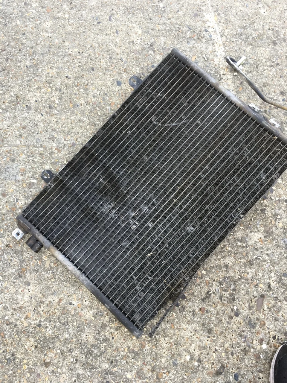

You may remember when I replaced the radiator I found the AC condenser to be rotted through at the bottom.
So I ordered a new one, which arrived today, unfortunately our friends at FedEx decided to damage for me by bending the top row of fins by bending the brackets.
The distributor was superb about it and offered me another item or this one at a hugely discounted price. As I don’t want a bright silver cooler behind the grille, I had always planned to paint the new one matte black anyway. So the damage won’t be seen once installed.
So a quick dust of zinc etch primer and some matte black later, it’s ready to go in.

Good idea to paint it black!
And I like the idea about the rivnuts in the back, never heard of them!

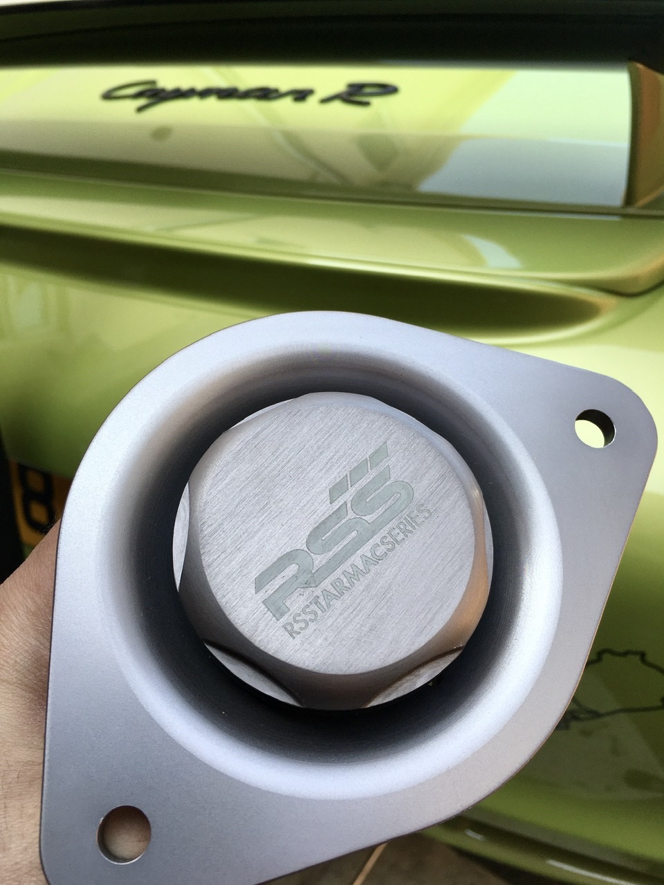

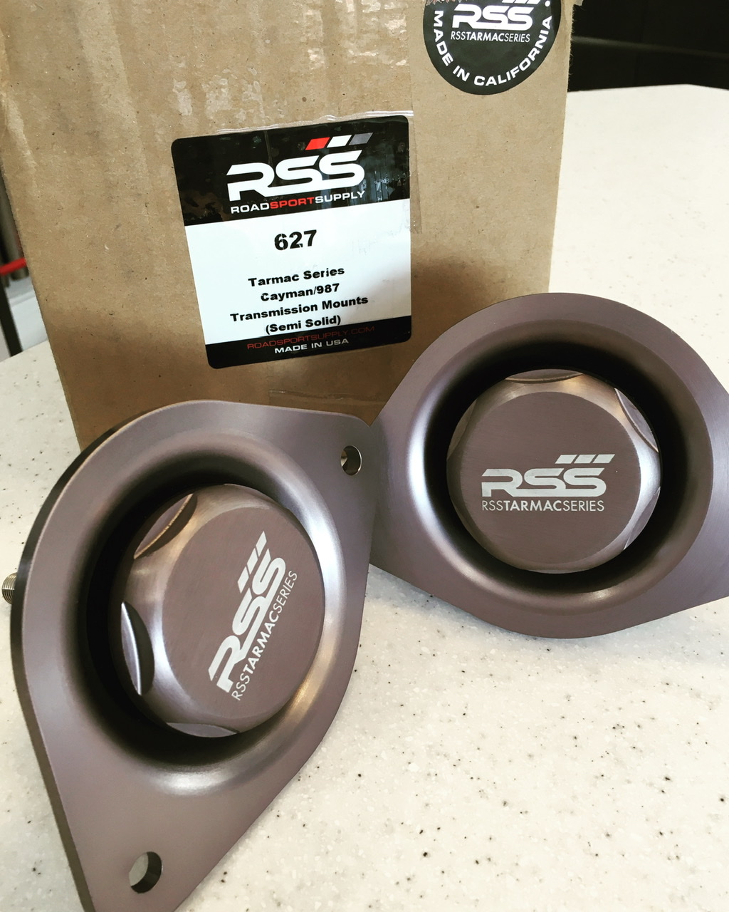

Excitement during lockdown got the better of me to fitted these up to the Cayman today. RRS semi solid transmission mounts.
For obvious reasons I’ve only driven around the block to check for unwanted noises. However instantly the car and transmission feels better connected. Theres absolutely zero additional NVH at idle or during driving but you feel the chassis and transmission respond more eagerly to throttle inputs and the whole car feels surprisingly tighter.
I’ll probably add the yellow Function First inserts to the engine mount too. I have the black ones here but think they will be too harsh for road use.
Just need to get out and have a drive now. smile
