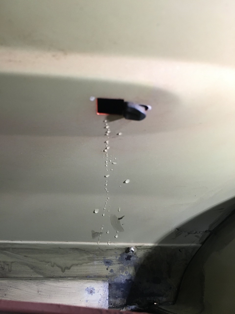

Interesting find this morning as it rained overnight. I found there to be water droplets from the side moldings on the drivers side and nothing on the passenger side?
Coincidence?
frayz
Come to think of it. Would it be ridiculous to think because there is more rain water in the dip in the road on the passenger side, that when we travel along, the water entering the sill sections washes more of the mud build up out and helps keep the tiny drain hole clear, therefore less crude build up to rot inside the pass side.. I love a conspiracy theory..
Sent from my SM-G977B using Tapatalk
Both my drains were and always have been clear 🤷🏽‍♂️

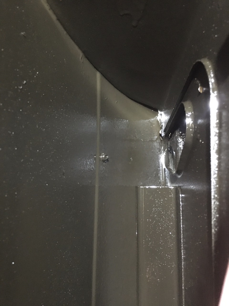

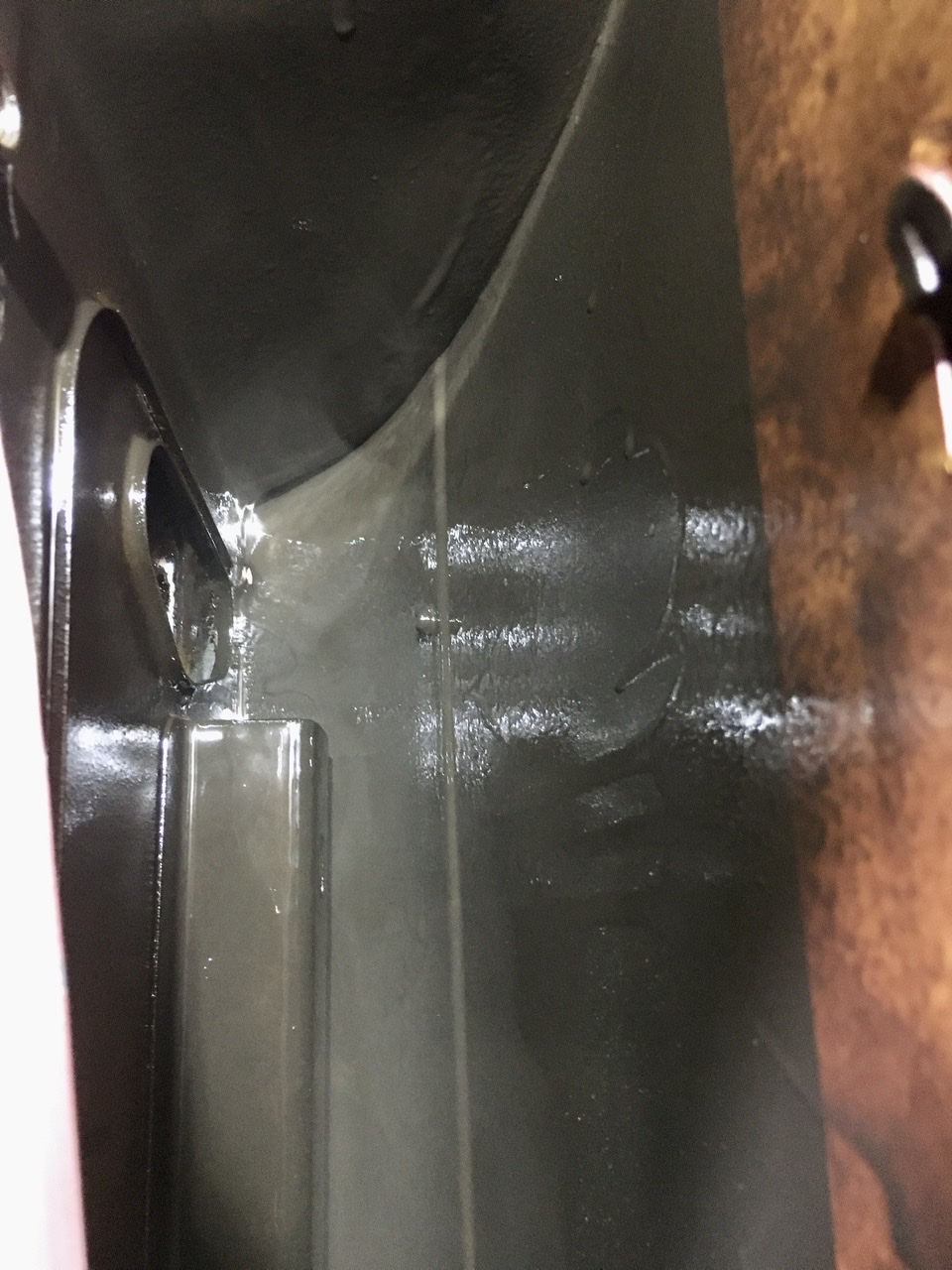

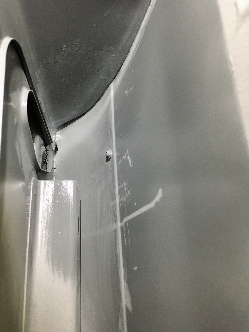

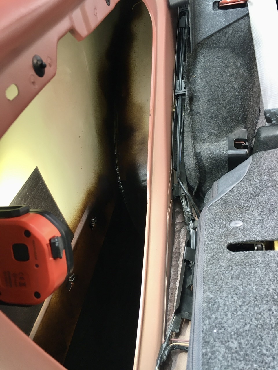

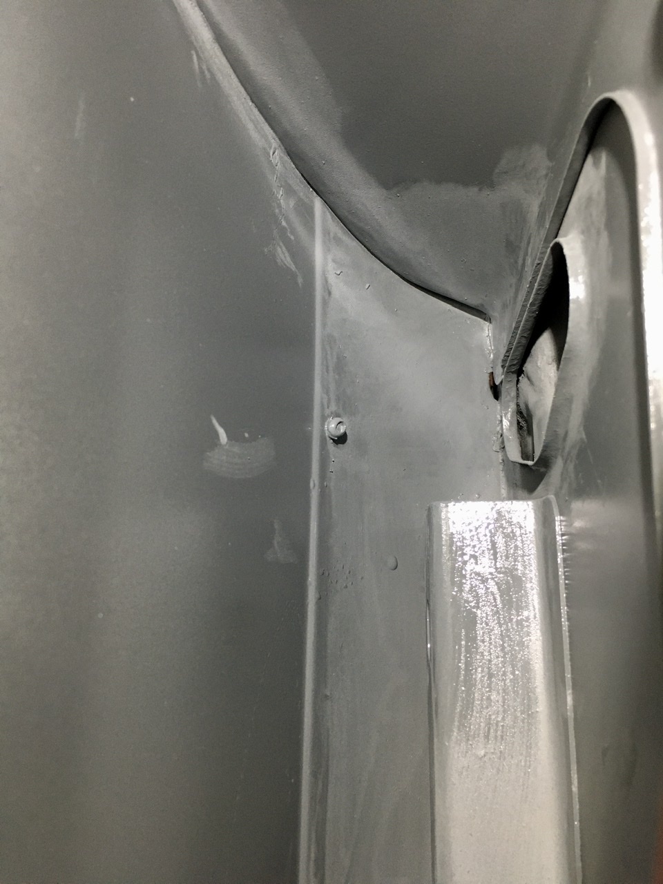

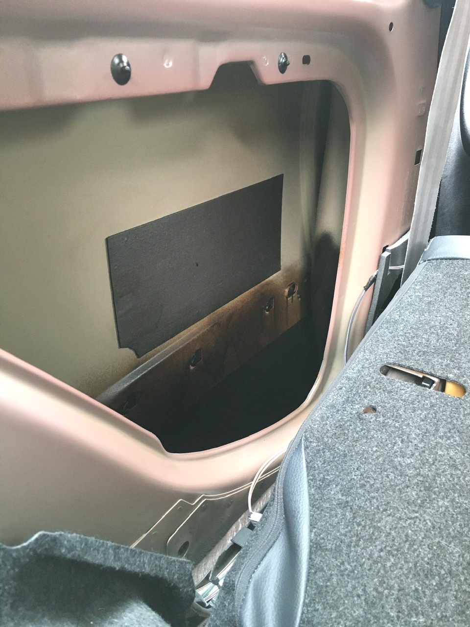

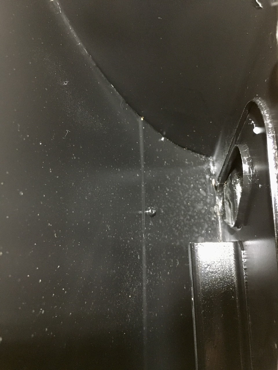

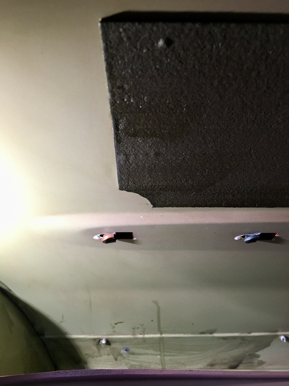

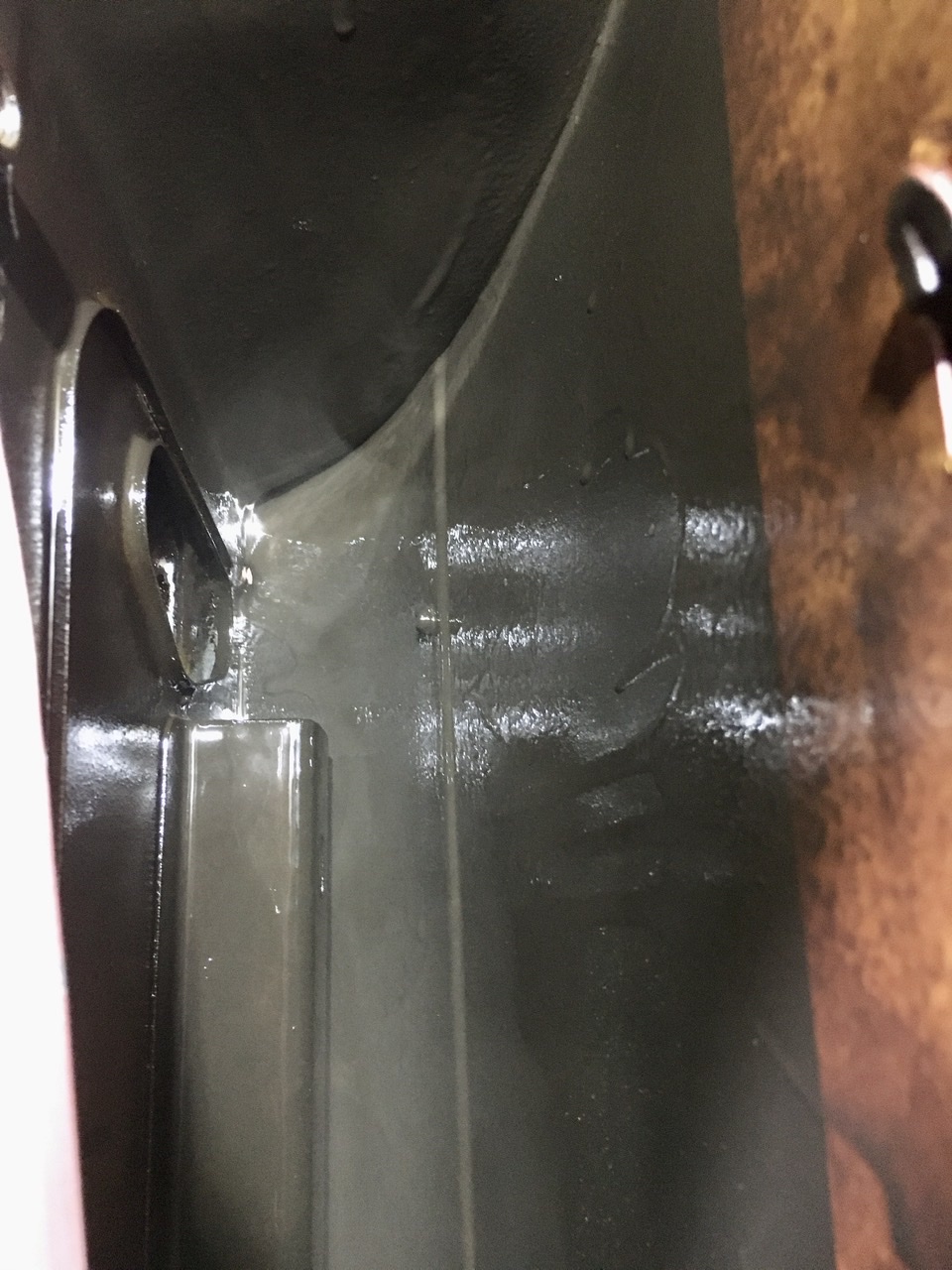

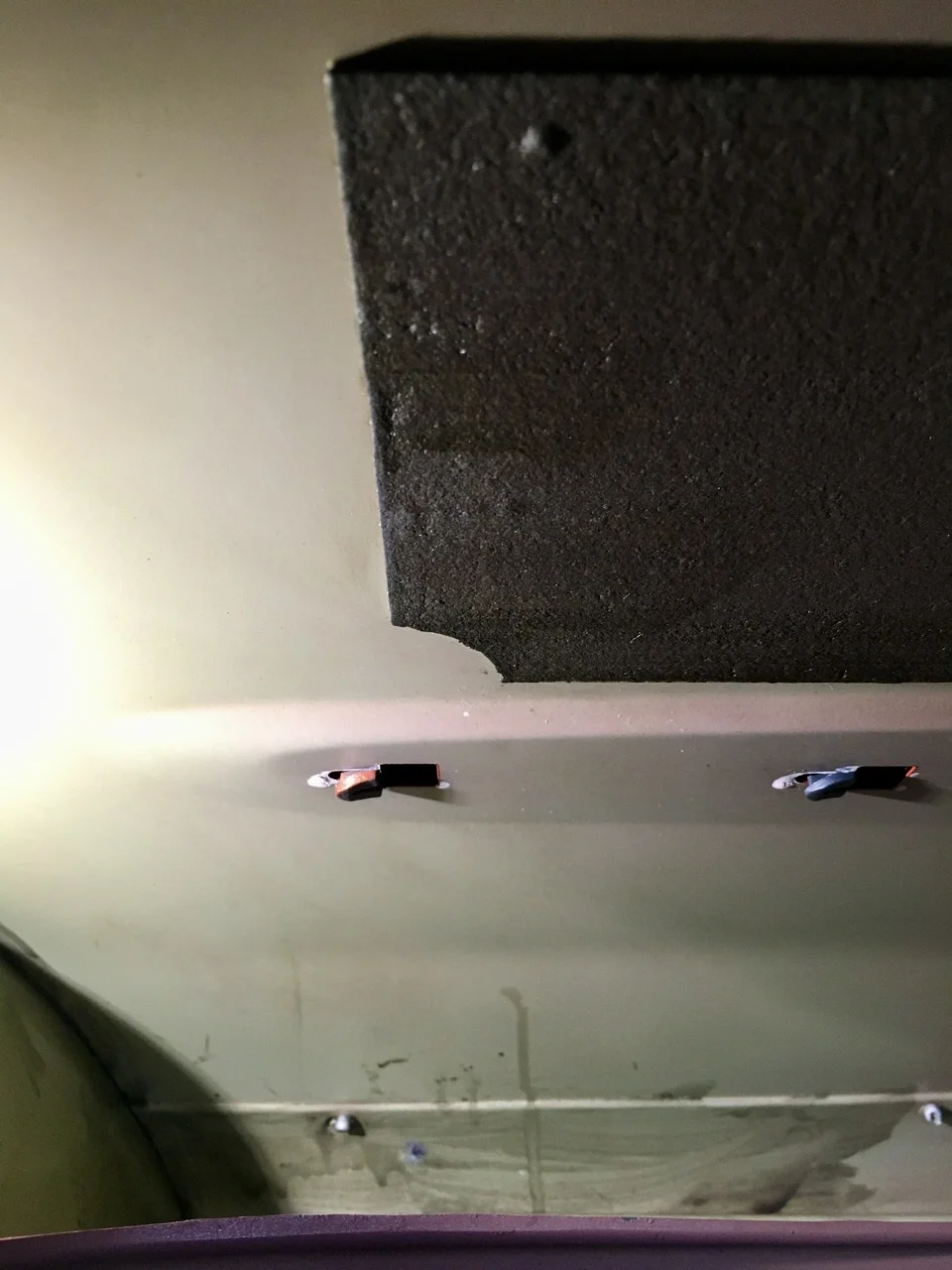

Got the inners sills in satin black and then lots and lots of Dynax UB.
These come with a longer tube nozzle which means you can get it right around the arches and hard to reach areas.
I also Dynax’d from the door moldings down, so if moisture does indeed come in those areas then it’s all protected.
View attachment 1470257View attachment 1470258View attachment 1470259View attachment 1470260View attachment 1470261
Real nice job there buddy.. I treated mine with Hammerite rust restorer and blasted it with half a can of waxoyl.. It lives under a cover on the trailer when not on track so hopefully mine will stay good for a while..

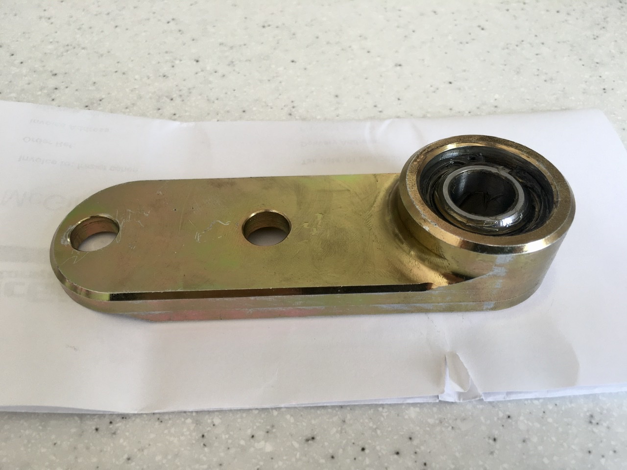

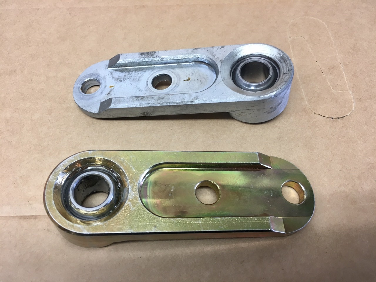

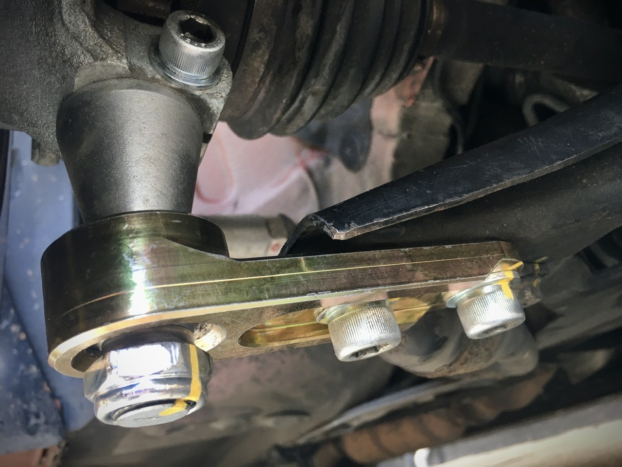

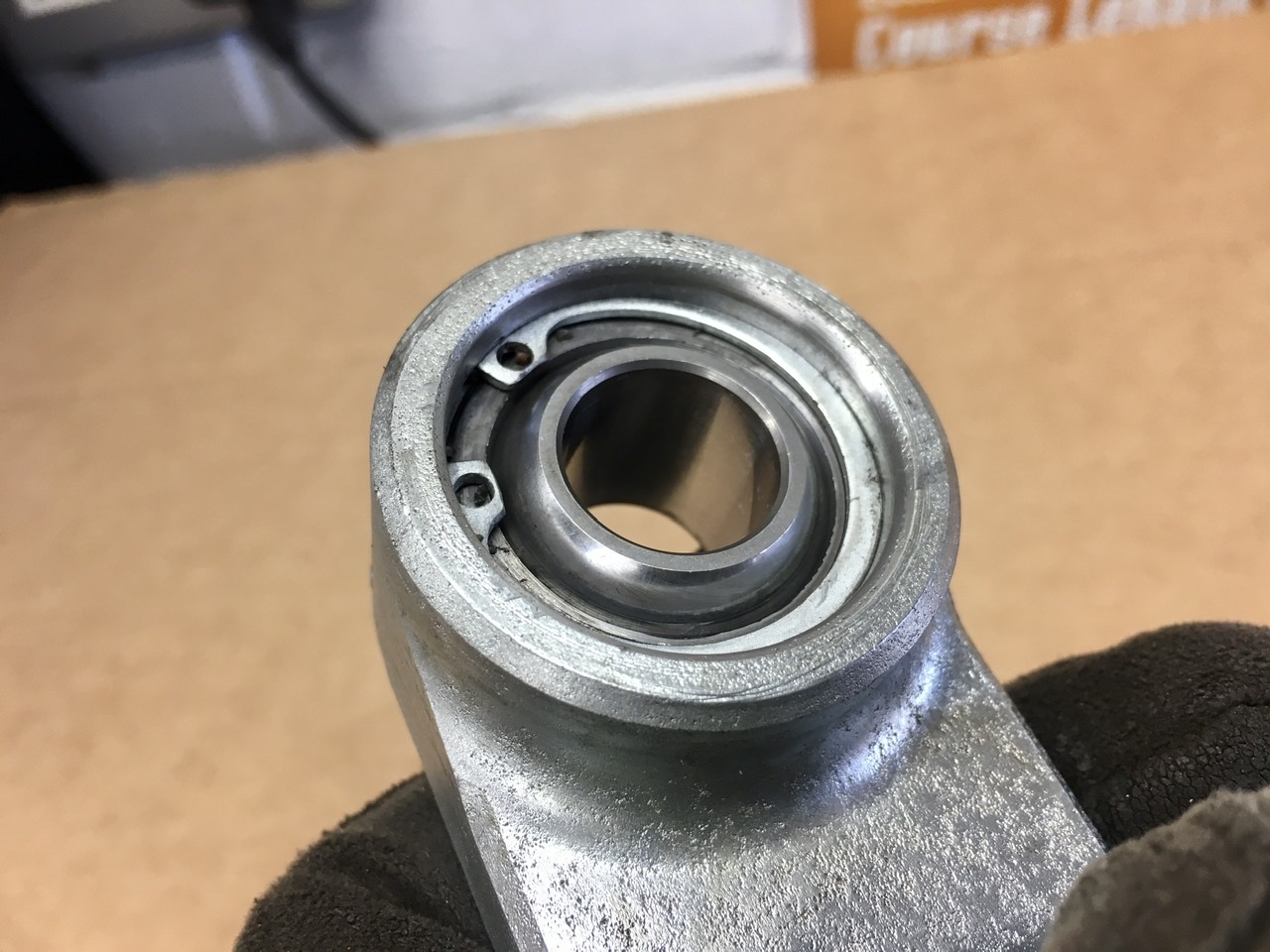

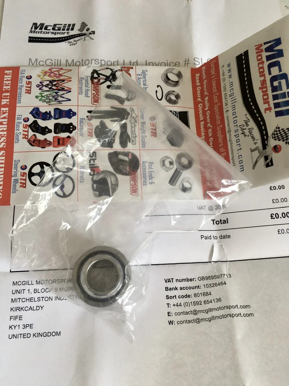

So as of last Monday I’ve been removed from furlough and sent back to work. This means I could finally get some wheel time and enjoy driving the little Clio again.

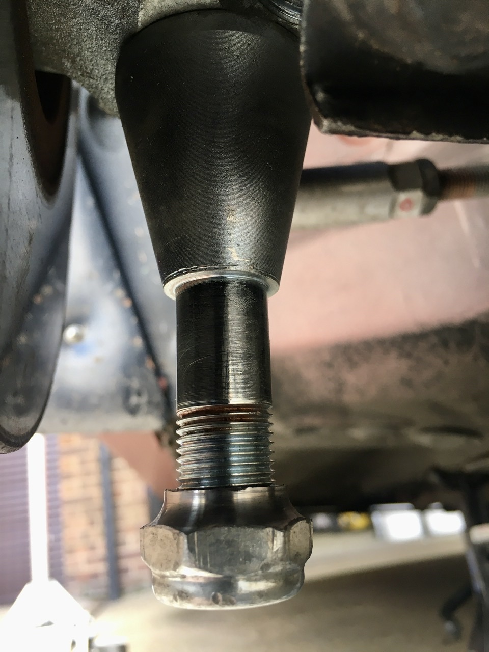

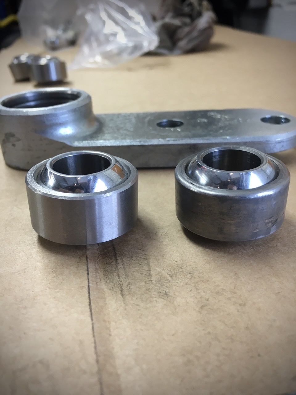

Thursday night as I pulled off the drive, and heard what I thought was a knock from the OS front. Bugger!!!
First look I could get at the car was Friday morning, and I found my issue at the first thing I suspected, the lower ball joint. Double bugger!
The bottom ball joint had a good 0.5 / 1mm of vertical play in it. These bearings were brand new from McGill Motorsport when I fitted the roll centre correction hubs only a few weeks back. Unable to get access to a press at work during the lockdown, they were pressed in by a local machine shop. Knowing they’re an interference fit i assumed, although unlikely, that the play was the ball in the outer race and had worn prematurely.
I sent McGill an email with a video and details of my issue of which they responded right away and got me a replacement bearing sent out FOC. Excellent.
They also asked me to return the faulty item which I was happy to once removed so they could inspect it and discuss with their supplier as to why it may have failed in less than 200 road miles.
I also didn’t want to rule out the bearing carrier having a possible tolerance issue or being out of round. So called Alan at Bridgecraft Motorsport who machined the parts originally, and bought a new bearing and carrier. I asked him to send it on a next day delivery so I could be sure to get the car fixed today. Again, excellent customer service from them.
So this morning I removed the faulty bearing and carrier. The bearing bore is a slight interference fit on the hub extender so used a small two legged puller to remove it. Happy to see it came off without issue. No reason for it not to be, but also pleased to see the hub extender was mint with no material pick up from the bearing.
My OCD was having issues with the new bearing carrier being a yellow zinc finish and my other parts are a silver zinc, but i coped admirably and fitted you the new carrier, torqued up and am delighted to say the knocking as gone.
On inspection I couldn’t see any obvious issue with the previous bearing or carrier but removed the circlip in preparation to press the faulty bearing out on Monday.
To my amazement the bearing slid straight out with very little hand pressure. Then to my amazement and annoyance, I saw the old bearing had what appear to be sanding marks on the outside of the outer race. It would appear these have been linished down to fit in the housings rather than pressed in as they should have been. FFS!!
I haven’t gone back to the machine shop as frankly I can’t be bothered with the conversation over a bearing.
So, great that the knocking has gone, and pleased there is no play in the NS bearing. But I’ll be calling McGill first thing Monday morning to explain my embarrassment in what I found, and pay for the replacement item they sent me FOC. Clearly this is not a issue with their part.

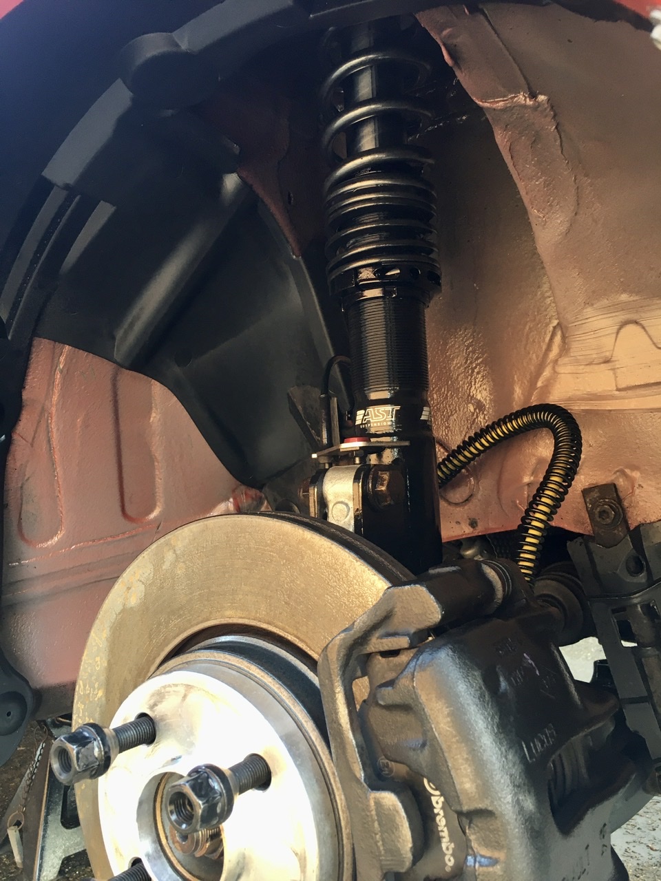

Anyway, tonight I set myself the task of finding and fixing this damn creek. Now apart from the ARB bushes (to be done soon). Every single Bush, bearing, mount and balljoint on the car is brand new since last July.
I had the car up and wheels both in compression and droop through all the ranges of motion yet couldn’t replicate the noise without the suspension loaded under the vehicles weight.
Then I had a random thought about the coilover covers and gave them a twist by hand. Just check out this noise of the damper cover creeking on the springs Powdercoating when the steering is applied. It was obviously caught up top by the topmount and the damper was rotating in the cover.
Covers off washed, dampers checked over and spanner checked. Coated in ACF50 and covers refitted. Back on the floor I’m a happy boy again as she’s silent.

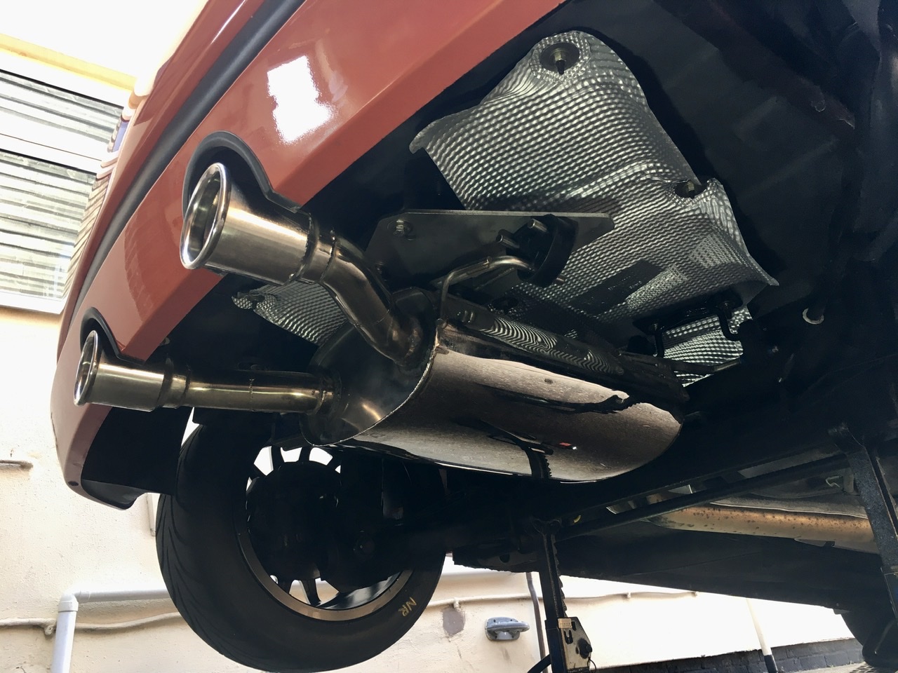

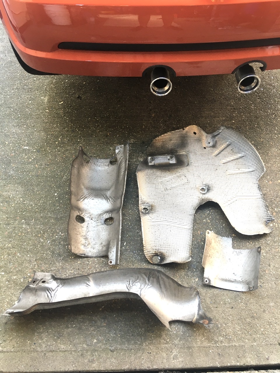

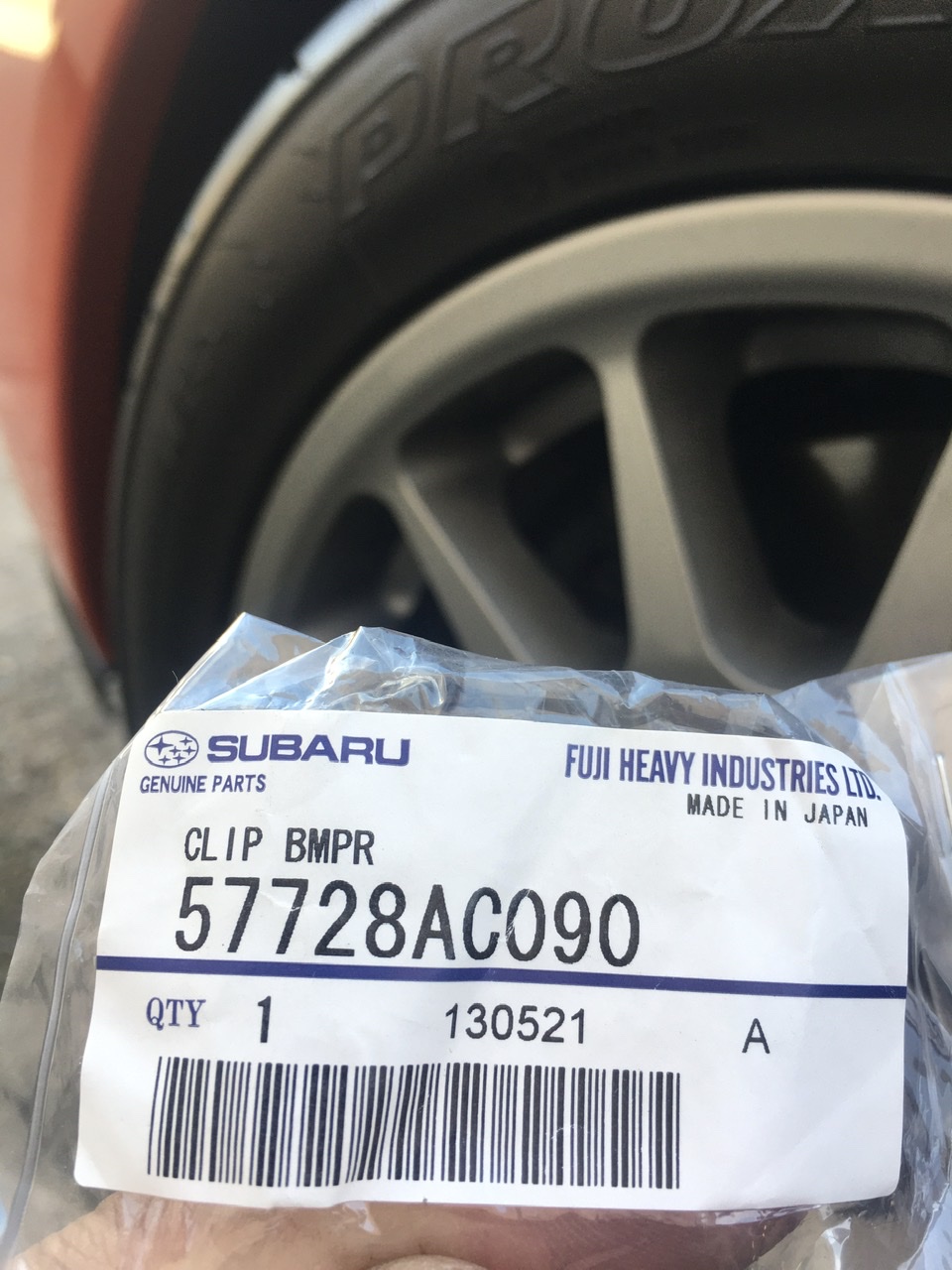

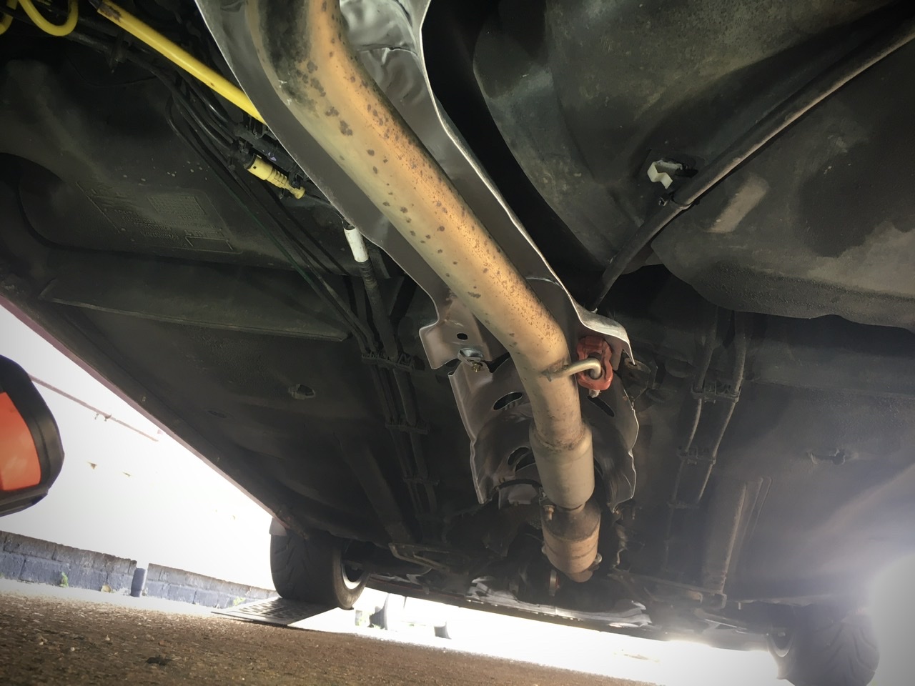

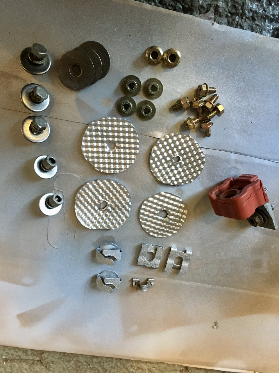

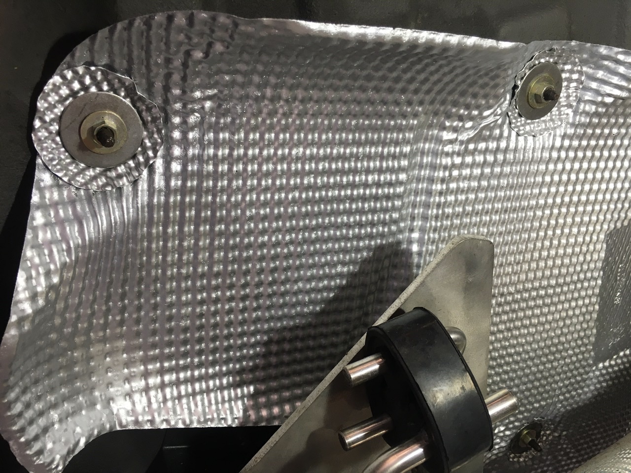

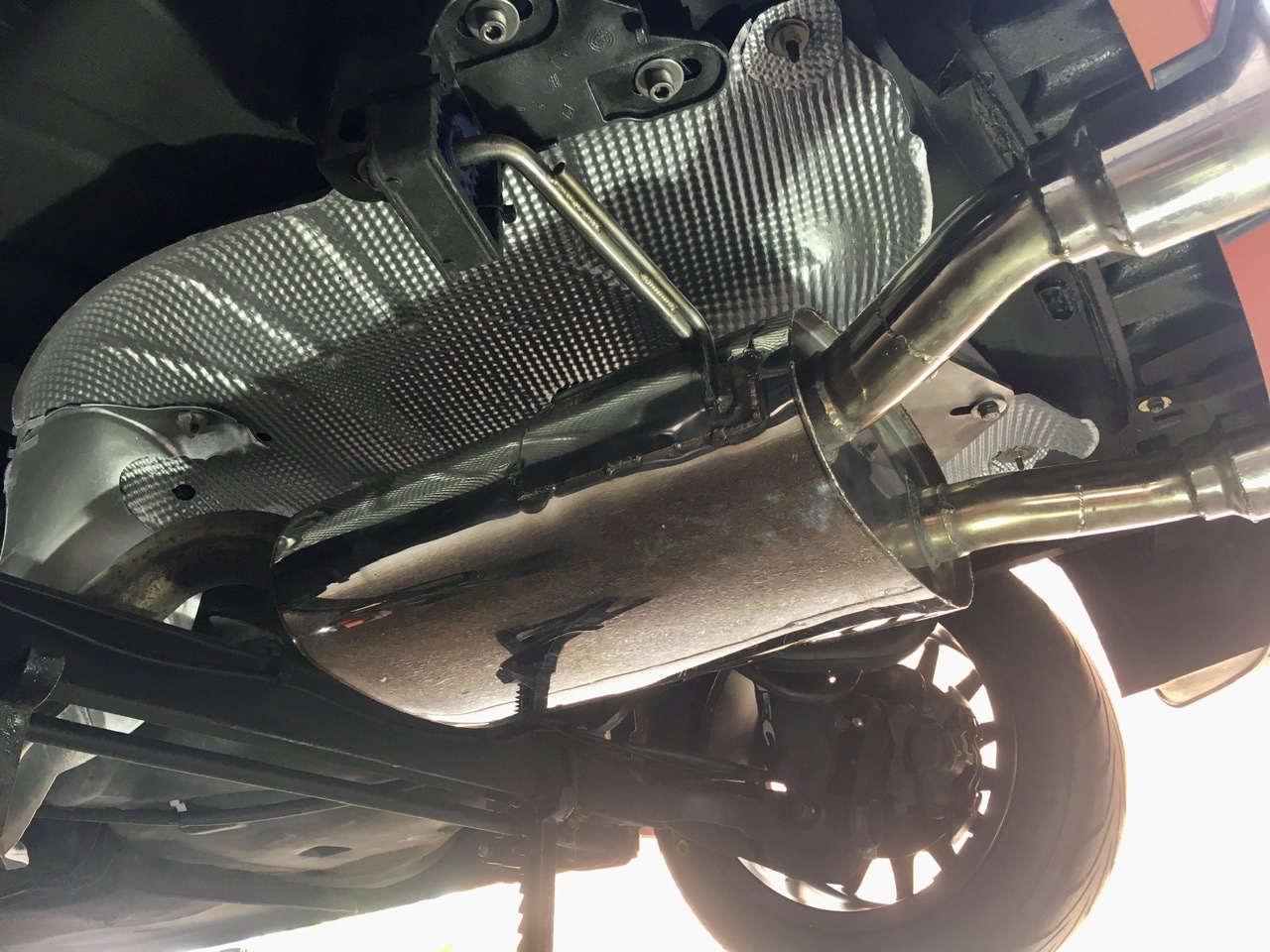

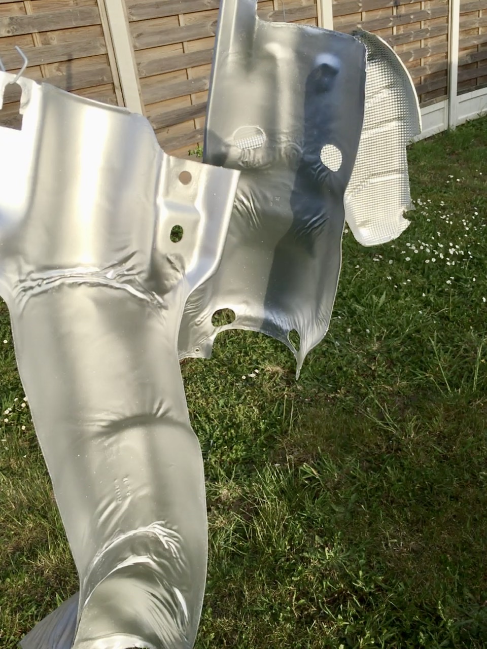

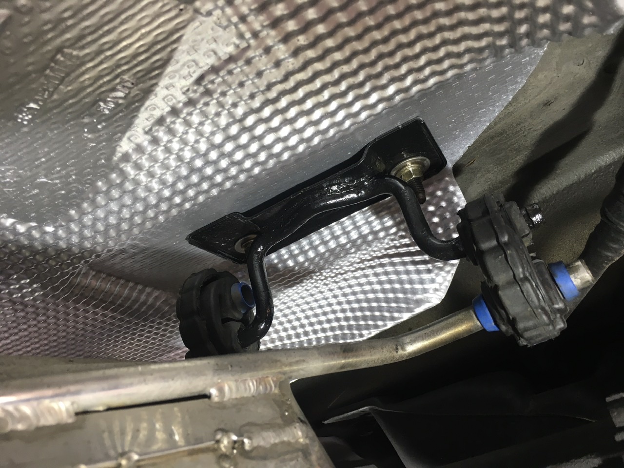

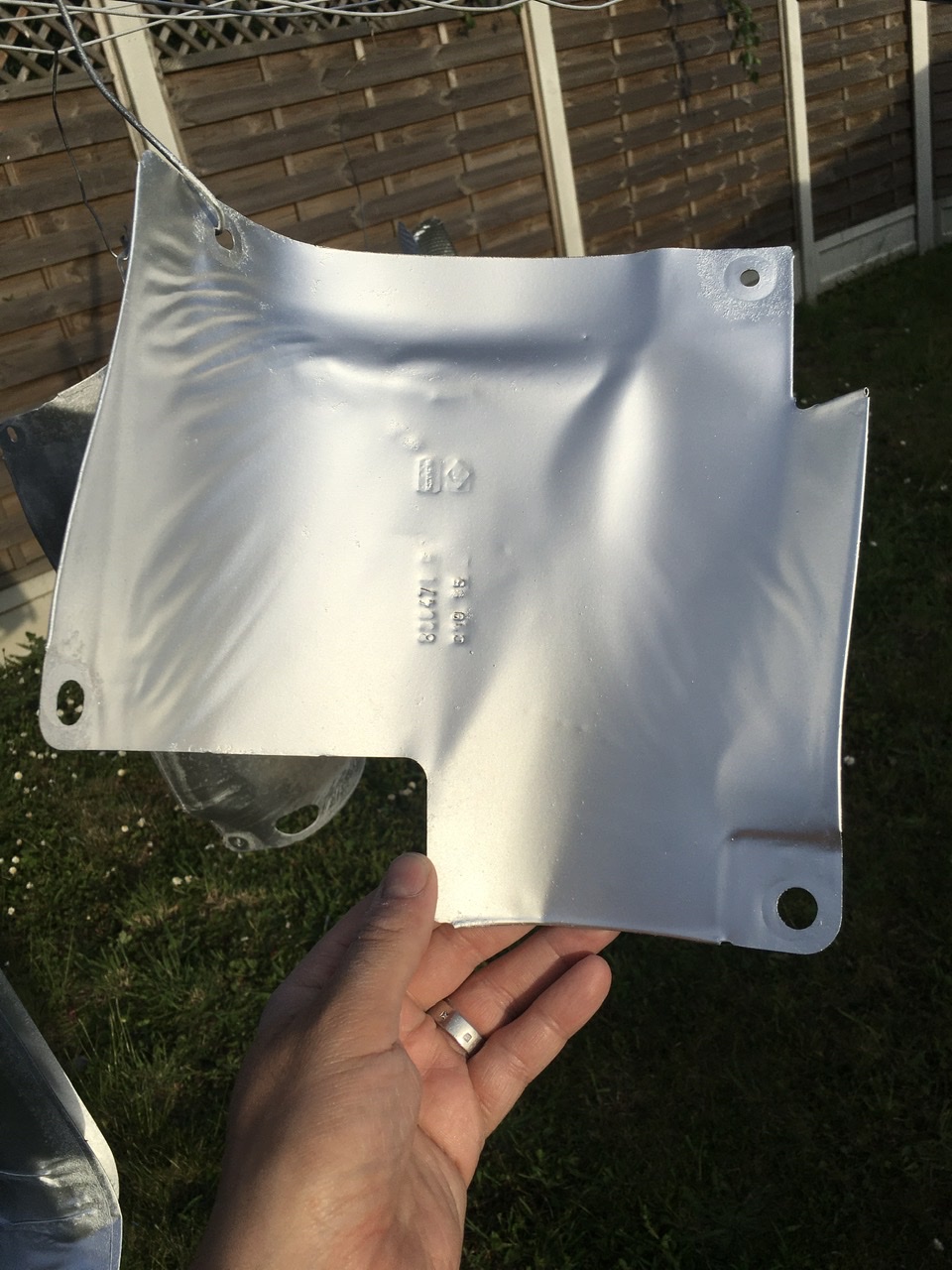

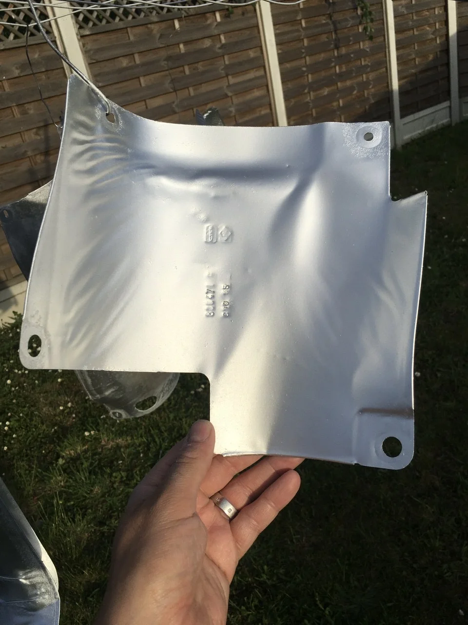

Latest tinker has been giving the heat shields a jolly up.
Nothing fancy, just removed, scrubbed with degreaser, 2 coats of Zinc primer and then 2 coats of VHT silver. I made up some large load spreaders with some spare Nimbus sheet and refitted with new hardware. Far from show standard but a bit fresher than it was.
Cleaned the 3rd exhaust bracket and painted that in gloss black too. Again refitted with new hardware

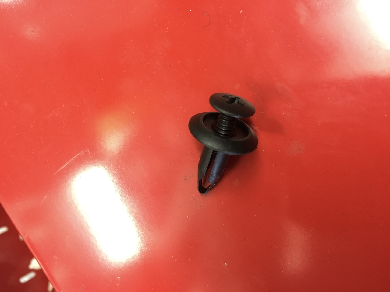

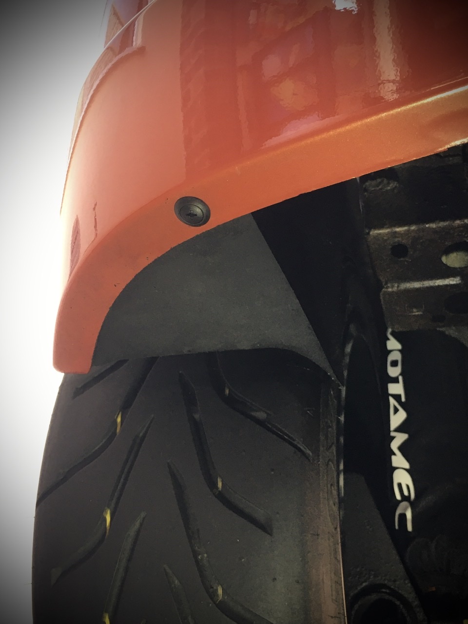

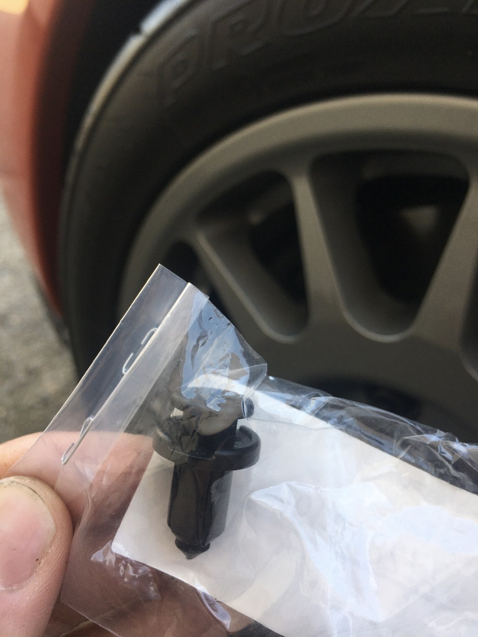

Also added some large trim clips to the bumper corners as I no longer use those mounts running R888s with the wider track and low tide height.
Then had the idea of adding some 6mm trim clips to the rear bumper/arch liners. It always annoyed me that they flapped about but now they provide so much more structure to the rear bumper and look totally OEM.
Subaru spares coming in good use.

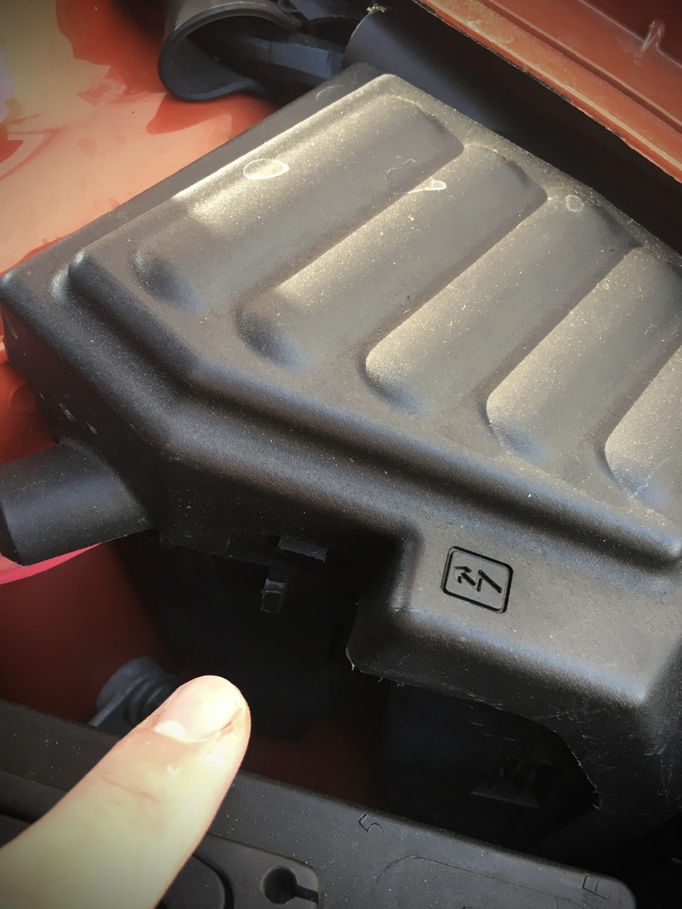

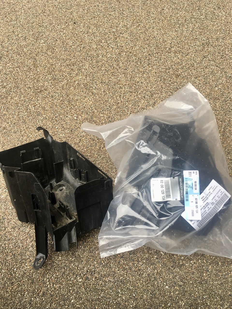

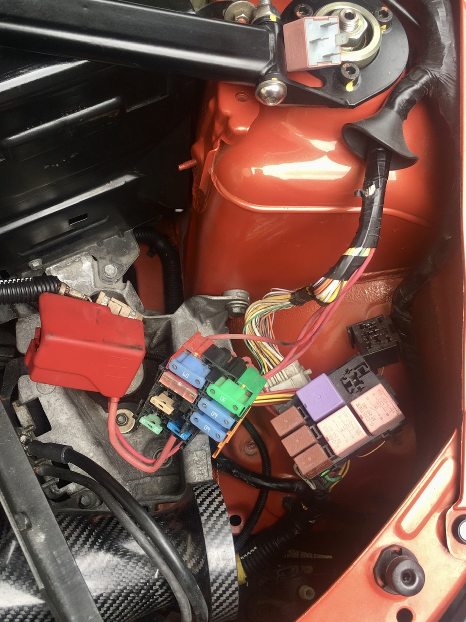

Small but satisfying job today. When I originally owned the car I was always careful around the delicate and rather fragile fuse box clip.
These were fragile at the best of times, and sure enough, when I bought the car back, this had been broken off.
I’d been meaning to replace the fuse box for a while but for reasons even I don’t know, I hadn’t done it.

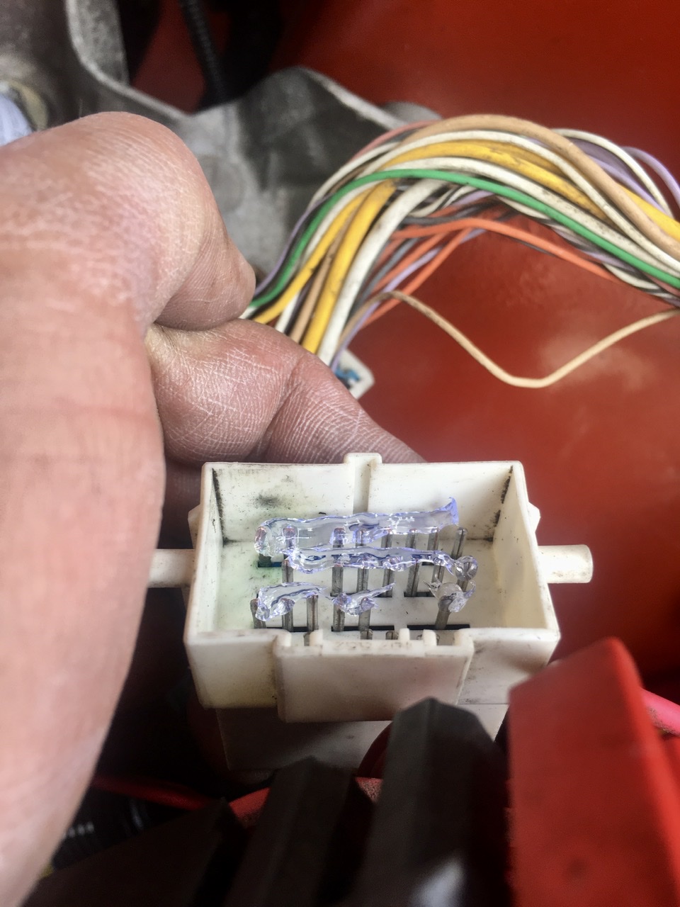

Happy to say these are available brand new from Renault for only £23.23. So today I set about changing this over. I took the opportunity to clean the bodywork behind the fusebox and fabric tape some of the harness where the protection had worn.
I also took apart all the plugs and relays to give the contacts a Fibreglass brush and Refit with contact grease to keep any moisture at bay.
As said, a silly small job but satisfying knowing it’s new and no longer broken.

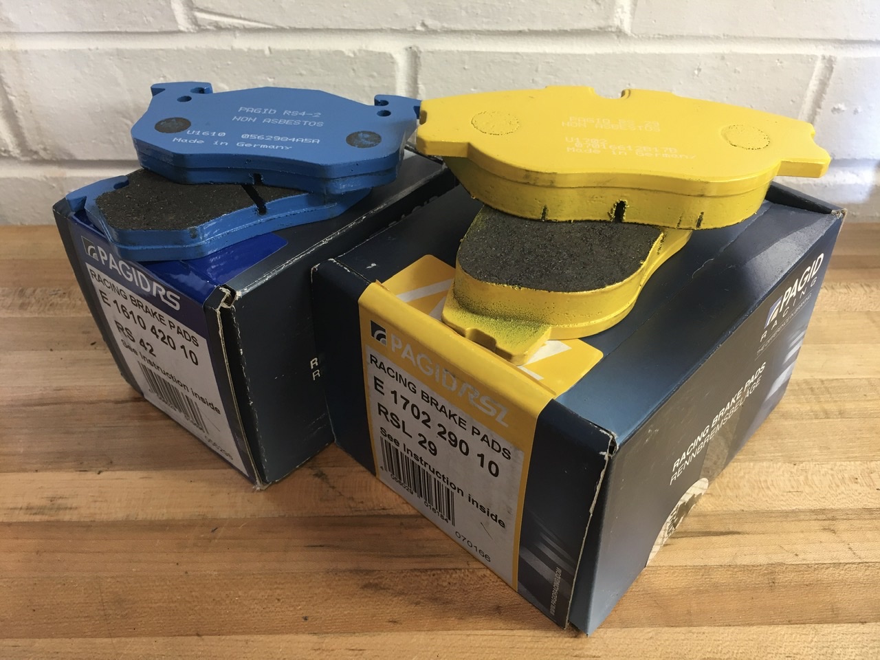

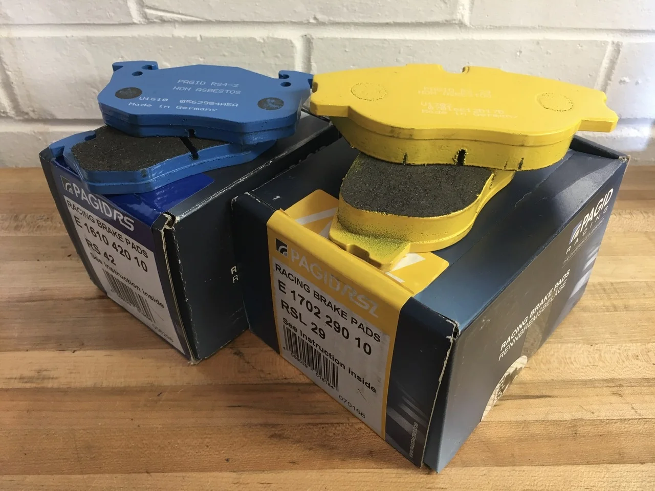

So you may or may not have read the thread discussing brake pad choices.
My pads of choice arrived today, I chose these based on my own experience as I’ve used them for years on my other cars.
Pagid RSL29s front
Pagid RS4-2 rears
I also dropped my black Turinis a the powdercoaters yesterday, these have been black for almost 10 years. They’re coming back silver and shoots add a different look to the little orange box.
-Rob
If you don’t use them properly yes they squeal like a mofo. However I’ve used them in my Impreza for years, my Mini GP and my Cayman R also has RS29s all round and none of them squeal at all.
Also had no problems running RSL29.
Saying that I have RSL19’s in my rear brakes and they’re noisier than my Project Mu racing pads..
frayz
Some do, some don’t. However I’ve always taken the view that If they squeal it’s a reminder of 2 things.
1) You have proper pads in there, so a bit of squeal isnt a big deal.
2) You’re not using them hard enough.
Hand on heart, I’ve never had an issue. You wait, now I’ve said that, these are gonna squeal like a pig. 😂
