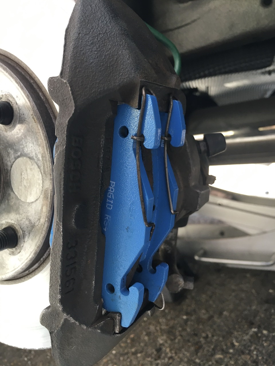

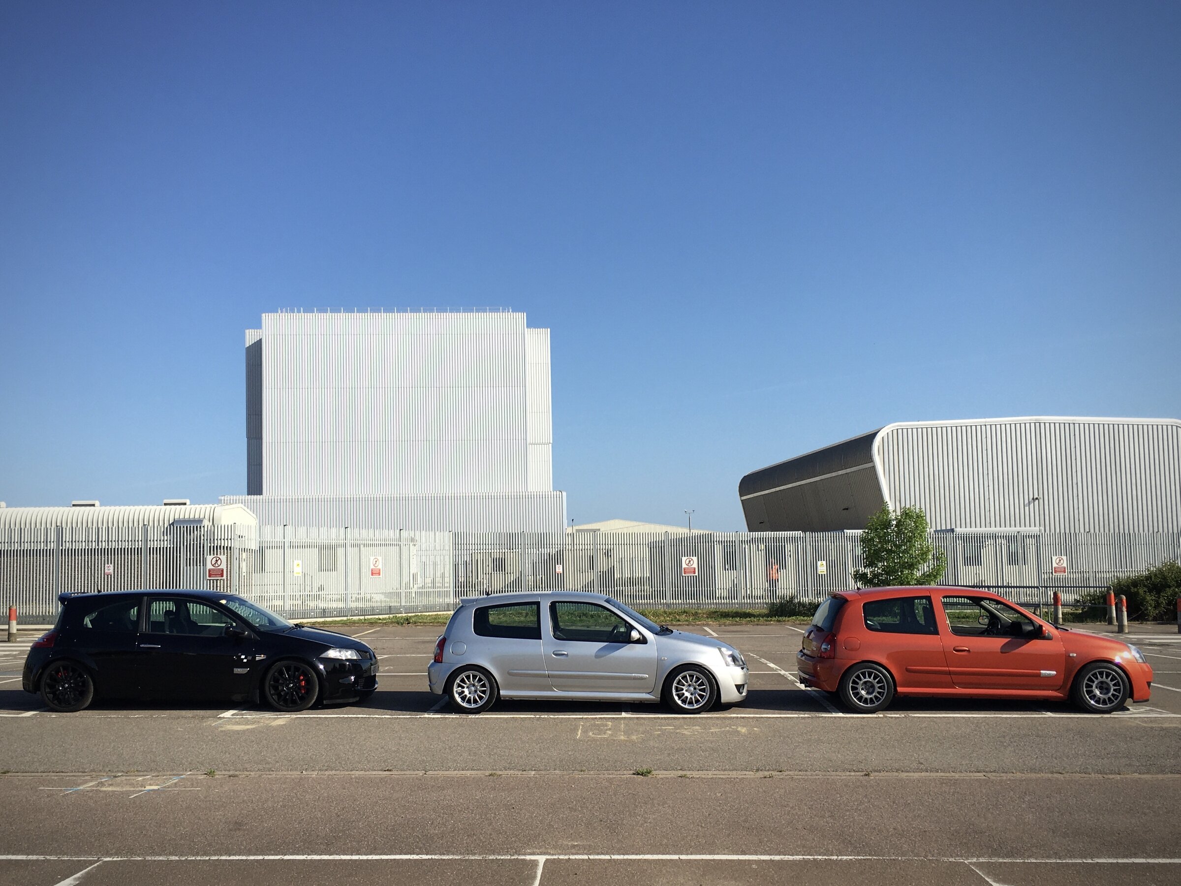

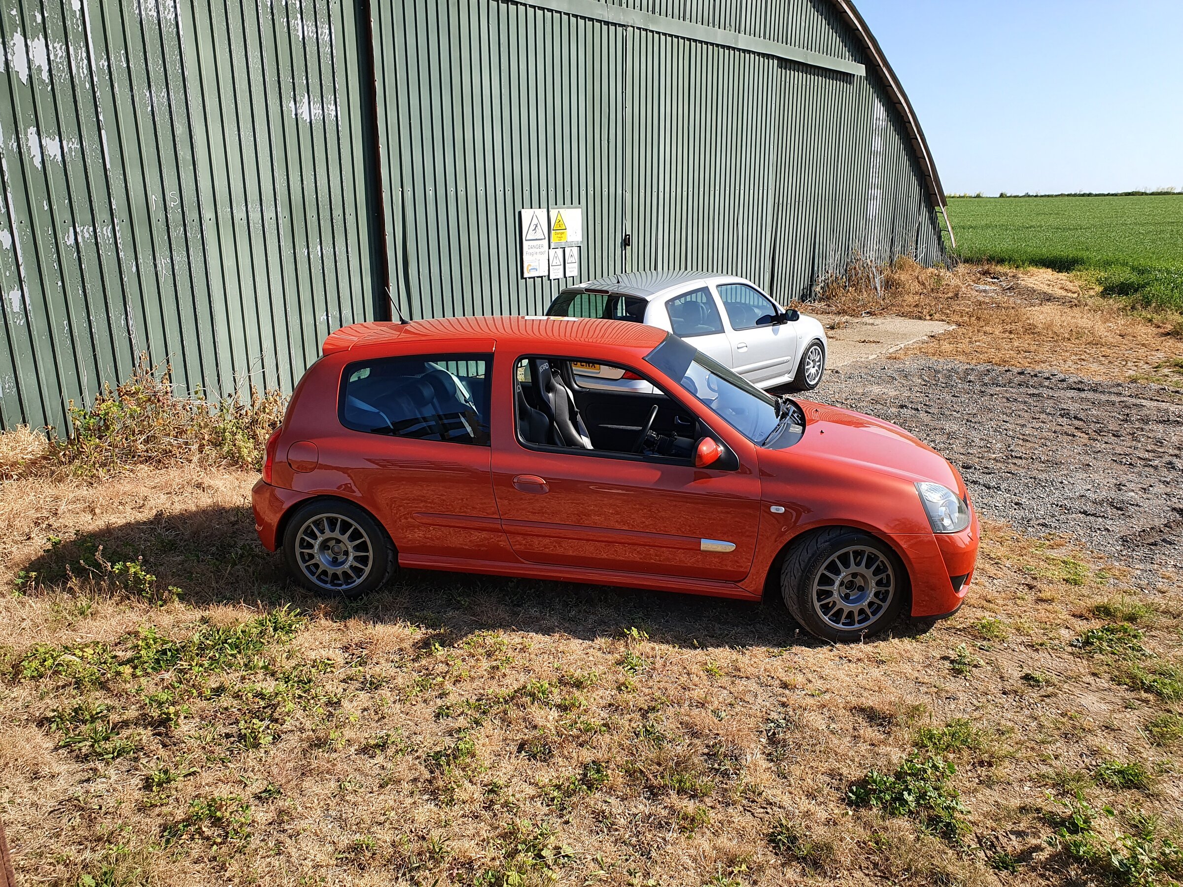

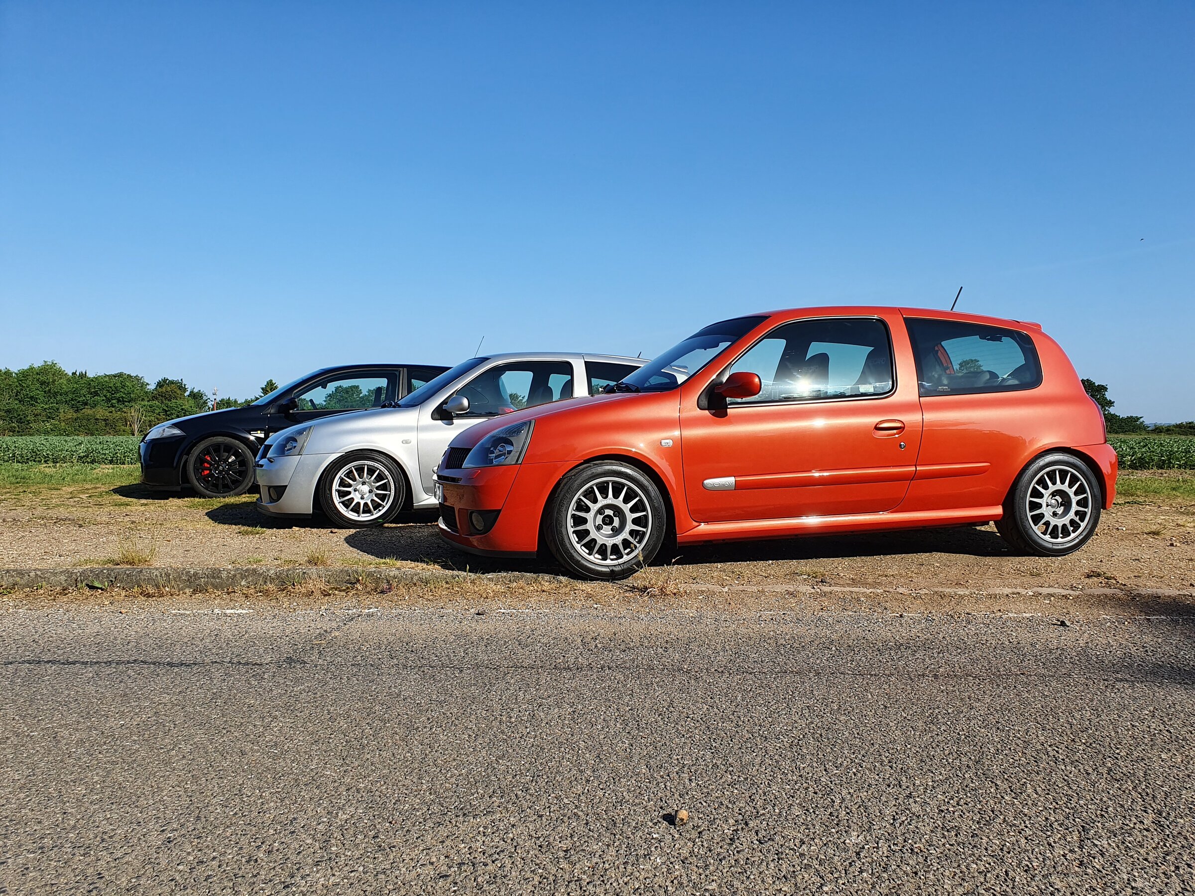

Managed to go for my first socially distanced drive out yesterday and caught up with @MrBlonde in his minty fresh Titanium and his friend Will in his lovely black Meg. Took a leisurely jaunt out to Bradwell and even stopped for some snaps. So nice to get out and drive for just the enjoyment of it.
Oh and i put my new Pagid pads in this morning so tonight will be some after hours bedding in post lateshift :D

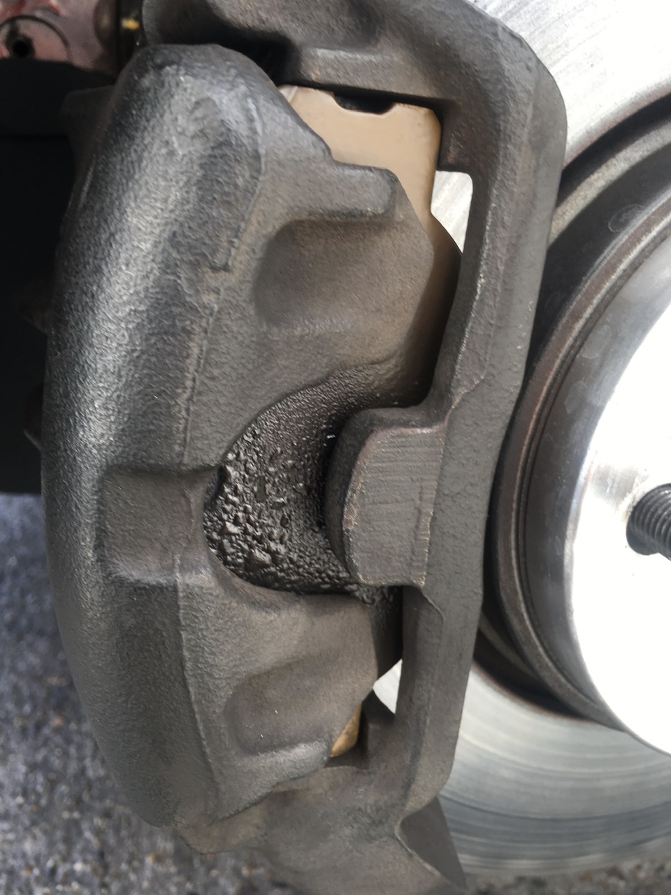

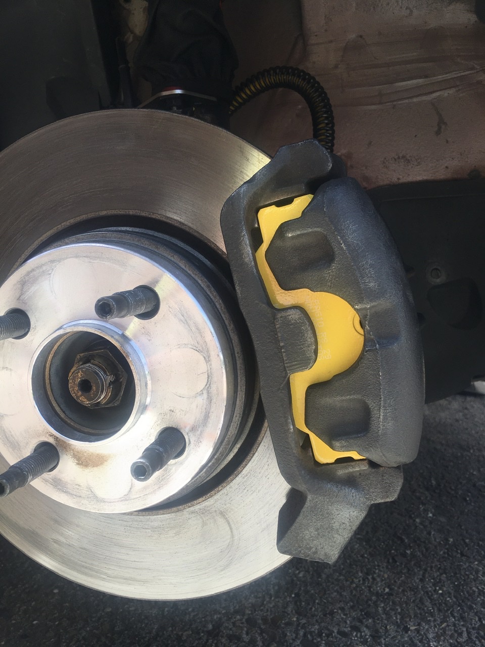

Bedded them in to the letter in the early hours after late shift last night and then drove home at a constant 50mph or so to allow them to cool slowly.
I have RS29s all round on my Cayman and also ran them in the Impreza and Mini GP. So I’ve no doubt at all they will be as good as they always are. Even pre bedded in i was easily activating the ABS with the car on R888s!!
You really feel the added bite from the rear axle too and the brakes instantly felt a lot more confidence inspiring than they have to date.
frayz
Well that’s the pads properly bedded in and heat cycled. They’re no longer yellow anyway. Ha.
Obviously not put them on track yet but the initial impressions were exactly as I was expecting. Good bite, solid pedal and loads of feel. Finally have brakes that inspire confidence when pressing on.
Also, zero squeal. 🐷

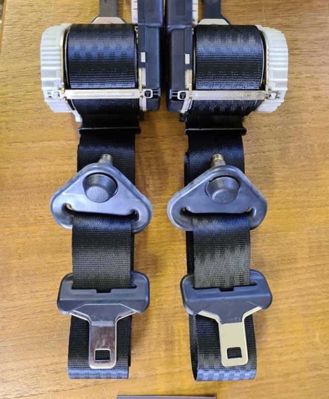

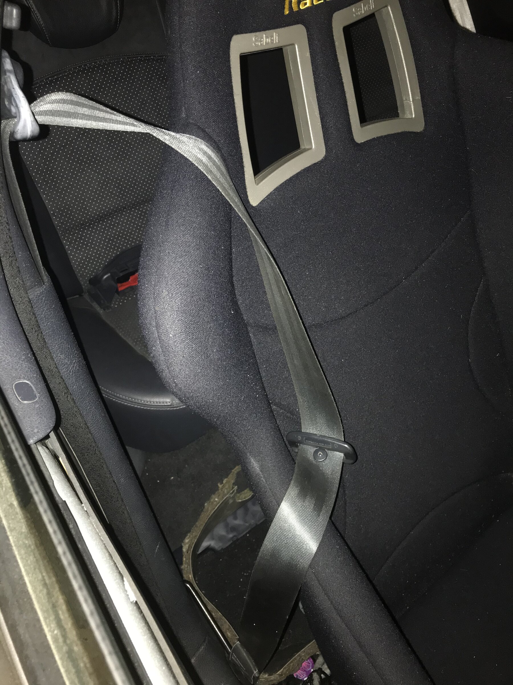

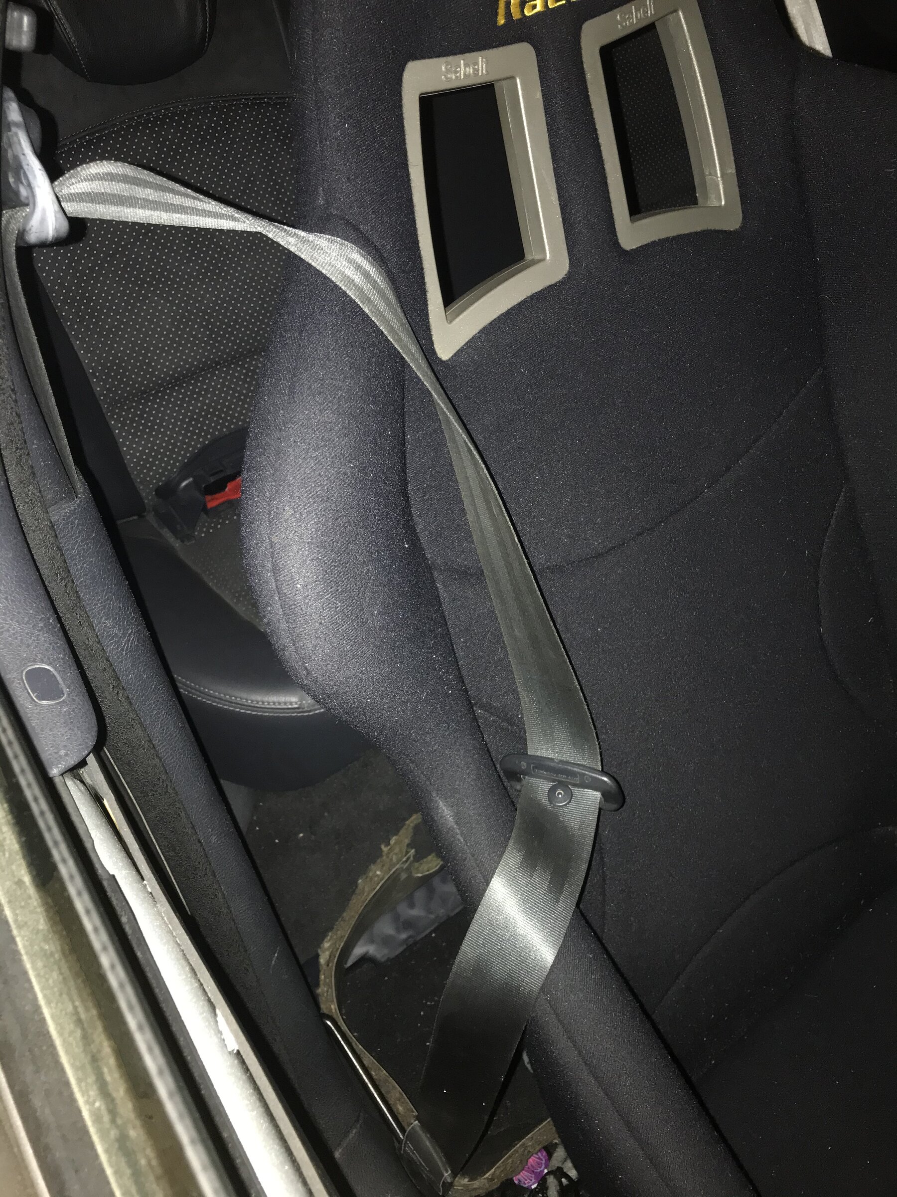

Also had my front belts re webbed in black, looking forward to getting these in and doing away with the continually dirty silver.
I swapped over to black belts on mine, looks decent and no cleaning!
Edit: You took them somewhere to do this?!?! 172s use black belts

FLOL at the "paint" on those pads now.. looks like you may have had a small thermal incident down there :ROFLMAO:
The paint's sacrificial anyway, the coatings never survive too well after a proper heat cycle anyway.
I followed Pagids bedding procedure to the letter and its pretty brutal in terms of thermal loading, however ive always doe it the way they say and never had an issue, its just not pretty lol.
Belts from 172, looking a tad worn but does the trick.
Ive found some RS4-2 rear pads for a good price, did yours stay blue or did they incinerate?

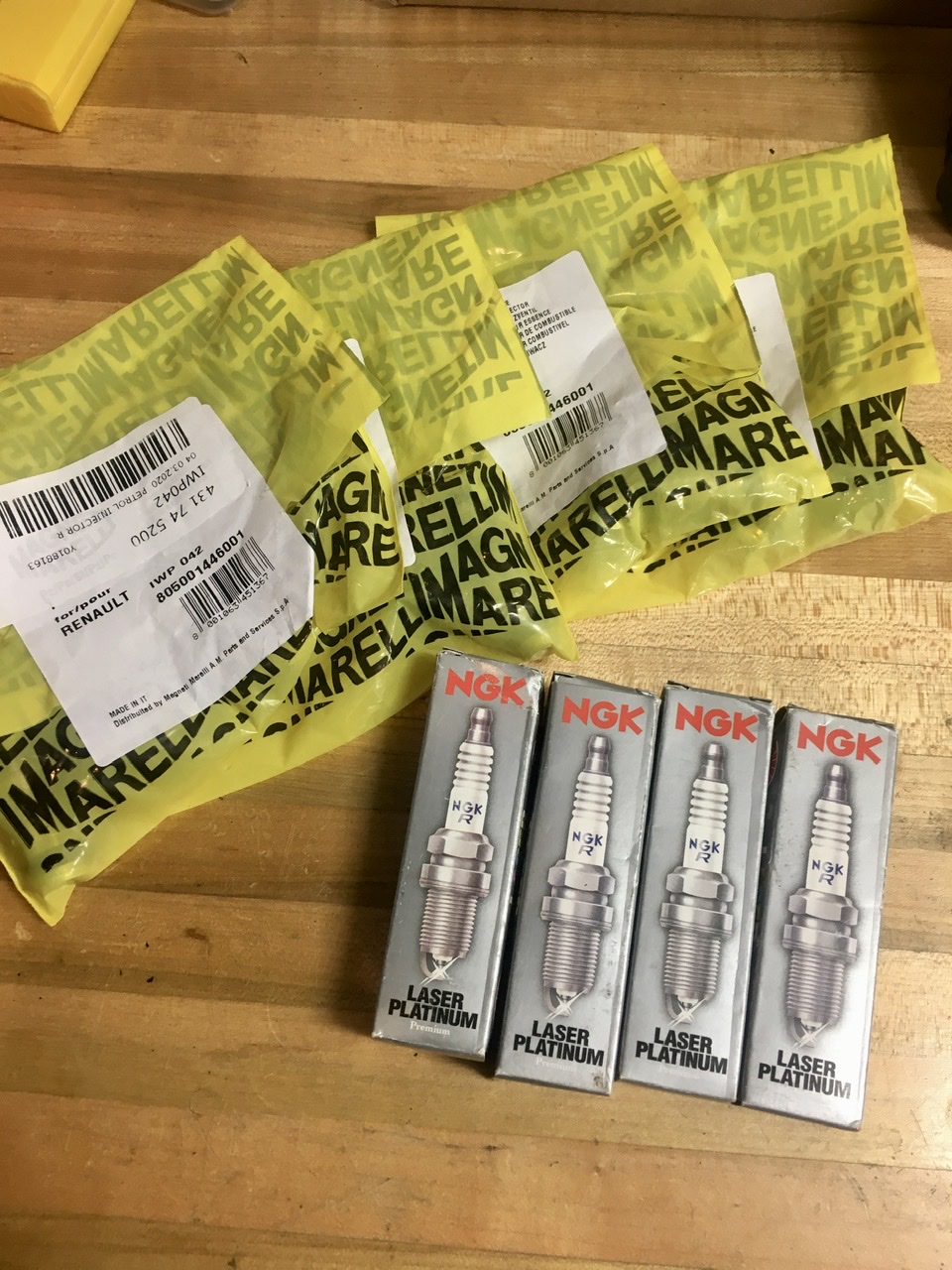

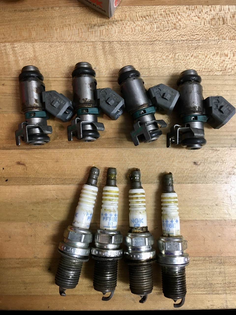

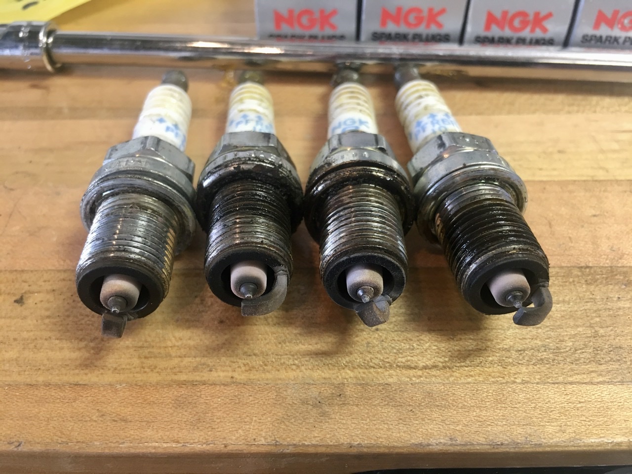

So she’s started getting grumpy on cold start and developed a cold misfire that clears within a few hundred yds.
Only on cold start, so wonder if this is an injector or temp sender going down.
She’s knocking on 125k now so either way I thought she could use a fresh set.

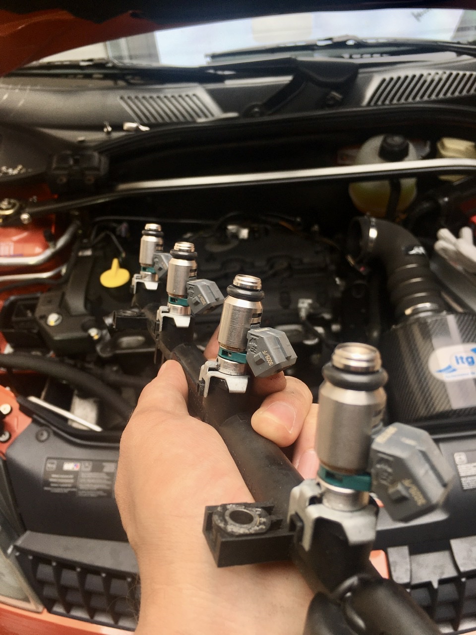

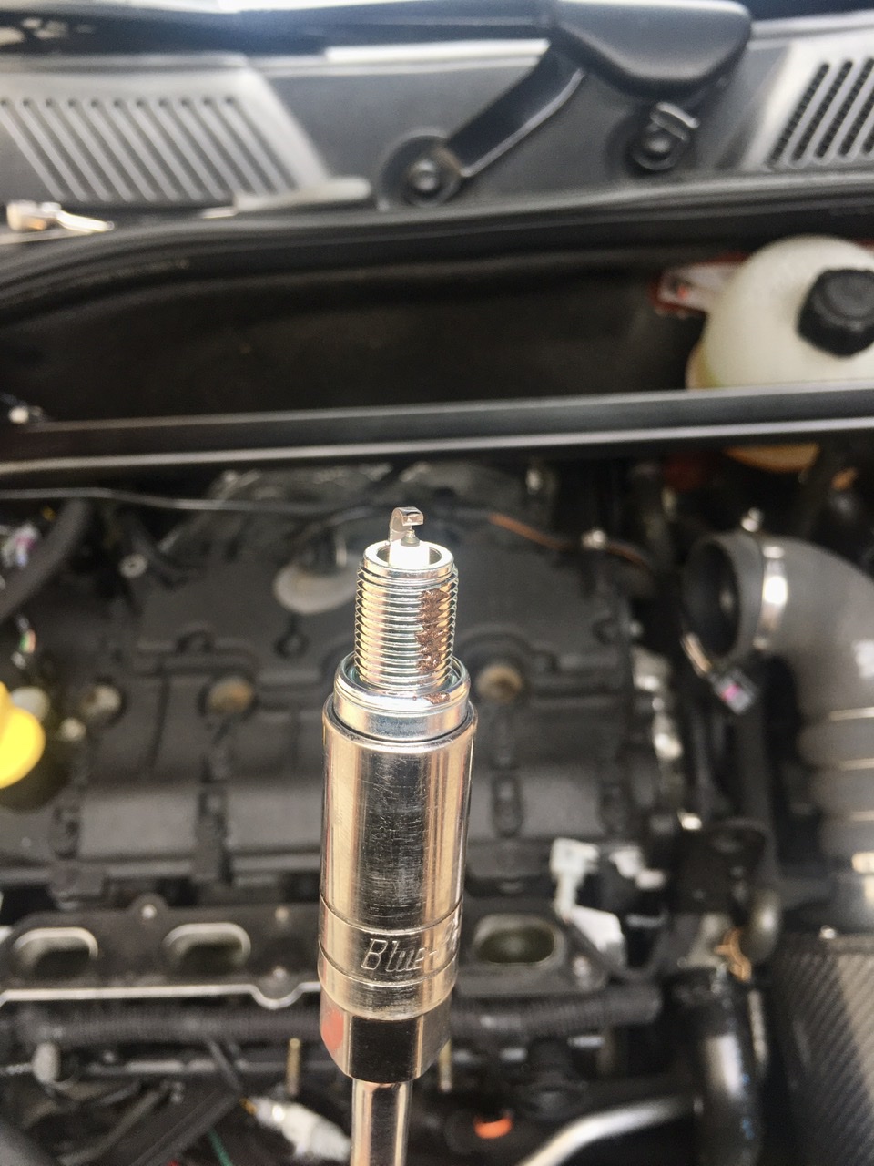

So fitted 4 new plugs and 4 new genuine Marrelli injectors tonight.
Plugs removed all looked clean with no nasty signs. All injectors also have perfect resistance between 14.6 and 14.8ohms
Certainly seems to start and idle cleaner, time will tell in the morning.
frayz
Pleased to say this morning starting and idle was perfect and back to the usual but still somewhat grumbly standard Clio sport idle.
No misfire or hesitation at all and feel like it pulls much smoother and cleaner throughout. Not sure if maybe a plug was starting to go or what, but certainly feels like it was probably down on power a little previously .

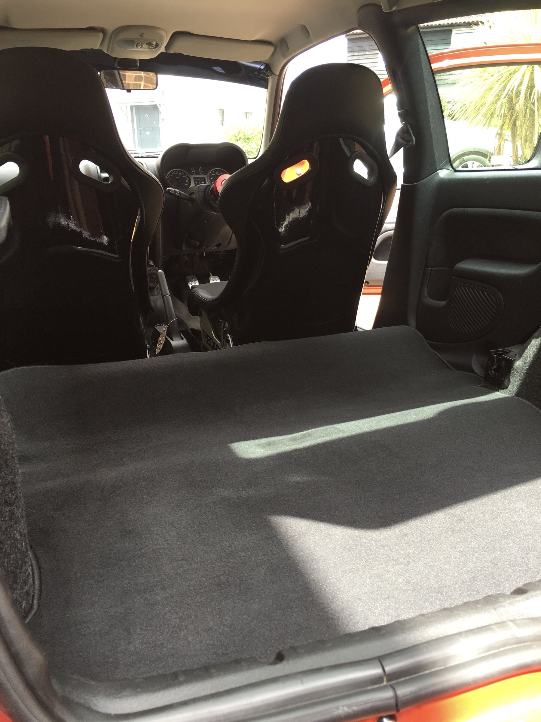

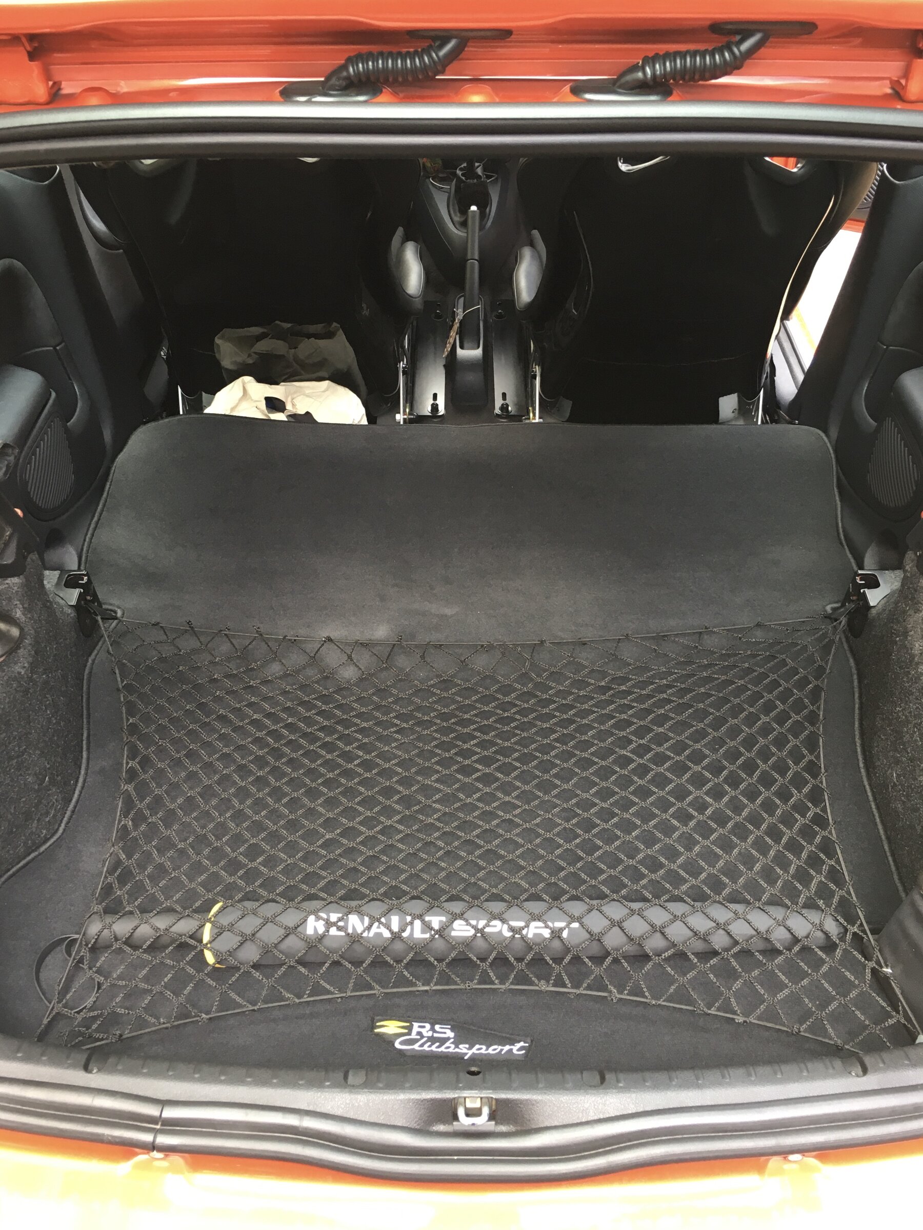

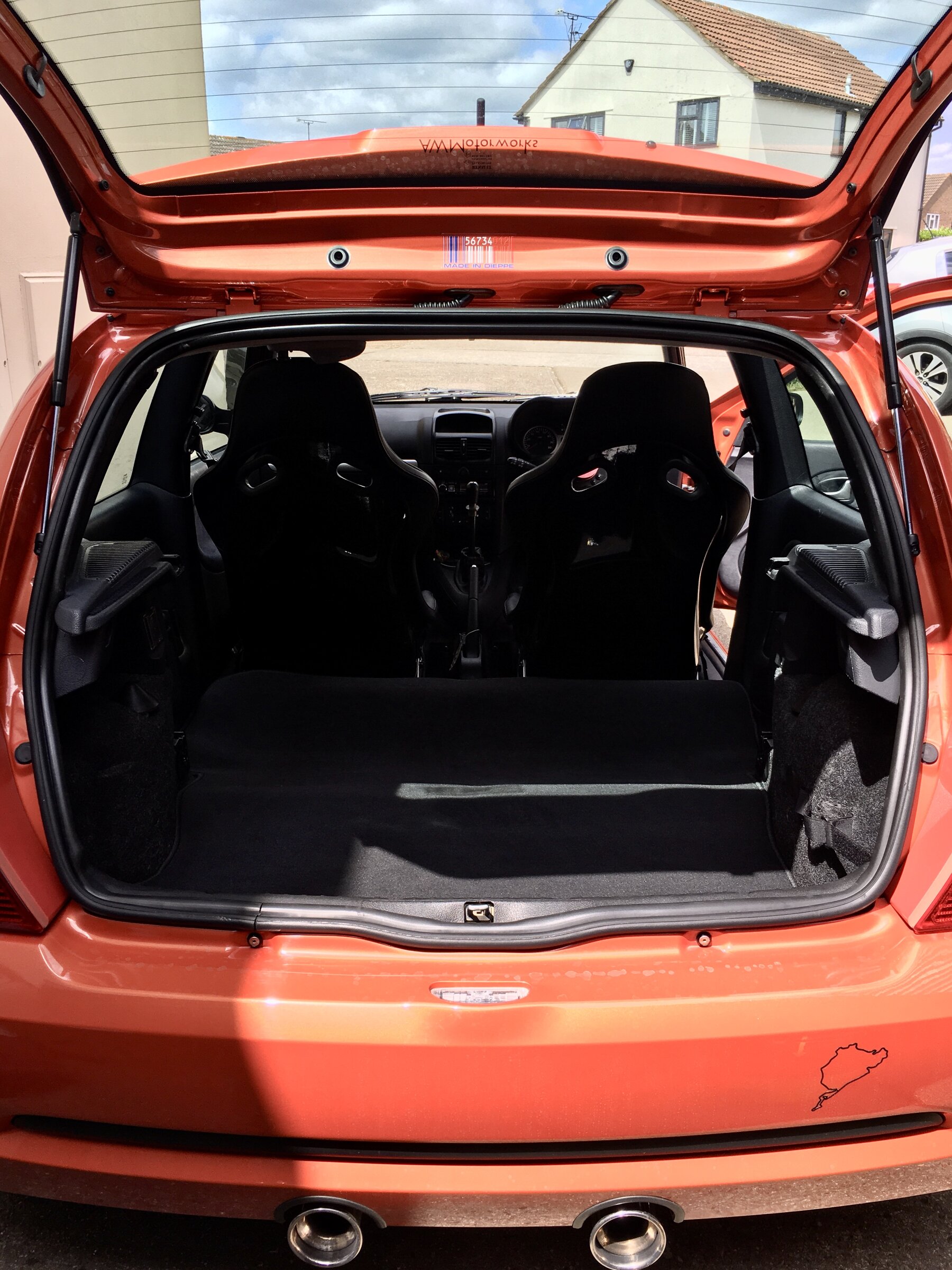

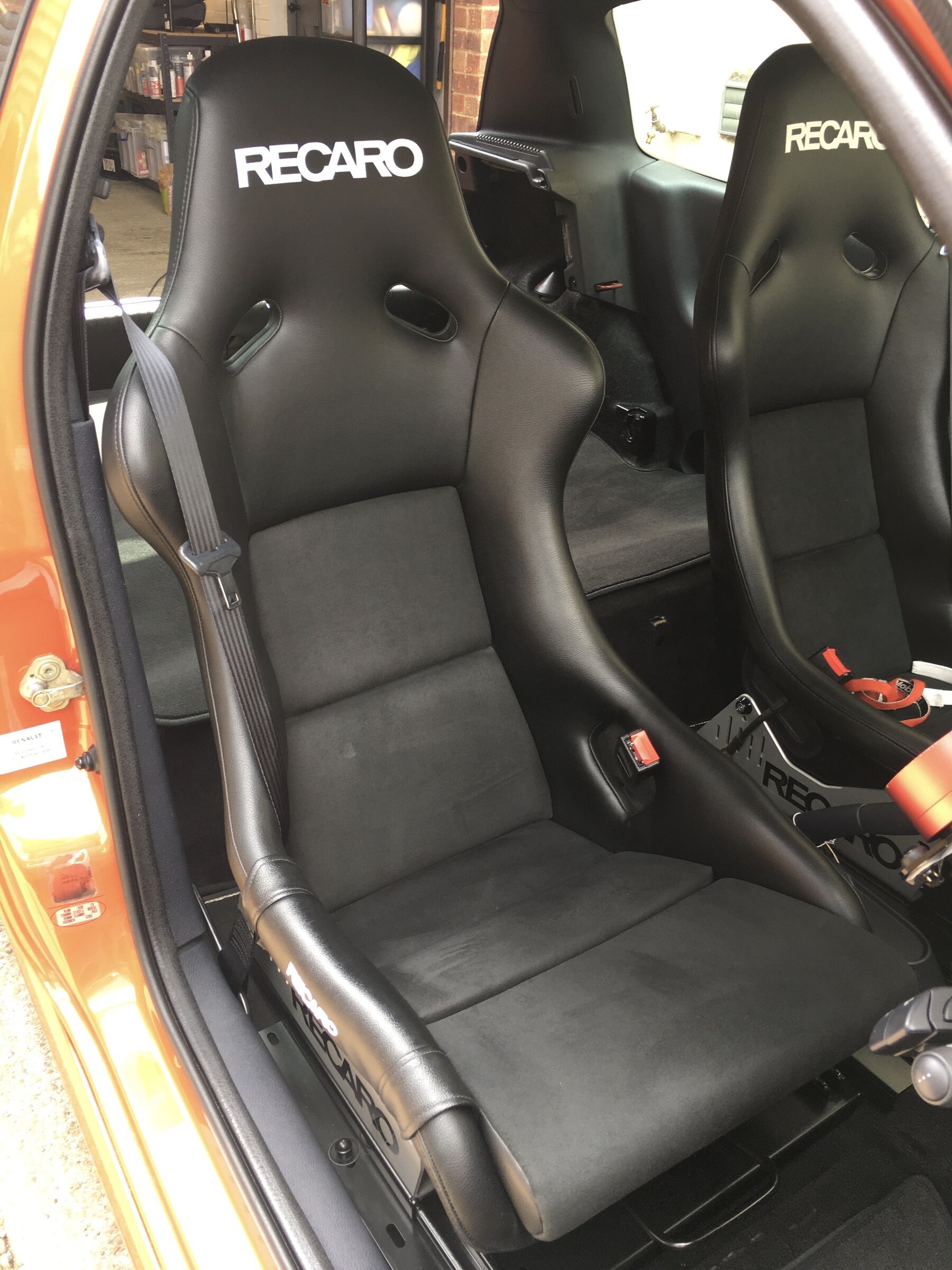

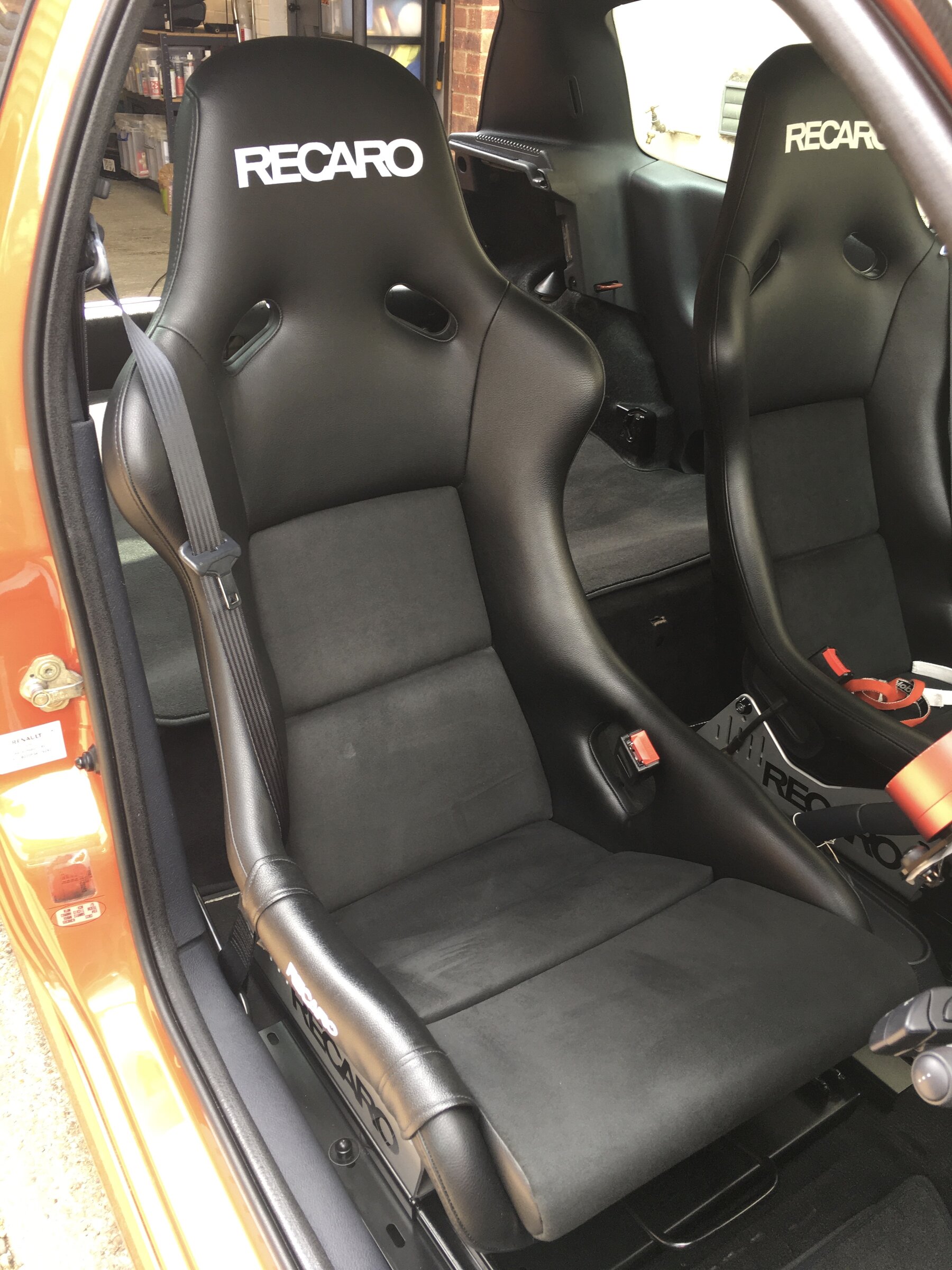

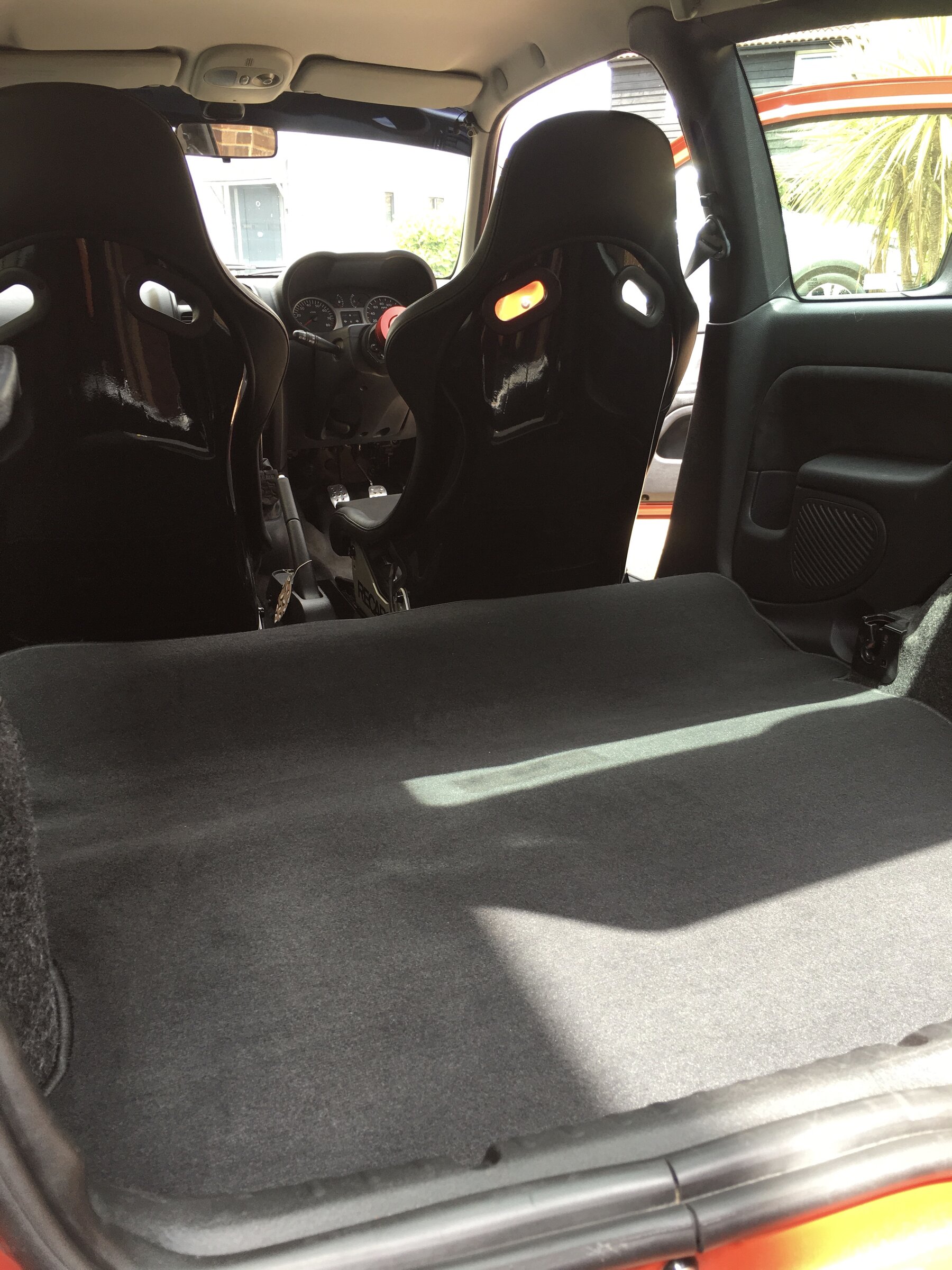

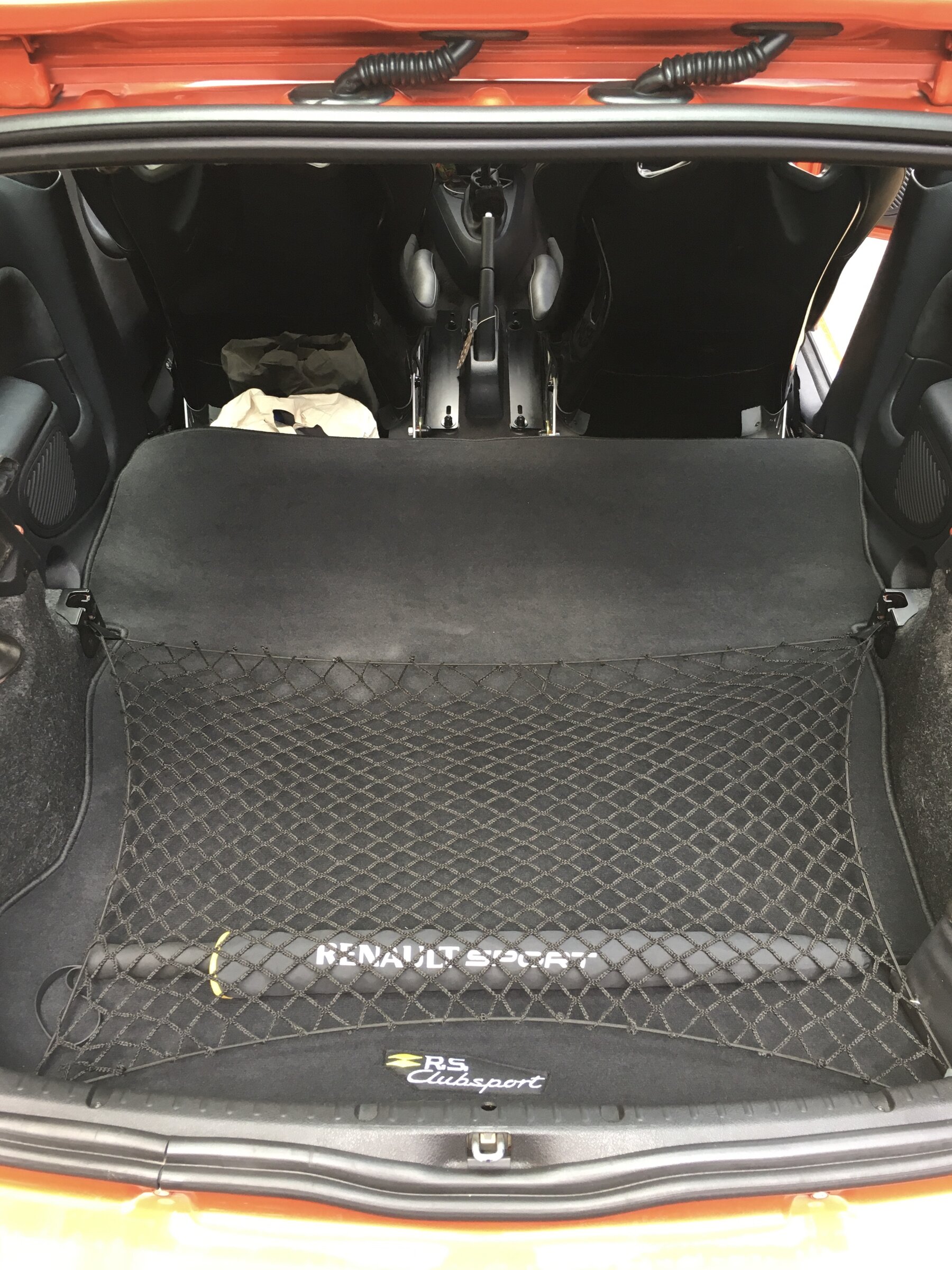

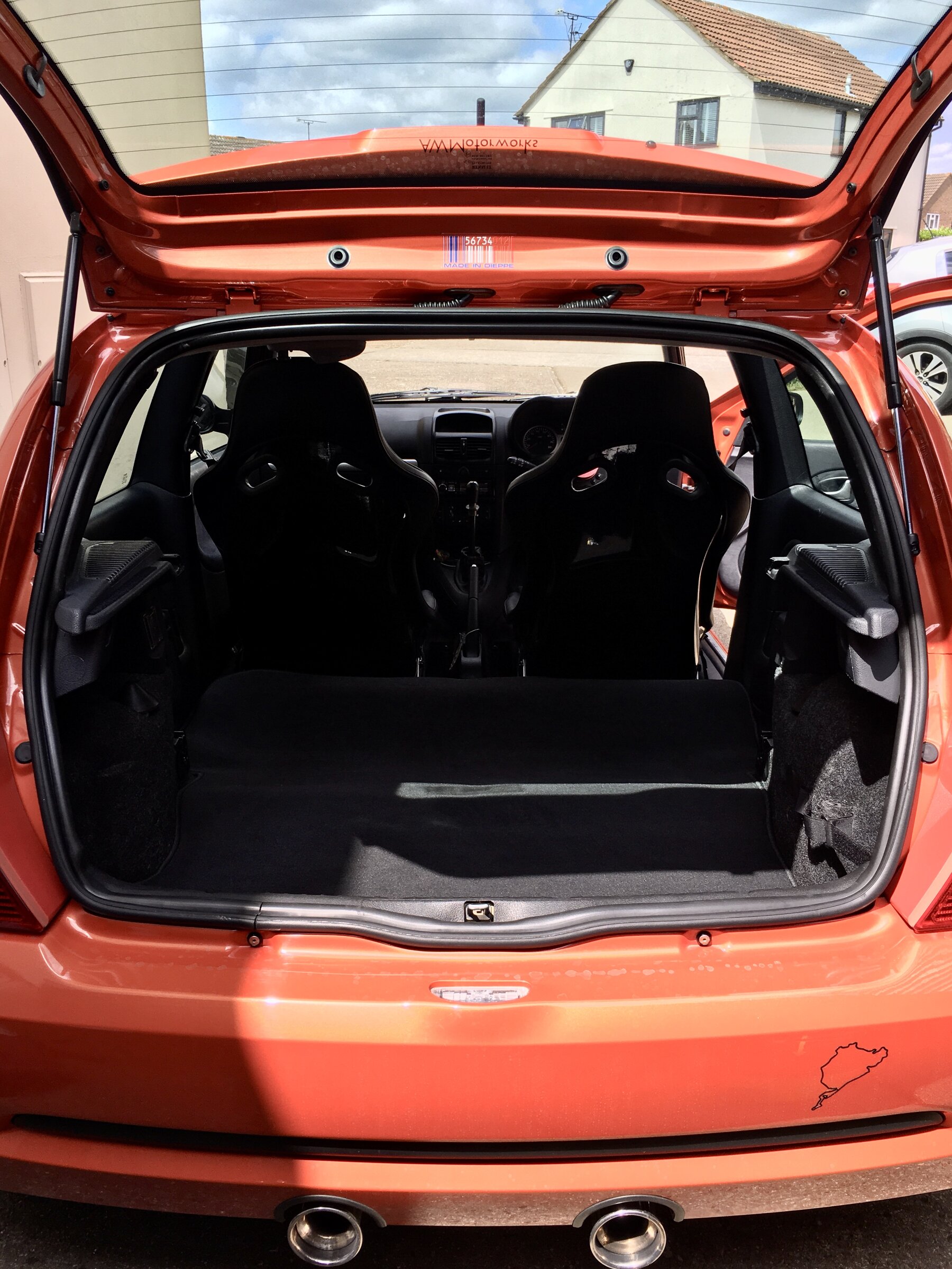

So finally nabbed some time to fit the black seatbelts and remove the rear bench. Black belts are standard equipment in almost all cars yet i really think they look better in here. The rear bench was never used even with the OEM seats in place, and absolutely cannot be accessed with the Pole Positions now fitted.
So as they were purely still there for decoration, I’ve decided to remove them and further add to my Clubsport theme.

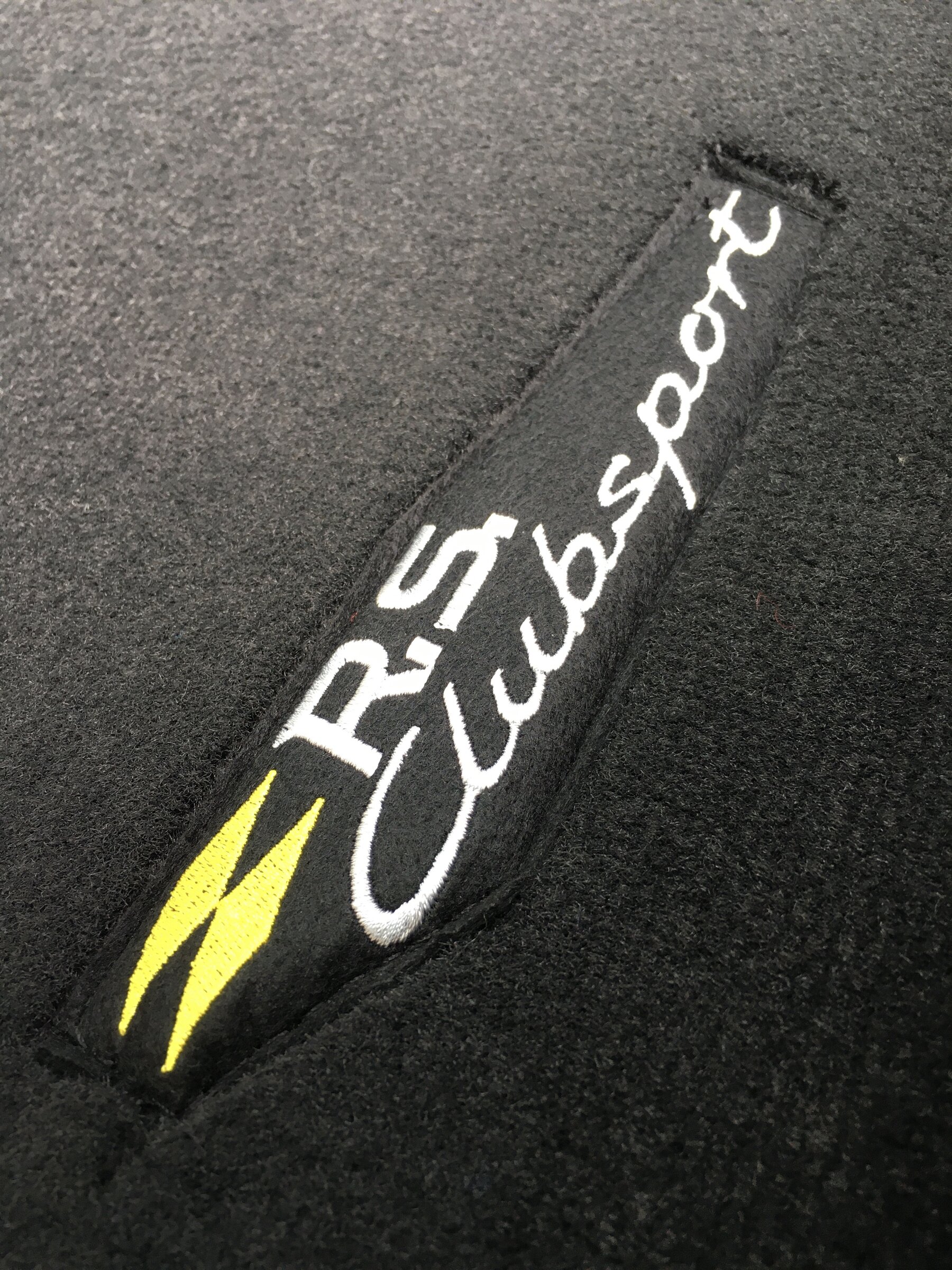

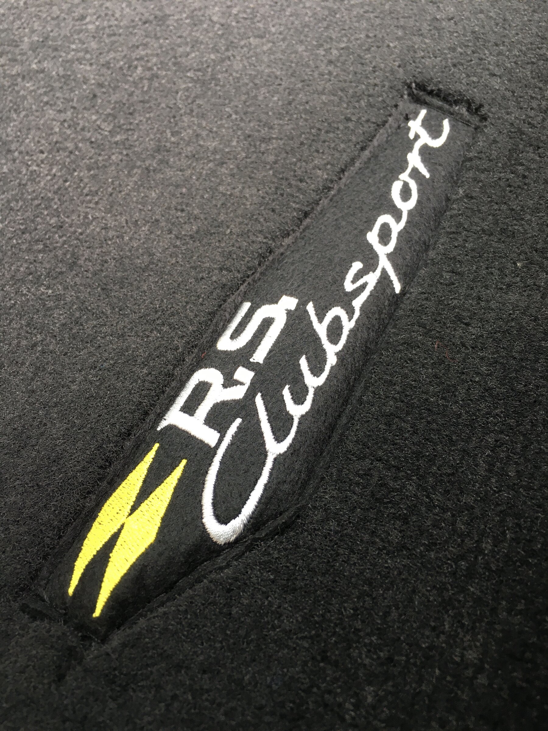

So for a bit of fun, I had the boot mat embroidered with a logo i made up.

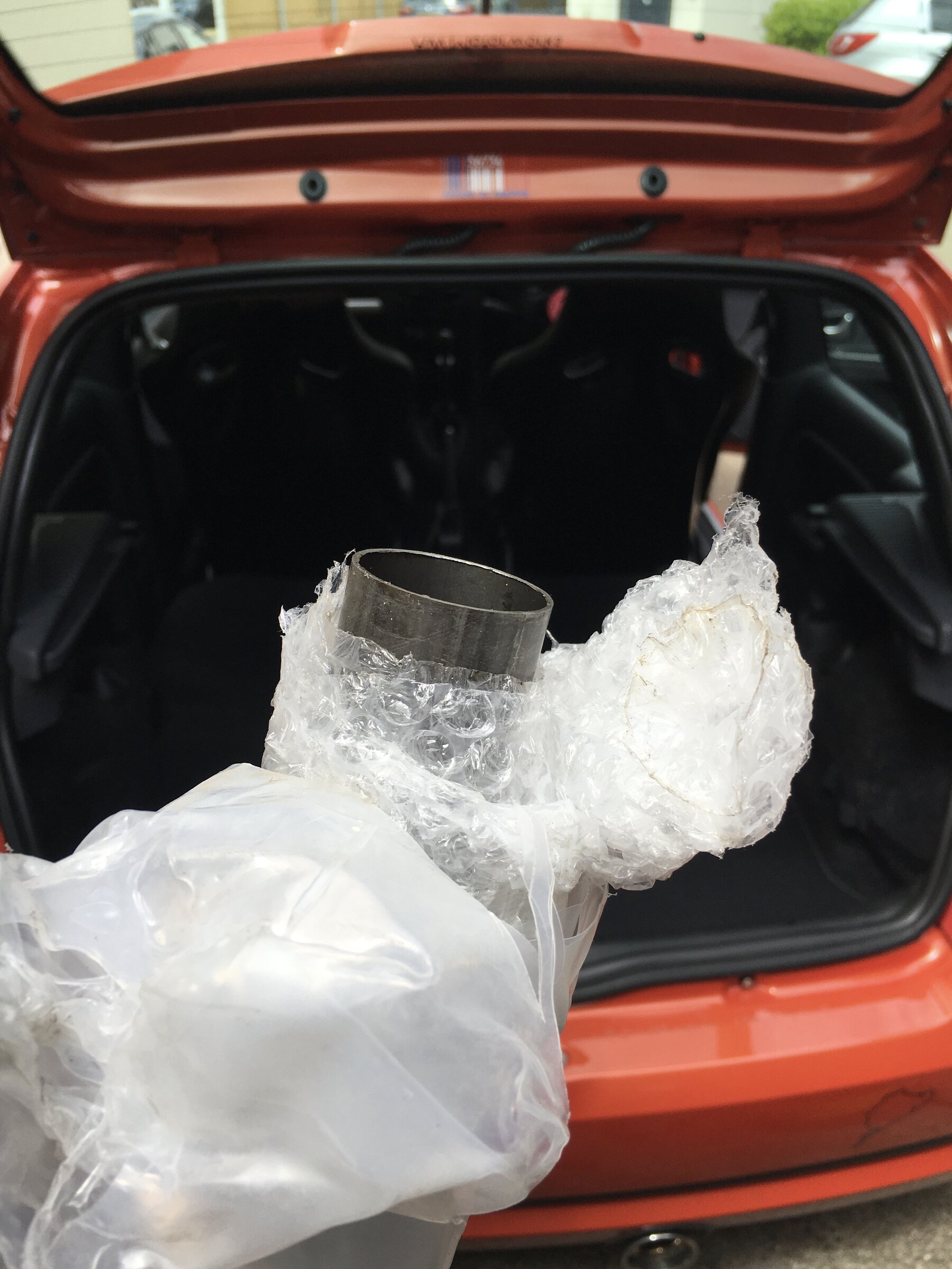

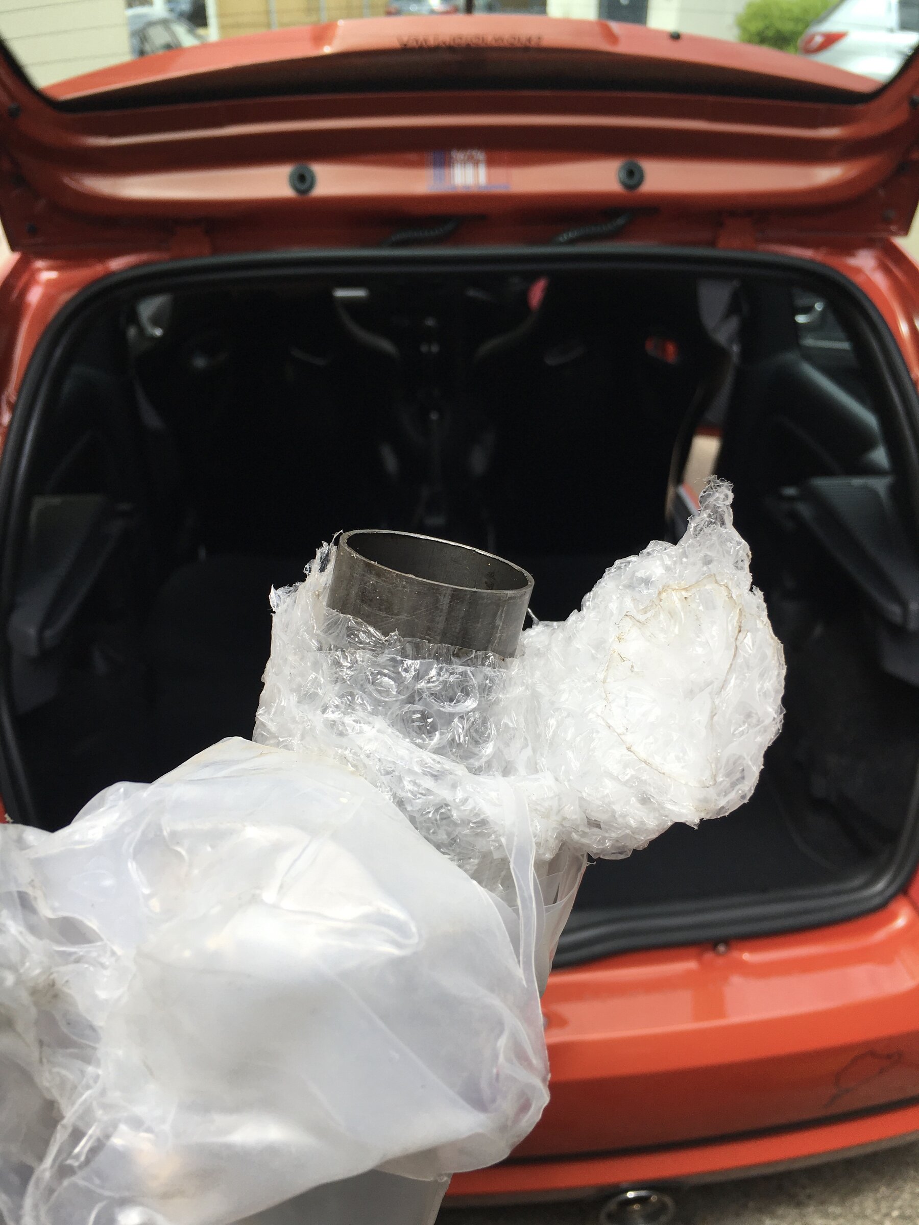

Lastly was the arrival of some 0.9mm wall T45 tube for another idea I have, so check back for updates on that.

Looking great mate. Those seats are a thing of beauty.
I think long term I’ll be looking at the Clubsport feel.
frayz
Thanks chap, like most of the good bits, you could buy another 182 with what they cost, but the Pole Positions are worth their money all day.
Undecided at the mo if i go for a rear cage or just a boot net as per the Golf Clubsport S.
As long as the level of finish is that of an OEM or near OEM, i'll be happy.
Still undecided on which route to take on some extra poke too so ive loads of ideas for it. :)
If I was you (had you car) I would only being going custom for a rear cage, Id want it to be very flush with the pillars and to match the quality of the rest of the car.
View attachment 1479358View attachment 1479356View attachment 1479359View attachment 1479361View attachment 1479357View attachment 1479360
Looks great as always! How you finding the noise with the seats removed?
