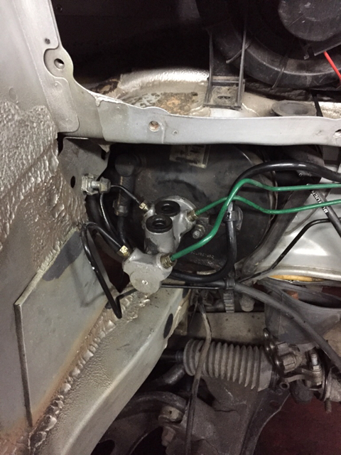

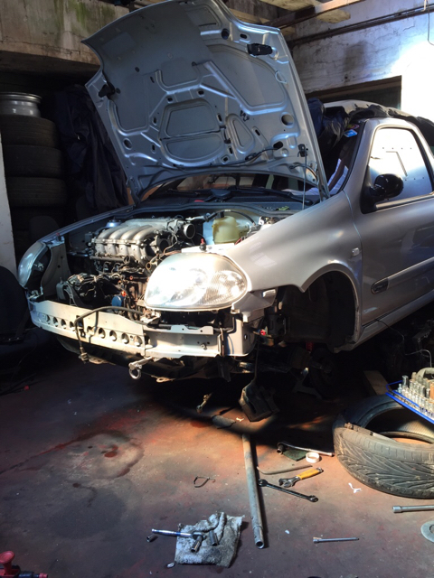

On the rack in that picture the two small 6mm pipes at the right get linked together, at the end where the column fits i just grease packed it and made up blanking plugs for the holes.

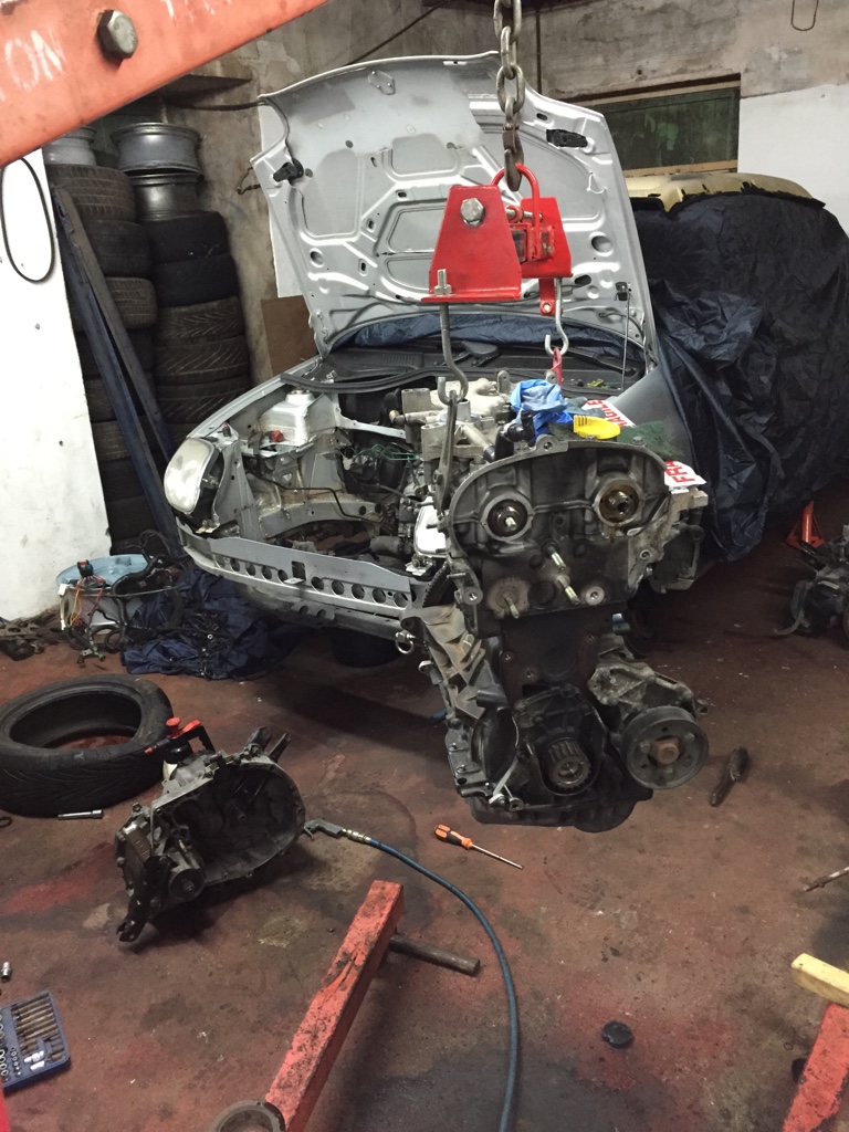

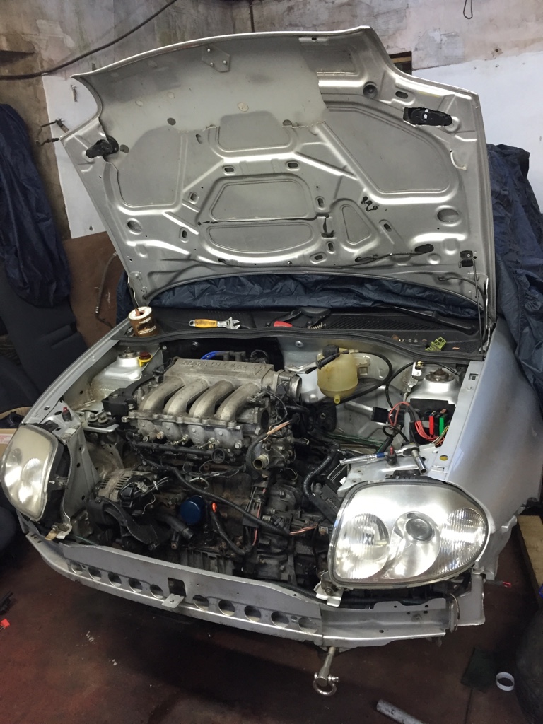

You's will need to give me info on the epas, was going to tackle it while the engines out but not sure on exact parts.

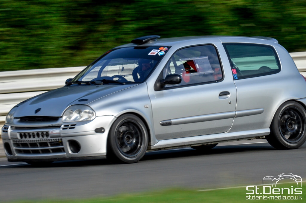

nice plans fraser. do like the two wheel picture, did it feel that much inside?

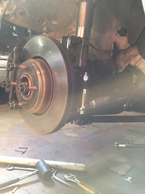

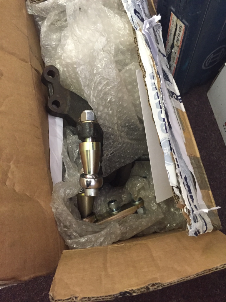

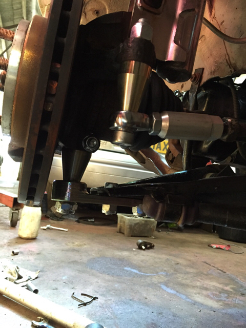

Cup subframe and wishbones

ABS removed
PAS removed
Hub kit
Minor weight saving

As you can imagine it feels a lot different. But in getting the hang of it.

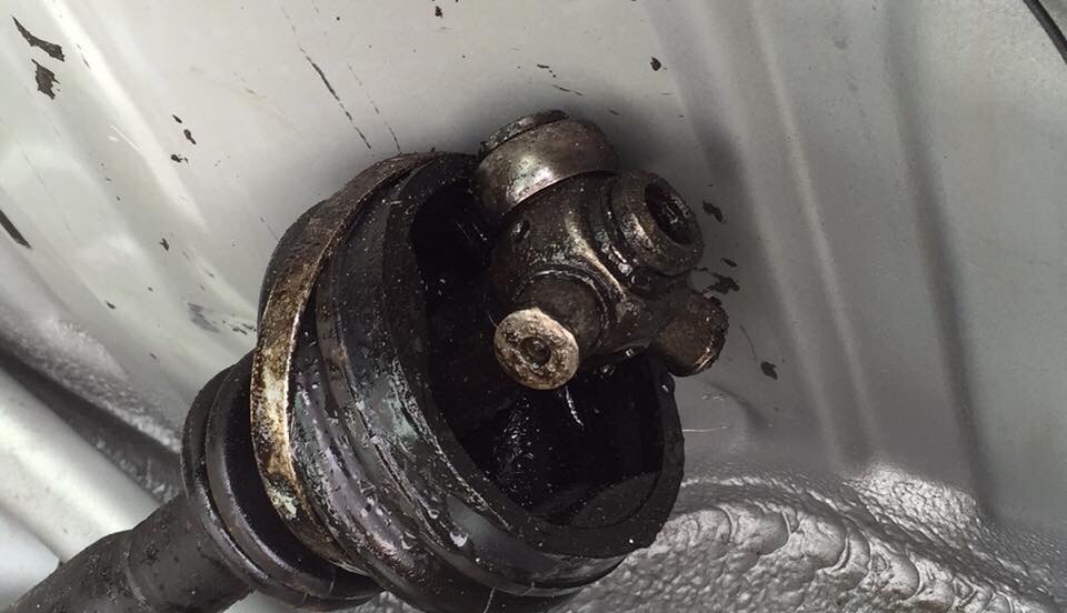

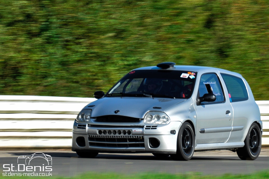

Well done CSS in this, morning track slot and blew a shaft
Luckily dry side, but I've been using ph1 shafts with a cup subframe 5mm wider each side and now the extra 5mm with the hub kit, I think this is the cause, amazed at how it hasn't happened before now but hey, maybe just luck. This resulted in a trip up and then back down to blyton with the Navara and the trailer!
Some pics on track
Really enjoyed CSS and the track, so I've just booked up for another next month! Will definitely be trailering it down this time.
