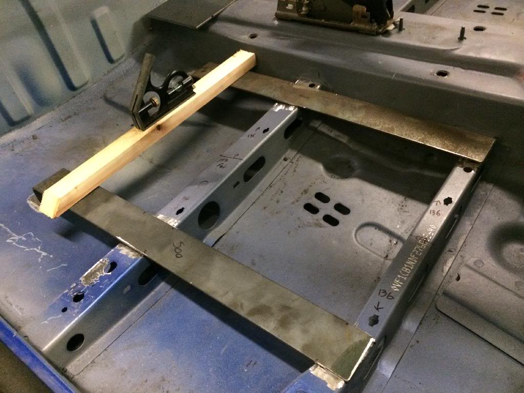

Removing spot welds is a nightmare!! We decided to run 3mm plate from front floor brace over rear and weld to floor, means we can have lots of seating positions if required and is a fair bit easier job!
I got the plate from Magma, 3x50mm in 1 metre lengths.

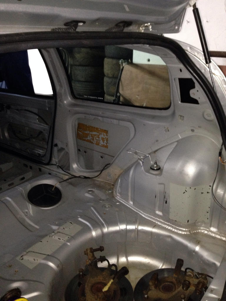

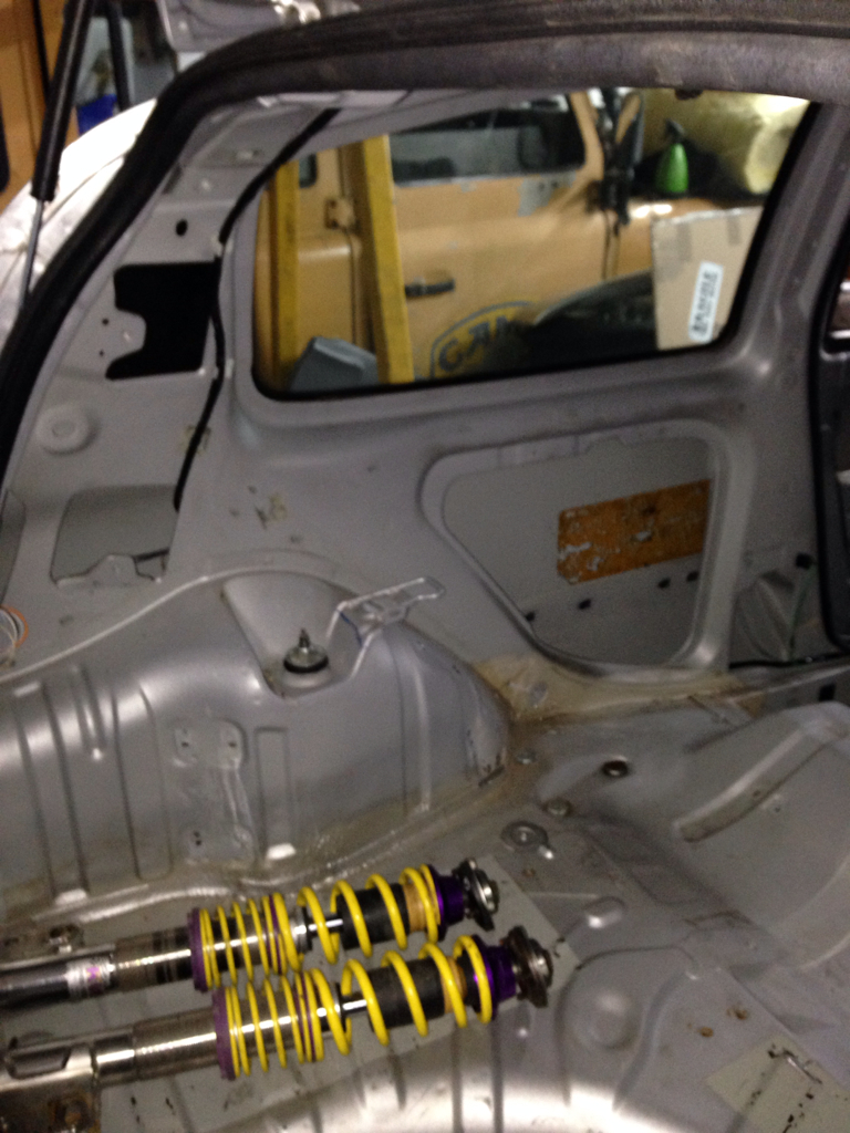

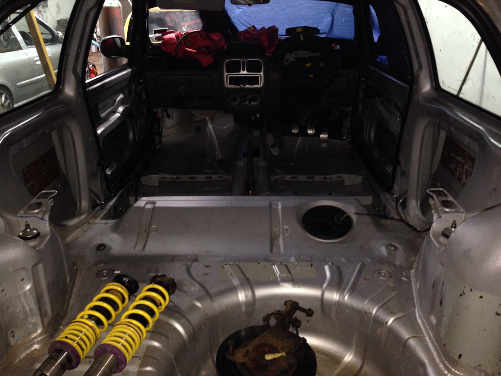

Got some more stripping done, tidied up wires, tucked them away. Need to get a drill bit to remove the bars under the seats to make way for the weld ins, then cut off and buff all the old threads sticking out everywhere that are no longer needed!

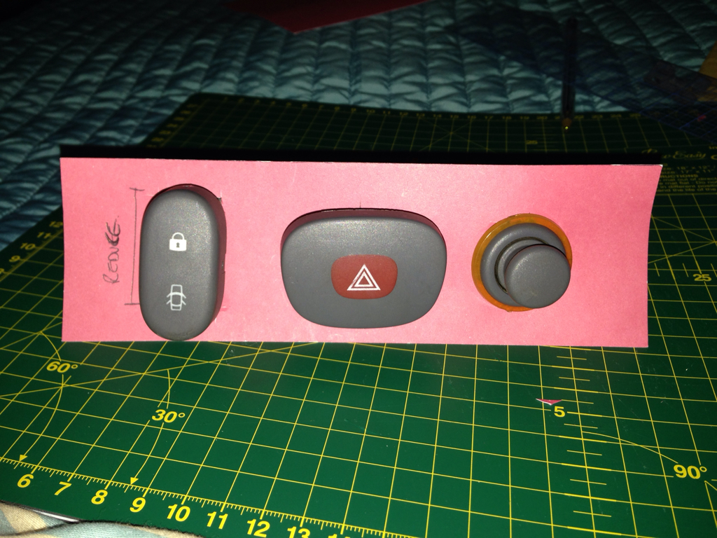

Also got a template made up to fit the gearbox cover switches into the radio position
Will get that made of out plastic by a mate, then slip it into the old radio postion!

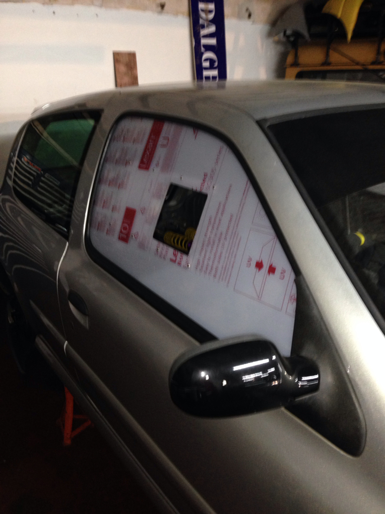

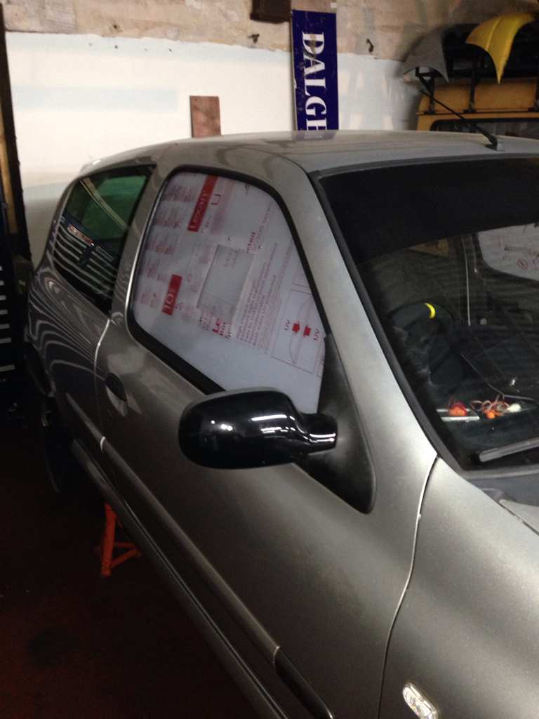

My windows came from ACW yesterday, not removed the protective cover yet but they look well made and fronts fit nicely, theyre a good buy!

She's on KW V2s, love them!

Front windows are a good fit in the seal so a couple of screws to hold them up will be fine, for the rear i bought the bonding kit, did you not see that? Comes with stuff to put the black surround back round the windows edge too. Ive just updated my project thing, a pic in there of them- but protective film on so not very good!

I think with the seals and a couple of screws from the inside you should bet a good seal on the front windows , I had to put serews in from both sides as my doors are a bit more flexy.

I've only got fronts so it's just how to hold them up!
I did this but with 6mm thick, mine slowly started to bend backwards so the seat looked as it was reclined and twisted the bits you are welded onto. Mine was bolted though but did sit level. I wouldnt advise anyone to do it like that!
Not a fan either tbh. They're not there designed to take them like that so hence why I'm going for weld in bars and they are coming out.
You bent 6mm plate!!? I doubt if it was fixed in any decent way that could happen, why on earth you used 6mm in the first place!?
3mm plate is strong enough to make car ramps never mind hold 37kg a side.
i can assure you they do not budge, and have already been passed by scruitineering ;)
The tubes do look the best way by far, but these will certainly do the job.
IMO, a 3mm bit of plate sticking out about 200mm from any support structure passing scrutineering is very surprising. There is no support which is allowing flex which over time will either bend or break the welds. Either way, it is not going to end well on track. Under hard acceleration and braking with the twisting of going round bends could weaken over time.
because I had it there so I used it, it was fixed perfectly well too Thankyou.
But mine didn't pass scrutineering, it also didn't pass the real life test.
If your happy with it so be it, It makes no difference to me!!

Haha yeh, it isnt a bit plate hanging over the edge like a diving board.. :headno:
Its bent down and out and welded to the floor, like a dog leg as Neil says.
Stop girning over it, its secure for fu ck sake, or id change it wouldnt i. :rasp:
Mine was, well kinda hung over the back ever so slightly.
Once I had seen the picture of it then i stopped fearing for your life haha!

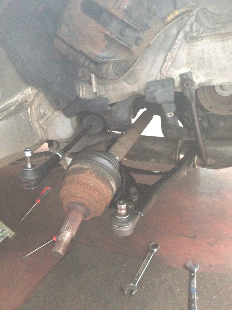

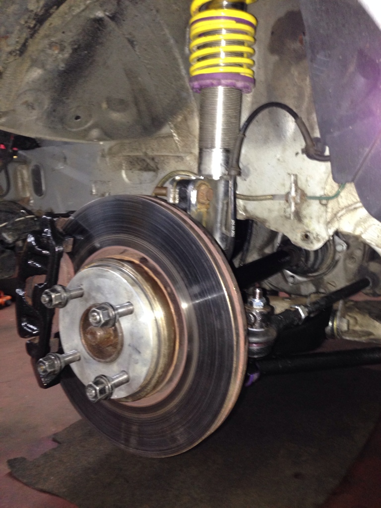

Well had a busy few days, got the new nylon rack bushes on.
Got new track rods and ends fitted.

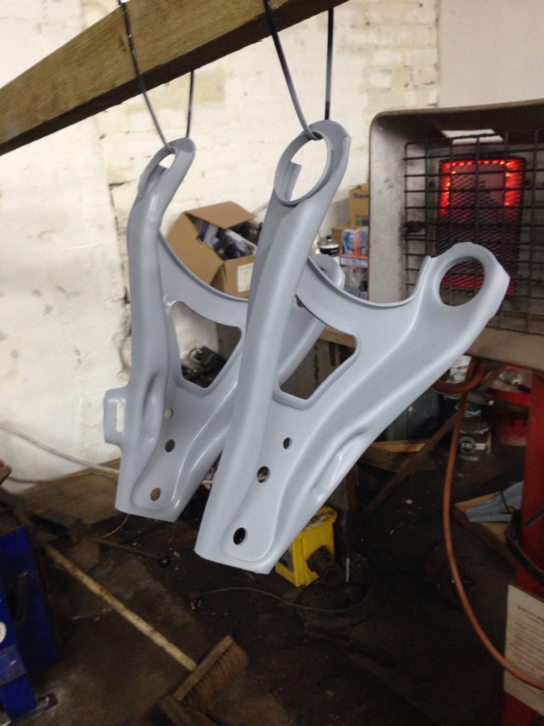

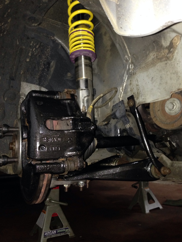

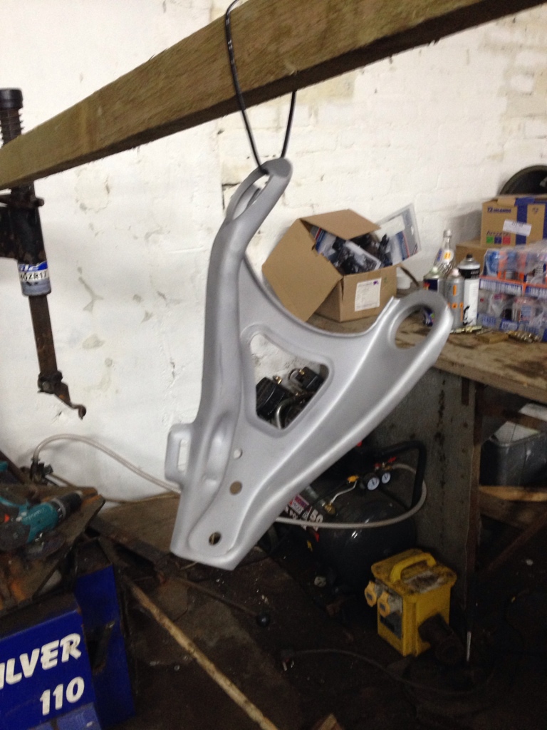

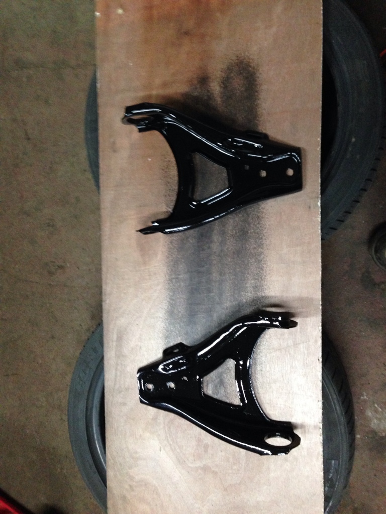

Got my old cup wishbones blasted, painted, new polybushes and ball joints.

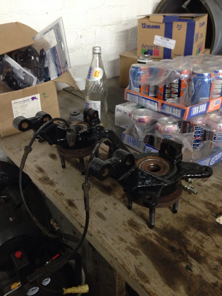

Painted my hubs
Painted the ends of the arb.
Painted the drive shafts.
Painted the calipers.
Some pics!
I'm now really just waiting on the cage, which should be the coming week, I can then get that in, door cards and Polycarbs in.
PMS shifter fitted, and back on the ground ready for alignment.
Hopefully for the 8th of March for the first trackday of the year!
