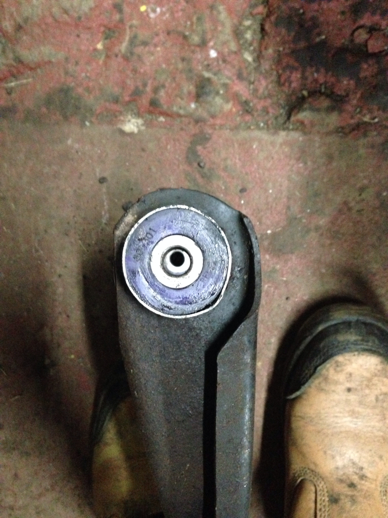

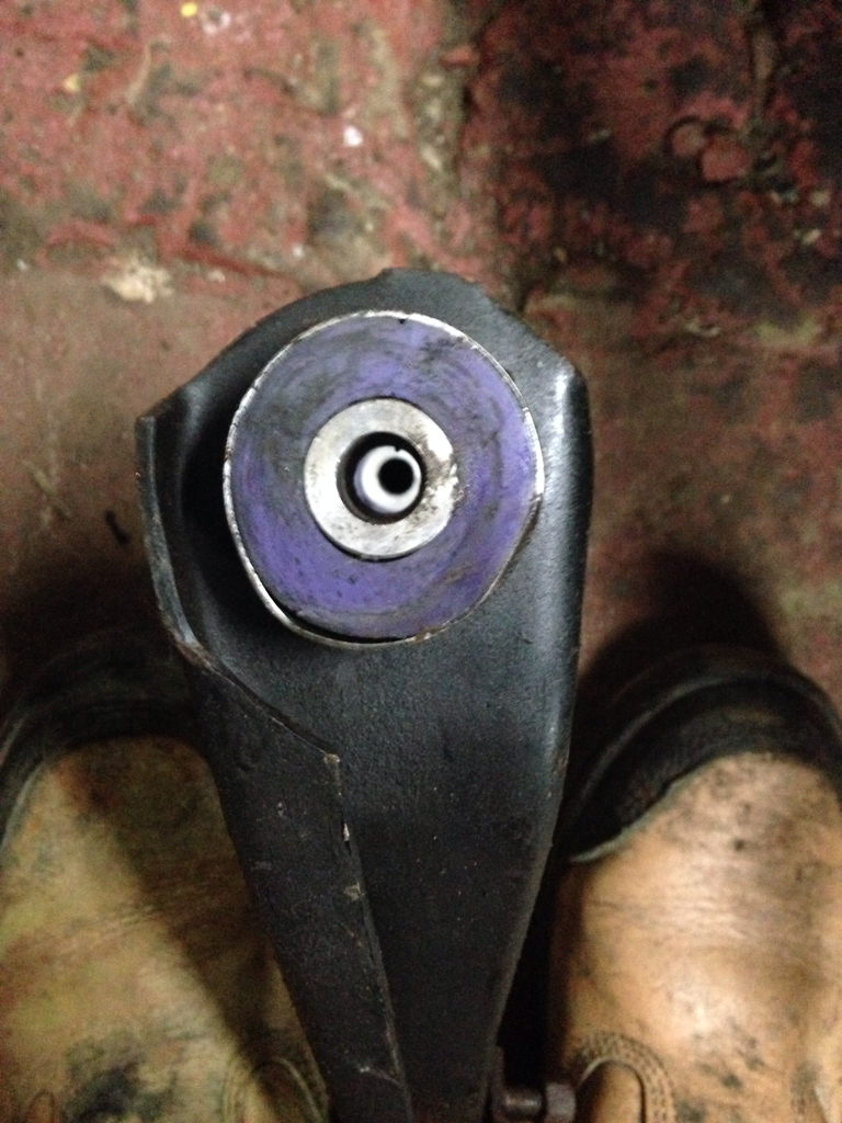

Well I got the wishbones off to find these
Standard procedure really so spoke to powerflex...
New black series! Will be fitted along with new ball joints, no longer taking new wishbones as there's no point really!

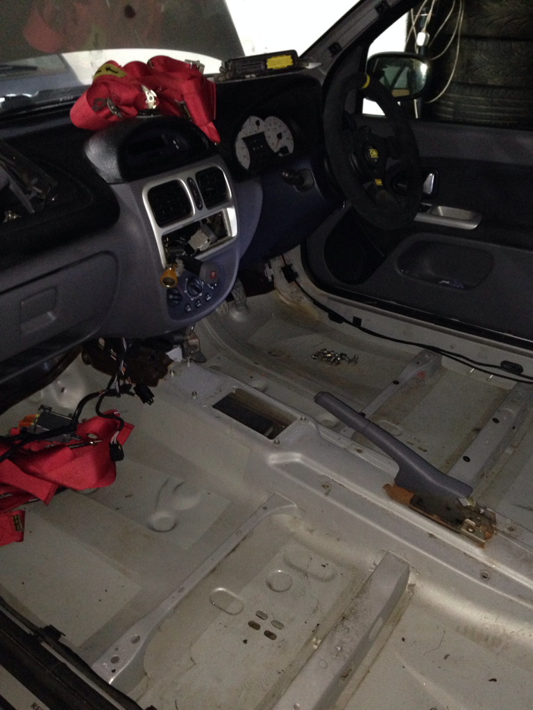

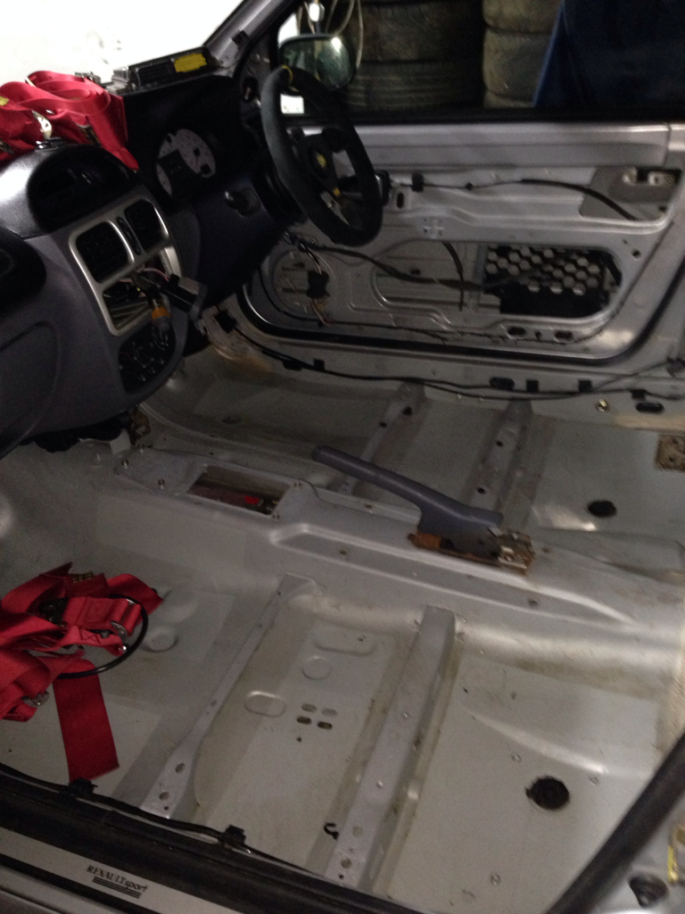

Also started stripping out the interior and removed that standard gear set up
Is that an offset metal insert in the bush? So camber is increased? Need to get some of them at some point as Clios are shocking for those bushes wearing.
What you planning for gearstick setup? Whats plans inside? Doorcards off i presume for cage, polycarb windows or that?
Nah they are the old design, and the new ones are just standard aswell, the camber adjustable ones are extortionate!
I have a pure motorsport kit there, want to get the cage in before I fit it though!
Ye I have flat door cards there, still to order Polycarbs but getting them too!
Aye after i wrote that i checked Powerflex website and seen the adjustable camber ones- £240!! Oft.
Metal insert inside yours looked like it was set for adding camber, but now i see it bigger on my laptop (was on Iphone), the hole that looked offset is just the hole from the other bush that you can see through the bush youve pictured.. Lol
