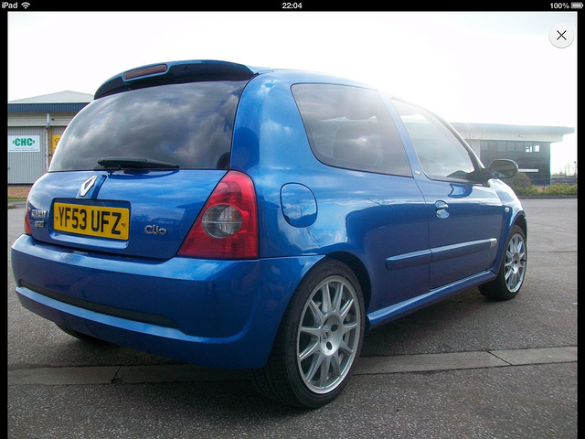

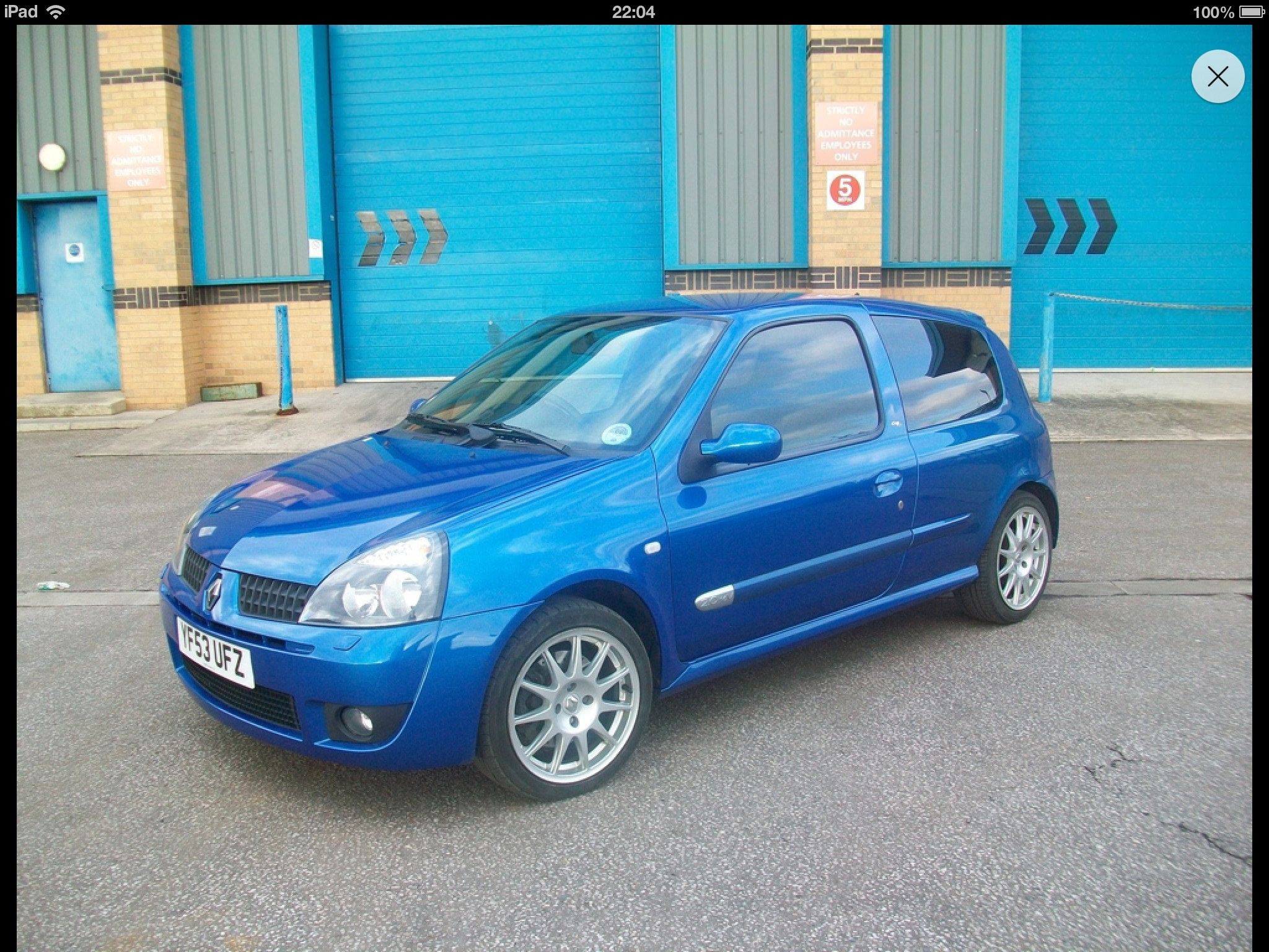

Hello,
Now that insurance has dropped a considerable amount, I can now afford to insure a 172 cup :), so left a deposit last week and went 180 miles to Sheffield to pick it up! It's a 53 plate on only 65,000 miles.
It needs a few things doing to it:
Cambelt is due in 5000 miles
wheels are in very bad shape so they're getting refurbed.
rear discs and pads need replacing
offside bottom ballpoint
de tint the back windows
door mouldings resprayed
These getting done on Thursday/Friday when I'm off work, I have already fitted some Eibach sportlines last night. Everything's standard apart from it has drilled and grooved front discs with red stuff pads and an Itg panel filter.
mods to come:
ktec induction kit
half leather interior
new steering wheel or refurb this one
ktec recessed exhaust
land maybe xenons.
have only got sellers pics and some crappy pics of mine.
Thanks for looking!

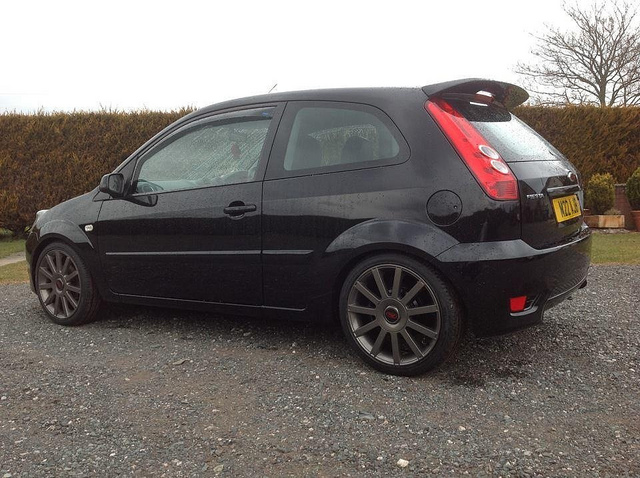

My other car

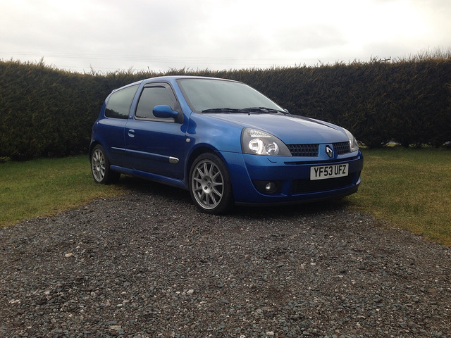

Standard
image by Blacky950, on Flickr

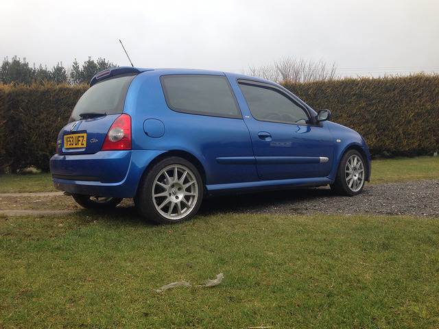

Sportlines fitted

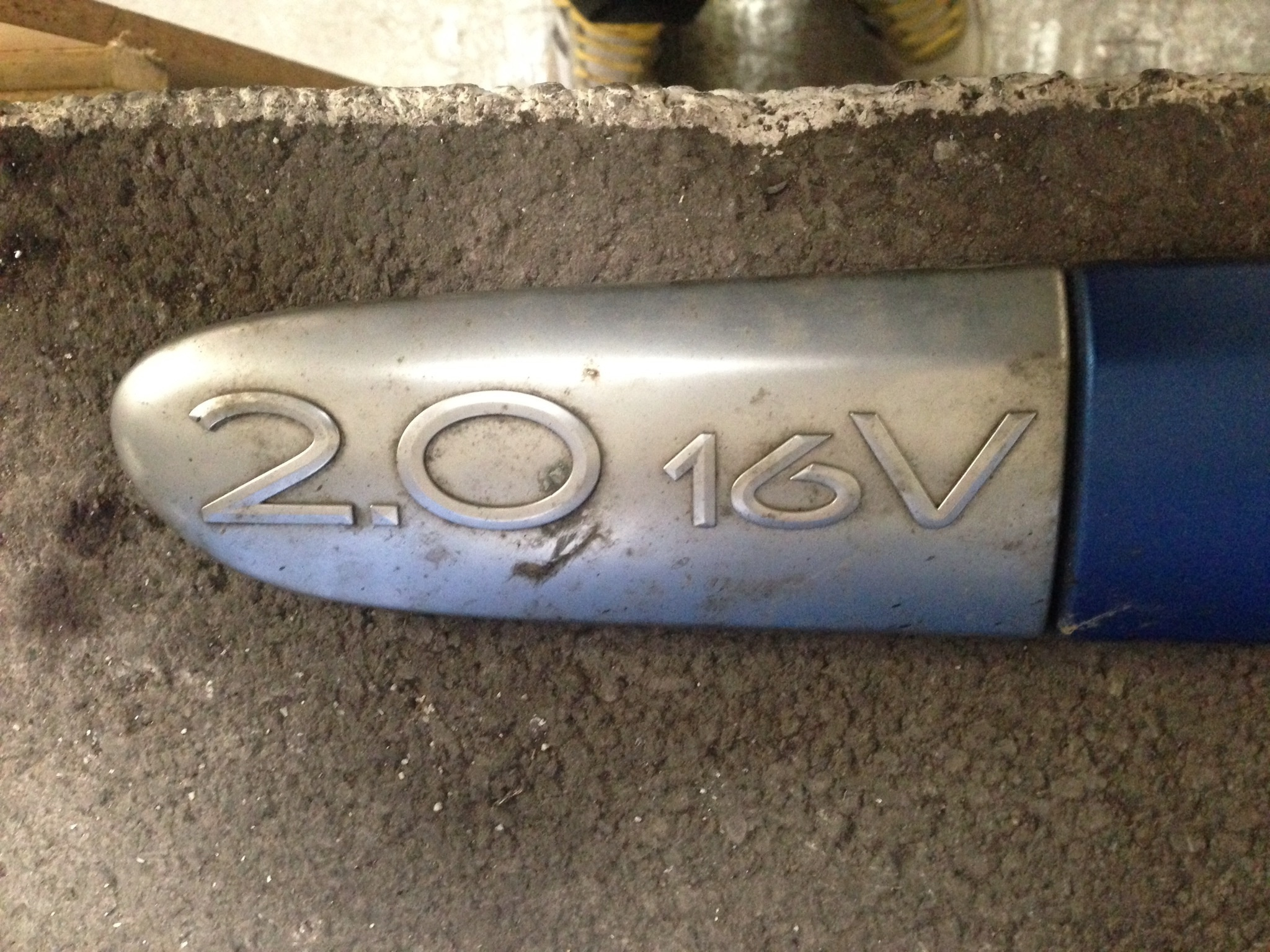

Badges before
After

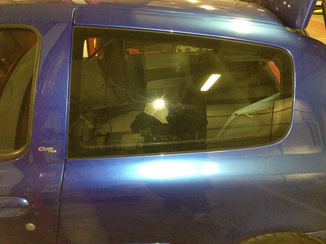

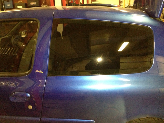

Tints before
After

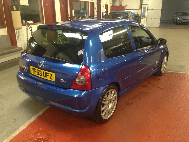

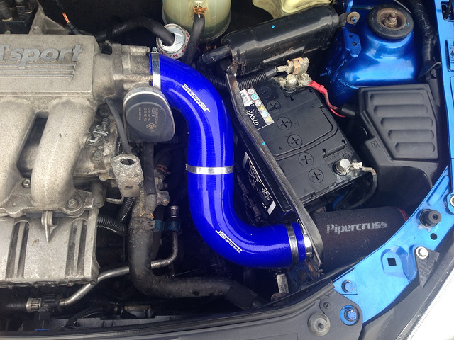

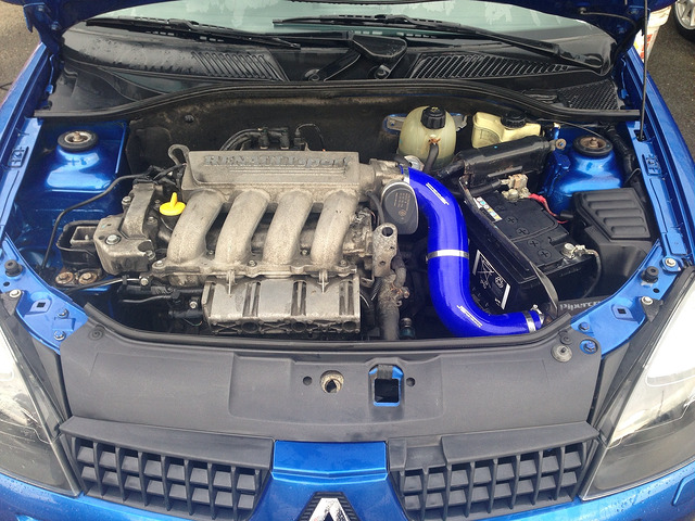

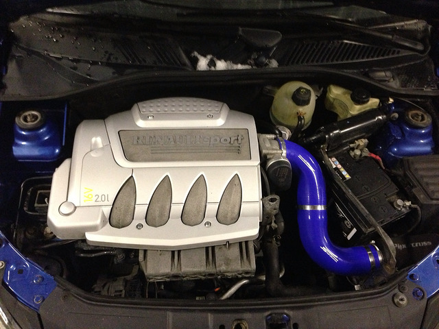

Bought all my parts to make my own 'ktec induction kit' so had it fitted this weekend with a quick clean of the bay, the sound is unreal :) inlets need polishing up so that's a job going to get done soon.
and the pikey catch tank for now

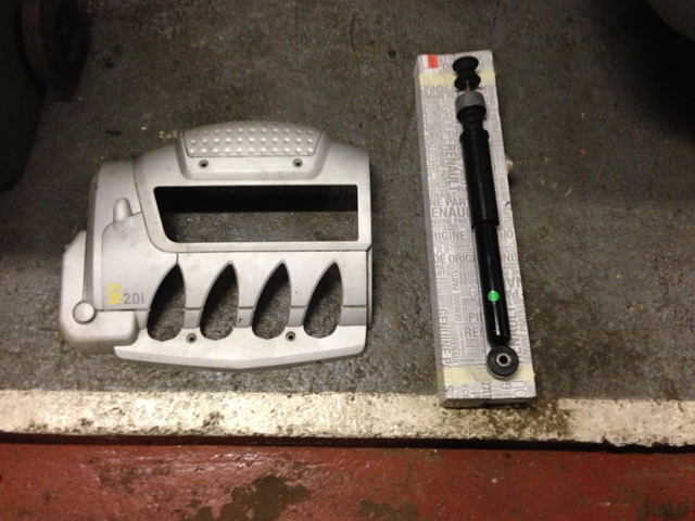

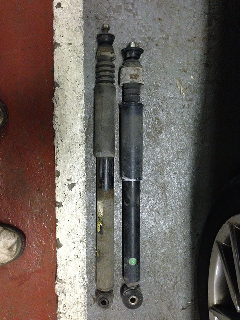

Bought some new genuine cup shocks and fitted them, found out one was a genuine fitted and one different one which was longer. Had also bought an engine cover which tides the bay up a lot more.

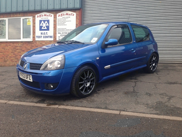

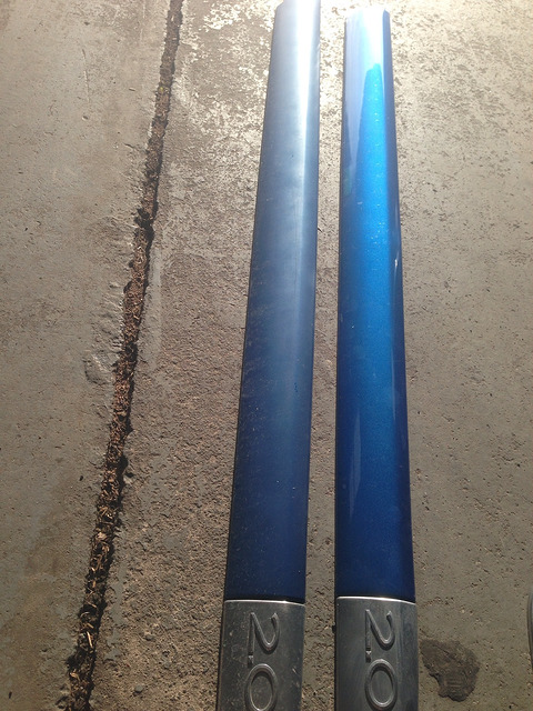

I bought some mondial blue side strips as well because my other front ones looked like they weren't lacquered.
The difference:

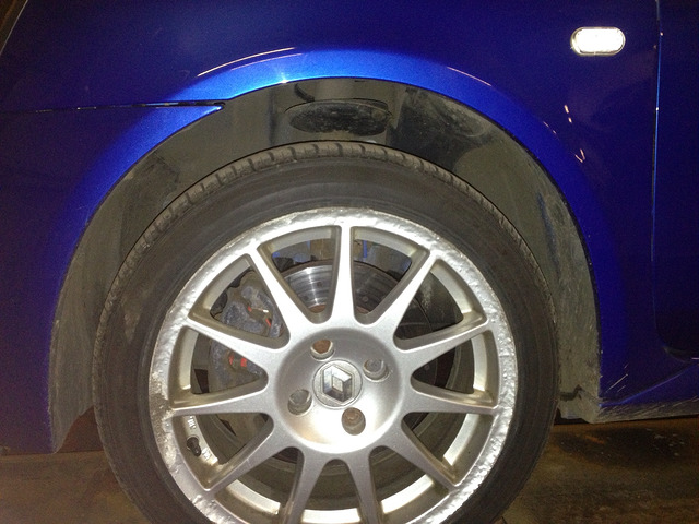

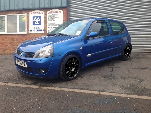

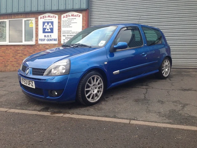

I will be getting my wheels refurbished soon and can't decided on colour so did a few photoshops.

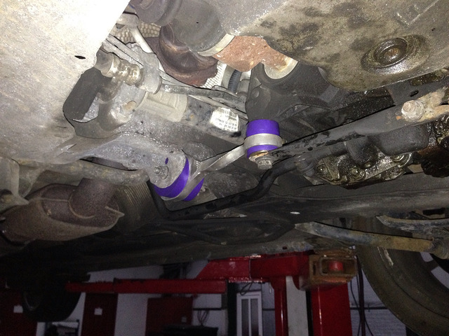

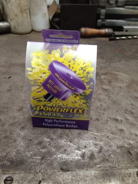

Noticed when changing gear sometimes I had a fairly loud knock turned out to be a worn dogbone mount, so ordered some powerflex bushes from Euro car parts for £31 +vat which I thought was a good price! Got them the next day too.
So got the old bushes knocked out and and gave it a good clean with a wire wheel and fitted. Got to say it has improved the gear changes loads and the engine doesn't jump around as much! Everybody says theres a lot more vibration inside the car but I can't really notice it tbh.

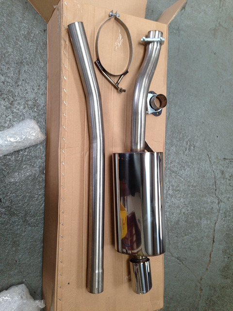

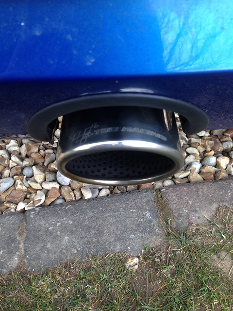

Had a day off work yesterday, and had this dropped out for me perfect timing! Ktec recessed supersport system.

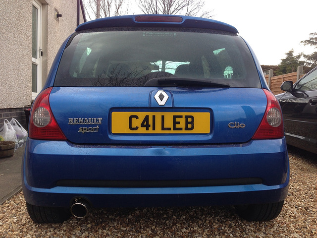

Got it fitted the same day, along with yellow daves powerflex exhaust mount fix as mine was bodged with the wrong shaped rubber mount.
Took a bit of cutting of the bumper to get the trim on should have had a Dremel but all sorted now! It's sitting a bit low in the pictures but did a bit of adjustment this morning and it sits perfect now :)
its an awesome exhaust a lot quieter than I was expecting but sounds good now thinking of decatting it too.
also had my private plate transferred from my old car yesterday with a 3/4 plate upfront and the added black inserts on the bumper too finish the front end off.

Have you got some links to the parts too for your filter setup and what you used on the bullets, I tried cleaning mine but they ain't looking too hot.
  172 Cup
Your car is getting there mate. Would you or are you selling the DCI? if so how much?
Thanks :) I've got it on ebay for sale I know it's not the best add in the world, looking for £1600 Ono.
http://www.ebay.co.uk/itm/Renault-C...4747181?pt=Automobiles_UK&hash=item4ac3559aad
Bought all from boostjunkies apart from the filter from regal Motorsport. Follow this guide mate from 106ben
http://www.cliosport.net/forum/show...induction-set-up/page2&highlight=Boostjunkies
