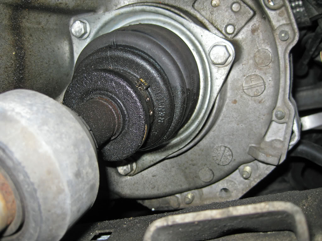

Are you sure they did all this stuff? The gearbox could be leaking oil a bit thus the levels are down over time, the other ball joint boot could have been damaged already and you didnt notice. I dont see how he could accidently pull out the driveshaft out of the gearbox as its held in with a ring clamp with 3 screws (and its a wun wheel ont he other side), he would have had to rip the gaitor on that boot to leak oil.
100% I only checked the gaitors this morning AND last night as I'm anal about it. If you pull the shaft out of the box, on the nearside it doesnt come all the way out due the big screwed on gaitor but can slide out of its seal on the small end enough for it to gush oil if the driveshaft is pointing down making the seal into a funnel for the oil - I know this as I did it myself about a month back. I know the gearbox was full as it hasnt been depositing oil and I filled it up, also probably about a month ago. The underside was clean this morning and now the under tray is oil soaked. Maybe I'm an anal b*****d but I knew of the ripped CV gaitor for a week and have been checking the underside pretty much every night for that week, no way was the car as oily as it is now as I went to town with brake cleaner last time wiping it all off
The inner gaitor stays in place and the shaft pulls out of it, doesn't take much to do that to be fair, not that it makes it acceptable.
ah right. these must be different to the ones I have seen before then. On the ones I replaced, the boot is attached with a ring clamp to a bearing on the shaft and as such cant move on the shaft. you can pull it as much as you like (upto a certain force) and it dosnt move possision on the shaft.
Exactly, its not much but when it pops out it makes a right old mess. Least they could have done is said it'll need some more gearbox oil, good job I didnt thrash the car on the way home and checked it asap
Its that clip, behind the rubber/plastic donut halfway along that shaft above. Shaft can pull out slightly and leak as that black donut and part of the shaft just sit inside the small end of the gaitor. I'd jubliee clipped it but obviously he still wrenched it out

No way he could of lost gearbox oil on the offside as you can take the shaft right off without losing the oil.
