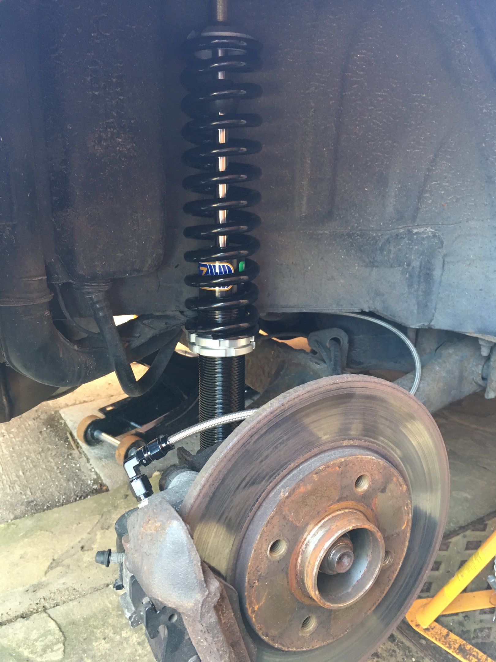

Thanks for the info. But they are not that low, probably the same as the eibach springs in before. I dont actually know how to adjust the height, its combined with preload but even if the springs are really loose it doesnt really lower it
img_0317-jpg.1363972
Undo the lower adjuster (locking ring). Then wind the upper ring up/down as much as you want. It will go down, just takes a while (1:1 ish installation ratio on the rear, and the rear corner weight on a clio is something like 140kg so you don’t get much pre-compression even on “softer” springs)

Thanks mate, Ill see how much it can be loosened. Ill have a check with the topmounts but pretty sure they are seated correctly
Will too much pre load make lower rebound settings all crashy or are they like that anyway? It seems like the first 10 clicks from soft up are useless. They are 300lb springs and are doing well on the road so far, just about to put the rear seats back in so that should help a bit, would at least like to soften them up sometimes though
Where are the helper springs that locate the springs at full drop?
@STEVE.M
They didnt come with any, I was under the impression they would. I went direct with gaz not through kam btw and was 275 all in all
I`d query that with them, that`s why your adjustment rings are high.
Kam supply them with the 300 lb springs, the same as yours and the helpers.
