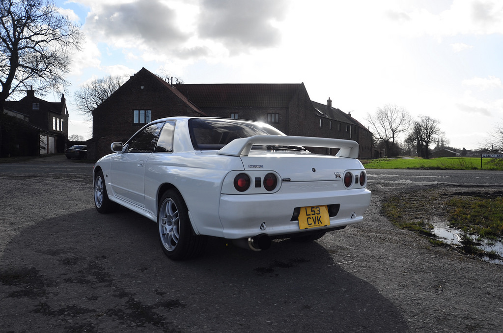

Really glad I washed it last night, because it has ended in this...

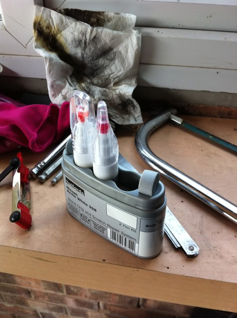

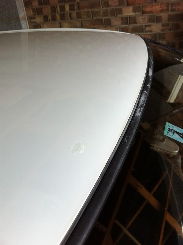

So pissed off, a huge stone chip right above the windscreen flaked paint off when washing it, plus I found a s**t tonne of little ones it had picked up. Barely done 600 miles on UK roads and it's getting ruined.
Don't really like the s**t job the kits give you either, but it's better than bare Japanese steel rusting away (which some had started to, thanks to the atmosphere it's parked in at work). Just hope I can wet flat & polish the stupidly thick brushed on paint to match the rest. Needs proper paint ideally, but there's so many individual bits chipping it turns into a full respray.

Use a cocktail stick and not a brush next time mate, will be easier to get it sanded down.
  S4 Avant
Round here all the roads are tar with stone laid onto it. It's utter w**k, such a s**te road surface.
They've just been round the whole of Derbyshire chipping the roads. Absolutely shite road surface.
you get 3 weeks of nothing but stone chips, and on the 4th week, it all starts to come back up again.
Started toying with idea of a bare metal respray in a more resilient form of paint that can chip without going straight to bare metal. Won't be cheap and changes plans for the car. However, I can't live with it chipping like a t**t every 5 metres down a road.

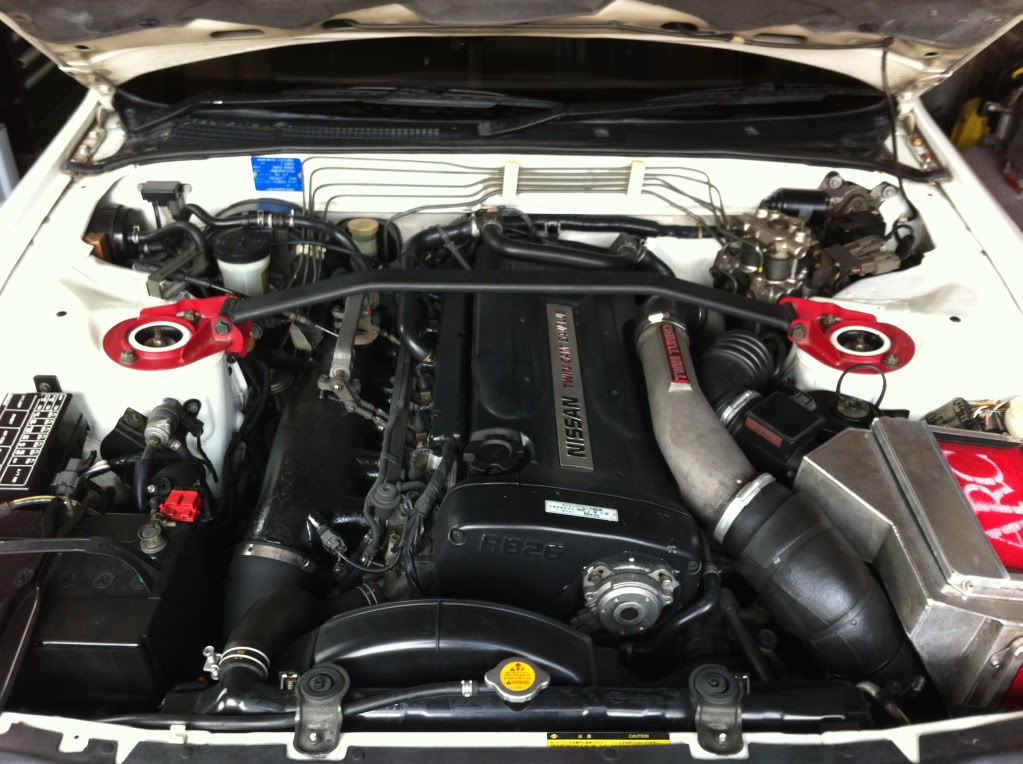

Picked up a front & rear Nismo strutbrace, only got the front fitted currently as I'm waiting on some cut out boot liners instead of chopping mine up.
I've never really been into strut braces, but these were rare, Nismo, and the front has the built in Brake master cylinder stopper that's always a bonus. The little flashes of red add to the engine badging/arc filters too, so it ties in nicely.

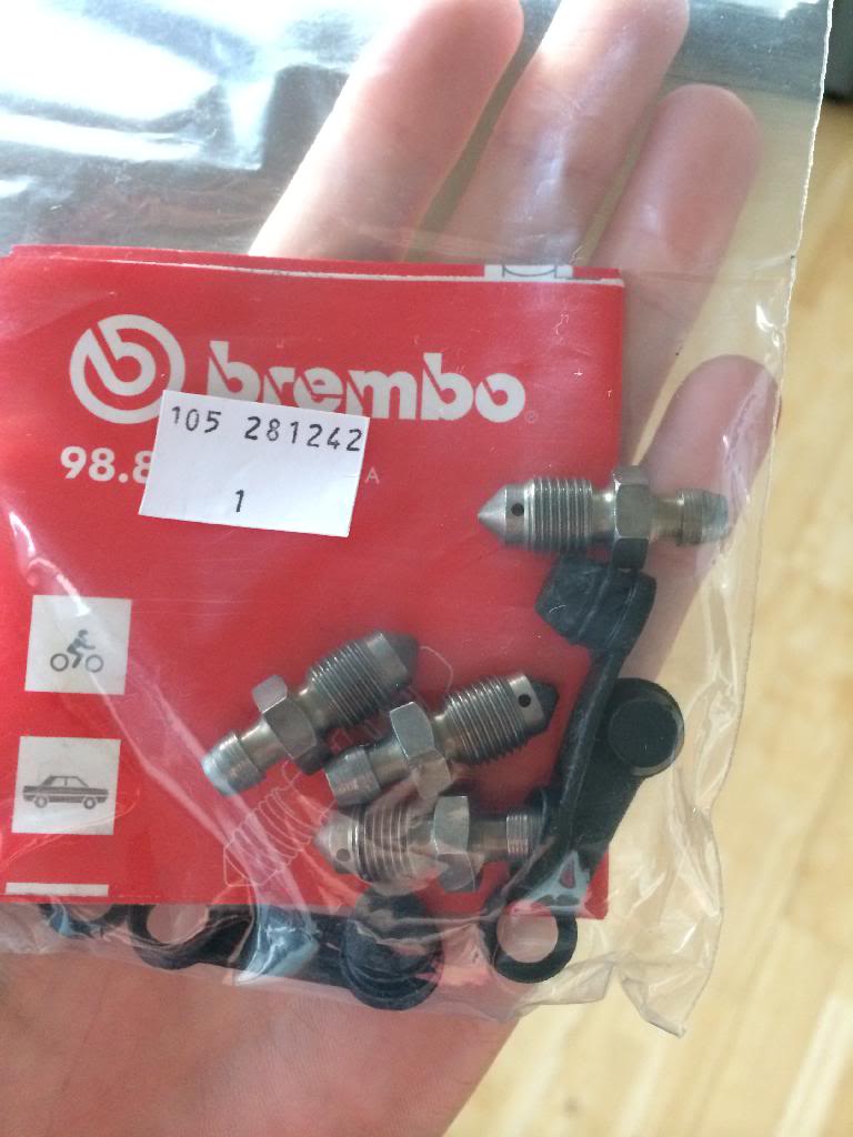

Tidy up R33 GTR Brembos (Just paint & stickers, No new seals, they were only done 2 years ago by my mate), along with new Brembo bleed nipples.

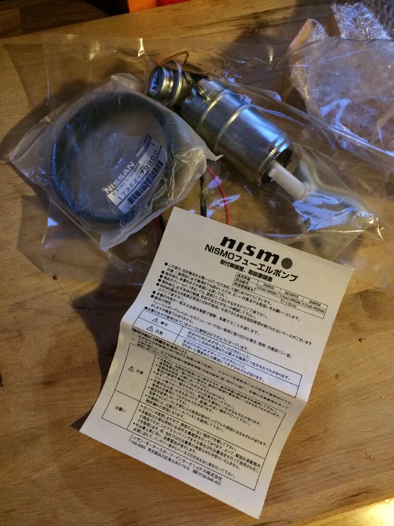

Fit Nismo 276L/H Fuel Pump.

The Nismo pump has arrived, might have to lose a but more fuel yet before fitting that (I'm at 1/4 a tank currently)...

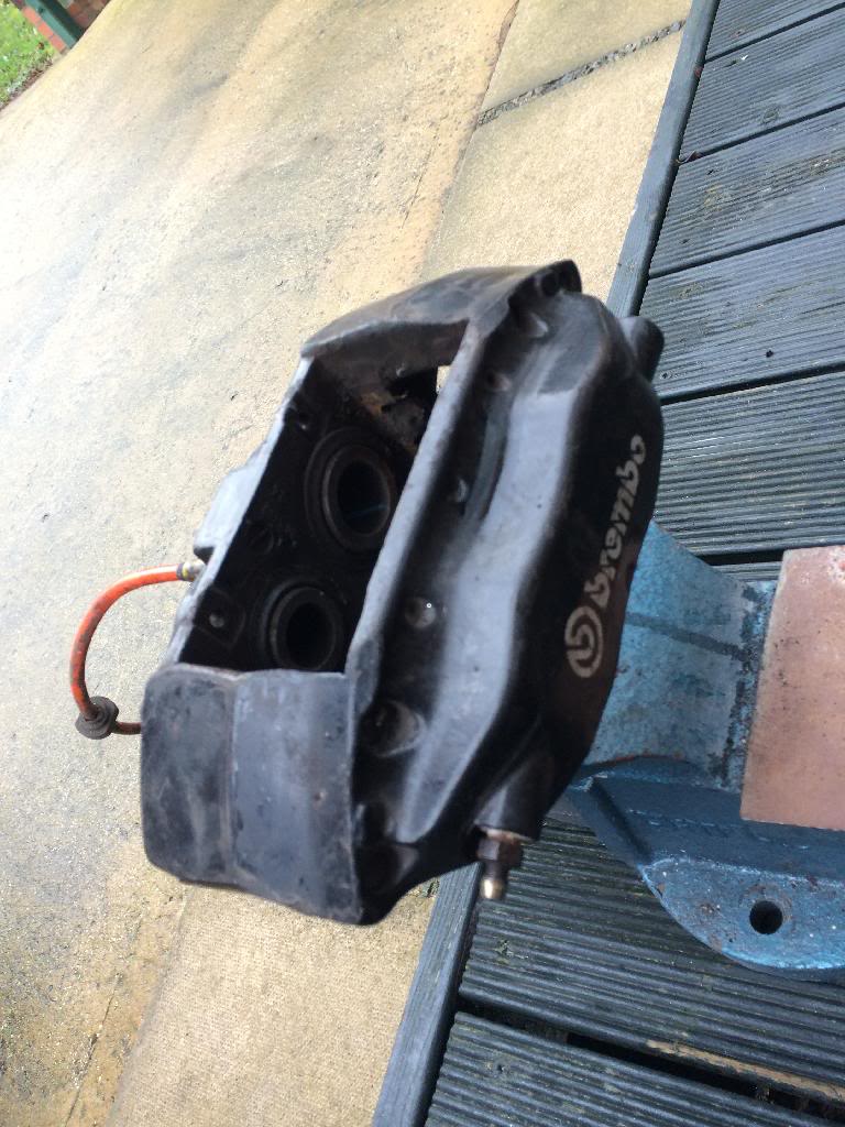

The R33 GTR Brembos are getting somewhere close to being ready for paint...

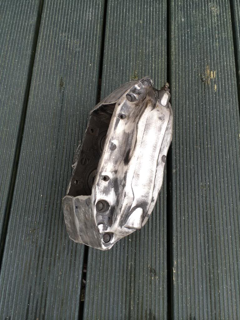

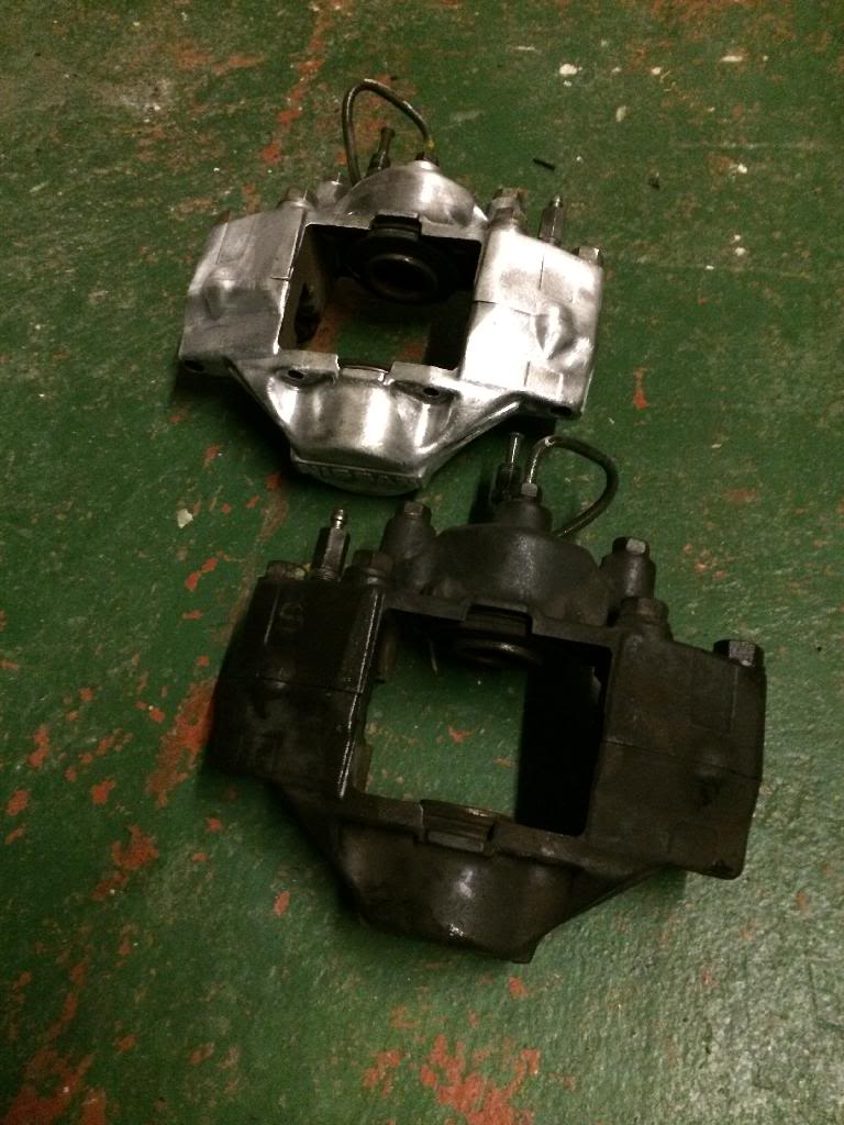

The front & rear OEM calipers are off and the master cylinder is drained. Started stripping the finish on the calipers but got rained off as I was doing it outside to avoid blasting s**te all over the car in the garage (will be moving work into the shed to carry these on!)

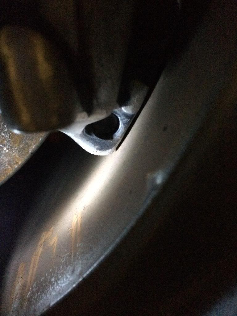

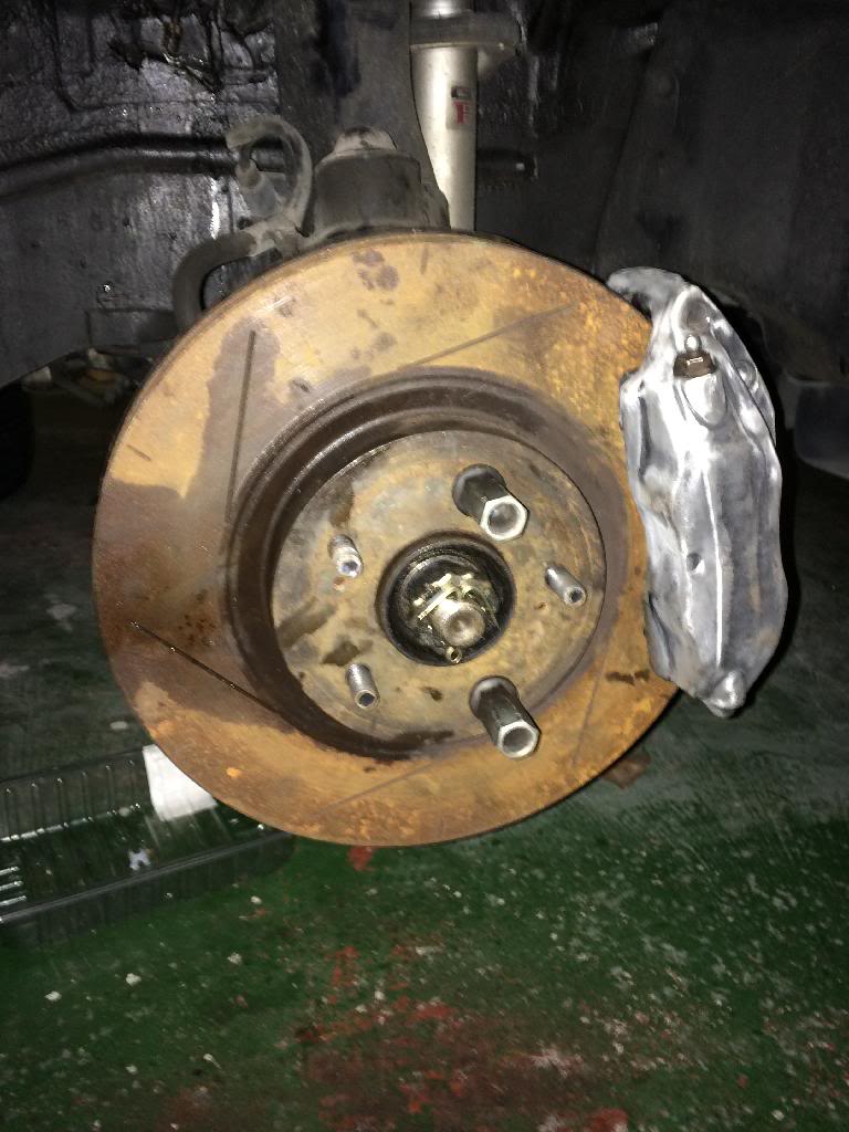

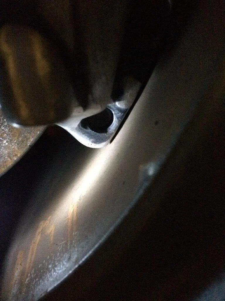

Anyway, I had myself a trial build up of the front brakes...

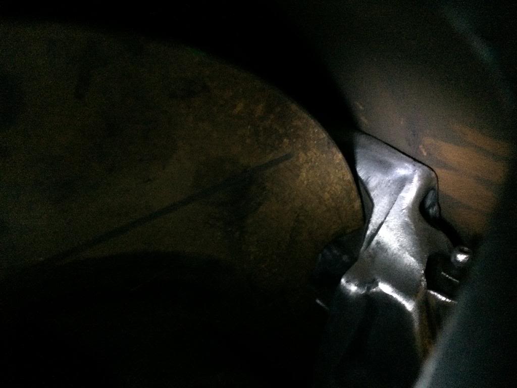

Stuck the wheel on and this happened! Turns out after a bit of googling that they still catch with 20mm spacers. I've sourced some R33 GTR wheels that I'm waiting on, with some tyres that'll suffice for the trackday albeit aren't anything special.

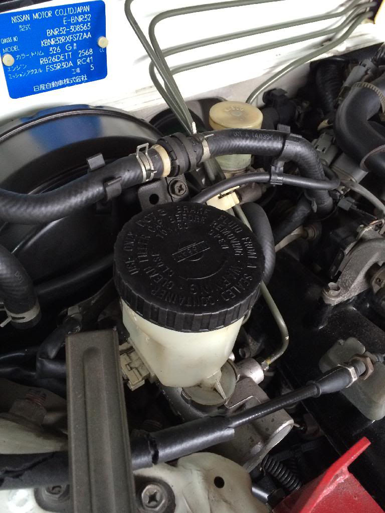

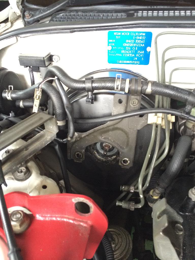

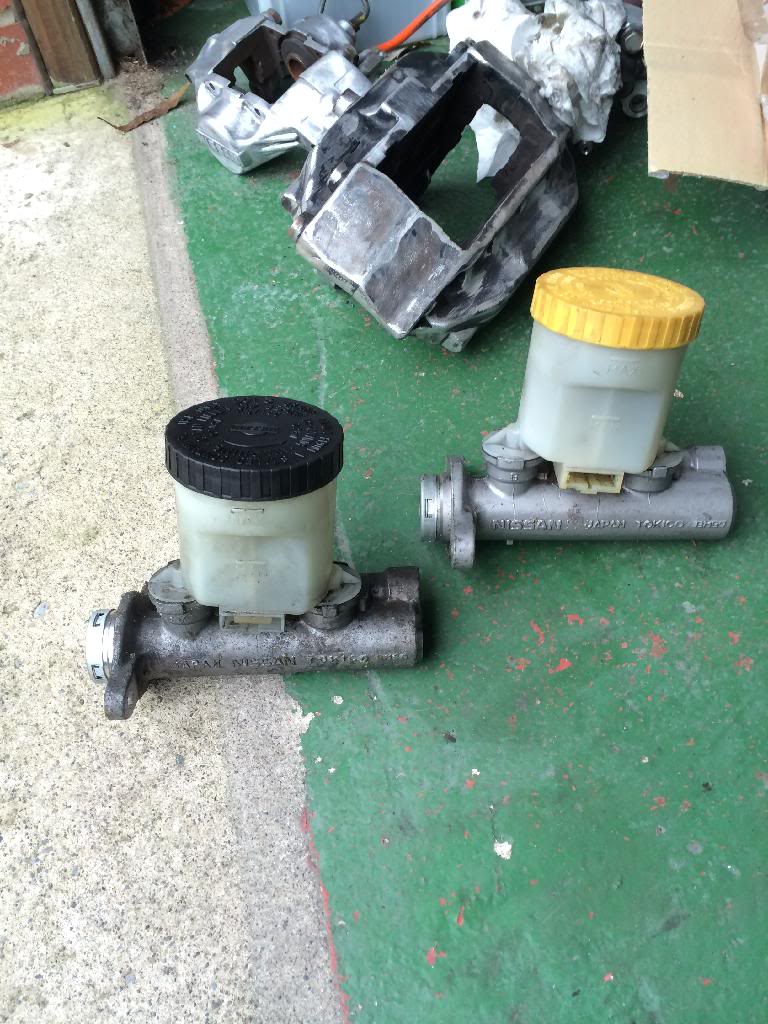

Master cylinder took a bit of effort to remove, the furthest rear of the 2 unions being madly tight that a union spanner was just destroying it. I had a solution for that in the form of mole grips!
Old on left vs new on the right. New one is a deja vu moment for me, having previously fitted a BM57 (Z32 300ZX TT) to the old 200SX S14A!
And the new one fitted, stuck the cap from the old one on as the yellow stands out like a sore prick, and we don't want that!

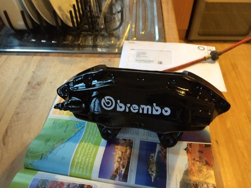

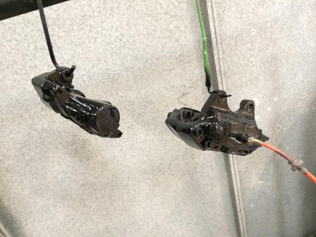

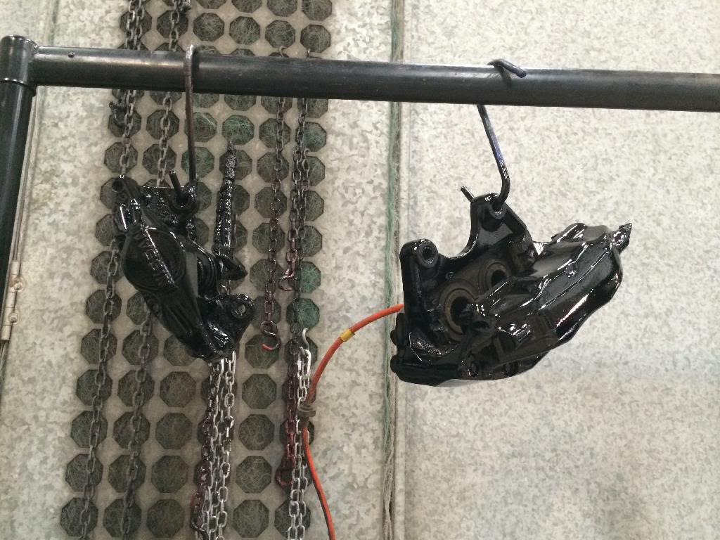

So Friday, I got over to Leeds and got the calipers painted with a Glossy VHT 2 Pack paint I got from a company called Brake-Caliper-Painting.com, which came out really nicely when sprayed.
Left them 24 hours, then fitted the Brembo decals to the fronts.

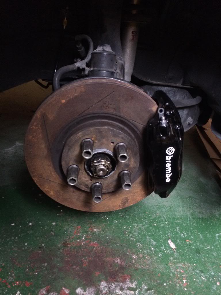

This morning I had a chance to fit it all up. New Brembo bleed nipples for the front calipers were fitted, and then I built up the front brakes (the discs aren't fitted "wrong", it doesnt matter which way those grooves go as the internal structure of the rotor isn't curved.)
Fronts all built up, Discs, Pads, Brake Lines.

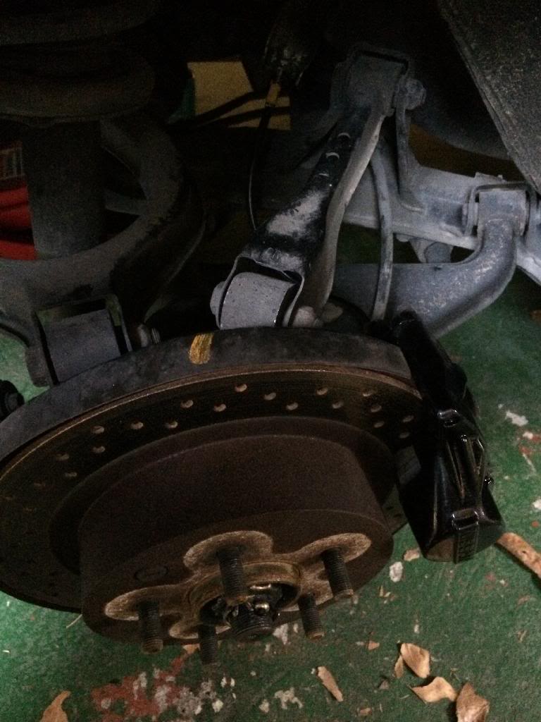

I was planning to fully refurbish the rears (all new seals). However, the grease & piston looked so fresh when I removed the dust seals I decided just to leave them alone and fit the new dust seals instead. I can push the pistons in by hand so it's not like they're stiff! So they're back on and built up with new braided lines too.

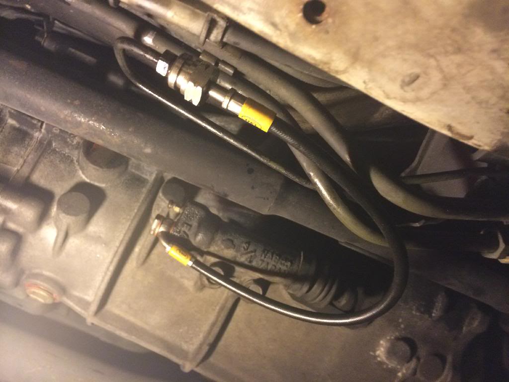

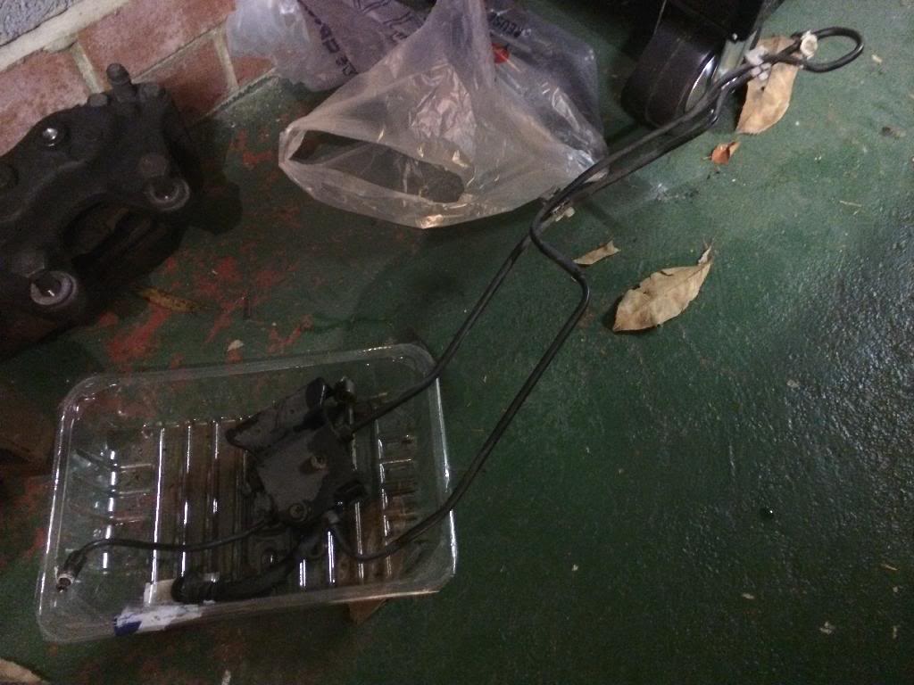

Clutch Line is on, removes the damper loop...

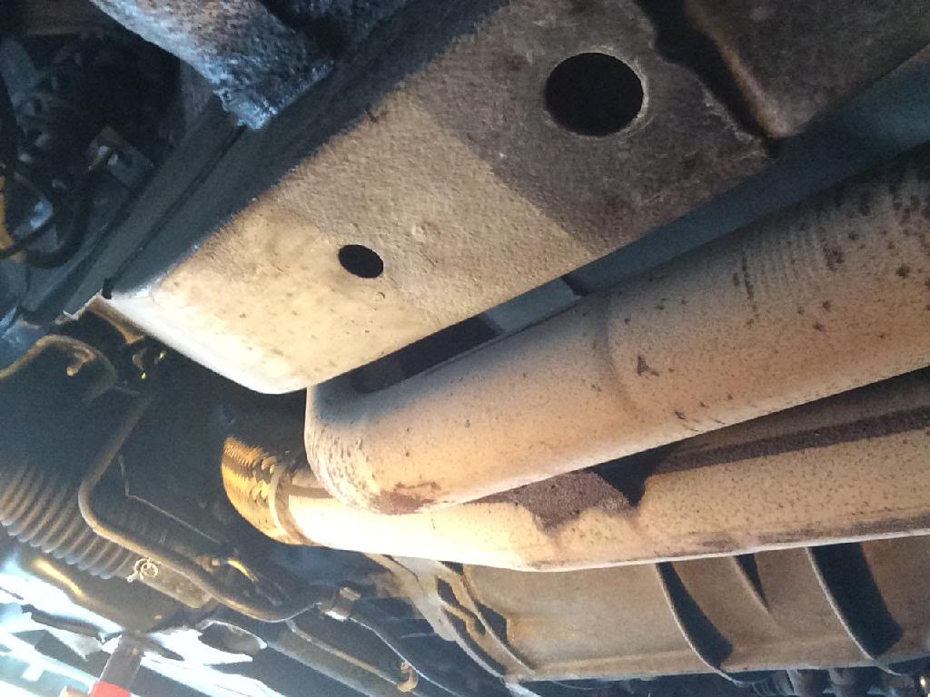

Whilst under there I was looking at the downpipe, didn't appear to be standard. Asked on GTROC and found out it's an old school TRUST downpipe, sweet!
