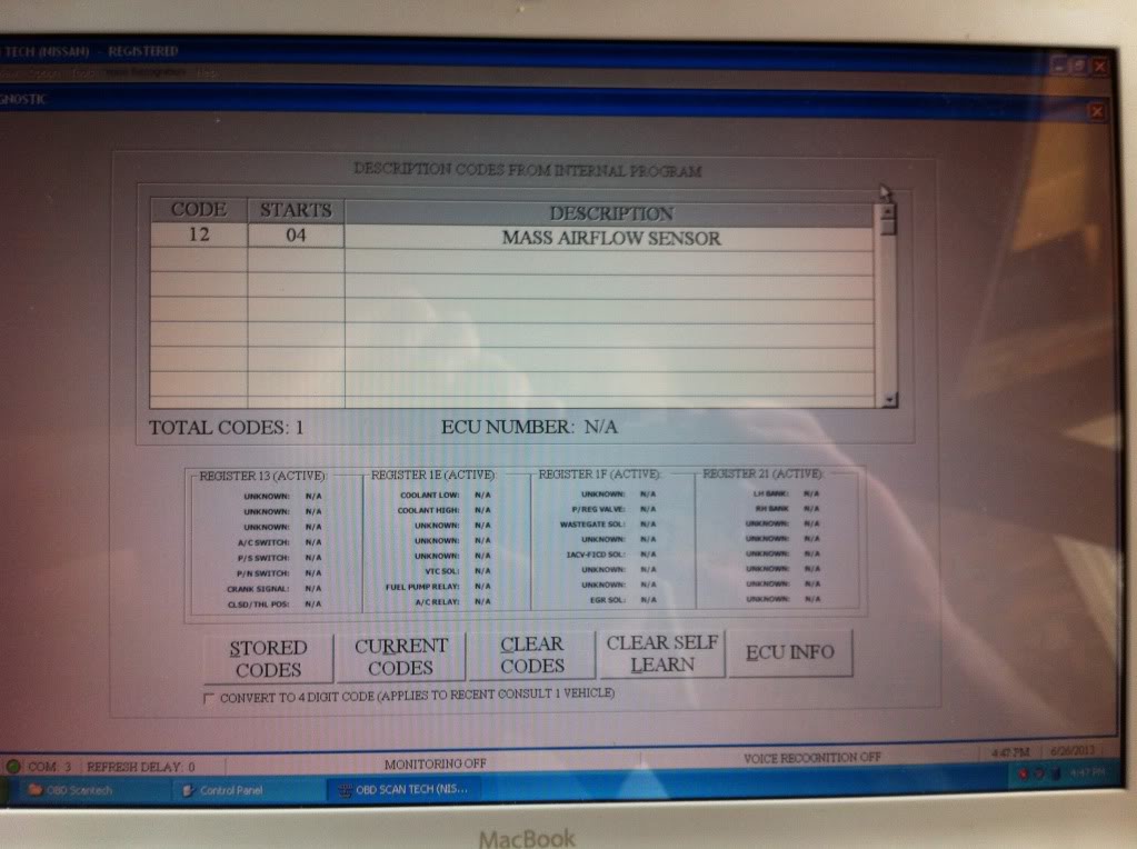

Those of you who know me, will know I'm having issues with an intermittent fault. Got a consult cable through today, and after about 4 hours of finding a program that would work on my mac through parallels, then making the computer talk to the ECU, I got this...
Could do with borrowing 2 working MAFs now, see if it fixes anything.

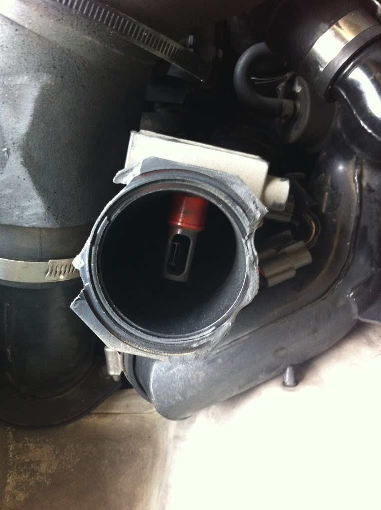

The plan today was simple, take the MAFs off, see how clean they are, take lids off and see if the circuit board solder had dried out, attempt to resolder. I kind of made everything worse. Due to the design of the ARC induction box, one MAF isn't accessible without ripping lots of stuff out of it. So, I decided to unbolt the box instead, loosen the hose clamp right off, unclip it, and it should slide out.
How wrong was I? Well, I took the ARC to the face, and left the MAF behind in the hose...
Looks like I need at least 1 MAF now, and no doubt I'll kill the other one trying to resolder it, such is my lack of talent in that department. All I can do is laugh.

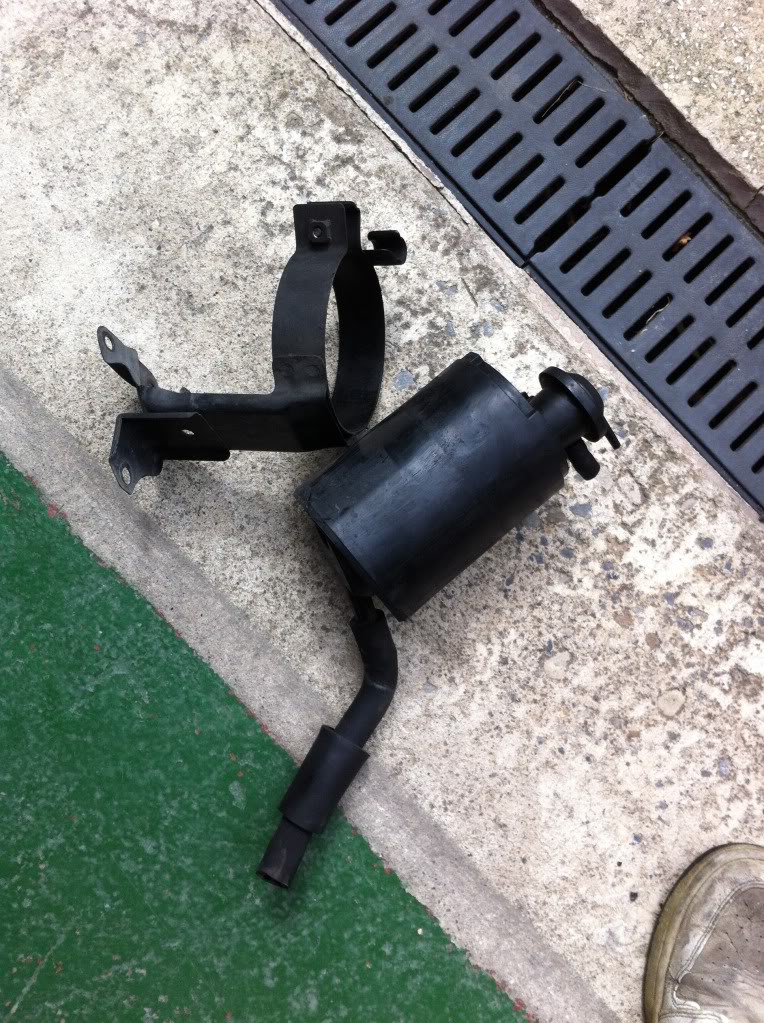

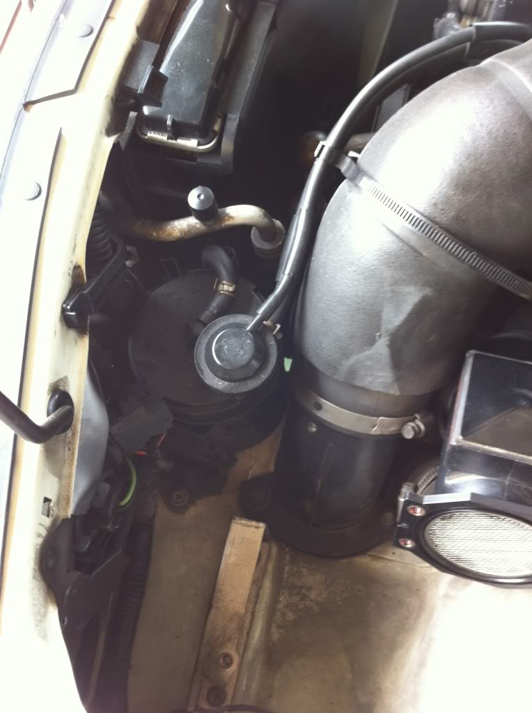

In the mean time, I'd had the ARC box out to do the MAFs, so I decided to ditch the carbon canister...

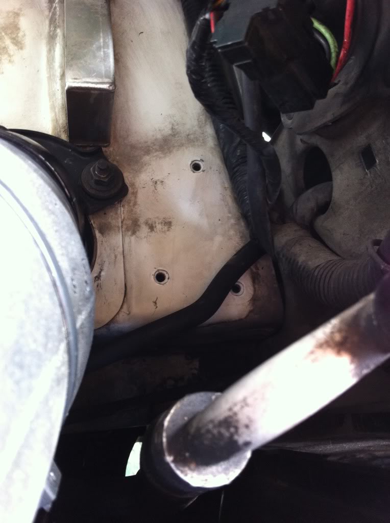

And ran the fuel tank vent down to the front arch...

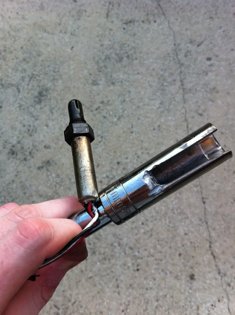

Far better. Rebuilt the MAFs/ARC (along with new front filter in the ARC), then set about removing the old O2 sensors. Now, must are an M18 thread (22mm socket). Not these, they're M12. So I manufactured a lambda socket out of a 17mm deep hex. It needed deepening after this photo as it damaged wiring, but that only mattered for the new ones...

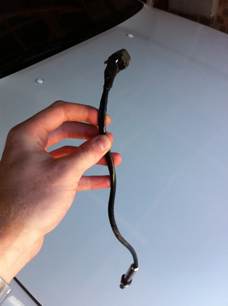

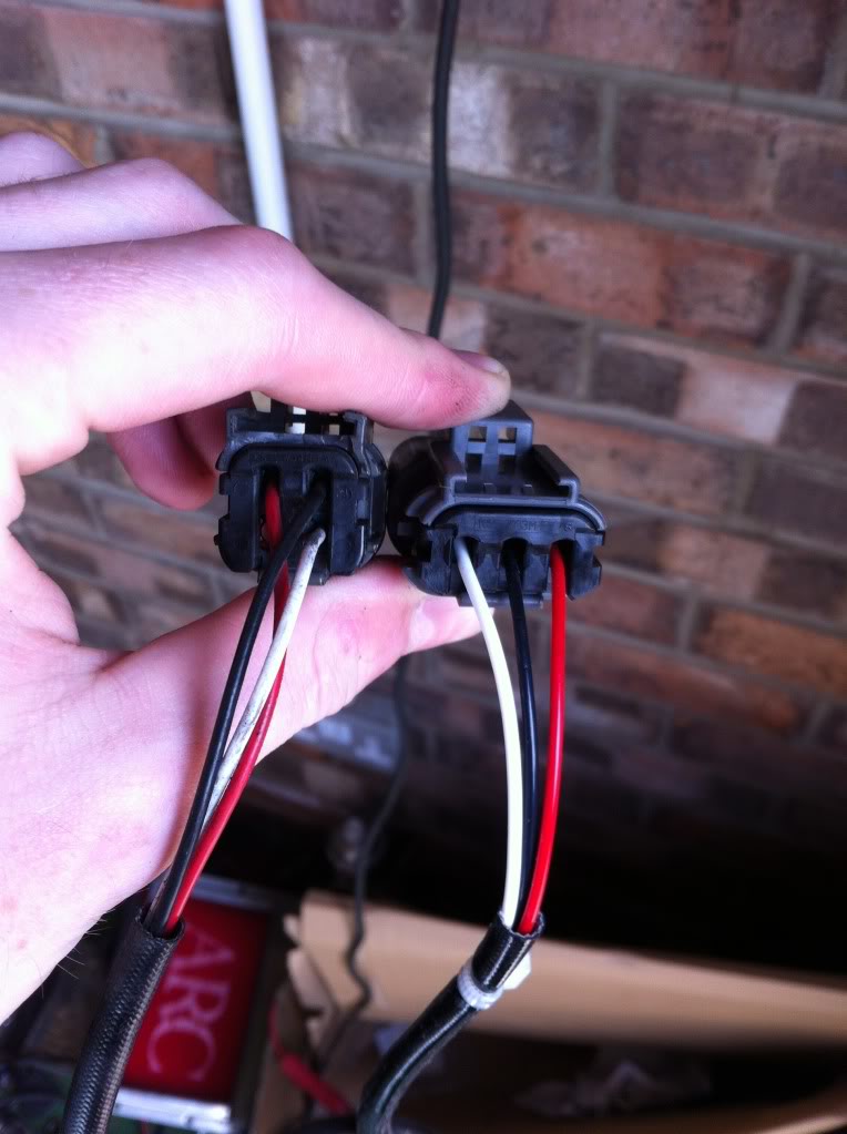

Then yesterday the replacements arrived, and I tried to solder the old front sensor's plug to the new rear sensor replacing it...
Only then I discovered solder doesn't stick as it's high temp wire! So today I've had to go buy a crimping tool & crimps. Wired it all up, fitted both sensors, and now it seems fine!

Is there any benefit of ditching the carbon canister?
More Space. Less Weight. It's ugly. It's only for emissions.
