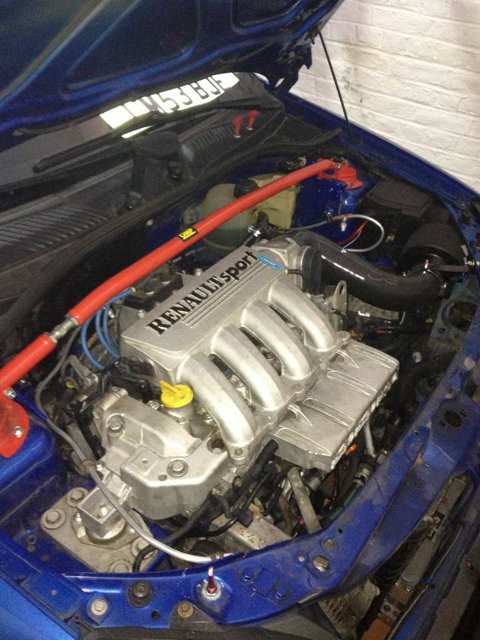

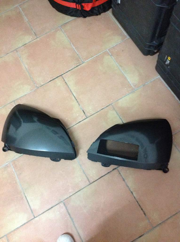

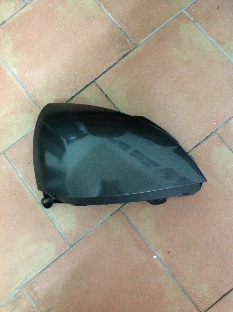

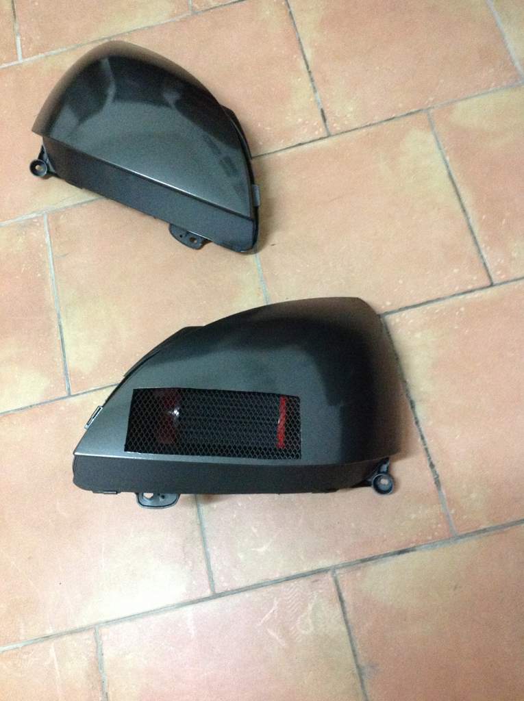

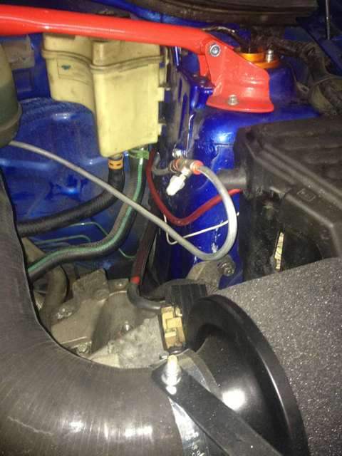

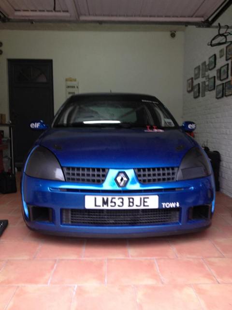

Well the headlight blanks are now done, I had to change my plan as I could not get the duct I had to fit so now I have used the original headlight insert to guide the air to my ktr induction kit.
The edges are not as straight as I wanted but everything I tried to fix it the hole became bigger but the same so I decided to stop before I ran out of headlight lol, hopefully when fitted it won't be as notice able.
Here a couple of pics and one with a old induction filter behind to show how I want it on the car.

Looking spot on there Gaz, I like the cup racer style blanks. So do you swap the blanks over with the original lights when you drive to the circuit or is it a trailer job?

Cheers fella's

Sonny for now I will swap them over but Cindy is doing her towing test on the 15th so hopefully will be using a trailer soon. Still not got the car back as Sanj has been having a few problems at the garage, hopefully the 9th now.

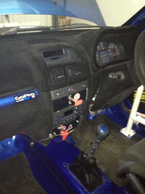

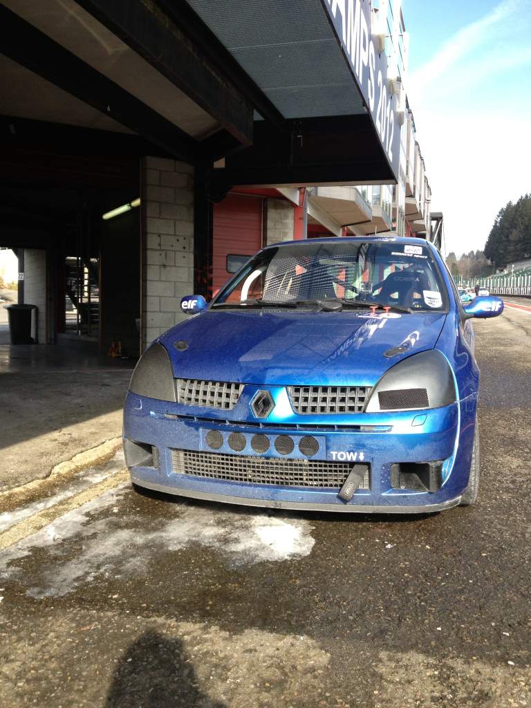

So got my car back a couple of weeks ago from the garage and been really busy getting it ready for spa at the weekend here are a few pics of what's been done sorry for the quality but to busy to get the camera out.
As for the diff and gearbox rebuild the car drives great now and feels unbelievable in the corners.

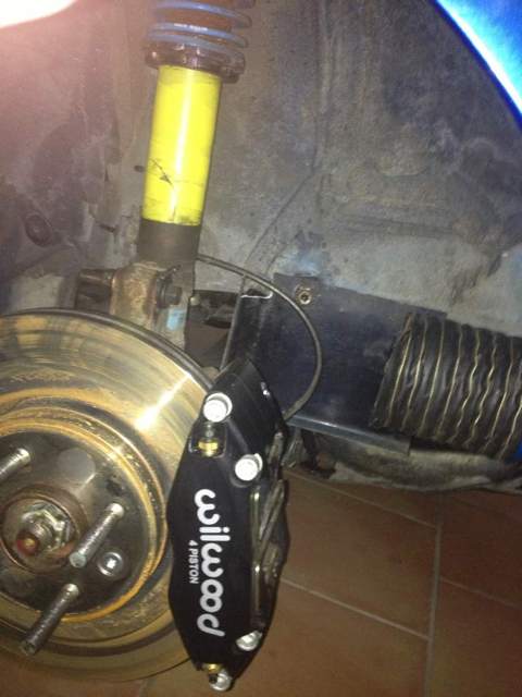

Wilwoods fitted

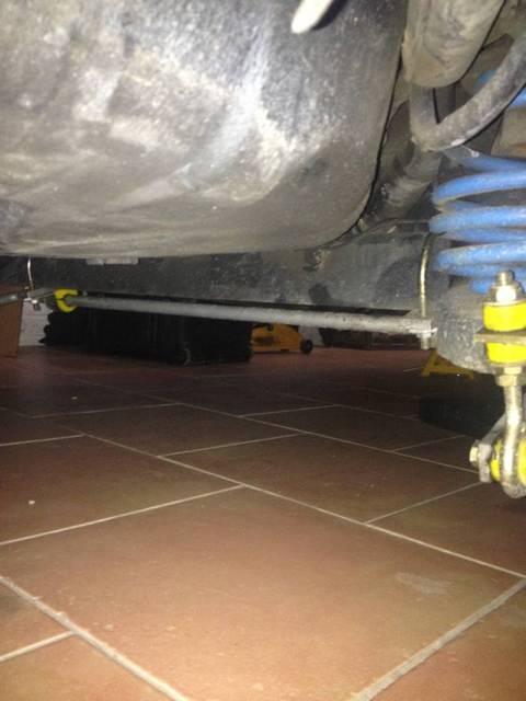

Whiteline arb

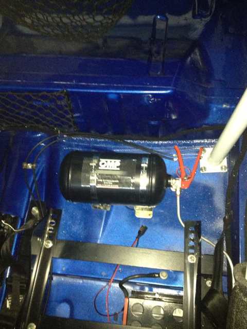

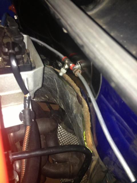

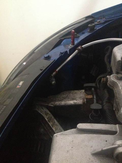

Fire system done

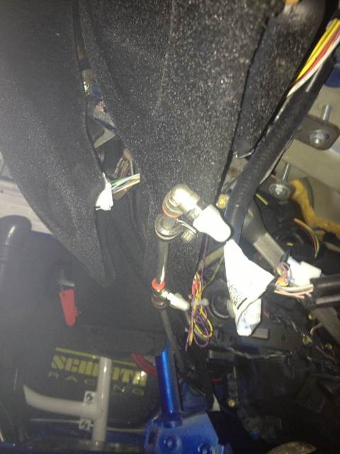

Electric kill switch and fire pull

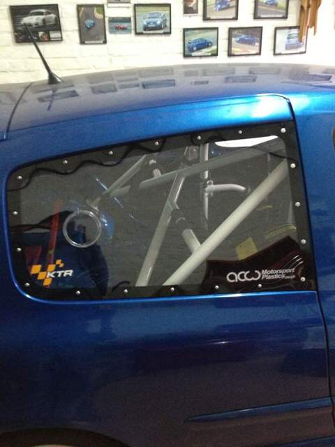

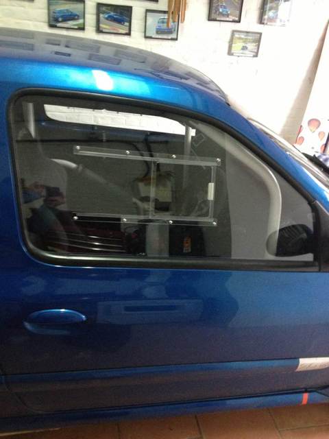

Lexan windows fitted

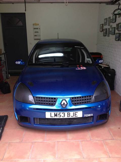

Headlight blanks test fit

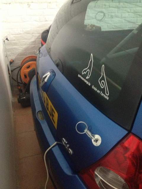

Boot catches fitted and locking mech removed
Done a lot of other little things but no real time to take detail pics, once I'm at spa I will try.

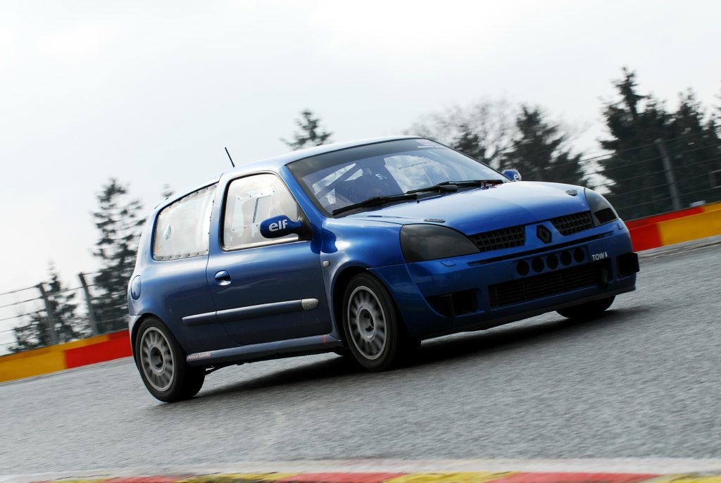

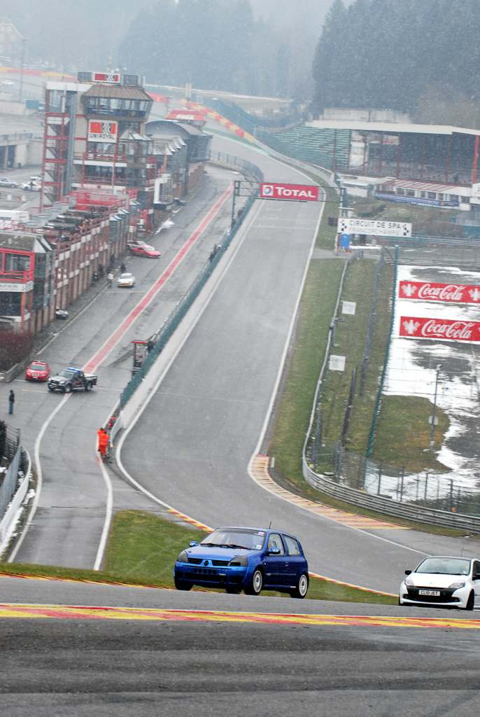

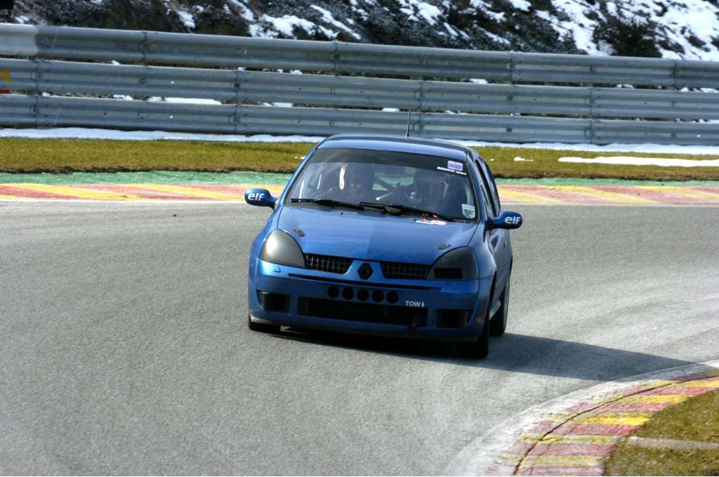

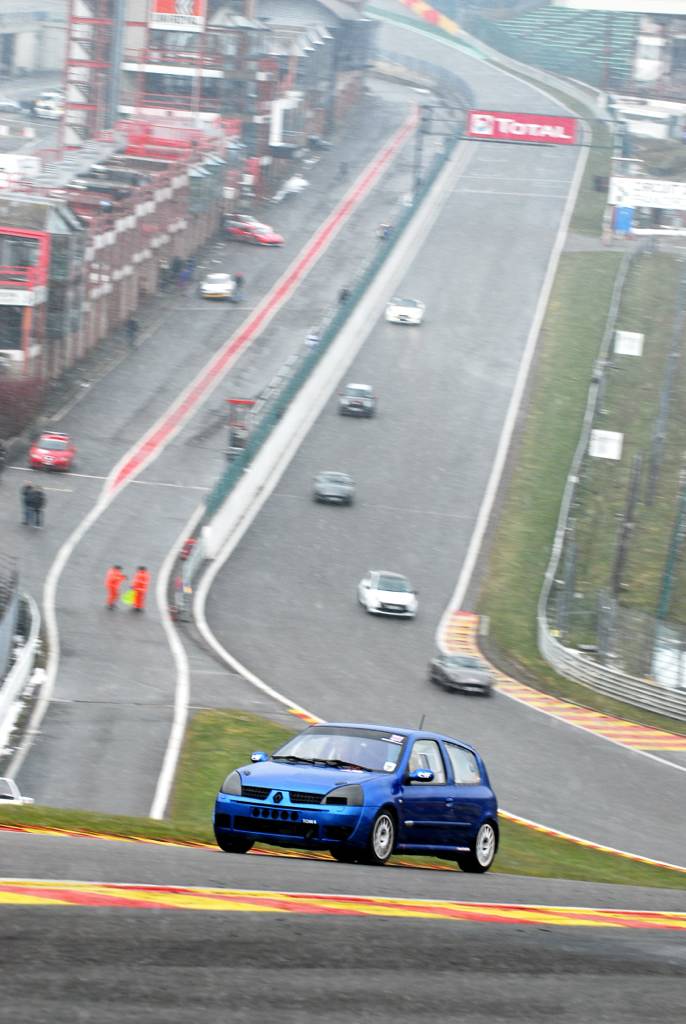

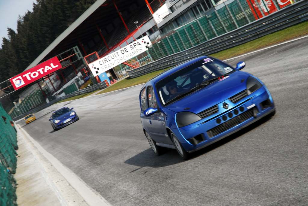

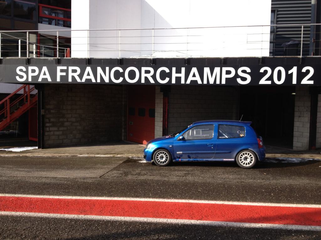

We got back from Spa yesterday and had a great time even though the first day we only got an afternoon session due to snow.
The car performed brilliantly and I'm so impressed with both the diff and the wilwoods. There are some new issues I would like to sort now before I take it on the track but nothing serious.
Also both me and the missis took a lot of lessons with an instructor and at one point he said she was faster than me lol as I had been making a lot of mistakes regarding lines but by the end of the two days he commented on the fact I had gone from an occasional track day driver standard to novice racer and that I most of given myself a good talking too after finding out the missis was faster hahahah
I didn't get any great in car vids as the gopro was eating the battery (maybe because the wifi was on). But here are some pics:

Car looks ace in the pics, yours is pretty much exactly how mine will look when finished.
Do you find the brake ducting fouls the wheels?

Swede: the ducts done cause me any problems with the wheels but the pipework did so had the remove them at spa, I will be looking into how to do it soon.

Hahaha glad you all like.
Northloop it's a great circuit, I am starting to enjoy it more than the ring now to be honest.
Agree amazing pics esp the 3rd one down.
