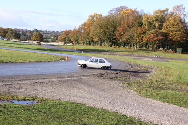

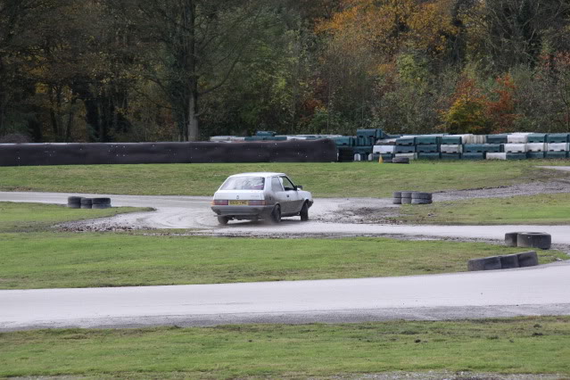

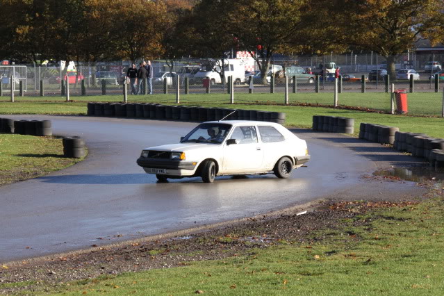

Back in November I went to my first drift day at Oulton Park. It was a properly sorted day, there were instructors on hand to help you improve throughout the day and the tracks were really good fun.
The car proved itself pretty well, to say the radiator still had a small leak it only overheated a couple of times the whole day, and nothing else went wrong :)
At the start of the day, one of the instructors drove it round the track and LOVED it! Honestly he had nothing but praise for it haha, and needless to say he set the bar pretty high after he effortlessly linked the whole track in a car he had never driven before :S

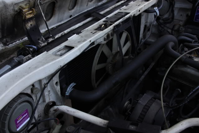

About mid January I got sick of always worrying about my bodged radiator and finally replaced it.
Shitt picture but hey, everyones seen a radiator before.

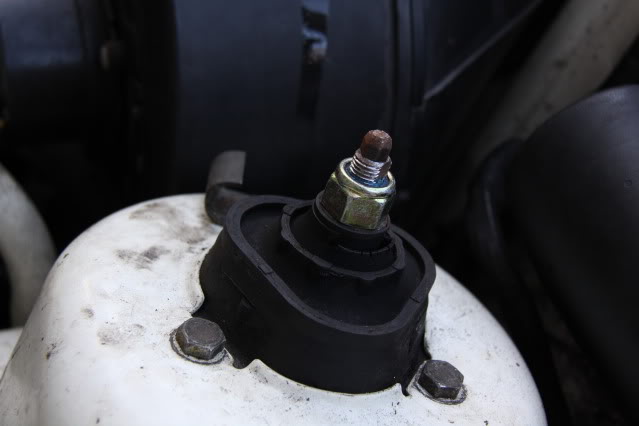

I decided to get my arse in gear and fit my front dampers that I bought back in October 2010. Relatively easy job as they were just inserts for the existing strut, so got that done and adjusted them to a pretty soft setting, and boy are they stiff! You can literally feel every bump in the road now :) Just how I wanted it!
Sorry but no pictures of me doing it as my camera battery was dead and couldn't really be bothered, but one s**t picture of the adjuster nut at the top lol.

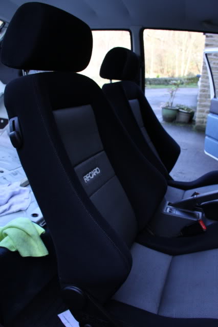

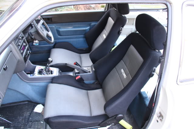

The day after I was browsing Pistonheads and found some Recaros that were local and cheap. Went to look at them and bought them for a £100 :)
I was grinning from ear to ear and couldn't wait to fit them!
I used the existing seat rails and just re-drilled some holes as mounting points and that was it. I was expecting it to be a proper faff, but I managed to do it in 3 hours before work :approve:
I'm over the moon with them, I think they look great and they are so comfy and supportive compared to the old armchairs I had before :cool:

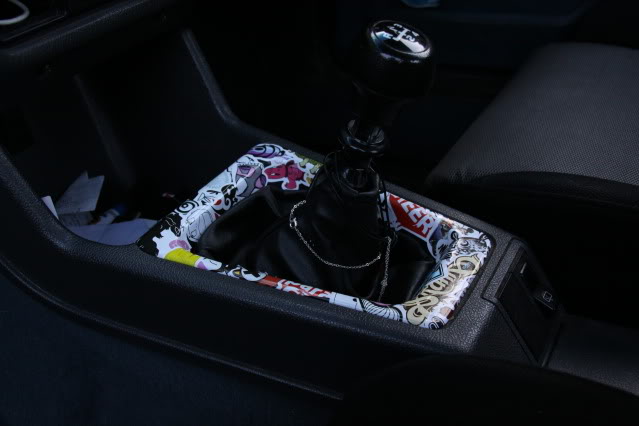

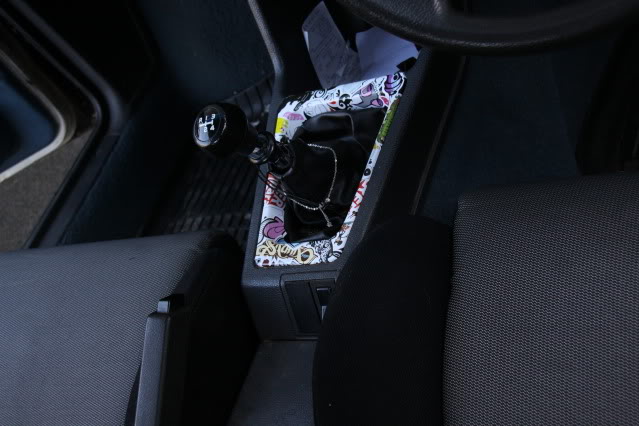

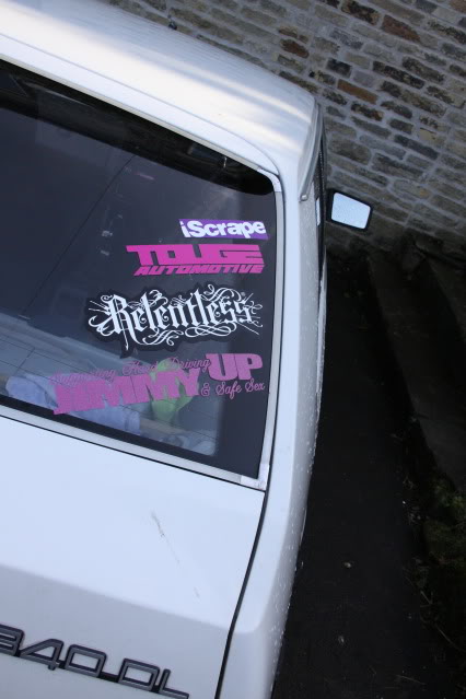

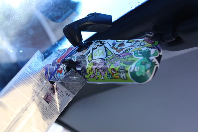

And finally... I've caught the stickerbomb bug :o
Im not going to go over the top don't worry, I just wanted to brighten things up a bit in the interior.

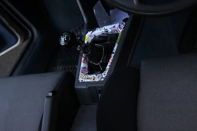

Gear stick surround...
Rearview mirror...
And put a couple more on the back window too.

The seats are out of a Mitsubishi Colt, but before that they were in a Evo apparently. And I agree Rob, everything else for that price is either none branded or Rage lol. Chuffed to bits :)

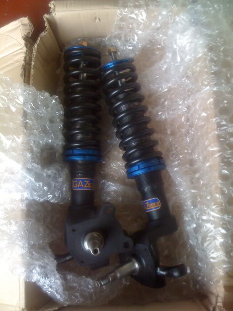

Oh and I've got a reply on the coilovers... £400 + exchange for custom front coilovers. Specs say they should be 2.5" shorter overall than the standard setup.

Im annoyed because...ordered the coilovers about 1 and a half months ago from f1moto in Kent. he's a volvo specialist who's already built one of these as a drift weapon and is building another one for someone in jdm allstars this year.
I contacted him about the coilovers and he said £400 + VAT + exchange of my old struts. (worked out at £600) he said they'd be ready in 2 weeks. During the 2 weeks my MOT ran out and because of my old front suspension set up it wouldn't of passed (springs were loose in the cups) so i rang him and explained blah blah. he kept me waiting for a month because he was waiting on the springs from Gaz. Eventually he said I could have the coilovers off his 340 which hadn't yet been used...only fitted. I agreed because I was fed up of waiting.

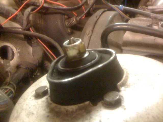

This brings me up to date when they arrived on thursday. Obviously when i bought them I asked about fitting etc. and he said they would go on no problem at all. so come thursday I thought it would be an easy job fitting them, only to find out that my existing top mounts are massively too tall! And so I had no thread for my top nut to screw on to. I rang him and he said "oh yeah, really you need the custom camber adjustable top mounts to go with them to make them fit, but you can just grind down your old ones until they fit and that will be fine." So i said okay and started grinding. I ground them down as much as I dared and the thread only just managed to show enough for the nut to screw on. But then i realised that this was WITHOUT the bearing between the top of the coilover and the base of the top mount (my top mounts don't have integrated bearings) so obviously it'll rub metal on metal- not good.
SO basically they won't fit properly without buying the additional top mounts that he makes (cost £100). My argument/reason for annoyance is why the feck did he sell them knowing full well i needed different top mounts and told me other wise. And to make things worse, if it took a month and a half for the coilovers to come, how long will it take before i get the new top mounts?
So now I've got to wait till monday to ring him and talk to him :( very annoyed and fed up tbh!
Anyways picture of butchered top mount
before...
after

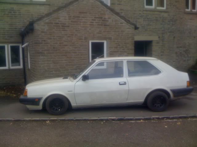

and this is how low it is with 4 threads left to go...
ignore the back, Im getting some bigger blocks made up this week to balance it out.

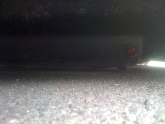

and my clearance...

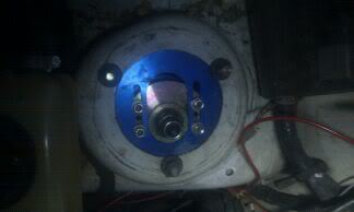

After ranting for a few days I've calmed down and spoken to F1 Moto. So my new top mounts should be here by the weekend (fingers crossed).
This is what they should look like:
