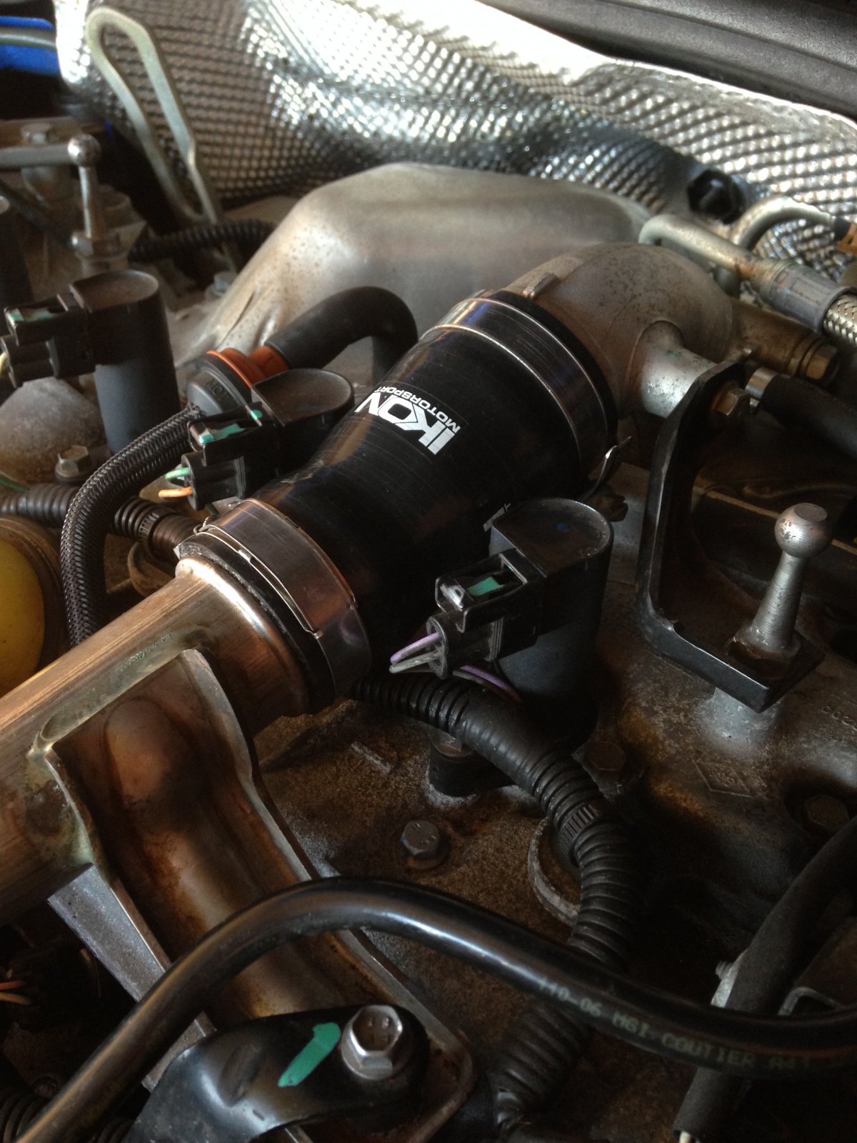

-Added a short shifter and a properfekt recirculation valve which was Abit tricky to fit, crap photo of the recirc valve.
Got some silicone boost hoses from ikon Motorsport in black.

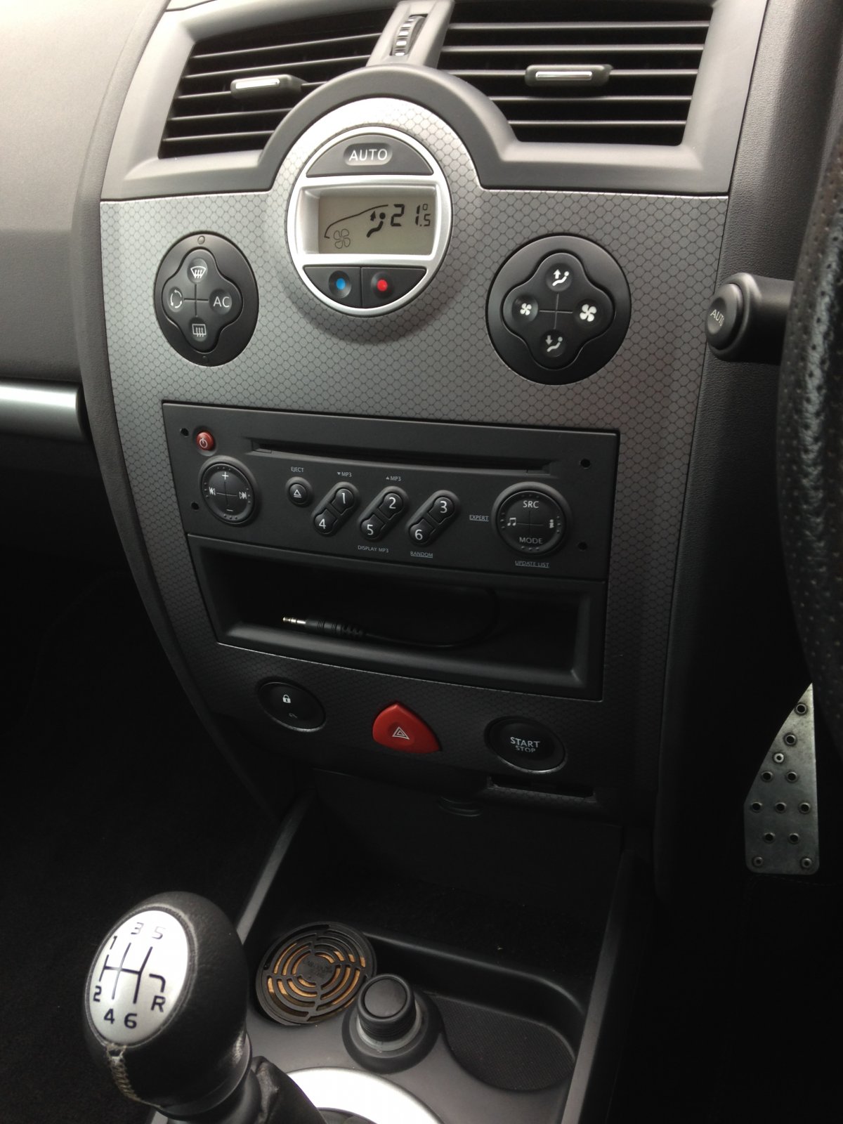

Next up was the interior centre dash panel. The standard one fitted to the car was quite tatty and worn with scratches and missing patchy paint so this got replaced for one sourced off eBay. Not sure if the pattern is standard or has been hydrodipped but looks well I think.
In the interior I noticed a few other people's Meganes had the ash tray/coin bin which mine was missing so bought a new one.

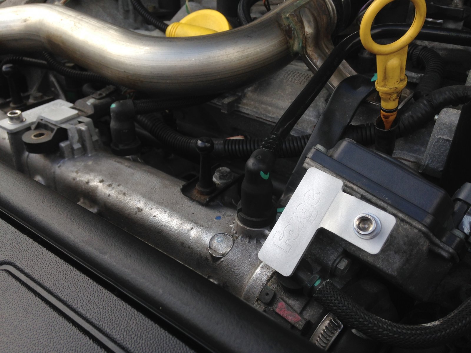

fitted some forge pressure sensor clamps.

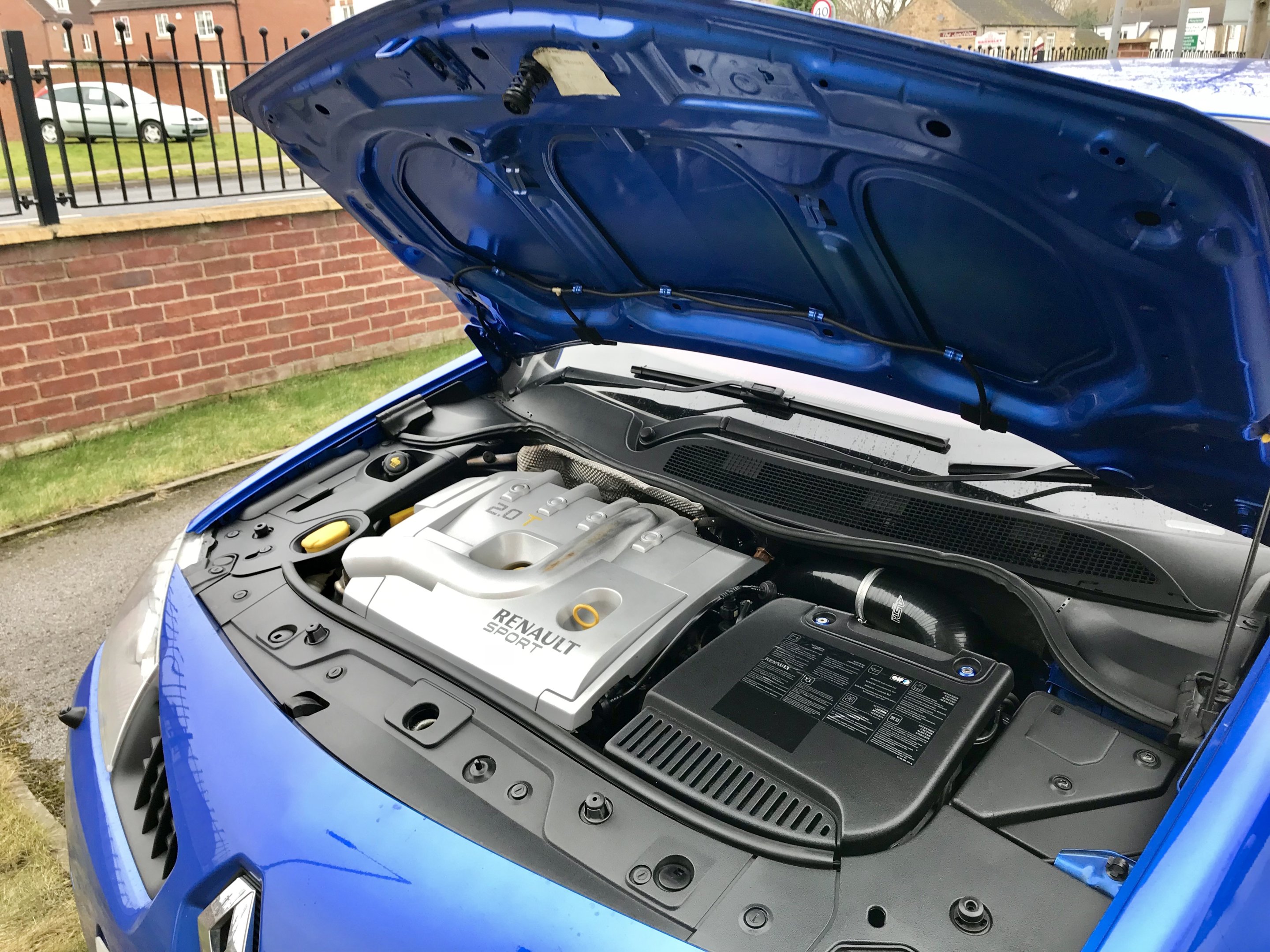

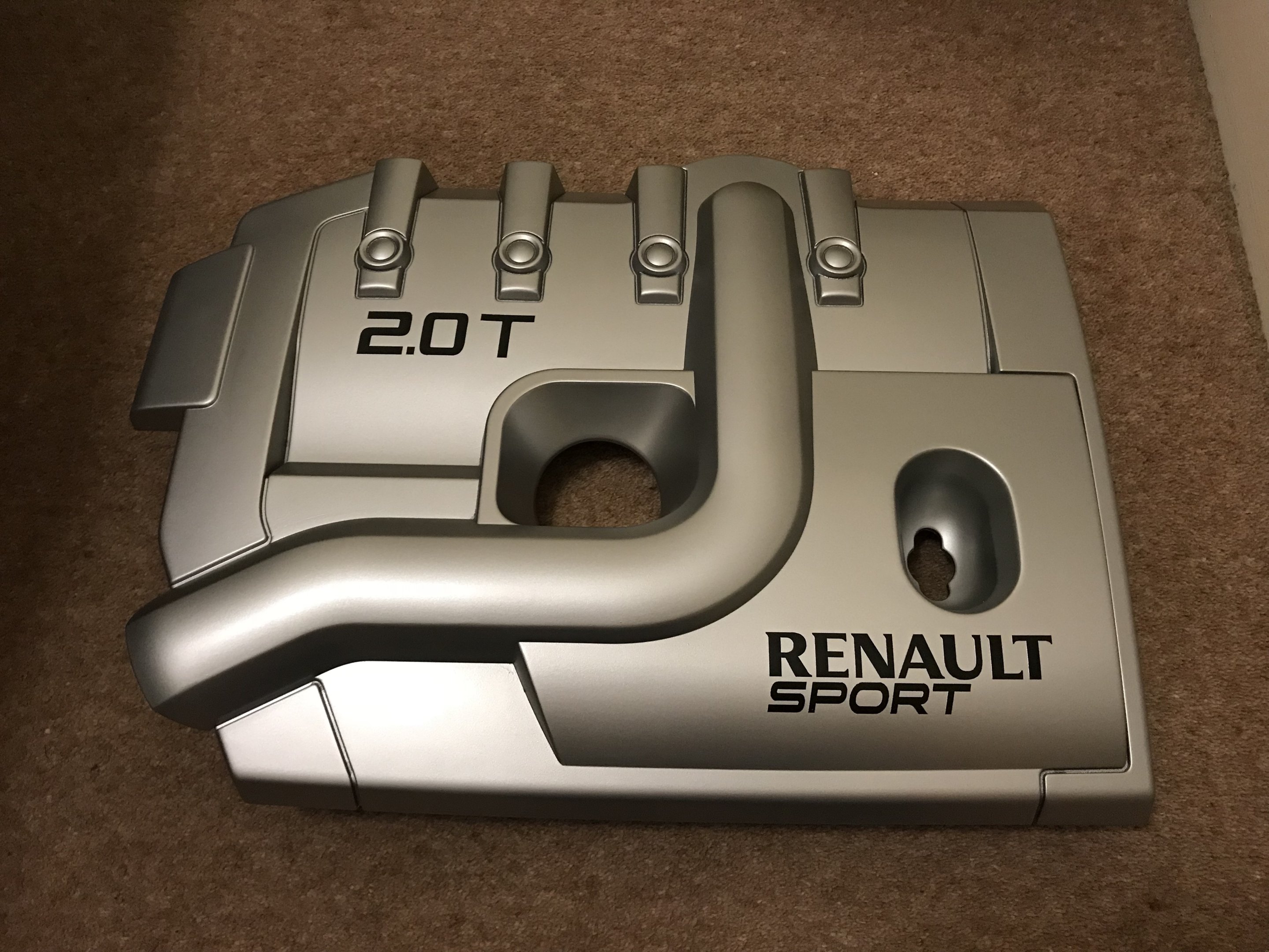

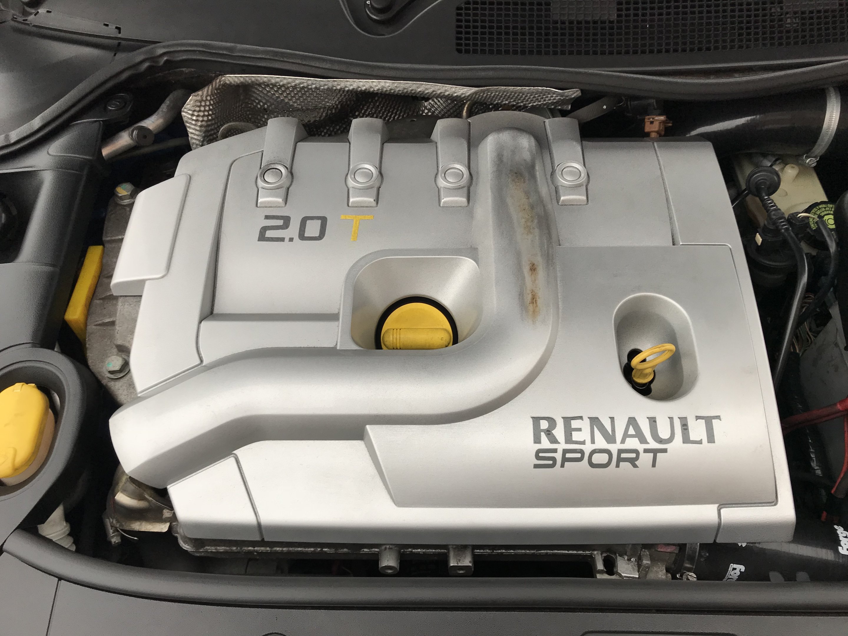

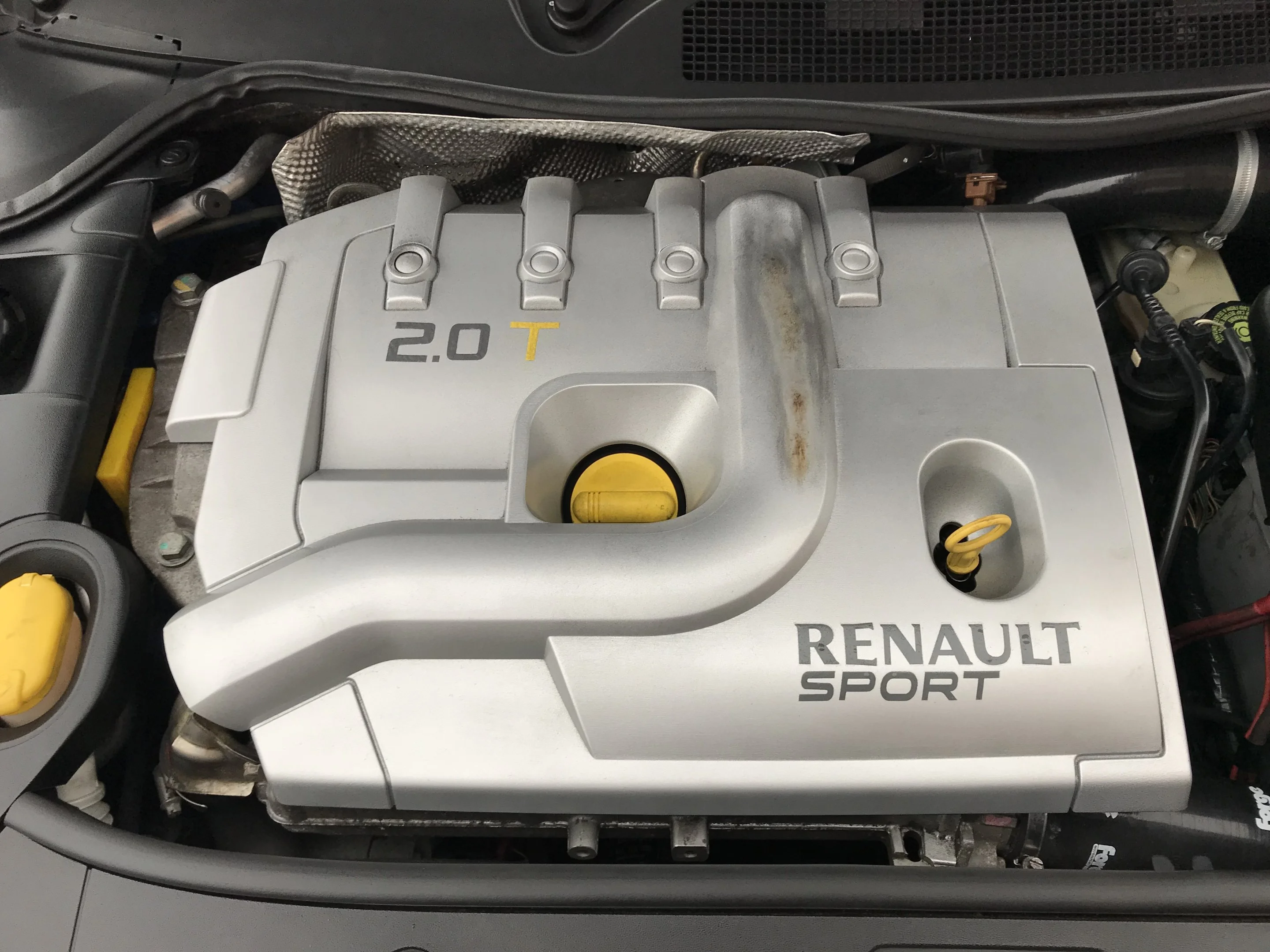

Engine cover was looking very tired so sprayed that in some silver paint I had knocking around and got some replacement stickers.

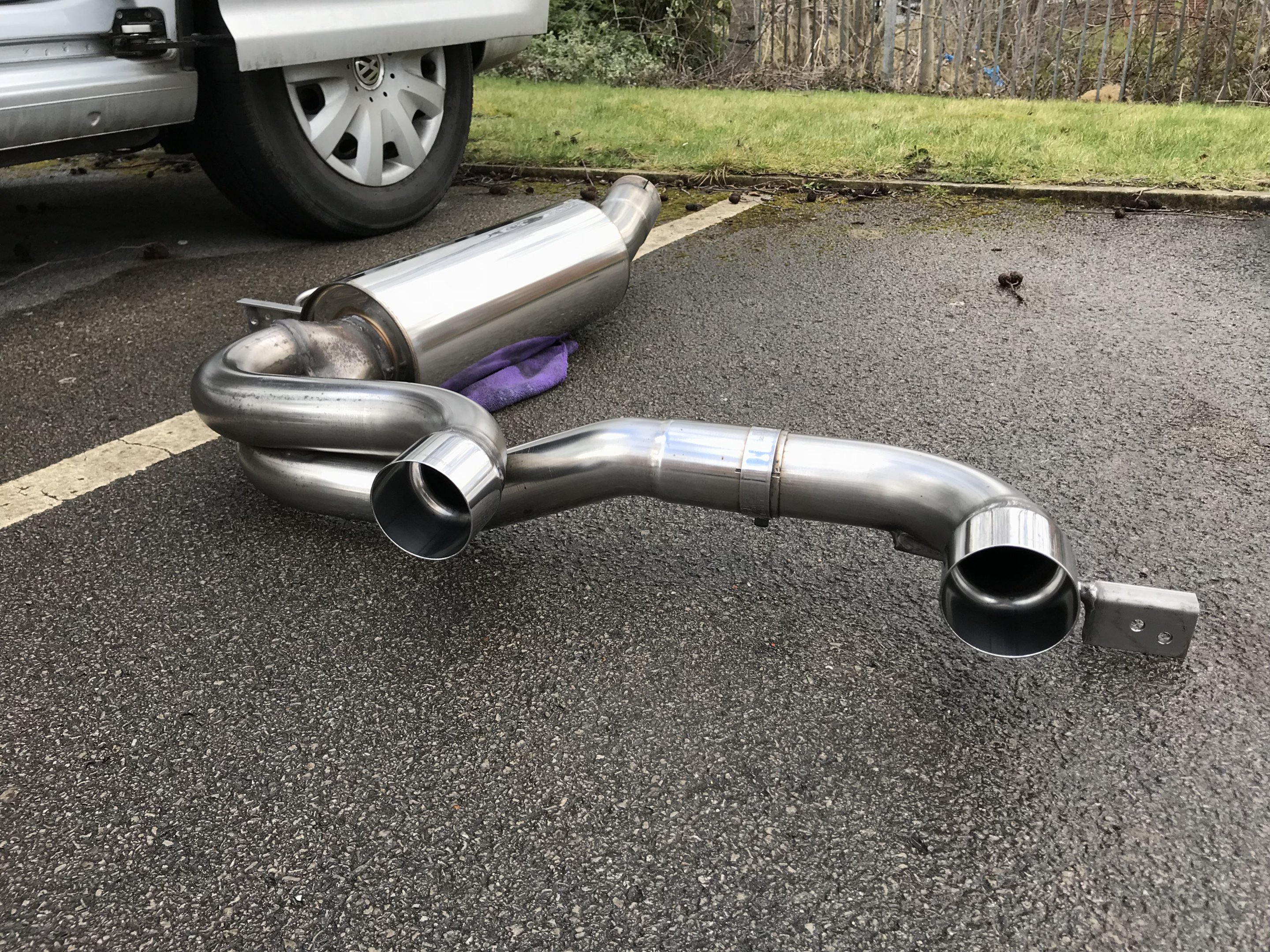

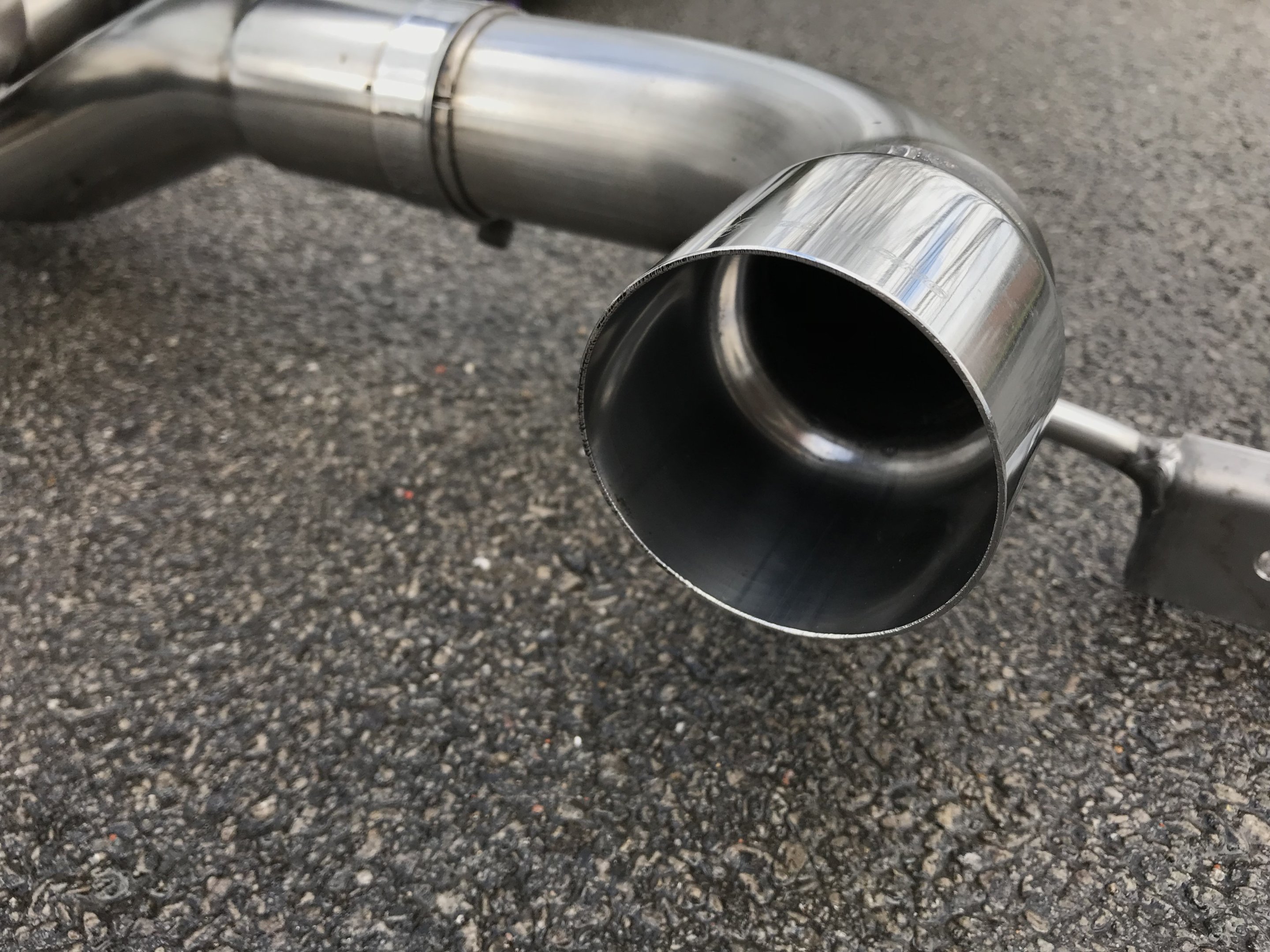

Couple more bits have been done. I originally wanted a new exhaust system but have other things I'd rather spend money on first, so with that in mind I took the car to Midlands Renault specialists to have the not so nice standard exhaust tips changed to marks custom ones.

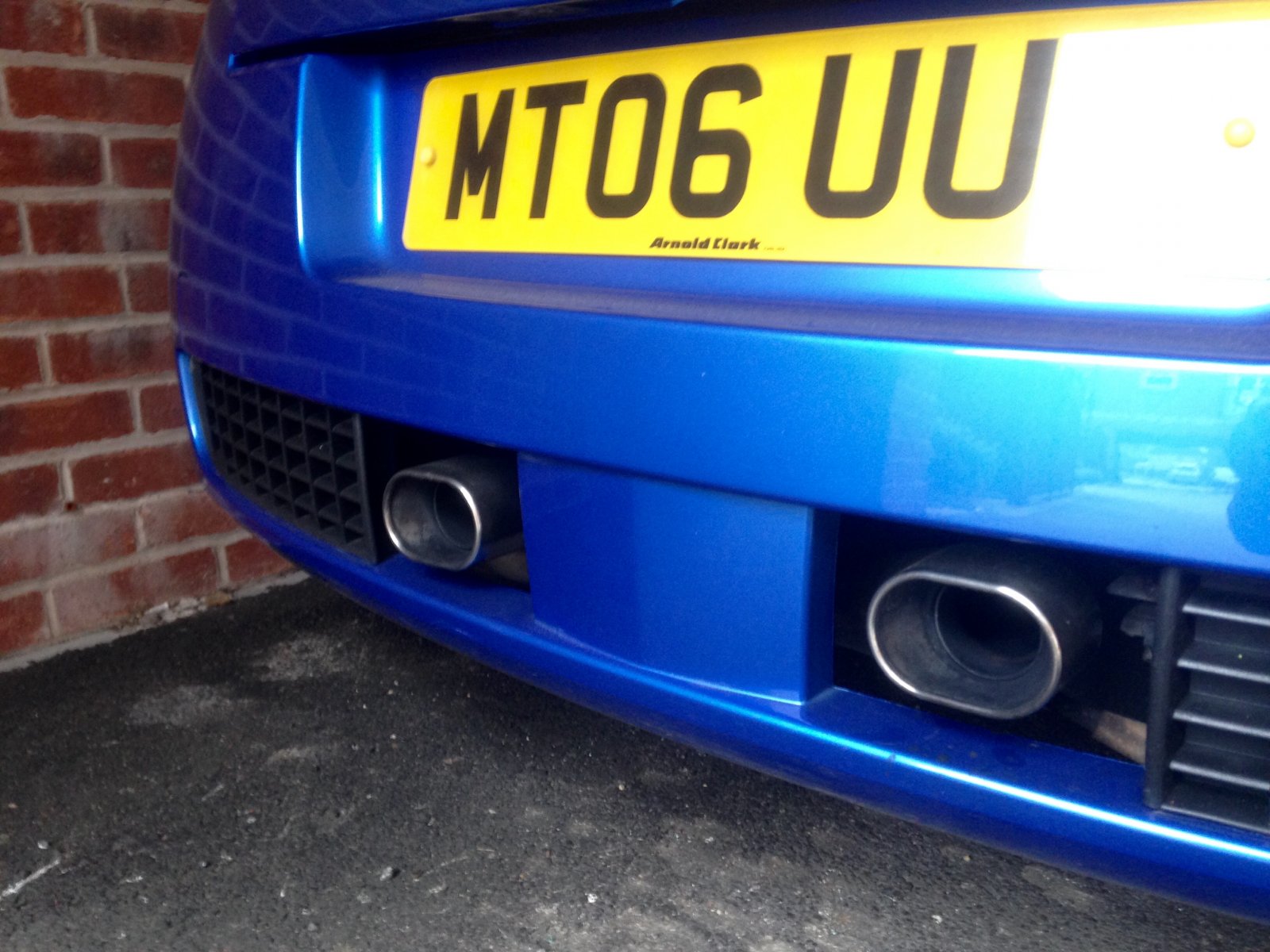

Quick before of the standard oval shaped ones.
Nice shiny new ones now fitted and looking a lot better in my opinion!

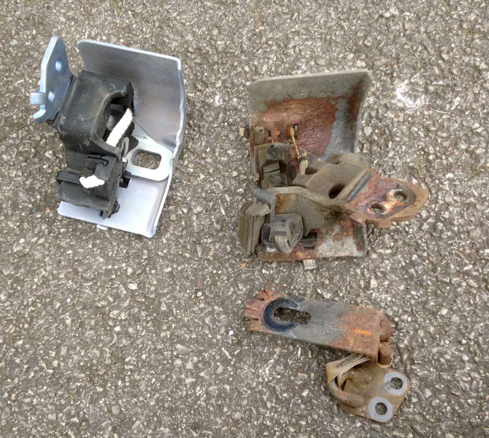

After having this done mark pointed out the exhaust mount was completely shot, nice new one ordered from kam racing. Can anybody tell which is the new one?

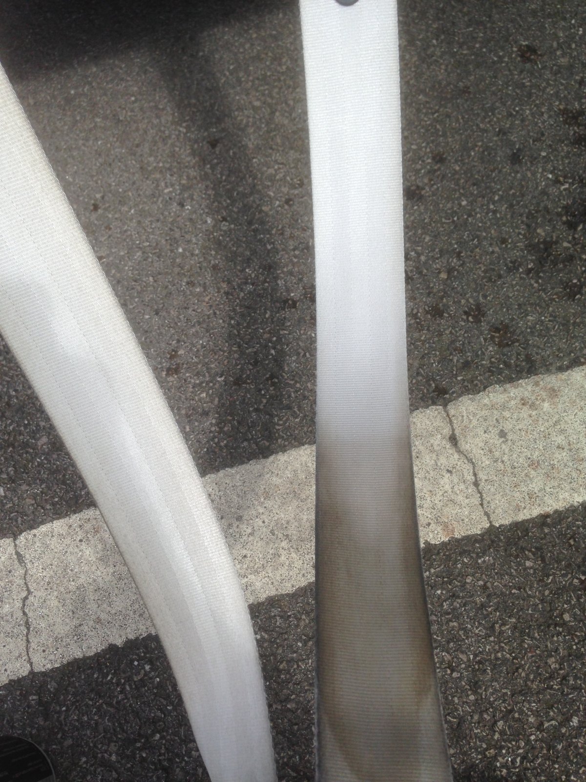

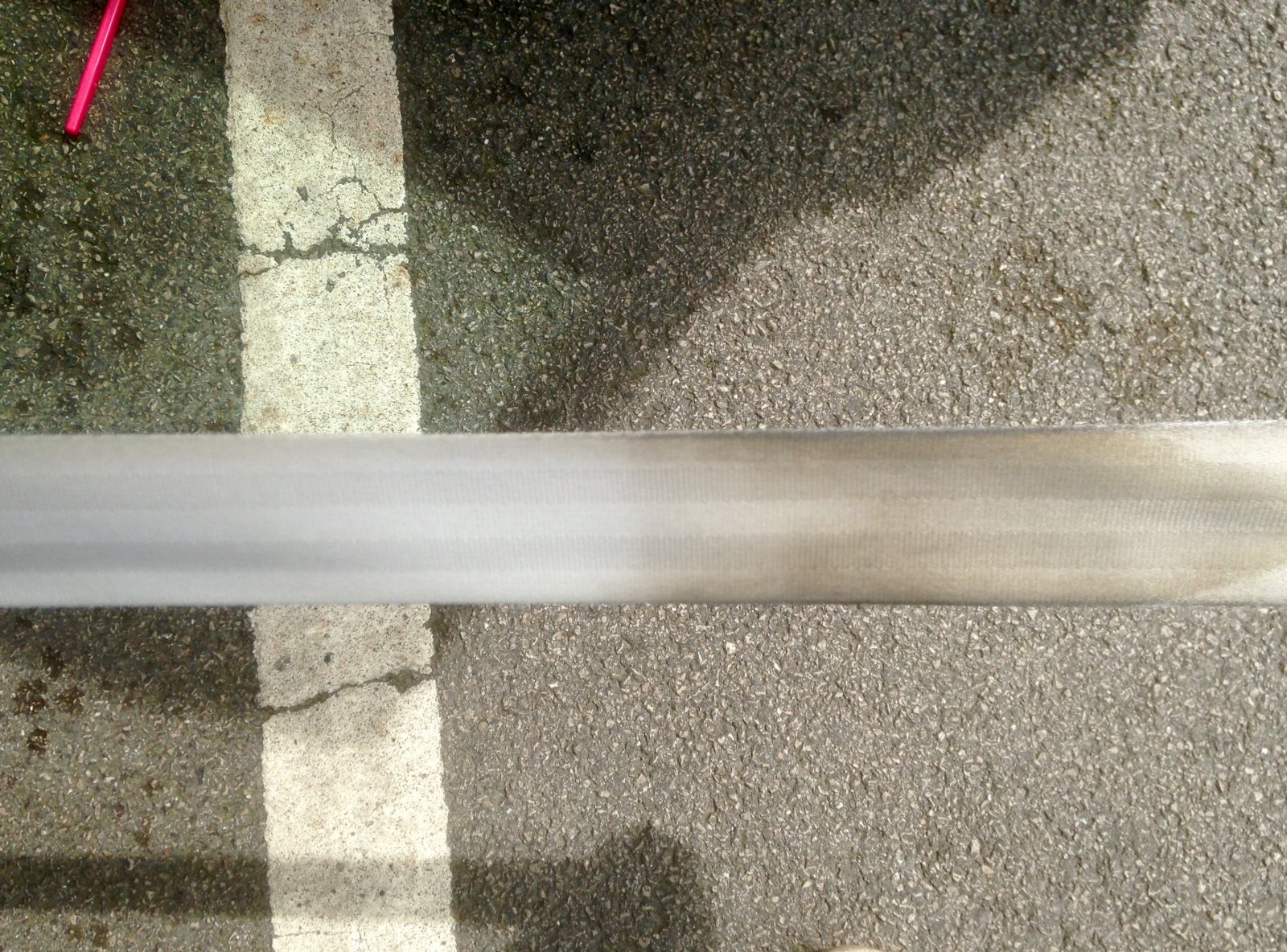

One thing that has always let the interior down is the should be silver seatbelts. After years of grime build up I couldn't bare to look at them any longer so got to work cleaning them, no jet wash or steam cleaner used like people suggest!
-Started off by unreeling the seatbelts and clamping them with some clothes pegs
-sprayed bilt hamber surfex apc (diluted) and scrubbed with some tooth brushes.
-wiped clean with a dry microfibre
- sprayed with autobrite fab interior cleaner and agitated with a different tooth brush
-wiped clean with a different dry microfibre to keep the heavily soiled one from smearing much back in to the clean seatbelt
-left to dry in the heat for an hour.
I think pictures speak a thousand words with this and I genuinely couldn't believe how dirty they actually were. Took around 2 hours in total minus the drying time

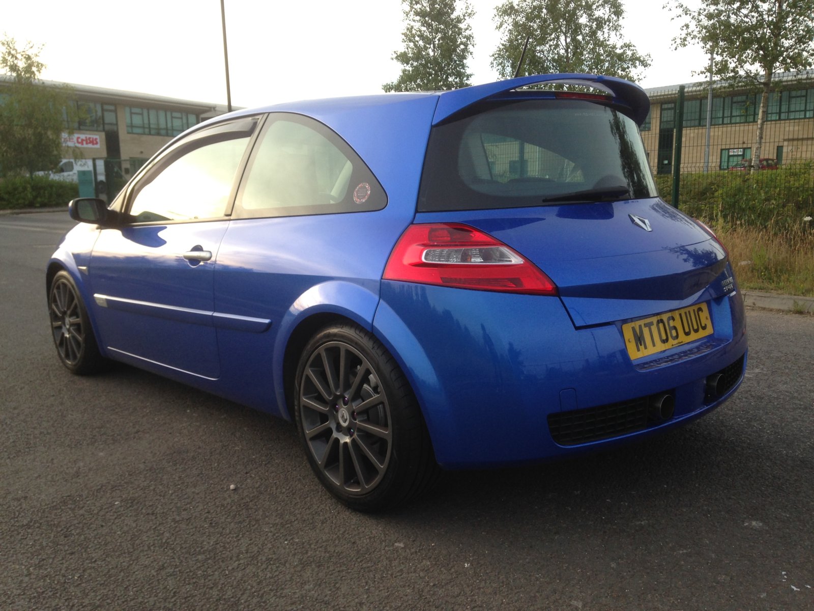

  Ph2 Meg 225

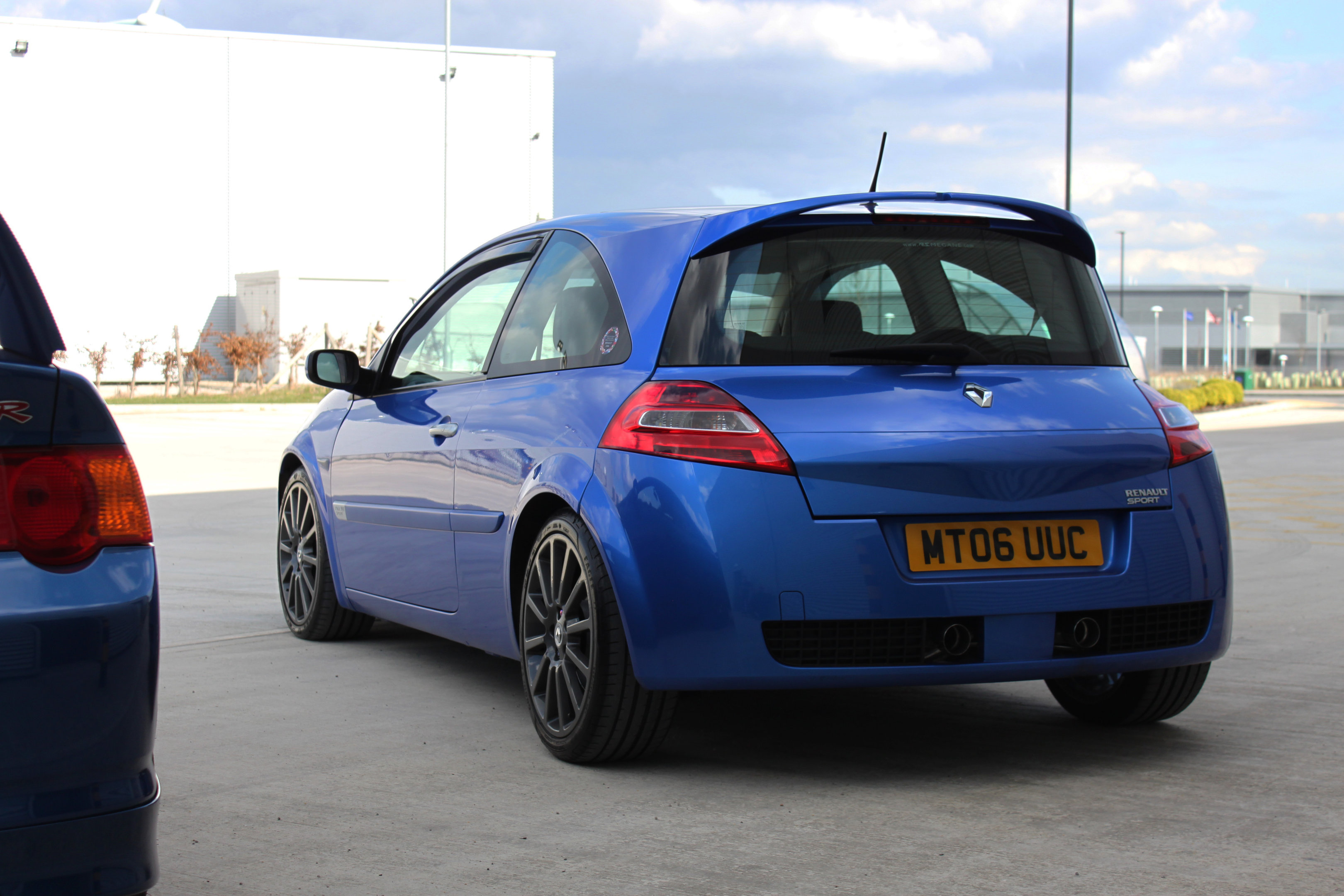

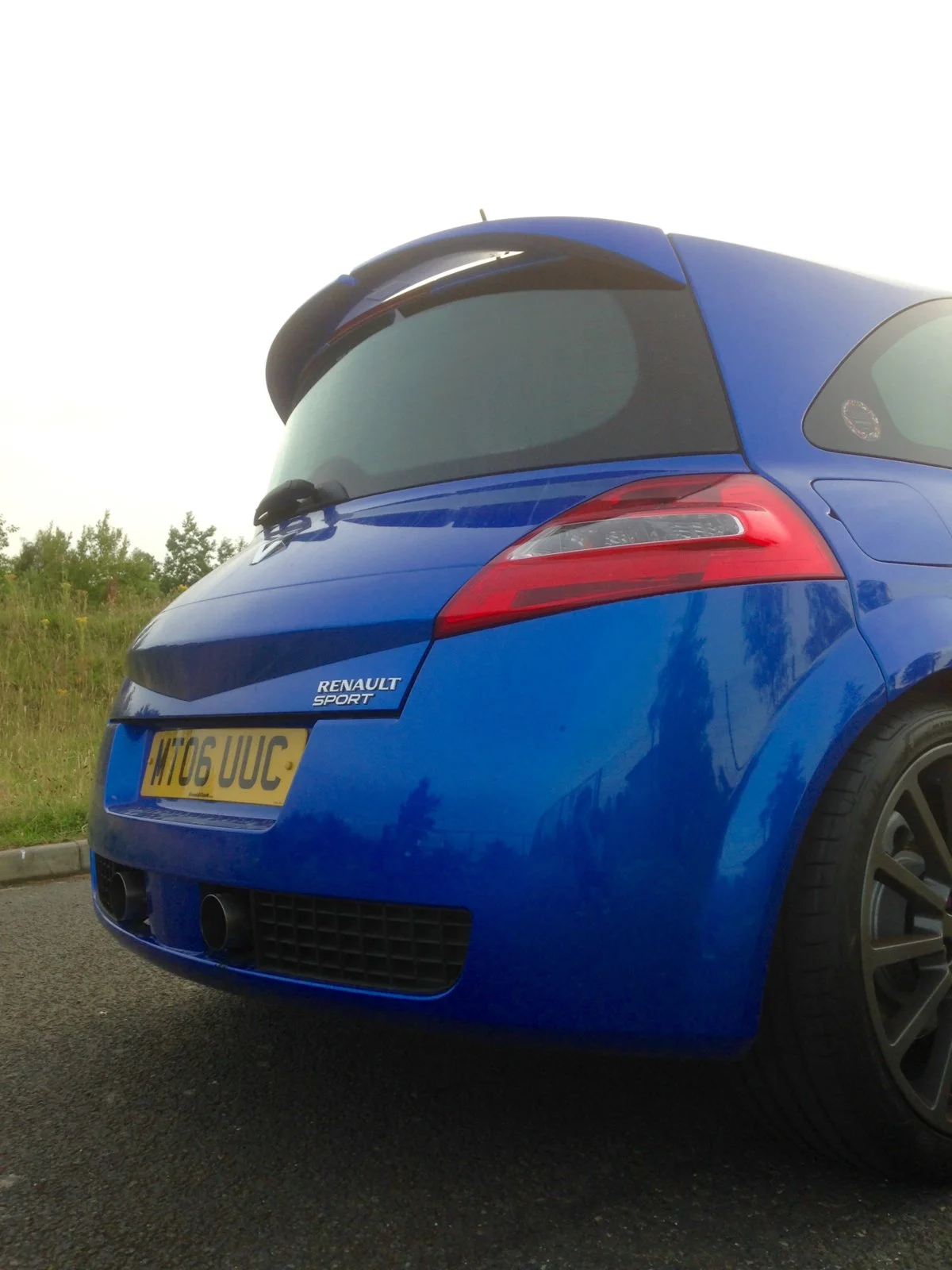

Just been to collect this from Ashbourne. 3 hour round trip in the sunshine and some decent roads made for a good Sunday morning.

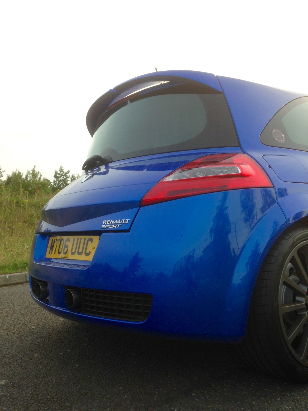

R26r spoiler. Will be getting painted to match the car in a few weeks when I'm back off holiday, can't decide whether to have the centre hole on the bootlid welded and filled or just stick a Bung in it.

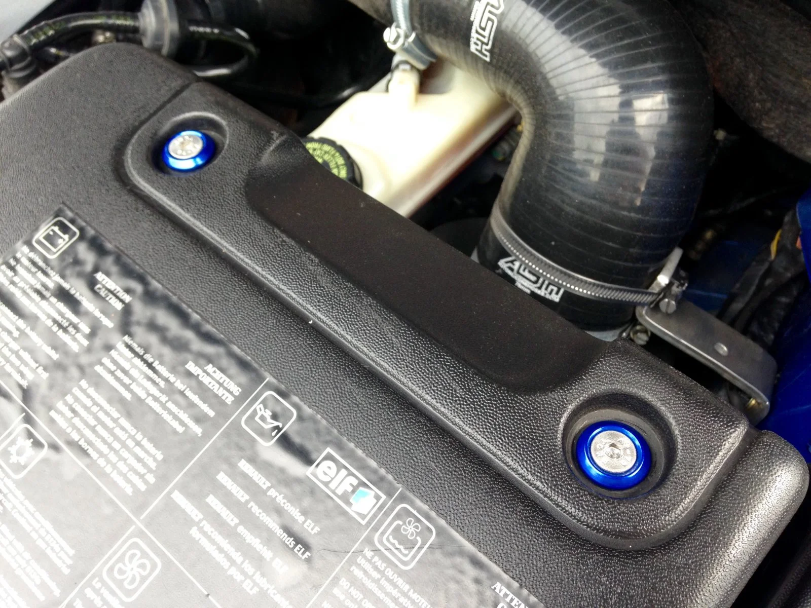

Changed the fixings holding the battery cover on, the plastic trim clips were working loose after a while so needed to be changed. Made a new bracket and tapped an m6 thread into where the fixing holes would be, bought some stainless countersunk Allen bolts and some blue anodises washers. Nice little touch I think!
Now for probably the biggest update yet. Got the r spoiler dropped off at the spray shop last week to be matched to my car and got it fitted Saturday. With the spoiler being second hand it didn't come with the fitting kit, I sourced all the parts in the original and made my own.
Removing the old spoiler went okay but the old foam glue was a pita to remove, this is what's left after separating the old spoiler from the roof.
The roof had some minor scratches from where the grit from under the spoiler?? Had dragged across the paint work when cutting through the glue (using plastic pallet strapping with a blunt edge) so was wet sanded with 2500 and machine polished, anyway here's some quick photos with the spoiler fitted...

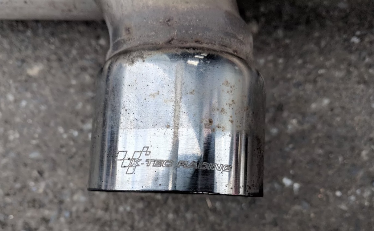

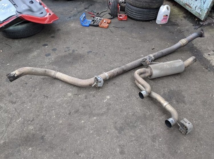

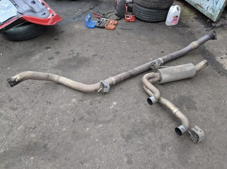

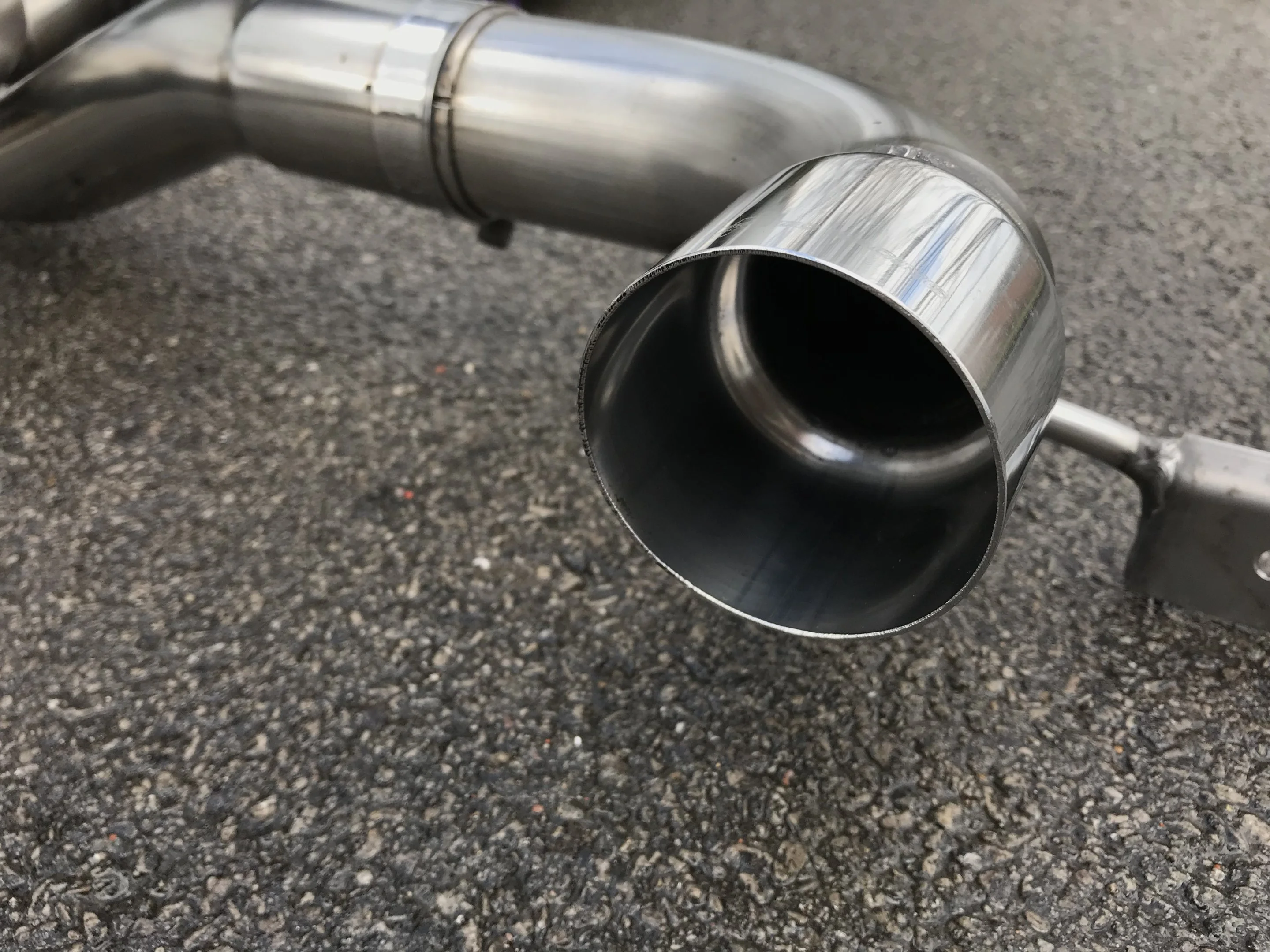

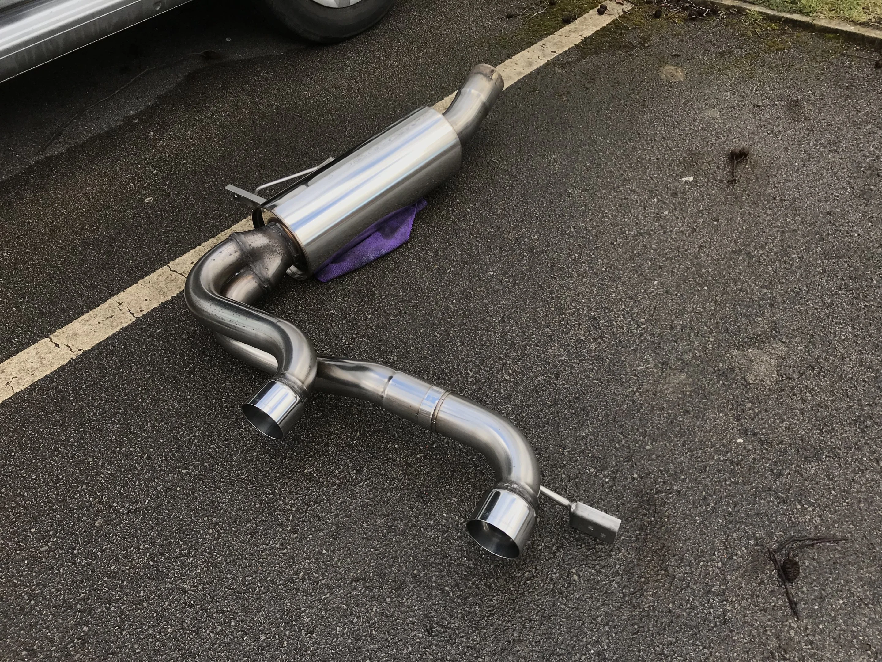

Not updated this for a while. Been thinking about an exhaust for a while and finally I’ve took the plunge on a second hand one that came up local! Its a ktec 3” catback system, it was up for £350 with the ktec 3” decat but wasn’t bothered about this for various reasons so made a deal for £250 without. Pictures from the add
As you can see from the above it needs a good clean and coked up heavily inside the tips. Apart from that it’s like new no dints or scrapes and the flexi isn’t damaged. Spent a few hours polishing the back box section with autosol and some 0000 wire wool and got the results below.

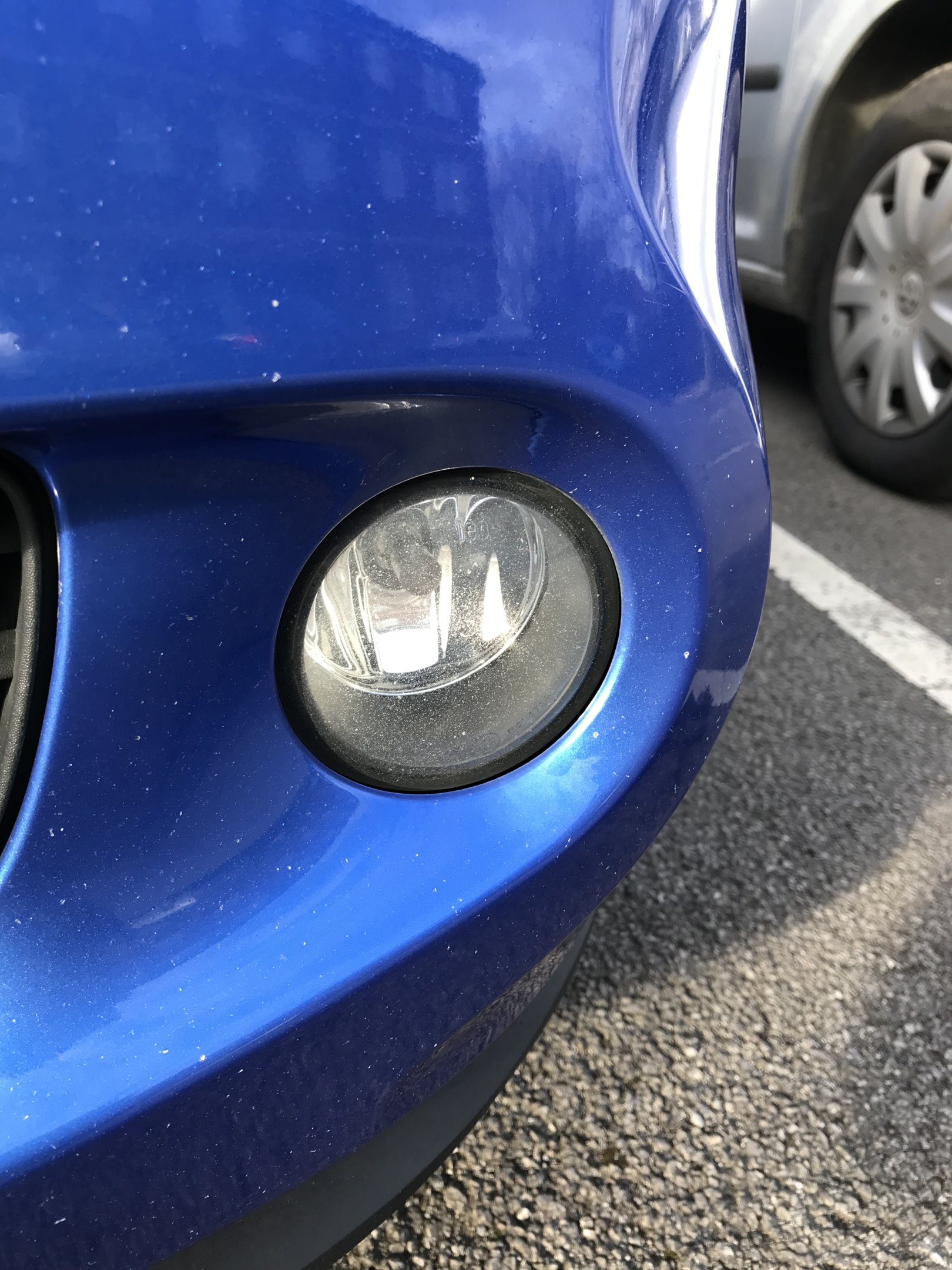

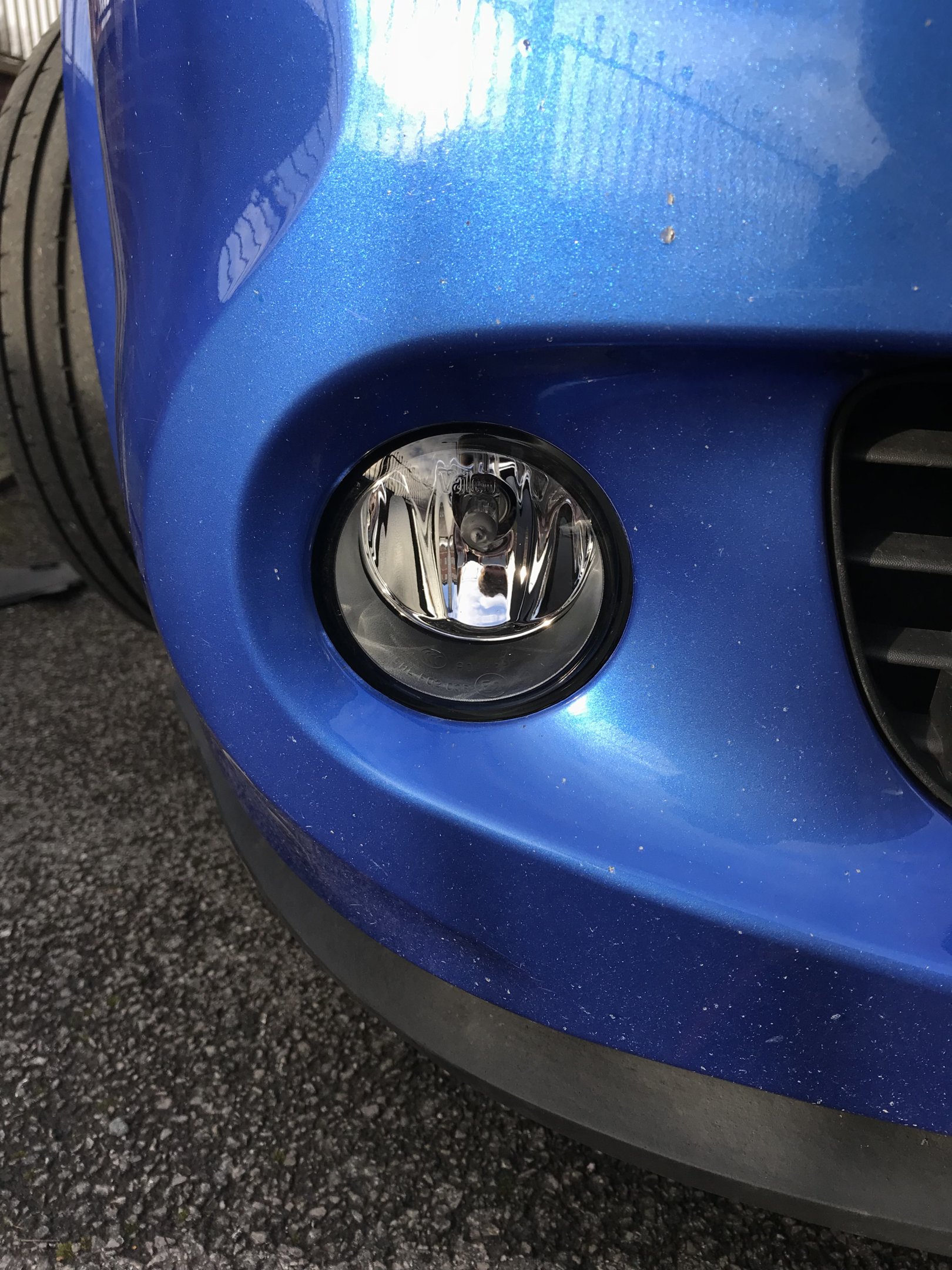

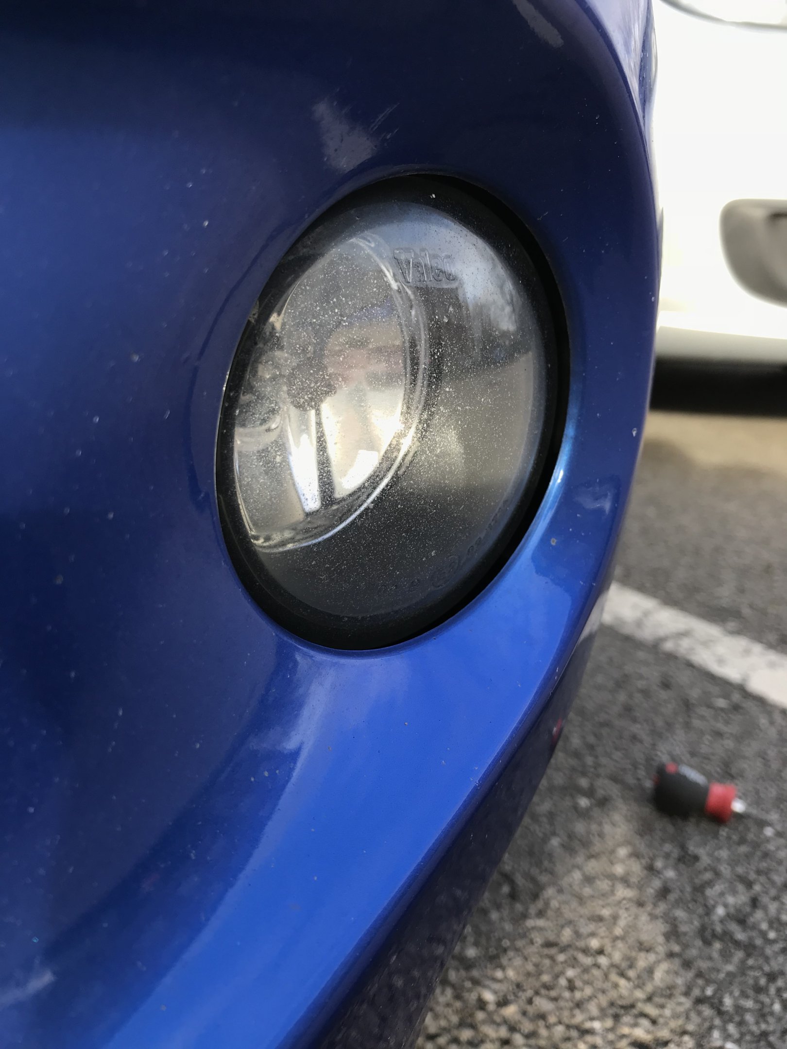

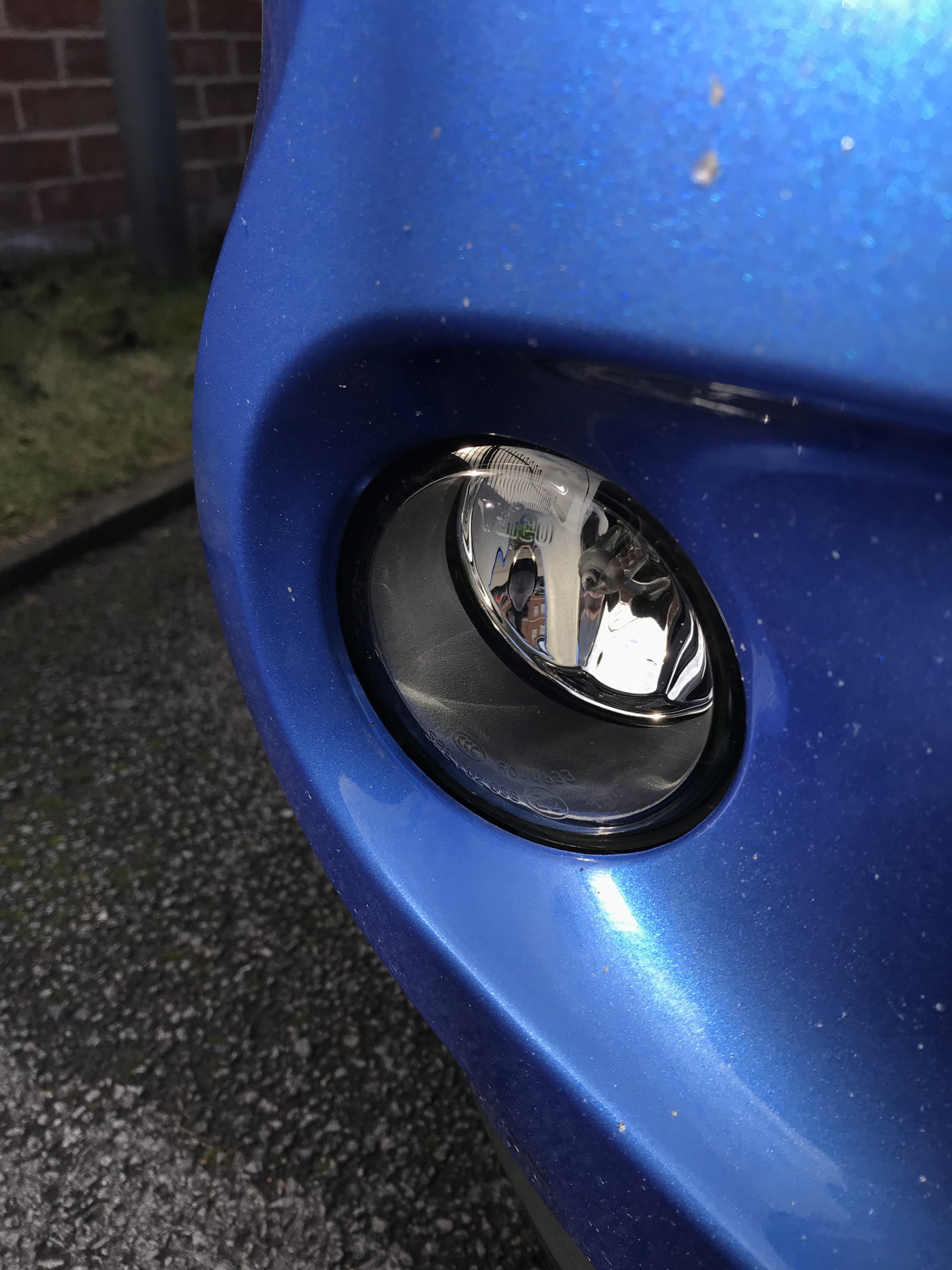

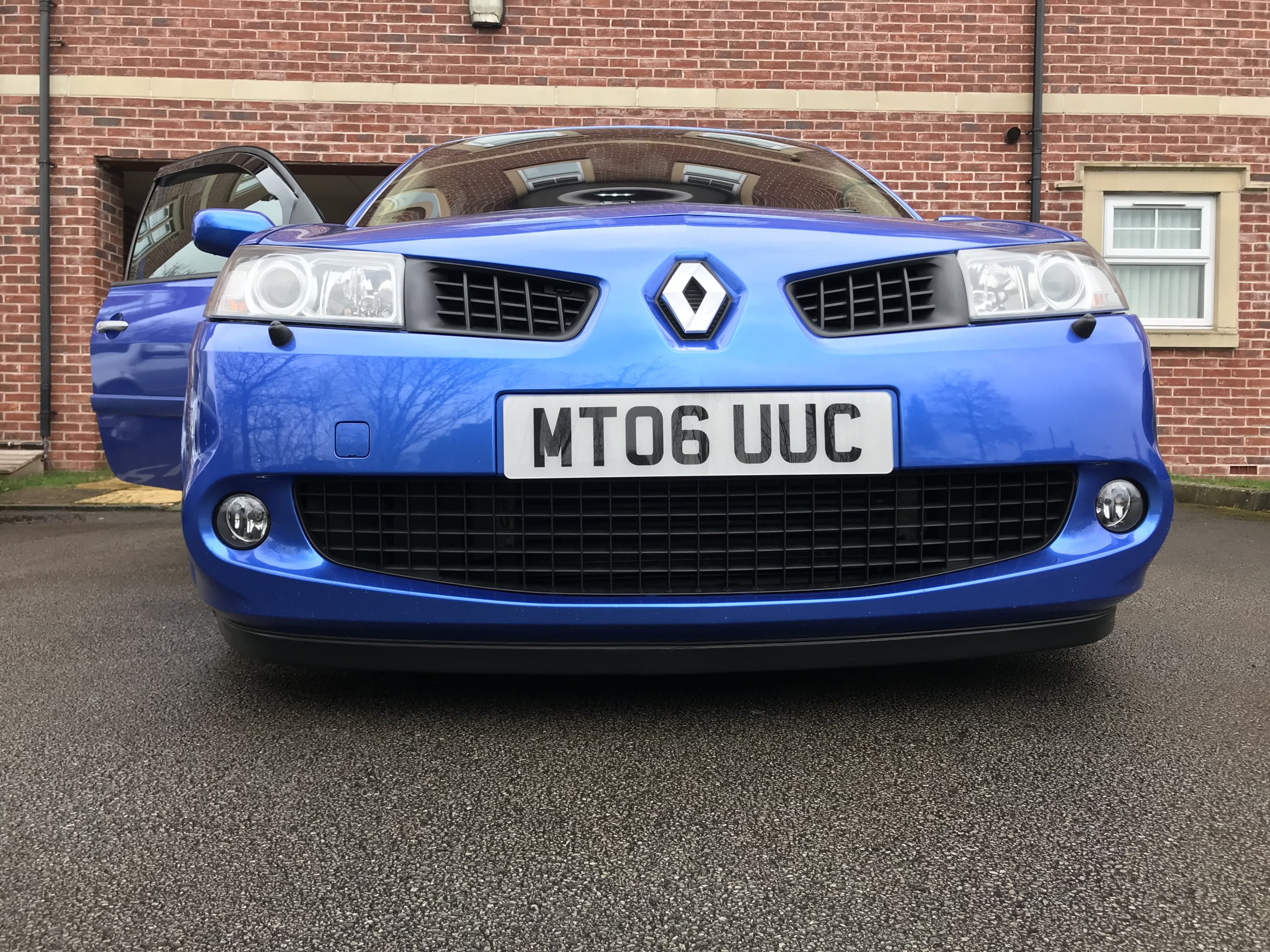

Fog lights looked quite tired and chipped so managed to source some genuine Valeo ones for around £20 each. Big saving compared to £58 each from RPD
Before
And after.

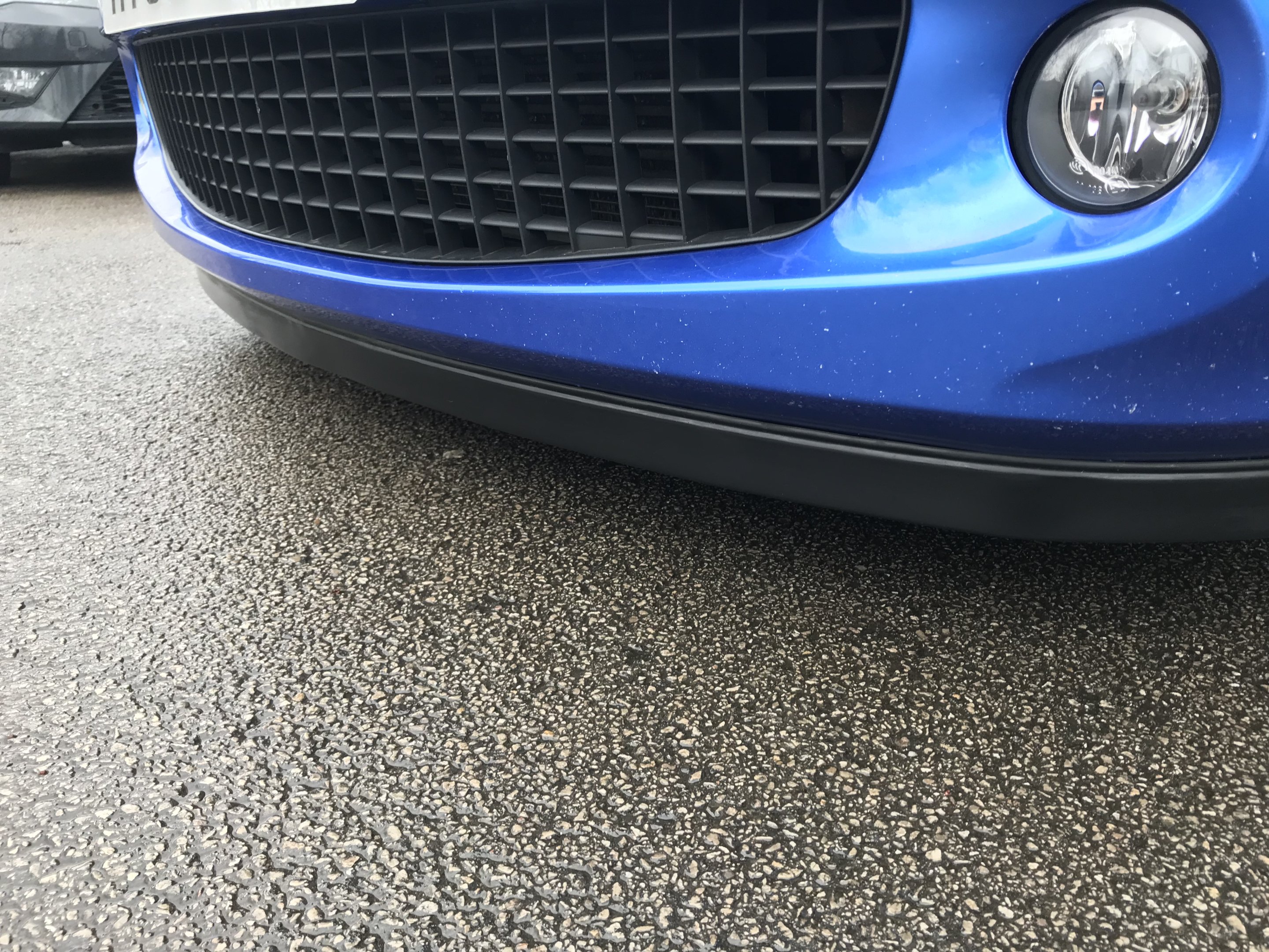

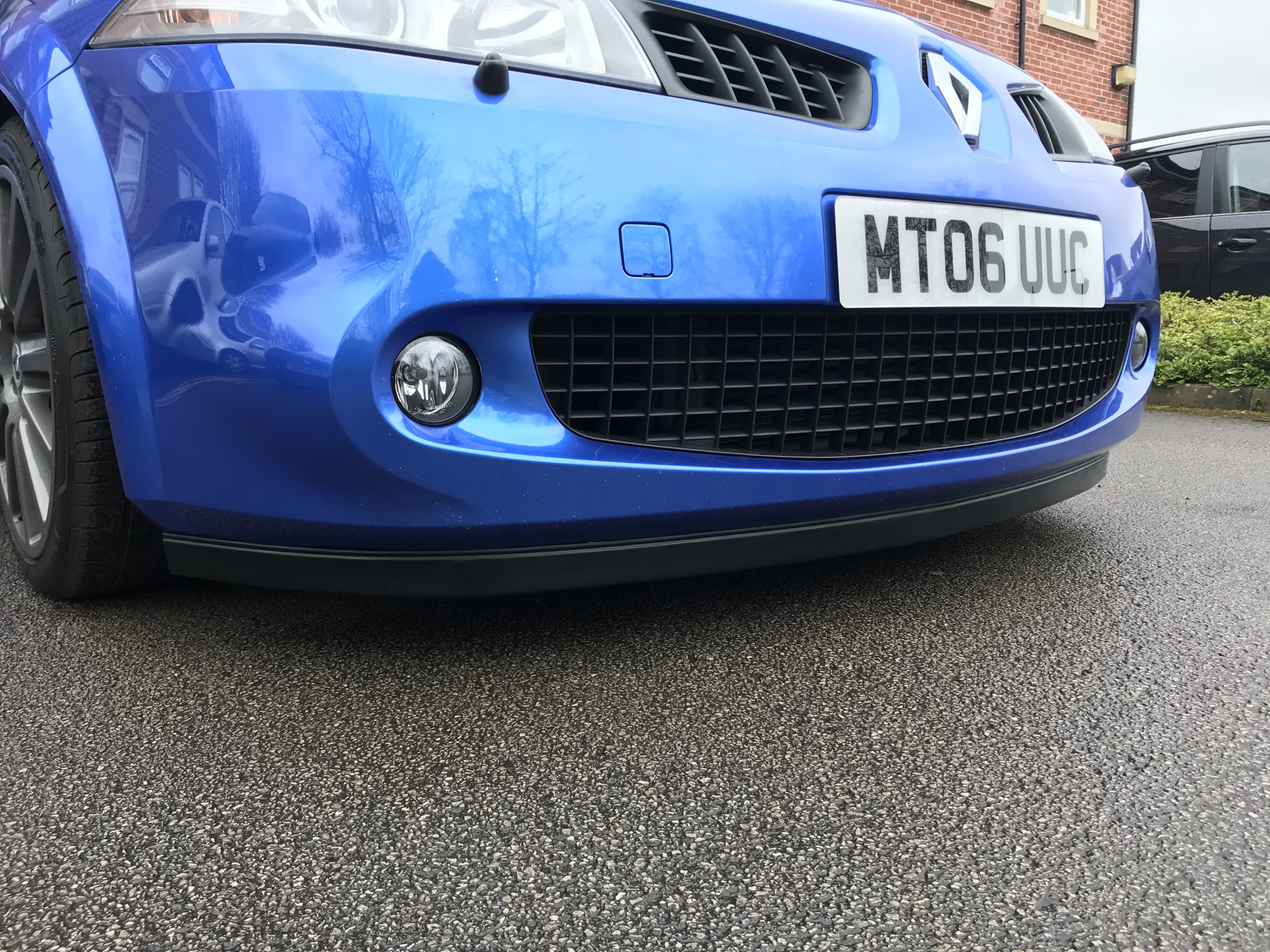

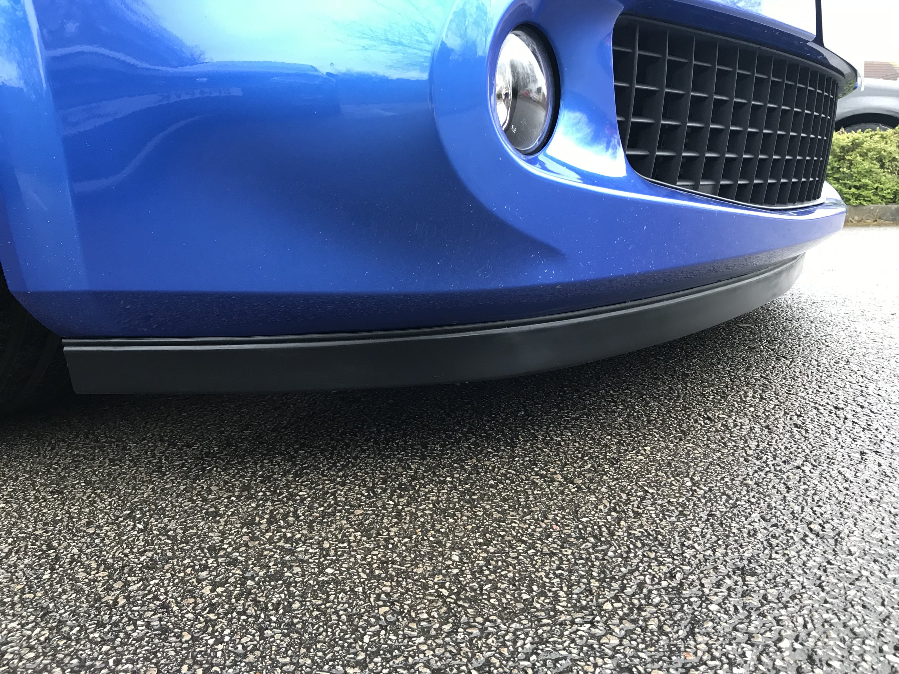

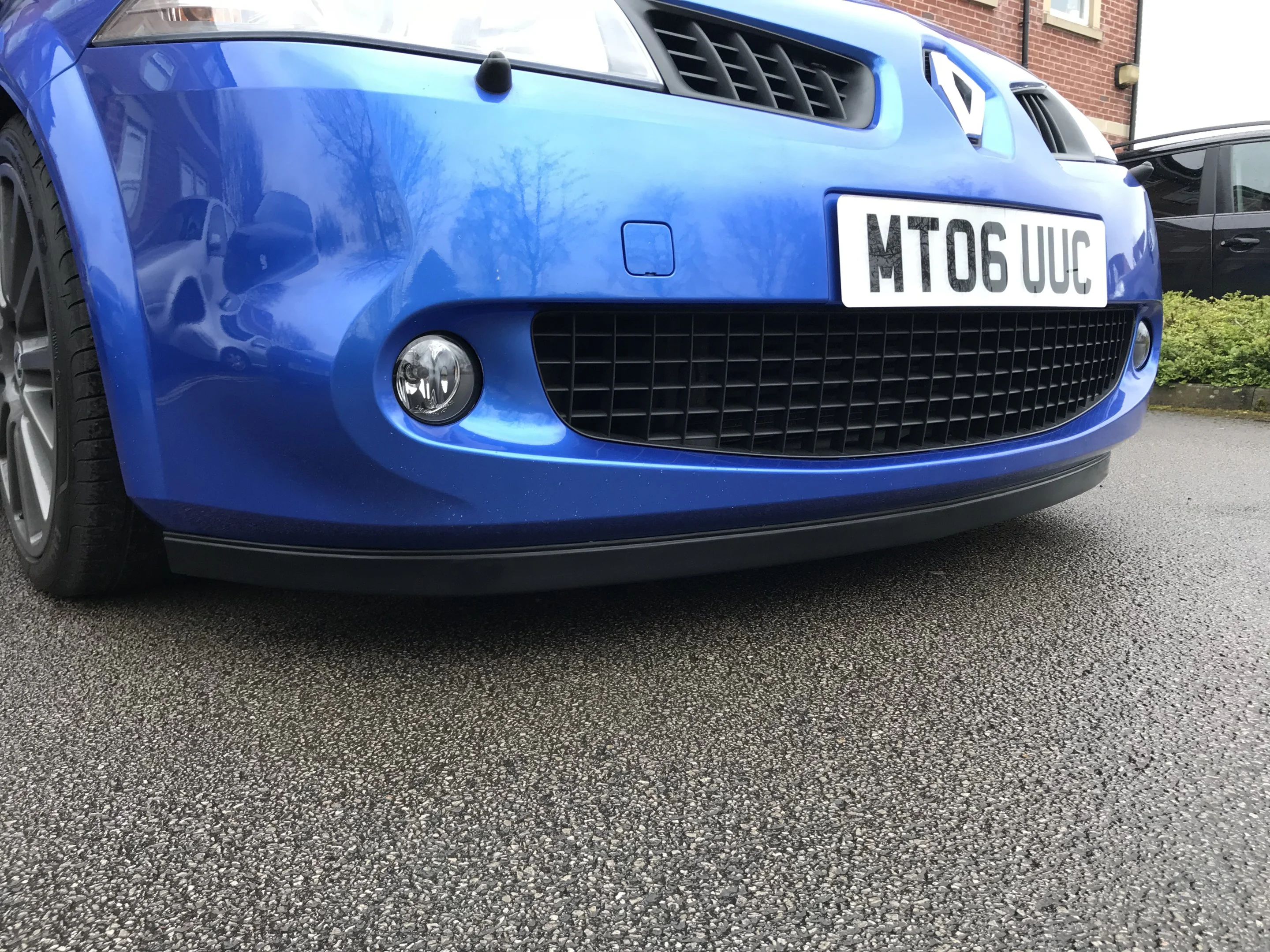

I’ve also bought a new genuine splitter for around £75 and fitted it. I’ve tried a few universal splitters (as can be seen above) but wasn’t happy with them and my original was heavily scuffed. No photos currently of the new one.

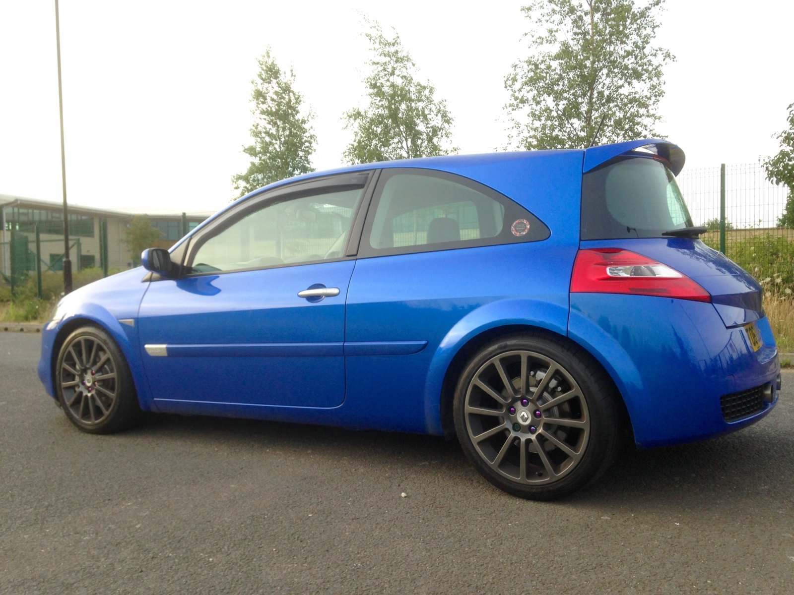

  Ph2 Meg 225
Had the ktec exhaust fitted. Has a nice deep tone, quite loud when having a spirited drive but still tame driving round town.
In the last few weeks it’s also had a new driverside drivshaft as the old one was clicking when turning. Also with the bad weather one night in particular with it being -7 the handbrake has seized, when trying to free it off from rolling one of the handbrake cables snapped with the wheel not showing signs of moving. Had the car recovered to ddc and had 2 new cables fitted.
Started painting the engine cover just needs clear coating
I’ll leave a few photos which were taken yesterday.

Cheers mate! Engine cover may have gone tits up when clearcoating so will have to look when Im home :weary:

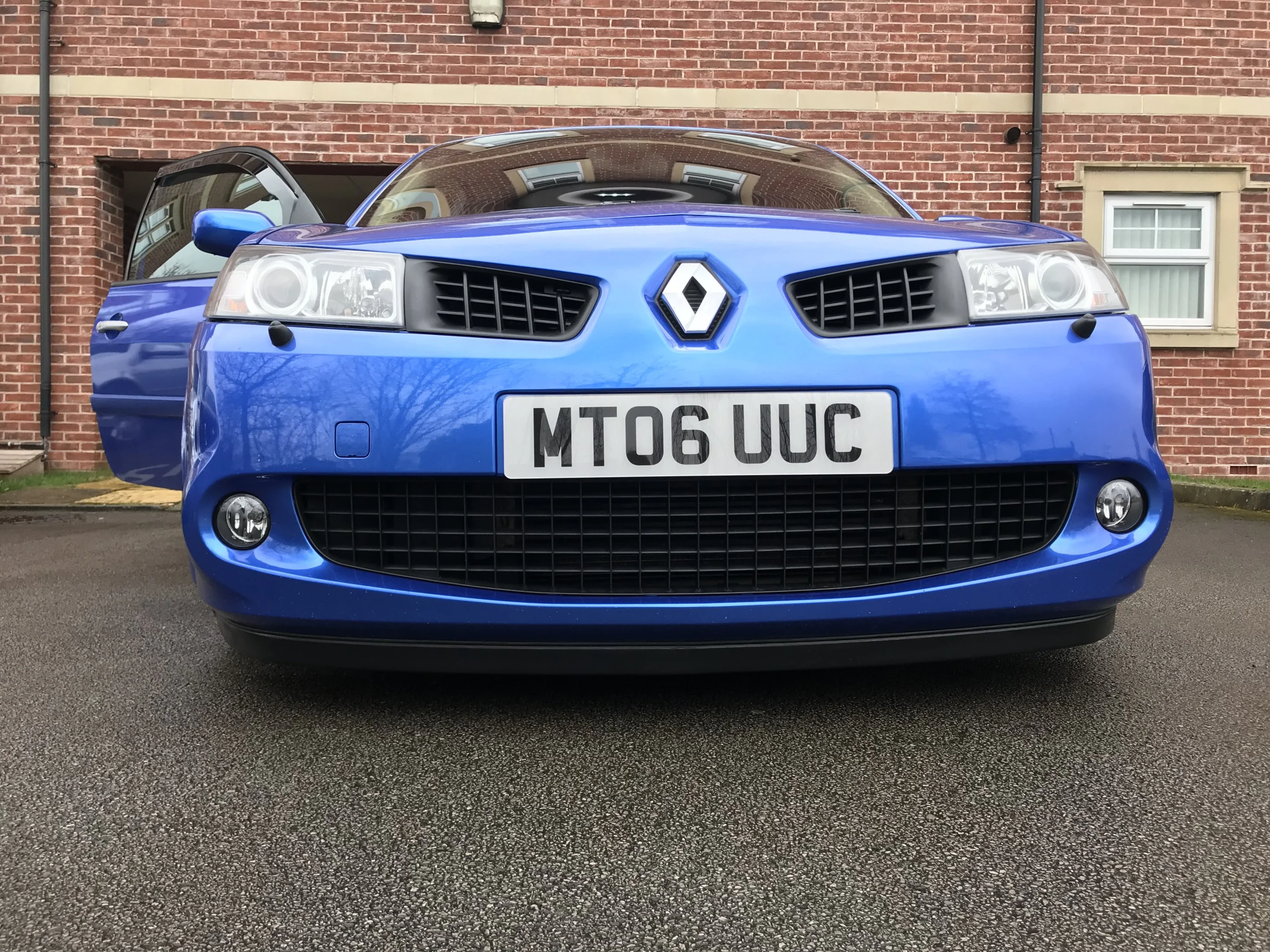

Fitted a new genuine Renault front splitter yesterday, tried a few different universal ones but wasn’t happy with how they looked so went back to standard. Finishes the front end off nicely!
The photos above had a genuine splitter on which had only been on since February but with the car being low it got damaged when being recovered. Me being anal had to replace it.
Future plans are:
-Have the front end resprayed as With the front end having new plate,splitter and fog lights the stone chips let it down.

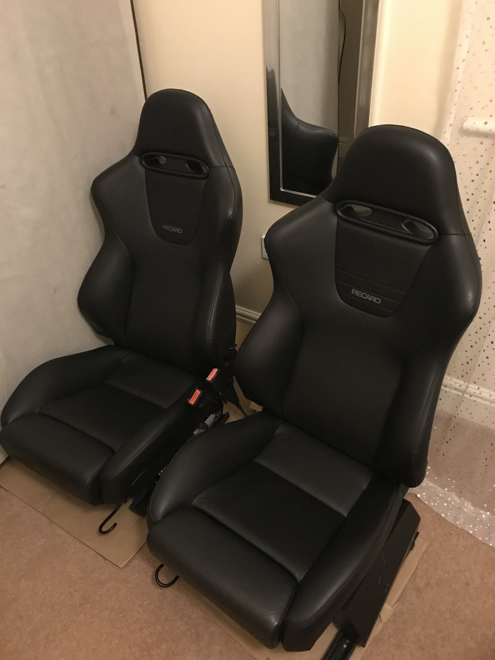

  Ph2 Meg 225

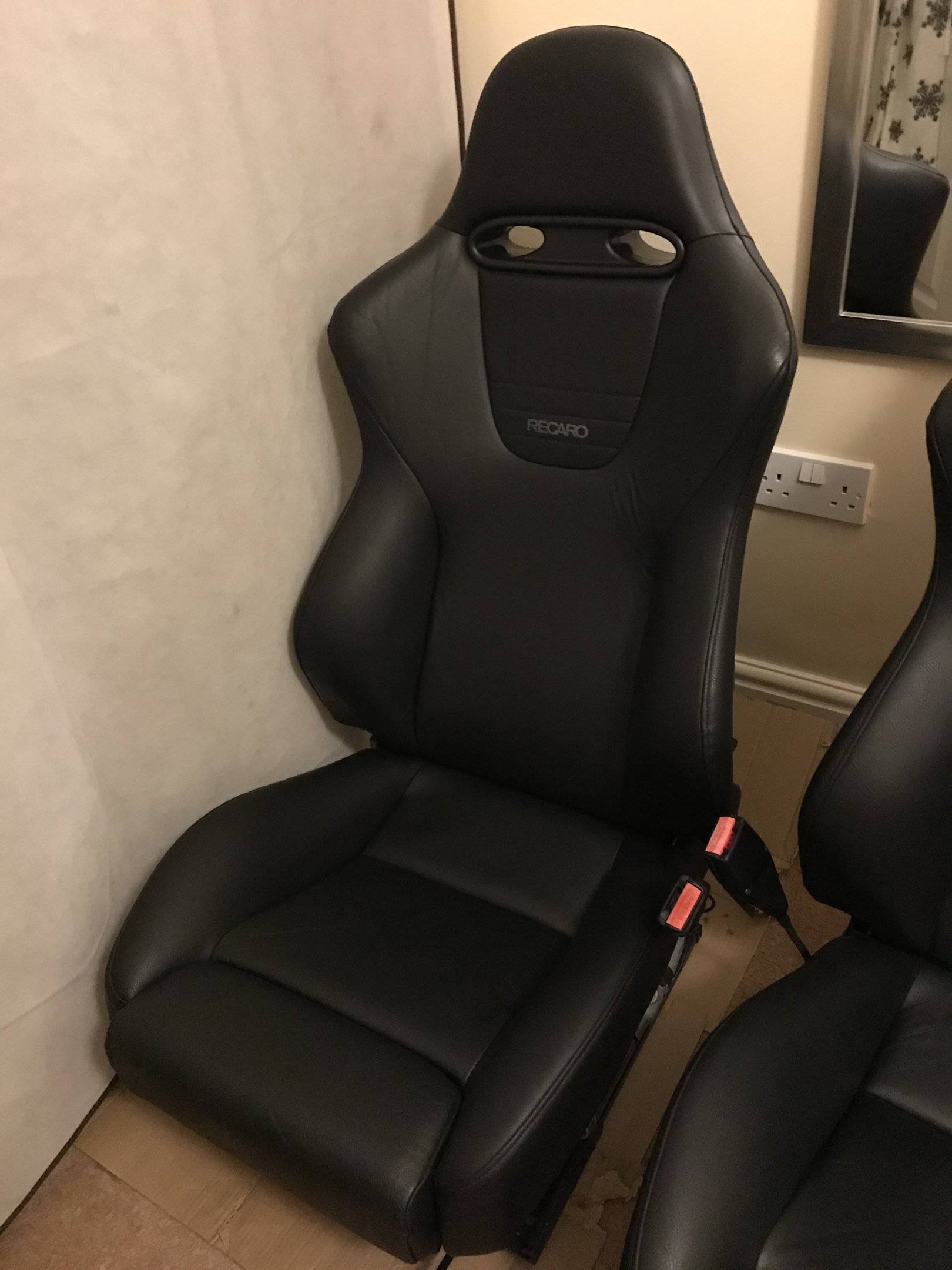

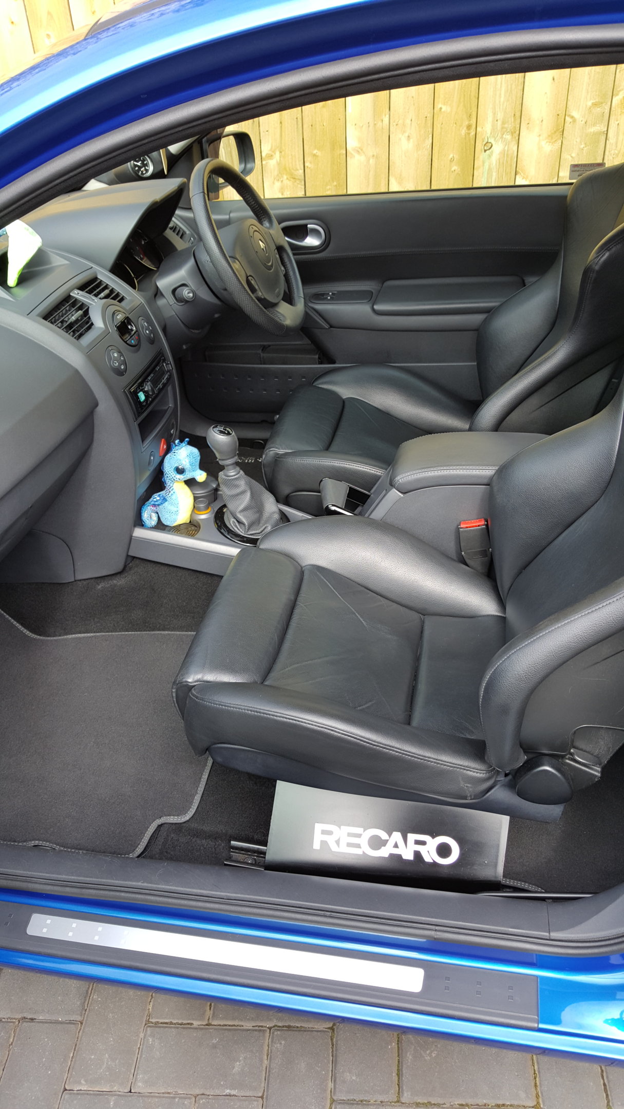

For the last few weeks I’ve been looking at evo 8’s and Nissan s15’s and I must admit I’ve been very tempted but with me and the girlfriend wanting to get a house (mainly due to me wanting a garage) the money would be better spent on a house deposit.
With that in mind I’ve decided to keep the megane for another year and spend abit more money on it doing some bits I’ve been meaning to do for a while.

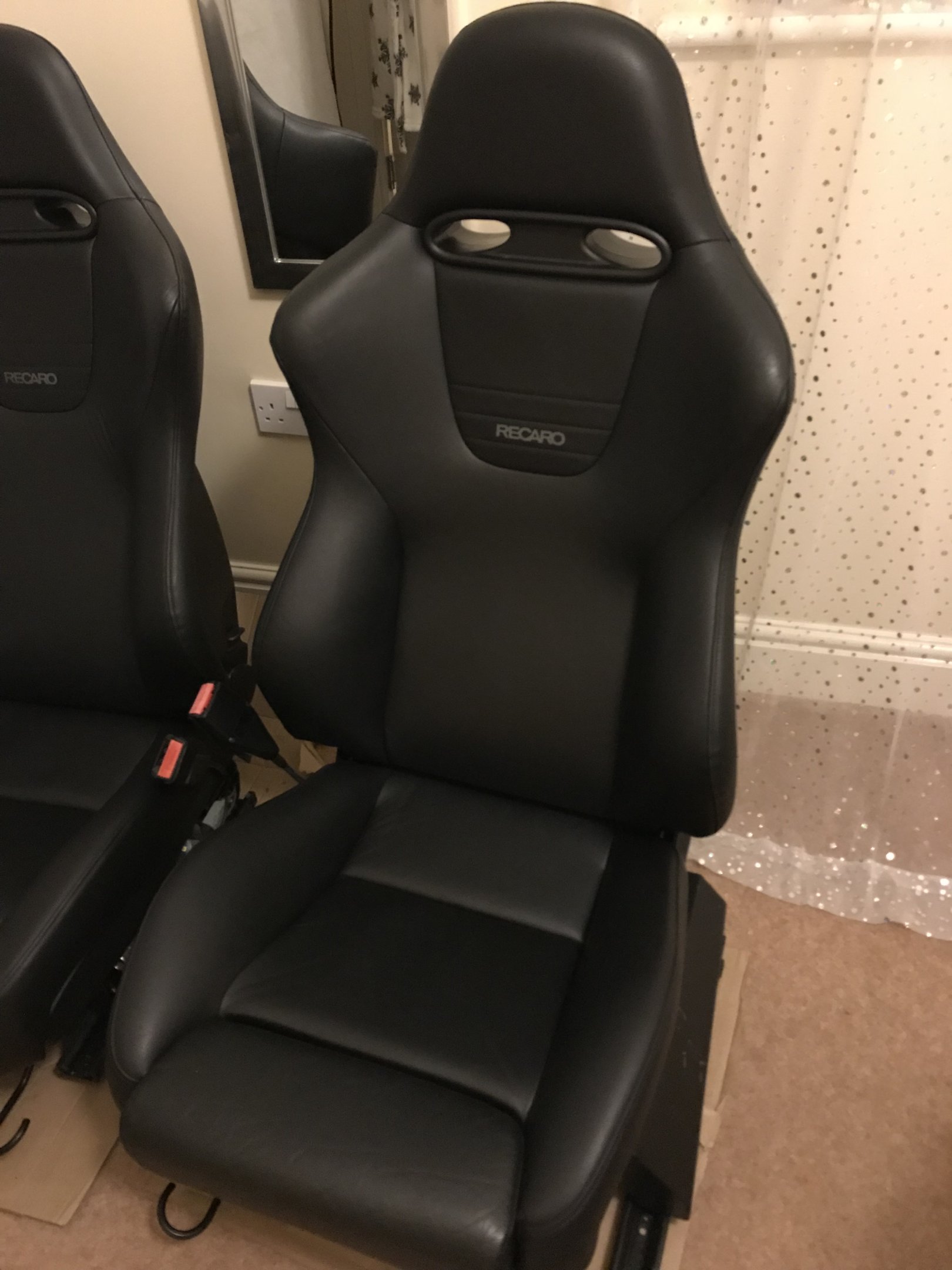

Here’s my recent purchase...
As can be seen I’ve bought a pretty much mint set of full leather recaros! They only have a couple of marks on one of the plastic backs but apart from that they’re in great condition.
They’re on lowered mounts aswell so should have a nice seating position over standard, spent a couple of hours giving them a good clean and condition so will be getting fitted in the next couple of weeks.

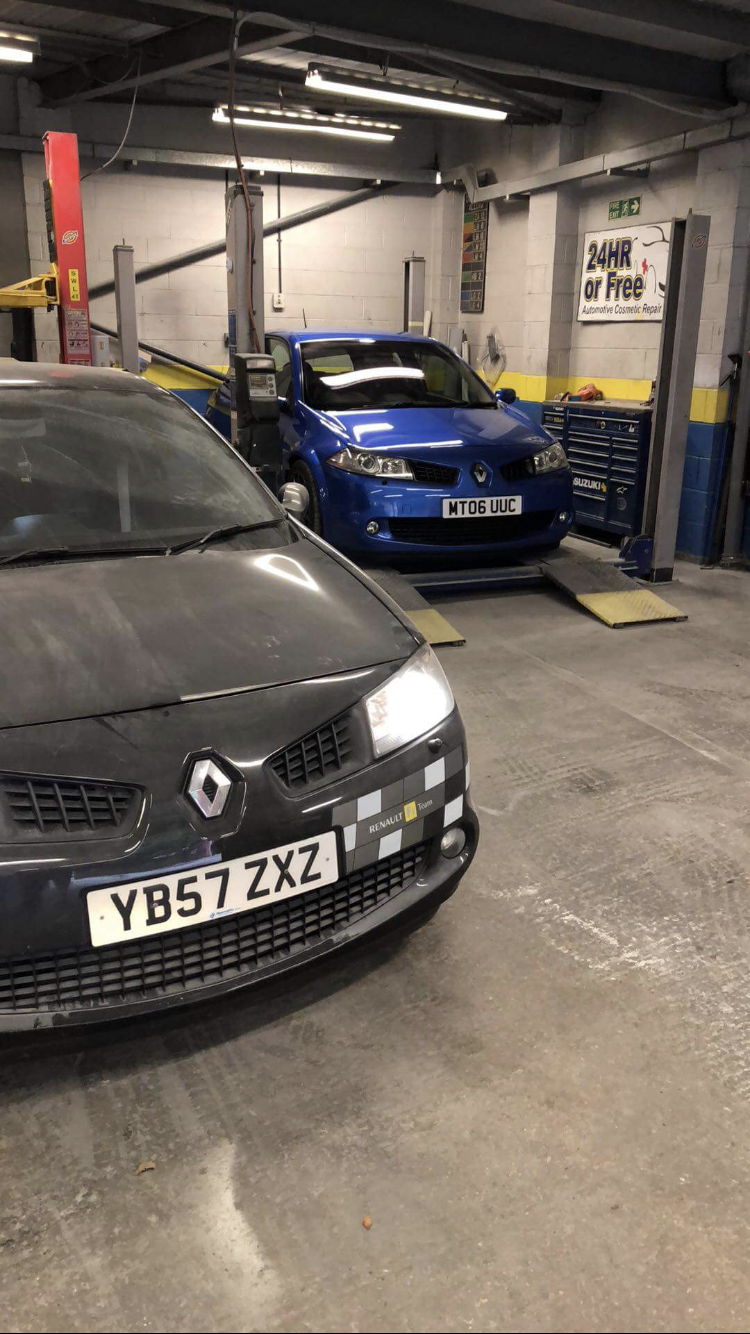

Few things to update since last time I fitted, Had new genuine rear discs and pads fitted at ddc.
dropped the car off today to have the bonnet, front bumper, wings and mirror caps repainted as they suffered with a lot of stone chips and road rash. Hopefully get it back at the weekend but here’s some photos from today.
A fellow Megane owner having some work done too. Does it belong to anyone on here?
