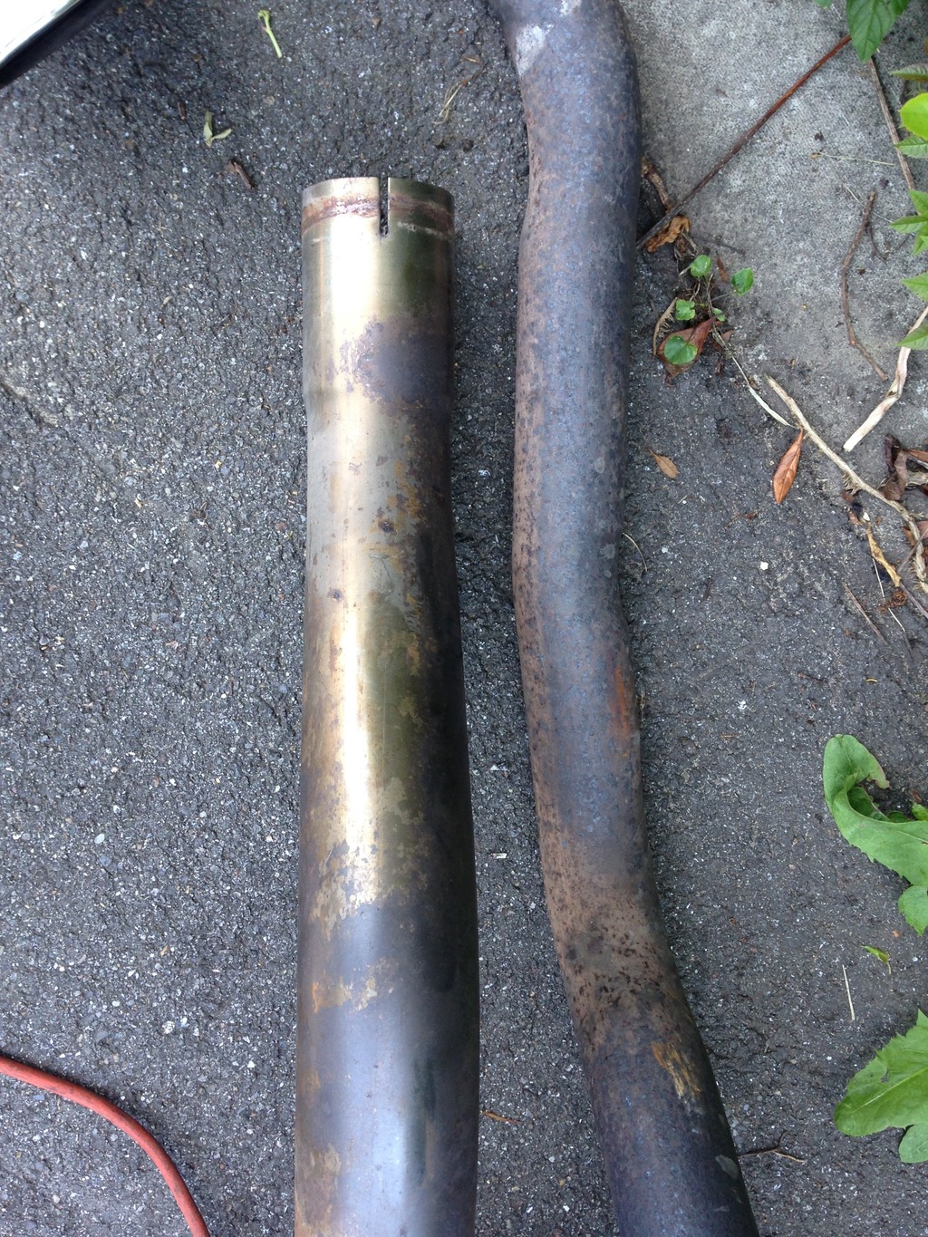

So glad you've got rid of that horrible exhaust :wink:

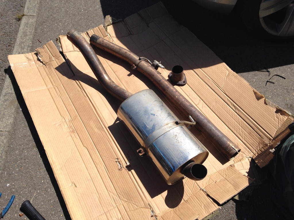

What's the k-tech stealth like with a decat no silencer mid section?
I'd like to know the same, got the cat back on at the moment, and the decat waiting to go on, seen youtube videos of a raspy disgusting mess, hoping thats not the case lol
No idea yet chaps! I've only got the manifold on and it's crazy loud. I've seen the youtube videos too which don't sound brilliant but I'll get a video when the rest of the exhaust and gaskets turn up.

Also wondering how the exhaust will sound. Bored of how quiet my ktec stealth with centre silencer and cat is after hearing a decatted PMS system :hearteyes: such want!

A decat with centre silencer might be the way to go if the full hog is too loud or just raspy and s**t. Will keep an eye out for your video though :wink:

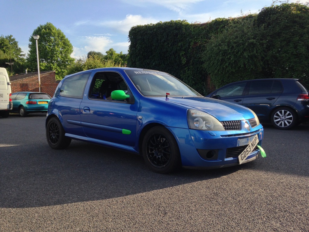

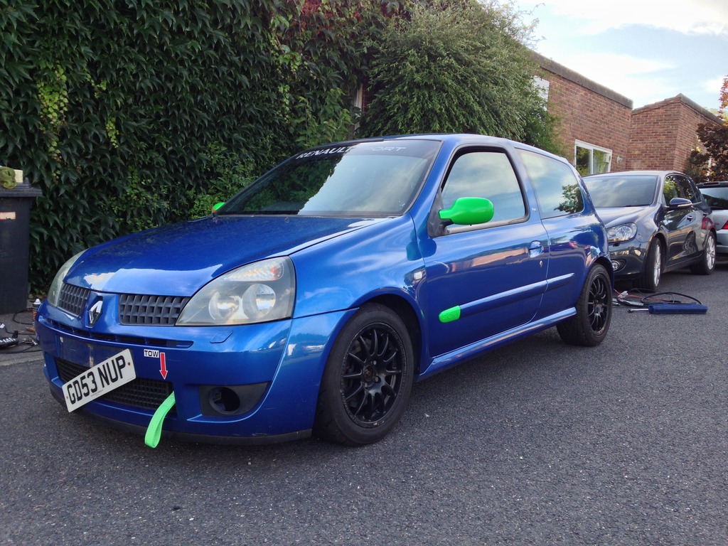

Today I managed to get a little bit more work done on the car as now we've finished Martin's I'm stoked to get on track. It's really nice to know I don't really have much to do any more before it's ready for the track.

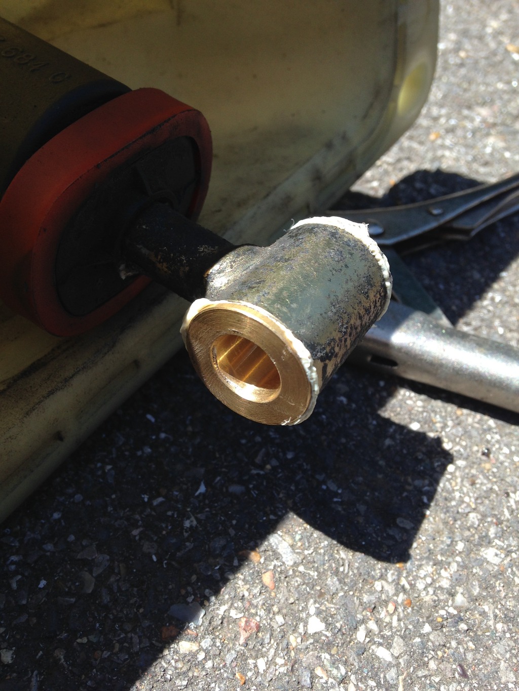

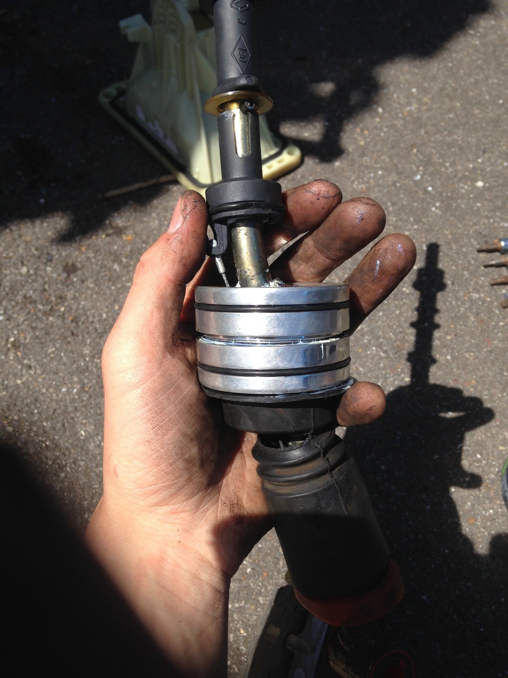

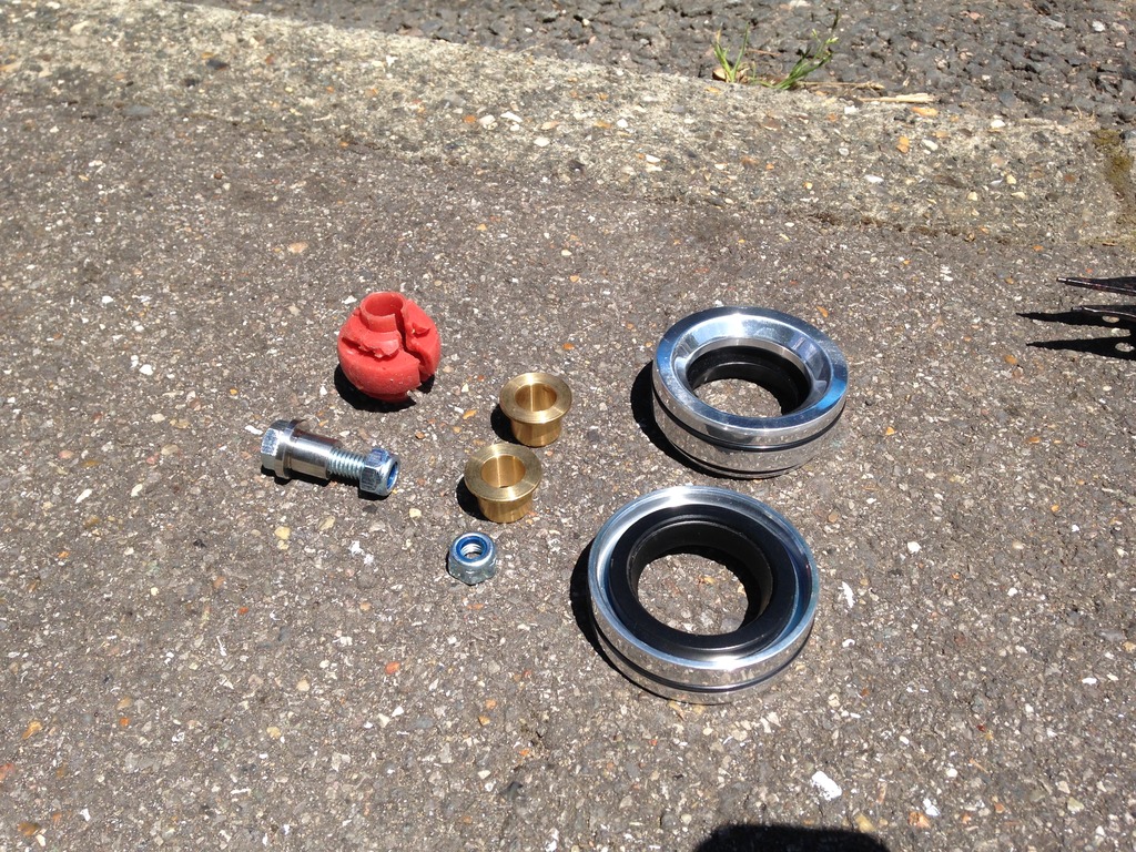

First job was to fit the Yanoo stiff shift 1.0. Of course I managed to break the reverse collar whilst doing this so now it's a little more tricky to select reverse but hey ho. The kit comes with the centre bushing on the gearstick and brass bushes for the bottom. I cannot for the life of me work out what the extra nut and bolt are for and had the same issue with the previous kit I fitted. As expected though the shift feels brilliant, tight and with absolutely no slop. Chuffed. Managed to completely destroy the heatshield in the process as the fixings were welded together. A project for another day.
Just as I finished the gear assembly my little parcel force friend turned up with a present. STEALTH SUPER SPORT YIPPEE. This was a total bargain to say the least. When comparing the old and new systems it's clear to see the old system was rather a weedy diameter. Oh my it's nice to be rid of the big chavtastic tail pipe. At the moment it's not fitted up properly as I need to get clamps, lambdas and wait for the gaskets to turn up but the exhaust is in place :smiley: My concern is that the link pipe is a narrower diameter than the rest of the system so will offer a small restriction. On a side note I put the link pipe and cat next to one another and thankfully will be able to make a bolt in 172 cat to fit the 182 manifold.
I quickly swapped the pads over to the RC5+ items which took all of ten minutes.
Finally the last job of the day was to put my new sticker from @Martin. on the sunstrip. COOOOOLLLL!!!! :cool::cool::cool:
Before I go away I should be able to get the driveshaft and harnesses sorted. Then I just need seat subframes and the battery relocated and we're ready to part, can't bloody wait.

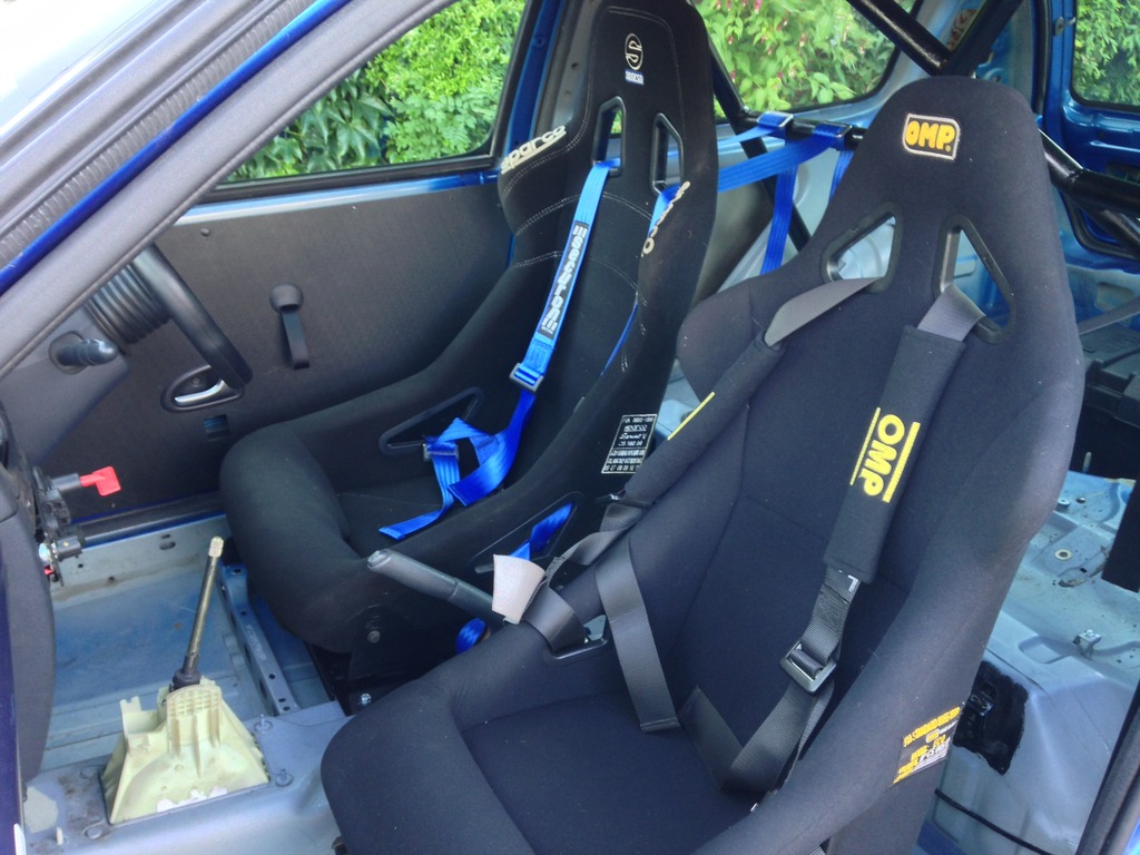

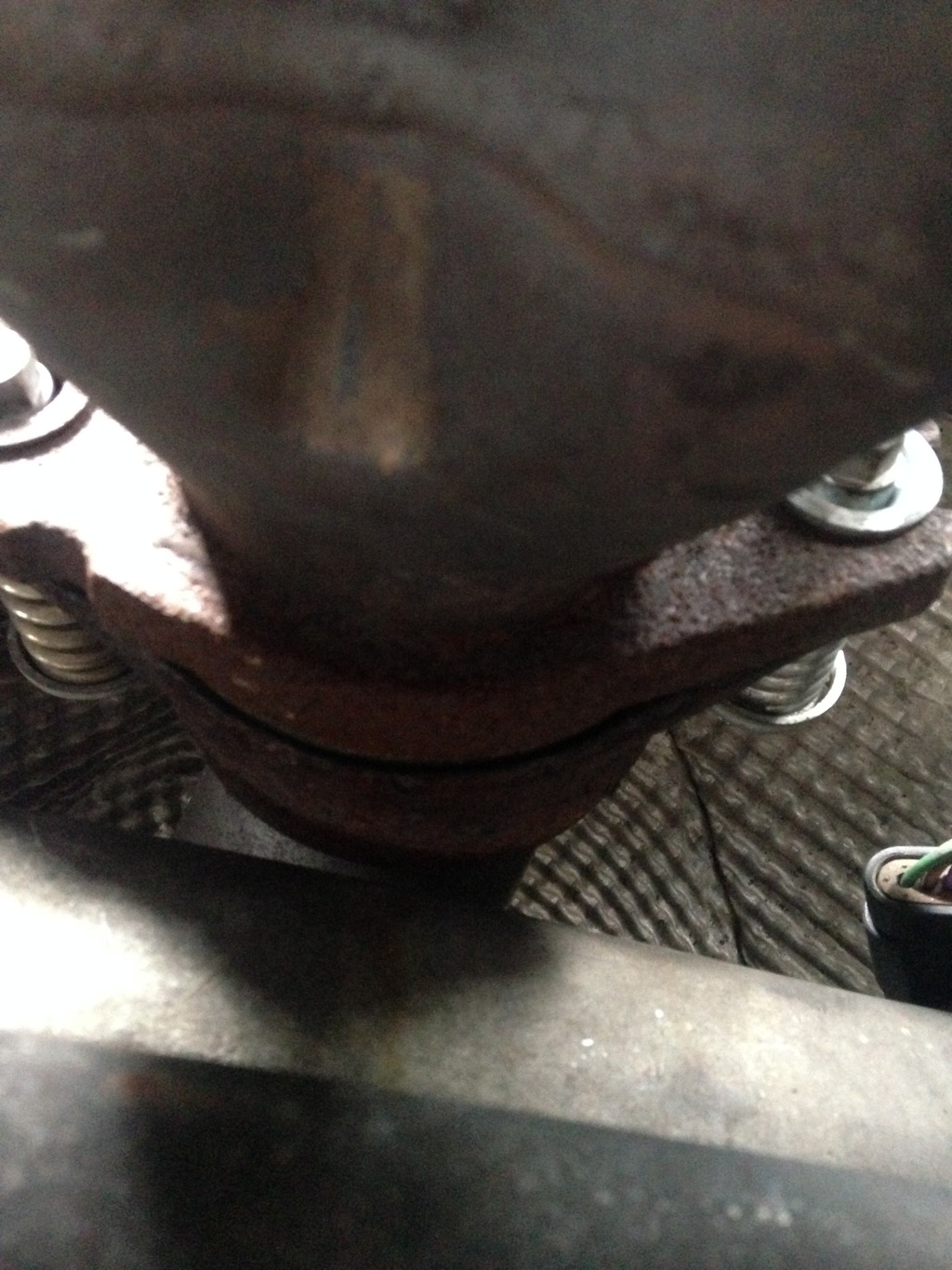

Before I went away I got some omp subframe a fitted. And the exhaust is all on the car now.

  • All gaskets fitting in exhaust and clamp rear section

  • Fit the drivers seat with a slider

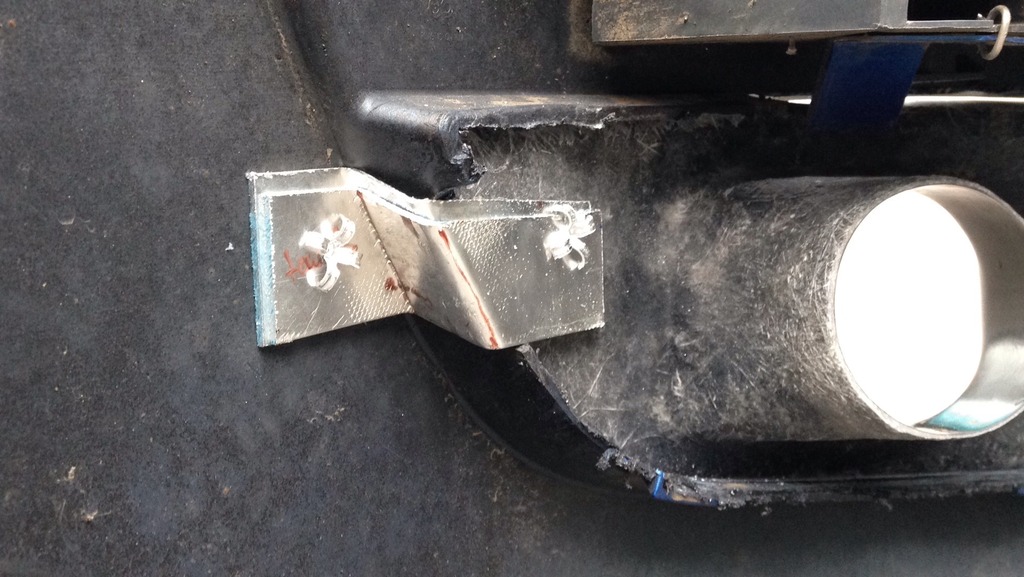

Well I barely got anything done to the car this weekend because of a few hiccups with parts. The little spacers for the harness mounts are marginally to large but not deep enough to fit in the harness fittings. I'll sort that out with mr drill soon.

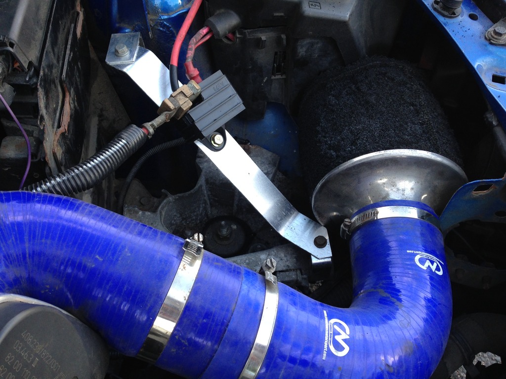

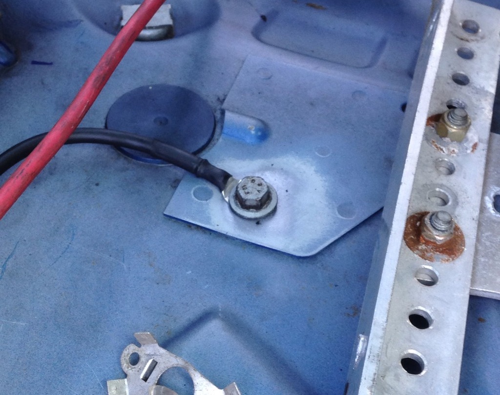

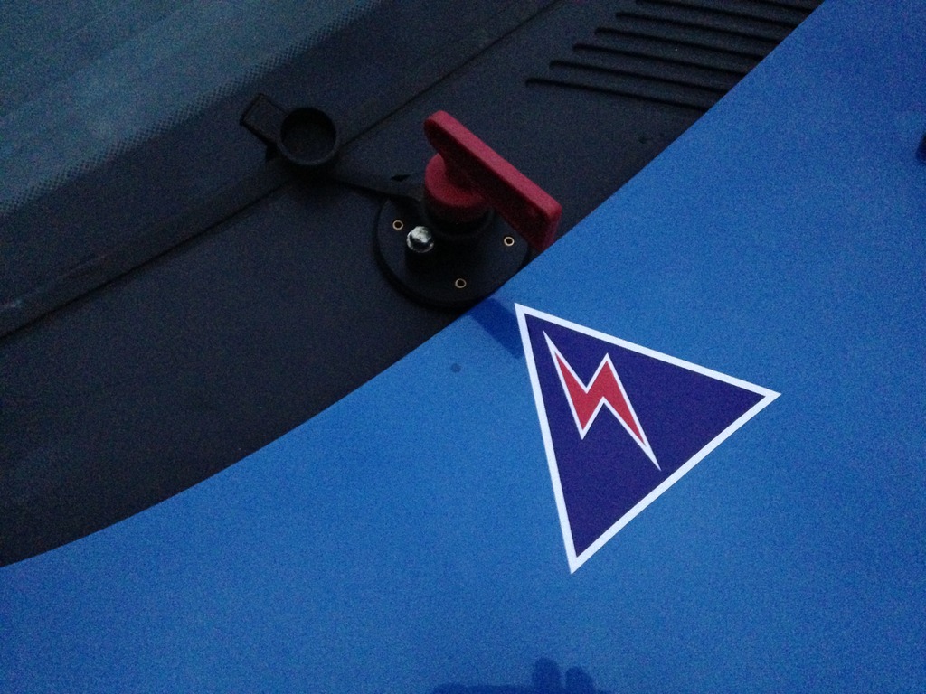

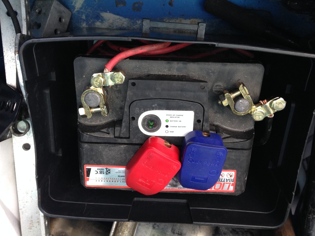

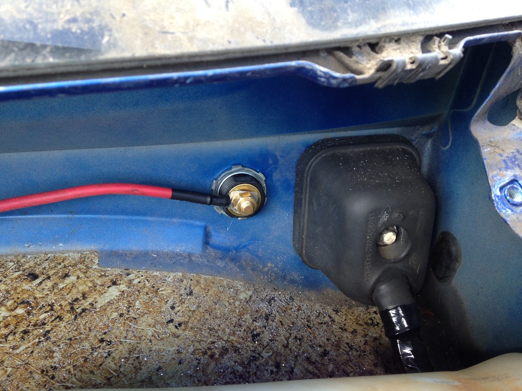

I did manage to get the battery relocated though! It took me almost all day as I want to to make sure it was done properly. I engineered this little bracket out of ali to hold the positive connector block which took me a couple of hours to do properly but I'm very happy with. The wire runs through the bulkhead using a longacre bulkhead thru connector which gives a lovely finish. Earth is on the old isofix bar holes with a nice bit of bare metal sanded out of the paint. At first when I connected the battery it didn't work which was a bit of a bummer but after a quick check using the multi meters I established one of the kill switches was faulty. As a temporary measure I've bypassed it and just have the one inside the car for the moment. In the future I will need to change the cable as it's 16mm and a bit small for the starter to draw on from such a long cable length. Piccies :smile:
Earth
Bulkhead thu connector
Outside kill switch (faulty one!)
The beautiful bracket

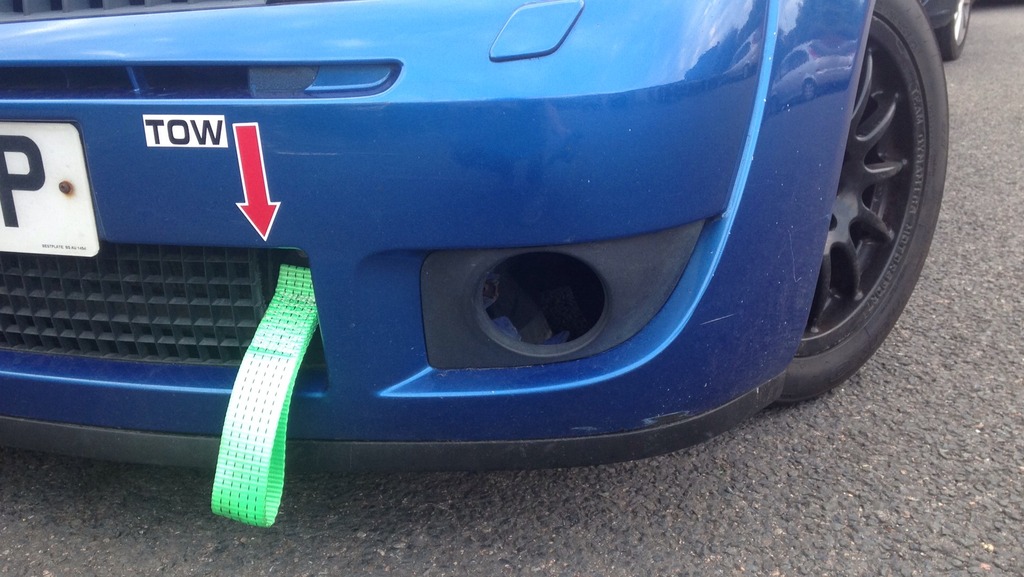

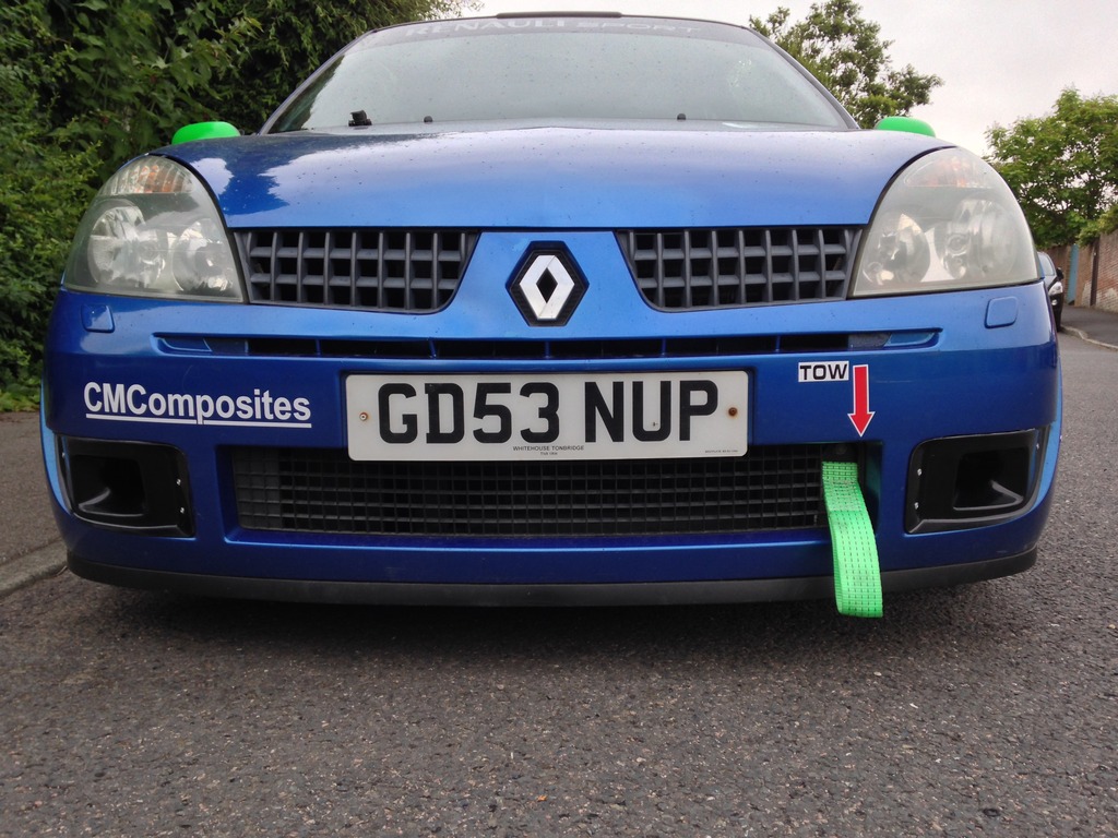

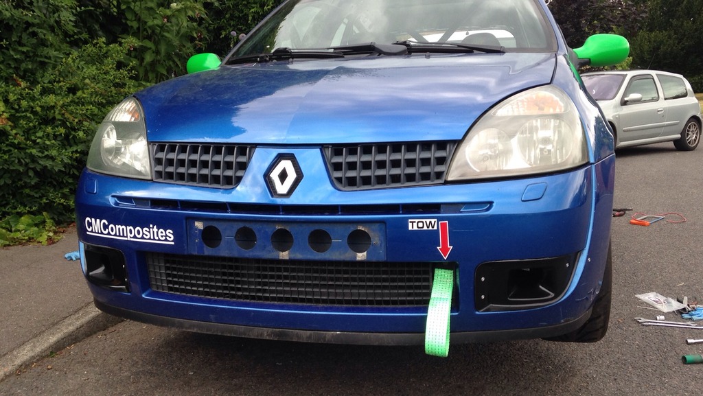

The only other bit I got done today was wack on the tow strap.
finally here are some pics of how it standard currently.

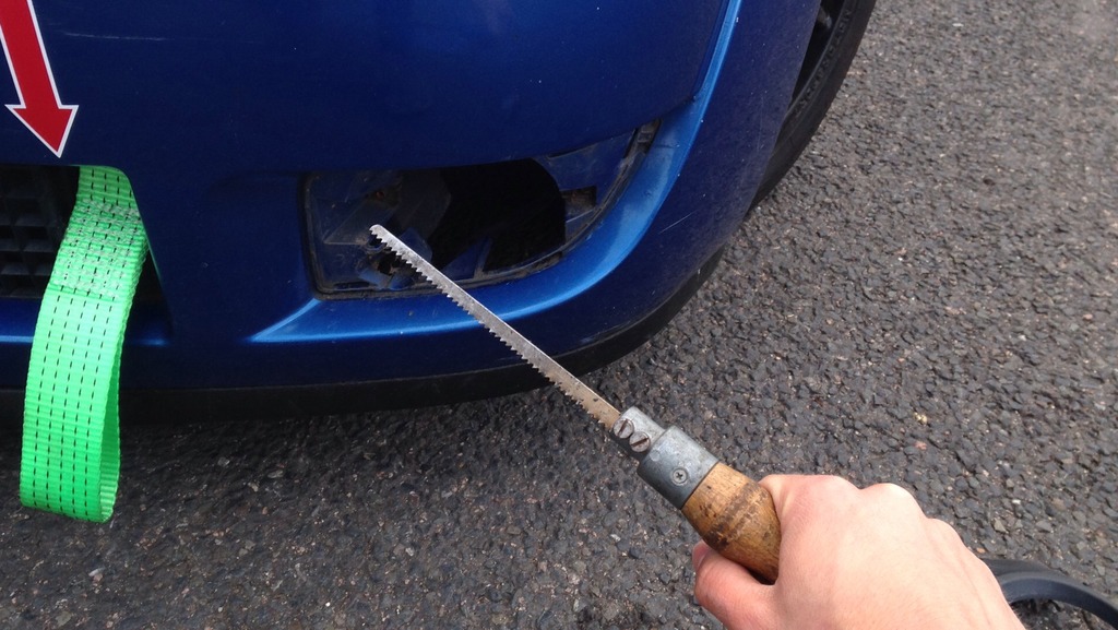

Thank you for all the nice comments chaps. Today didn't go quite to plan and I had a bit of a lazy day. @Martin. popped over this morning on his way home so we went out for a spin with me as passenger because I'm not actually insured on the car, my rents are. DOC cover is a wonderful thing and we had some fun. Stupidly I left my keys in his car like a true plonker so haven't been able to get into the car all afternoon so decided to fit some rather sexy brake ducts from CMComposites. I did get a bit excited when I first got them and accidently chopped a bit much from the n/s fog support so had to make a small bracket to hold the outer section of the duct. A bit of time with the dremel on the front bumper, 6x16mm 4.8mm peel rivets and they're in. Absolutely love them.

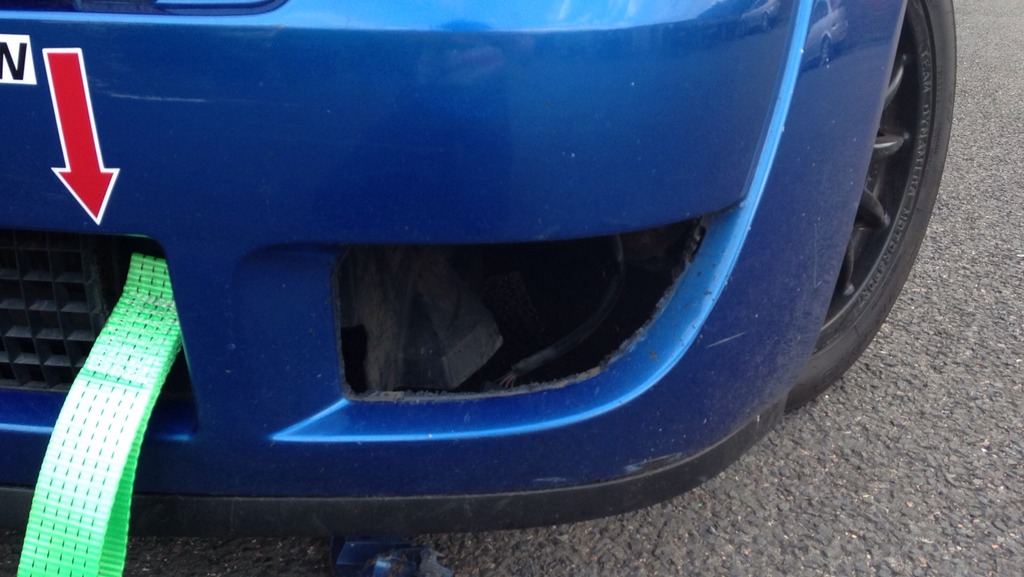

CHOP CHOP
Cut too much out, woops.

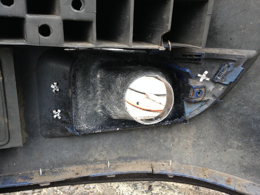

One side done
Also put some new battery terminals on although I really need to get new battery cable as the current one is so thin you can't start the car from it which is very annoying.
....and being the idiot I am I fitted the new kill switch totally wrong but I'll sort that out one day soon.
I've got your keys with me today :smile:
Love the cup. Feels very fast! Would be interesting to see what power it's actually making!
Loving the ducts too, even though you butchered it to start off with, they still look properly done!

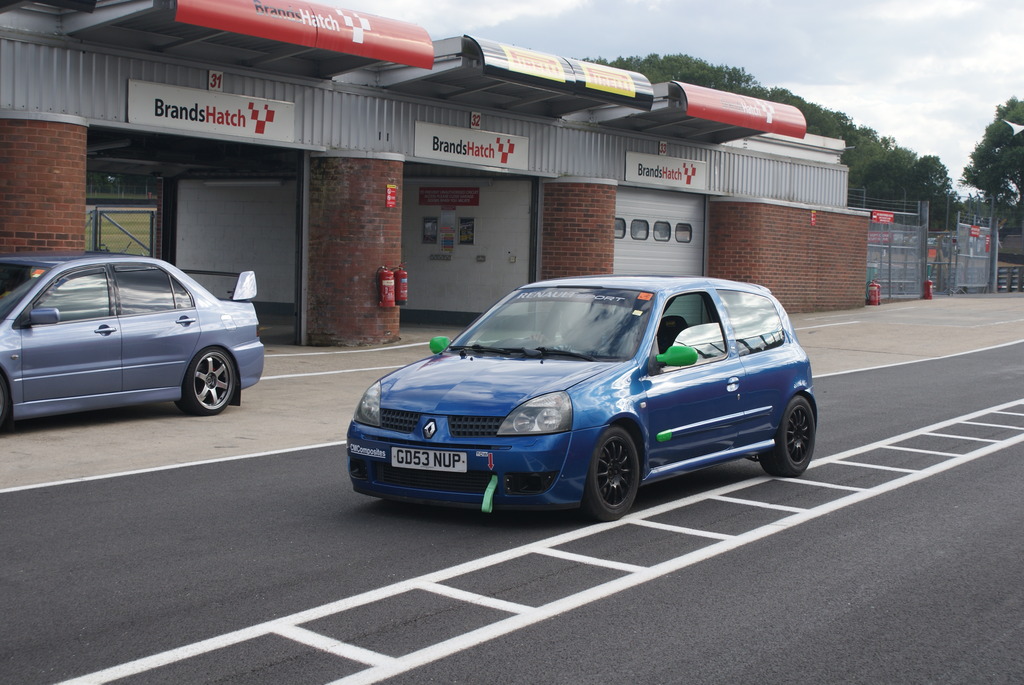

Brands Hatch :D

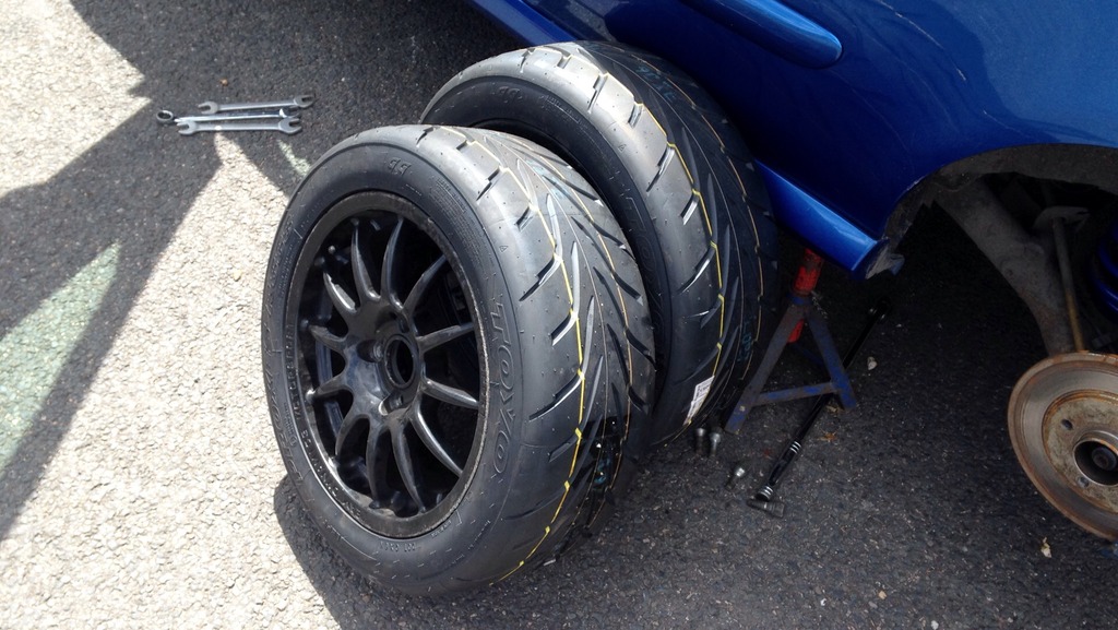

The first track day happened finally and oh boy was it good.
I'll start with the build up to Brands. The car was nearly finished after the last update and so I booked my first evening session for the 28th although this turned out to be the biggest stress ever.
Saturday just gone, 25th, I'd written a list of things that needed to be done to finish the car for the Tuesday and of course it didn't go to plan at all. Saturday morning I put the new lambda sensors in, finished off the interior and unseized the rear brakes. I finished looping the rack using the blanks and pipe, cut some bits in the bumper and did a raft of other bits.
Earlier in the week I'd ordered a 50mm battery cable but this was the demise of the weekend as it didn't turn up apart from all the extra parts I needed to fit it. As a result the battery cable had to be shortened to eliminate the kill switches as the existing 10m was way way too long for 16mm cable. After this I got myself insured with Greenlight so I can drive the car and test out any little mods I do. The big difficulties started with the steering, I drove the car for about 10 miles and noticed the steering was incredibly twitchy in the centre but was heavy after you turned the wheel a small amount. I worked out this could be one of two things, play in the rack or play in the column and after speak to a few people established it was likely the rack and not the column.

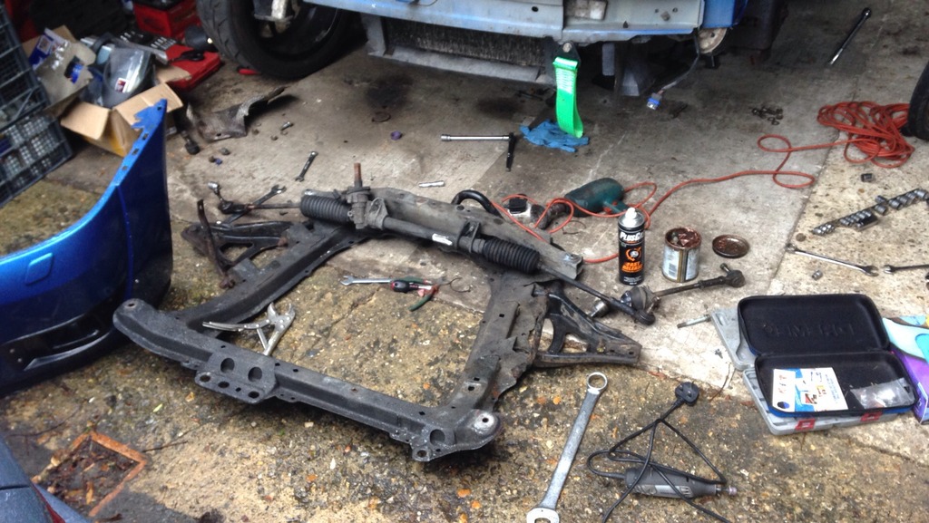

Sunday came and I got desperate for a full DCi EPAS set up so put the call out to CS and everyone I knew. The savior @stevem42 had exactly what I was after and I collected a rack and steering column (just incase) the same day and went about fitting it that evening. To say fitting it was fun would be a total lie but I had the subframe off in 30 minutes and started to fit up the new rack. Quickly I noticed the old rack had a shot inner tie rod so decided to keep the DCI inners and outers. They loosened up nicely and didn't have any knocking. So that was Sunday done.

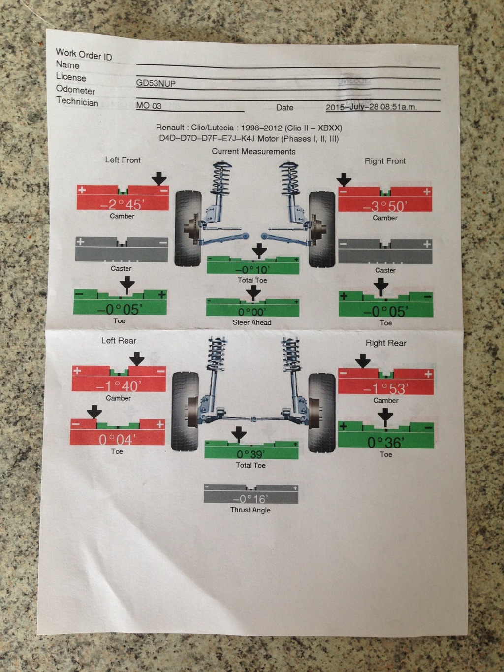

Monday I had work and only 2 hours when I got home to adjust the camber, adjust the lower half of the epas column so the turns were the same side to side but of course this involved taking out the whole lower dash and at 10pm it was all done. The camber wasn't particularly scientific and I just adjusted it to maximum on the bolts which turned out to be 2.5 and 3.5 on the other which was odd. The day of the track day came and whilst at work my Dad got the tracking done for me although unfortunately wasn't particularly clued up on the camber settings so didn't get the 3.5 side done. Hey ho, 5 minutes out each wheel seemed to be agreed as a good setting. Done though, to the last hour, it was a total panic to make sure the car was actually driveable.
So on to the actual track day. I didn't feel good going into it as the car was pretty much untested since I'd done all the work but as soon as I got there I knew it was a goodun.
So the day was a total success. I could unfortunately feel some play in the steering still and had to do the track time with the EPAS off so this will be fixed for next time. I also managed to cook the brakes and after my first session I came in with the brakes smoking a lot but no fade so it' s just a case of getting some pipes and deflector plates on the back of the ducts. As the photos show, had a few bumper issues so will get some catches for that too. Other than that the car was perfect, performed flat out with no dramas and took a real beating with the small breaks it had between going out. Thanks to @Martin. for coming down and once again sorry for the pathetically short passenger time! It was a jolly good evening to say the least.

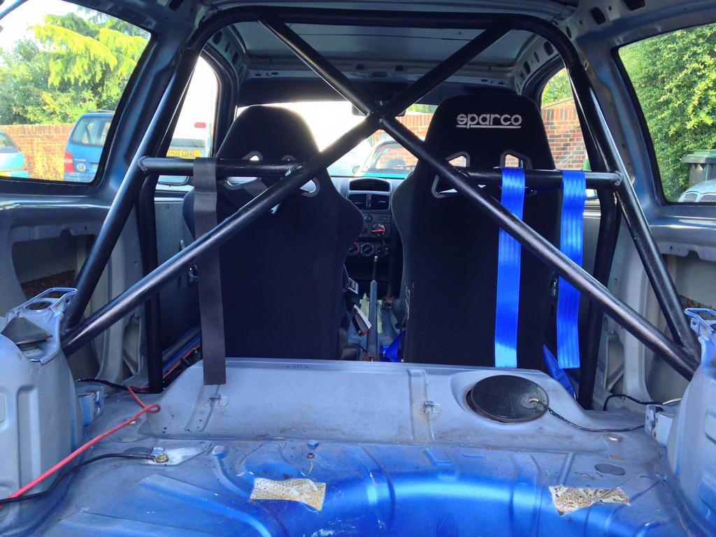

Can I ask how you finished off the harness mounts?

Quick get out there! The booking made me get mine finished despite the final rush being horrible :smile:
I used these for the insides and then bought just the spacer on it's own for the outsides http://www.ebay.co.uk/itm/Seat-Belt...113?pt=LH_DefaultDomain_3&hash=item4199c19201. They're bolted on the exhaust tunnel towards the back to give a good angle for the harness. The outside is in the existing seatbelt bolt hole using the original bolt. Top is of course around the harness bar.
@sburrell93 it was 94 db at 5k with the 182 mani, link pipe and supersport stealth.
Ah cool thanks. Take it yours are bolt in harnesses then and not clip in? Have you got a photo of the exhaust tunnel bolts? Did have the bolts go in facing the the roof or on the side facing into the seat? Enough room for the spreader? Questions questions lol...

Mine are bolt in yeah although I would prefer to have clip on ones. It came down to cost though. I haven't got a photo! the only one I don't have. They're on the angled part of the tunnel close to the rear seat box. I'll get some photos as soon as I can but the car is garaged up ATM.
Yes though, absolutely loads of room for the spreader plates in the tunnel.

Cheers for that. Just waiting for delivery of spreader plates and the paint to dry inside lol....

@GrahamS did you have to remove the dashboard to get the longacre battery connector through? I had the top off today and looks like i have to remove the whole dash!
GrahamS
I didn't no although it's a bloody tight squeeze behind there to get the nut on the terminal. The difficulty is that a lot of the bulkhead at that level is double skinned or has a hollow behind it for the screen vents so your options are limited. Definitely possible to just have the top dash off though.
Akay
  Clubman Cooper S
Thanks. Id prefer to do it there purely because it looks neater and is out the way! As mine has abs my options are limited until further down the bulkhead and then im worried about corrosion!

The skuttle is definitely the best place because it's always dry in that place and won't cause leaks if the car gets caught outside in the rain. The run to the kill switch in the centre is also reduced compared to having the thru connection lower down.

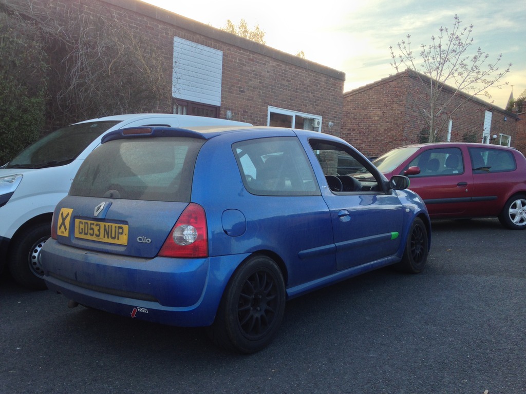

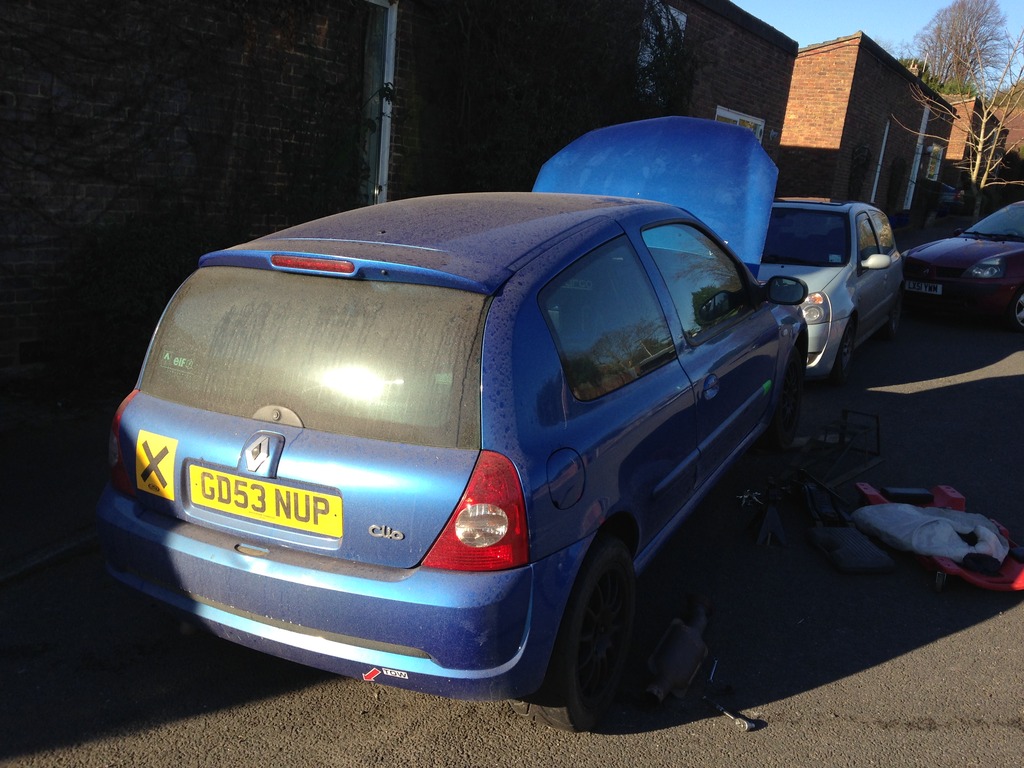

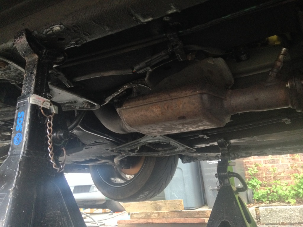

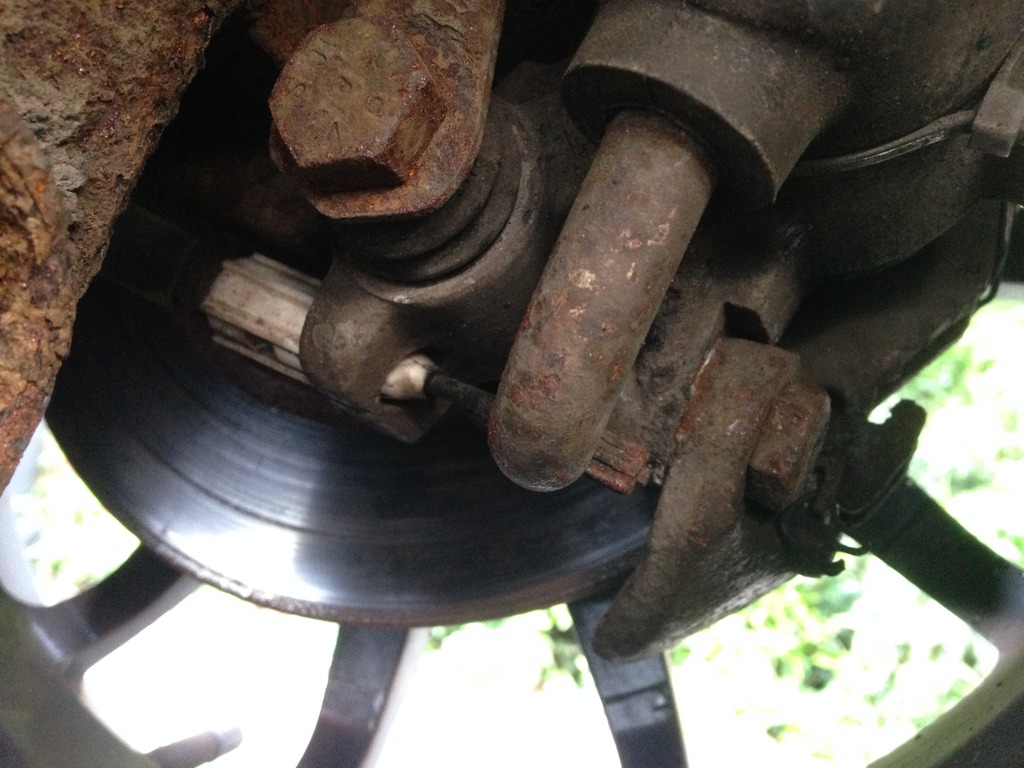

MOT epic fail this morning!
Last night we went at picked up the car from the barn it had been laying in for the last three months. I knew the cover had blown off before I got there and I was of course expecting the tyres and battery to be flat. It fired straight up though and after a little slipping down the track we were out on the open road again.

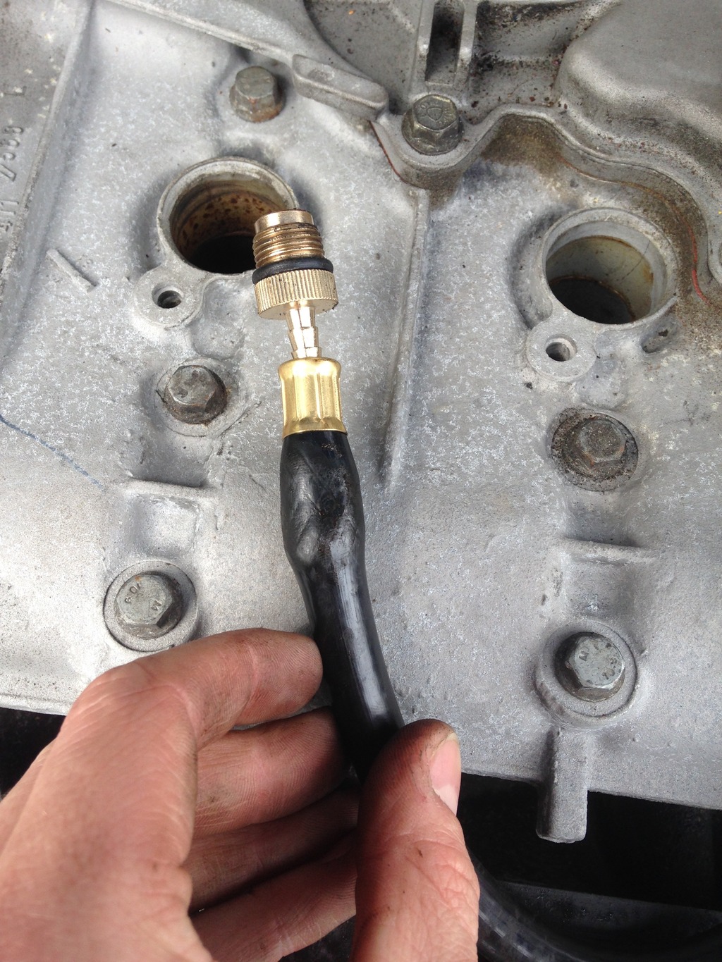

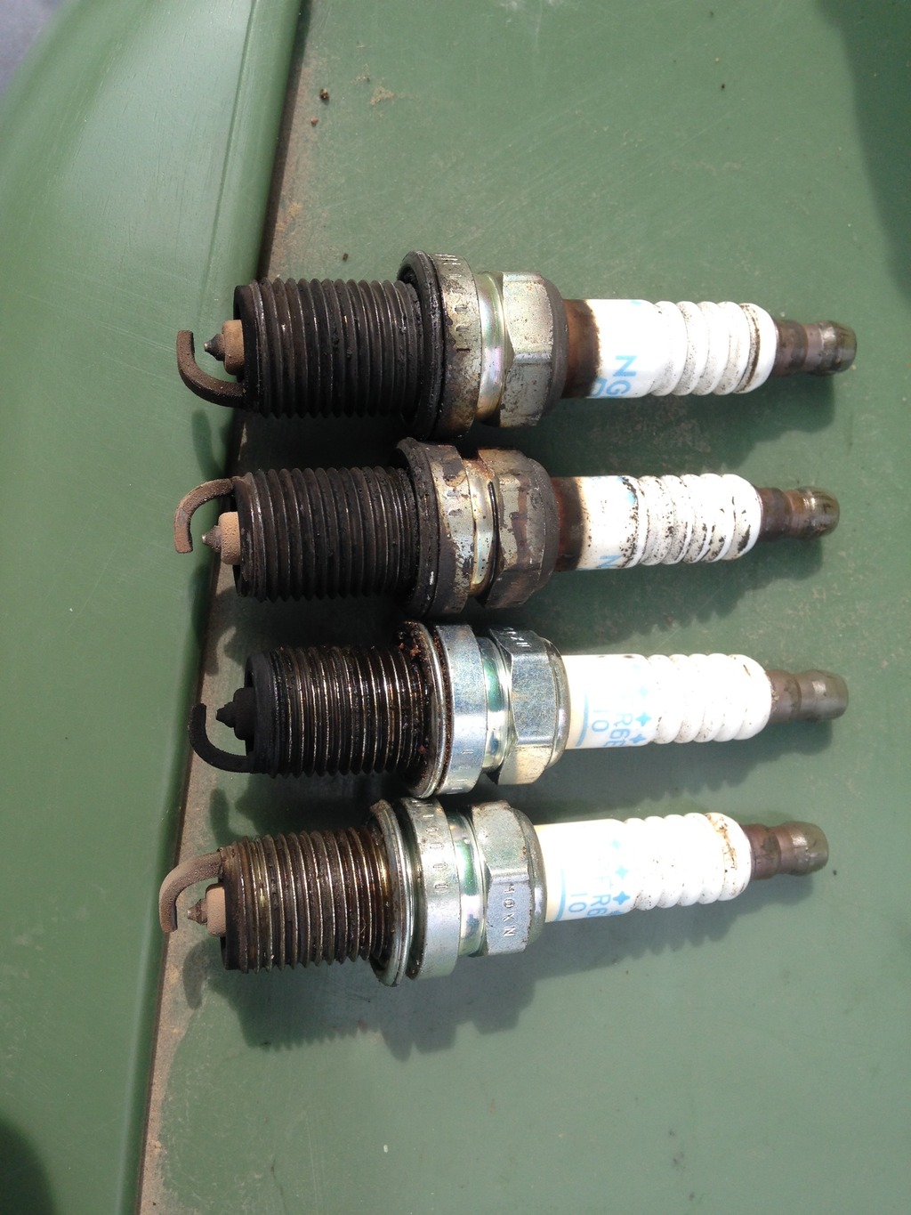

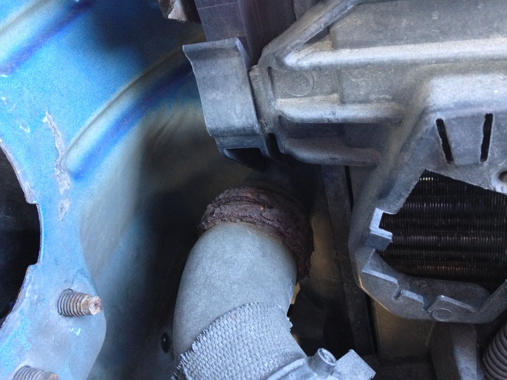

This morning my plans to get the car MOT ready just weren't meant to be. I went to get the cat welded into the same size as the link pipe, got to Laddingford engineering and then found out what I thought was the cat had been split and decatted...brilliant. To cut a long story short the poor quality cat fitting kit snapped a bolt, I forgot my laptop to turn off the engine light, I lost my compression tester and I found out the squib was not recoverable for a horn. It was also 2 degrees and not nice weather to be spannering in.

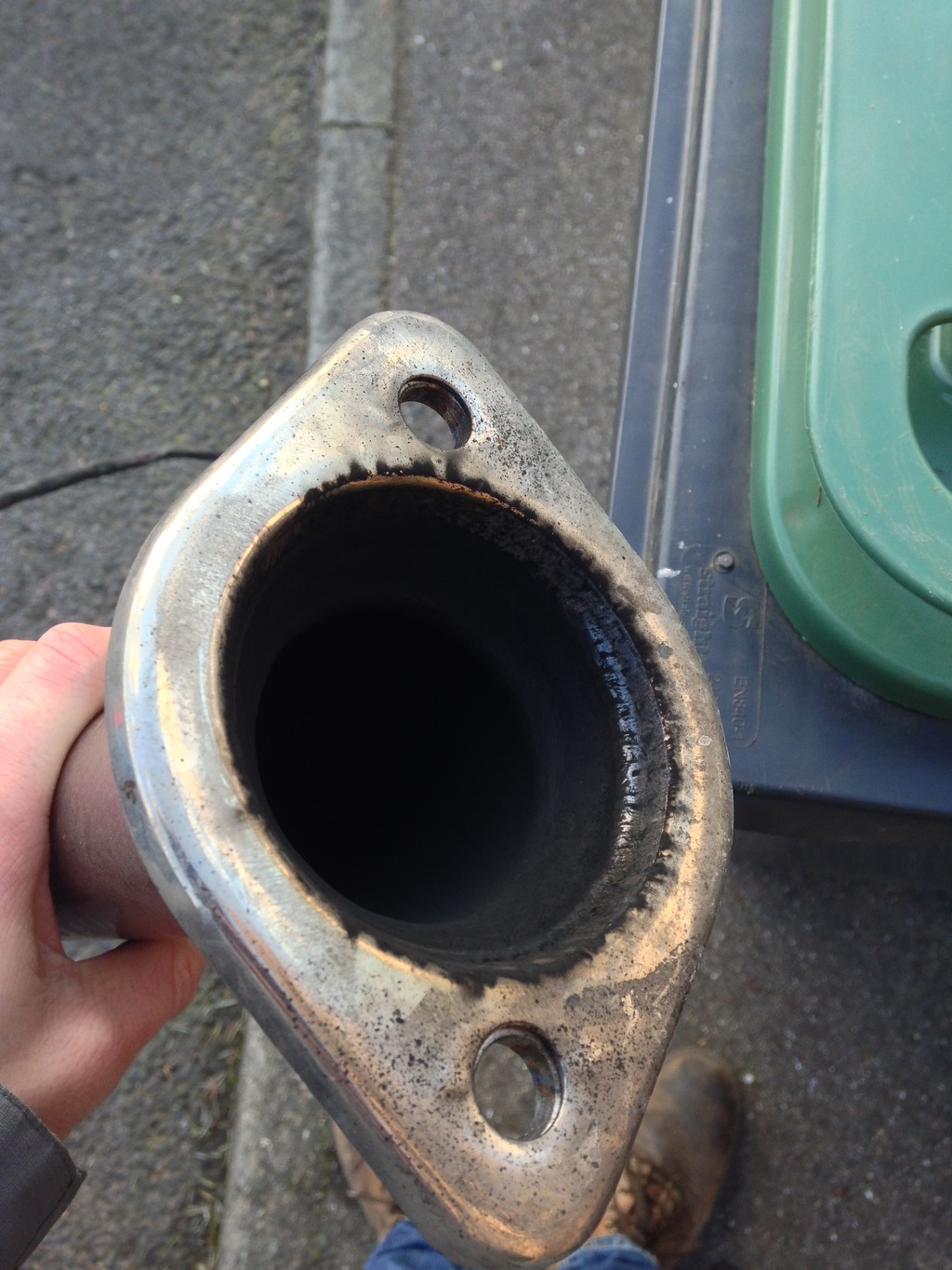

Soot! Lots and lots of soot in the exhaust. I think this is a valve stem seal that's gone but am waiting to have the manifold off to see if one of the exhaust ports is sooty. I'll probably do this job myself if it is the stem seal.
Rusty rad clips!
Think a mouse has been at this
Junk
Barn dust
I now have a long list of bits to do to the car before it's back on the road but unfortunately this isn't going to start taking shape until may when I finish my uni exams and am free forever :smile:

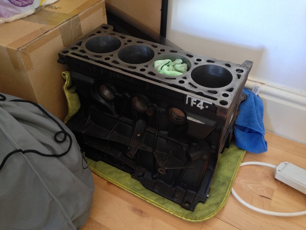

Plans for the car are to rebuild the engine with new rings, all bearings, seals and a rebuilt head with f4r830 valve springs as they're about 12% stronger from my calculations. @Engine Dynamics have recently done a 230 kit with these springs and have seen good results so I'm going to future proof the engine whilst it's being built. Cams will be 438s from my 182 but when going boost I'll swap back. Eventually boost will happen but not until I've got the cage in and the rest of the car is a spot on base.

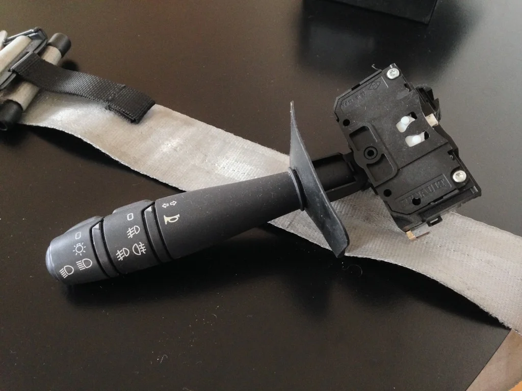

These are the bits I've got waiting to go on the car.
172 manifold, cat and decat (need 172 bits for MOT ease, 172 decat for when boost arrives, will swap back to 182 mani for track sessions whilst N/A)
Honed engine block. Will check mine when engine is apart to compare condition.
Head gasket set

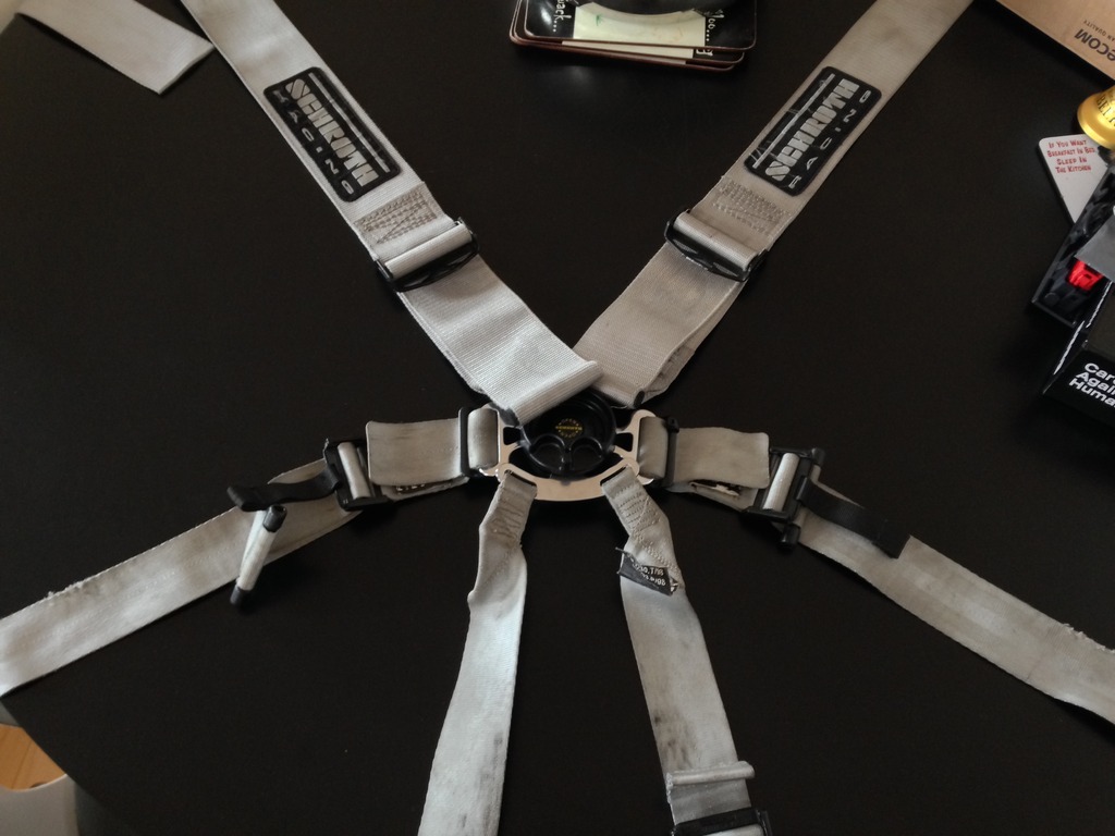

Schroth 6 point harness (not sure which model)
OMP 4 point saloon harness (may convert to 6 point)
ph1 horn stalk
walbro 255 FP

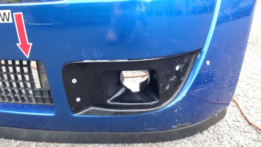

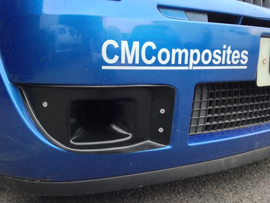

Cup Racer Ducts and deflectors (non-gen)

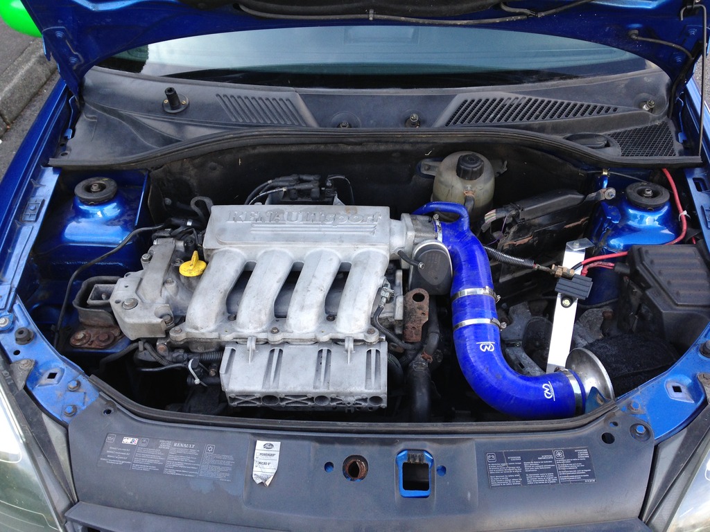

It's action week! I'm spending the whole week working on the car after having my final ever uni exam on Monday. Since January time there's been a huge growing pile of parts in my living room ready for me to fit but it's certainly a task to get them all done in such a short time period.
After picking the car up on Sunday from it's resting place it was a brilliant drive back. I noticed a couple of small things which I wanted to address, the main one being a misfire which has developed. More on that later. The week hasn't exactly got off to a flying start. Tuesday was almost rained off completely although it allowed me to clean the car which was suffering from a bit of barn dust. A quick dry spell thankfully saw me get the 172 manifold and cat on the car for MOT but I found the car has been binned on the o/s at some point, nothing hurting the car now but the subframe looks to have taken a knock and there is damage to the inner arch. There's also a fair build up of surface rust on parts where it's been sitting on soil for the winter so the sooner I get a house the better. Slight issue with the 172 manifold touching the subframe but hopefully the solid engine mounts will resolve that as bringing the standard o/s mount didn't rectify it yesterday.

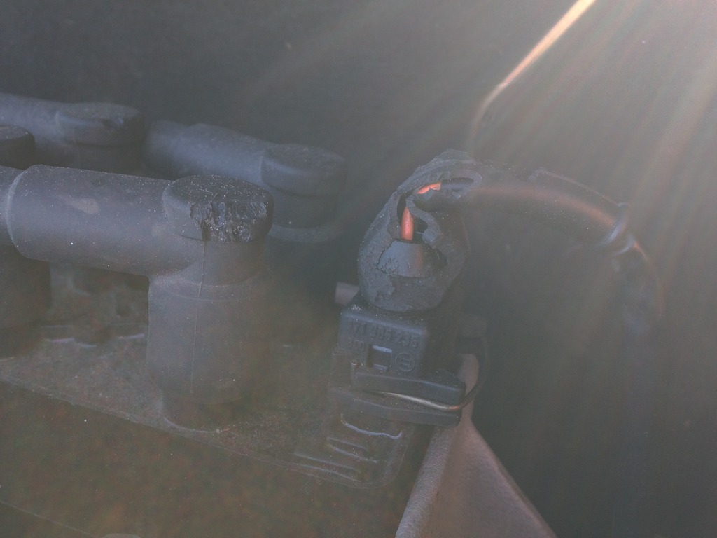

Wednesday was a better day for getting things done although wasn't perfect. The misfire was really bugging me and I needed it to pass emission at the MOT so went about trying to find it. A quick pull of the plugs showed cylinder 2 was sooty and not firing correctly, I think it's the injector but am yet to try all their resistances when cold. Unplugging the lambda and all the other inlet sensors didn't make it better so it's safe to assume it's the injector, plug, leads or coilpack. Luckily I can swap these from the 182 to check. Amusingly after taking the plugs out I went to test the compression and the thing exploded sending the main unit flinging out and leaving the fitting in the head....a slight brown pants and very loud moment. Thankfully it came out with ease.

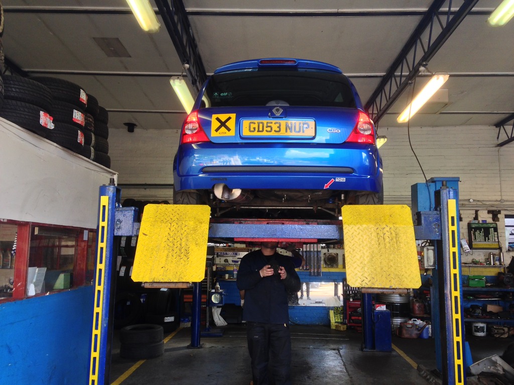

MOT time in the evening did see the car fail but only on minor things which I'm glad are getting sorted. Front wheel bearing is totally shot and has a lot of play in, potentially my steering issue and the hand brake being inefficient on one side. Upon further investigation a complete plonker has put the o/s handbrake cable on the wrong way round.

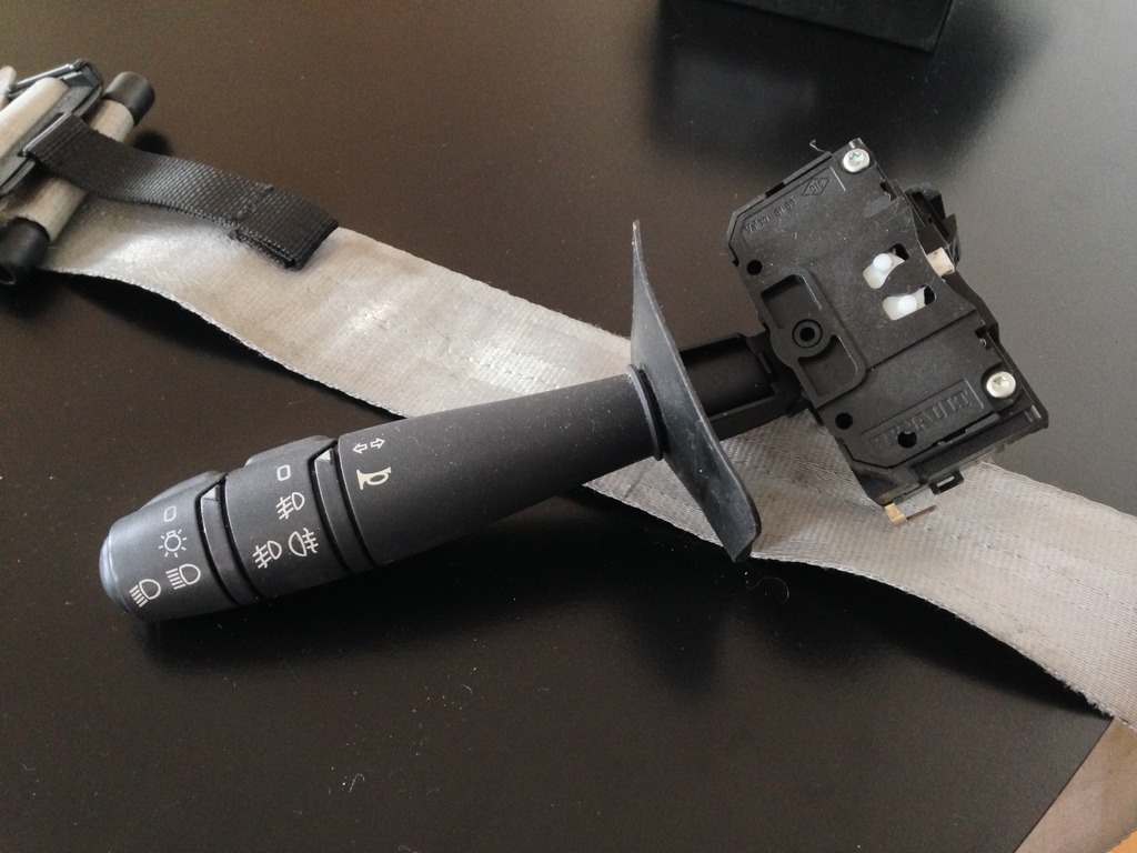

  • PMS shifter

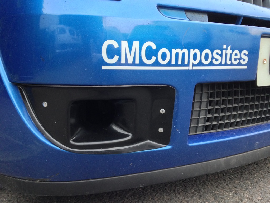

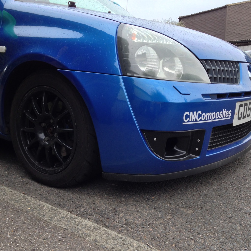

  • Cup racer brake ducts

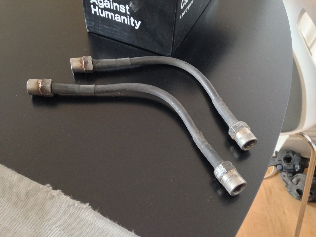

  • Braided lines and TYP200 fluid

Looks awesome.
What you doing with the brake ducts you have fitted? I'm after some but thought CMC had gone?
