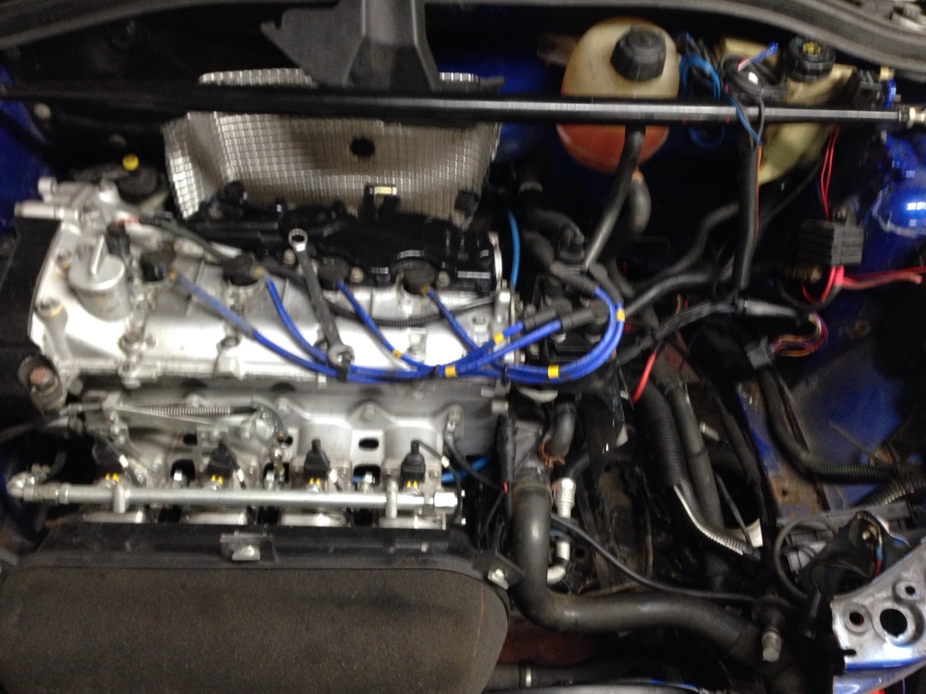

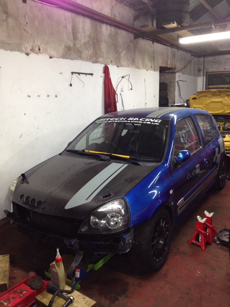

It's a demo car for Sitech racing so not forged yet as trying to see what standard parts will take. Justnow it has intake , exhaust, tubular manifold and a efr turbo.
He went out in the knockhill round of time attack as a one hit wonder and ended up winning his class

Thanks makes for a easy switch out then , I may move the ecu and fuse box inside the car to clean up the engine bay.

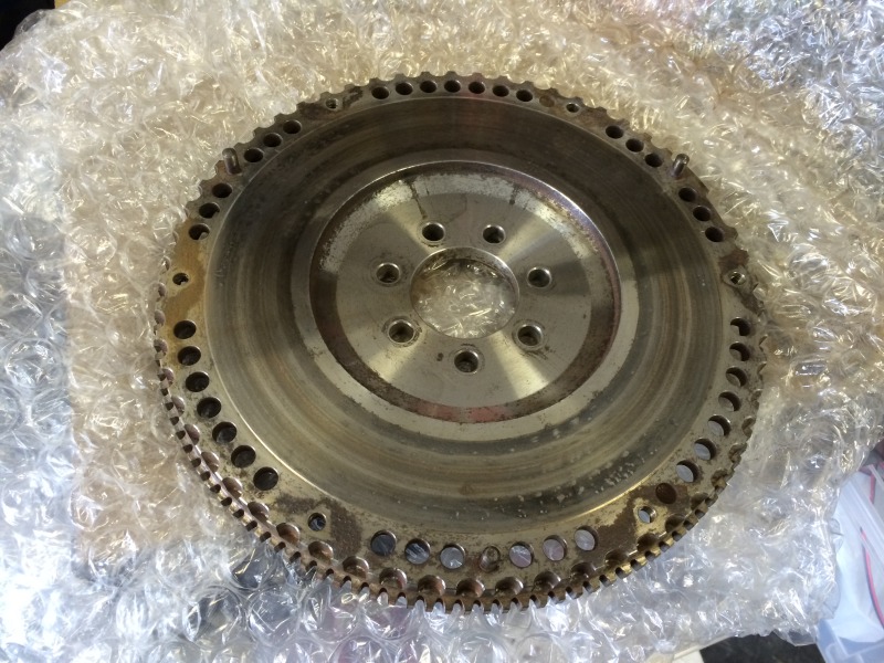

Well parts a piling up while I'm away on holiday I now have a gripper box, lightweight flywheel and some rear AST suspension to fit, only problem is I won't have time to fit any of it before I have to go back to work. So looks like that might be a job for Fraser and Stu lol.
Are ARP bolts worthwhile for the flywheel or just new standards and some lock tight ?

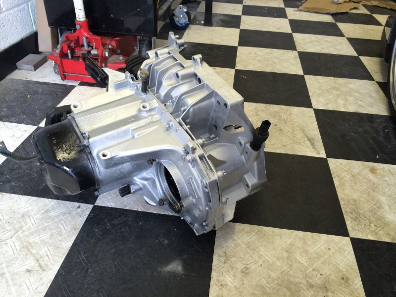

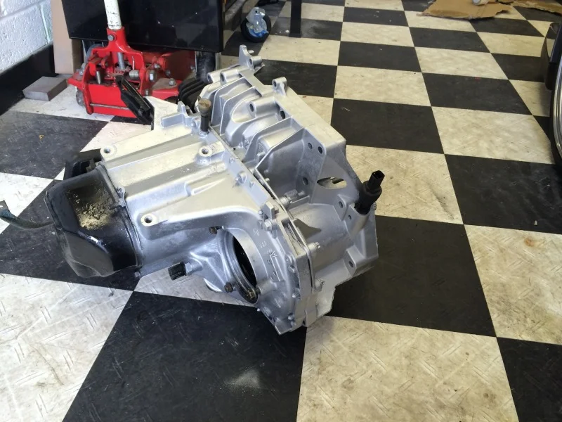

Jon Foz kindly dropped the box off yesterday and flywheel turned up today :)
I gave the box a quick paint as it had been painted black in the past.
I will be dropping the car off to Fraser and Stu from on here for the job of fitting the parts while I bugger off to the other side of the world with work.

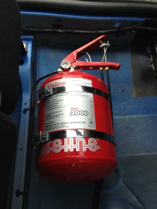

After reading the regs I need to make a few more changes, mainly saftey stuff with kill switches , fire system and also need a fuel sampeling point.
Ive just bought the Lifeline kit and kill switches from Jon Foz on here so will get that fitted over winter, the other thing I would like to do is move the ecu and fues box from the engine bay to inside the car. As I hate wiring this is a job im really not looking forward to.

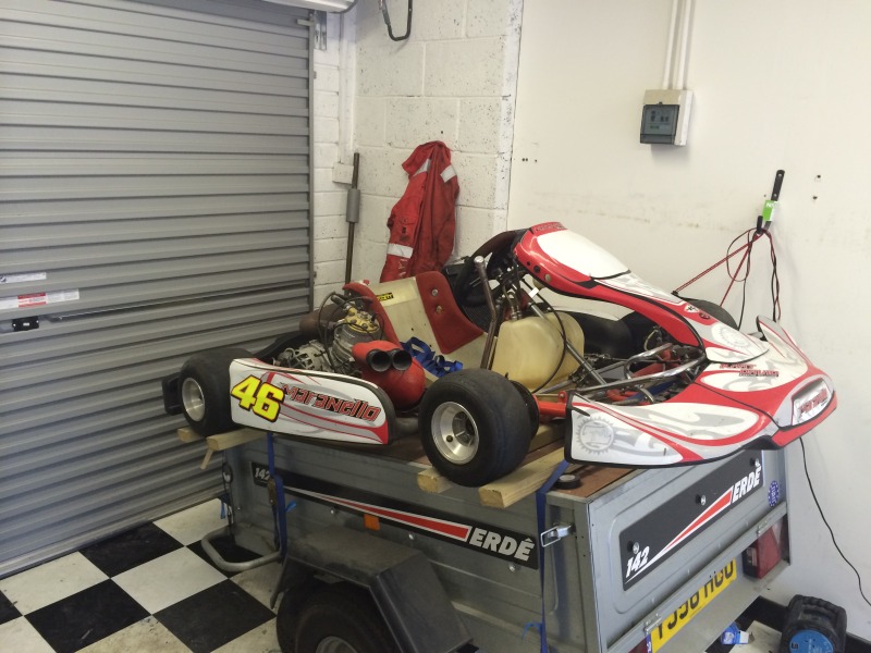

Its a 2006 intrepid chassis with 2005 Vortex 125cc engine (42bhp) , 6 speed box , 50mm axle ,tiller seat....
They are brilliant fun much more so than my old rotax max that i had, I have a spare 2006 vortex engine in the trailer thats not been ran since it was rebuilt.
Is that power output correct. 42bhp from 125cc is 336bhp per ltr NA. That F1 levels of power output.
Yip the engine thats in just now might be down on that a little as its due a piston soon , but 40/44 bhp is the norm for this class of kart they rev to 12500 rpm.

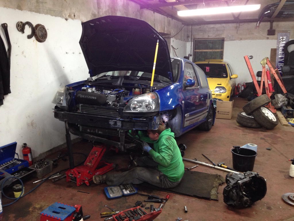

Well Neil hired some help while he's abroad working.

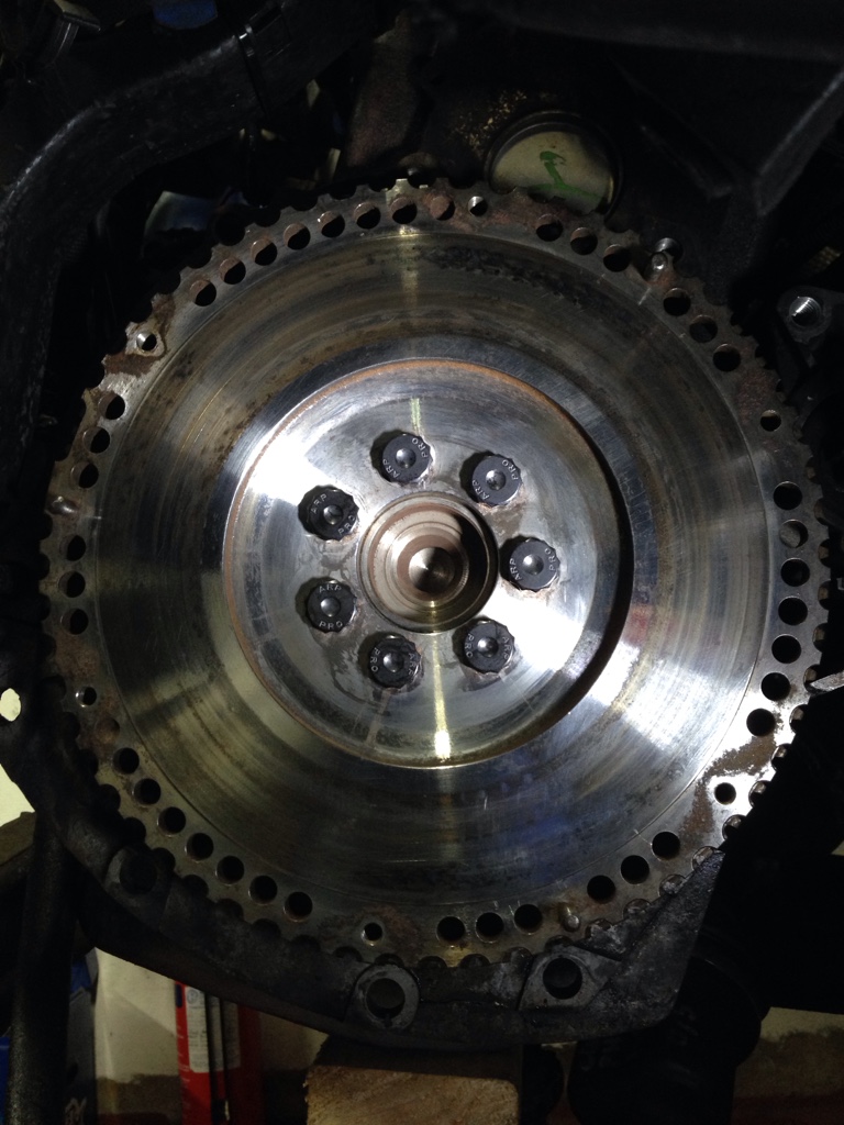

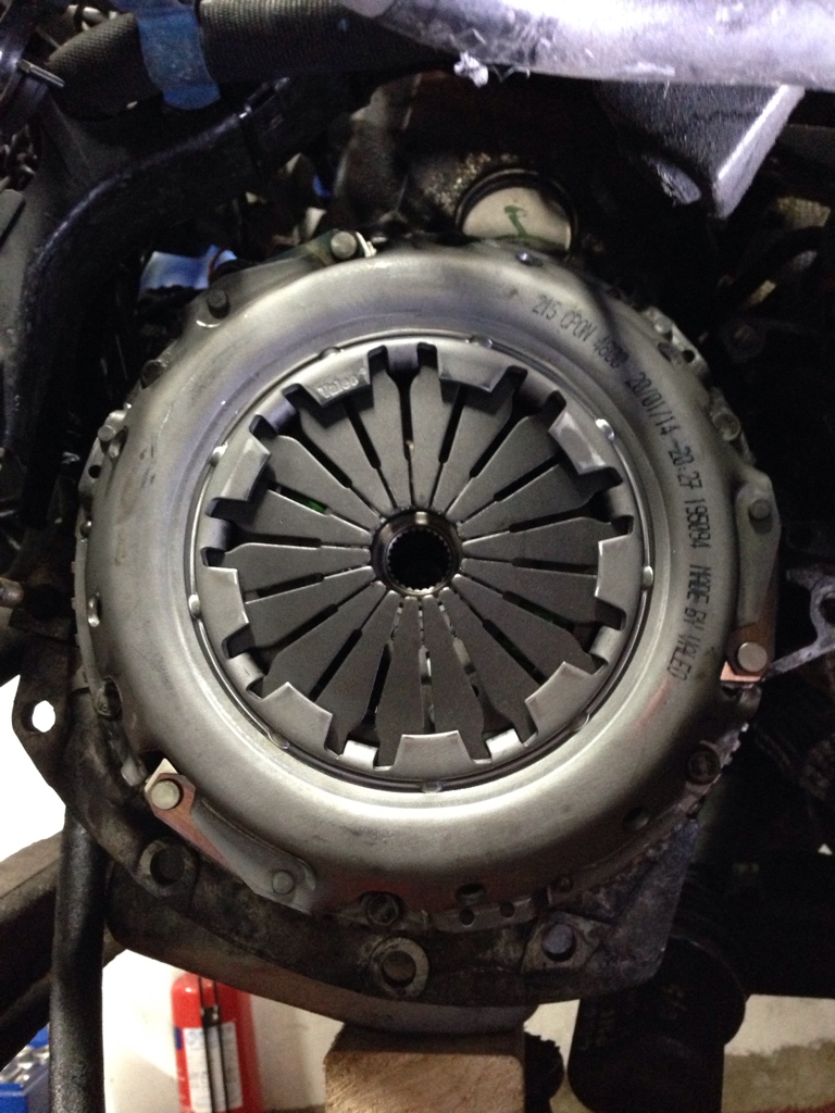

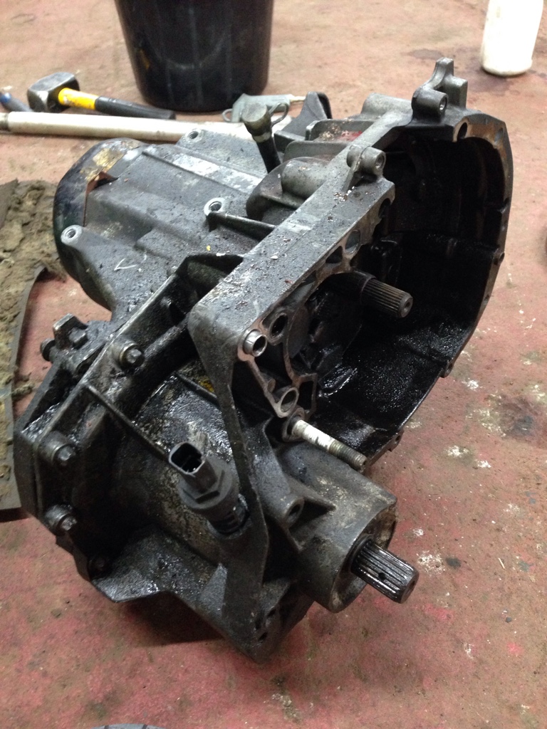

Me and Stu made a start tonight on removing the old box, clutch and flywheel, ready for the new billet fly, ARP bolts, new clutch and box with gripper diff!

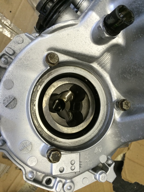

Very oily old box!
I knew the shifter seal was leaking but , dam that's a lot of oil on the inside of the housing lol
Glad the cars in good hands, can't wait to get it back on track with more grip and shorter gearing.
Need to get rid of all that messy power steering pipe work aswell, all the eps parts bought so that's the next job.
Very oily old box!
Didn't realise you guys were race engineers now! Need to remember that if mine is ever ready to race lol.
Thanks Fraser/Stu just got your msg when I landed in Amsterdam will give you a shout later to arrange picking it up. Then we can see if it will lay down two lines instead of one :-)
Are the arp flywheel bolts stretch to yield or can you torque them up as many times as you like?

Got a msg from Fraser.J. last night after he had gave it a quick test " your thing is rapid revs so quick" , so really looking forward to getting it back now. Will get one track day in to test out the difference the box has made, then pull it to bits to fit the AST rears and roll bar.
