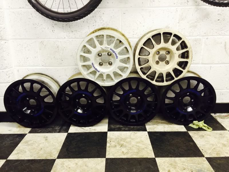

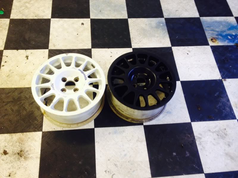

Not sure if I should keep the speedlines white or do them black , I've ordered some new blue stickers as they will need a refurb either way.

Yes that's what I was thinking plus I don't like the idea of trying to keep white wheels clean with track pads. I'm running 16mm spacers on the front and 15 on the rear but might have to remove the fronts now I've got the roll centre hubs.

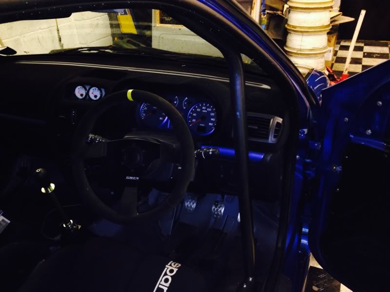

Got out my gauges fitted where the clock use to be so in line of sight.

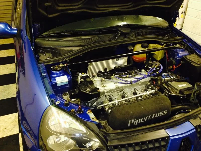

Finished my engine bay with a new heat shield , but noticed the rad is now leaking ( must of caught it while re fitting the bumper ) so have ordered a fiat punto one.

It's a sparco rear brace for an escort cosworth, I had it lying for years so just drilled and tapped the top mounts as it was a perfect length.
Re: Road/Track 172
Interesting, hopefully the single bolts at the ends will be strong enough. Ktec have a front brace now that works with the ktec top mounts, something I will be looking into soon (fyi)

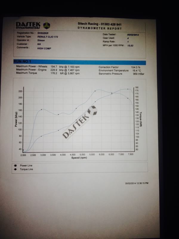

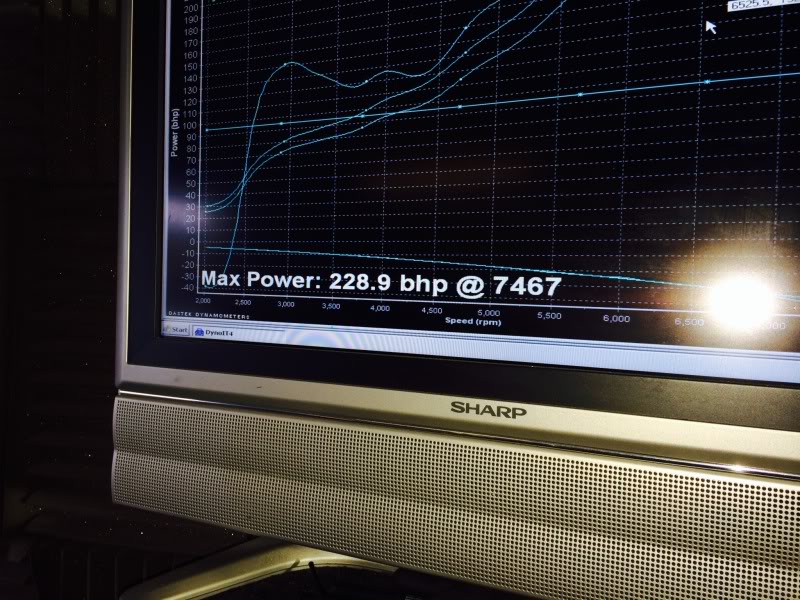

Mapping went well today peak power we seen was 230.1 bhp ,but after pulling a little timing for safety we ended up with 228.9 bhp and 176.9 ftlb . We tried upping the rev limit to 7800 rpm but made no more power so capped it at 7500 since I'm still on standard rods.
Re: Road/Track 172
Nae three bad Neil, remind me of the previous RR figure?

Last time it made 214 on the same rollers, god i hate NA tuning :cry:

That's still a fairly nice improvement for high comp pistons and some head work, if you went with 422's or 423's you might have seen more peak figures but I bet it will go well as is.

In the mid range we went safe with timing which has caused a dip in the torque , on the road this isn't nearly as bad as the graph would suggest . I actually wanted it left like this just now to aid traction out of corners until I get a diff.

Yeh more happy that the engine looks to be performing as it should as it's the first high comp build I have done, I'm not overly fussed about the top line figures but I'm happy with the gains when overlaid on my old graph.

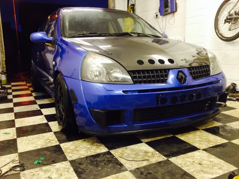

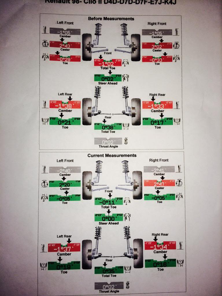

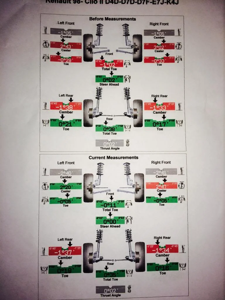

Alignment done today after fitting the new hubs, and finally got to try the car out on a bumpy back road :)

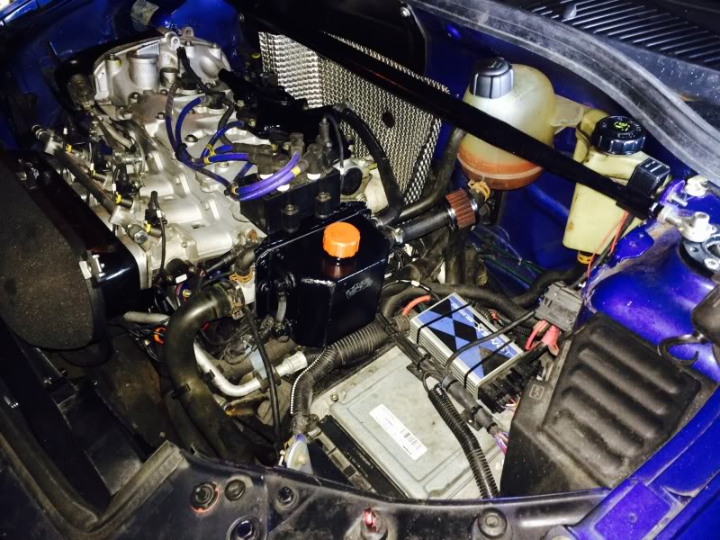

Fitted a breather tank
How the car now looks

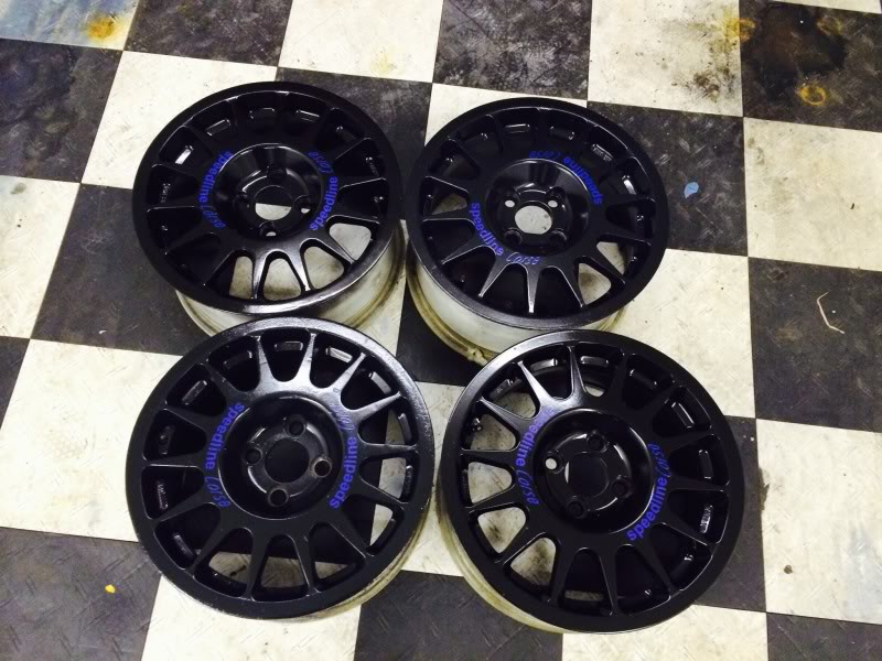

Also finished the refurb of 4 of my 2118's the other two require small repairs first. The stickers were off ebay and not the best fit .

Fully ready to go?
Why have you just went for 1degree of camber?

The 1 degree was the before readings I had just set the front end up by eye, it now has 2.4 degrees on the front. I do have some 1 degree shims that I was going to fit the rear but never bothered yet.

So it does, was looking at rear reading duuh!

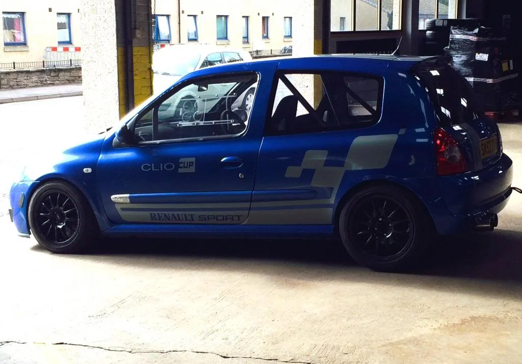

How did you find the car on your blast handling wise? Also, looks to have a lot of rake on the picture above? Or is it the angle of the floor?
Re: Road/Track 172
The above pic was taken on the angled floor coming out of the garage.

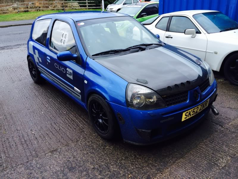

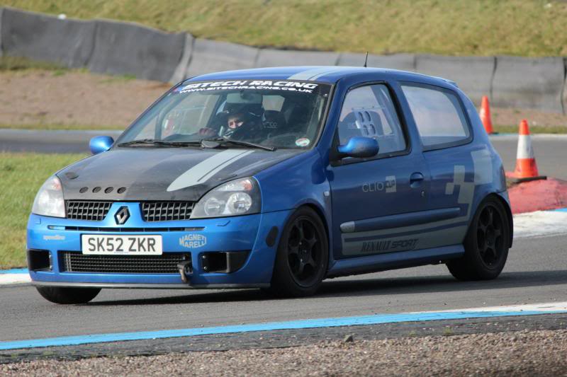

Couple of pictures from yesterdays open pit at Knockhill.
Morgan MGCup having a shot.
