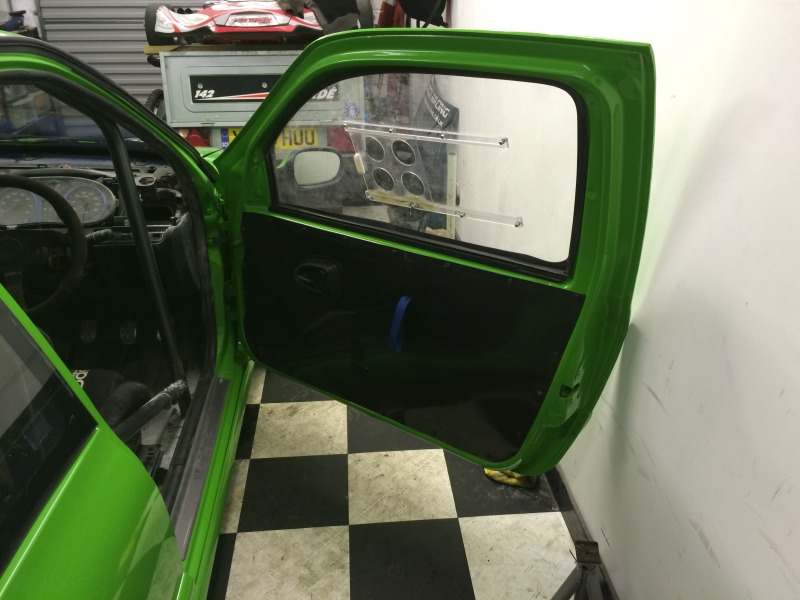

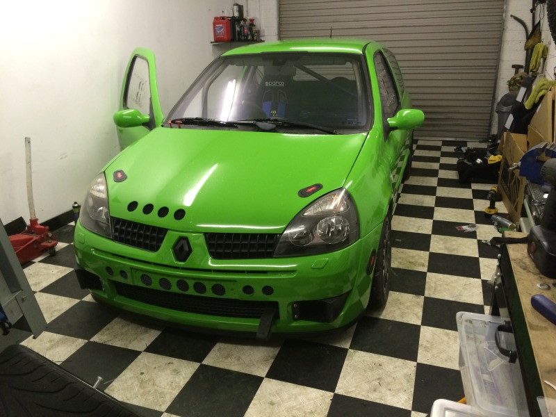

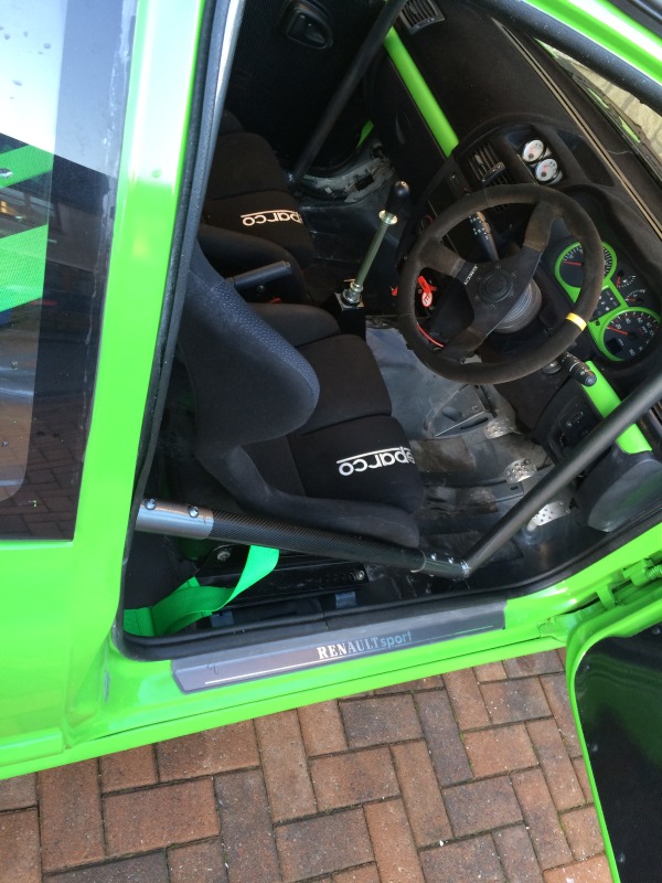

Not looking forward to cleaning up the inside but thats tomorrows job after fitting the electric steering column.
Think I will make a set up , might get the headlights tinted as well to keep them useable for track days.
Looking good Neil!! Tempts me to do mine viper green even more now! Lol!
CM Composites do the headlight blanks as well.
Did you see the viper green one forsale recently ?
Will check them out for blanks, if not i will just gut a set of lights and paint them.
Having a bit of a nightmare with the electric steering, got it fitted and wired but the steering is notch almost like the motor is binding up seems worse when turning to the left.

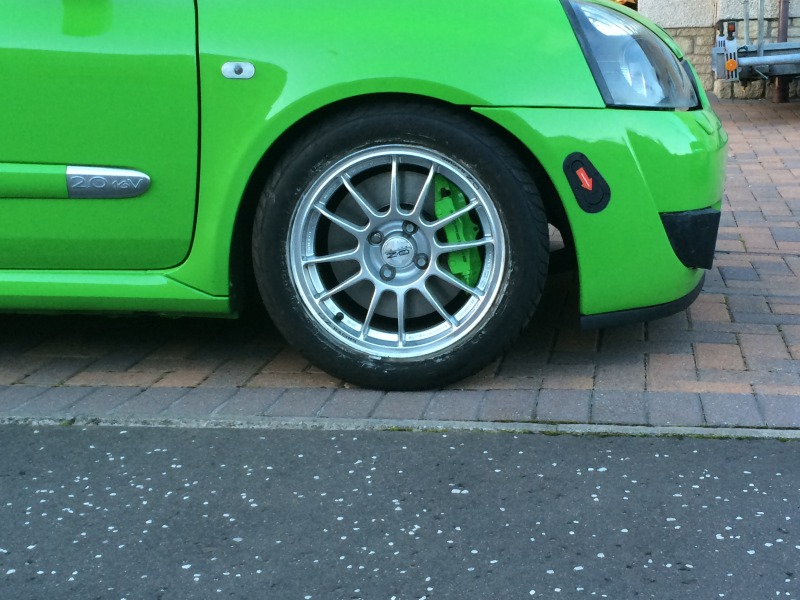

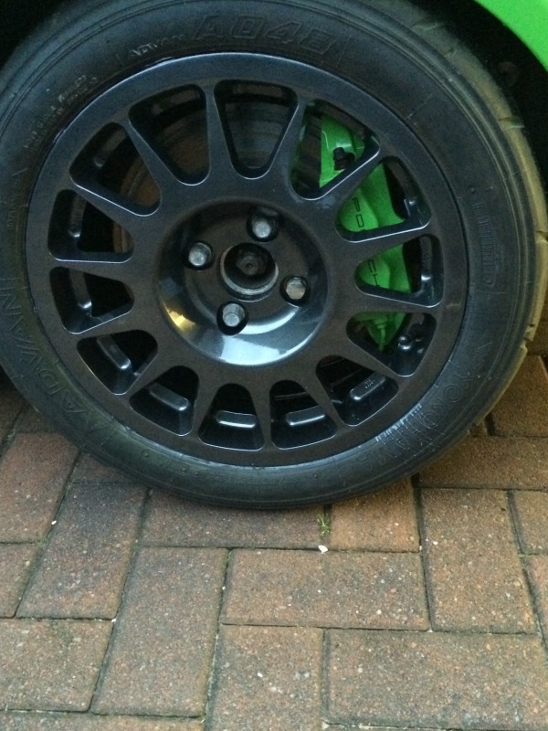

Did get one of the front callipers fitted to check clearance with my proper spacers, and looks like i could maybe get away with a 10mm , but would rather stay hub centric.

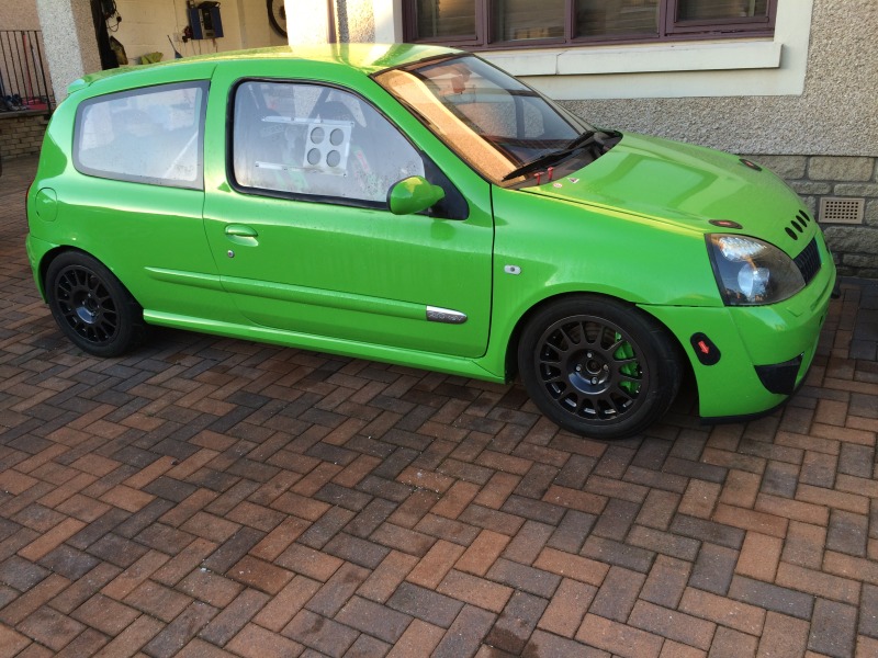

Looks so mean. Calipers look awesome under there!! Bet they're a very expensive alternative to other 4 pots people fit to clios!?
Did yo spray the car yourself? Sorry if I've missed you mention it.
Another :up: for the colour, suits the shape well.
NO a local body shop guy painted it for me for a price that was too good to pass up, its to back to get flatted and polished before the graphics go on. But after seeing the car built I think the graphics will be minimum.
The callipers would cost about £100 more than Megane ones, luckily they were free to me as they came off my car.

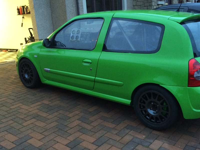

Saw the car on the Clio FB page the other day, nice bit of kit Neil and loving the green (even if I did tink it was yellow on FB as I'm colour blind)

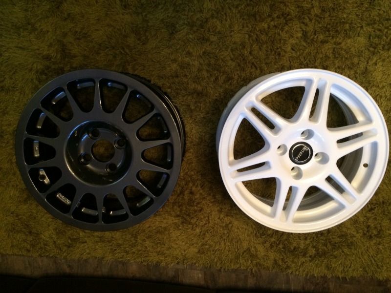

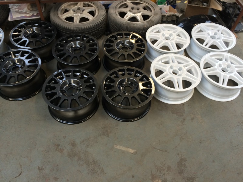

Got my wheels back today from Fife Powdercoating ,

I just told Mikey i wanted Anthracite , really like the colour it has a bit of bronze through the grey. Just need to get two more 2118's then I will be selling my pro race 2's and the OZ's I think.

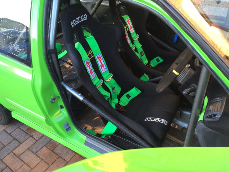

Well thats the car ready to get checked over on sunday by the scruitineers at Knockhill to see if it is up to blue book spec.

Harnesses were an early x mas press from the mrs :)

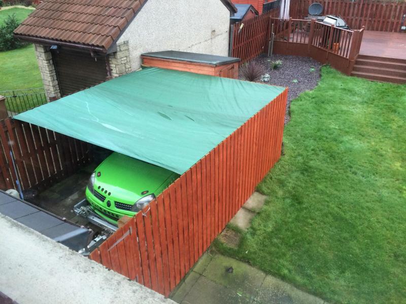

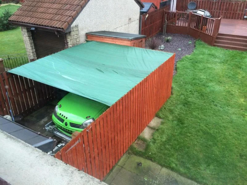

Also made the clio a little shelter to try and keep the worst of the winter weather off it , until I get a proper roof over that area.
