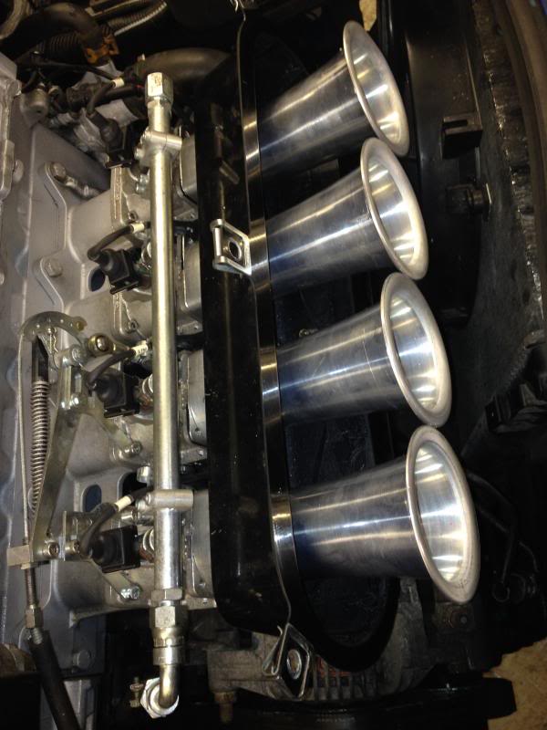

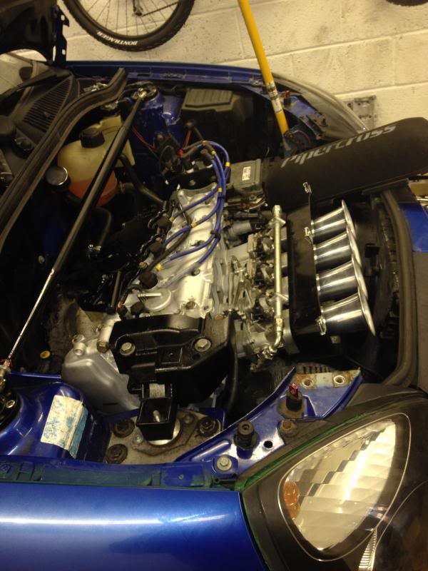

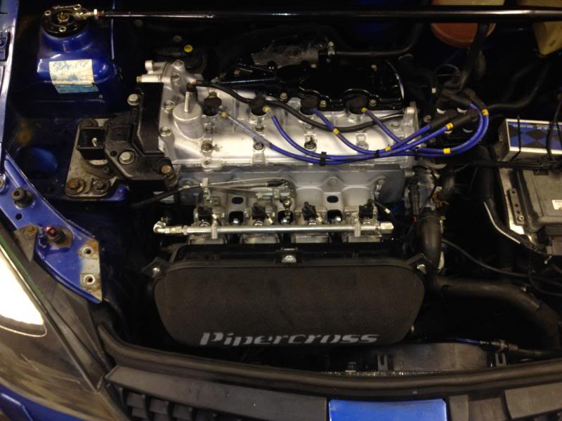

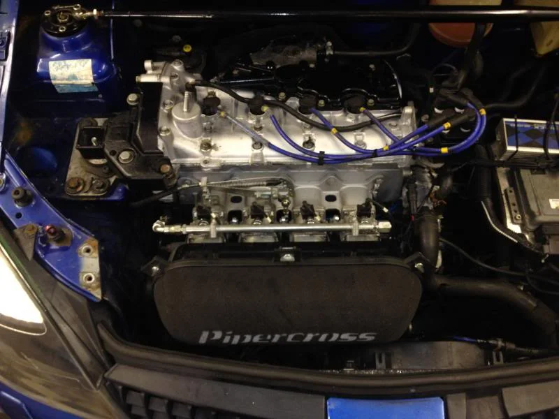

Also managed to get 120mm inlet trumpets fitted, along with some 20mm spacers between the bodies and backing plate to get the longest inlet possible
neil a
Re: Road/Track 172
Ive had to switch back to the standard injectors so I could let the engine run to check for leaks, as need to get the car mapped and injectors re-scaled to stop it fouling plugs.
LOOOOOONNNGGGG inlet

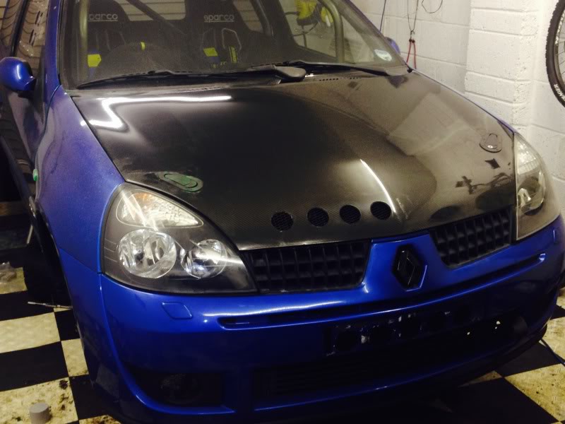

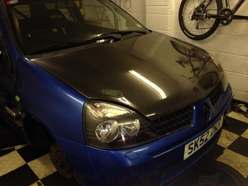

Still need to trim the inside of the bonnet where the latch should be to gain a little clearance.
neil a
Re: Road/Track 172
Bonnet now shuts and clears the filter with ease , also drilled and meshed some holes to feed air directly inline with the trumpets.

I'm not sure if they would fit , I had to cut a fair bit of the bonnet skin out to give good clearance around the filter. I will more than likely look to fit an alloy polo rad at some point to get the heat away from near the filter then put a heat shield in to direct air to the filter from the girll.

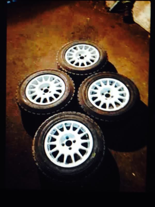

My Clio cup ducts have now turned up after being lost by royal mail .
I also should not be aloud both eBay and PayPal while away with work, somehow I ended up buying oil temp and pressure gauges today which are a good safety.

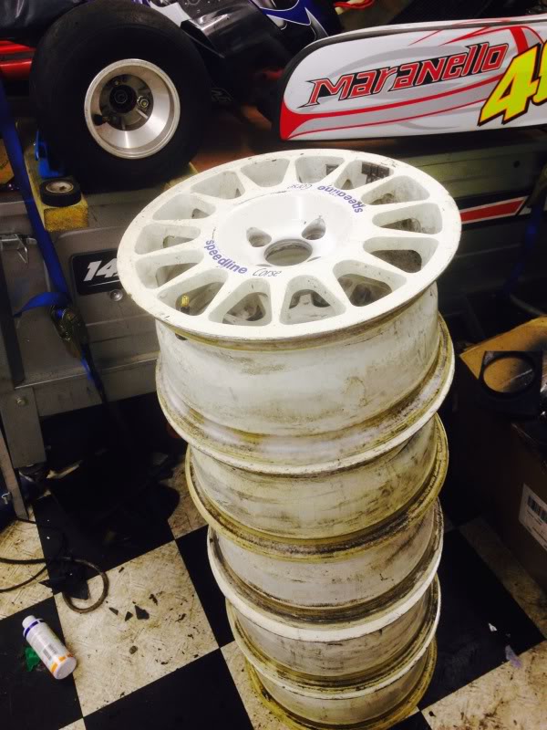

BUT also somehow ended up with six 15" speedline 2118's :p
Not sure if I will put the prada's off the 1.2's on them and sell those wheels on or if these will end up with 888's or similar.

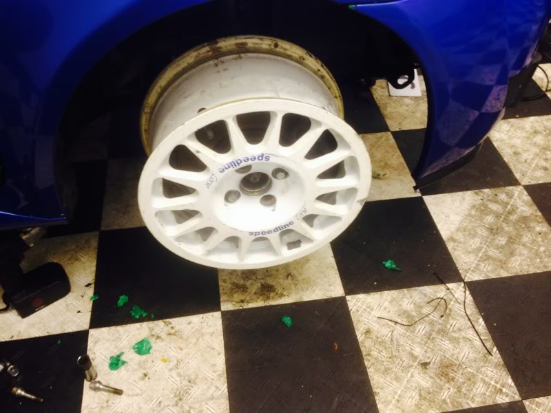

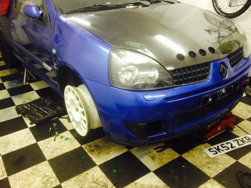

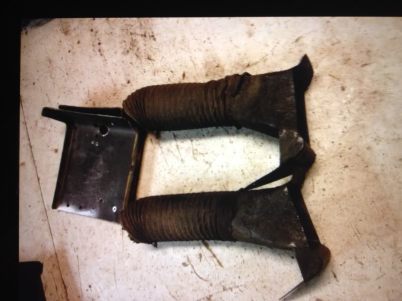

Had a couple of hours on the car today but didn't achieve much , the cup brake ducts fit badly but I've got a plan so few hours with some fg and they should look ok. Got the roll center hubs fitted then tried an alloy on and noticed the bearing in one of them is shagged so will need to be changed :(
NorthloopCup
Re: Road/Track 172
I noticed this when I had them mate, but figured you were aware already. If I'd known you weren't I'd have whacked some in for you like I did a few of the others from the group buy.
  Cup In bits
Re: Road/Track 172
Neil sorry about one of the bearings being U/S. They seemed fine when they left my place IMO and you can't check a bearing properly untill the cv joint pulls it together unless its totally shagged in which case it wasn't.
Pm me your PayPal and I'll refund some money for a bearing.
neil a
Re: Road/Track 172
It ok Morgan I got a bearing today so will hopefully get that changed over tomorrow.
