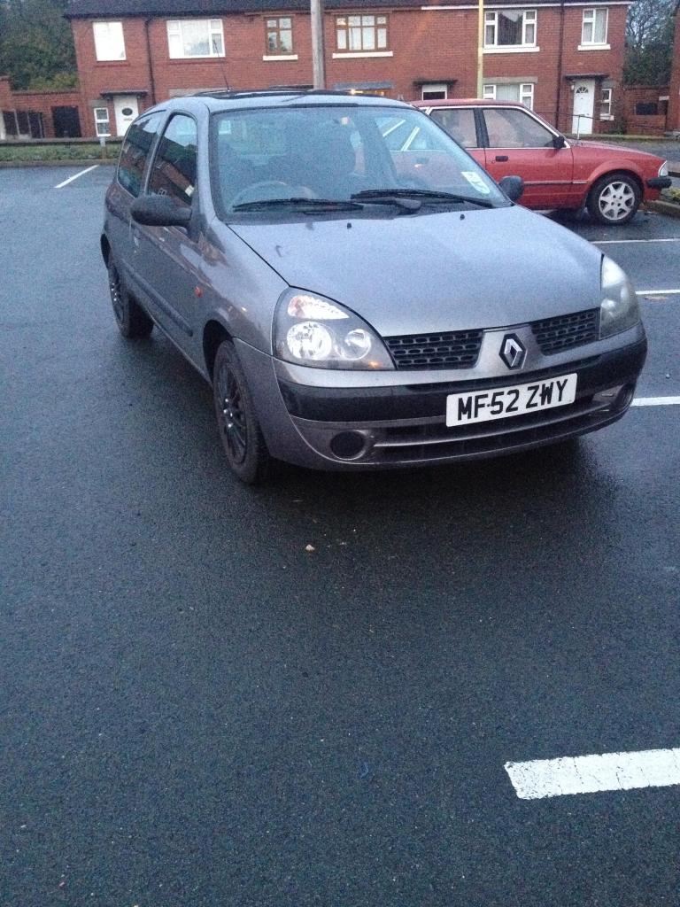

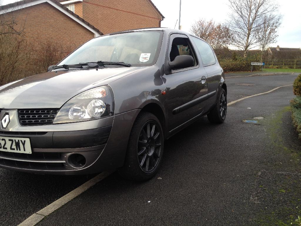

This is my 1.2 clio 'Patrick' when I first got him, had service history and cam belt change.
2002 1.2 16V, when the log book arrived it had 7 previous owners, which got me a bit unsure about it as to why so many people had had it but it isn't an issue anymore.
After the first couple days of driving this car it seemed fine, ran well and got me around pretty decent, was strange going from a diesel to a petrol. In heavy rain the car would lose power and a light on my dash would come on, unsure what the light means..
After this happened and left me stranded twice I had my girlfriends dad who is a mechanic to have a look at it, after a diagnostic check came up with nothing a couple of forums had mentioned that a couple wires coming from the cars ECU would have come apart and got torn and wet forcing the car to lose power, apparently it is something that Renault don't check for so whenever this is taken to their garage and it is never found the problem is never fixed. A bit of tape around the wires and a test drive in the rain, the car ran perfect and no problems with the loss of power.

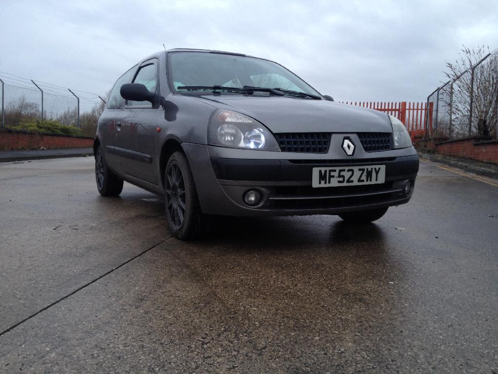

After a week or 2 of driving this new car I got rid of the wheel trims and sprayed them black, which I still didn't like, it was just a made do for now job, I soon found on here that someone was selling a set of turini's not that far from me so I offered the guy a price and he accepted, I drove down to chester to pick them up a couple days later.
The headlights on the car, one of in excellent condition on the front but behind the connections were broken and the other headlamp was hazed and stratched, I got out the headlamp polish and gave a go at restoring them both, but after the hazed one not even getting a single bit better i got some cup headlamps for chorley and fitted them.
Need to get the alloys refurbed but for now they are fine, might arrange to get it done after winter.
With this swell a couple of small modifications had been changed, 3/4 front plate, aero wipers and xenon bulbs

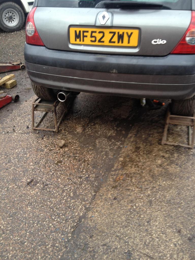

After a pretty good payday I bought a few parts for Patrick to pick up on the mods, first I always wanted an aftermarket exhaust, sported seemed to do fairly decent ones and so I bought one. After a week of waiting for it to arrive, it felt like ages, it finally came and got it fitted 2 days later by myself and my girlfriends dad.
Was a real pain to take the stock exhaust out but defiantly worth it.

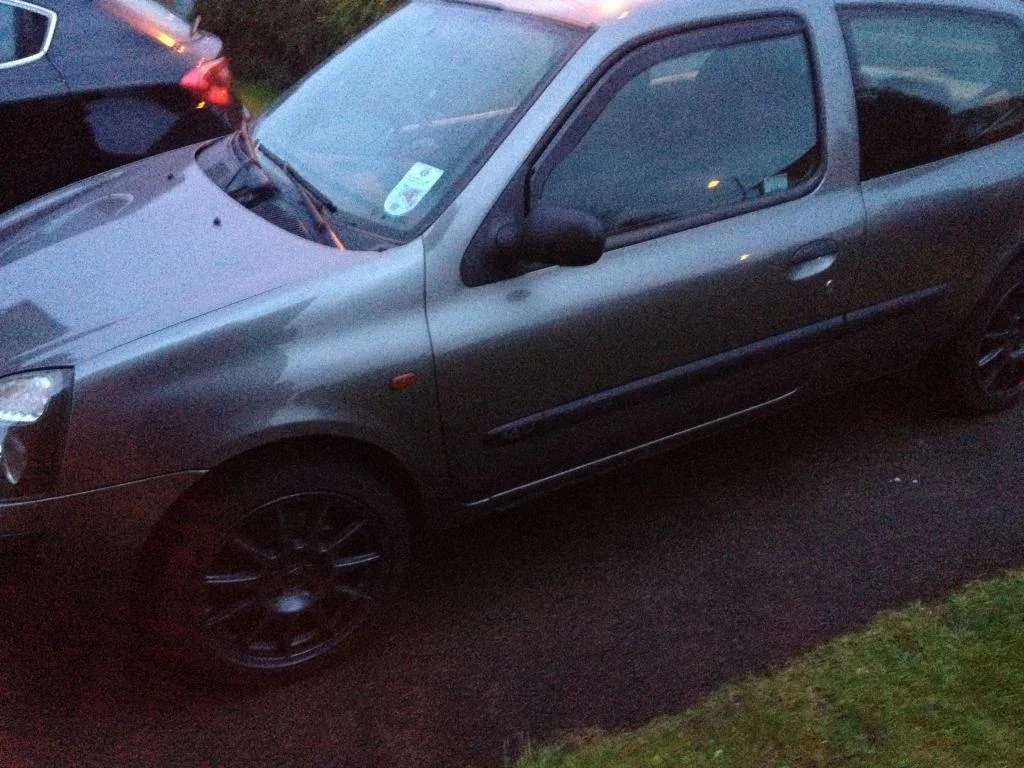

Update: After it going dark and starting to rain on sunday, while I had some time before work today I decide to finish off my small detailing with the minimal cleaning products I have, I redid the polishing with an autoglym palm applicator which after about half way through doing I dropped on the floor so a standard polishing pad was to hand and a couple of cloths...

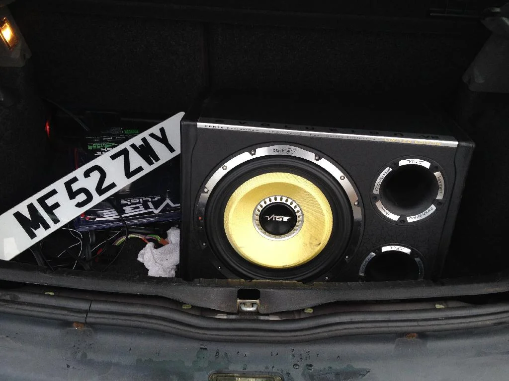

After losing the sub wires in my last car I bought some bring new ones and spent quite a while trying to get the power wire through to the engine bay, after that the rest of the wiring was simple, took a good while but happy that I got my sub up and running, although 2 days down the line my car was struggling to start, multimeter to hand I sourced out the problem and that one of the wires was constantly getting power from the battery even when the car was off, after sourcing the correct wire I swapped it over and the car runs fine again.

I noticed while cleaning the car today that my exhaust was hanging quite low, the weight of it on the old rubber exhaust mount is crumbling on the mount, need to get my hands on a decent one pretty soon before it complete breaks on me.

I have the same sub - been sat in the loft for about 3 years but tempted to get it out for a laugh - where did you wire it from the engine bay? any grommets at all?
I wired it through where the wire is for the bonnet cable, took some time but managed to get it through.

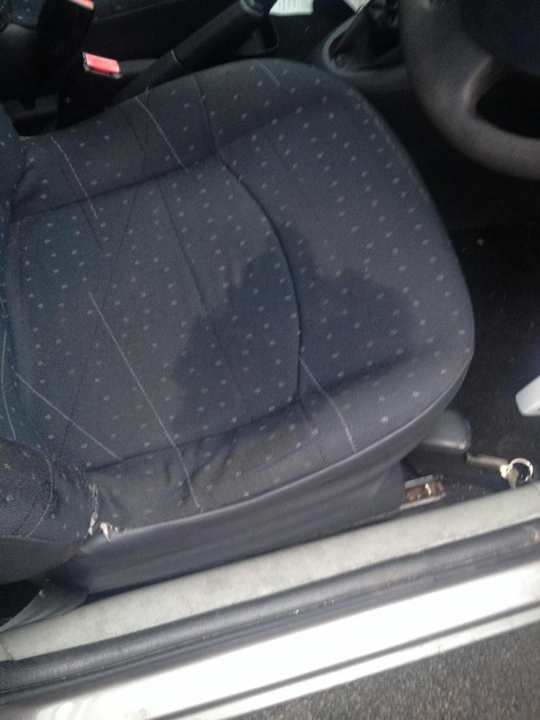

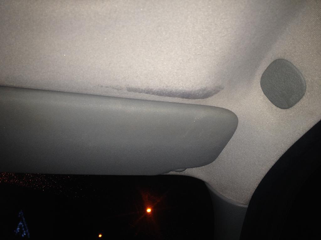

So I got to my car the other morning and noticed my seat was pretty damp, being in a rush that day I didn't really do much about it,
There has been a bit of bad rain today and I have been in the car for most of it, just before I came home I noticed that the roof lining had a slight damp patch on it
ive heard that there is a usual problem with 1.2 Clio and the sunroof, not sure if it's certain models or all but I was wondering if anyone knew how I could fix it?

Check the seal on the roof outside the car, I got a bit of mastic and sealed mine up and had no problems since
  172 Rep
Okay thanks a lot pal, seen your rep looks pretty sweet.

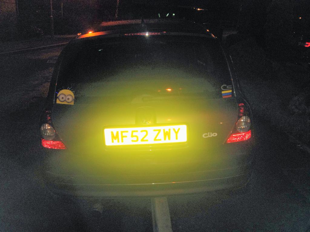

I found some minion stickers and thought that it would look alright on the back of the car...
Now that's it's on I'm not too sure whether I like it or not, to keep it or take it off?

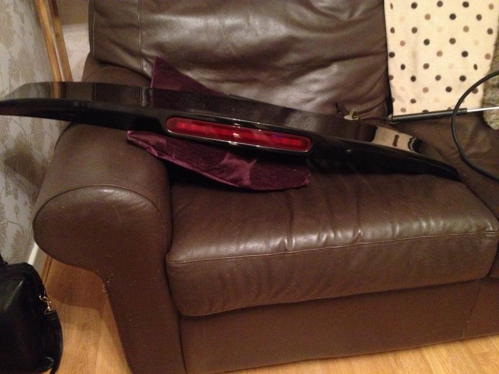

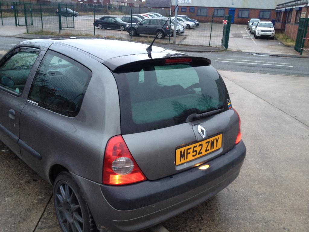

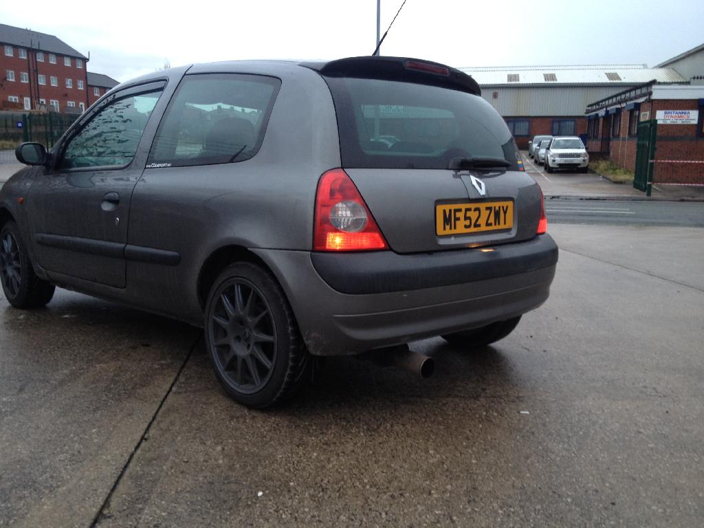

After my cup spoiler being sat in my room for ages I decided I would put it on the car today to see how it would look, with it being black it usually blends in with the other small black parts on the car. How the car looks now.
Not sure whether to keep it black or get it sprayed the colour of the car which was the original plan but it seems to work with how it is aswell.
usually keep on top of the cleanliness of the car but been driving through a lot of dirty roads so not bothered for a little. Also want to put my 3/4 plate back on but unsure whether it's worth the hassle of I get pulled over for it or anything.
getting my bumper cut out sorted on Saturday for my 172 bumper and then can get my bumper sprayed and fitted.

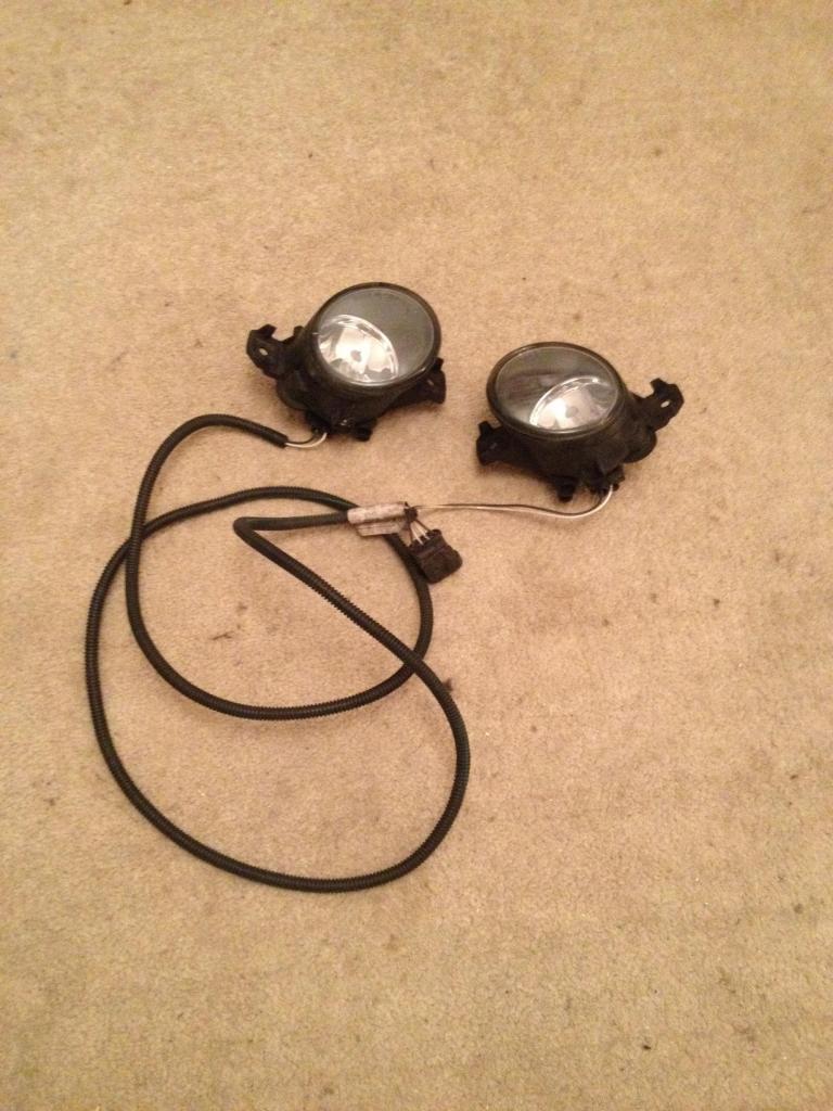

Forgot to add: also fitted my fog lamps, they don't work at the moment due to not having the correct stalk for them to work but they along side of the sport grill has made a big difference to the front of the car.
