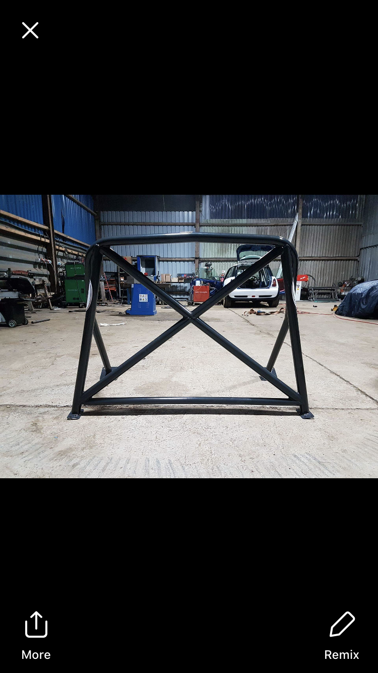

Just one to throw in depending on where you are. jP Cages. I had one built for my fiesta ST and was a rear bolt in. If you are the first mouldings for it aswell he will do it cheaper.

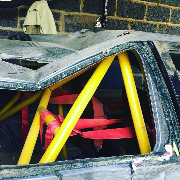

Thing is with cages, you can't really review them until someone bins it! Bit like insurance, might be easy to buy and fit etc, but the real test is like the photo above.
That ep that rolled at brands last year had an sw cage too I think and it did well.

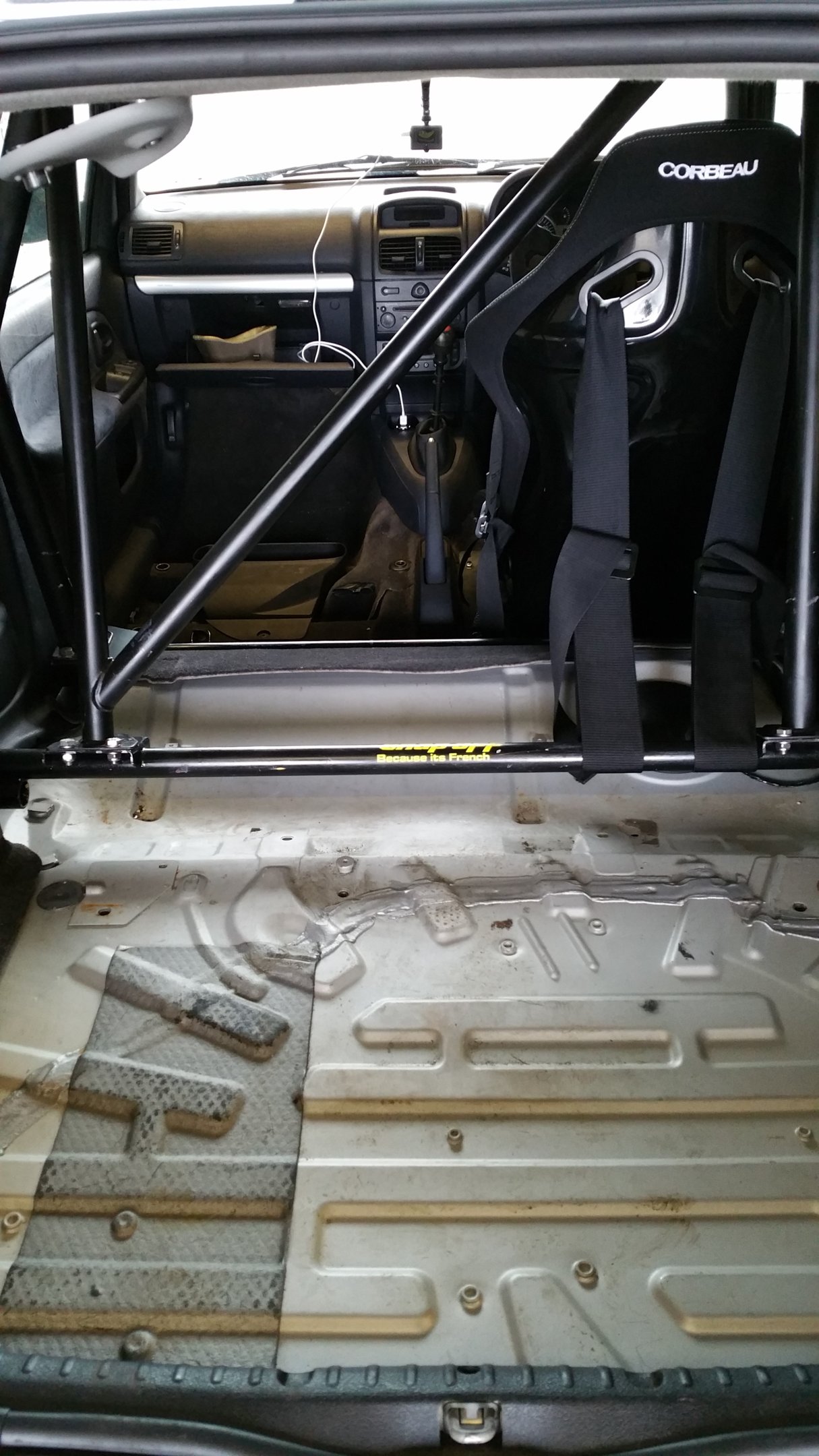

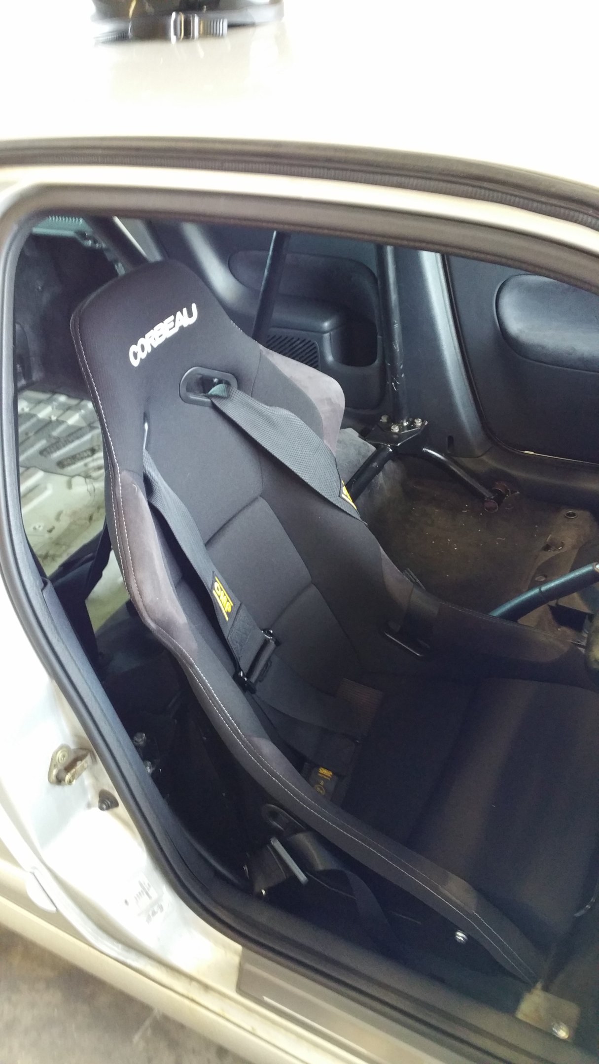

Can you not get a half cage that bolts into the existing seat belt mounts like the MSV one I had in the Clio? So much easier to fit/remove and easier to sell on...
Not seen that option mate? Both the sw and safety devices attach to the floor at the base if the rear seats and the wheel arches. Identical except for the weld in feet on the sd
Those don't appeal to me very much. Do you just end up with the bases of the main hoop being supported by a single bolt where the lower seat belt anchorage would be?
The horizontal rear beam bolts into the side seat belt mounts by a m14x110 so nice and deep into the chassis. The front horizontal again bolts deep into the lower seat belt mounting points using an m14, also the front horizontal bolts in 3 places along the floor pan. The single piece loop then bolts to the horizontals in 4 places using 16 m12 bolts in total. Very secure and I'd much rather this than some of these half arsed weld/bolt in cages you see with poor spreader plates or no plates at all, welded/bolted to a rusted/weak floor pan.

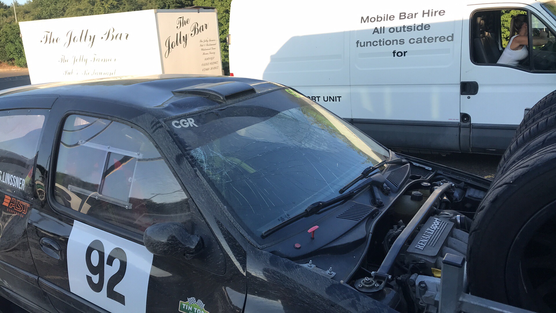

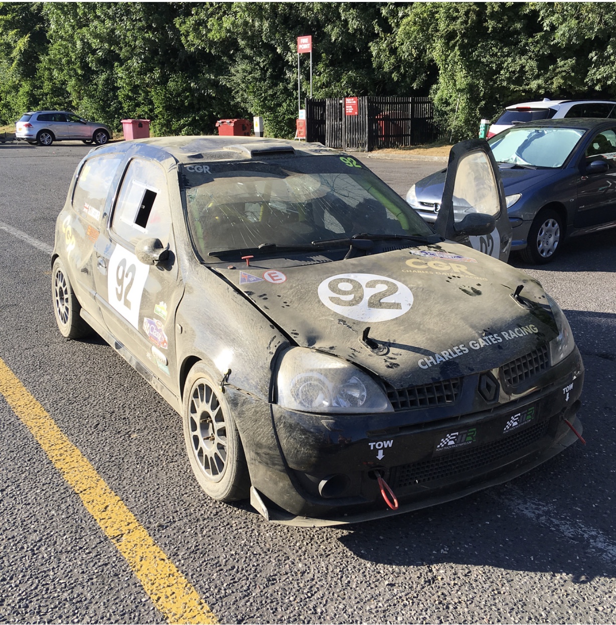

Hit some sort of fluid in the braking zone of paddock at brands. Lost the back end. Did a 360 and hit the gravel side on. Went over nearly twice.
During the race chasing p10 so I was going for it [emoji23]
Pretty sure that's where the civic rolled too
