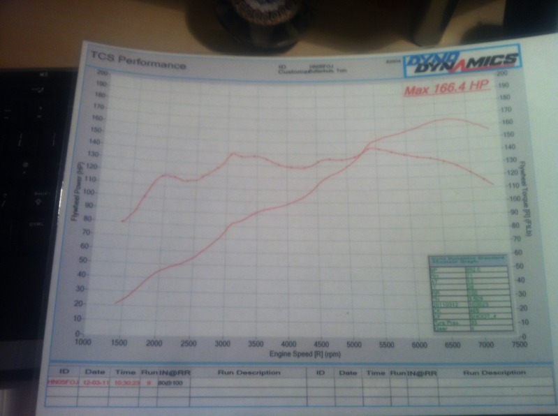

Right i have my car rolling roaded nearly a year ago... and only produced 166bhp
the mods are :
Full miltek decat system
k tec matched inlets
K tec generic map
Itg panel filter
was probably around 55000 miles.
had just been serviced..
after speaking to a few people, they suggested the cam timing was out. ( done at K tec at around 46000 miles..)
i have now fitted a rs2 inlet and changed to a yozza exhaust and meant to be getting my car mapped by MWM on thursday...
before mapping there going to check my cam timing..
on the same day my mates itb 182 ran 194 bhp and when we had a little tear down the by passes there was nothing in it...
from the graph the bhp line looks really smooth... What do you think?
Surprised it made that little with the RS2 fitted, I dont think I recall ever seeing one under 180bhp, Im sure MWM can sort that with a bit of mapping and any cam timing adjustments needed though :)
Doesnt look as smooth as normal with the RS2 either TBH
Am sure there is more to come there!
Unless ive understood wrong and thats your before graph still?
Chip, I think thats the standard graph from a year ago.
MWM/RS2 results to come thursday

does the power curves look ok for the mods it has?
I made 175bhp at Alan Jefferies on my old ITB F4R about 2 weeks after i had royally fried the rings to pieces. Its a good rolling road and the lads are friendly down there. I got them to partially rebuild my bottom end aswell (hone block and gap rings), they did a good job :)
Its a little lower than others manage on the same mods, but doesnt look too bad a curve considering how much the standard inlet plays havoc with the torque delivery by optimising it in some places and hindering it in others.
