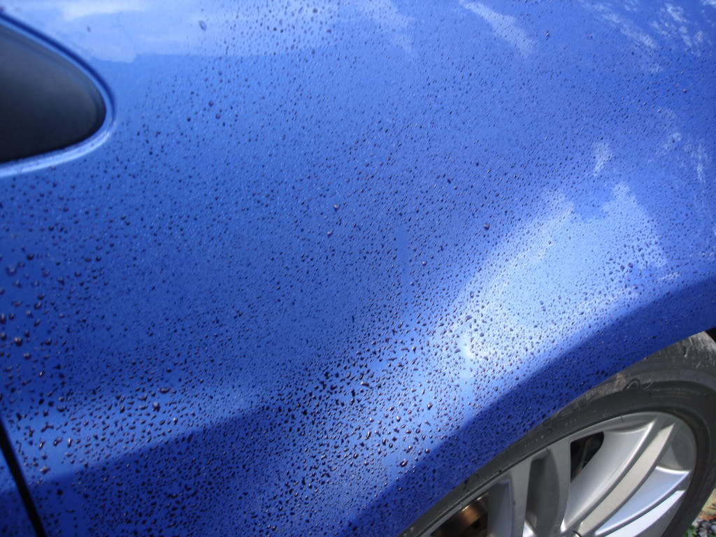

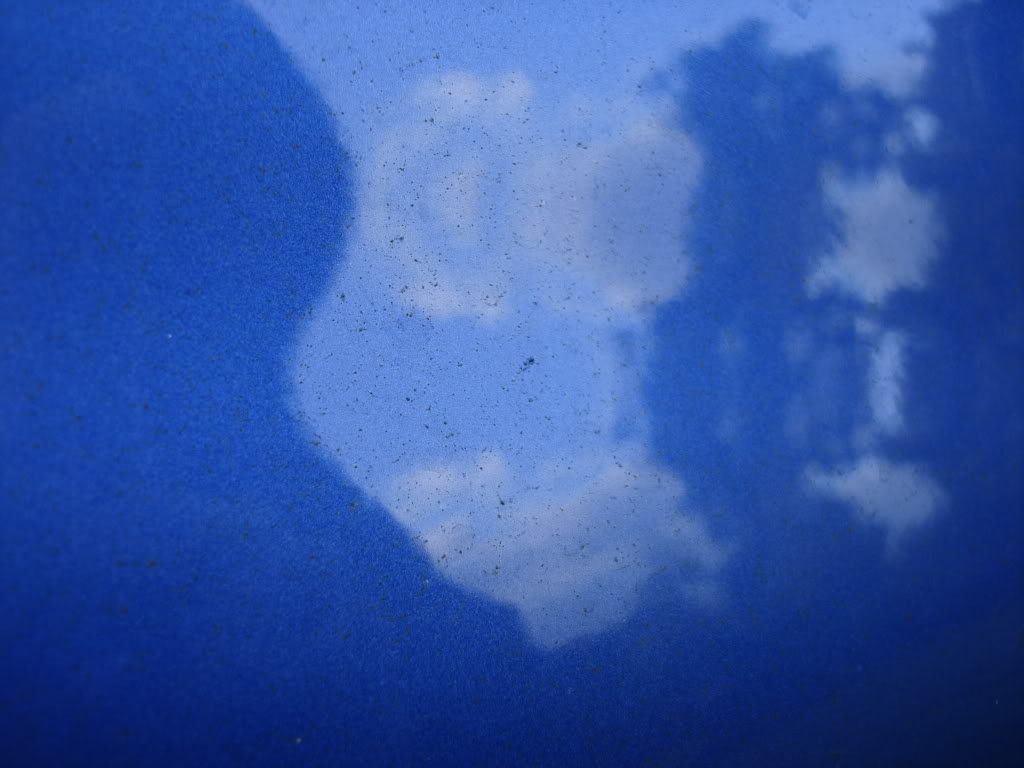

on a recent track day shall we say an incident resulted in a pad slipping loose of the caliper and jamming between caliper and disk causing it to spray little speckles of metal down the side of my car which are now stuck in the paint what will be the best way to remove these?

Try giving it a going over with some Ironx, then use a claybar with some lube. Should help remove some of the fall out.
ive already gave it a go over with jet wash basically point blank with no success but thing because the metal was red hot its hit the body burnt into the paint and cooled instantly?

There are alternatives like Wolfs Deironizer or whatever its called now, but Iron X is the best.
thats similar to mine thought the specks have began to rust many thanks ill go to few local places 1st before i get it of the bay
No point pressure washing at point blank range as it will just drive the particles further in to the clear coat.
Best bet is Iron x as previously mentioned. It works wonders!
