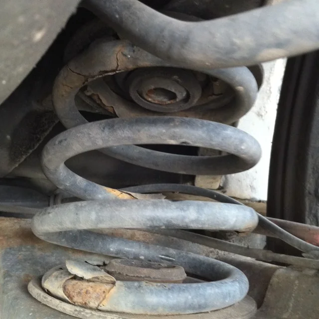

I managed to look with a torch last night, there is no fluid from the shock, and it is still bolted in ok. The only thing I could see last night is that the plastic cover on the spring is peelin away and the spring is rusty. Cracked spring???

In the mean time here's a pic of the spring that I feel needs replacing. May get a set of lowering springs?

Yeh the rear spring has sheared, nothing major to worry about just get them changed asap. Can lend a hand if you need it being local an all.

Creaks like mad now. Haha I'll order a pair of springs. Always best to change both sides perhaps rather than just the one. (although other spring looks in much better condition.)

Ordered two rear OE springs, and got some shocks as well... even though they look OK i'm pretty sure they're crap!! lol

Fitted two new shocks and springs today! Drives like a new car.
Passenger side was ok, I'd lost a huge chunk off the drivers side spring, AND the shock was gone on drivers side too!!
