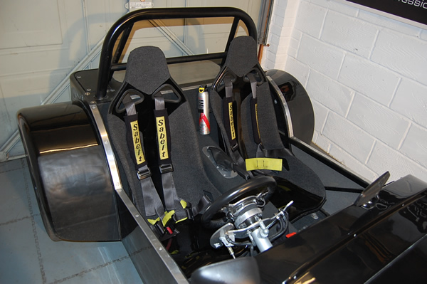

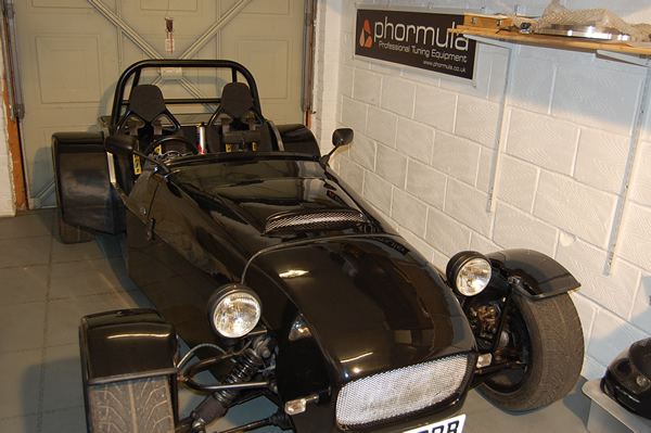

Here's my project: I'm swapping the fireblade engine out of my kit car (it weighs 467kg). Replacing it with a Hayabusa and a GT3076 :D. It should make just over 500hp at 2 bar.
I'm hoping to keep the weight of the car under 500kg. It shoud be pretty close to that by the time I've added the IC, turbo, pipework, dry sump, etc.
Here's the victim:
It's an Lotus Seven Replica. Currently fitted with a 126bhp Fireblade engine.

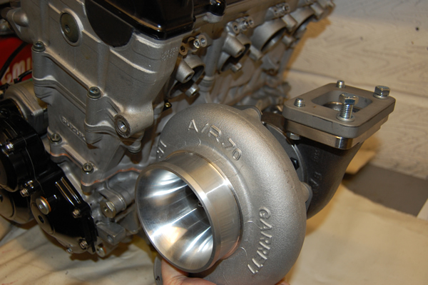

The replacement hayabusa engine with the GT3076. I'm going to have to fabricate the turbo kit as I want it to fit under the bonnet and use a single throttle body.

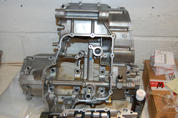

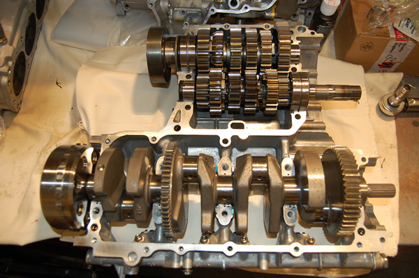

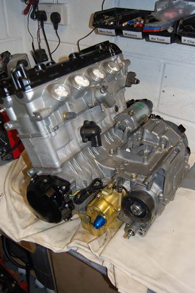

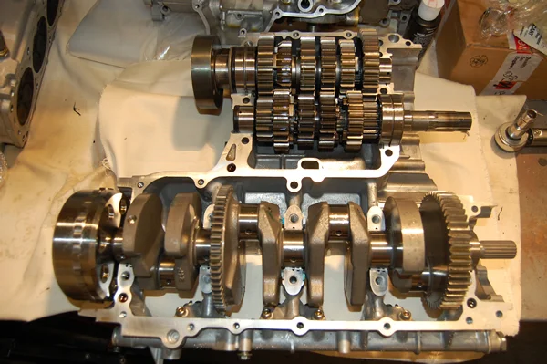

Crank and gearbox. The engine only had 1700 miles on it, so everything was nice and fresh.

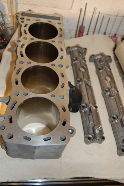

Cylinder barrel cleaned up
Crank case cleaned up

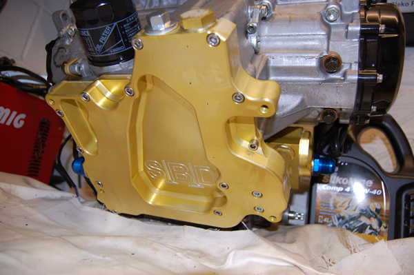

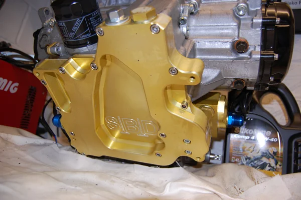

Dry Sump installed.

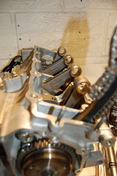

Wossner rods.

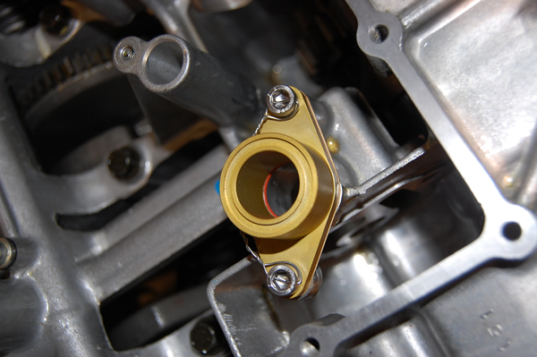

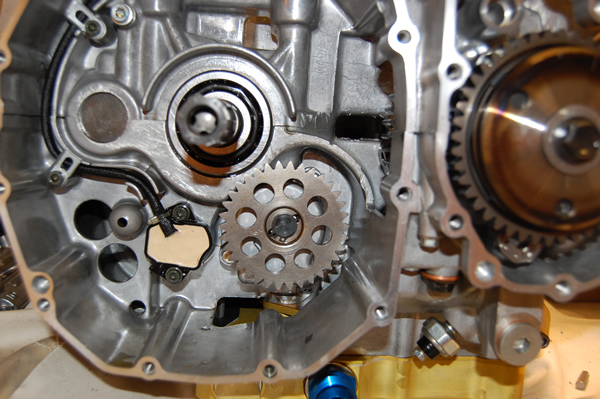

Uprated oil gear to give the oil pressure a boost.

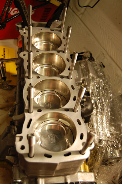

Wossner pistons and ARP studs.

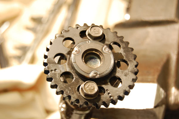

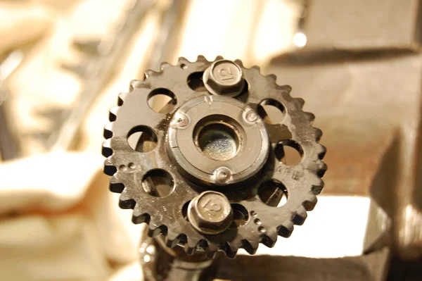

Adjustable cam sprockets pressed onto the cam shafts and tack welded.

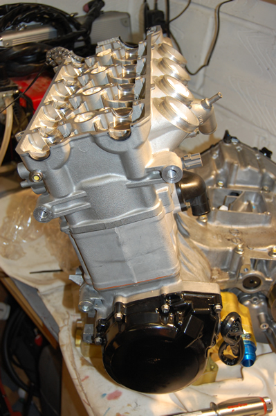

Engine Built.

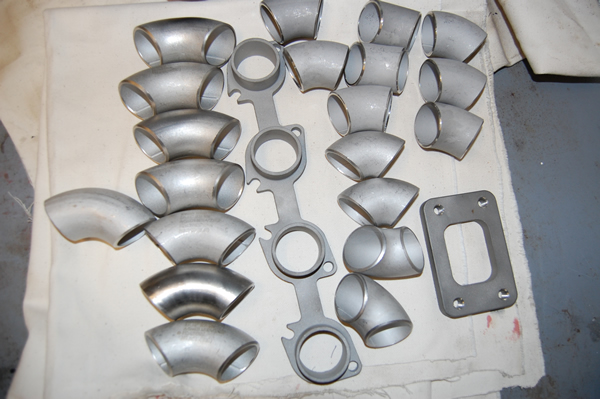

Fab the manifold. :smash:

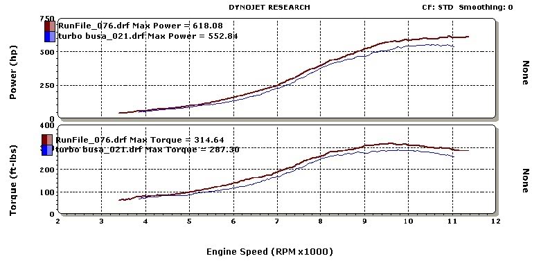

There's not going to be masses of torque, torque using a bigger GT35 on the same engine peaks at 280ish lbft @ 9800rpm, power peaks at 552bhp @ 10,500rpm. He's using a smaller turbo, and there's not masses of grunt low down.
That image shows a GT35 (blue) vs a GT40 (red/brown).
