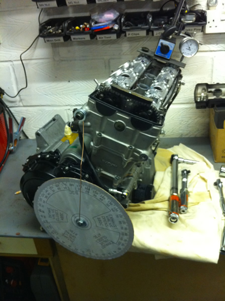

Checked the valve clearance and degreed the cams to 105in and 108ex. Cams will get tweaked on the dyno, but this should be a fair starting point.

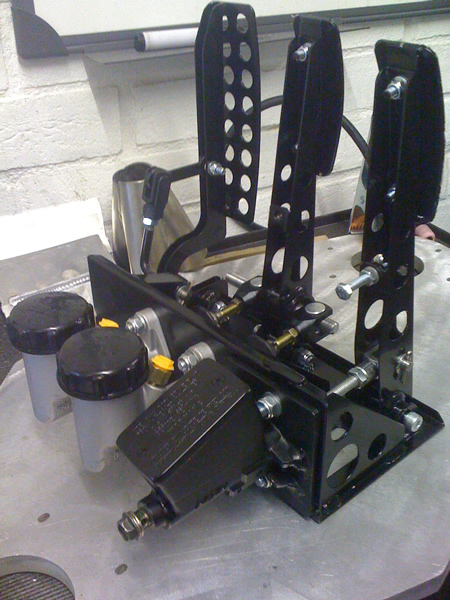

Modified the clutch master cylinder from the bike handlebars and welded to a mounting plate. It gives the correct travel on the clutch, I'll probably have to add a bleed nipple to the top plate so that I can fill the reservoir to the top and not get air in the system.

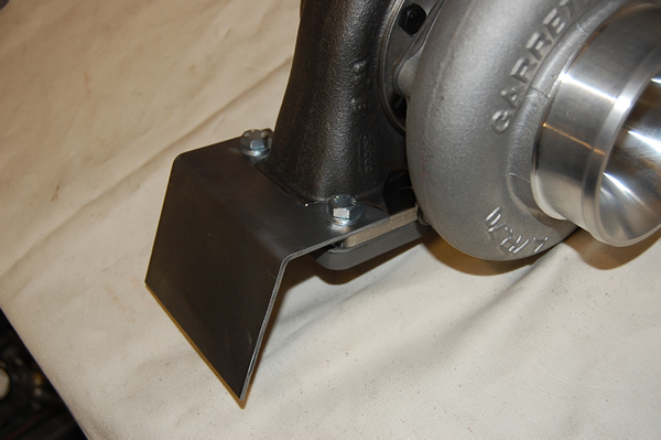

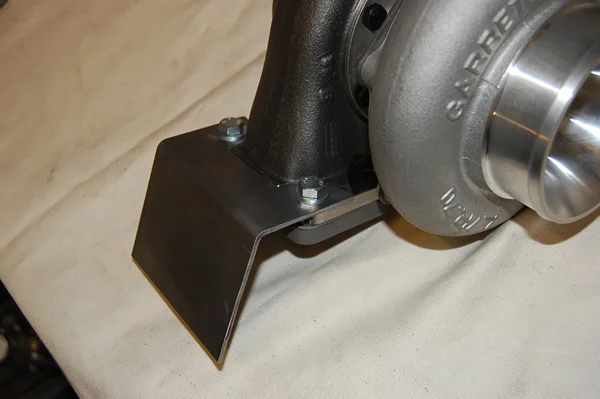

Turbo mounting bracket.

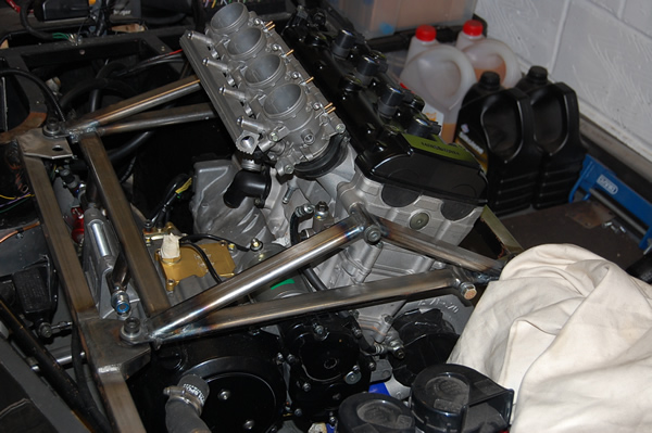

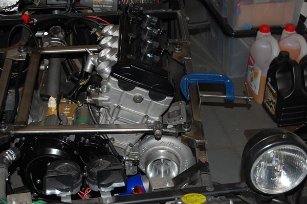

It fits! Found a spot for the turbo, it's a bit snug. Uprated the chassis mounts, but the engine cradle is for a standard Hayabusa and doesn't look up to the job (see those end tabs). So I'll be making a stronger cradle. There is also another engine support that will triangulate from the head of the engine. Manifold is going to be tricky... it's a bit tight in there.

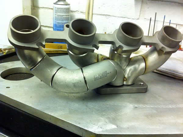

Here's my attempt at a turbo manifold. Needs cleaning, welding and porting.
I know that equal length runners would be better and a straighter drop into the collector, but space is tight and it's my first go at making one of these. It cost about £70 in materials... and 2 days grinding!

Strengthened the engine mounting frame.

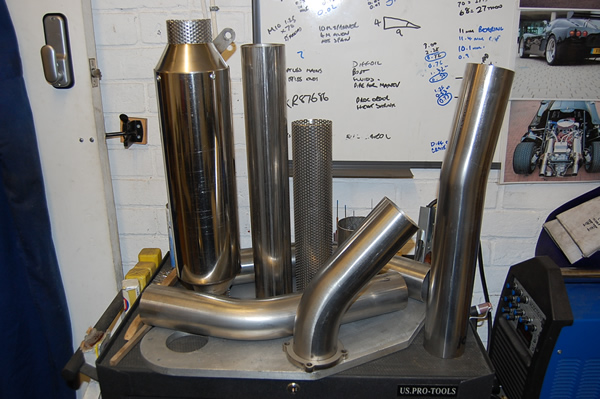

Started working on the exhaust. It's 3" from the turbo. Yes, it's going to be loud.

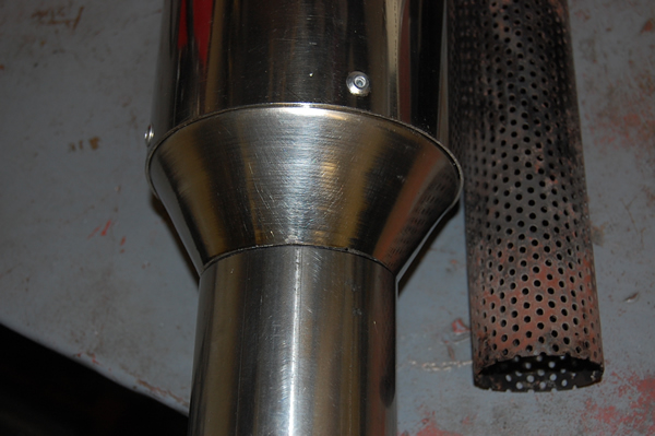

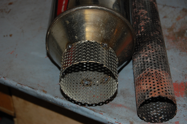

I decided to use the existing silencer and open it up to 3". Here's the original 2" pipe.
I cut and welded the perforated section to just under 3", so the 3" stainless fits tight over the top. It also means I can still repack the sliencer.
Exhaust finished

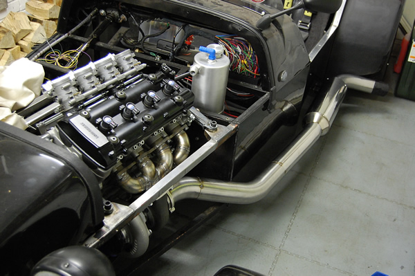

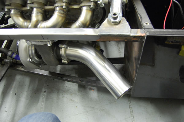

Tacked the exhaust together today and ordered another turbo flange to make a side-exit exhaust like in the previous photo.

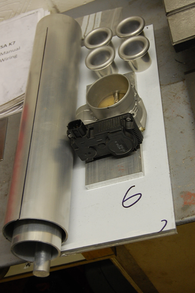

Next job is to make a plenum from this...
