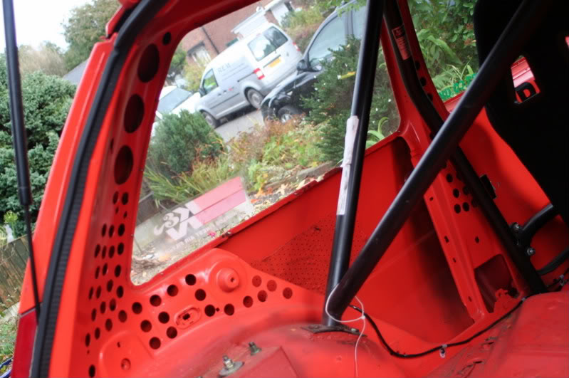

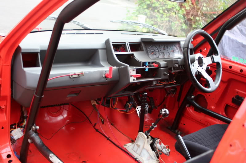

Holes....

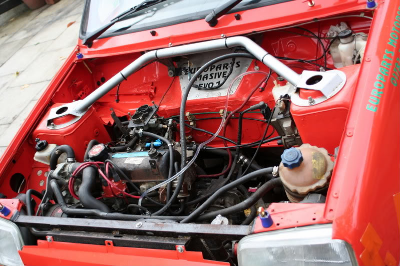

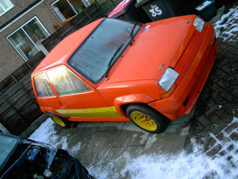

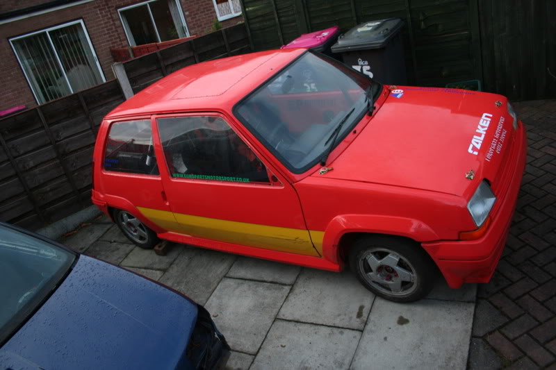

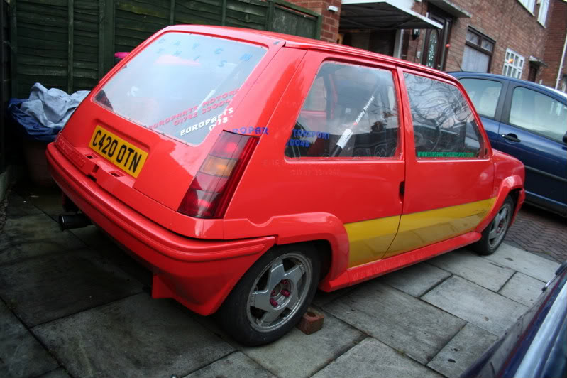

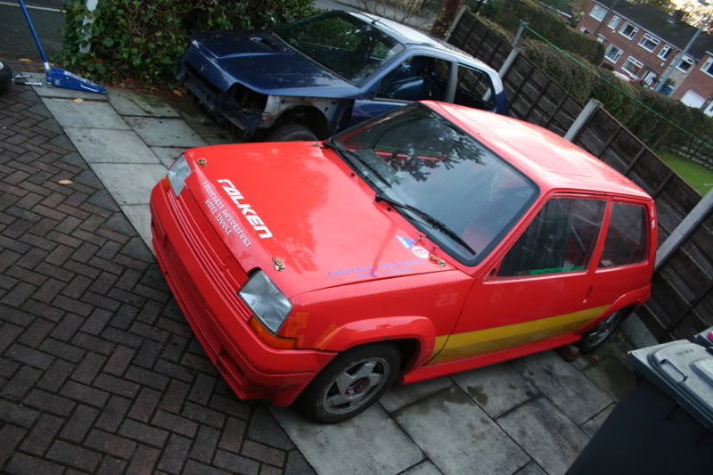

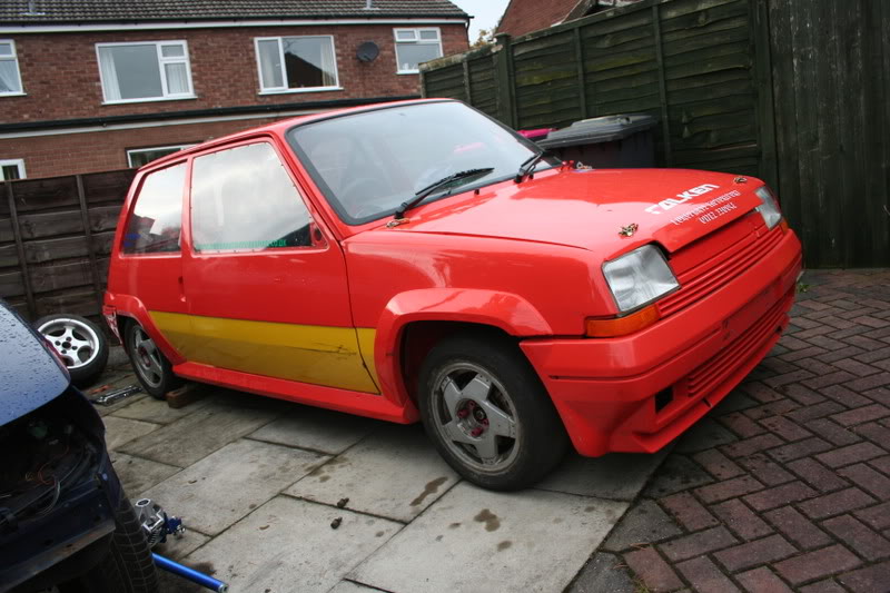

Some Pictures of the car as it stands

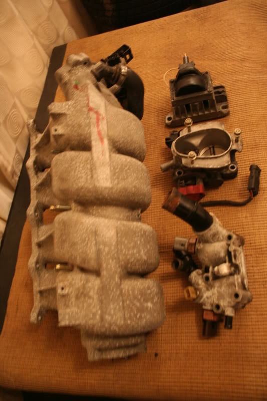

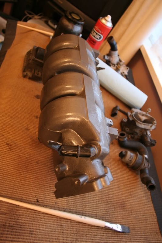

Today I have been painting my inlet and head with brush on hammerite but im letting todays coat dry so i can give them another coat, so no pictures yet. I would normally spray them but its far to cold to get good results

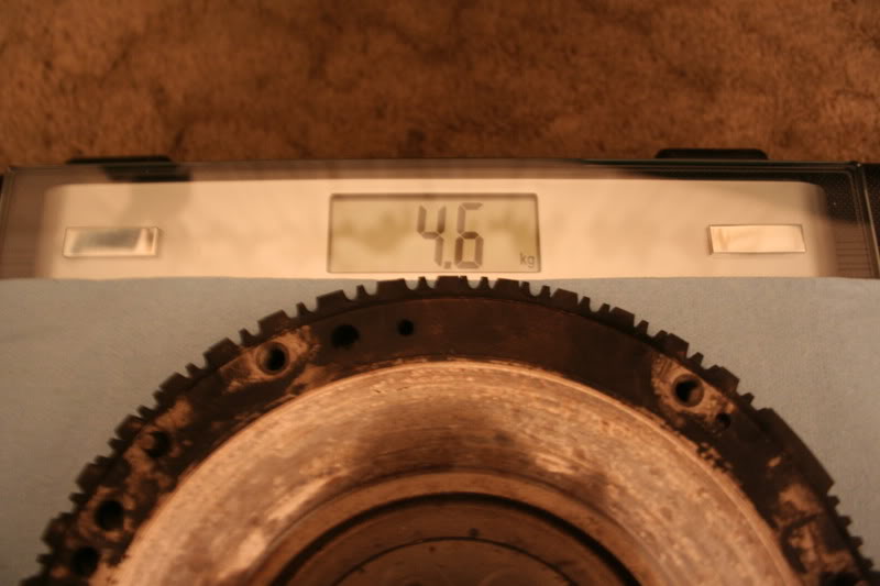

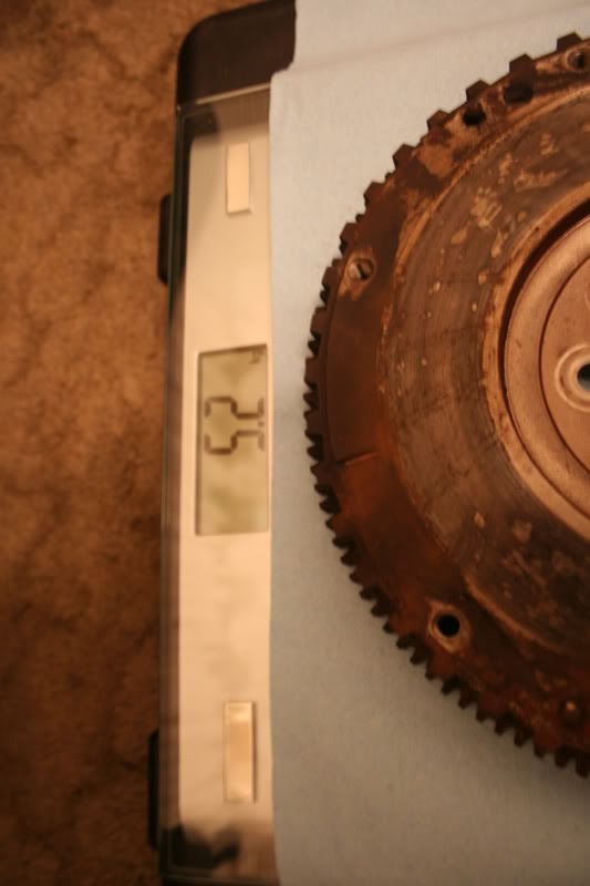

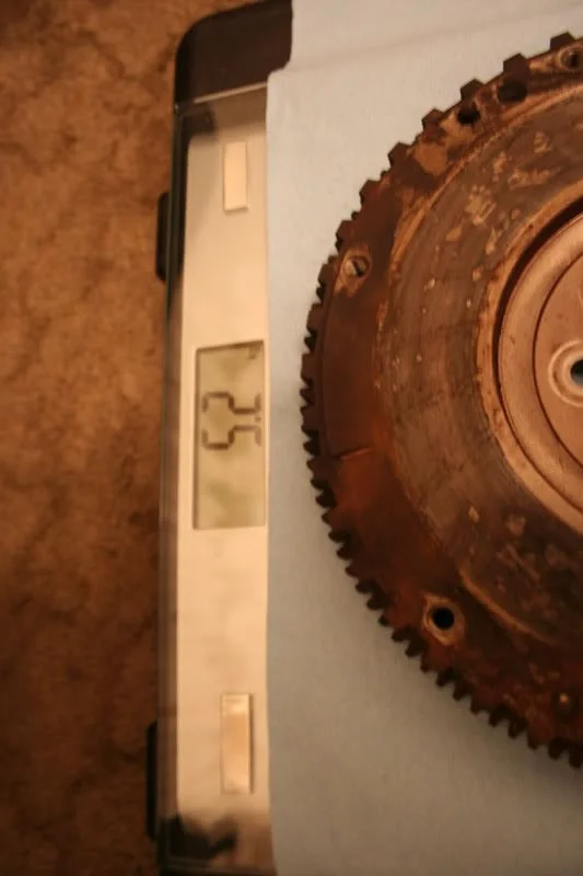

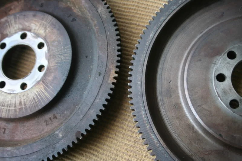

I also weighed my lighterned flywheel to to see how it compared to my standard flywheel
Standard
Lightened
Difference between the 2
Im not sure if thats alot of saving in weight, as far as flywheels go.. but it all makes a difference :)

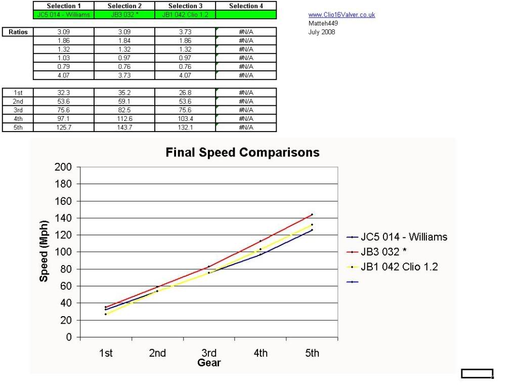

Depends what box I use... as the 5 turbo box is geared for 13's.. still not sure which box to use
Valver box - 120mph (on 13's)
GT Turbo box - 145mph (on 13's)
I deffo want to hit 13's and trap at 100mph +

but I do know how good a nice f7r is in a lightened valver you lose another 100kgs+ and it will be truely savage in the first 3 gears....I reckon the valver box might work better winston, letstorque says 13.3/13.4 based on 165 bhp or so... I reckon with a 2.0 60ft it sounds about right!

5Gt box 145mph on 13's? have seen 140 on 16's on 13's tho I may be suprised?

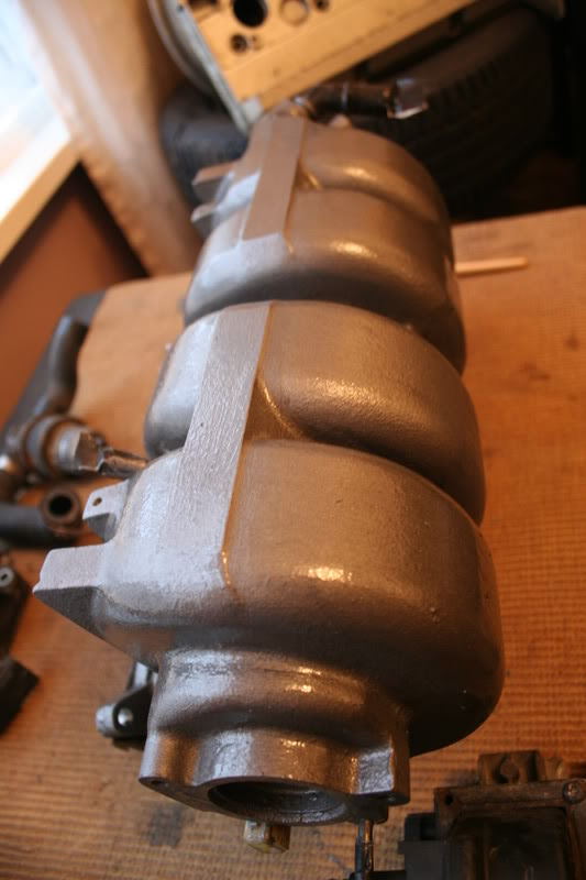

Some of the boring stuff lol
Inlet before (sorry poor picture)
Inlet after 2 coats of hammerite
Just plodding on getting all the parts cleaned and painted :)

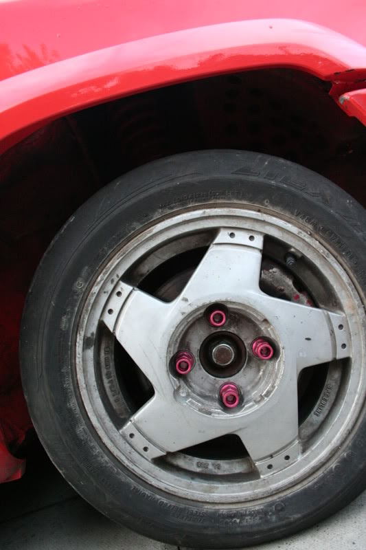

The splits have been painted black (and are on my caddy for the time being) thats just the colour they were when i got them. I just tryed them on to see what clearance is like with slicks... altho they did look pretty cool with the yellow :)

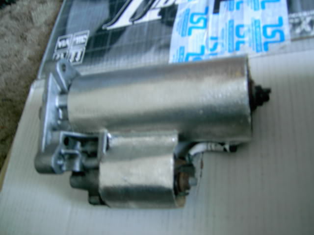

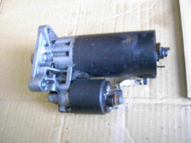

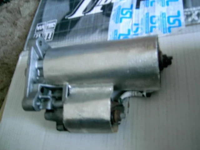

I made a heat sheild for the starter motor to protect it from the heat from the exhaust manifold, the factory item is a cover that goes over the top and tbh gets in the way...I cut up a Audi TT boost pipe heat sheild to suit
Before
After
