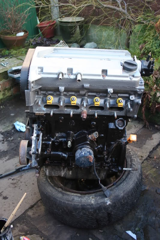

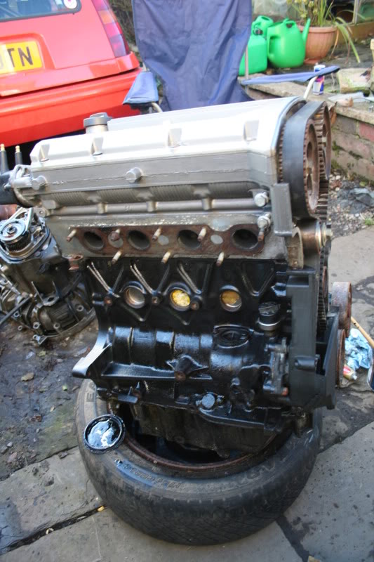

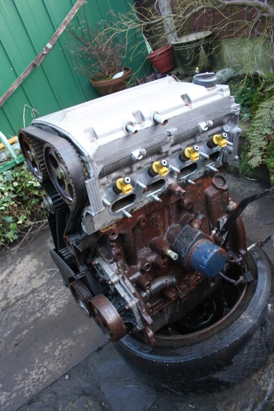

I had already give the head a coat of paint... but this is how it looked before
Out came the black hammerite smooth... gave both sides the bottom end a first coat, not pretty but better than rust brown

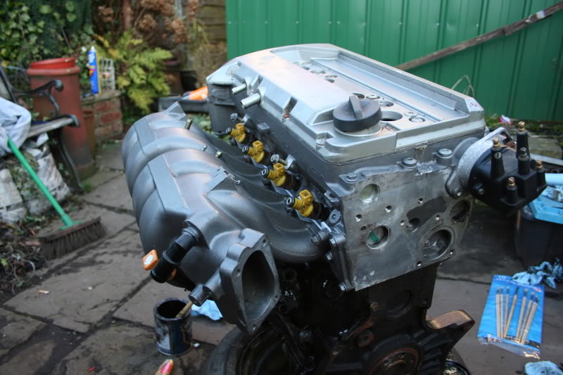

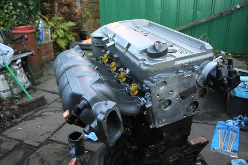

I gave the head a 3rd coat of paint.... fitted my pre painted inlet manifold and thermal inlet gasket
I need to finish cleaning the gearbox then paint it.... fit the flywheel, clutch and gearbox... then i can get it mounted on the subframe :)

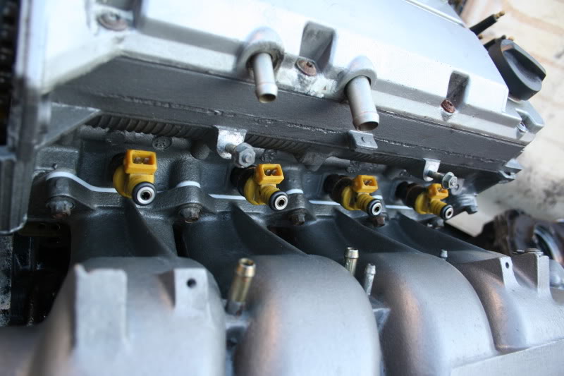

Loving the project winston out of interest what injectors are those you are using?? If known what CC are they??
James5_GTT
  R5 GTT
Re: Renault 5 F2000 Tarmac Rally / Sprint Car - Clio Williams conversion & overhaul
Ignore me just had another look and realised they are standard valver jobbies:clown:

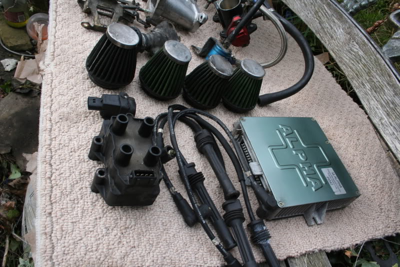

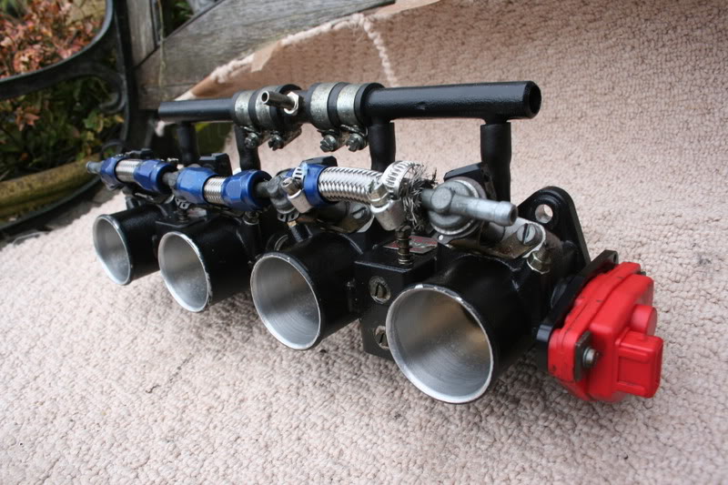

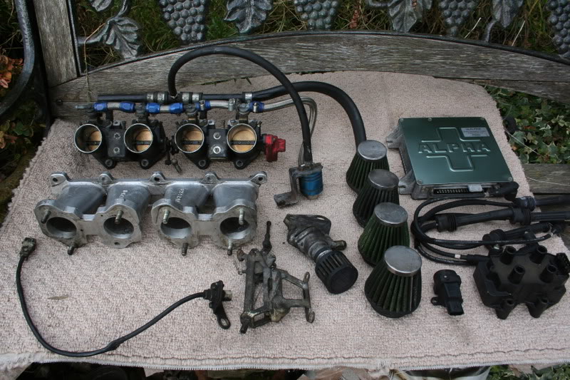

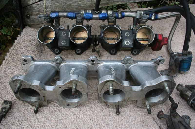

Alpha weber ITB's from an ex K-tec demo car... lets just say i got them for a good price.. and I was praying no one beat me to the deal lol
  ValverInBits
Plug n play! lovely.
What power did the kit make on the last engine it was fitted too?

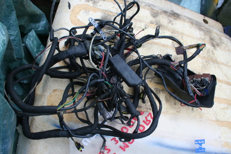

What's the deal with that ECU? Is it a proper fully mappable standalone jobbie? or just a modified renault Siemens unit?
The Clio 1.8 16V they came from had a big valve head and cams and was said to make 175bhp
I think its a standalone jobbie... but was confused to see the the plug was the same as 16v standard ECU plug

The map will deffo need tweeking... I hope to get a copy of the software... Some how lol

45's may be better for a 2.0, although 40's would still work. Jetting them you only need to do once and set-up can be done once on some rollers, then adjusted when needed. Only a mixture screw and length of pipe down the carb to "listen". I used them on my Nova, epic. A 5 deserves carbs TBH ;)
Ive been offered some 40's from a 2.0 8v Ford pinto for dirt cheap... could just bang them on to get it running for the summer... need to chat to a few people tonight see if they can tune them for me
Got to remember its on a ghetto budget ;)
M
mini-valver
Tuning them is easy! I had the mix screws at half way, idle screw all the way out, got it running and set the idle, then listen to each cylinder and adjust the mix so it idles nice and all cylinders sound the same. Old skool way a 70's Vaux nut showed me. Worked aswell, lol. Plugs were spot on too, so it wasn't over/under fueling.
DCOE's run best when you set them up quite lean as they like to hunt for the fuel, if that makes sense, lol.
  williams and trophy
the bodies are basically twin 45s mate. but using injectors rather than jets.
like i said.wayne can map em.......think he quoted me 350........as he did for my original map, but it dint cost me that much ;)
bear in mind tho.....u will need any ecu mapping, well any thats worth its salt, by a reputable tuner/dealer to get the best out of it.
wayne did actually offer me a decent price for the alpha + but that wouldve left me ecu less and still need a map for the new un.
bite the bullet n get it mapped properly. tbh
