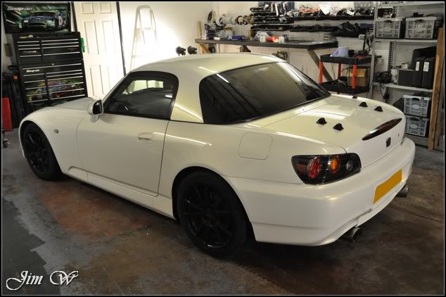

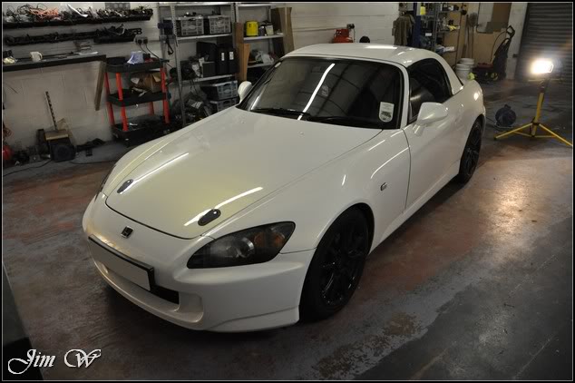

Having spent three days with Jonny from PureDetail a month or two back down in Sevenoaks, Kent, it was time we caught up again. I was invited to the PureDetail HQ in the North West, the plan was to help out on a correctional detail he had on the go and also to try my hand at wet-flatting using the DA.

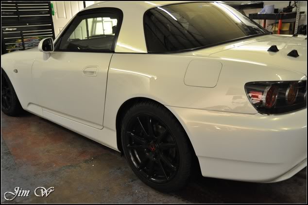

The car in question was a recently resprayed track-spec Honda S2000. If I am honest, the finish was dreadful. Probably the worst respray I have seen to date. With this in mind, only so much could be done with the flatting; sanding scores, paint runs, hundreds of fish-eyes and deeper ‘dimples’ were dotted around on every panel.
On my arrival, Jonny had already put the Honda through the full wash stage including clay and tar removal. The wheels hadn’t been touched as they would be coming off the following day for a full cleanse and wheel-nuts to be painted.

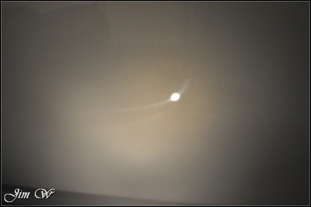

The tailgate was suffering the worst – Mirka Abralon 2000 sanding discs used on the DA to give a consistent smooth finish.
Here, you can see what we were up against: (Note the dimples)
As we were working with UK paint and not the usual ‘butter-soft’ Jap stuff, we were able to go quite heavy with defect removal. Multiple hits of 3M/Menzerna polishes given to chase our sanding marks and swirling.

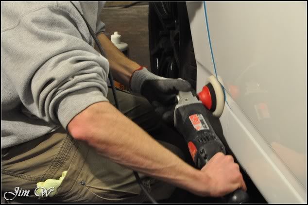

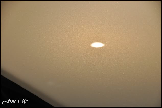

Whilst Jonny battled with the best part of the tailgate, I got stuck in with Menzerna polishes to correct both the near and offside of the Honda.

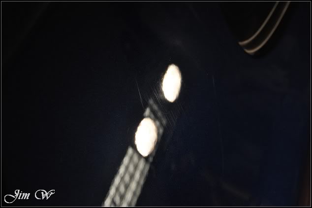

Buffer-trails spotted before:
Clear and crisp after:
More machine holograms:
Removed via correct rotary polishing and product choice:

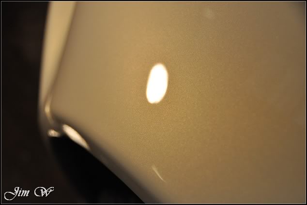

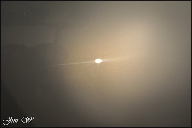

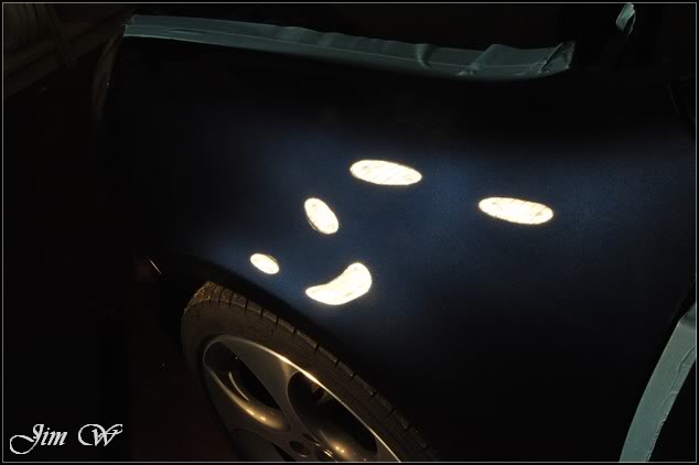

Although not badly swirled, the N/S front wing was covered in a haze:
A single stage machine correction pass was able to remove the holograms and restore the high gloss:

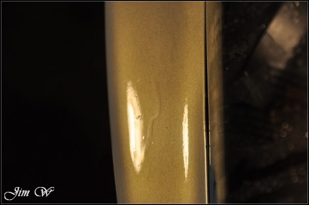

Check out the paint run on the front bumper:

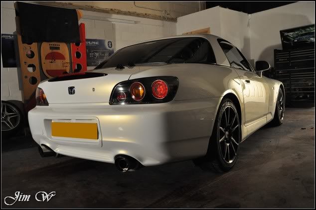

Jonny refining his work on the rear end:
My before/after on the N/S rear quarter:

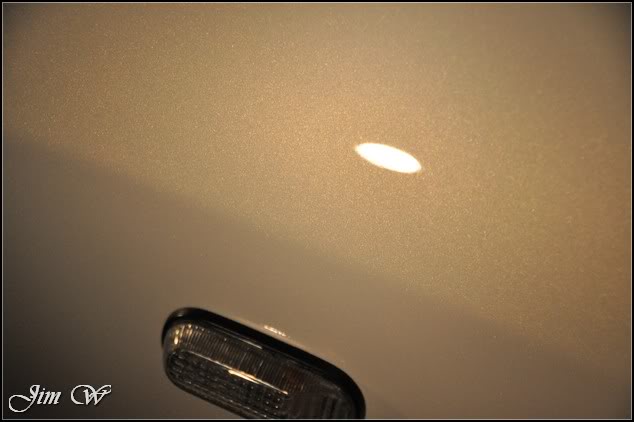

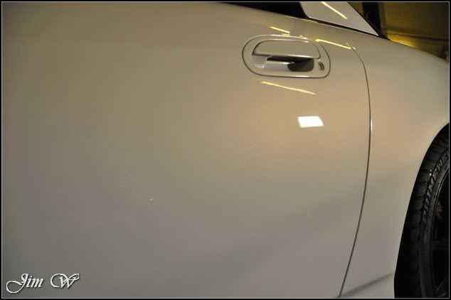

And a nice shot of the pearl flake ‘popping’ now it’s correctly finished:

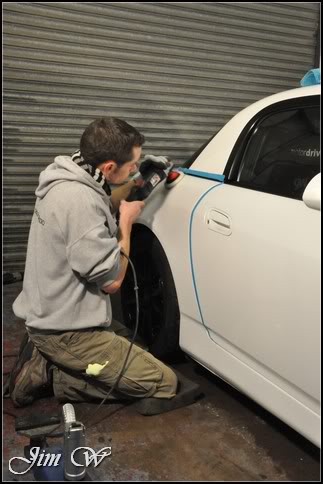

Switching sides, I took control of the DA for a bit of wet-flatting and Jonny corrected the bonnet:
The far left hand side of the tailgate was left for me… A 2000 sanding disc to remove the nastier scratches and to lessen the fish-eyes, then following with a finer 4000 grade disc before compounding and polishing to a near on perfect finish.

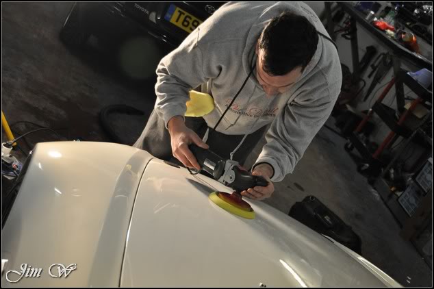

Whilst Jonny finished his work on the bonnet, I rejoined him on the rotary and started to work down the O/S hoping to meet him half way.

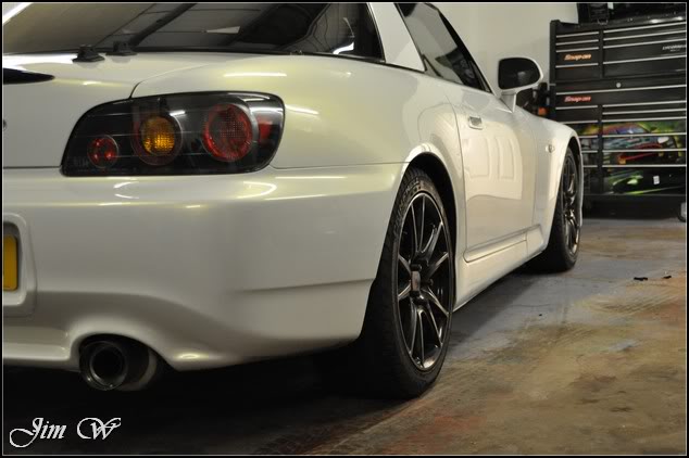

A final wipe down of the paint and we’re finished. Not a bad afternoon’s work!
It’s a shame about the respray nasties… The cars style/colour coupled with the aggressive track-stance really grew on me. A good day spent at the PureDetail HQ – watch this space for more tag-team work coming soon in a capital city near you!!

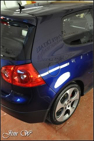

Volkswagen MKV Golf GTi – Shadow Blue. Minor Correction.
Having only owned the car for 10 days, the owner searched for ‘Detailers’ in his area in hope of giving the Golf a lick of protection and a general tidy up. Many recommendations were given on various Volkswagen sites for WhiteDetails – a few emails were exchanged and a date was set.
Slight change in the plan however. After seeing the results of a Minor Correction Detail, the owner decided to scrap the Winter Protection and go with the latter (A good job, too!)

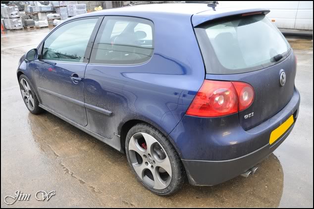

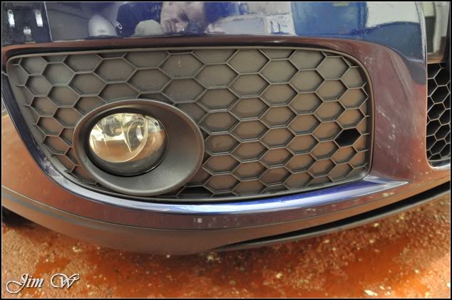

Wheels, tyres and arches cleaned with AutoSmart G101, AutoSmart Tardis and Meguiars Super Degreaser. Engine bay soaked and cleaned with Meguiars Super Degreaser. Doorshuts and sills cleaned with AutoSmart G101 and body washed with Dodo Juice Born To Be Mild.
To touch, the car felt fairly silky. A sign that little claying was required maybe?
After a test section,

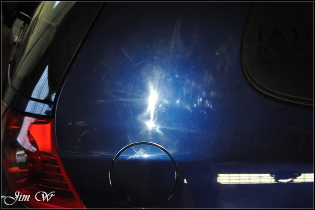

Heh. I take that back. The car was clayed, and, as you see, it was pretty contaminated. The lowers were soaked in AutoSmart Tardis to dissolve the tar specs and Megs Last Touch was used to aid the clay bar.

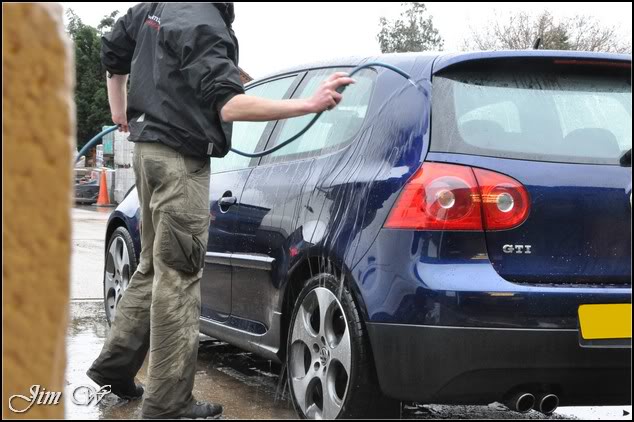

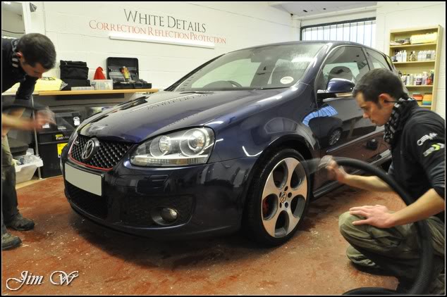

Rinsing as I go to shift the residues, a final ‘open-hose’ rinse was given to sheet the standing water off of the car.
After a quick towel dry session, the black baron made light work of the trapped water in the grilles, the panel gaps and the badges.
An awesome bit of kit - it really is. I wouldn’t like to work without one at this time of year to be honest. Yes, you probably add fifteen minutes to the drying stages, but later on in the day you’re not having to worry about chasing drips, smears and contaminated pads when trying to machine polish, apply a glaze, wax or window cleaner etc.

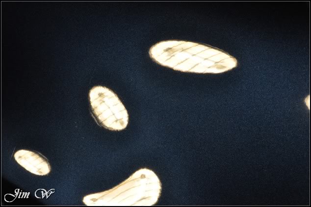

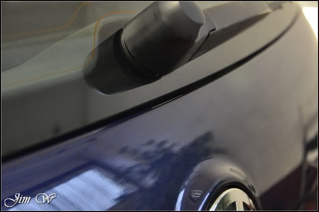

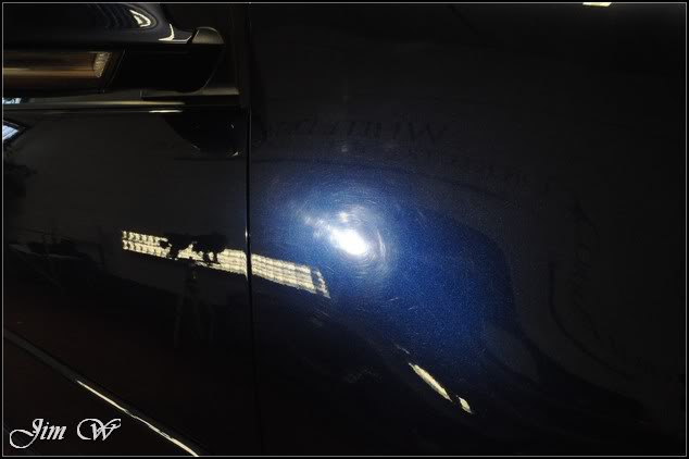

Time to inspect the paint now it’s clean.

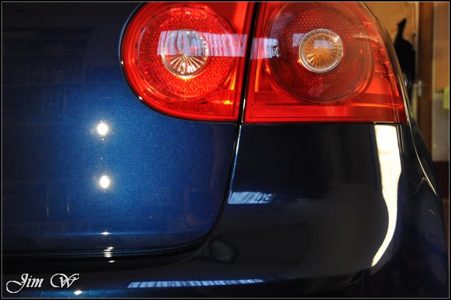

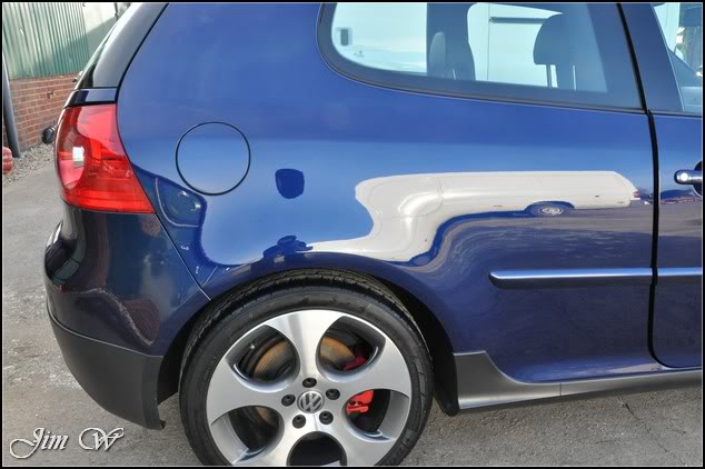

Colour match, eh? One of the two has been painted… (Turns out, they both have (just at different times one must assume!?))

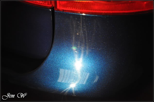

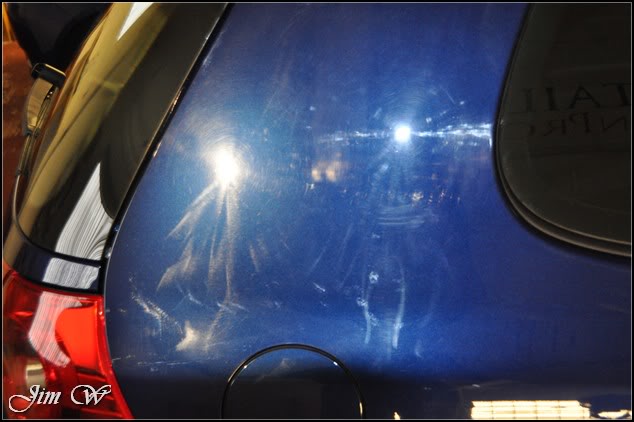

The rear O/S quarter was awesome. One of the areas I pointed out to the customer when he dropped the vehicle off:
So pretty! Even under strip lights it looked horrific.

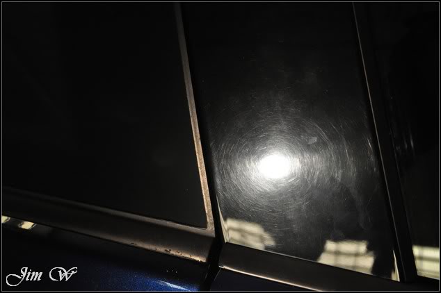

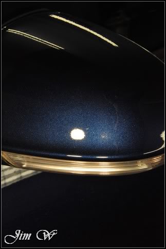

Gloss black B-Pillars:

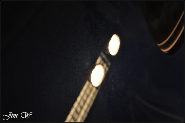

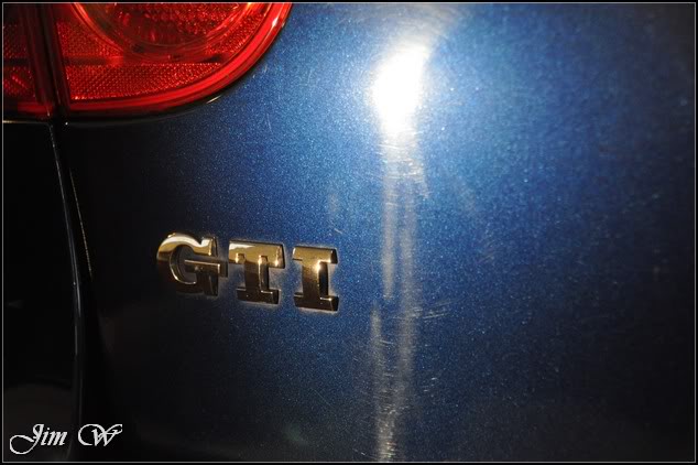

Roof: (with a loooong scratch that stretched from the boot spoiler all the way across to the windscreen (possible ‘water-blade’ maybe?))

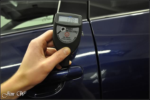

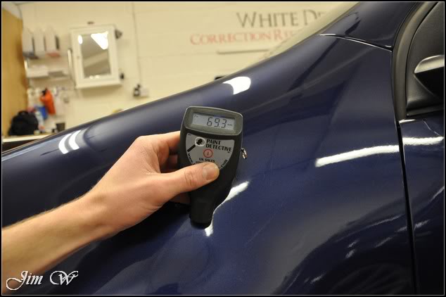

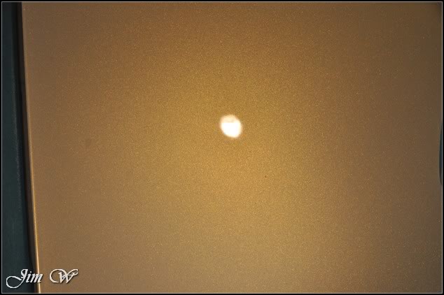

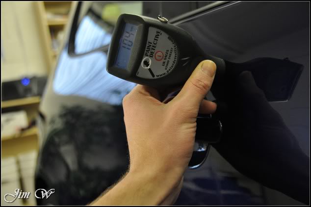

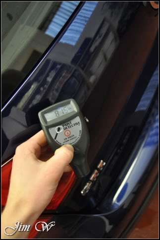

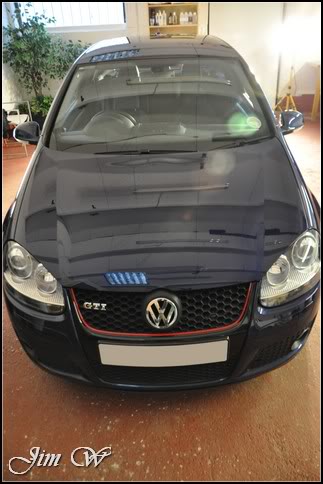

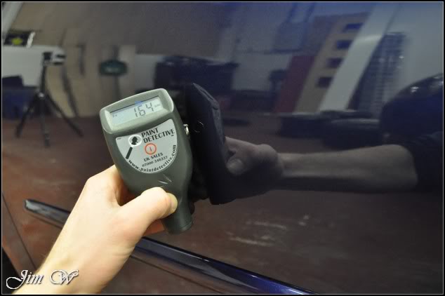

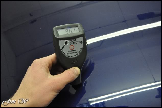

With the kettle on boil and the biscuits at hand, it was time to gear up. Paint thickness checked…
“oh, little low on the bonnet in places…”
“The O/S isn’t much better..”
“OK. Another area of caution.” On the tailgate this time…
“Finally. Some healthy readings!” (Turns out it had been painted)
The difference between the N/S door and the N/S front wing:
70 microns is really pushing it. I’m pleased we’re only booked for a ‘Minor’ correction as I don’t fancy going too heavy on that area at all!
By the end of the two days, I was trying to piece together the cars history. The front bumper had been sprayed (lacquer peel in a couple of places and a little bit of flaking on the edges), as had the N/S front wing and the door. “But the paint thickness readings on the wing were low?” Yes, but, wait till you see the marks from the DA sanding session!
The N/S wing and the door were a different colour to that of the N/S rear quarter. Photos later will show you this…

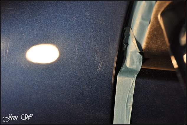

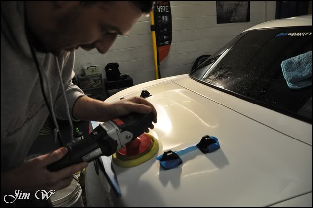

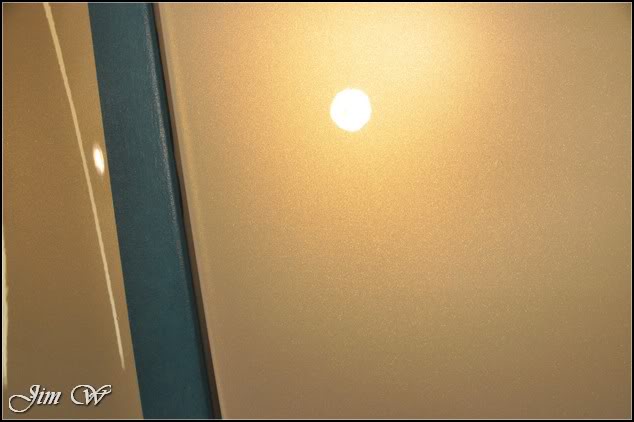

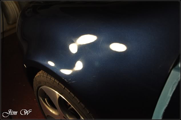

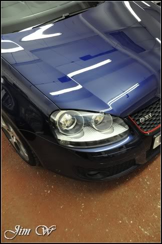

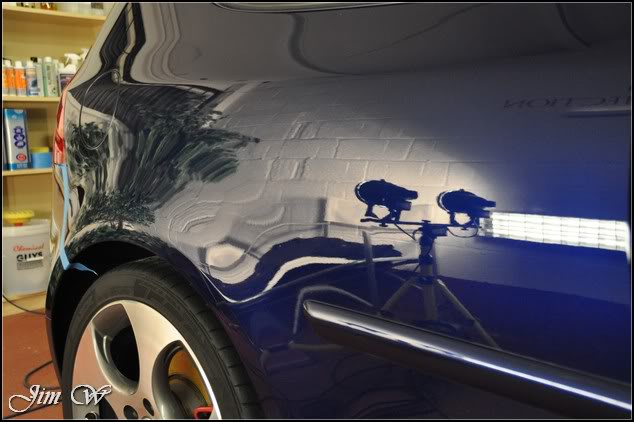

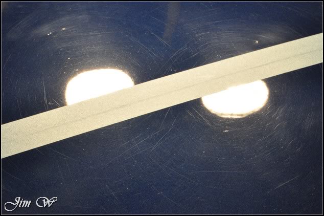

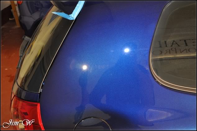

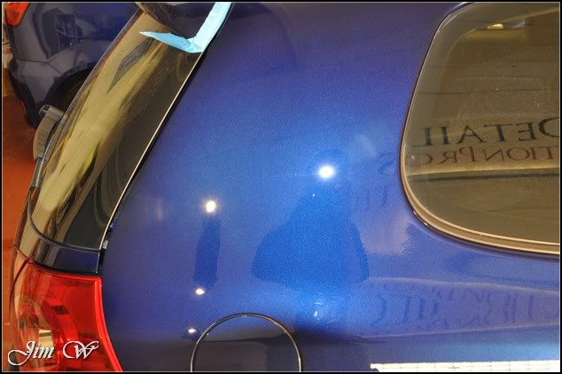

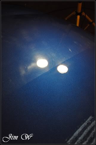

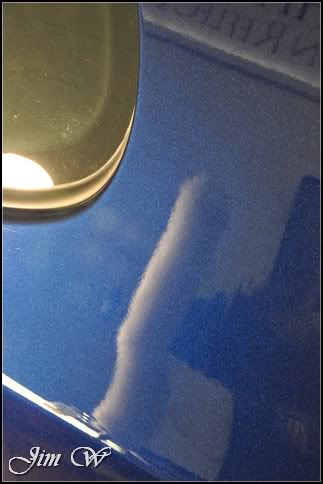

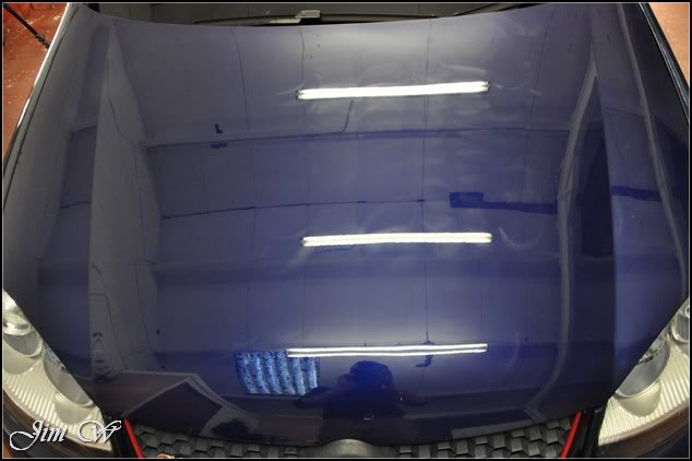

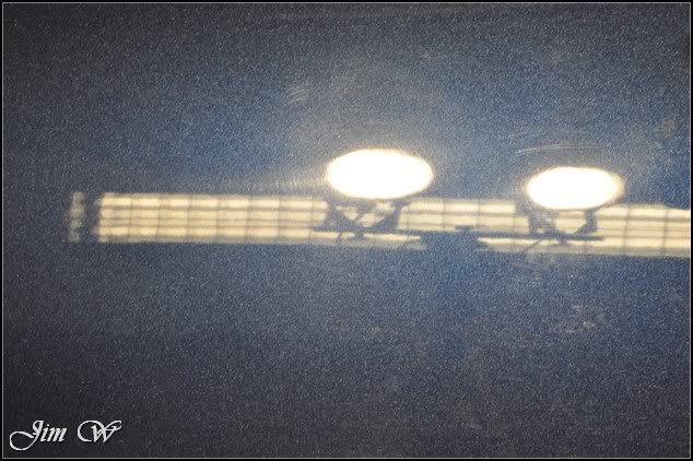

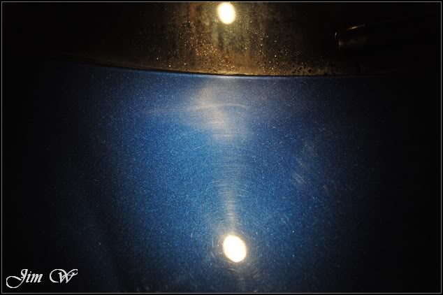

Testing my polish and pad combinations, I tape a 50/50 up on the bonnet.
Before/after:
Menzerna 203s and a 3M yellow polishing pad. Happy with the correction given (for a single-pass ‘minor correction’ detail) and I was able to finish with it well too. (IE, a burnished finish with no need to follow with a milder approach)
Bonnet 50/50 visible under the strip lighting:

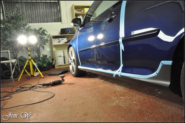

Continuing to work down the O/S.

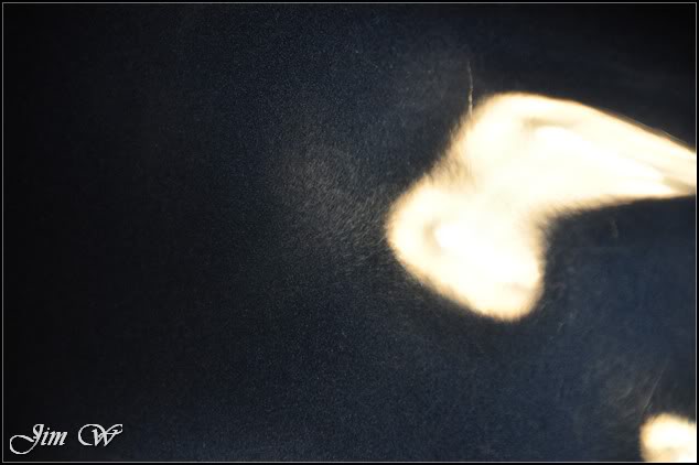

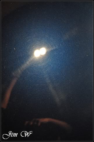

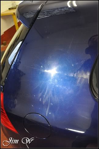

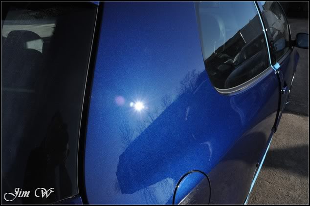

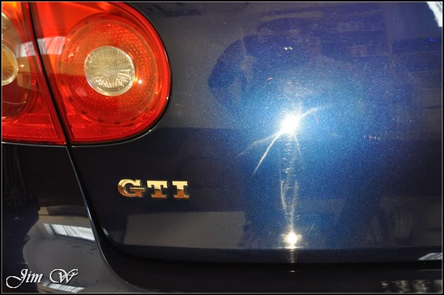

Remember this?

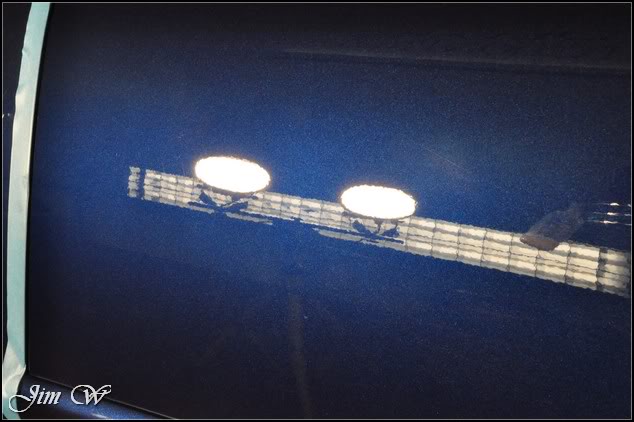

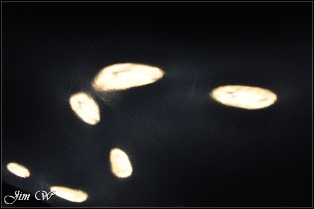

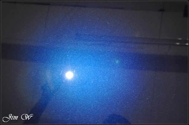

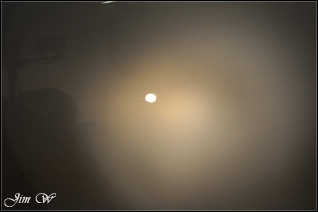

The single-pass with Menz 203s managed to clean the swirls and buffer trails quite nicely (…but left massive room for improvement!)
As thickness levels were healthy(ier!), I went with Menzerna 85RD 3.02 for more cut.
Much better:
And refined with Menzerna 106FA:

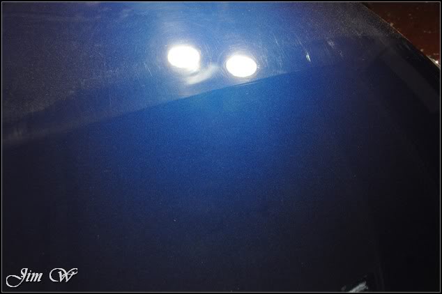

Back to Menz 203s and the yellow 3M pad - up onto the roof:
…and the tailgate:

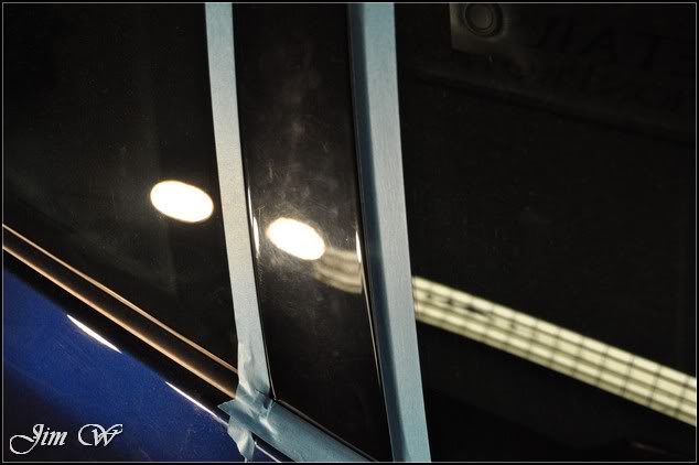

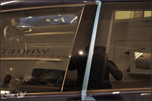

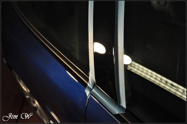

The O/S B-pillars taped and polished.
Menz 85RD 3.02 followed by 203s.
Before/After:

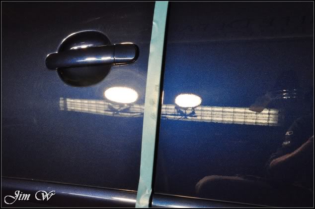

Even though the door is yet to be corrected in this next shot, you can see the difference in colour between the two panels:
Before:
After:
50/50:
Before/After:

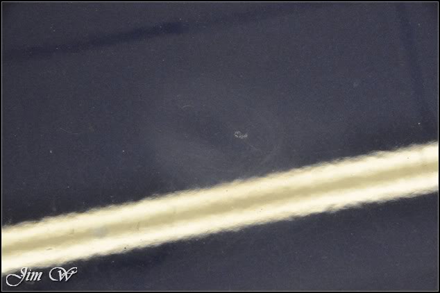

Much like the BMW Tourer recently completed, another burn through spotted on the edge of a panel:

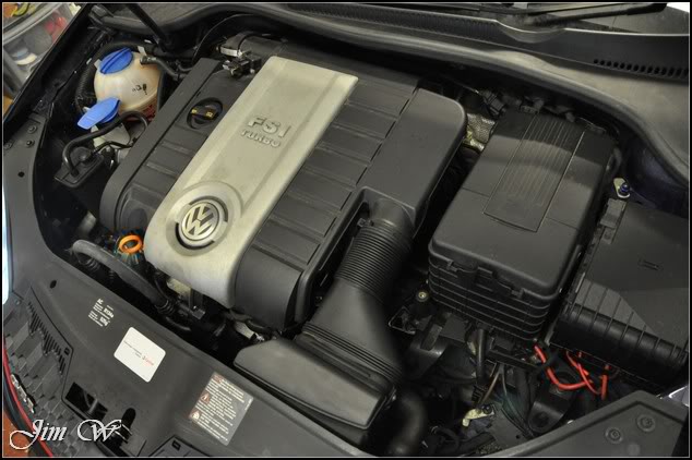

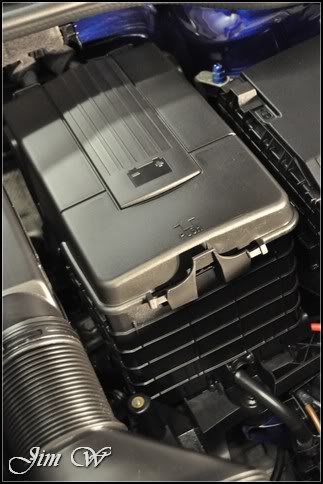

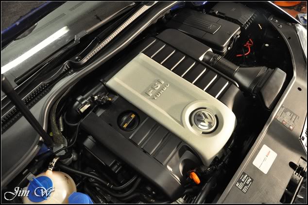

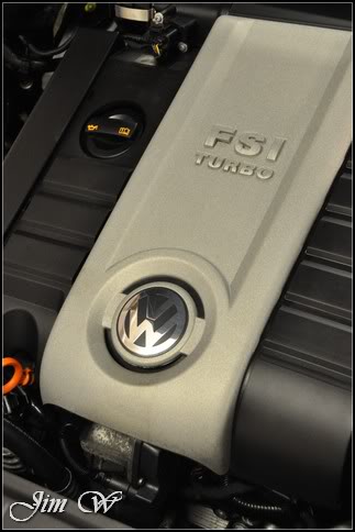

Bringing Day 1 to an end, I dressed the engine bay with AutoGlym’s Vinyl and Rubber Care.

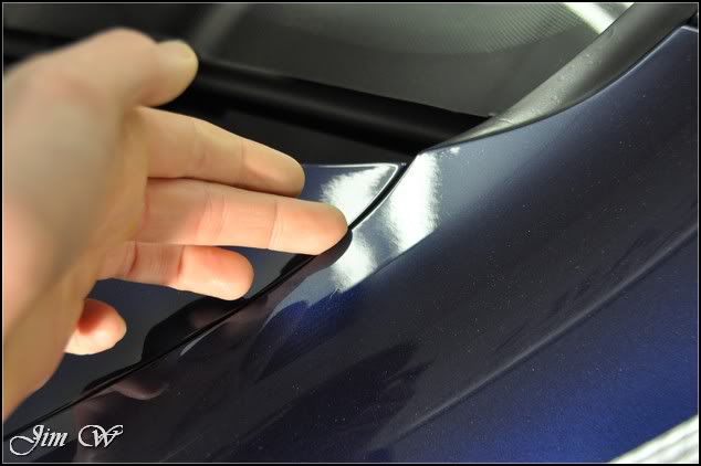

Another clue as to this vehicle having bodyshop repairs.
Quite a ‘lip’ between the edge of the bonnet and the edge of the wing on the N/S.
Comparison between the wonky N/S and the flush O/S…

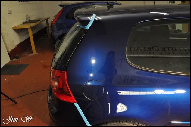

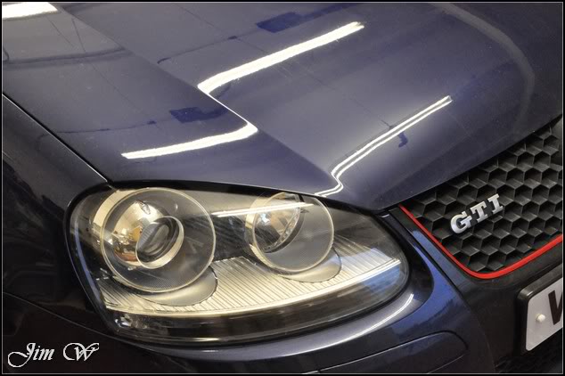

The morning of Day 2 and I’m finalising the machine work. Front bumper, rear bumper and half the bonnet to go… (The big 50/50 on the bonnet had been left on purpose for the owner to see when they popped in later on in the day on Day 1)

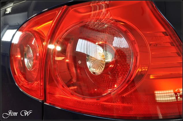

Light clusters before/after:
The sun was shining so I made the most of it by finding the excuse to turn the vehicle back-around…
And the rear wing that was riddled with deeper scratches and machine trails:

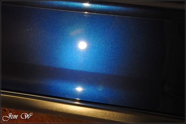

A stunning colour once properly prepped.

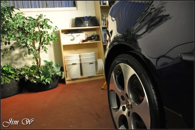

Wax removed. Glass polished inside and out. Alloys protected and tyres dressed.

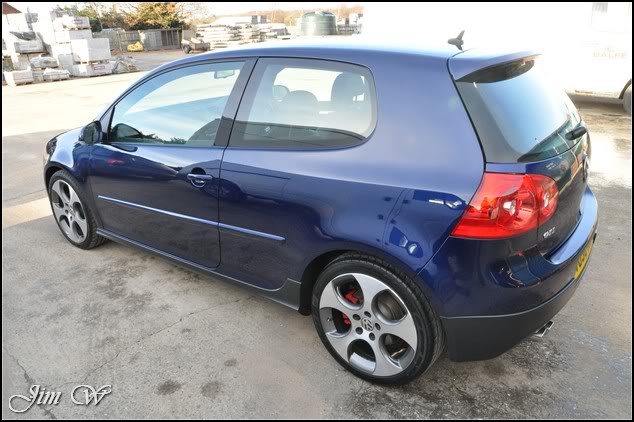

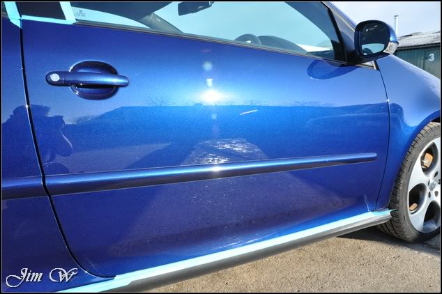

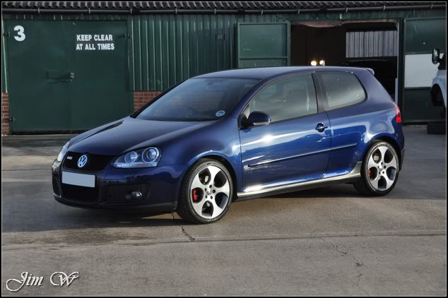

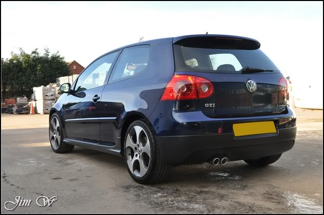

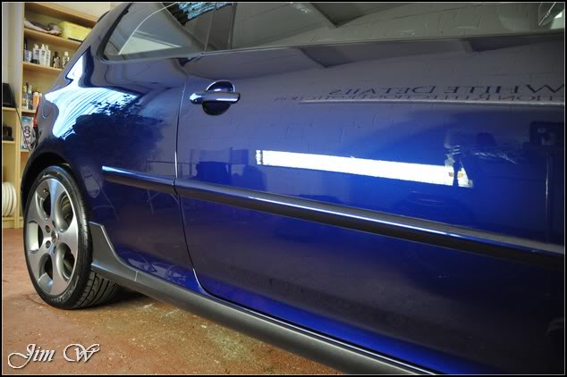

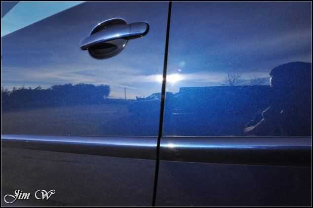

It’s pushing mid-afternoon; so I didn’t lose the sun, I snapped my ‘final’ outdoor shots before continuing with the interior work.
So, before and after:

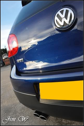

And shimmering in the sun:

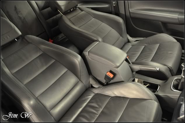

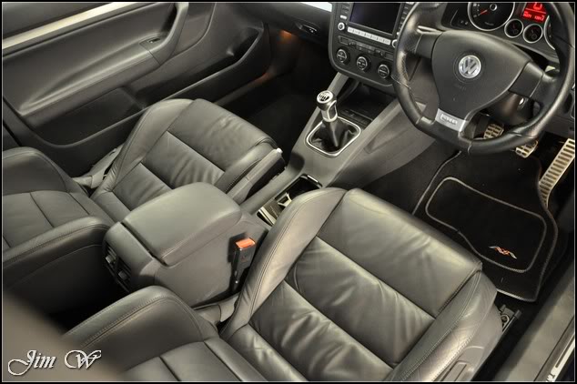

Leather seats, although not too dirty, were cleaned and protected (on request) with the LTT Auto Ultra kit:
The owner calls in at this point, and, we’re finished.

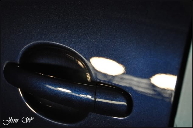

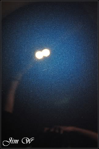

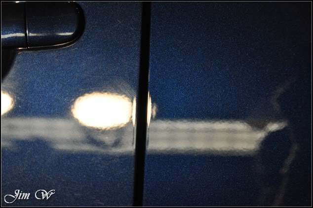

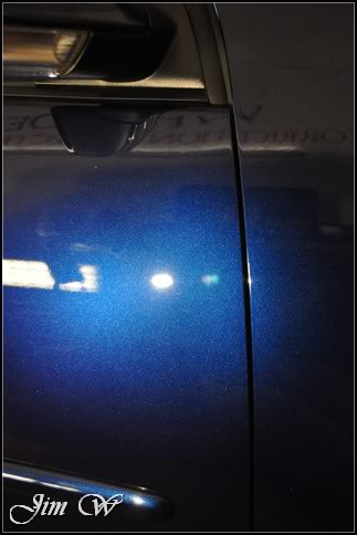

With the brinkman (LED torch) showing correction levels:
Again, lovely colour:

Is it me or does the N/S door look a different colour to the rear quarter?
Nice work, love mk5 golf gti's :)
Well spotted Chris - you're not wrong! I did write a little bit about the respray work on the N/S; you obviously just checked the pictures! ;)

When sheeting the water, is there any kind of knack to it? Speed of water etc? Because I've tried doing it before but miserably failed and ended up chasing water around the car with a very wet towel.
*brr*
A last minute booking this morning for a Refresh Detail as part of a maintenance contact in place with a local AM DB9. Here's to hoping we're not looking at -5/-8 degrees again as I don't fancy turning the Aston into an ice-cube.
Leeds2592, is your car well protected? You can see it working well above as I'd used Megs Last Touch to aid the claybar treatment; this keeps the paintwork slick and offers minimal protection (but, enough to help out whilst sheeting the water)
There is no rule as to 'speed of water', no. Too fast though and I'd imagine you're splashing it all over the place. On some maintenance cars, I can near enough dry the whole car without physical touch.
Start high obviously and work your way down onto the windows/tops of doors. Keep the hose pointing down and near 'flush' to the panel.
I tried to get my Dad to 'open-hose' once before and he got in a right mess. :rasp: You'll get used to it. (PS, what towel are you using?)

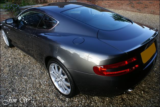

The Aston was difficult JD. Although all of my kit was thawed and 'ready to go', I forgot that at this customers house, my hose reel doesn't reach all the way round the house. Thus, meaning I have to borrow one of his and link mine up. But of course, his were all frozen... *one hour later...* heh!
No write up involved I am afraid, it was just a little 'refresh' detail in readiness for Christmas and a top-up before his next maintenance visit.
Previous report can be seen here: Aston Martin DB9 - Meteorite Grey
