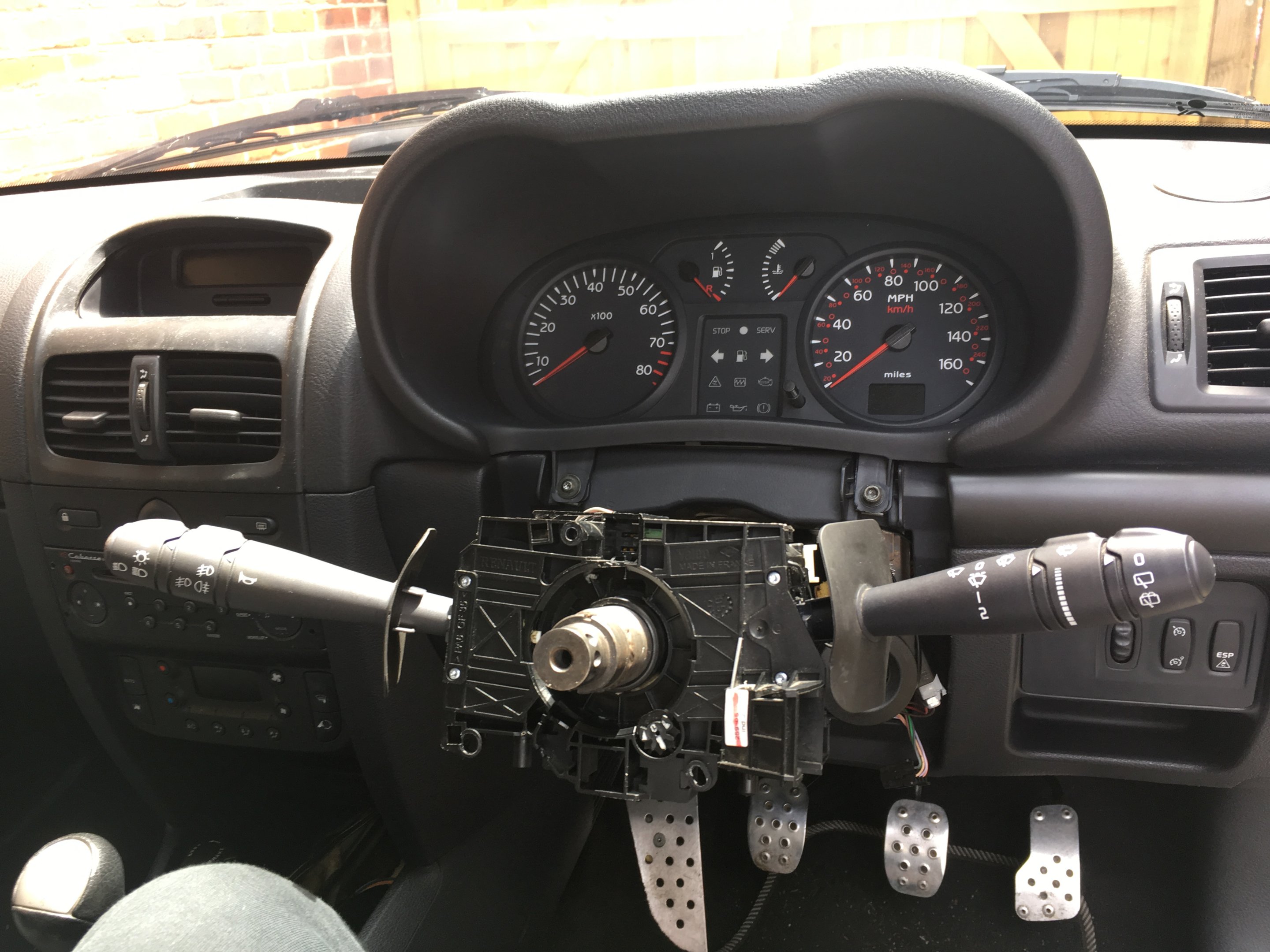

When i switched mine out i dont remember taking the steering wheel off, I thought i had to take the two plastic bits that wrap the steering wheel column.
Remove The top and the bottom one if I remember correctly.
The things that the sticks go into. Im sure thats how i changed mine. I defiantly didn't remove the steering wheel.
I think theres 3 fixes on the bottom under the housing. and then the top one should lift off? I think.
Then Two screws. Pull the stalk off. Then reverse.
Im fairly sure thats what i did.

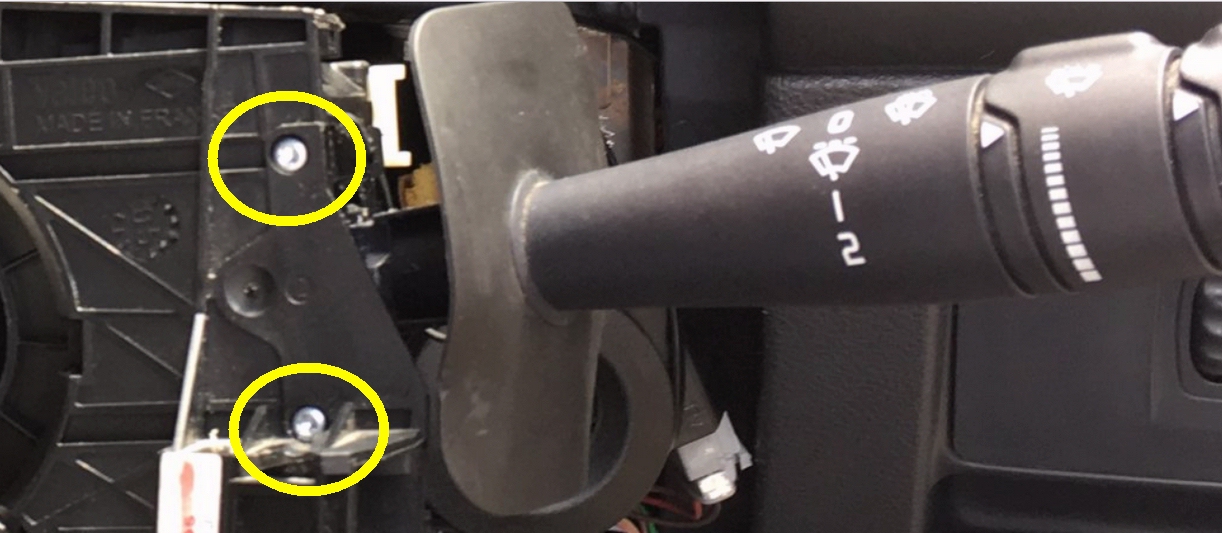

wonder if its just these 2 torx yokes then holding the stalk then? cause i can see these without removing the steering wheel, be a bit awkward to get to with the wheel on ... but should be doo-able
