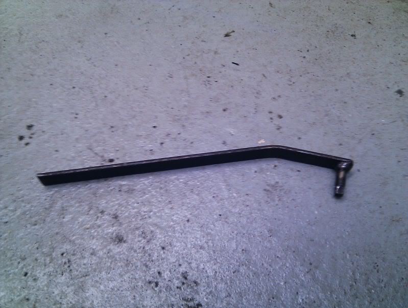

Re: how do you wind back the tensioner for the alternator belt on a 172, f4r 736 engi
Fabricated tool. Job done
