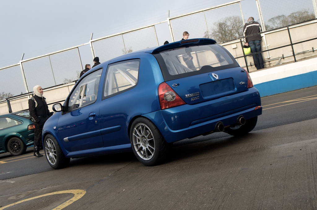

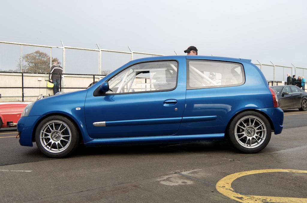

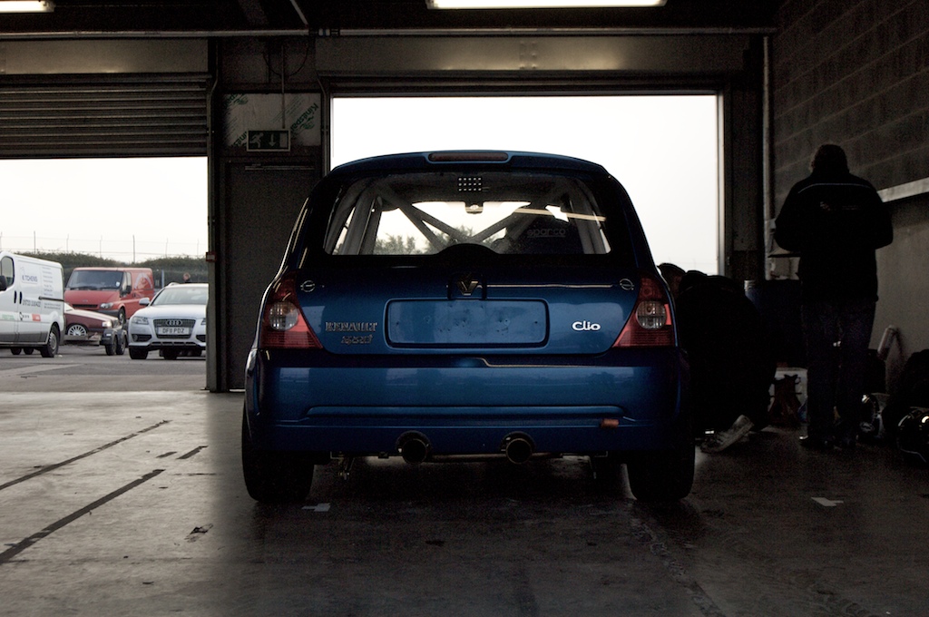

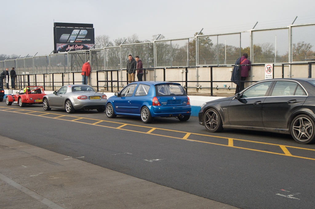

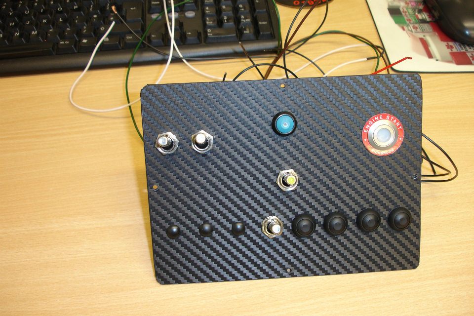

Well the car went on its first test Yesterday at Donnington, not the best of days as it was very chilly and damp with fog. We did not get on the track till gone 12 and suffice it to say I was VERY nervous.The car performed great, better than great to be honest. One small problem was that the front spacers bolts came loose on the left side. Looks like the bolt does not match the spacer and so only bites on part of it. These will have to be machined. Oil pressure is low on idle and we disconnected the ARB. I actually spun it twice. Once was down to cold tires and my lack of experience and the second was me lifting off half way round a corner because of traffic and my general lack of front wheel drive experience (lift off oversteer) again. learnt a lot :)The new switch panel looks awesome in ally :) Figures so far arebhp = 192At wheels = 168This puts me right at the top of class B for TDT which is perfect.

The first test is always a big day, glad you came away with no bumps or scratches. Did you get any pictures?
Sounds really good and sounds like it went really smooth for a first day. Pictures of the completed car would be great and would be good to see how you have done the switch panels :) When are you next planning on testing it? I bet your happy to see all your hard work finally come together and get to drive the thing!

Here goes on the pics. I was that excited i didnt take as many as i hoped too. Switch panel ones to follow

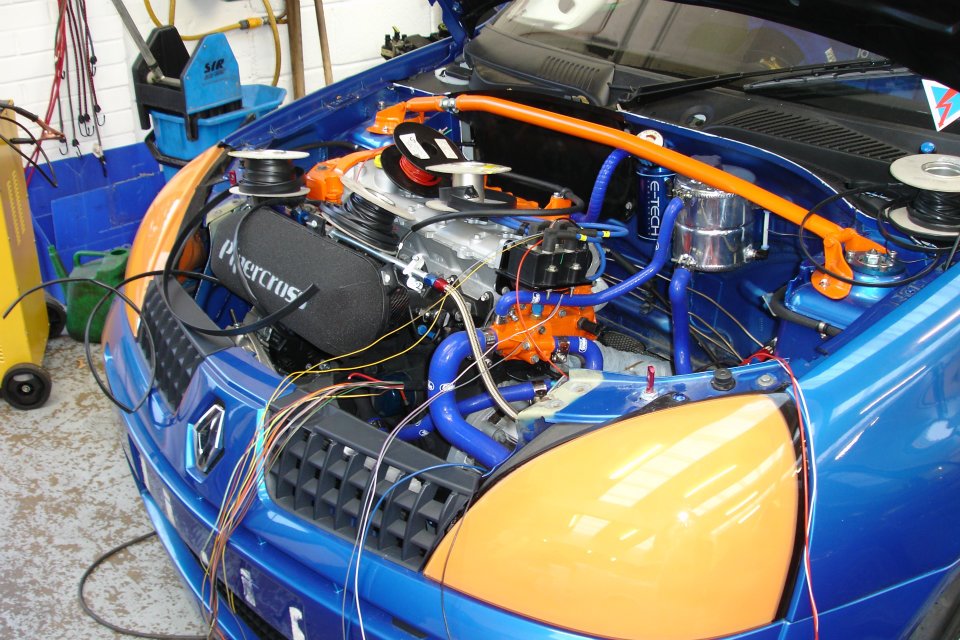

A short vid of the car on the dyno at NMS

Ah bummer :( Yes backend was quite light, very odd on the spacers as they were very tight and checked too. I guess these things happen all the time so you just check everything. I am so pleased it just ran though with no issues and we all went away with no bumps too. A good maiden outing.
Next track day will be once I get confirmation of TDT and then I will plan it around the first track of next year with some test days etc and post it here and PM you too that we are defo going :). I do not want to go racing with out having practiced on the track first.

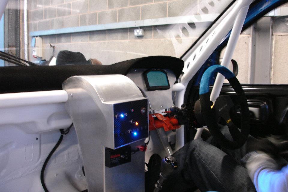

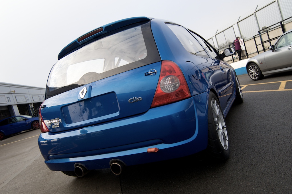

Just looked at those pics again and cant believe I finally got it finished and out on the track :)

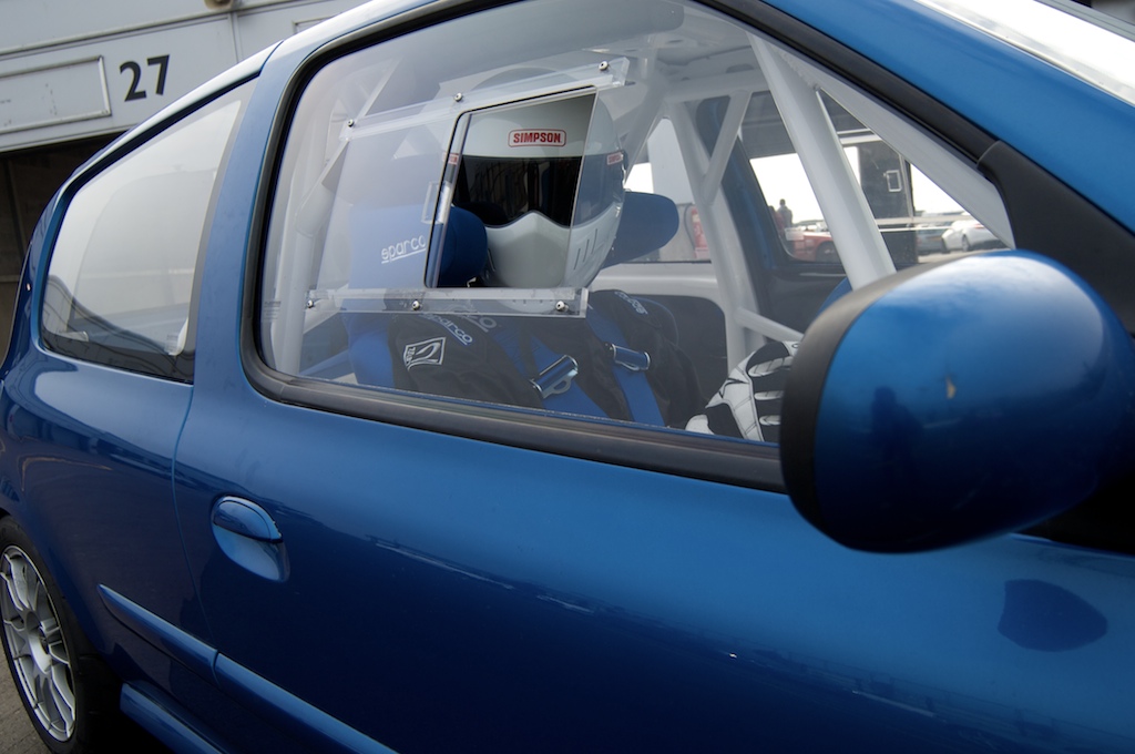

Chrispy drove it and had a massive smile on his face :) I even let him have the last drive of the day. He deserved it as without his hard work and help it would not have been finsihed this year. Funny though as my clear instructions on his first outing were, take it steady and do 2 or 3 sighters. Ten laps flat out later LOL ah the exhuberance of youth eh :)

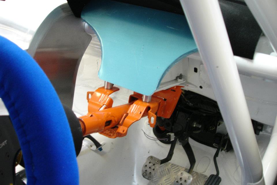

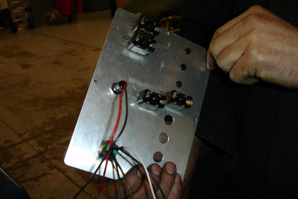

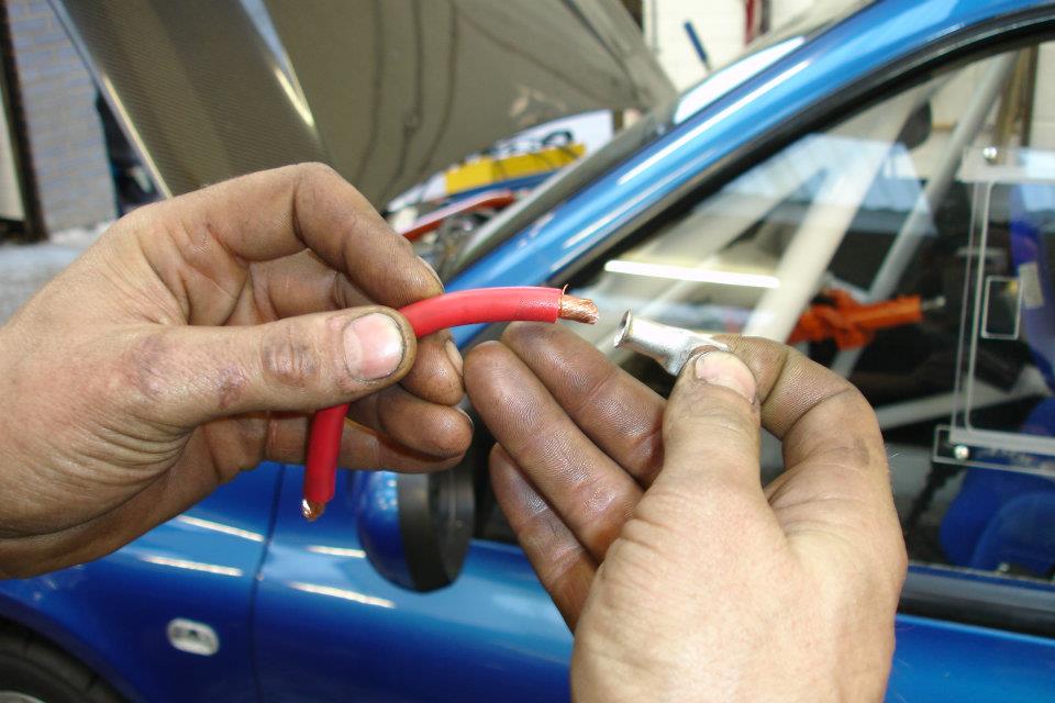

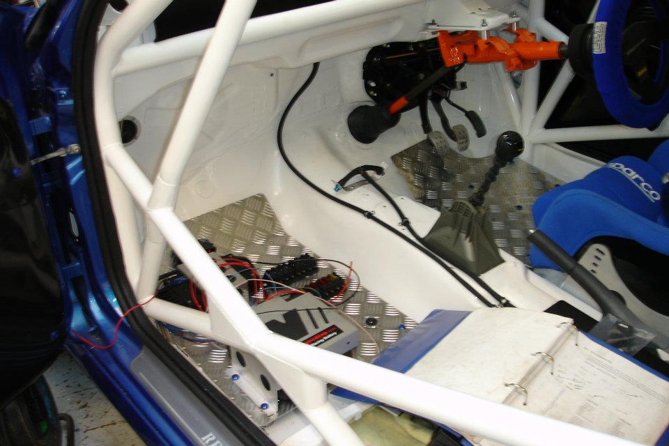

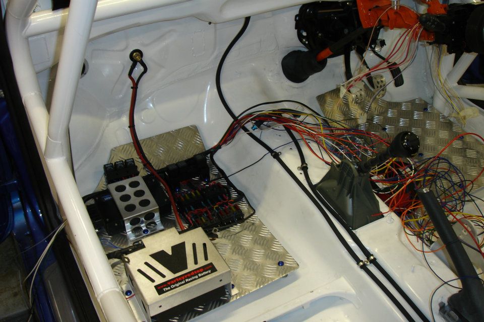

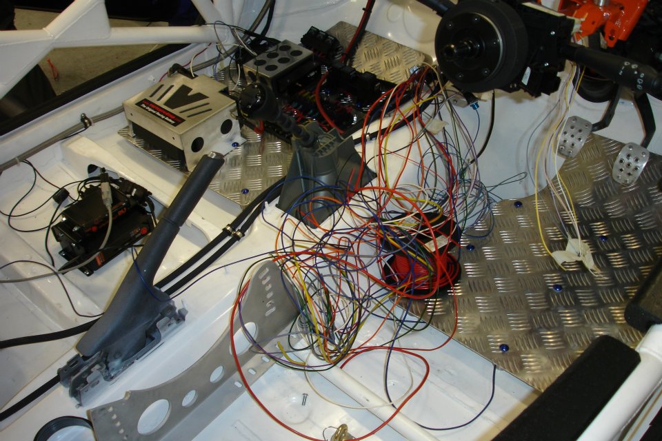

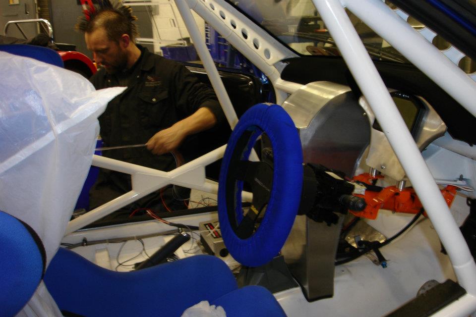

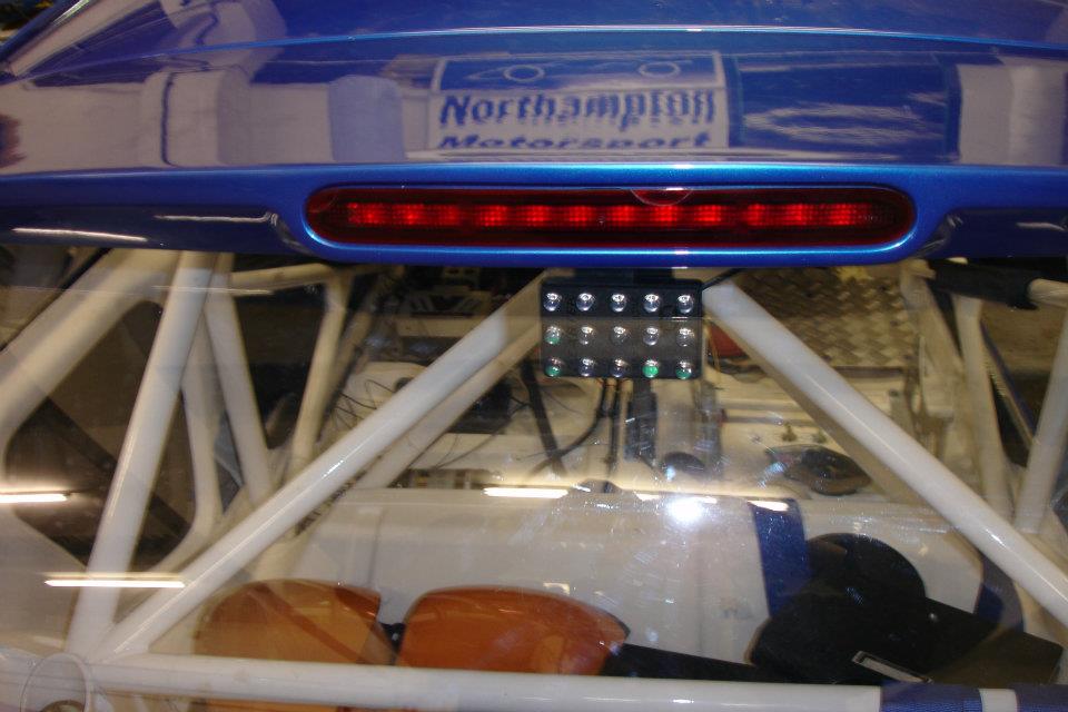

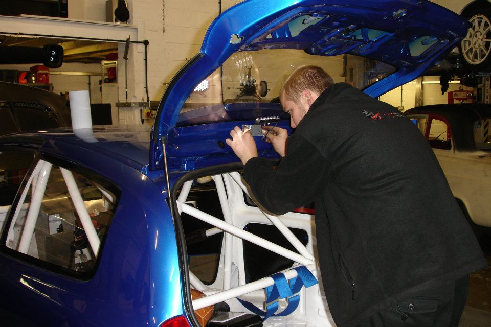

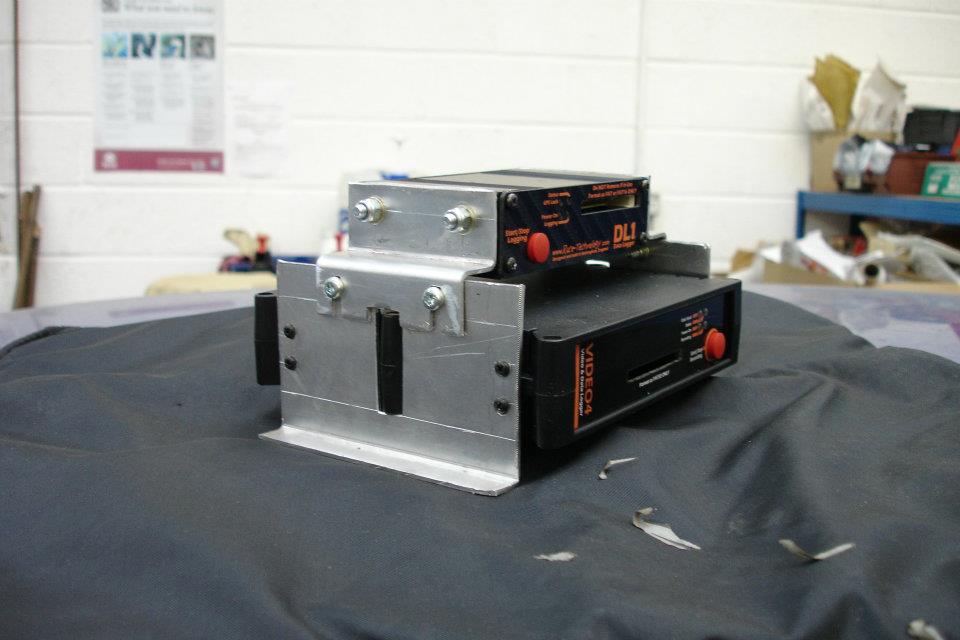

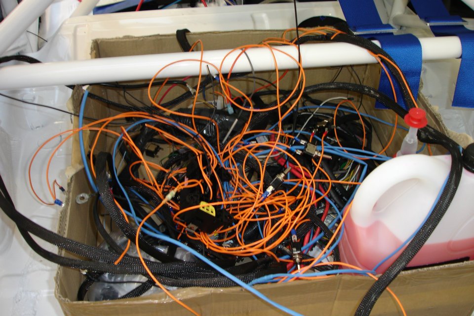

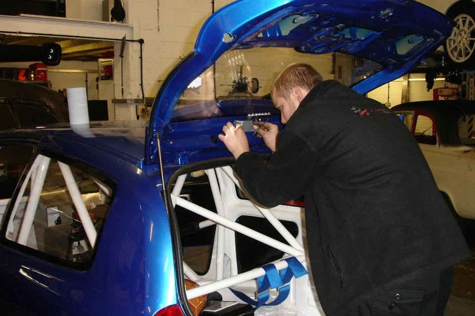

Here are some very nice pics of the excellent work that Northampton Motorsport have done. I cannot recommend them highly enough, why?
1. They always answer the phone and ring you back unlike Custom cages and others who did totally the opposite
2. They always make time for me and my endless questions
3. They supported me and are genuinly interested in the car
4. They have a great neat and tidy workshop
5. They know their stuff inside out
6. They are the best dyno guys I have come across by far!
So to the pics :)
Mark

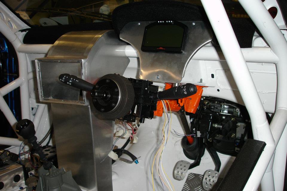

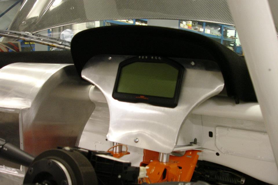

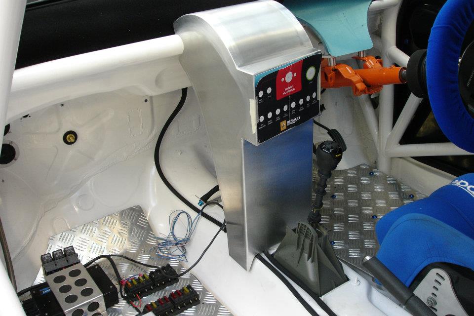

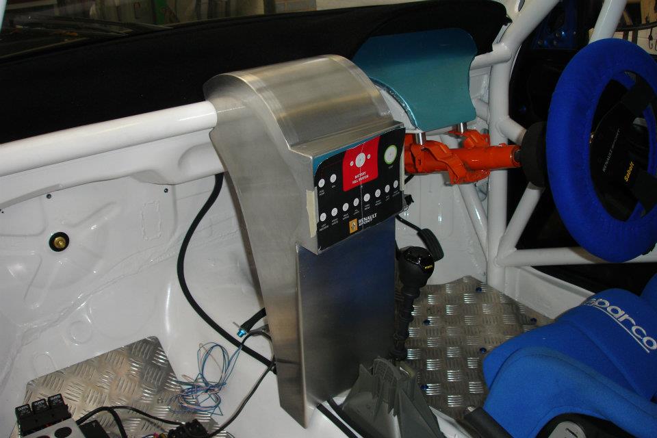

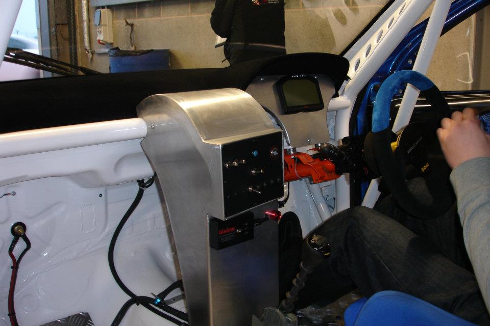

Looks awesome Mark you have done a great job of it all and NM look they have done a sweet job on the wiring with great attention to detail and so neat! Have you kept the UCH out of interest?
Edit: PS what is the dash top? Cut down ph1? :)
  Clio 172 Ph2

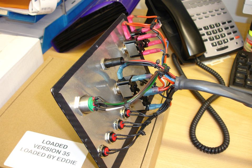

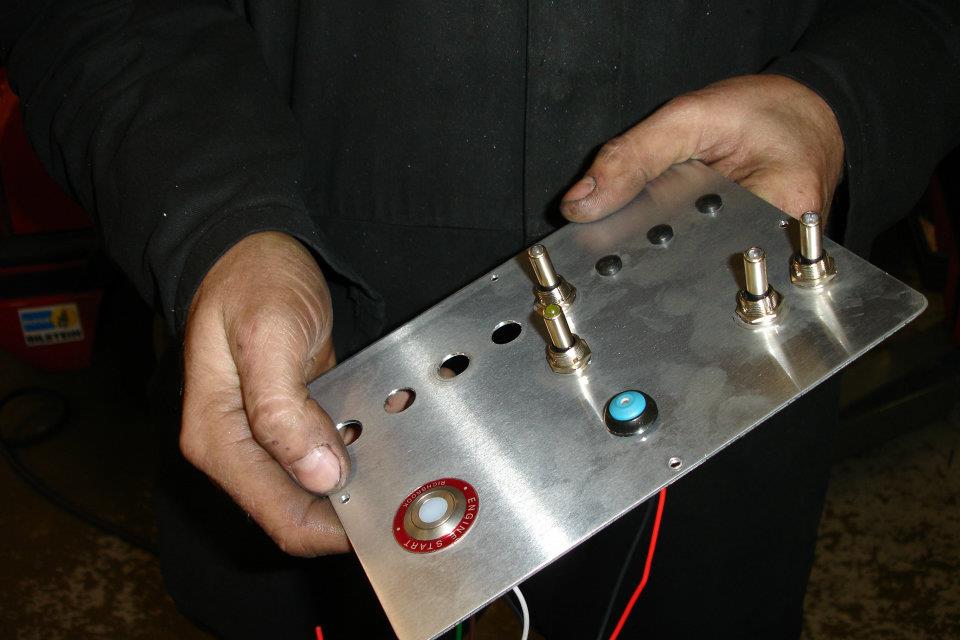

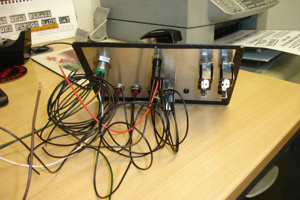

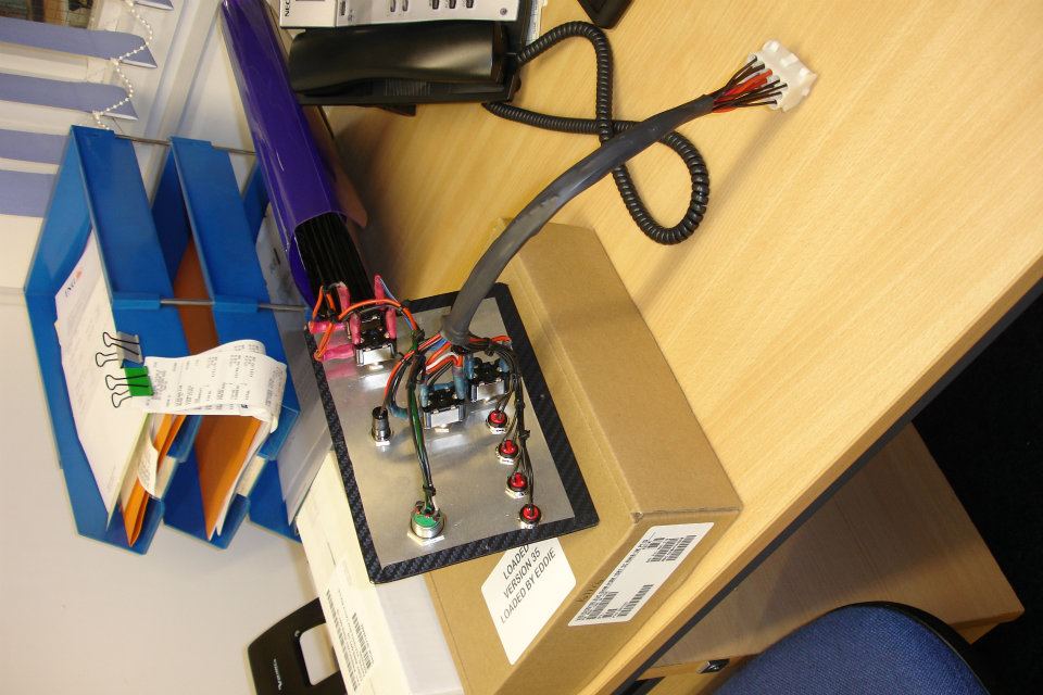

Does the switch panel need to be that extravagant?. I can appreciate the skill involved but does look like a lot of work for a few switches?
Whole car looks finished to such a high standard! Awesome work from all.
  BMW Z4
Just two words for you chap
Without Wax
  BMW Z4
Yes cut down MK1 dash top. What's a UCH?
  172 Race Car
Its the Fuse box/Body control usnit. Judging by the realy and fuse panels on the floor id guess they sacked it off
