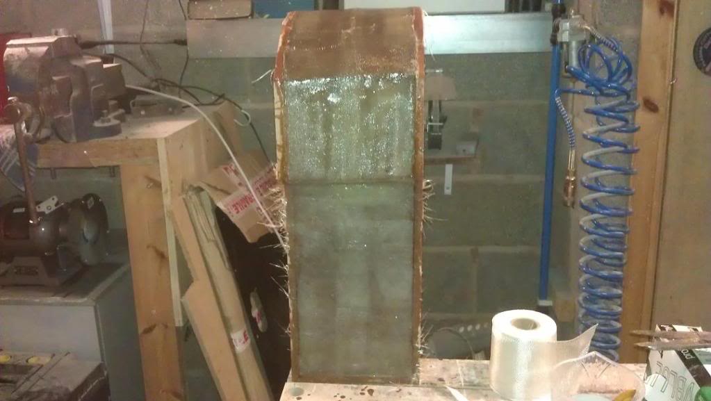

sorry couldnt email back the other day, my mobile broadband was playing up with the bad weather. Anyway to answer your question regarding the size I have made the panel the same size as the top part of the fiber board template you sent, I thought it would be best to use this dimension as your better to have it slightly larger than too small, anyway the top is exactly the same.
Nearly finished the grp work so not long till its time to get the sanding block out, I can't wait :-(
Here you can see it starting to take shape

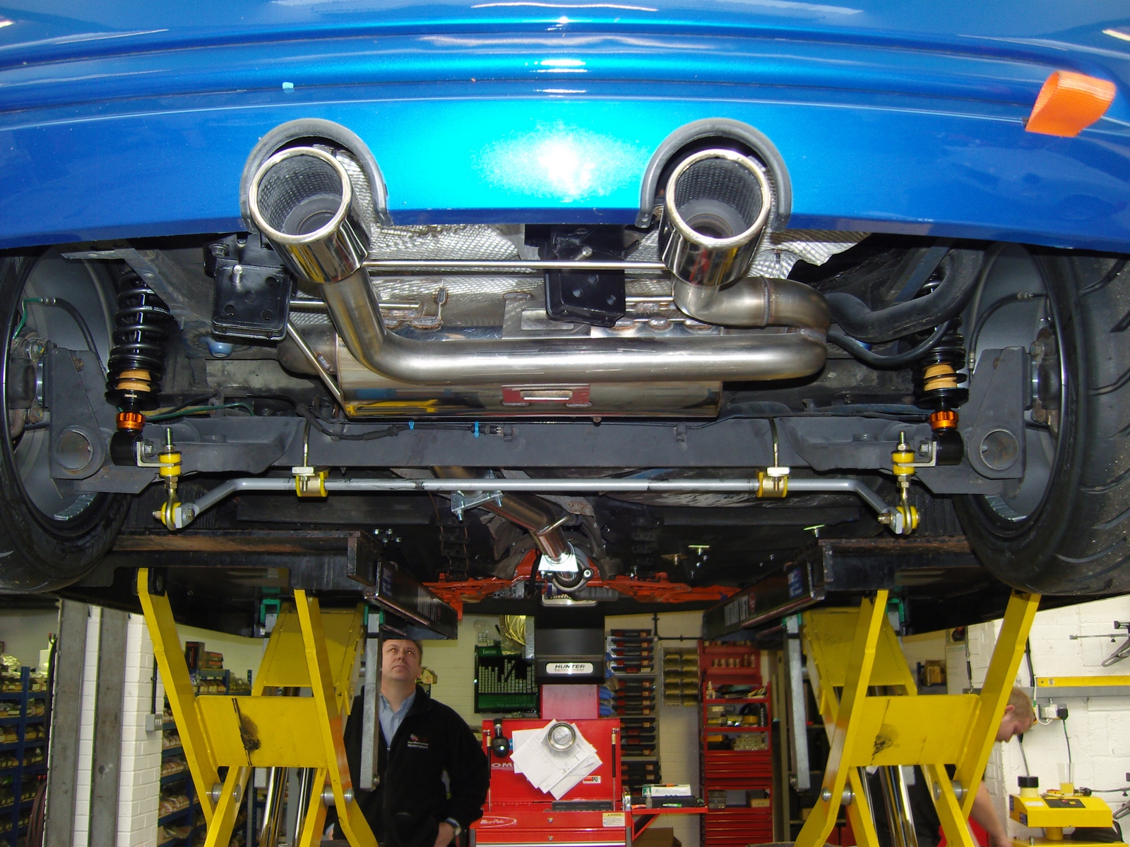

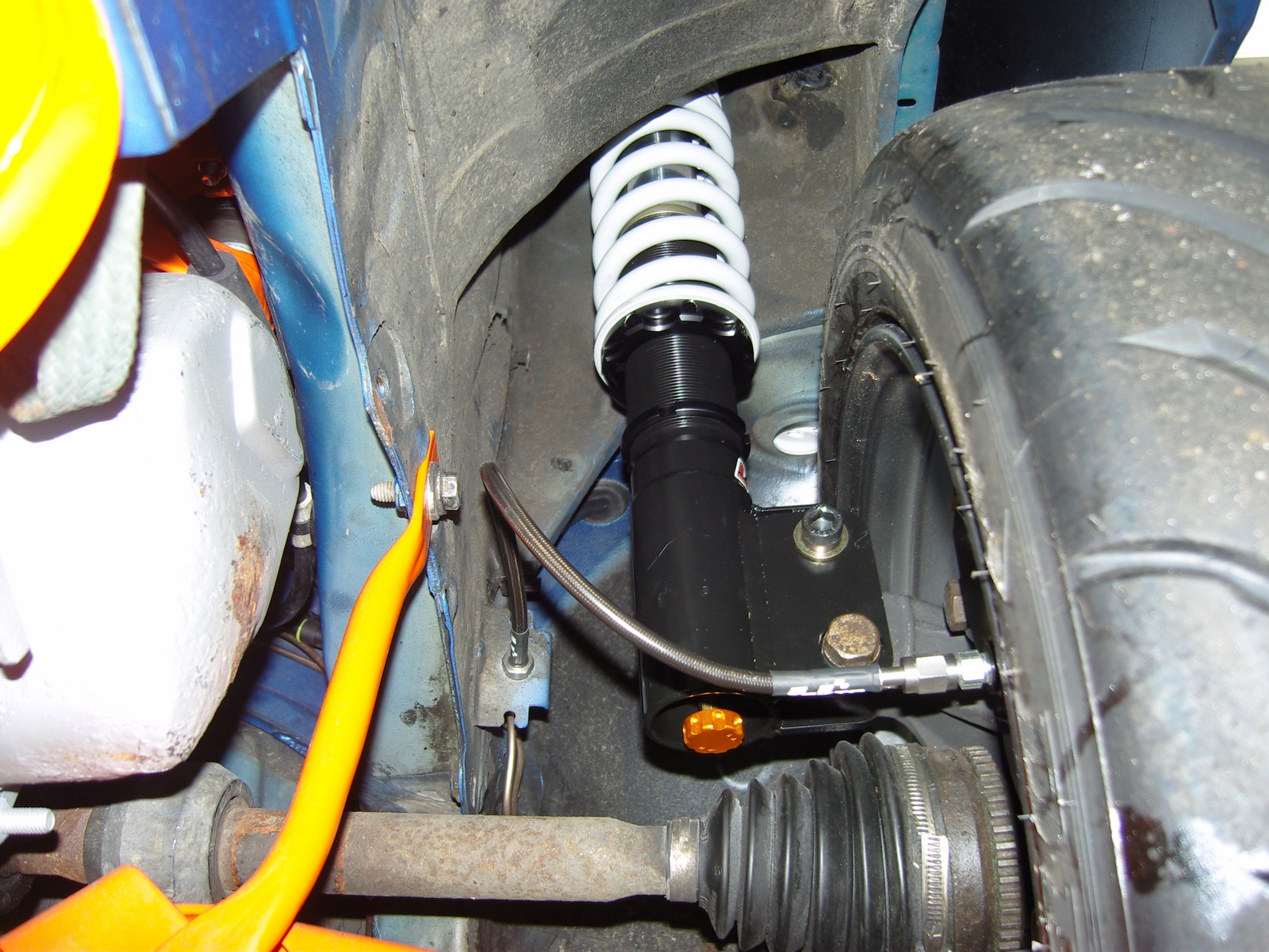

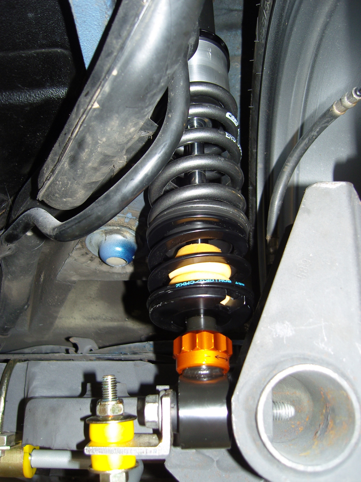

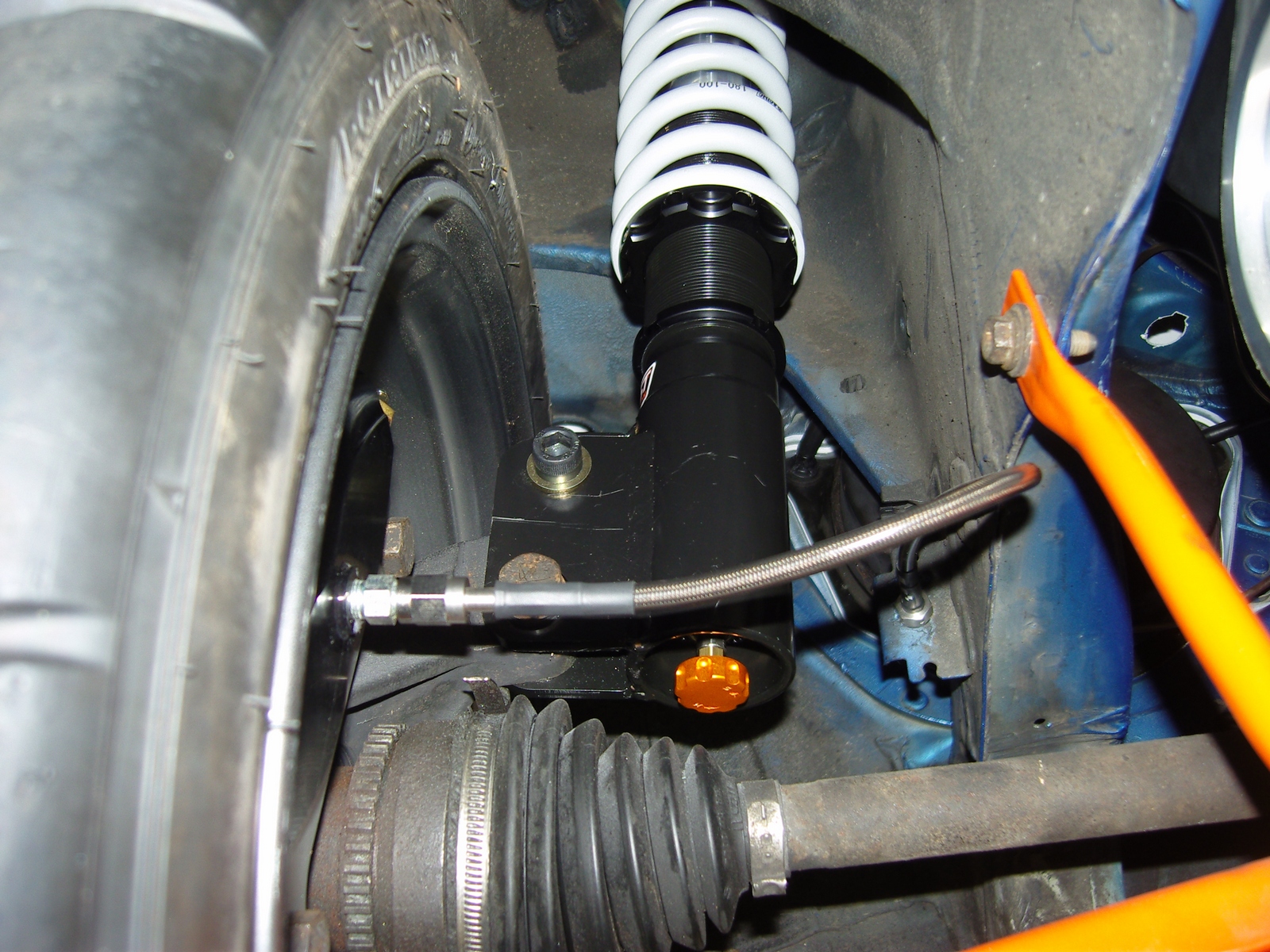

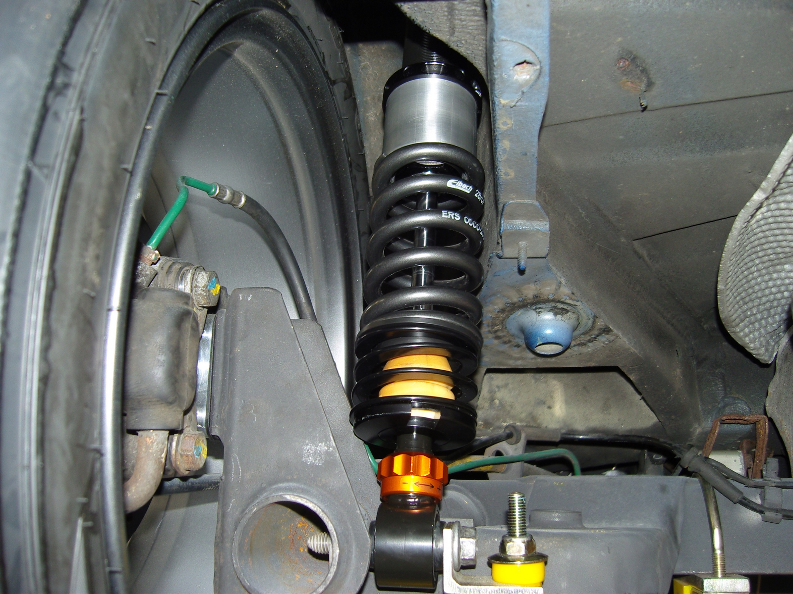

Update long in the coming :) I went over to NHM to weigh in and the car weighs 880kg without me in it. I took some shots of the new AST's whilst there and these are below.
Mmmm very nice. The corner weights and geometry are now done. I shall be selling the KW's now as new unused which is what they are.

Wow, 140 rears? AND an ARB.
Ours would spin like a top with that setup. Interesting to see how you get on
Yes the L bracket, I cant see it making any difference but it will be very low at the back and may catch on a trailer or something.
Also one of my brackets bent so would be worth welding on a web to strengthen them.
Now you have me worried Jay LOL. Someone recommended those rates although I cant remember who to be honest. lets suck it and see eh. I was also told the other day that with my cage I wont need the ARB so again let's see. You could fit on a penny black what I know about spring rates to be honest :)
I've noticed that you have used an allen bolt for the topstrut hole,I guess this has been done to achieve more camber adjustment,I'm afraid they will move,try and get the proper bolts in there,even if it means filing the slots out a little bit.
